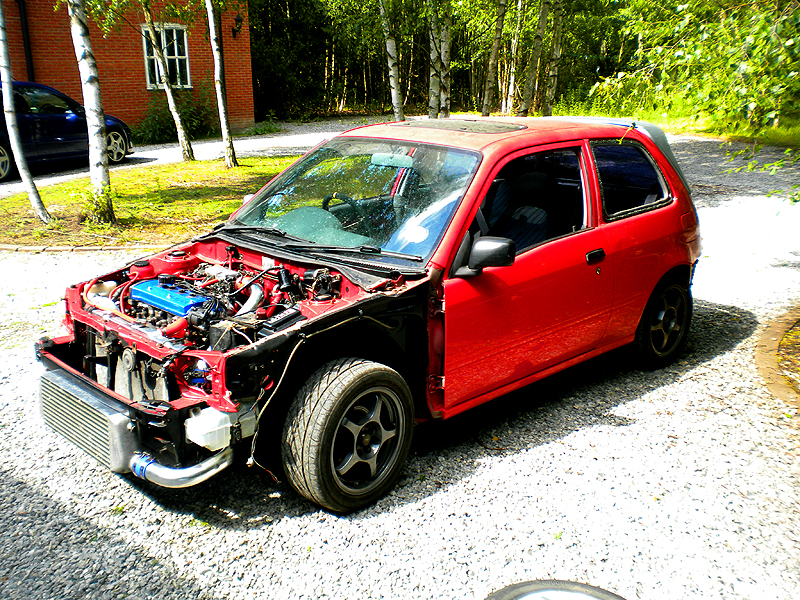

Socks Posted July 1, 2011 Posted July 1, 2011 dont get used to the wheels, they belong to DavidAshton.... we towed it back on them, so there coming off when Dave gets chance to collect them, we are just using them to move it about!We got both the shafts in today, filled the gearbox up with oil, started it up and got her up to temp and bled the water system. Even with no fan on a 22c day and no airflow the alloy rad kept it cool!The engine sounds spot on, sweet as a nut!So now.... left to do:Transfer Door Electrics (Passenger Side)Drill Holes for Door LoomsRebuild Bodywork, Bumpers, Wings, Bonnet, Lights. etcBlank off D/V Outlet ProperlyDrill Holes and Mount SkirtsGet O2 Sensor out an old Cat to bung hole up in fitted Cat!MOT & Tax.... Sorted Mark should be going to japfest 2 Quote

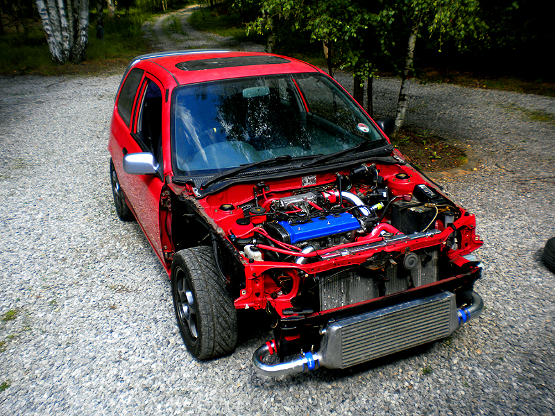

TrisK Posted July 4, 2011 Posted July 4, 2011 1) why is the intercooler puttogether with red hoses on teh table, and fitted with blue?2) socks couldnt you lend a headlight for MOT? unless it genuinly doesnt have a functioning headlight at all :/3) fastest conversion ever, ill be interested what your doing with the bumper! Quote
Socks Posted July 4, 2011 Posted July 4, 2011 Fuck me at size of that house isnt bad is it perfect for wat we r doin atm!1) why is the intercooler puttogether with red hoses on teh table, and fitted with blue?2) socks couldnt you lend a headlight for MOT? unless it genuinly doesnt have a functioning headlight at all :/3) fastest conversion ever, ill be interested what your doing with the bumper!1) cus the red ones from roose motorsport are like 6 ply, very thick, and the massive clips wont fit over them lol!2) i wudnt dismantle my car for anyone im afraid! plus its going to rickys very soon 3) thx matey. well, the bonnet and front bumper came off a crash damaged glanza, so its going to look proper ghetto! but hey its to pass an MOT cheers for the love Quote

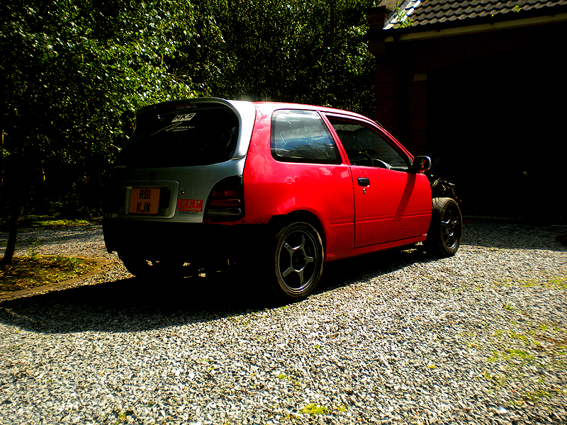

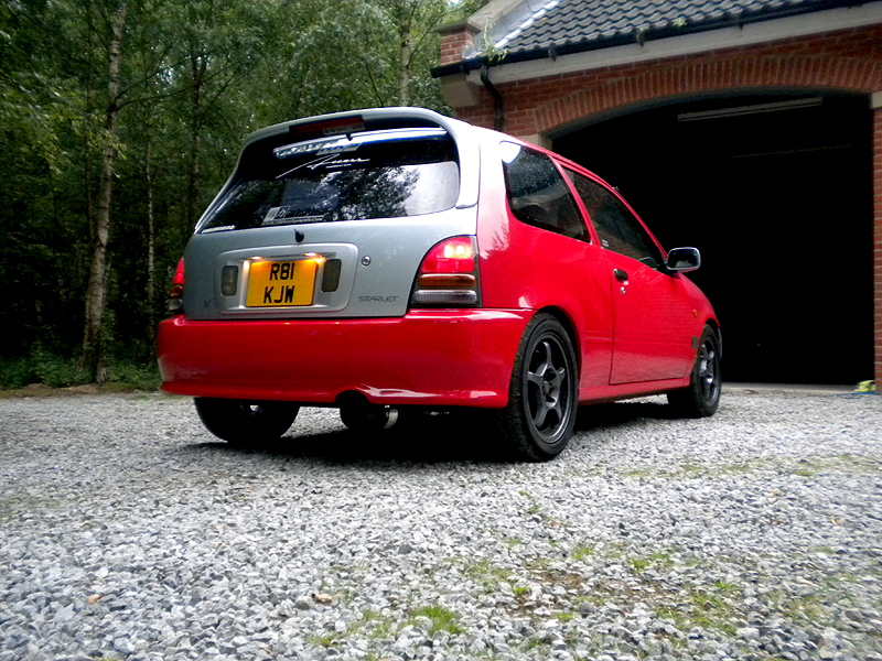

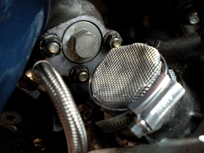

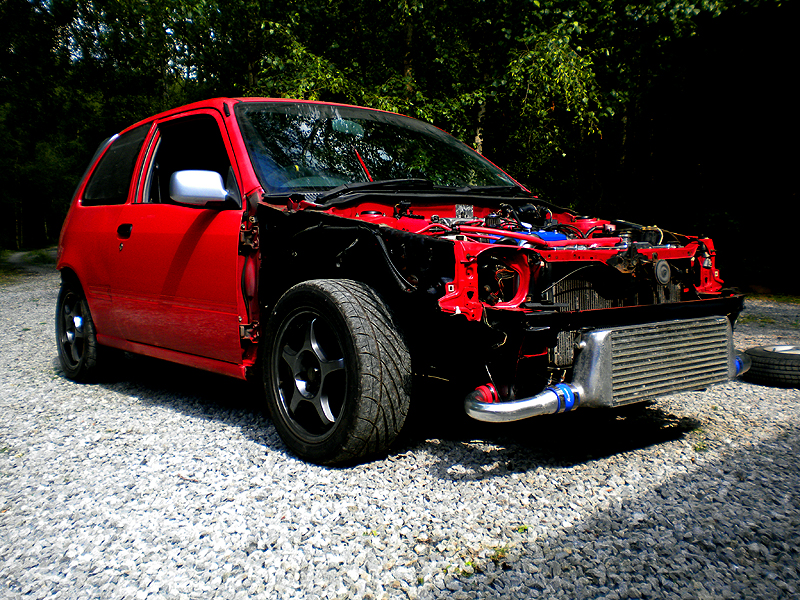

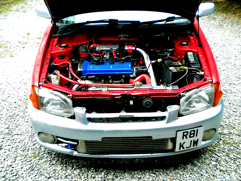

kidV Posted July 5, 2011 Author Posted July 5, 2011 UPDAAAATE!!!She's live and legal so i'm afraid you'll have to put up with us at japfest II couple of pic's of how she stands... would of been nice to be one colour but time is a factor working against...on route to be tested;the business end. custom 'filter' and the all important...so there we have it, the 'ghetto bitch' is ready for go, a little 'drift spec' but useable! super happy but far from finito...<3 all round and especially to matt!see you at JAPFEST II!!!kidV xo Quote
