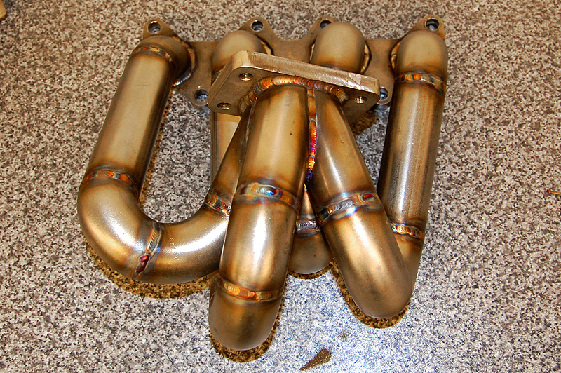

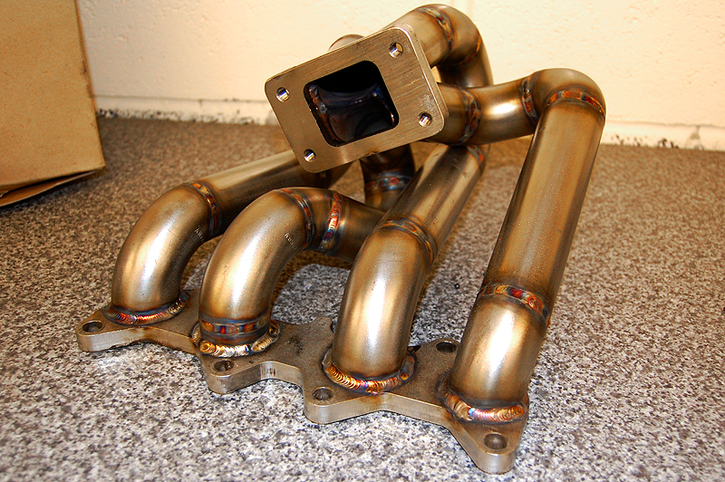

Ricky@Race-Tech Posted February 26, 2012 Posted February 26, 2012 Wepr all day long i have had a zisco mani and decat and wepr mani and decat not had any racetech products although i have seen them and are top quality items i personally feel wepr products are just that bit superior, and sacha is a top guy to deal with.As we constantly strive to improve our products I'd be interested to see your opinion of why Wepr products are that little bit "better".This seems to be their flagship turbo kit.http://www.wepracing...series-manifoldIts difficult to see the actual material/weld quality as they paint their manifolds. (not sure why?) Would this improve ours?They also appear to use a much shorter collector than us, (not good for flow) The flanges look to be water/laser cut from flat plate, ours are CNC machined and pocketed out at the back to ensure a perfect leak free seal. (this is just a td04 manifold)The wastegates appear to be the 2 bolt style, we always had problems with these blowing gaskets so went to the newer Vband type, Maybe we should revert back?Sorry for the bad picture, but heres a picture of our kit (sorry for the quality) The one pictured has a Vband back housing which doesn't require gaskets, flows better, is lighter and ensures a leak free seal. Quote

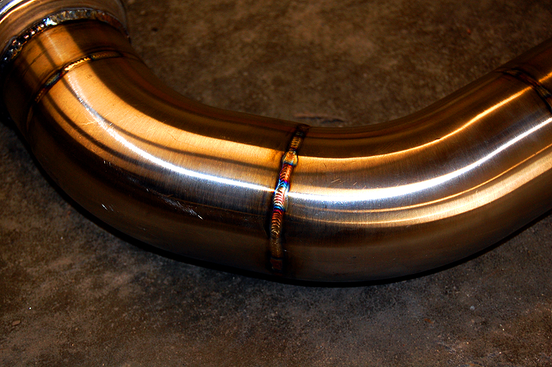

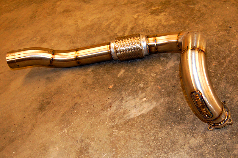

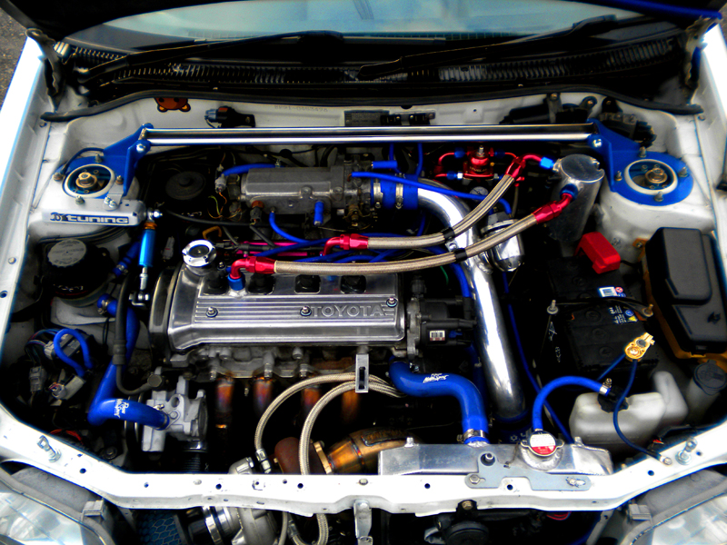

Socks Posted February 27, 2012 Posted February 27, 2012 Everyone knows what im going to say.... and there right... But the fact your literally 30mins from Race-Tech would make my descision alot easier! Local support is somthing alot of people would cry for!As for my kit, love it, looks amazing and functions absolutely perfectly!and some from when it was built... You'll be nothing but pleased with Race-Tech mate. There turbo kits leave me speechless when you look at one close up or even one being made!Ontop of that, Ricky is actually a really genuine and quality bloke to work with, is very honest and will always steer you in the right direction for more power! Just my 2 cents Quote
