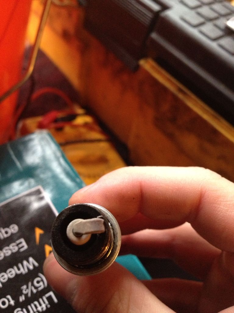

akyakapotter Posted January 28, 2013 Author Posted January 28, 2013 Just whipped the spark plugs out they all look like this Quote
akyakapotter Posted January 28, 2013 Author Posted January 28, 2013 Quick vid out side my mums house dose this alot more when driving turbo seals or valve stem seals ? http://youtu.be/iGAkUrGTVGk Quote
Socks Posted January 28, 2013 Posted January 28, 2013 Was the car cold when u filmed that? If it was up to temp... and its bluey coloured could be turbo seals yeh.... If it was cold could just be moisture in the exhaust it is very cold atm! Quote
akyakapotter Posted January 28, 2013 Author Posted January 28, 2013 Yeah man was warm been on for about 15mins mate so maybe turbo seals that's not to bad that would explain the smoke but what about my crap fuel now lol lambda ? Quote
