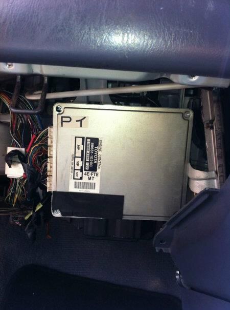

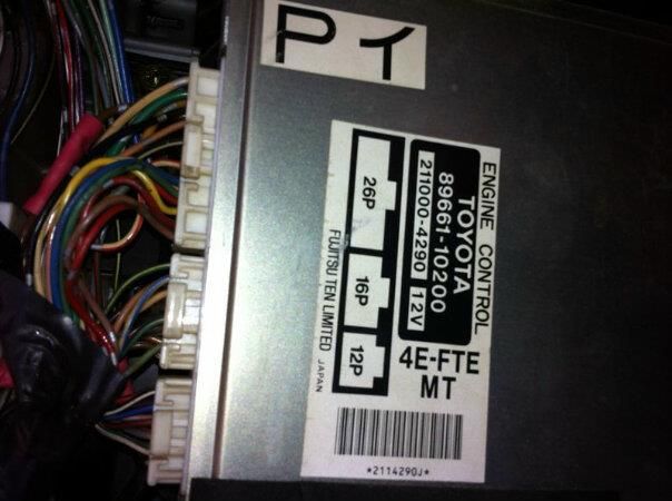

mowgli123 Posted May 6, 2013 Author Posted May 6, 2013 http://s1061.photobucket.com/user/mowgli1234/media/575597_10151334584946486_310025988_n_zps85918fc8.jpg.html'> http://s1061.photobucket.com/user/mowgli1234/media/946903_10151334584726486_982946228_n_zps81afbc97.jpg.html'> That's my ECU. Stock? Quote
Matt1878 Posted May 6, 2013 Posted May 6, 2013 Yes, stock ecu.. Personally I'd get rid of that manual boost controller.. They are just trouble. Set the actuator to a safe .7 bar to allow for slight boost creep and you will avoid fuel cut.. In the meantime.. Save up for a proper management setup like a plug and play it piggyback ecu.. Quote
