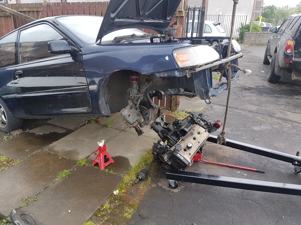

daniel_g Posted August 14, 2016 Author Posted August 14, 2016 So before i had a chance to swap engines this happened haha.And yet again oil sprayed onto the exhaust manifold heatwrap and a wee fire broke out. Luckily i keep a few bottles of water in the car for such occasions.. caught it early and the only visable damage is the protective coat around the MAP sensor wiring has melted slightly.In the meantime i'll be driving this about.That Glanza shell i have will be getting stripped right down for its wiring loom etc to convert this And back to the 4paw, im thinking build a high comp forged motor up, wind the boost up to 1.4bar on this new TD04, standalone, supporting mods and say hello to 280bhp. Quote

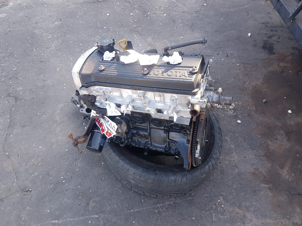

daniel_g Posted August 16, 2016 Author Posted August 16, 2016 Genuinely love those three spokes.I hate them. I hate the sportif too. Pulled a decent night shift (4am type shit, outside rolling about the deck) to change the engine in the sportif, now got a weak spark / non start.Can see this being turbo converted very soon. Got most of the parts there. Quote

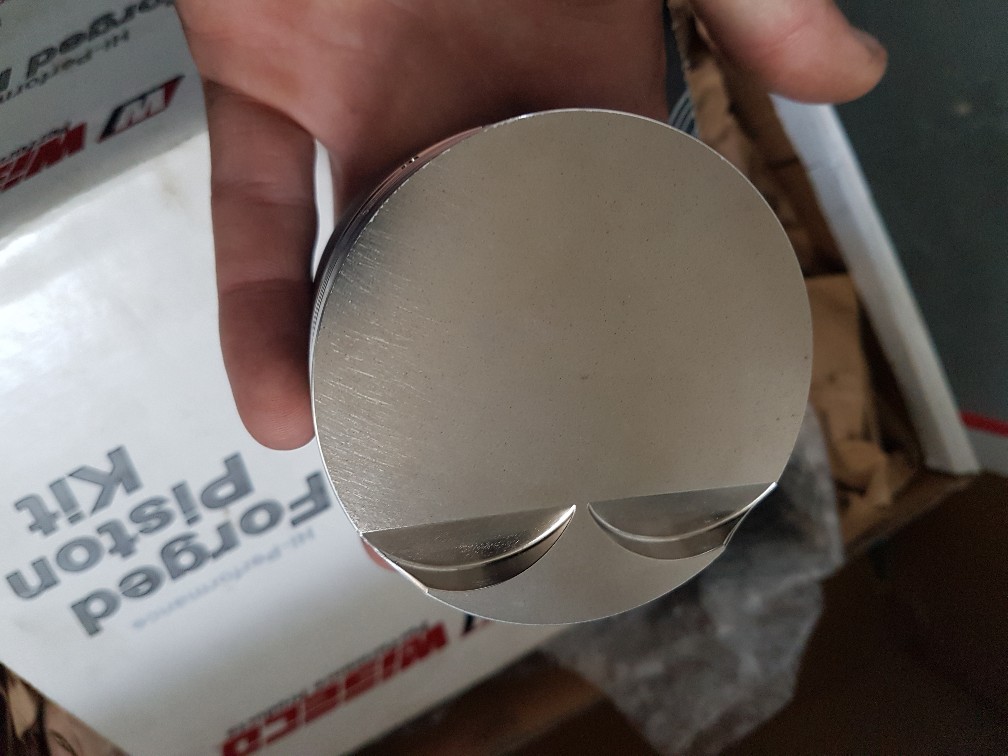

daniel_g Posted December 1, 2016 Author Posted December 1, 2016 Ended up scrapping that N/a after not very long, it was a terrible daily, in every way! Went and got a legacy saloon.. then got a wagon again Havent forgot about the 4paw though! Bought some forged rods and pistons for it, will be collecting the rest of the parts in a bit. Pistons are wiseco 74.5mm, and went for Maxspeeding rods, the engine builder im gonna use swears by them. Will be going for a 0.5mm HG and ARP headstuds not bolts A 4paw welded rear diff, solid prop piece and front CVs came up for sale nearby so had to go get them haha.. thinking put the solid prop in which removes the viscous coupling, and fire the welded diff in, this should give me 50/50 power split.. and probably very poor handling, and 2 broken halfshafts :/ Or i could take the front shafts out and have it RWD.. although i will 100% die, especially when its forged and the TD04 is at 1.4bar I've also bought the GT shell which won TOTB twice a couple of years ago, theres a few bits on which i might switch onto the 4paw ;) Quote

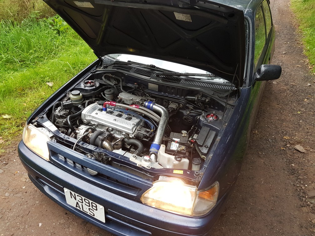

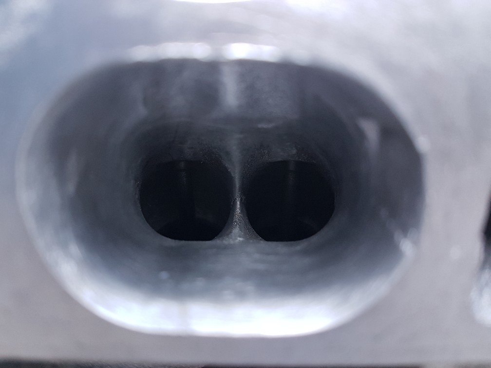

daniel_g Posted July 17, 2017 Author Posted July 17, 2017 Havent updated this in a long time!So after blowing up a few engines in various catastrophic ways i decided after nearly 4 years of 4paw ownership it was time to get a forged engine built Cuthill Engineering built 4EFTEMild headwork, polish / skimARP headstuds0.5mm metal headgasketBlocked deckedWiseco 74.5mm pistonsMaxspeeding rods / ARP boltsARP main studsLightened flywheelAll components weighted and balancedPlus all new Toyota gaskets / oil / water pump etcIt works out a higher spec than Race Tech or TD stage 3 engines.Removed the old blown engine and swapped over my exedy 3 puk clutch, refit gearbox and transfer box.Barely ran it in and took a run upto Crail for Banzai in May... did two runs, both of which i fucked it into 2nd gear... needing to get used to the lightened flywheel. Paired with the short ratio box it revs like a fuckin superbike. Quote
daniel_g Posted July 17, 2017 Author Posted July 17, 2017 Since these pictures i have swapped on a 205 black MK3 GT boot and spoiler. Also have both GT black doors now... not 1 black and 1 white Quote

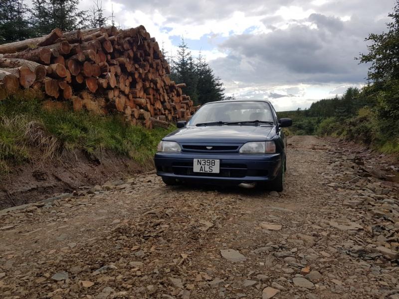

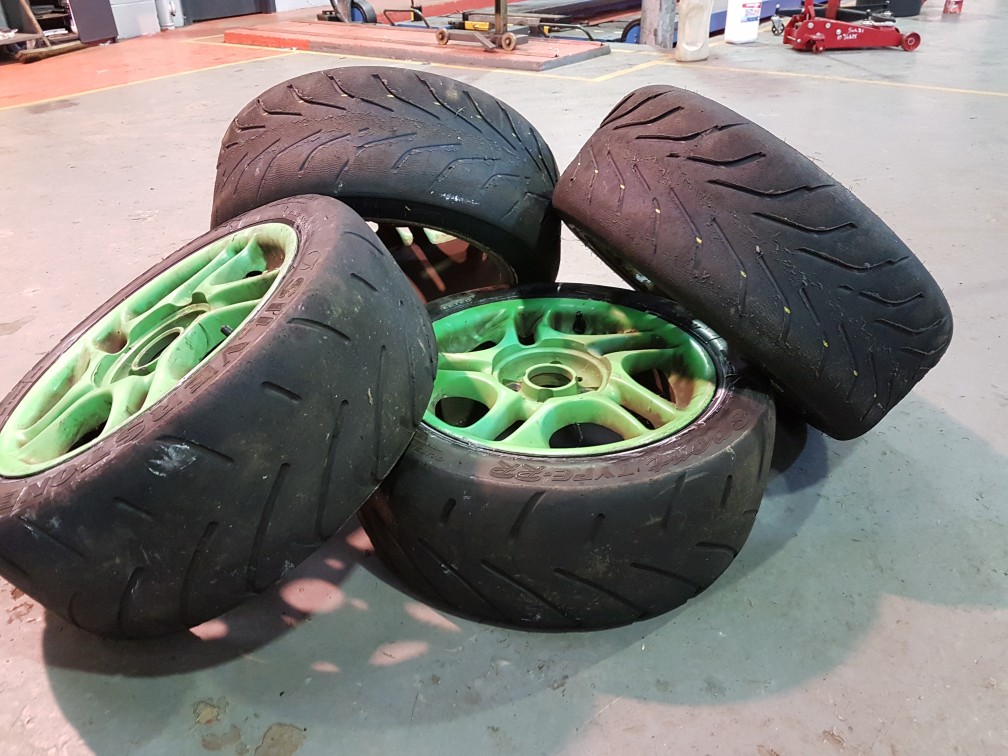

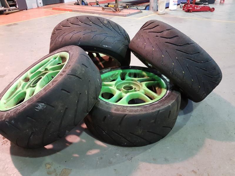

daniel_g Posted August 8, 2017 Author Posted August 8, 2017 Been out a few blasts in this recenty Picked up a couple pairs of cheap track tyres so fired them on my spare wheels. The r888 have seen a couple laps too many to be used on the road but the old skool silverstone ftz are sound-ish, chucked them on the front, or until i inevitably get pulled over. Quote
maddox710 Posted August 8, 2017 Posted August 8, 2017 I love the front end of this Dan! Them old r888 go really shit after they've seen too much heat cycles, the Nanking ns2r hold up really well to the heat and don't drop of as bad if your considering a new tyre Quote
daniel_g Posted August 8, 2017 Author Posted August 8, 2017 Cheers man! I do like it too, something a bit different. Facelift JDM front.I rate those NS2R pretty high, i have a pair of them on another pair of alloys. Although i managed to tear through both inner shoulders very quickly, due to camber and dodgey wheel bearings. Quote

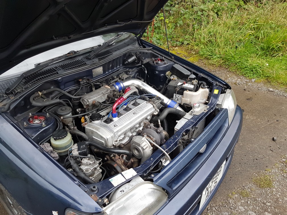

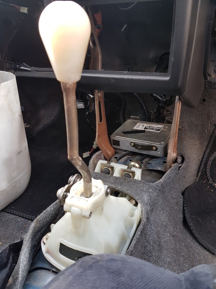

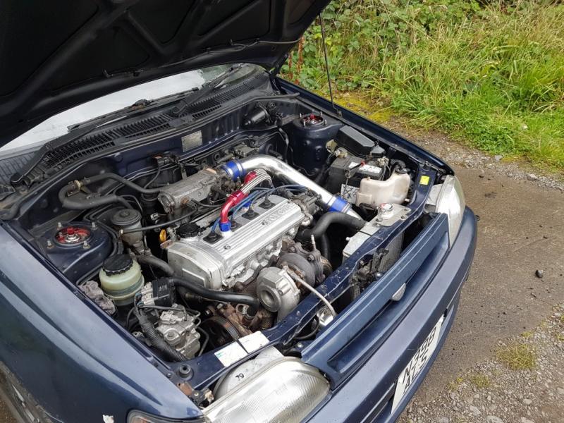

daniel_g Posted September 3, 2017 Author Posted September 3, 2017 So ive recently fitted a DIY short shifter and a set of gear cables with solid bushes. Cant believe the difference!Had a mate weld up a rocker cover with AN12 fittings, and a pair of braided hoses made up by a local hose company. Probably a bit overkill but there shouldnt be any crankcase pressure issues in future. Just need the inlet blocked up properly.Ive also taken off my TD04, it was smoking quite badly, its away back to Midland turbo to be checked over as it was rebuilt by them about a year ago.Ive fitted my VF12 again love this turbo, it is laggy though, i will be able to improve that with a better intercooler setup and an EBC, for now until i get a standalone.Yesterday i had it up on my ramp in work so carried out an engine oil and filter change, also did the rear diff oil and gearbox oil. Will do the transfer box when i can be bothered.Went out a blast to see whats what and get a couple pics. Up to Dunblane, back roads to Kinbuck and into Braco, then nailed it along a straight, developed a misfire.. There was nothing obvious at first glance so crawled it home. Will inspect it properly tomorrow. Quote
Ollieh17 Posted September 5, 2017 Posted September 5, 2017 that oil feed running over the slam panel would bug me lol Quote
daniel_g Posted September 5, 2017 Author Posted September 5, 2017 that oil feed running over the slam panel would bug me lolThats the best route for it on my setup. I had one that ran too close and melted before, sprayed oil all over the heatwrap, which set the bay on fire. Which was fun. It cost me an engine. Shaun was behind me at the time. Thats when i had to use a bottle of peach volvic as a fire extinguisher. Quote
