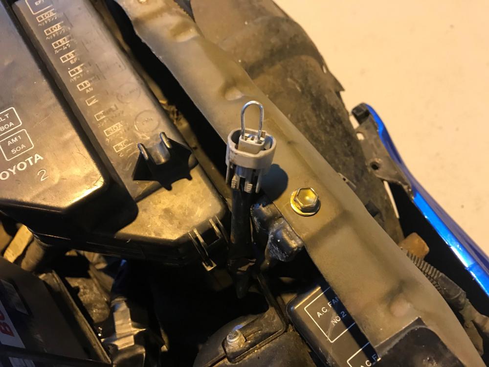

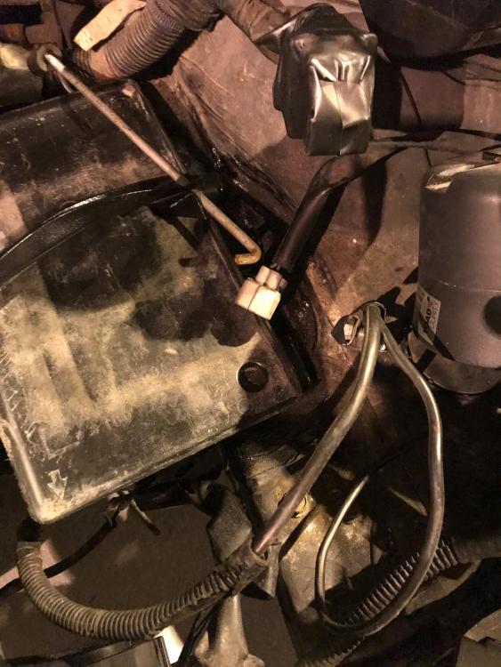

Nilz90 Posted March 19, 2024 Posted March 19, 2024 On 11/10/2013 at 11:13 PM, morgey said: Unplug the sensor and see if it stops. then run a wire from the connector to an earth. See if it stops or starts 1)If it stays running when unplugged but stops when earthed then your sensor is open when cold but needs to be closed. 2) if it stops when disconnected then your sensor is closed when cold but needs to be open. I have this same issue. On my mk3 gt turbo 1994. The fan is always on constantly. Mines is 1) stays running when disconnected and when earthed it stops. is anyone able to confirm if it means I need the old type fan switch sensor or new type by this please? Quote
akyakapotter Posted March 21, 2024 Posted March 21, 2024 Has the ac been removed ? If so you need to bridge one of the connectors by the battery. Will stop the fan coming on straight away. Quote
Nilz90 Posted March 25, 2024 Posted March 25, 2024 (edited) On 3/21/2024 at 1:33 PM, akyakapotter said: Has the ac been removed ? If so you need to bridge one of the connectors by the battery. Will stop the fan coming on straight away. Managed to sort it now put an older type switch in and it worked the fan is now coming on at around 92 degrees is that correct and good for a 5E running 280bhp or would it be better to invest in a low temp thermostat? Edited March 25, 2024 by Nilz90 Quote
Nilz90 Posted March 27, 2024 Posted March 27, 2024 It stopped working the next day anyone know what can be causing it to not function again? I have voltage coming to the fan switch Quote
