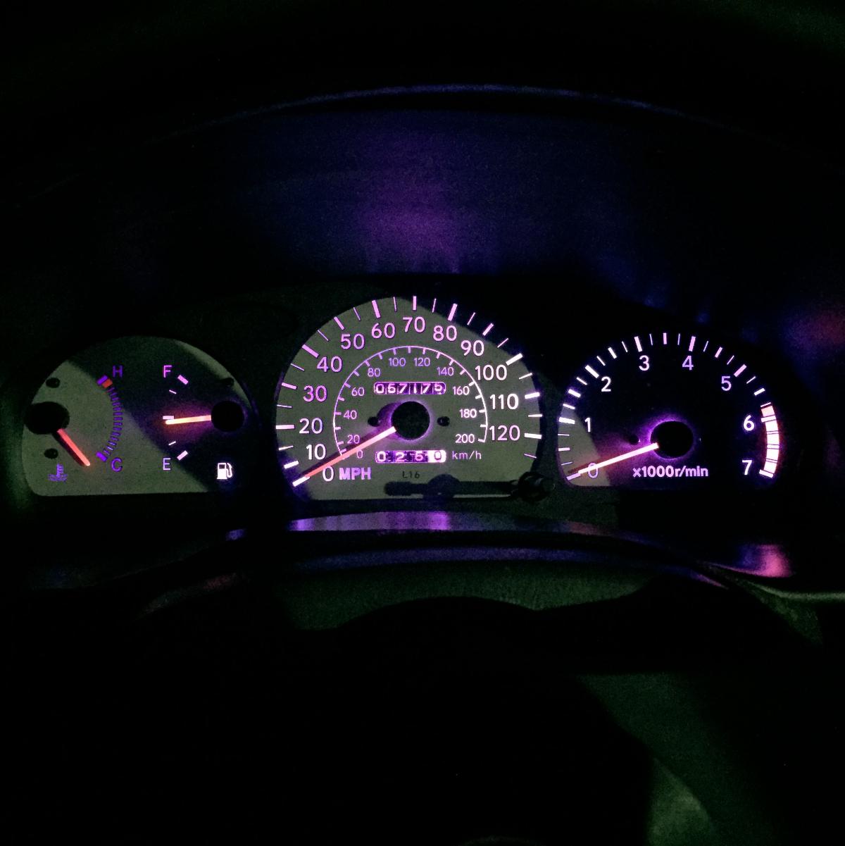

chris84 Posted June 15, 2015 Posted June 15, 2015 I need some leds for my dash. Where did u get them from mate ? Quote

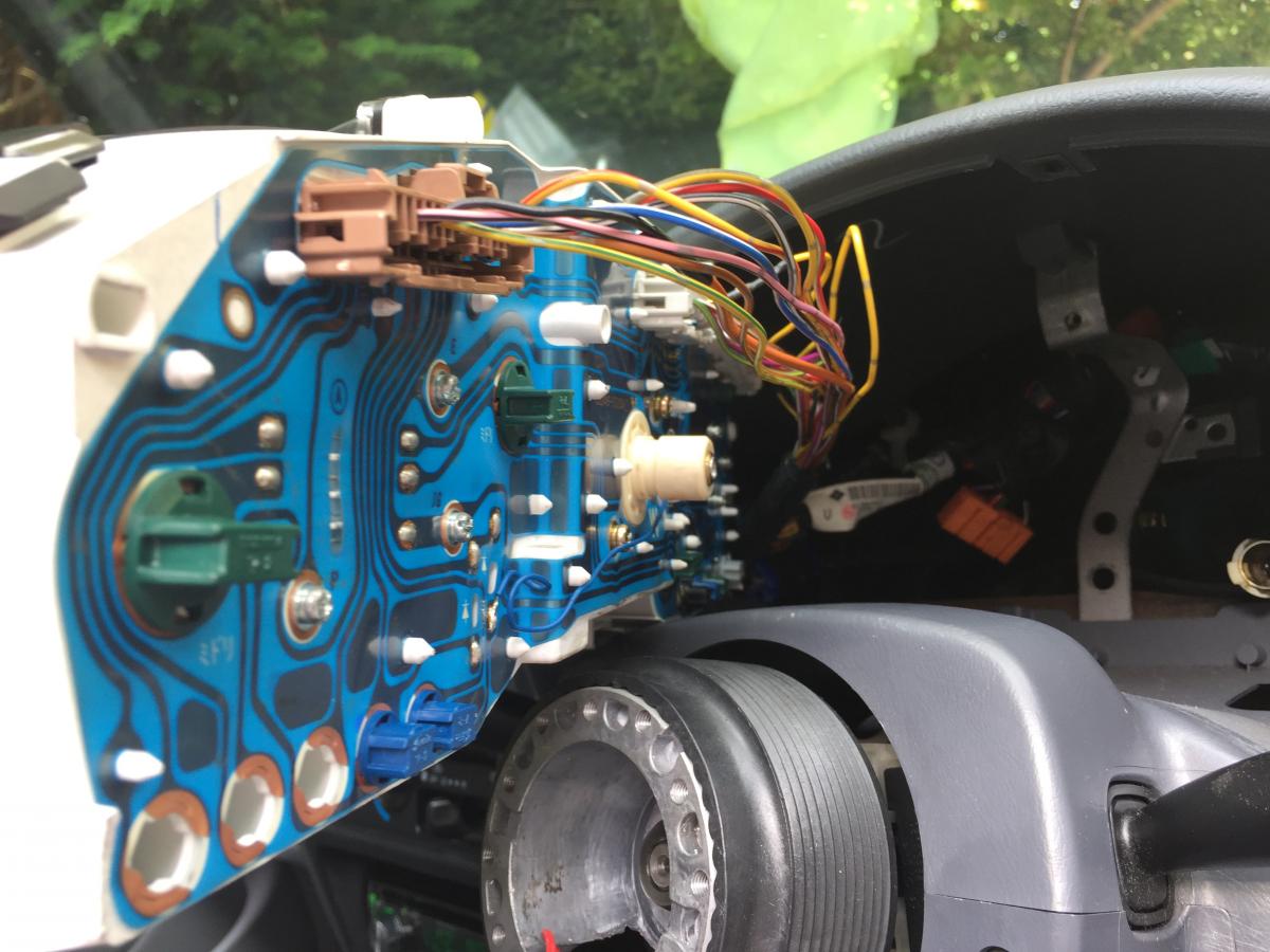

*Pete* Posted June 16, 2015 Author Posted June 16, 2015 I need some leds for my dash. Where did u get them from mate ? Ebay, i did have to buy them from China as noone in the uk did that colour but it will be 501(speedo), 286(speedo, center console & cig) and t3 neo wedge (switches/buttons) Quote

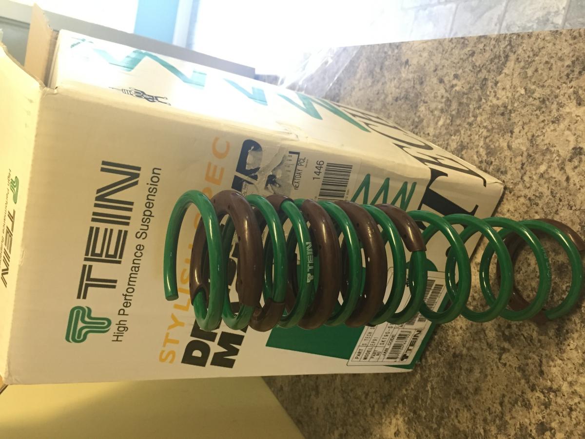

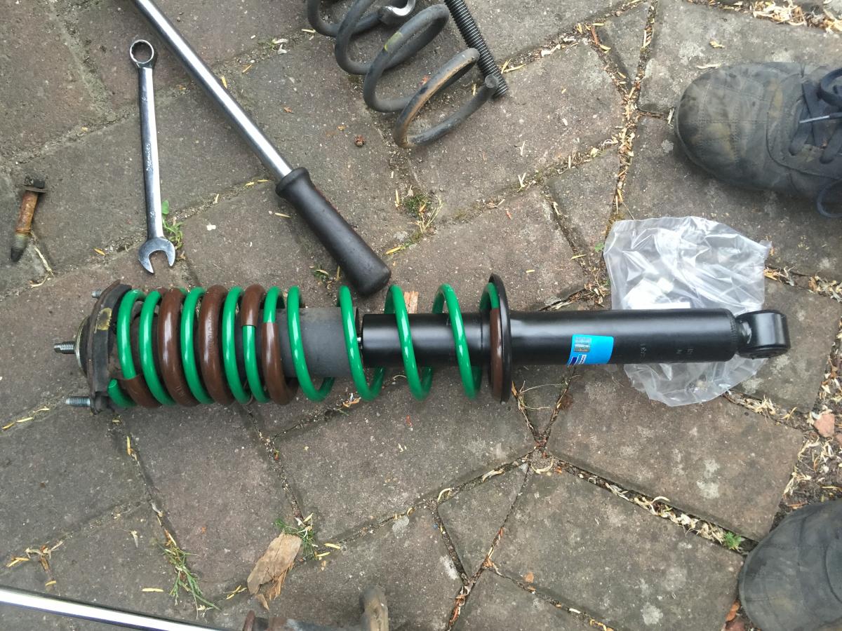

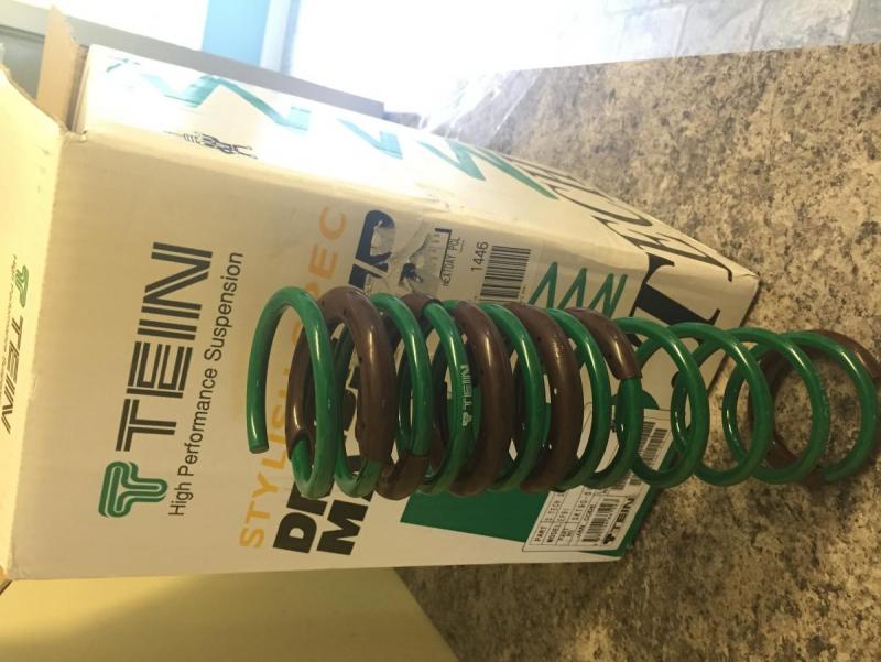

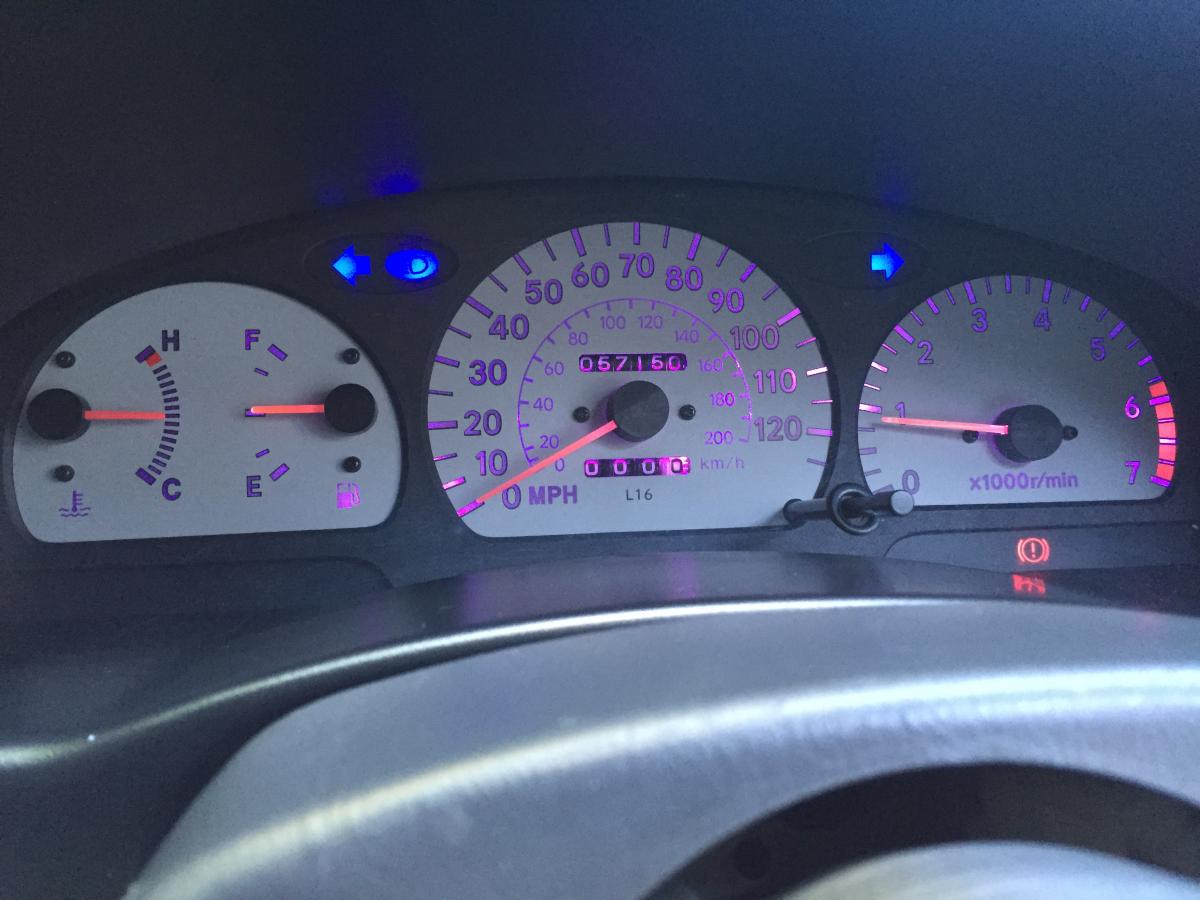

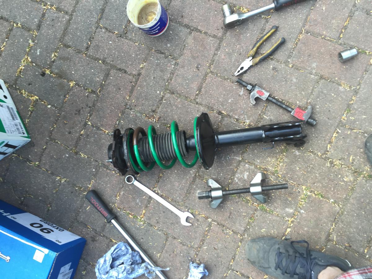

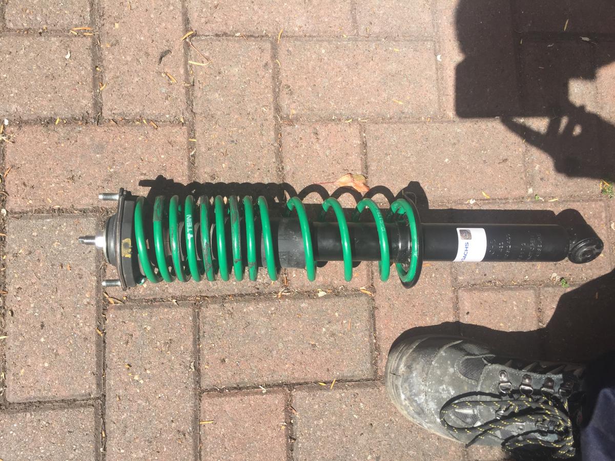

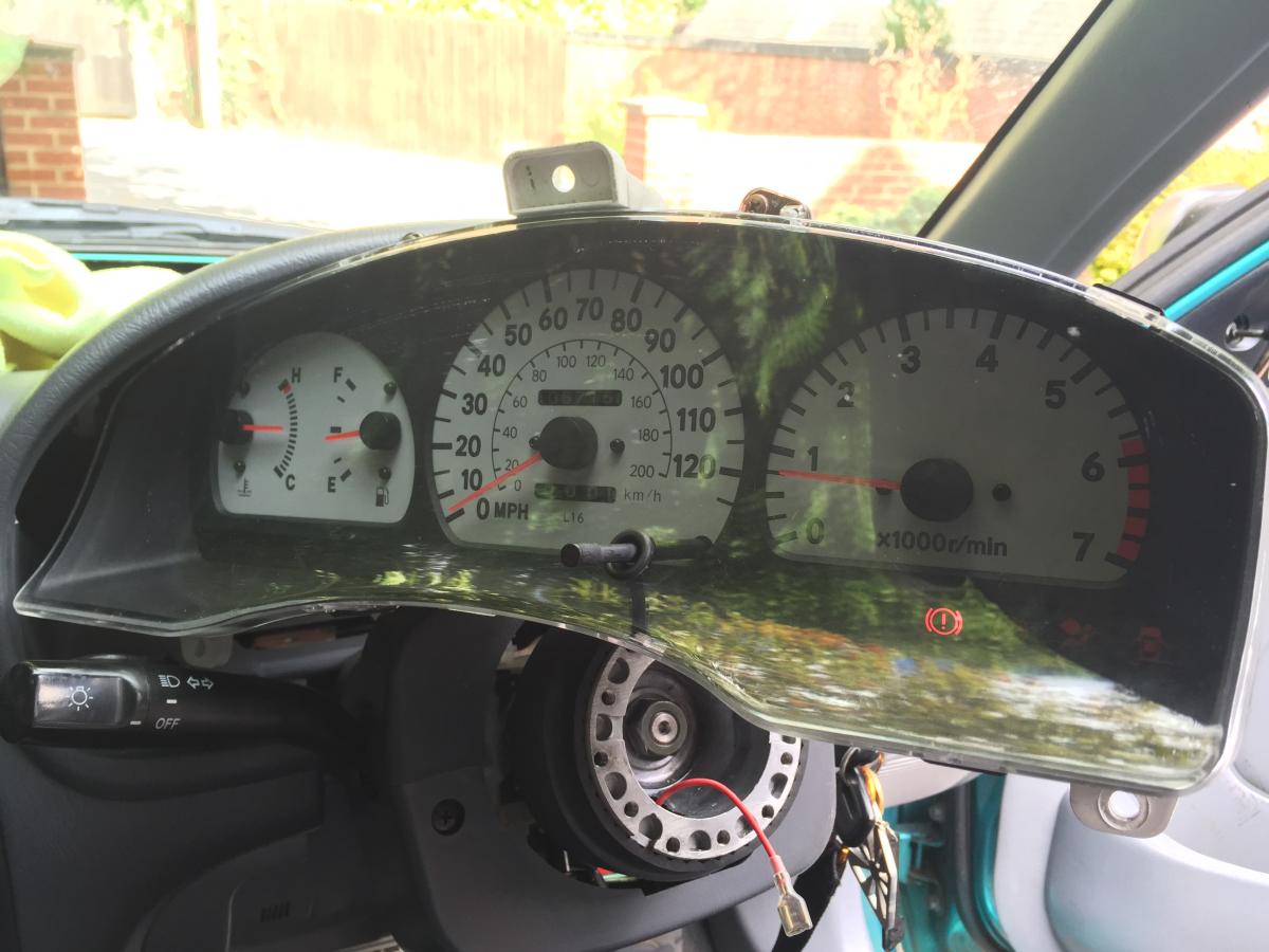

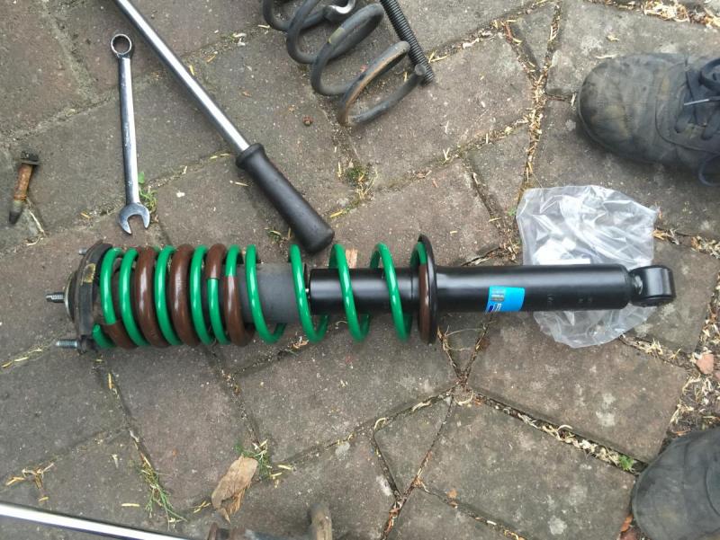

*Pete* Posted July 5, 2015 Author Posted July 5, 2015 (edited) Update: While ago put the peaso dials in that i had in my white one wound the mileage to the current clocks took awhile got from 140,000 miles to 57,000 but got there with a dremel and fitted purple lights, already changed my mine on the interior leds and now going to go green.Also fitted thrusday had some spare time so fitted the id workz gear shifter bearings was a bit of a struggle but worth it, much nicer feel for gears and much smother Also brought these springs and brought new shocks which was a pain first brought some bilstein ones but they not longer stock them to the uk :/ order some off ebay the day after they were meant to arrive they contacted me and say they were on back order so cancelled the order and the morning i went to eurocarparts to pick up air filter, fuel filter and spark plugs while there i just ordered shocks. Had to go back and pick them up at 4 so did the fuel air and plugs before then. fitted them when i got back went out was good by wasn't really sitting that low and there was a rattle at the back. so saturday took it all part took out the plastic bits on the springs and some other bits and fixed the rattle by the thread on the rear shock wasn't holding the top mount to the stepped bit where the bump stop/cover goes so put two washers on top so the nut was reaching the end of thread.Bit happier with how its sitting and now just waiting for it to settle a bit.Then with the time I had left I clean the motor and then took some photos Did decide to see what my car would look like in different colours Edited July 5, 2015 by *Pete* Quote

JDMfreak Posted July 5, 2015 Posted July 5, 2015 great little project there I like the tin foil idea behind heater dials makes the led's twice as bright Quote
*Pete* Posted July 6, 2015 Author Posted July 6, 2015 Looks great! What mm springs are they? There tein s so ment to be 57mm front and 50mm rear Quote

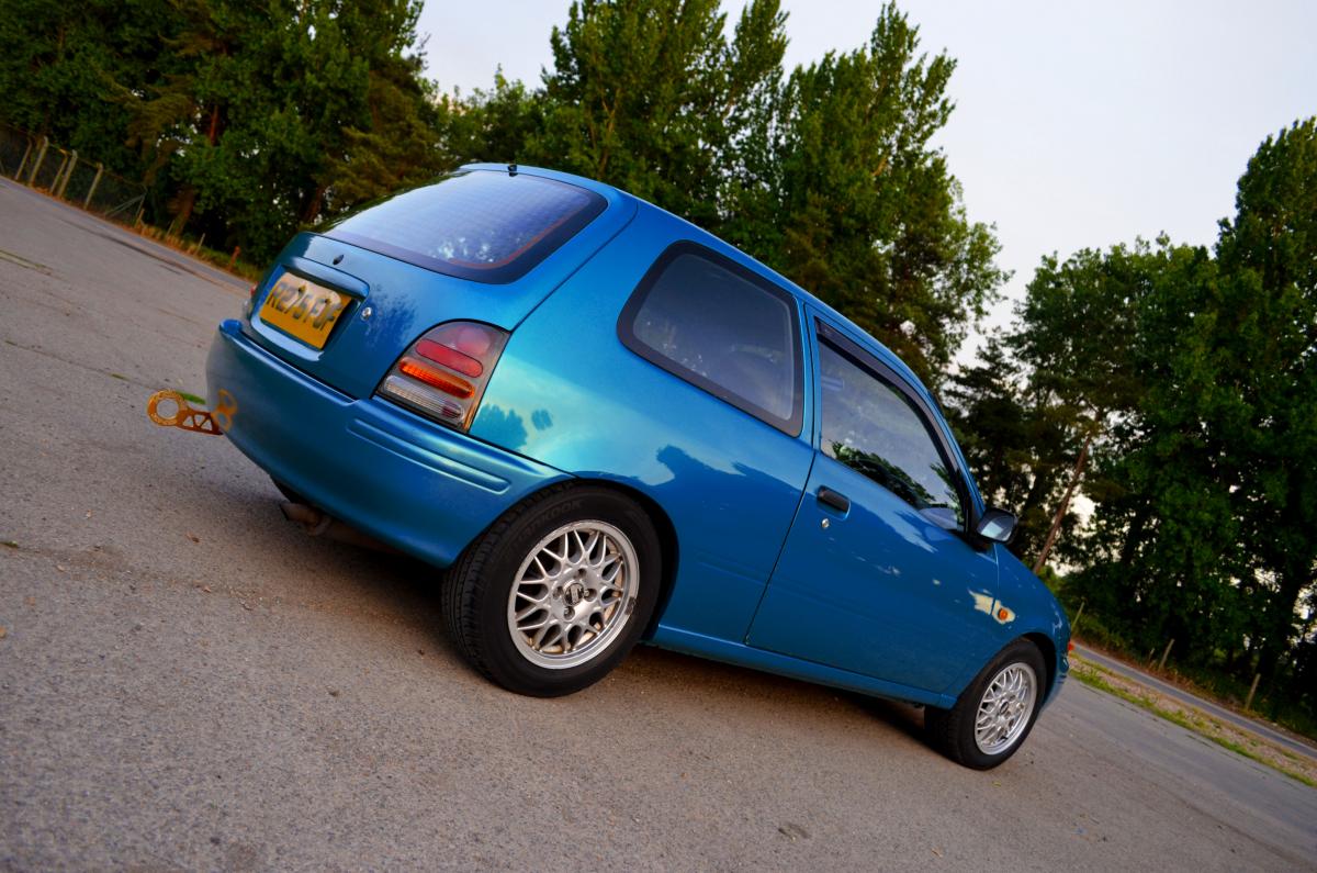

*Pete* Posted July 31, 2015 Author Posted July 31, 2015 Little update:Borrowing my brothers wheels possibly with the aim to buy them, for the keen ones there lensos and not bbsAnd got some stickers on Quote
Westley Posted July 31, 2015 Posted July 31, 2015 That paint comes up so nicely! We have matching lanyards! Quote
GlanzaJim Posted July 31, 2015 Posted July 31, 2015 Get some dencent wheels then it will look good 👍 Quote
*Pete* Posted August 1, 2015 Author Posted August 1, 2015 Yer love watching mightycarmods, cheers and I am still in two minds about the wheels they look good but then I something more jap style Quote

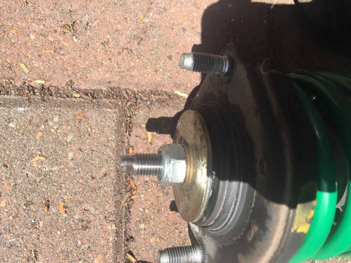

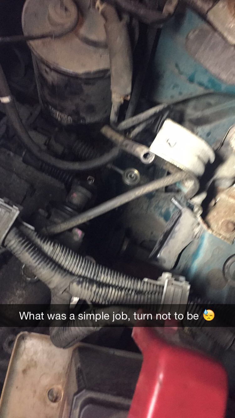

*Pete* Posted September 14, 2015 Author Posted September 14, 2015 (edited) Just flicking through my photo pictures I found a picture of the bolt I snapped on the anti roll bar bush from doing the engine mounts so had to drill it and using stud extractor got it out all I seem to do is snap bolts :/Also at JAE while charging my phone via my car i finished of my dash lights all one colour apart from the management ligths etcBrought a new purple tow hook at JAEAlso added my JAE band to my steering wheel Edited October 30, 2015 by *Pete* Quote
