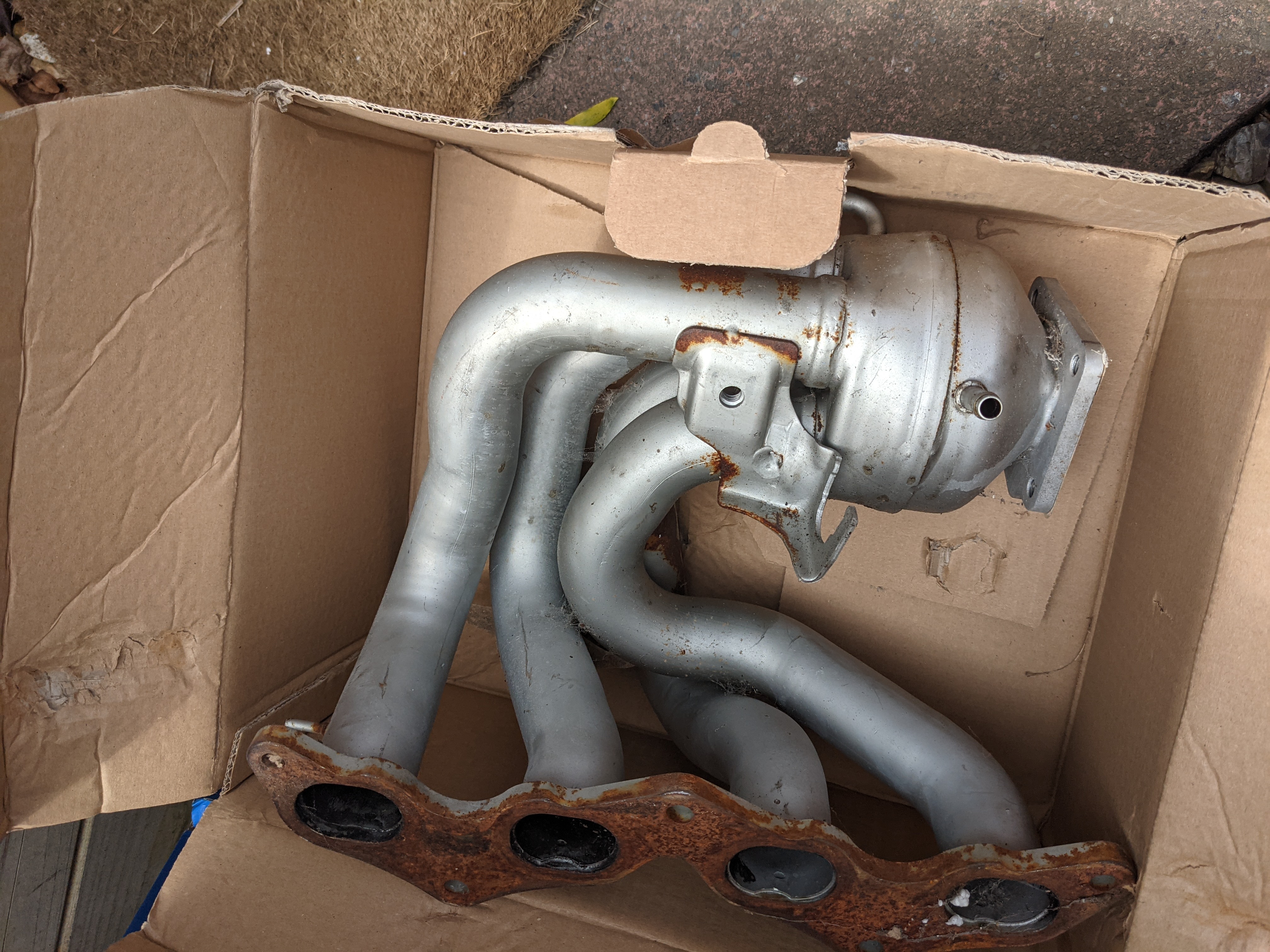

JLF88 Posted May 25, 2021 Author Share Posted May 25, 2021 Well, her plans are to tidy her up a bit first (faded plastics, deep clean) get some service work done (bearings, oil change, filters, timing belt, plugs, etc.), Then start on styling and tuning. On the styling side she's already got wind deflectors (who hasn't), but going to get a sunroof deflector also, as the noise is horrendous, but it's so nice having it open. She came with the optional extra MOMO alloys (but will need a real refurb as have bits of damage and only been sprayed without filling and smoothing), and I miss the winky faces shed had so getting some for her, and I don't have any ideas beyond that, untill I have money for Glanza body parts. As for modifications, got a pipercross panel filter, got lightweight water and alternator pulley, have a 5e-fhe full exhaust (manifold to tailpipe) to pick up this weekend, then need to source 5e-fhe throttle body (or 4a-fe), 4e-fe tubular intake manifold, certain set of corolla (or Glanza) injectors, piggyback ECU (emanage blue probably), and humming and haring over whether to take a risk on blown coilovers and trying to rebuild them, or just get springs as need comfort and height when heavy laden, and then go from there. Got ideas, just need money and to source parts. And the GLS come with better interior in a lovely colour, same on door cards, clear corners, rev counter, chrome trim in various places (handles, grill, window seal, dash, door cards), can't remember what else, but the interior alone and rev counter make a huge difference, and Chrome door handles make a subtle but nice look. GLS is top spec for a reason, that's for sure. Quote Link to post Share on other sites

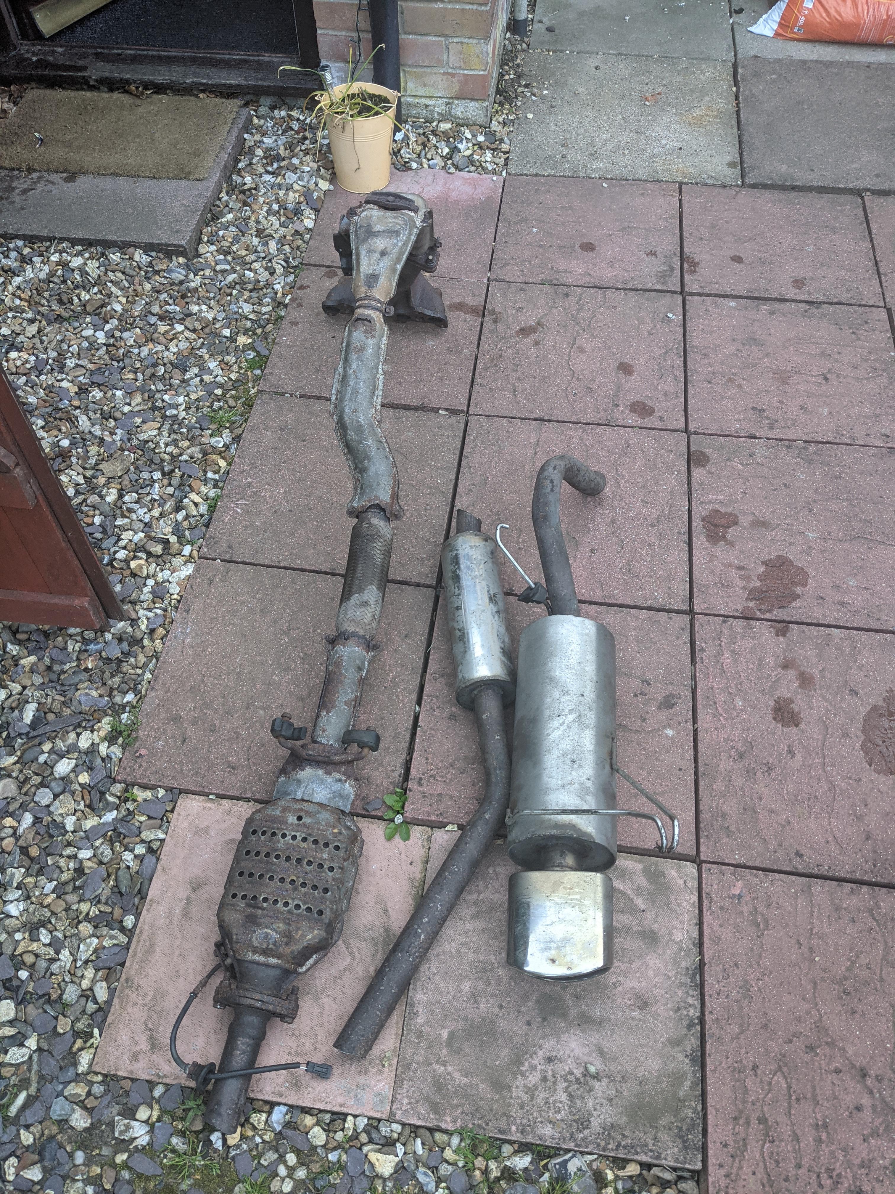

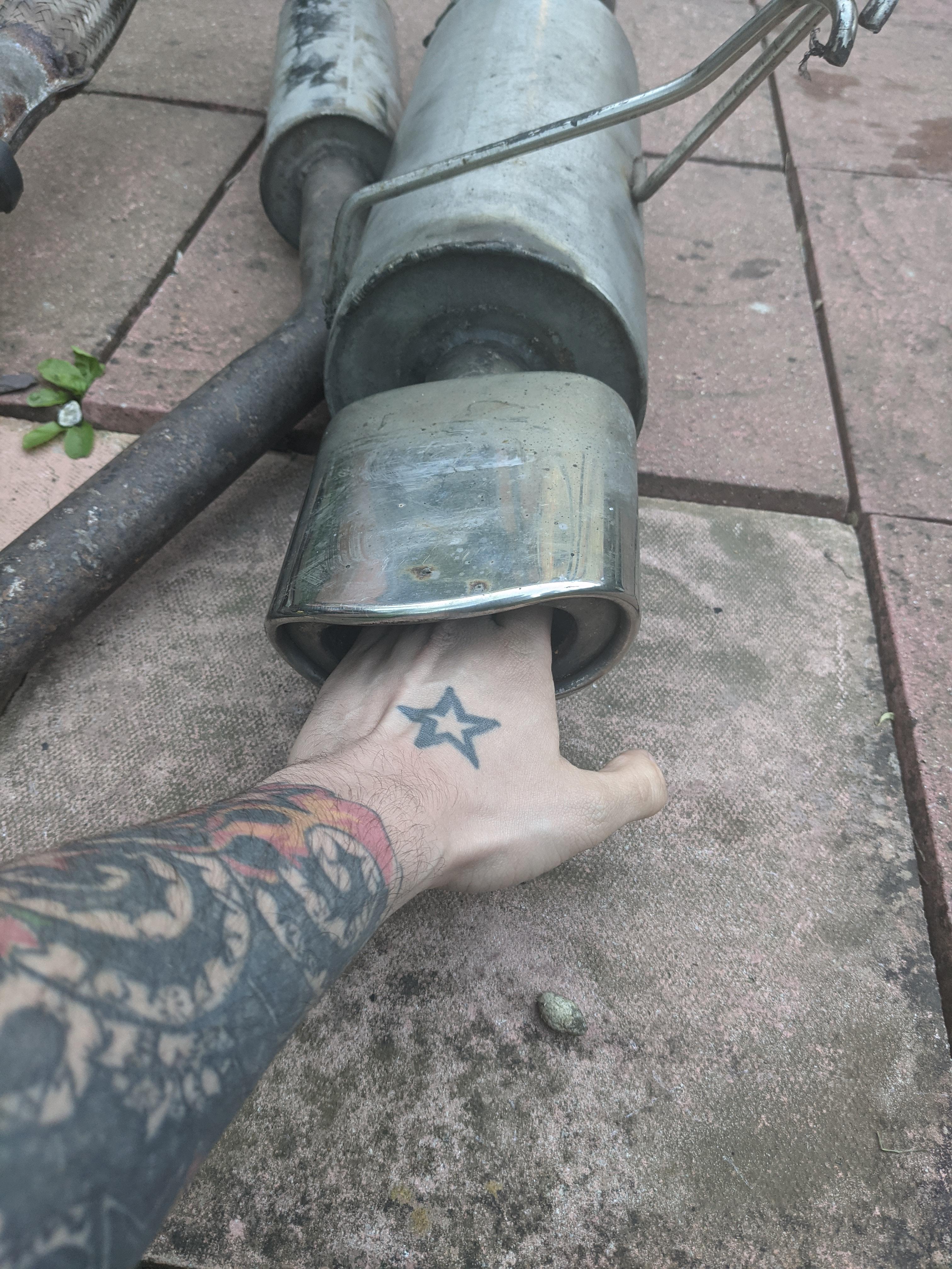

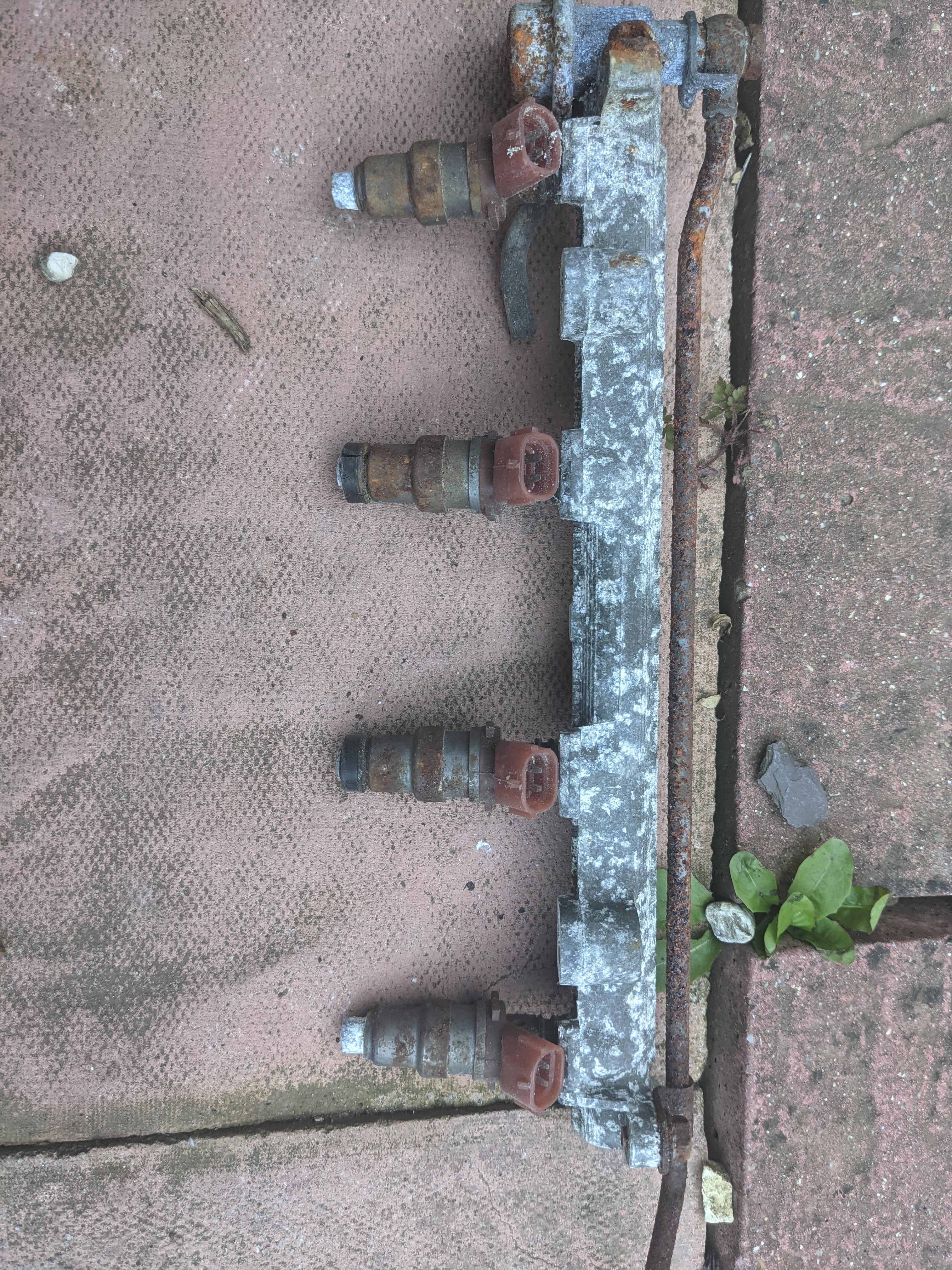

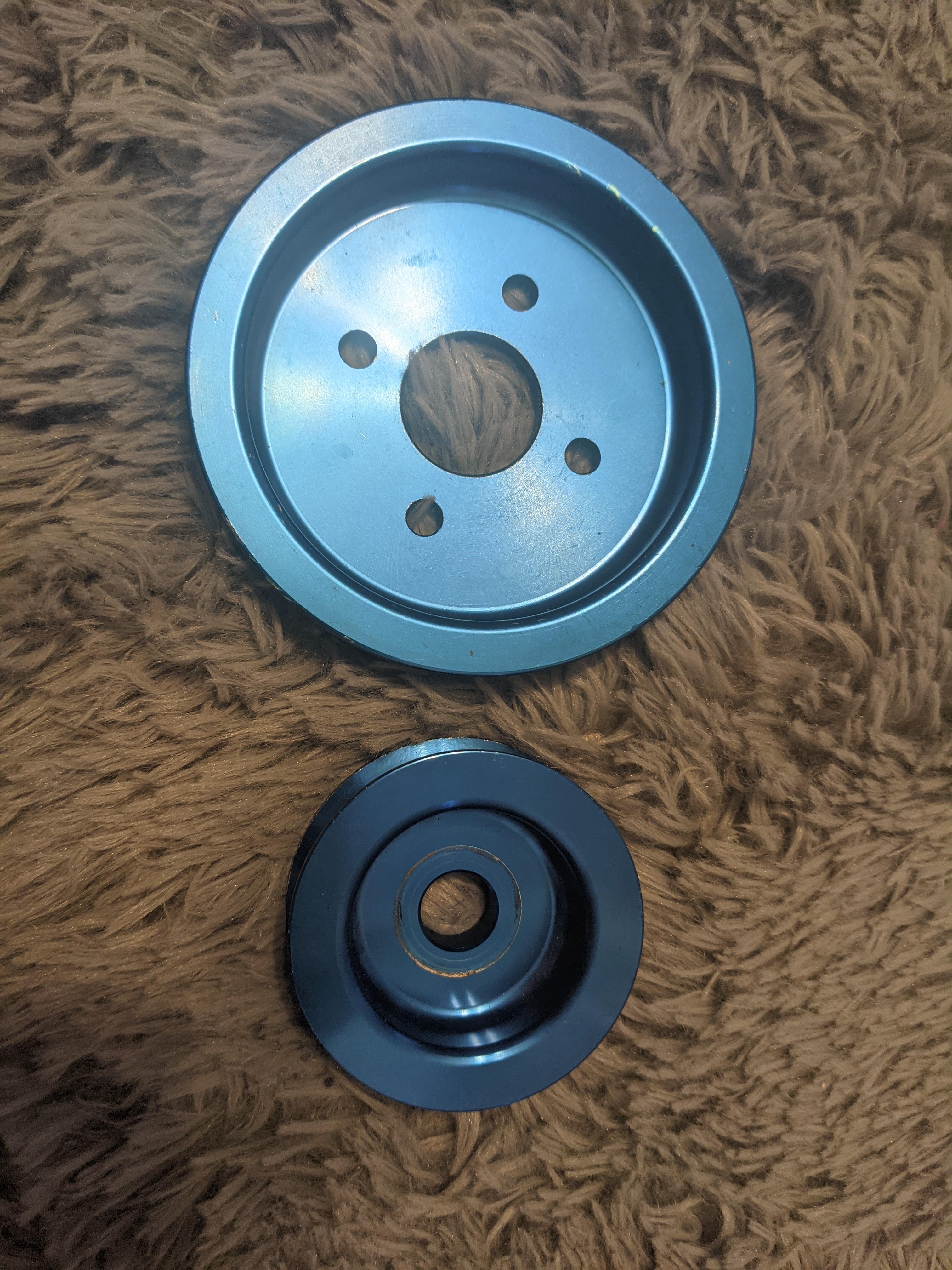

JLF88 Posted May 31, 2021 Author Share Posted May 31, 2021 Well, got a 5efhe full exhaust system, wasn't expecting the back box and tail pipe to be so big, 5efhe injectors, and a couple lightened pulleys. Just need to wait for the other parts to turn up, but probably won't get everything cleaned up and put on for a couple months. But it's a start, struggled so much to source these parts, used to be an easy task, now it's near impossible. Quote Link to post Share on other sites

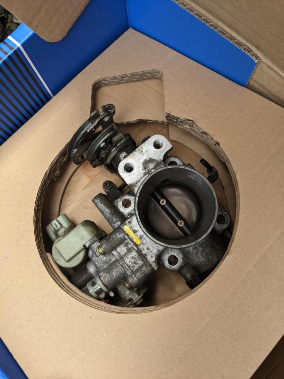

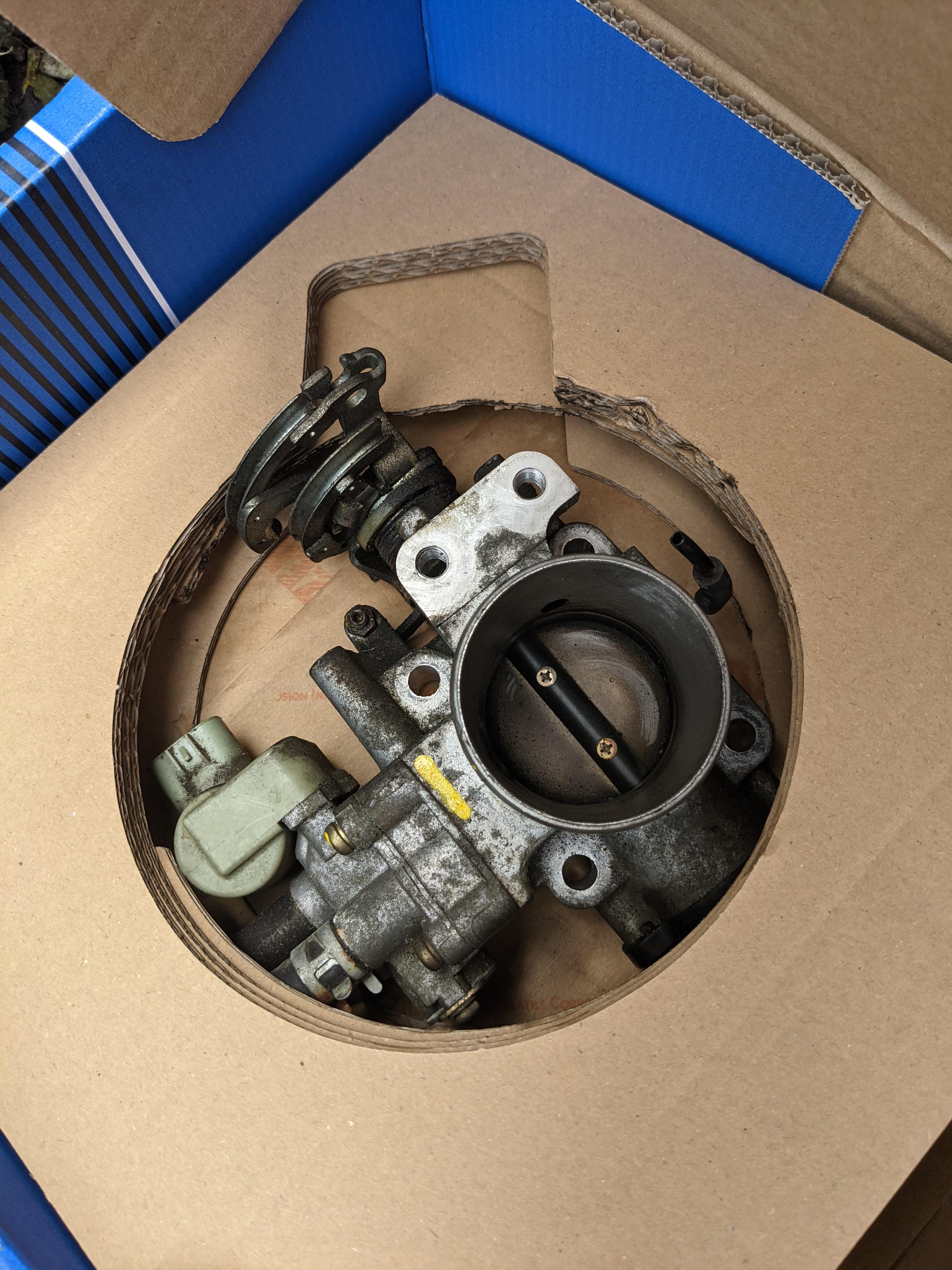

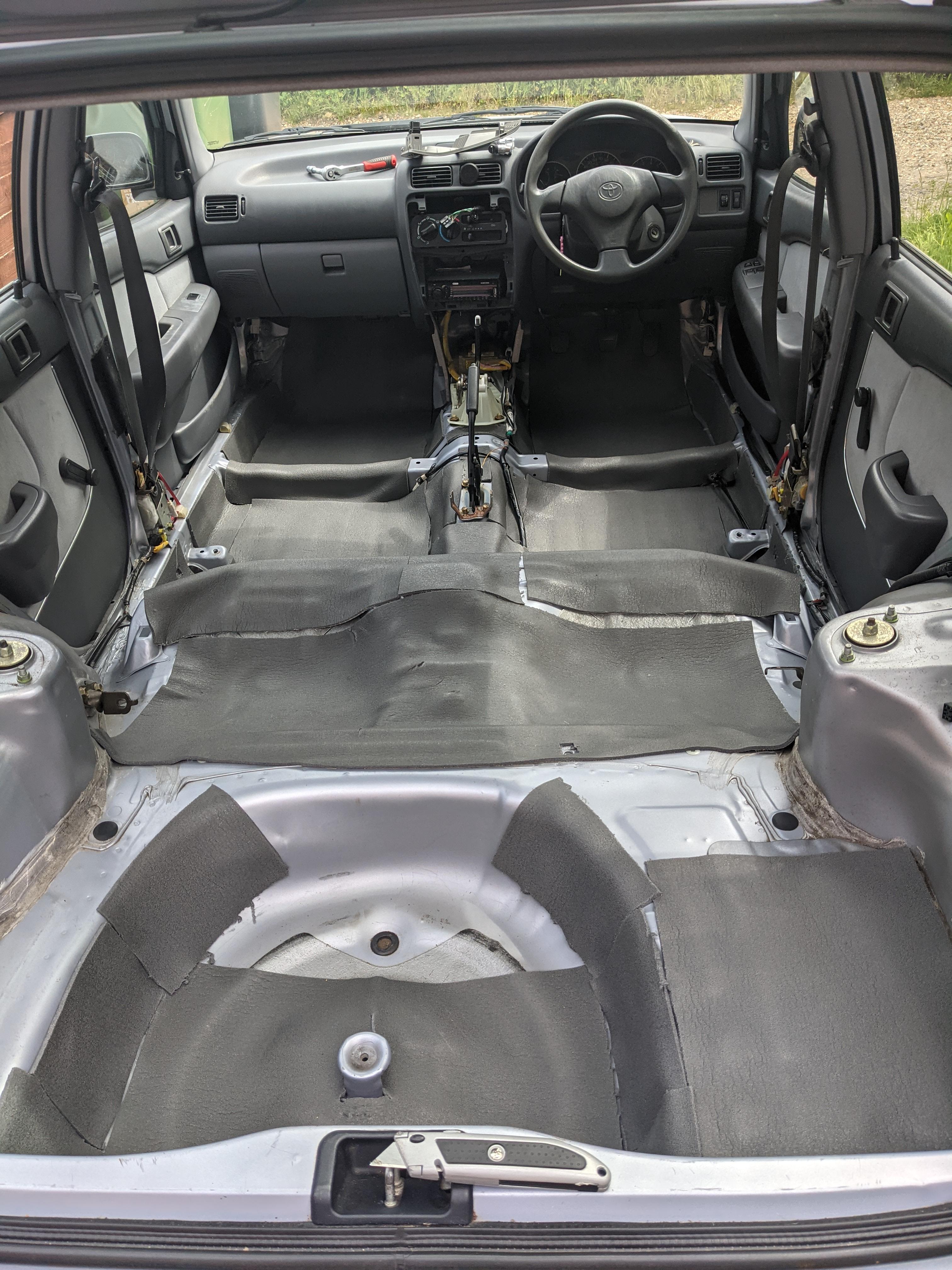

JLF88 Posted June 4, 2021 Author Share Posted June 4, 2021 Well today's a bit of a productive day, took the day off work to get a head start as busy most of the weekend, most of the way through installing noise reduction insulation, and two packages turned up, intake mani and throttle body 😁 Quote Link to post Share on other sites

Sam44 Posted June 6, 2021 Share Posted June 6, 2021 (edited) is this throttle body the sera 5ehfe unit. if so whats the internal diameter. the reason is i have a 5efe paseo running the power inlet manifold/sera inlet/4efte inlet/4efe gen1. trying to get the most out it. that inertia is nice. i have a 4efte inlet cam here if you are interested. Edited June 6, 2021 by Sam44 Quote Link to post Share on other sites
candy_red Posted June 7, 2021 Share Posted June 7, 2021 (edited) This looks like the 5efe TB. The inlet is identical to the turbo one, but necks down to 45mm towards the plate. It also has the variable TPS. I also believe this tubular manifold will provide massive gains up to 4-5k rpm. It will be a restriction though in the upper rev range compared to the turbo manifold. Dyno testing is your best friend on these things. Edited June 7, 2021 by candy_red Quote Link to post Share on other sites
JLF88 Posted June 26, 2024 Author Share Posted June 26, 2024 Well it’s been a slow two years, but all the belts are done, spark plugs, lower suspension arms, track rod ends, ball joints, new callipers, disks and pads, just need the tracking done and she’s road worthy, then it’ll be onto the tuning. was shocked how seized up many of the bolts were. Got the Corolla intake manifold on, trying to clean up the 5efhe injectors, the throttle body sadly was a no go, so on sourcing the same type I used in the past, but hoping to get round to measuring up and fitting the exhaust system over the next few weeks, and need to look into what piggyback ecu can be used. ill update in another 2 years when I get the next bits done. Quote Link to post Share on other sites

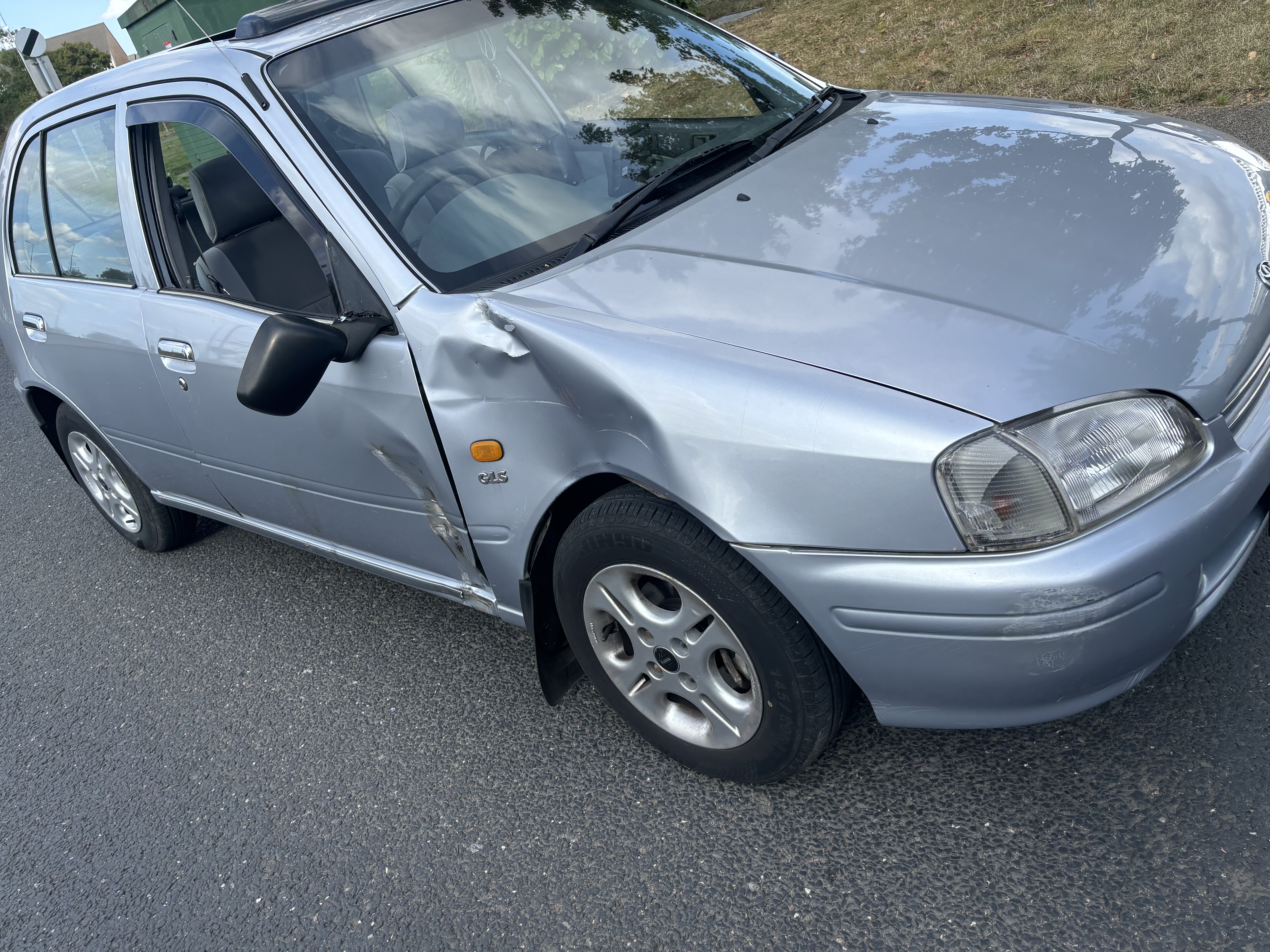

JLF88 Posted August 30, 2024 Author Share Posted August 30, 2024 Turned out to be the lambda sensor, new one fixed it, but then two weeks later the worst thing happened. She’s been wrote off by an idiot. Quote Link to post Share on other sites
JLF88 Posted October 11, 2024 Author Share Posted October 11, 2024 It’s a Cat B, even with the insurance I’m 2 grand out of pocket, can’t afford to buy another, so looks like after 11 years I’m finally done. but who knows, I may be back again, so I’ll just say farewell for now. Quote Link to post Share on other sites
