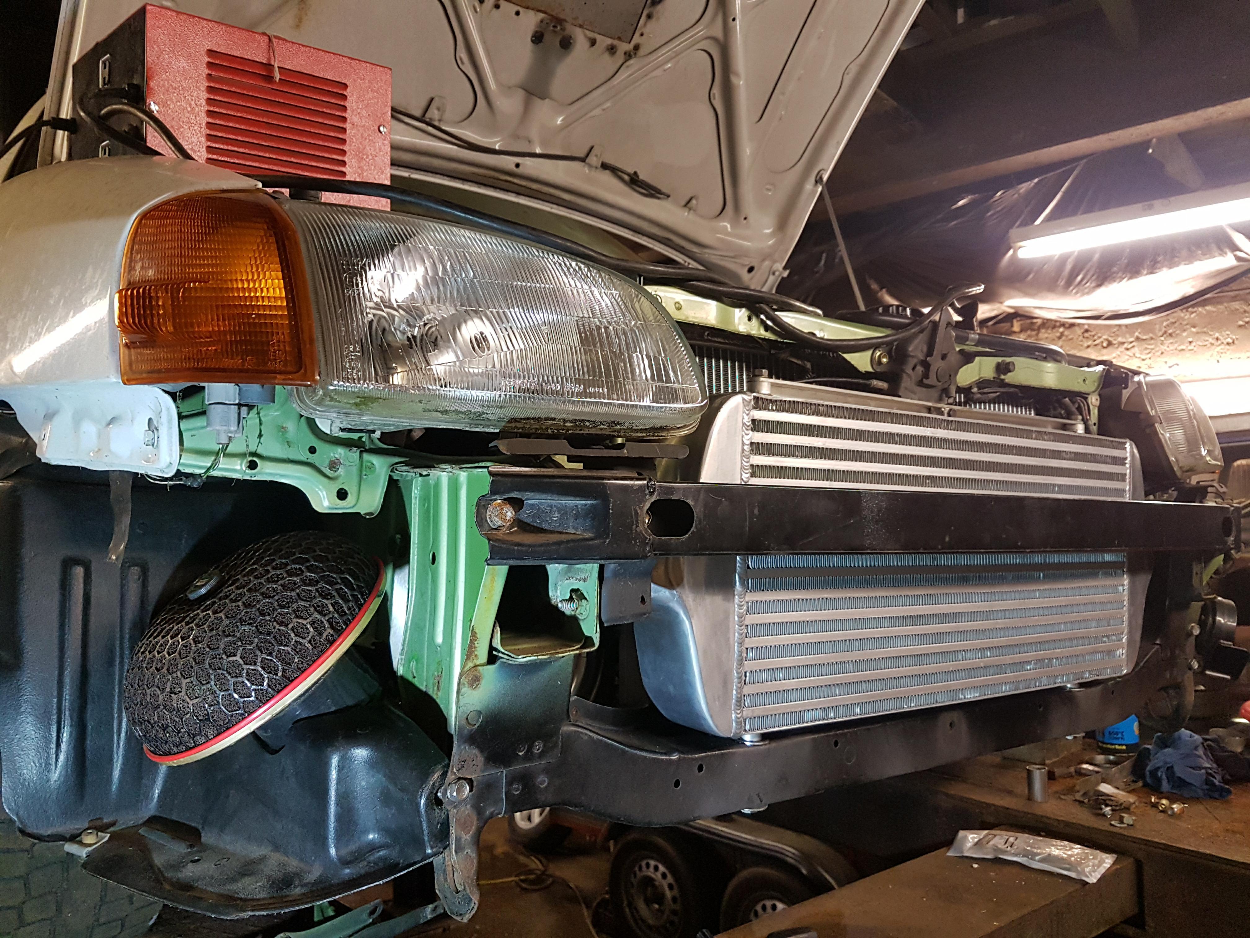

ttestarlet Posted July 19, 2015 Posted July 19, 2015 (edited) This has been a long term project for me. I've lost interest more times than enough basically due to having other more interesting cars. My initial plan was to turbo it and make it a White SR replica with the decals, TTE splitter, TTE spoiler, set of speedines, recaro interior and oem extras. Anyway here's some pictures. Glanza S front end fitted temporary to clear the intercooler. I bought one that would fit further back but it doesn't lineup with the turbo kit as nice as I'd like. Recaro rear seats and there is a Walbro fuel pump fitted in the tank underneath. Glanza oem recaro fitted along with dash, steering wheel ect. I cut off the inside rear 4x4 seat bracket and welded it too the oem recaro rails then sand blasted them and powder coated them black. I made this rad bracket, blasted and powder coated. The engine was rebuilt with forged pistons and oem gaskets, water pump ect. Vf35 fitted currently but ideally I want something like a ct9 hybrid but more reliable. I cut these out of a glanza shell I had and drilled the spot welds. The plan was to weld them into the rear struts and boot floor so I can fit a oem 3 point strut brace. Edited August 3, 2015 by ttestarlet Quote

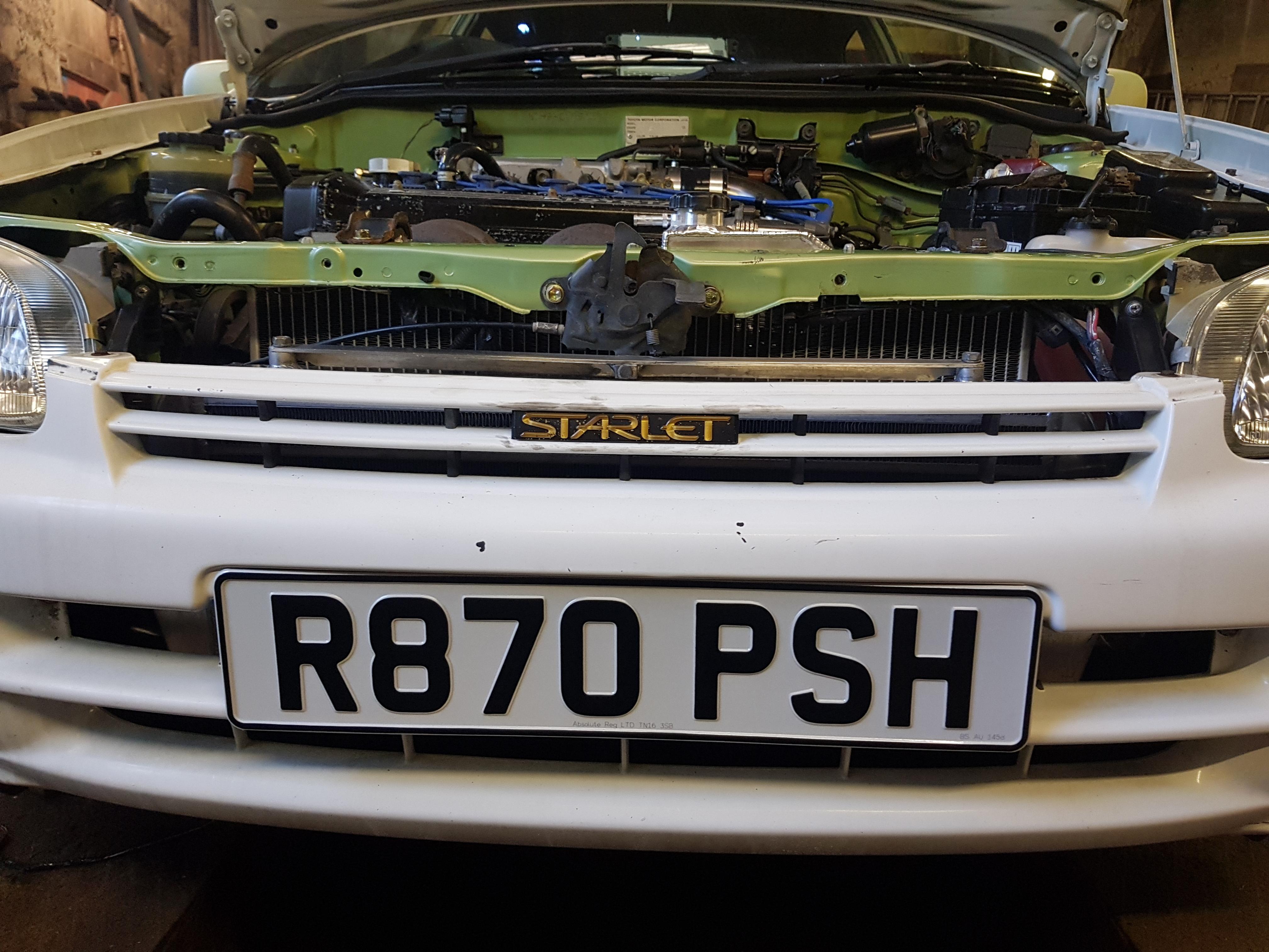

ttestarlet Posted April 29, 2018 Author Posted April 29, 2018 Engine bay is getting there. The tf035h actuator only holds 0.5bar so I'm.fitting a apexi avcr as neatly and professionally as possible using black pneumatic 8mm air line and o-clip crimps. The radiator pipes are all done in 316 stainless, TIG welded and purged. The black samco joiners were cut on the lathe so the ends are perfect. All the clamps are mikalor. The boost pipes are all stainless also, TIG'd and purged. Same again with black samco and mikalor clamps, the same with the HKS air filter pipe. Quote

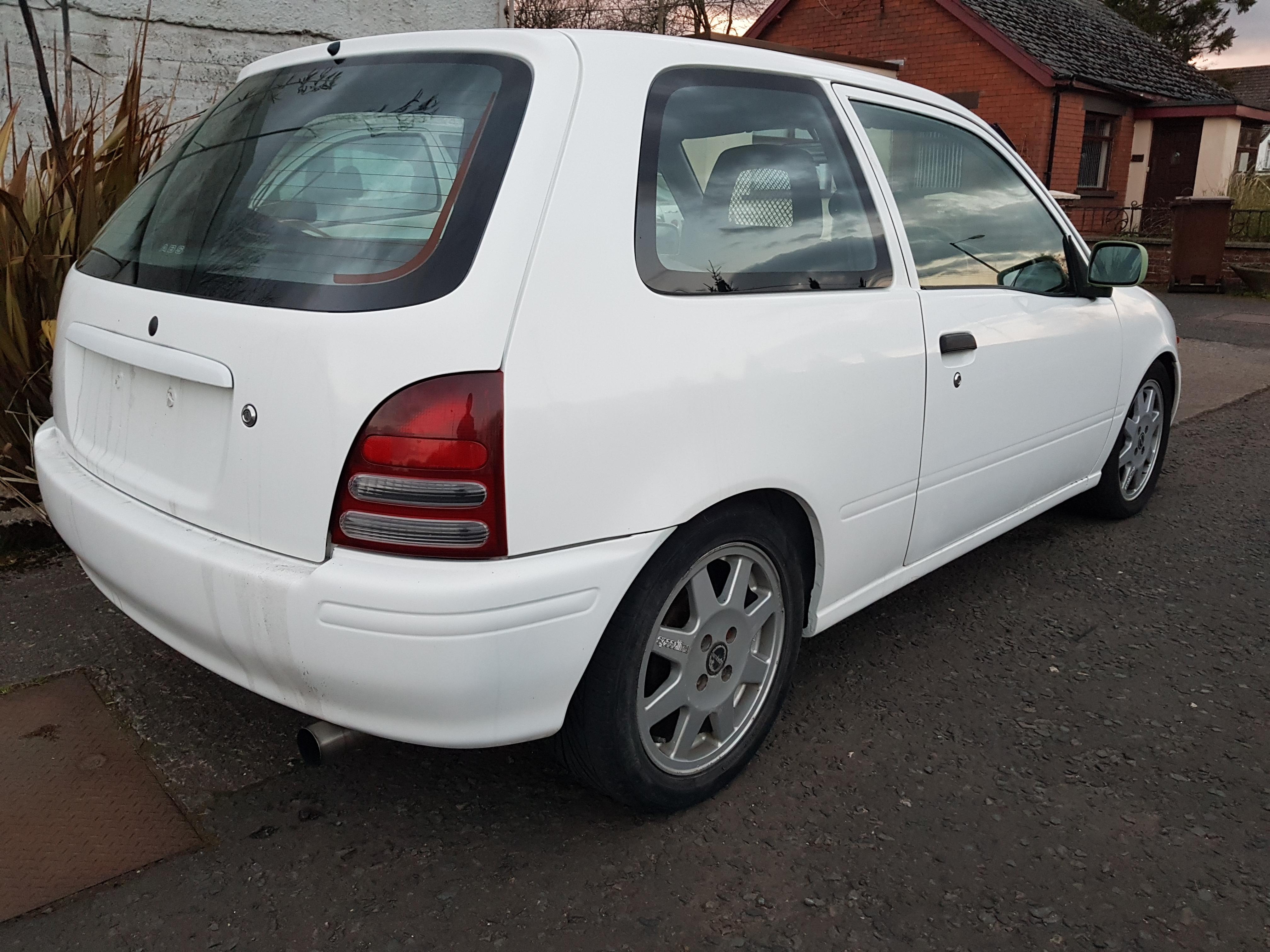

ttestarlet Posted August 27, 2018 Author Posted August 27, 2018 I've speedlines on it now. Having trouble resizing pictures to upload of my mobile. Quote

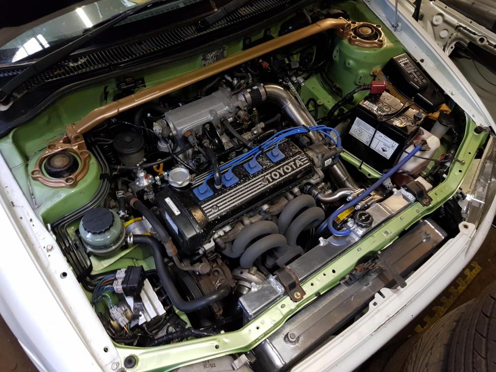

ttestarlet Posted December 16, 2018 Author Posted December 16, 2018 This is how the engine bay sits now. Quote

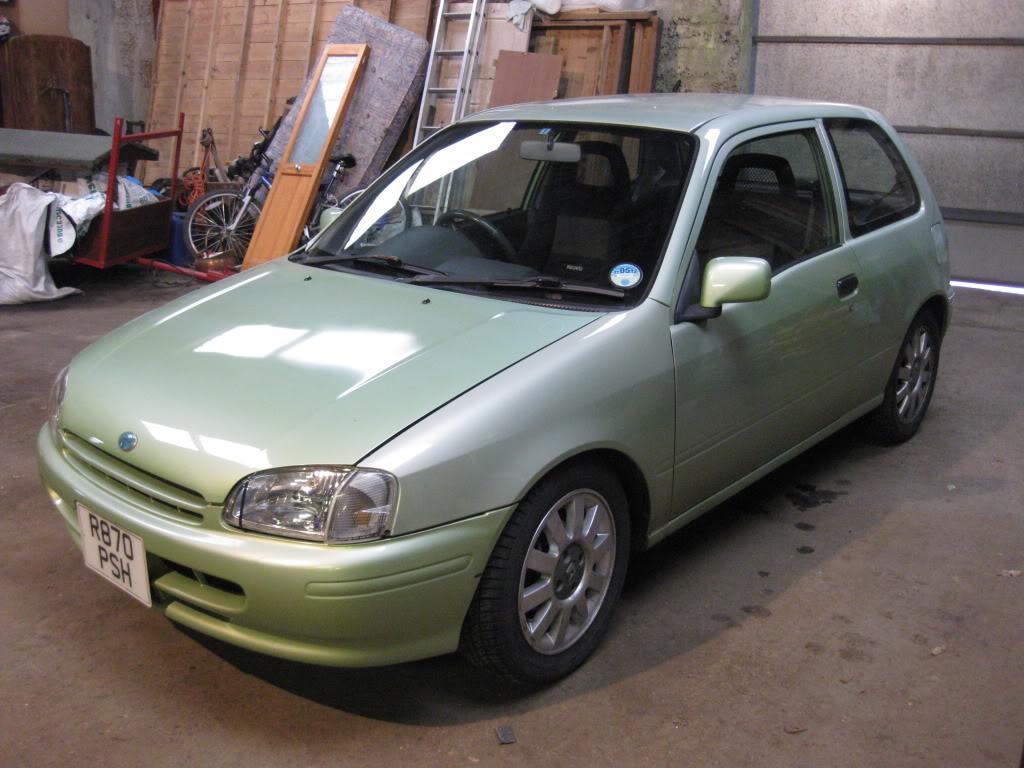

Calum122 Posted December 21, 2018 Posted December 21, 2018 That was quite a unique colour before. Was that the original colour? Quote
ttestarlet Posted December 21, 2018 Author Posted December 21, 2018 Dont know the name or colour code pal. Quote
Calum122 Posted December 21, 2018 Posted December 21, 2018 46 minutes ago, ttestarlet said: Dont know the name or colour code pal. No, but what I was saying was white is a very common colour for those Starlets and you had such a unique colour for it. Almost a shame to have changed it, even more so if that was the original colour. Looking sweet though. Quote

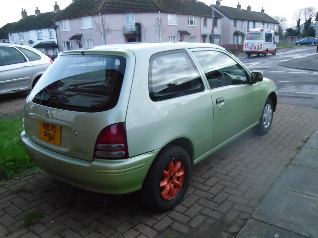

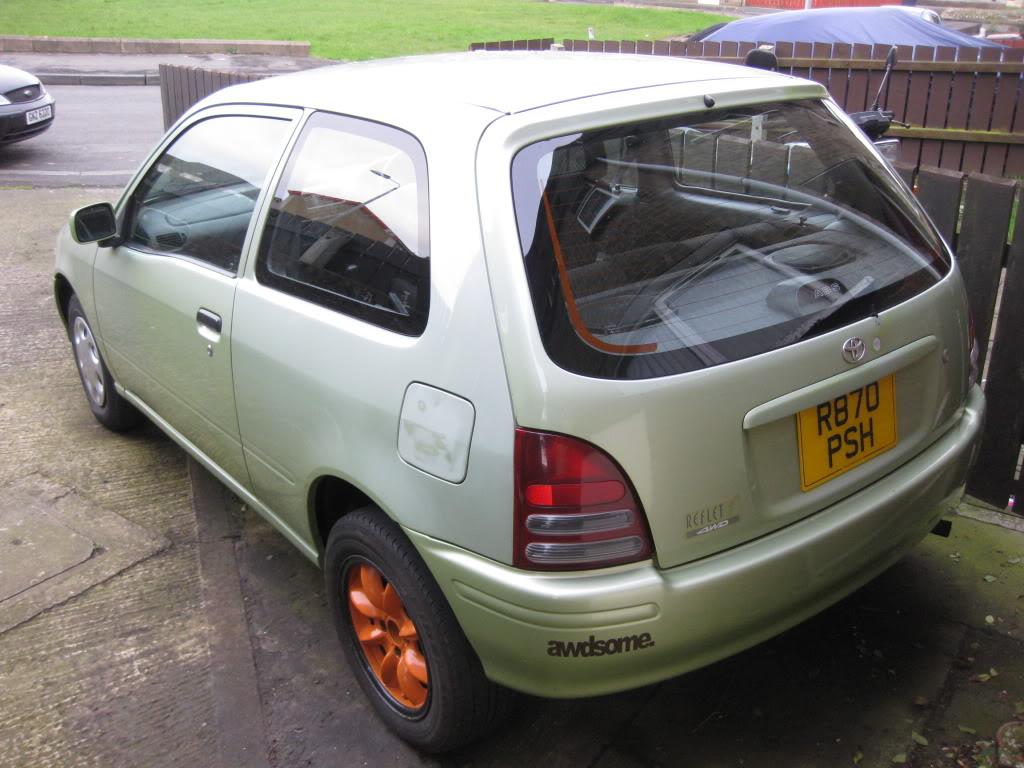

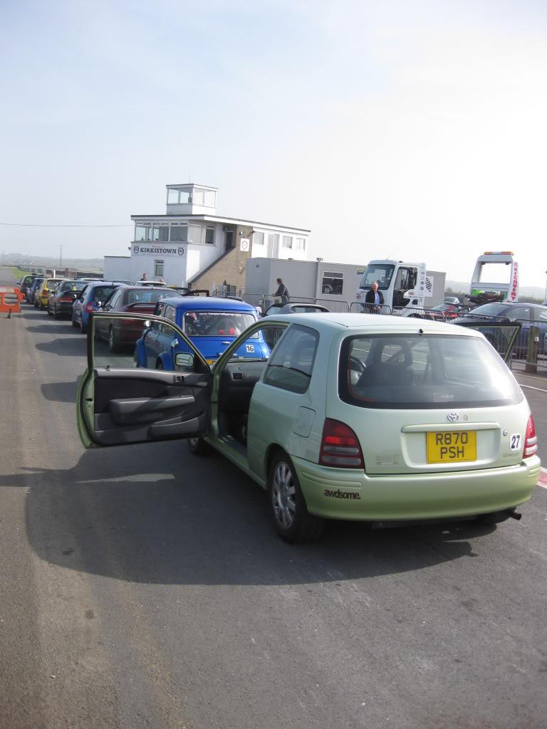

ttestarlet Posted December 22, 2018 Author Posted December 22, 2018 Yea green was original. The pics with the orange wheels was the first day I got the car, the ones that came on the car weren't legal and the orange ones were all I had. The picture with it lowered and the Renault megane wheels was getting it ready for its first track day at kirkistown in non turbo form. This was probably 7 years ago. Quote
