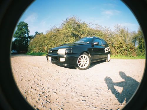

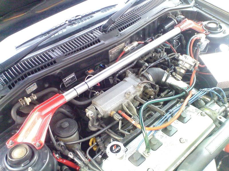

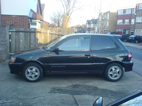

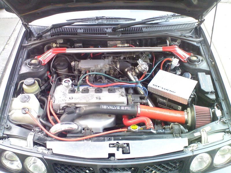

Derek Posted February 21, 2008 Posted February 21, 2008 Hi all been here so long and still haven't put up a theard about my GT.So here we go, lets start with the latest pic of the car:-engine bay at mo:-Heres a link of all my GT photos, all new pic will be add on there. enjoyhttp://s103.photobucket.com/albums/m151/chinaone/ Quote
Derek Posted February 21, 2008 Author Posted February 21, 2008 Random Picture postHow the car looked when i picked it up Quote

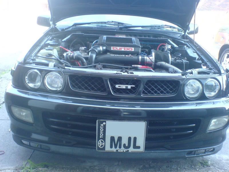

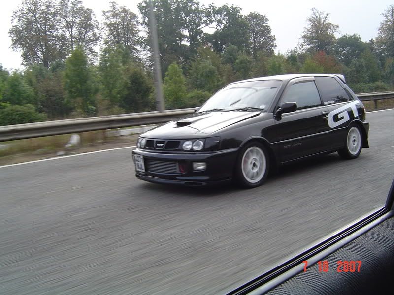

Derek Posted February 21, 2008 Author Posted February 21, 2008 Quad Lights Conversion on GT guideAs i was doing my Quads conversion, had a Tutorial along.Unscrew the grill and bumperTake off the crash bar, easier to work with.Unscrew the lamp off the brackets.Cut out all the RED area, inorder for the quads to fit, as they are much more bigger than the square lamps.I use drill and hack saw, easier with air saw or some sort.The brackets holding the lamps needs to be cut as pictured, but you can always get the brackets for the quads, save you cutting and holds better. as mines not that steady.After modding the brackets and fitted.Made my own brackets holding on the lamps, as i only have one at the top, you better to have one at top and one at bottom.Now drill as the pic shows, so you can screw the lamp in place.Testing with the grill in:Wiring the bulbs as soHere is a Wiring diagram i made:As its a conversion, you cannot have all beams to come on at the same time, only side lights can be on all times with either main or hi. Cannot have main and hi on together.After all fittedExtra info:High beam - HB4 / 9006Main beam - HB3 / 9005you may need to mod new bulbs, as the wings on the bulbs are bigger.as what i've done to my HID bulbs on the pic.The left bulb has been cut on the wings, as the right one has big wings on them.I done alot of research before i done this conversion. Alot of help from members on TGTT, so credit to them all - OllyGTIR, Starlet_GTTurbo_Bristol, rameshsingh13, people who i forgot to mention, thank you! Quote

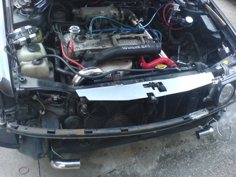

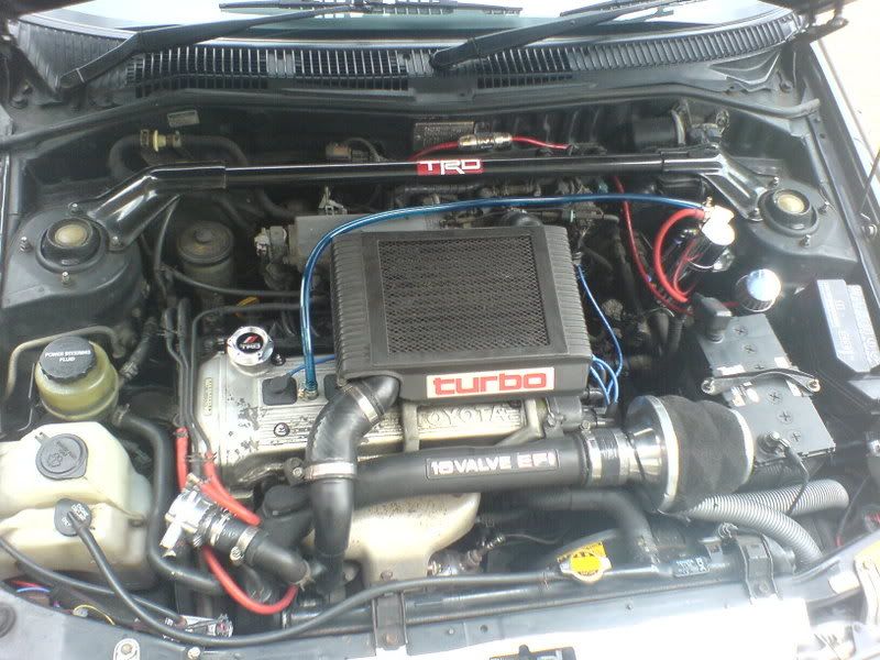

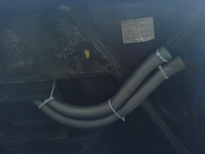

Derek Posted February 21, 2008 Author Posted February 21, 2008 FMIC I got the WEPR Pipings, with a 700mmx280mmx65mm FMIC.I think the smaller the cooler is, last of lag you get.This is what the front & engine bay looks like, before the FMIC went in.After putting the WEPR pipes inNow the coolerAs the scoop on the bonnet no use any more, i put 2 tubes where the scoop is, directing it to the aor filter for more cooler air.As i was doing the FMIC, i relocat the air filter behind those lights. Which i had to relocat the battery as well. Quote

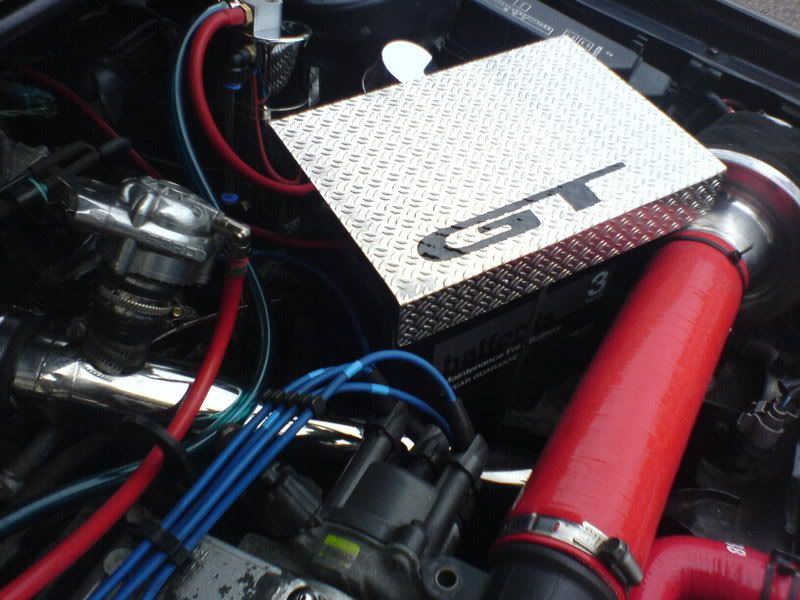

Derek Posted February 21, 2008 Author Posted February 21, 2008 Battery cover!!! Found a sheet of metal at work, thought it could be useful, and this what i made of out it:and the engine bay Quote

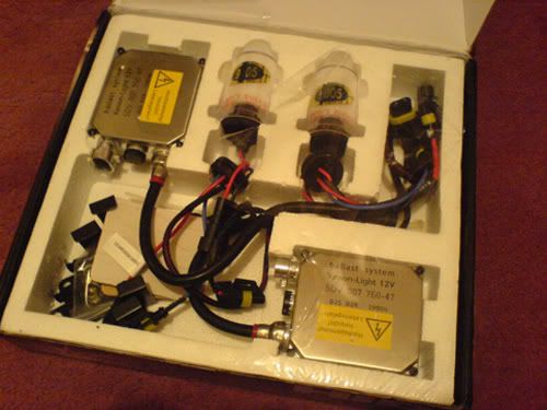

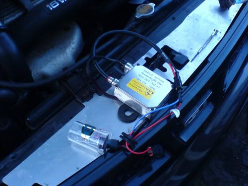

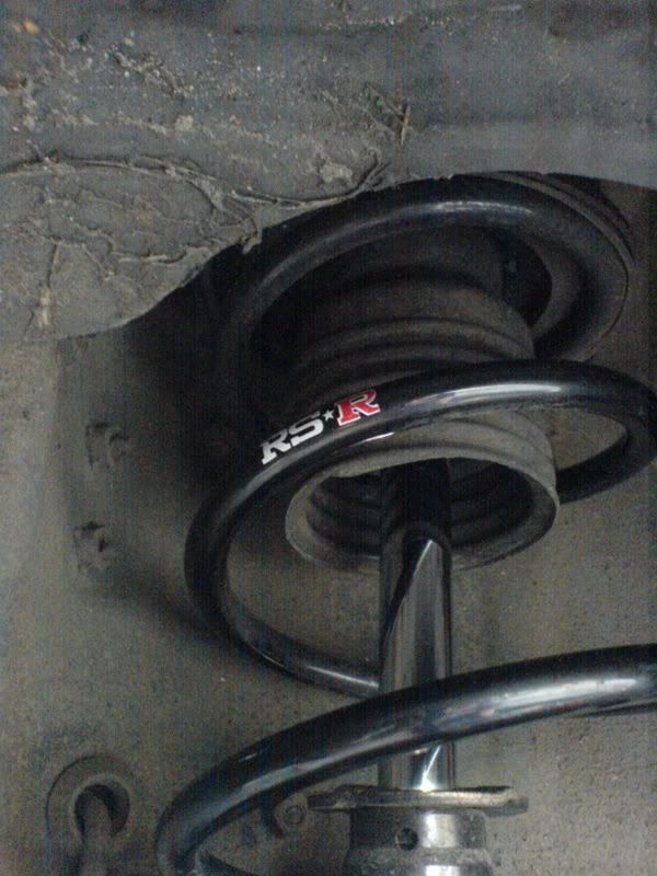

Derek Posted February 21, 2008 Author Posted February 21, 2008 Some more parts addedOh i have a 3 in 1 GT, the mk1, 2 & 3 together, as i have a mk2, i had quads convertion and mk1 rear glowing GT panel.and i am LOVING it.Spilter addedHID kitR2D2 bovACRE/ TOMs Mud flip and painted caliperToms rear strut braceGT vinyl on the spoiler brake lightRSR springs Quote

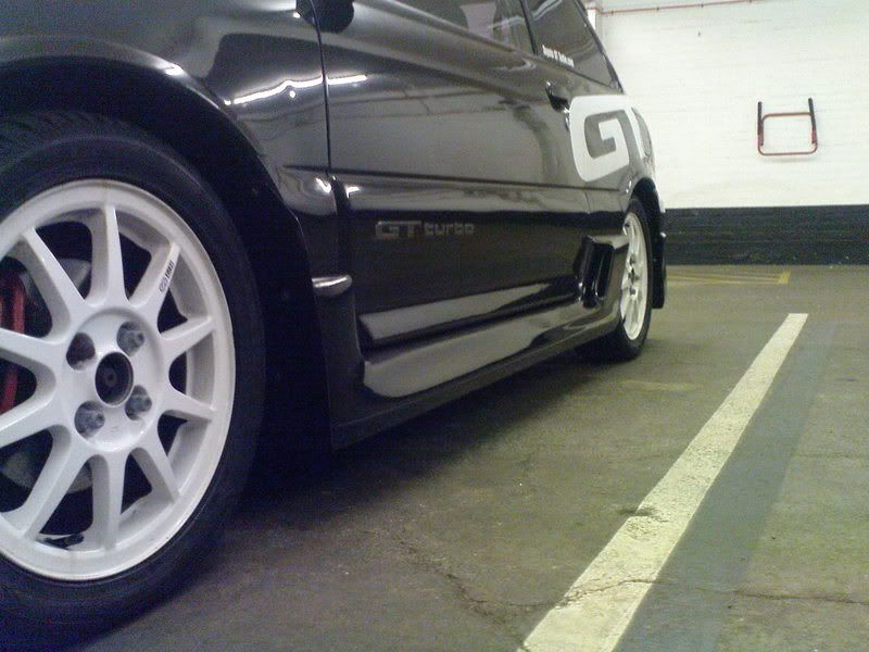

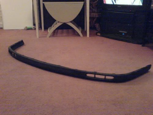

Derek Posted February 21, 2008 Author Posted February 21, 2008 DOOBIE Side skits and Rear spliter Let me know what you guys think. Quote

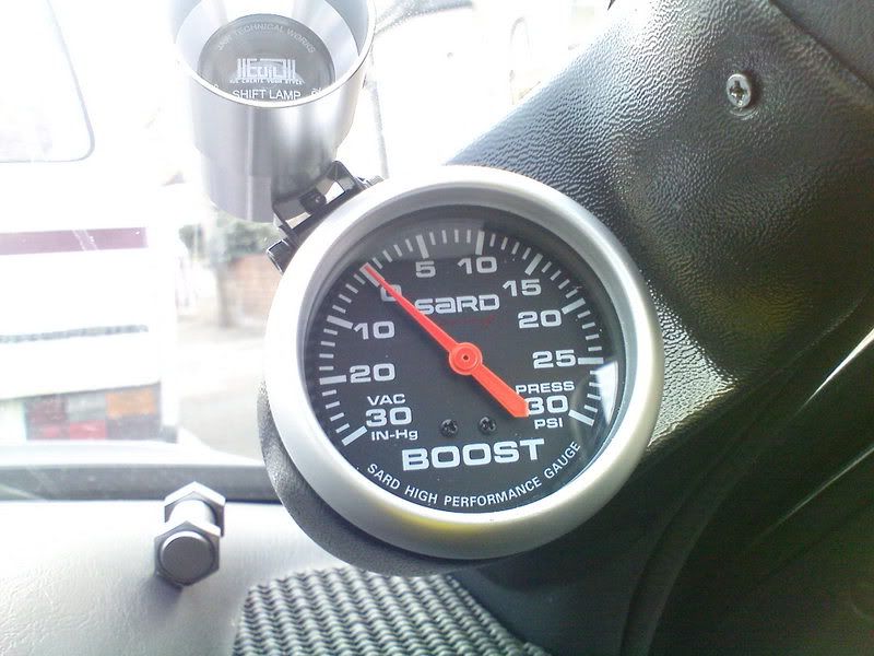

Derek Posted February 21, 2008 Author Posted February 21, 2008 SARD boost gaugeGot this Brand new 60mm SARD boost gauge to replace the shitty Auto Gauge, what a difference it made.Mounted my SAFC II under my sunvisor. Quote

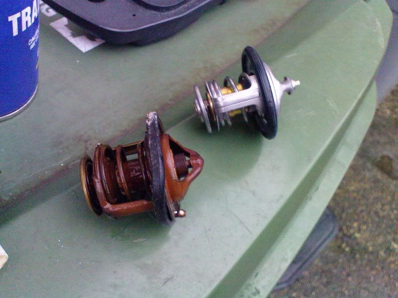

Derek Posted February 21, 2008 Author Posted February 21, 2008 My car didn't heat up as it should, temp drops while the car is running above 60mph. And heating takes about 30mins for warm air to come though.So i guess the thermostat is fooked, change it today every back to normal, yea.take a look at this old thermostat, ohh my god!!. Quote

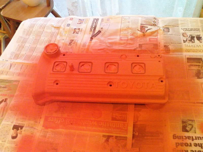

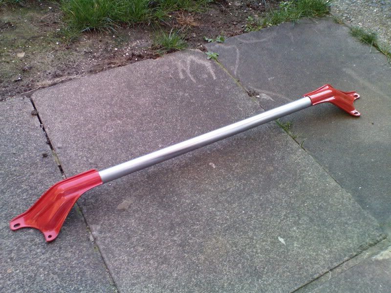

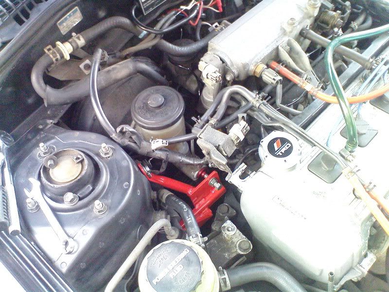

Derek Posted February 21, 2008 Author Posted February 21, 2008 Sprayed my rocker cover at the same time I polish the strutbrace and paint the sides, also had the Cusco Brake Master Cylinder Stopper installed and painted. Quote

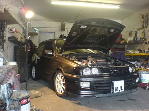

Derek Posted February 21, 2008 Author Posted February 21, 2008 Heres how i lifted the bonnet with, thats when i still had the TMIC. Quote

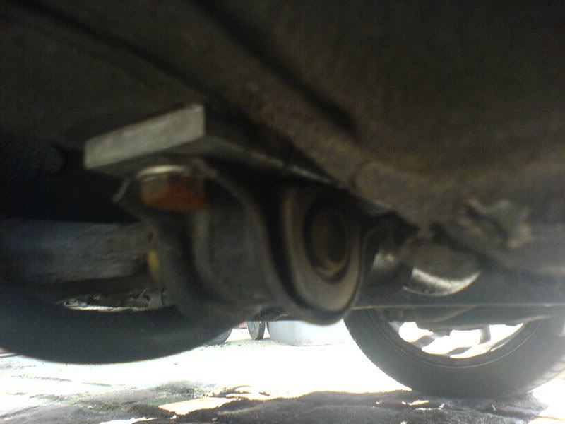

Derek Posted February 21, 2008 Author Posted February 21, 2008 Anti lift platesThose helped alot, made alot of difference. Quote

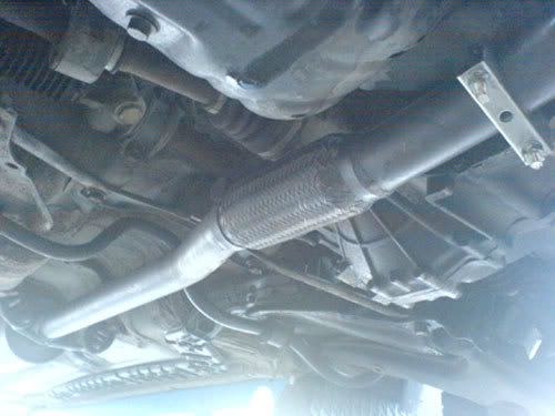

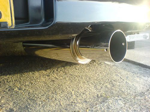

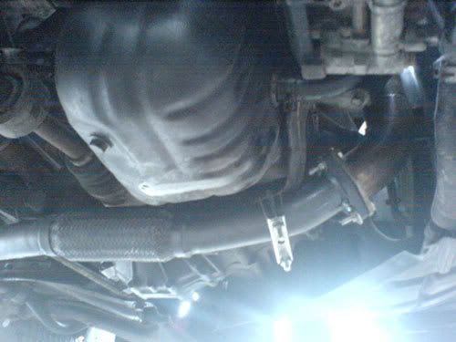

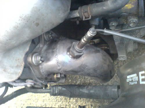

Derek Posted February 21, 2008 Author Posted February 21, 2008 HKS hi power system Had to sent this exhaust back from Hong Kong the day i left, it got home before i did.At the same time had the decat install as well Quote

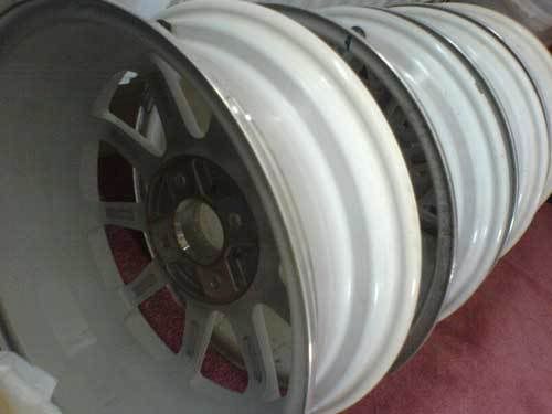

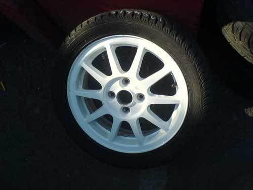

Derek Posted February 21, 2008 Author Posted February 21, 2008 Enkei 15" ES-Tarmacwith 195 45 15 Quote
