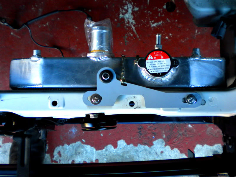

Whitenoize Posted September 19, 2015 Posted September 19, 2015 You just remove your old rad brackets dude and replace with the new ones use the same holes etc on top and it will give you a good idea what ones to use for the bottom bracket..no drilling etc it's very very easy Quote

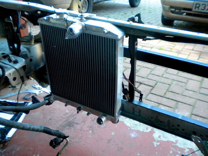

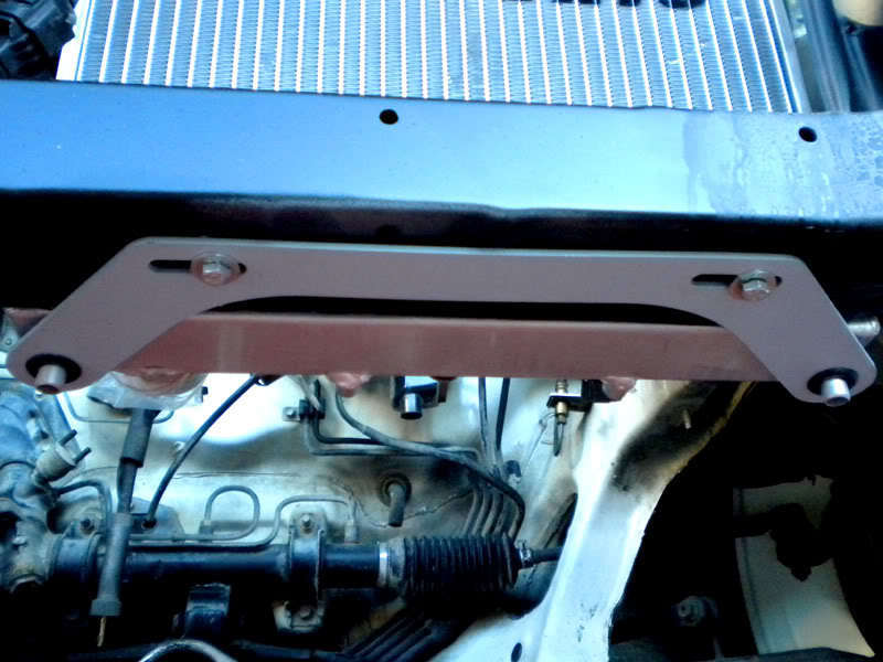

morgan Posted September 19, 2015 Author Posted September 19, 2015 The holes do not line up with the brackets supplied, do you have a picture at all mate ? There the old radiator sat there is a bracket at the bottom the seems to hit the radiator aswell Quote
Whitenoize Posted September 19, 2015 Posted September 19, 2015 You can take the old rad brackets at the bottom off dude I dont have any pictures unfortunately mate sorry Quote

morgan Posted October 4, 2015 Author Posted October 4, 2015 Anyone have any pictures of this at all as the brackets I have do not line up with any holes and it looks like I have to cut the old bottom radiator mount off aswell to get the radiator sitting correctly Quote
jellybaby Posted October 10, 2015 Posted October 10, 2015 Yer u have to cut the oldBottom rad mounts off also u use the two bumper bolts which is on the cross member Quote

dan106 Posted October 17, 2015 Posted October 17, 2015 You have to cut off the old rad mount, I drilled two holes in the cross member to mount mine to Quote
Malcolm GT Posted October 18, 2015 Posted October 18, 2015 Cheers Dan. I have cut the old bracket out and will be drilling and finding bolts to hold the bracket. My rad hoses seems way to tight over the new rad. anyone else find this? It was like it was going to break! Quote
