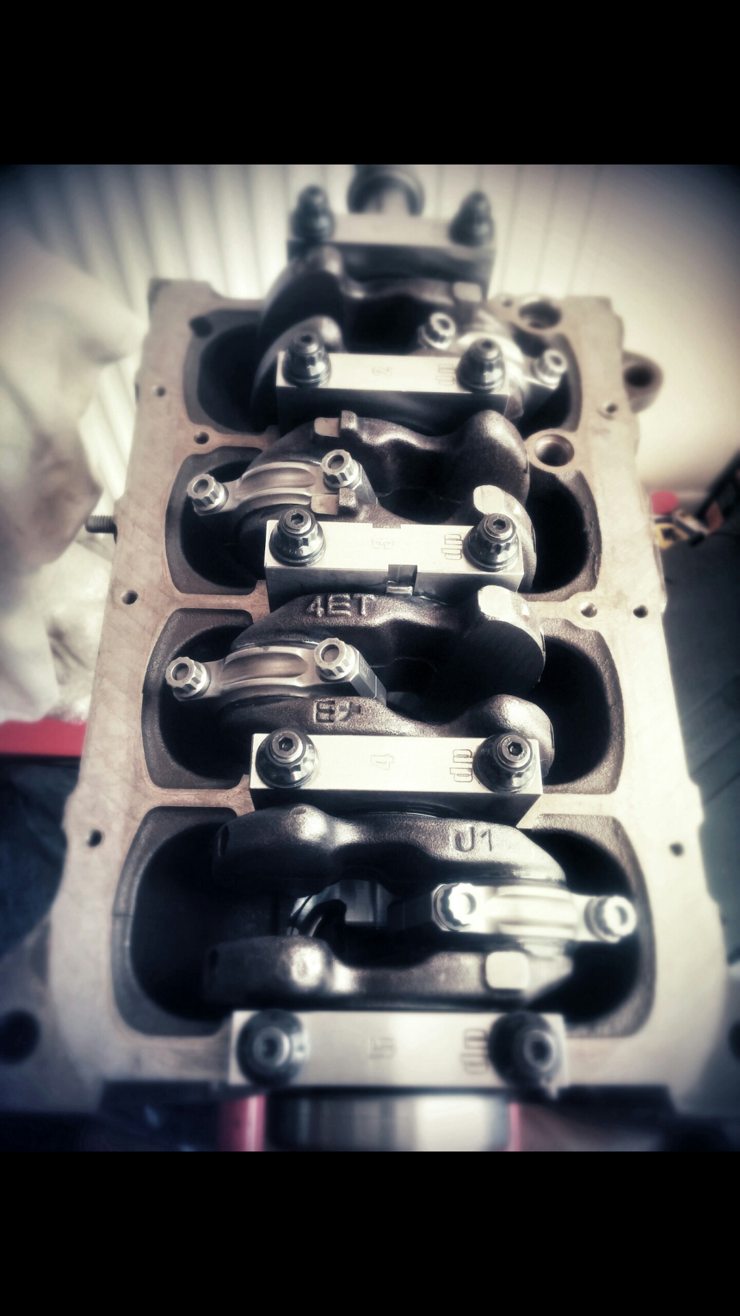

RobSR Posted February 12, 2019 Posted February 12, 2019 37 minutes ago, GP82 said: Looks like a nice build with the billet mains and stud conversions. Whats the rest of the spec? Quote

GP82 Posted February 12, 2019 Posted February 12, 2019 1 hour ago, RobSR said: Im currently missing quite a lot of bodywork... Hi Rob, WoW! Looks like great chassis work in progress! You removing weight and I guess weld in cage?! Top stuff as always!!  This is the area I want to concentrate on after getting the power. Cached in the background, I have noticed there are some EP veterans out there not willing to retire just yet and moving onto the next level   haha, Great stuff!  1 hour ago, RobSR said: Looks like a nice build with the billet mains and stud conversions. Whats the rest of the spec? Engine wise CP pistons, solid wrist pins, Carillo rods, currently running on the old Vf29 setup 20+ psi boost pressure, until I get all the bits for the big turbo setup. Just got the engine up and running not so long ago, I'm still smiling. Yeah if owners can please post here and TGTT of their cars progress, that would be much appreciated because a lot don't do those social media thingamajigs, what is it facetube and whatschat and I wanna see! Thanks. Quote

GP82 Posted February 12, 2019 Posted February 12, 2019 29 minutes ago, RobSR said: Yup lots of weight coming out, but its mainly to do work with the suspension, so removing the wheel well gives us a lot of clearance. The other part left in the pic will be removed as well when things progress and the cage all ties in  Fabricator is just waiting on some more T45 to turn up then we should see more progress.  Sounds like a very nice engine build. Do you build it yourself? Any plans for different turbo/ecu in the future? Ah I see, You mentioned time attack, do You have any plans regarding aero for this car as I have seen that is a big factor in these competition events. Yeah built the motor meself, I try to do everything myself. Love motorsport. All types, enjoy all aspects of tuning. My current set-up feels like 250 ~ 260 hp @ wheels. I'm aiming for 500 ~ 600 with big turbo set-up and ecu (I've got Haltech in my mind, but we will see) and a big overhaul of the fuel system. This build You are creating sound's really good and looking forward to seeing it progress! Quote

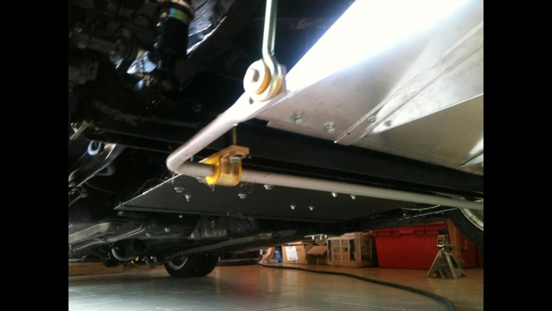

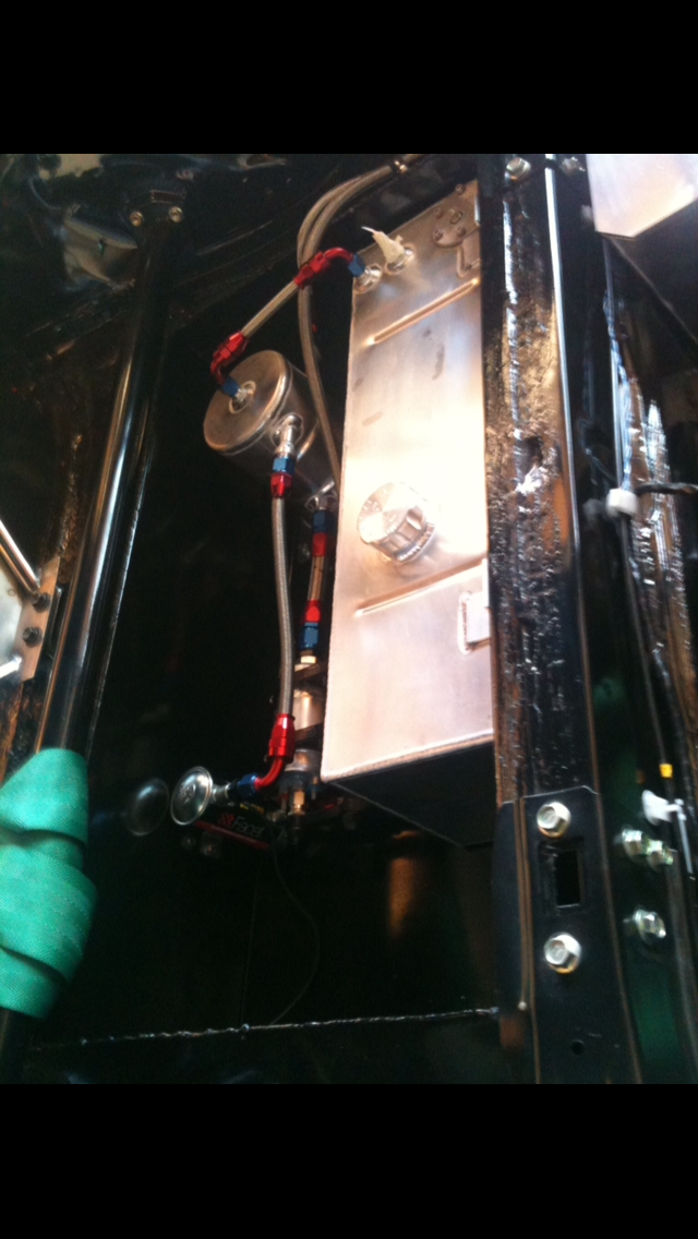

glanzagee Posted February 12, 2019 Posted February 12, 2019 Under body view of tank compartment ;) Quote

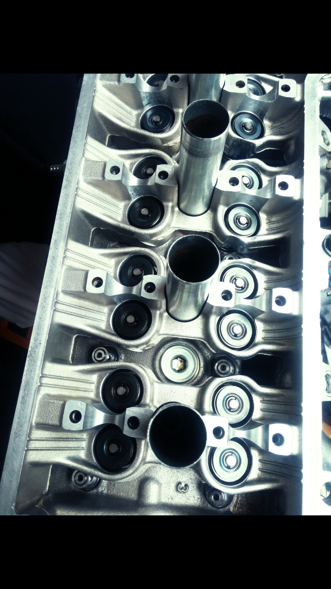

glanzagee Posted February 12, 2019 Posted February 12, 2019 4 hours ago, GP82 said: who done the work on the head ? could we have some more info whats been done to it other than ARP studs Quote
RobSR Posted February 12, 2019 Posted February 12, 2019 1 hour ago, GP82 said: Ah I see, You mentioned time attack, do You have any plans regarding aero for this car as I have seen that is a big factor in these competition events. Yeah built the motor meself, I try to do everything myself. Love motorsport. All types, enjoy all aspects of tuning. My current set-up feels like 250 ~ 260 hp @ wheels. I'm aiming for 500 ~ 600 with big turbo set-up and ecu (I've got Haltech in my mind, but we will see) and a big overhaul of the fuel system. This build You are creating sound's really good and looking forward to seeing it progress! Yes plan is to do some Time Attack, that’s why we are building the car the way we are.. we need to do quite a lot to make sure we are competitive! Aero will be coming but later down the line. Good stuff, look forward to seeing it all come together Quote
GP82 Posted March 4, 2019 Posted March 4, 2019 On 2/12/2019 at 7:15 PM, glanzagee said: Inside view  On 2/12/2019 at 7:09 PM, glanzagee said: Under body view of tank compartment ;) That looks awesome! Really good work!  Regarding cylinder head, it's ported, exhaust ports have been enlarged, intake cleaned up, small changes to the combustion chambers, intake and exhaust ports matched to their manifolds, studs, mild camshafts (not yet fitted), Cruise valve springs, durex stem seals. I were gonna go with uprate stainless steel valves, not bigger ones thou, but for strength to fight heat generated as I've seen stock valves bend, worse case just break on high hp output race cars. The cause it's inspected to be the stem diameter is very small and taking into account material used, but this being mainly a road car I should be fine. Done all the work me-self (a lot of hours spent working on it, at-least a hour every other day to try to keep quality of work up, over a month or two)  I have got some work to do on it: Bigger fuel lines, Mech fuel pump install, Water injection kit to fit a lot of sensors to be installed  Yours a dedicated track/ competition car I'm guessing? What is Your set-up? What will Your range be like with the fuel tank and type of fuel You will be using?  Cheers   Hits.    Quote
