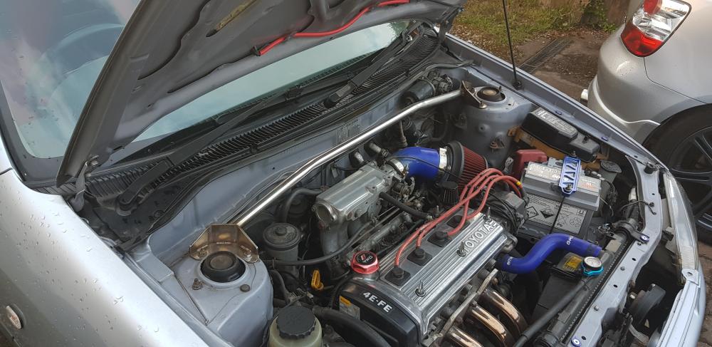

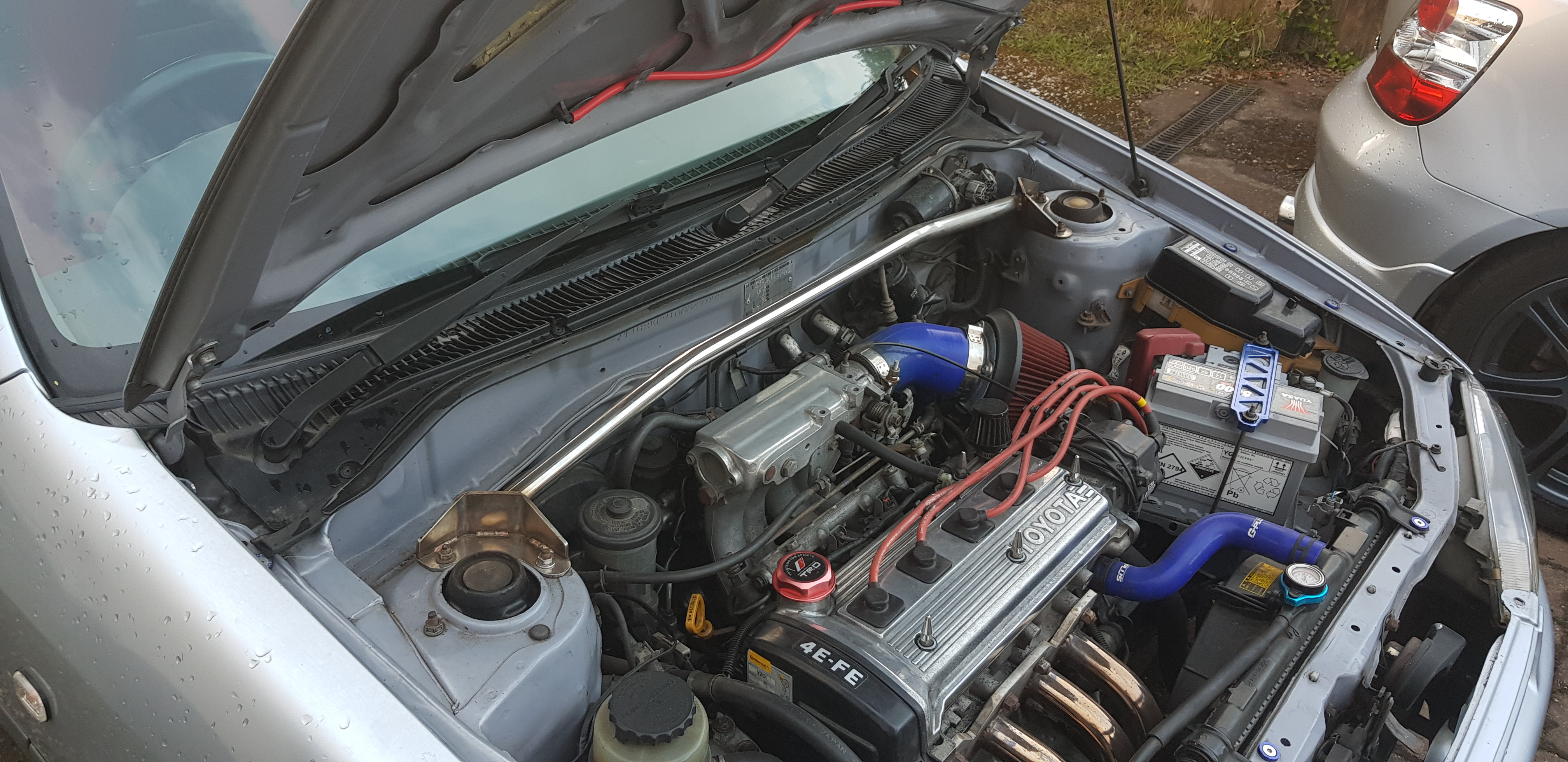

Hi guys haven't been on here in a while, the starlet is still going strong but been so busy with other cars. Speaking of which my most recent buy is another starlet which is having a very unique engine swap which hasnt been done yet. Will have a blog eventually.
As for the sr in this time it has had abit of work, mainly engine as it was burning too much oil so I fully rebuilt a spare engine with the addition of :
Skimmed head, fully ported and polished, lightened flywheel, full rotating assembly balance ie crank, pistons, conrods, flywheel, clutch, front pulley.

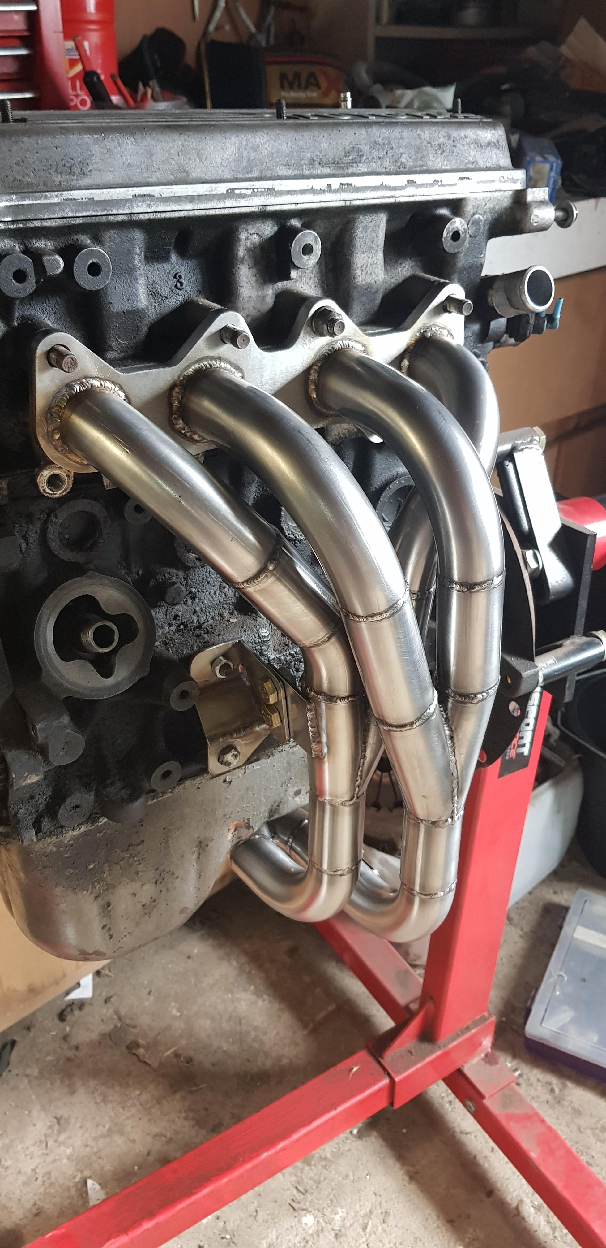

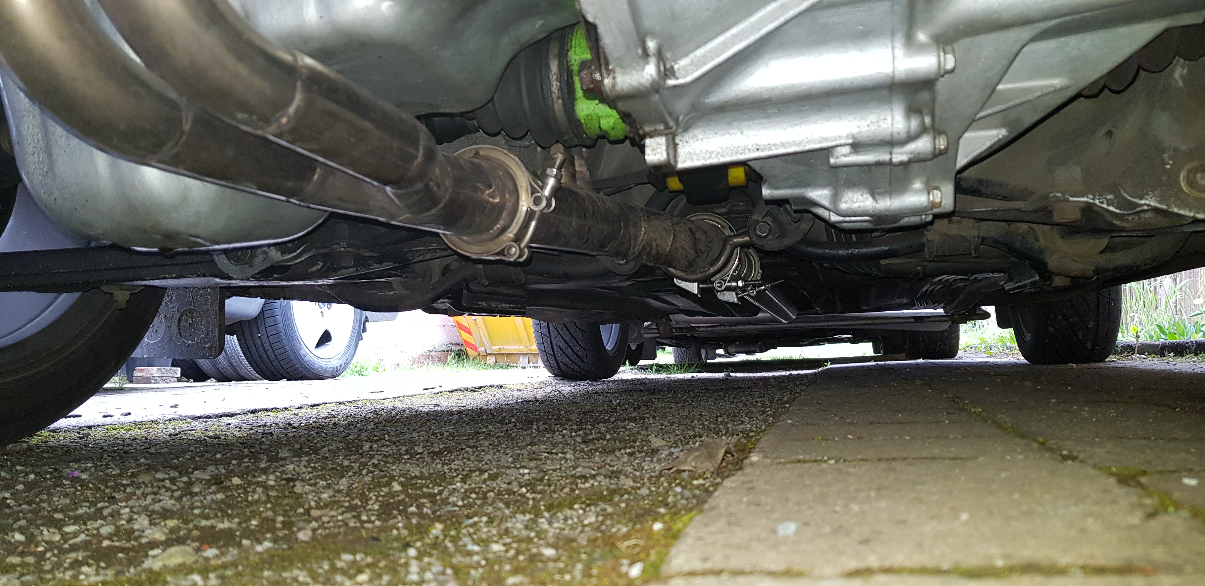

Apart from this I've put some recaro seats and built a full stainless exhaust system including header which was all made by myself. Once the car was back on the road I was very impressed with the work I did as the car pulled alot nicer not too mention it makes the engine bay look 10x better with the golden runners. after making the first manifold tho I made a couple more designs with the materials I had left over see which one I prefered. Next thing is too get the management wired in properly once i get abit of time.

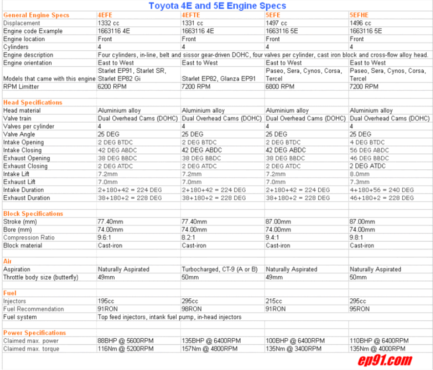

Nice work do you know about the higher lift 4efte turbo inlet cam.
I've not been threw your build, yet, you might be running 5ehfe cams or bigger but if not it's true the 4efte has a much better inlet cam it's also run on the UK 5efe paseo engine.
Good to see your running the power gen 1 inlet, how to you compare this to the itb setup you had & also what size itbs did you use.

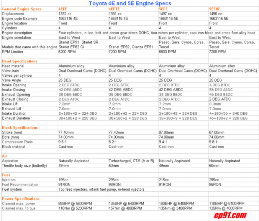

Just a quick one sam the 4e,5e and 4efte cams are all the same. Only the 5efhe intake cam has a 1mm higher lift.
There not. I've measured them my self the 4efte and 5efe are the same but the UK ep91 has a different intake cam around 1mm lower lift on the 4efte and 5efe. I'm yet to measure the gen1 4efe out of the ae101 and ep80.
Trust me it's true anuff. Measure them, don't just read specs and believe them.
Time to embrace the truth.
There are quite a few specs on that sheet that is incorrect.
From power out, to injector size to cam profile.
Edited by Sam44
Hi sam yea I have a pair of 4efte camshafts in the garage I got for cheap and yes their is a difference in lift, just abit less than 1mm I measured. So they will be going in soon hopefully as I think theres a small leak from camshaft seal.
