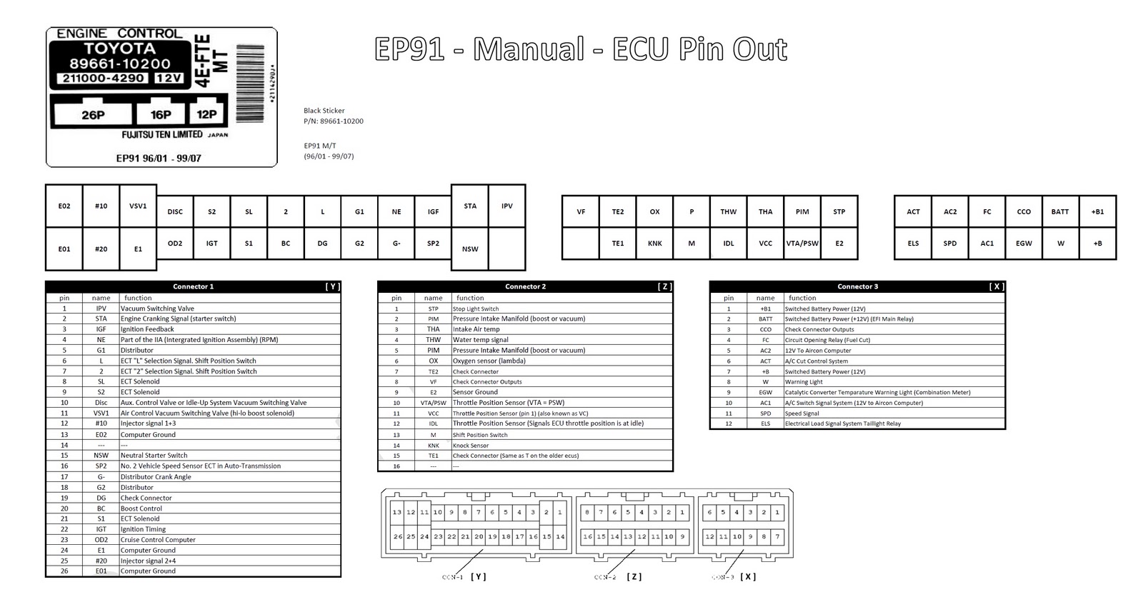

Shan Singh Posted July 8, 2017 Author Posted July 8, 2017 also guys i need help with rewiring the 02 sensors since glanza's have 2 wire o2 sensors i cant pick that up where i live but i have single wire ones, i was looking at the ep91 ecu pinout and was wondering if i can run a wire directly from the ecu to the 02 sensor? will this work? check link http://1.bp.blogspot.com/-rosKml3sFaQ/TtA4VNXh7bI/AAAAAAAAATg/jW-wiYdSmIo/s1600/EP91+ECU+PINOUT.jpg%C2%A0 Quote
