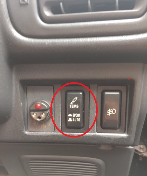

starletezy Posted July 11, 2017 Posted July 11, 2017 Hello guys on my mk1 gt there's a sports button never seen one before anyone know what it actually does ? Regards Tez Quote
starletezy Posted July 11, 2017 Author Posted July 11, 2017 Its a manual car ahaa I see never seen one before cheers pal Quote
Whitenoize Posted July 11, 2017 Posted July 11, 2017 Its a manual car ahaa I see never seen one before cheers pal is for the suspension as above it's electronically adjustable if it's still fitted to the car Quote
starletezy Posted July 11, 2017 Author Posted July 11, 2017 We're will the motors be located ? Exactly on top on under the wheel ? Quote
Whitenoize Posted July 11, 2017 Posted July 11, 2017 On top of the shock absorbers mate I'd be very surprised if they have lasted this long does the suspension rise and lower when you press the button ? Quote

maddox710 Posted July 11, 2017 Posted July 11, 2017 Toyota electronically modulated suspension Well well rare option Quote
lukEp Posted July 11, 2017 Posted July 11, 2017 It won't rise and lower it will just adjust the stiffness of the shock (dampening) Quote
starletezy Posted July 11, 2017 Author Posted July 11, 2017 Have never looked at the suspension since the purchase will get some pics up soon very interesting discovery have had a lot of optional extras in my starlets in the past but never seen this before lol Quote
starletezy Posted July 12, 2017 Author Posted July 12, 2017 So bad news the motors have been removed and replaced with normal shocks absolutely gutted on the hunt for the motors and shocks wish me luck lol Quote
