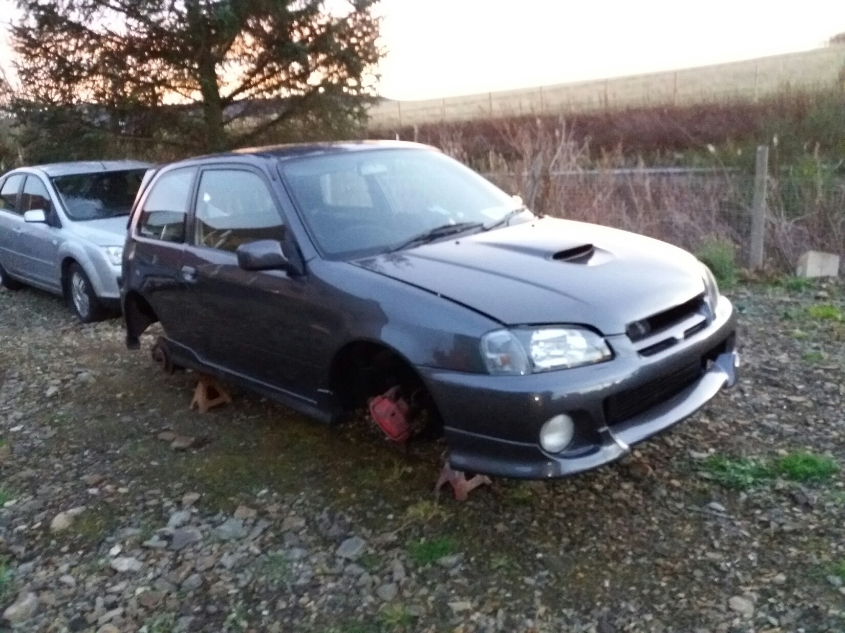

Mike84 Posted December 28, 2017 Author Posted December 28, 2017 This is the 3rd reincarnation of this build , to cut along story short . I stared building an ep82 into a hillclimb car then decided they were getting rare and harder to source parts (as I like a barrier or 2). So bought a black ep91 which came with a quaife lsd box , paddle clutch and lightened flywheel along with bc coilovers. I stripped the shell bare to prep it as I'm fussy which is when this latest shell came up all fully painted at a price I couldn't resist ! Needless to say I have a few spares !!!! Engine currently looks like this waiting for its new home Then this is some pics of the first car I started prepping Then how the current shell looks waiting for it's rear cage to be fitted , which is partly mocked up Quote
