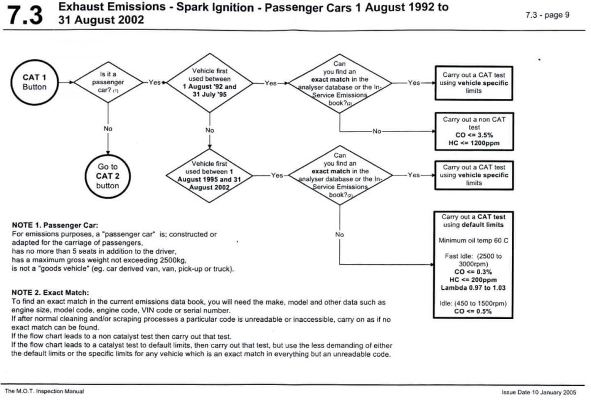

akyakapotter Posted January 20, 2018 Posted January 20, 2018 Exhaust emissions is wrong they have tested to UK spec not import tell them to look in the book and go by that it's has a non cat test co2 3.5 hc 1200ppm i no this as have had a few times and contacted dvsa over the matter. Cheers nick Quote

00joeindastarb0 Posted January 20, 2018 Posted January 20, 2018 I think Nicks stating that it is a model produced for foreign markets so VOSA don't have the required guideline figures for the model Quote

akyakapotter Posted January 20, 2018 Posted January 20, 2018 3 hours ago, 00joeindastarb0 said: I think Nicks stating that it is a model produced for foreign markets so VOSA don't have the required guideline figures for the model Yes your right mate has to be put though as non cat test as they cant find 4efte the system it dosnt exist. So have to have a cat for visual check. I've put it through 3 mot's like this every time they have tested to 4efe UK spec I've explained the above and they have gotten the book out and been sorry for not knowing. Usealy saying don't get them often so it gets overlooked. Cheers nick Quote
Calum122 Posted January 20, 2018 Posted January 20, 2018 Ahh right, I always thought any post 94 car needed to pass the fast idle cat emissions. That's really cool though. Quote
patman Posted January 21, 2018 Posted January 21, 2018 20 hours ago, akyakapotter said: Exhaust emissions is wrong they have tested to UK spec not import tell them to look in the book and go by that it's has a non cat test co2 3.5 hc 1200ppm i no this as have had a few times and contacted dvsa over the matter. Cheers nick Not kicking up a stink here Nick mate, as I agree with you, my car failed twice on emissions last year, and when I showed them this above, they were having none of it, telling me it’s all changed now etc, little fuckers, they still wouldn’t pass it, ended up having to get a sports car welded on in the end. Quote
akyakapotter Posted January 21, 2018 Posted January 21, 2018 I have a sports cat for mot purpose and it flys through emissions if they test it correctly ie not fast idle 1 2 ect just the co2 and hydro carbons for non cat test Cheers nick. Quote
Jwood91 Posted January 22, 2018 Author Posted January 22, 2018 (edited) No way! So they've done the emissions test to a UK starlet standard? Just to be sure... Are you guys saying it should be tested as though it didnt even have a catalyctic converter? like a car made pre 95? or it should have been tested using default limits like lowest right hand box in the diagram? It flew through its first MOT with just one advisory about play in the steering rack and nothing on emissions. do you guys think its likely If i get it retested to the correct standard it might get through on emissions then? If thats the case it'd just be the welding needed which also didnt show on the last MOT (which I found a bit odd). The MOT tester said its only a small bit of corrosion so could have been missed... What do you guys think about the idea of just taking to a different MOT tester and explaining the emissions thing prior to them testing it. Could they miss the corrosion and pass the car? (Thinking purely to get her back on the road fast here not thinking leave the corrosion to get worse afterwards haha) ta again lads Edited January 22, 2018 by Jwood91 Quote

daniel_g Posted January 22, 2018 Posted January 22, 2018 That MOT emissions chart is out of date. 90% of starlets burn oil to some degree, thats what will be showing up in the emissions test. The standard CATs on these are well worn out by now, that wont be helping matters. Removable sports CAT fitted into the exhaust is probably the way to go. Try that before spending thousands on an engine rebuild and turbo rebuild. We need to see pictures of the suspension component mounting to offer accurate advise. Quote

jellybaby Posted February 13, 2018 Posted February 13, 2018 On 20/01/2018, 17:53:54, Calum122 said: It's a 96 spec so it won't be a non cat test. It will be due to the car being a gray import you have to test them as stated in the manual regardless if it has cat due to emissions standerds are different in japan i also a mot tester for the dvsa Quote
