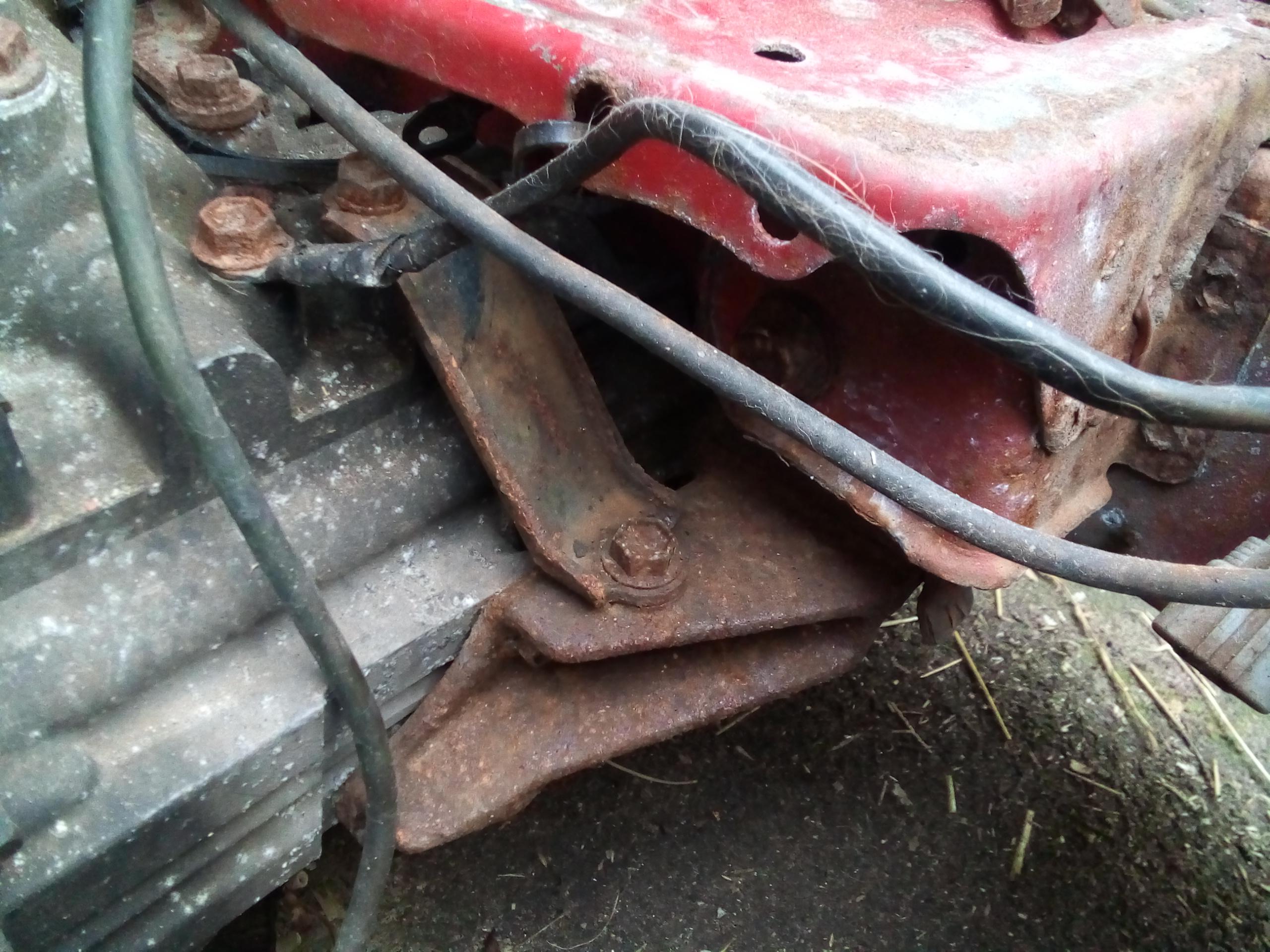

Sam44 Posted August 30, 2020 Author Posted August 30, 2020 I have the additional gearbox support off the GT turbo and glanza to install. Quote

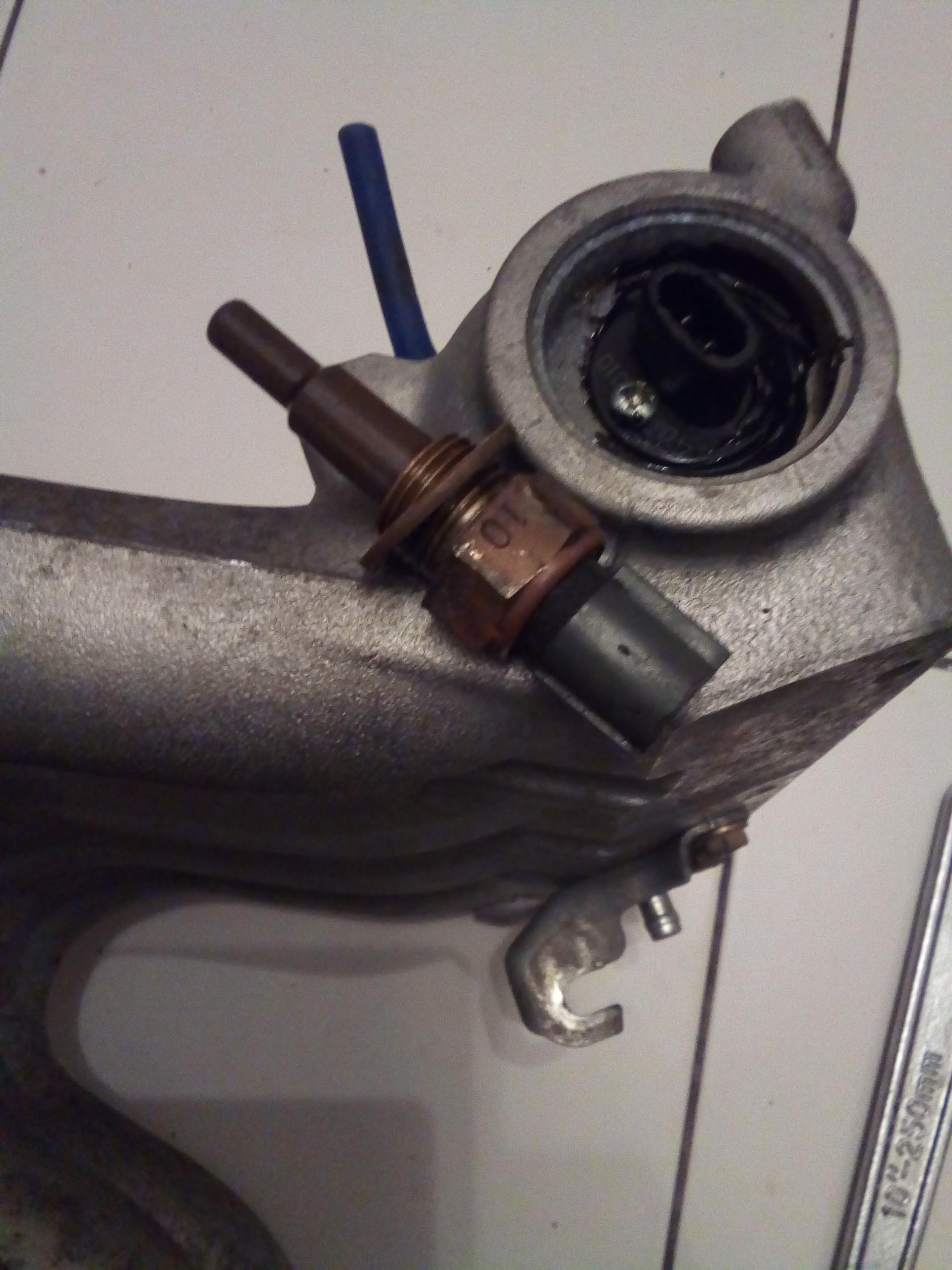

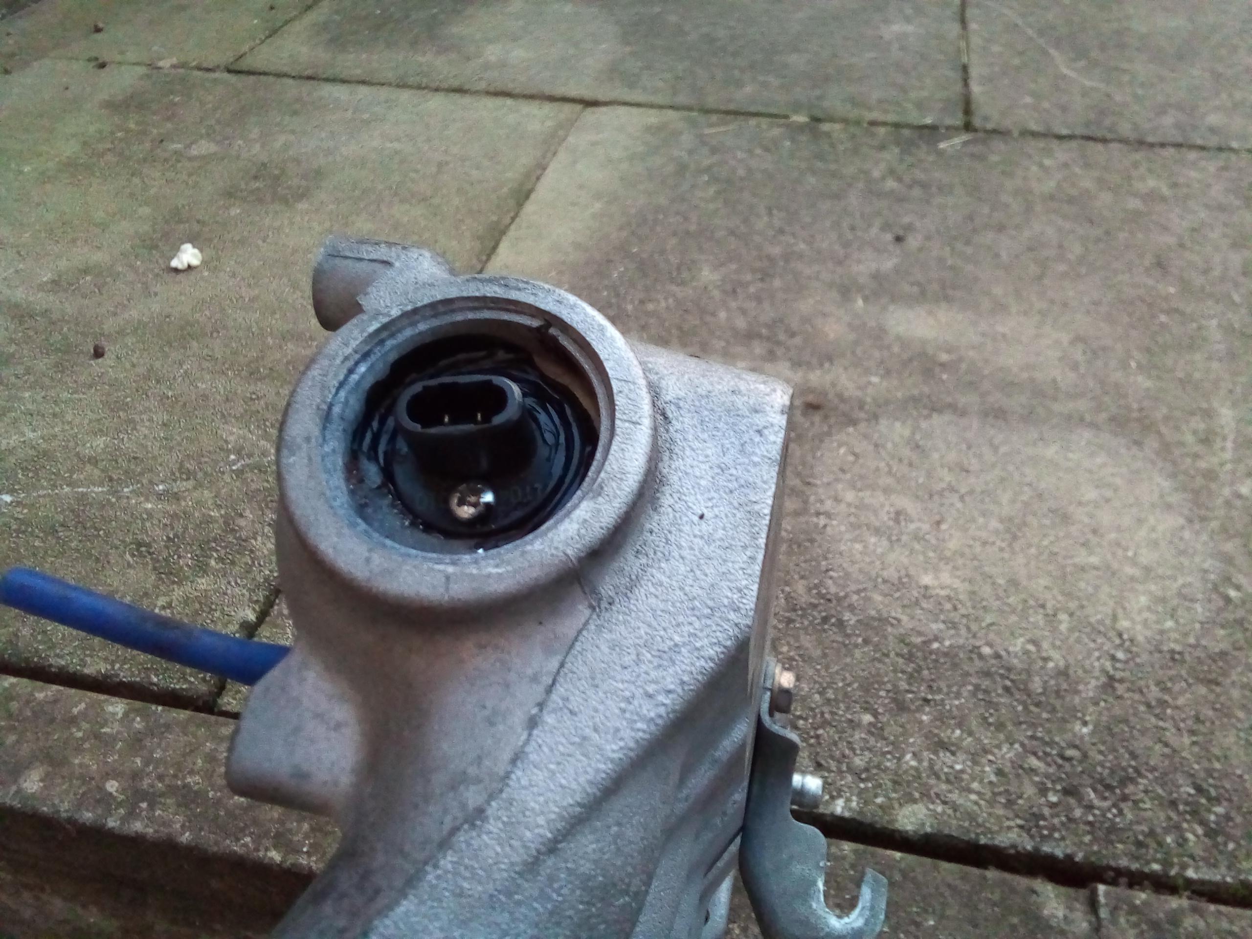

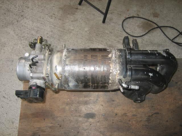

Sam44 Posted August 31, 2020 Author Posted August 31, 2020 (edited) Modified 5e intake manifold to house the 4efe intake temp sensor. The more robust 4etfe intake air temperature sensor (thermistor) does share the same resistance values as the plastic 4efe unit and is threaded so can be used. Edited August 31, 2020 by Sam44 Quote
Claymore Posted September 1, 2020 Posted September 1, 2020 12 hours ago, Sam44 said: Modified 5e intake manifold to house the 4efe intake temp sensor. The more robust 4etfe intake air temperature sensor (thermistor) does share the same resistance values as the plastic 4efe unit and is threaded so can be used. Nice touch mounting the sensor (better than in the glove box 🤭). Looks like a second generation 5efe manifold? Do you know what the differences to the 4efe stock starlet manifold are? I'm sure I read that the first gen 5efe manifold is the same as 4efte (short, fat runners) larger TB port, but I also read that the second gen is the same as starlet 4efe? Internet BS perhaps. Also I take it the fte sensor has a different plug shape? Quote
Sam44 Posted September 1, 2020 Author Posted September 1, 2020 (edited) 1 hour ago, Claymore said: Nice touch mounting the sensor (better than in the glove box 🤭). Looks like a second generation 5efe manifold? Do you know what the differences to the 4efe stock starlet manifold are? I'm sure I read that the first gen 5efe manifold is the same as 4efte (short, fat runners) larger TB port, but I also read that the second gen is the same as starlet 4efe? Internet BS perhaps. Also I take it the fte sensor has a different plug shape? The intake runners are slightly longer than on the 4efe, other than that its pretty much the same. I'll do a side by comparison as soon as I get home. Yeh the electrical plugs are different for the intake air temp sensors. The one I have here is off a ep91 1997 glanza v, it has a gray plug, but I've tested both at different related temps and the readings are identical. I've reduced intake air temp by around 20degC. This will help the 4efe plastic sensor reading and service life expectancy, as well as engine torque output. Edited September 1, 2020 by Sam44 Quote

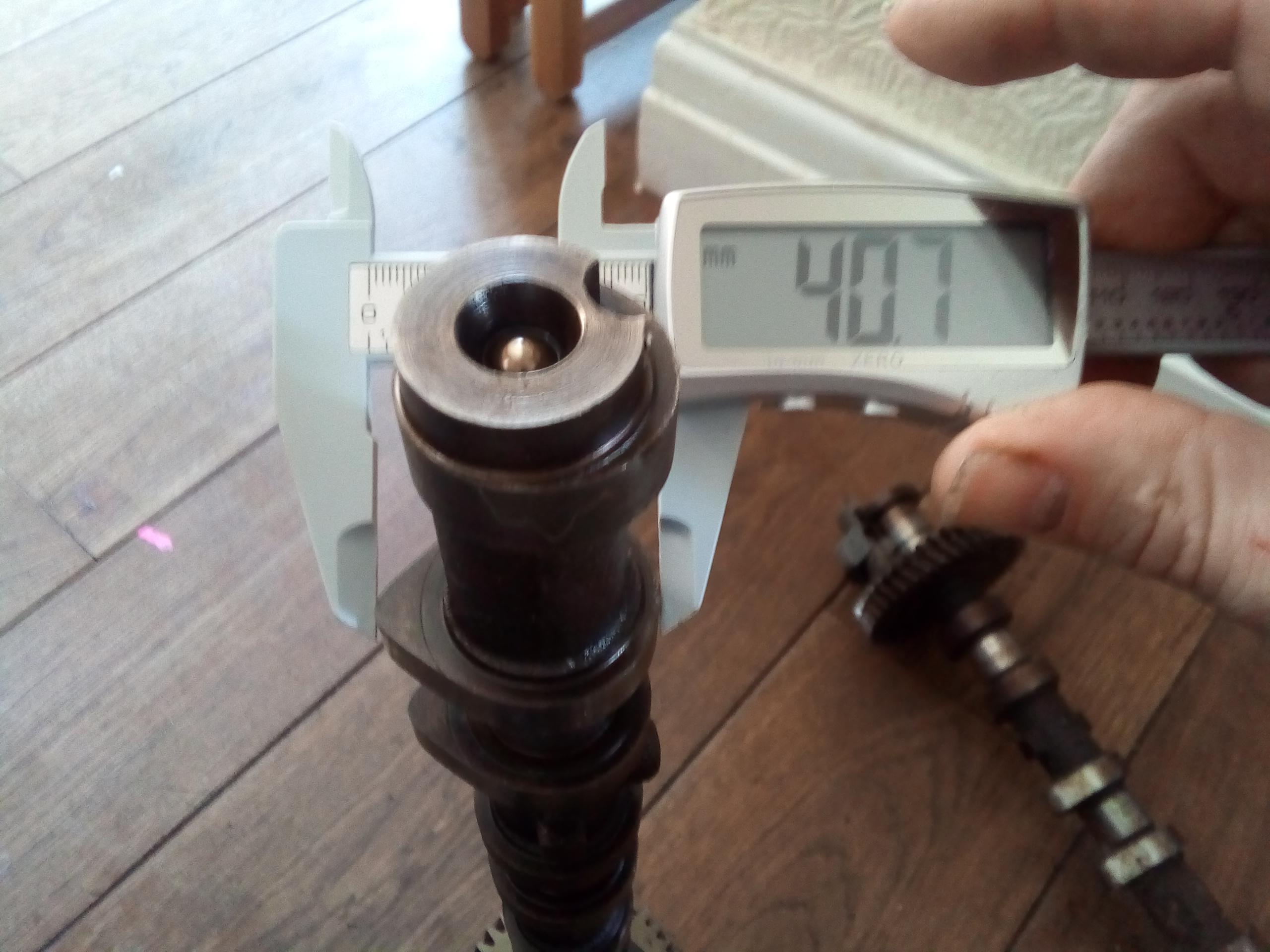

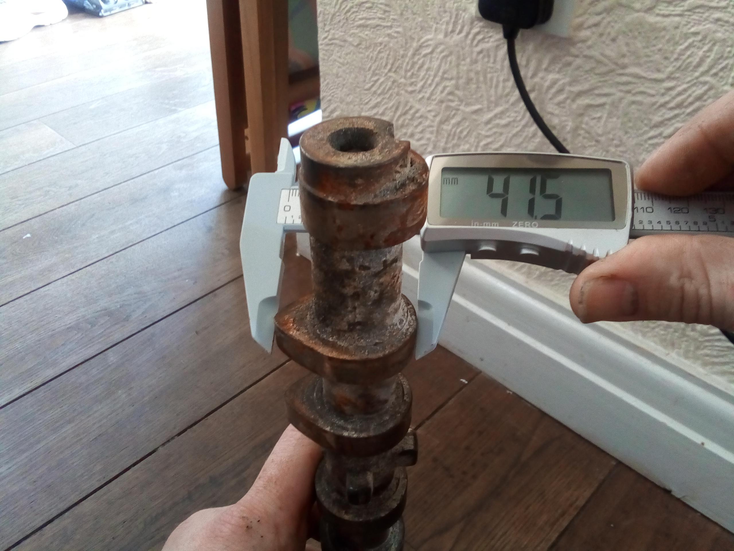

Sam44 Posted September 15, 2020 Author Posted September 15, 2020 (edited) The lift difference between the UK ep91 4efe and 4efte inlet cam. 1st up 4efe 4efte inlet cam bellow. .8mm more lift on the 4efte unit. Which can clearly be seen on the Dyno graph torque peak and length. I'll update this with duration and other cams I have here (5efe, 5ehfe, gen1 JDM ep80, gen1 4efe E11 corrolla. After speaking with some of the older Jamaican lads in order to utilize the tubular corrolla inlet manifold and align it with this cam (to slow the torque drop off around 5.5krpm) holding the torque as high for as long as possible this modification has been recommended. Extending the manifolds plenium chamber. From what I'm being told this modified manifold is good for 260hp. Providing great power balance and torque figures. Edited September 16, 2020 by Sam44 Quote
Claymore Posted September 15, 2020 Posted September 15, 2020 21 minutes ago, Sam44 said: The lift difference between the UK ep91 4efe and 4efte inlet cam. 1st up 4efe 4efte inlet cam bellow. .8mm more lift on the 4efte unit. Which can clearly be seen on the Dyno graph torque peak and length. I'll update this with duration and other cams I have here (5efe, 5ehfe, gen1 JDM ep80, gen1 4efe E11 corrolla. Interesting, I take it the base circle of both cams are the same size? Quote
Sam44 Posted September 15, 2020 Author Posted September 15, 2020 (edited) Yes the cam circle with out the cam profile is identical working to .1mm on vernia calipers. I will dti the cams in, and plot lift (mm) against duration (deg) on all to see if any other cams have been over looked threw out the years. Edited September 15, 2020 by Sam44 Quote
Claymore Posted September 15, 2020 Posted September 15, 2020 Cool Cool, don't fancy my chances of finding anything other than a turbo cam but it'll be interesting to see. Can you measure overlap? Or just concentrating on intake cam? Quote

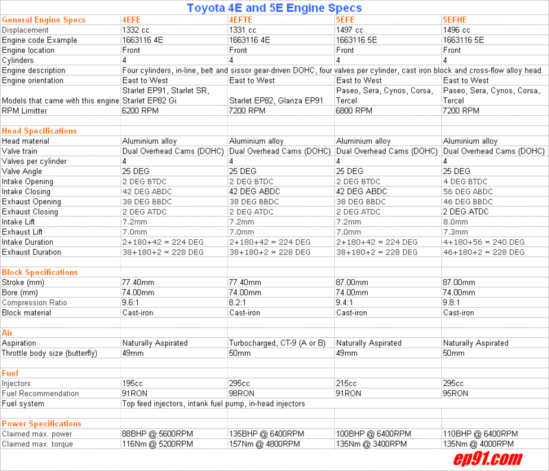

Claymore Posted September 22, 2020 Posted September 22, 2020 (edited) 52 minutes ago, Sam44 said: As soon as I'm back I'll start to measure the standard configuration against all other sets out there. At the present i can't find any measurements on the standard timing and lift on any of the E series engines. This is a good starting point. Found this on the gtt website from 11 years ago. Seems to have some errors. Can't say for sure what info is correct or incorrect as I've not measured anything but it would be interesting to see the differences when the cams are actually measured against this info for reference. Maybe the turbo cam lift increase was an update, perhaps the early gt's or the later glanza's had different specs? Perhaps Toyota were using up the N/A cams at the end of glanza production and this is the one example that was measured that has caused the confusion? I know you have lots of turbo cams knocking around, are they all the same increased lift? I also saw on a Matt berry youtube vid that the 5efhe's with and without ACIS have exhaust cam differences. Could be BS also. LOL. Looking forward to the results. Edited September 22, 2020 by Claymore Quote
Sam44 Posted September 22, 2020 Author Posted September 22, 2020 (edited) Yeh alot of guess work going on between the different car models it seems. Same with the gearbox information online, alot of comparisons going on between things like the g6 and g6r boxes where as straightaway I'm finding differences. The misinformation super highway strikes again. Dutchie these cams are designed for a ct9 style turbo with more lift so I'd say your good. With a increase in mid to topend power levels. But check for case hardening and lift against springs. The increased lift increases overlap slightly, but not by much. Recently I witnessed a cam setup were the high exhaust temp and back pressure (which a ct9 on high boost can produce) was playing right into the hands of big valve overlap with low lift available killing the topend power. These are the polar opposite. Edited September 22, 2020 by Sam44 Quote

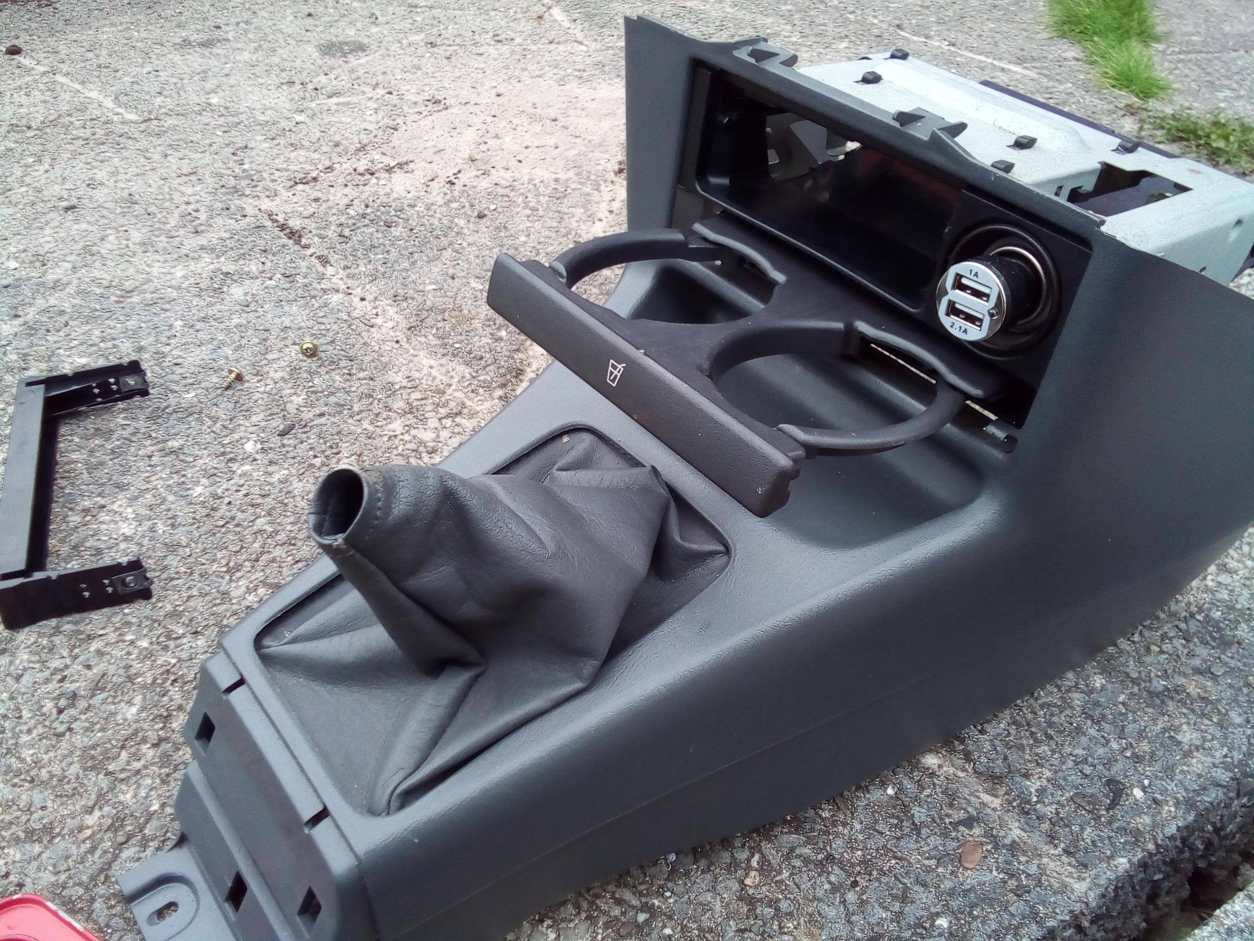

Sam44 Posted September 22, 2020 Author Posted September 22, 2020 (edited) Making some cup holders. I can't do the starlet thing any more unless I have a cup holder for my monster. It's come to this point now. 1hr install. Proper moding Edited September 22, 2020 by Sam44 Quote
RoyalDutchie Posted September 23, 2020 Posted September 23, 2020 Really need to start reading into cams. I do not know anything about them😅 Cupholders looking good may actually work better than the oem ones.👌 Quote
