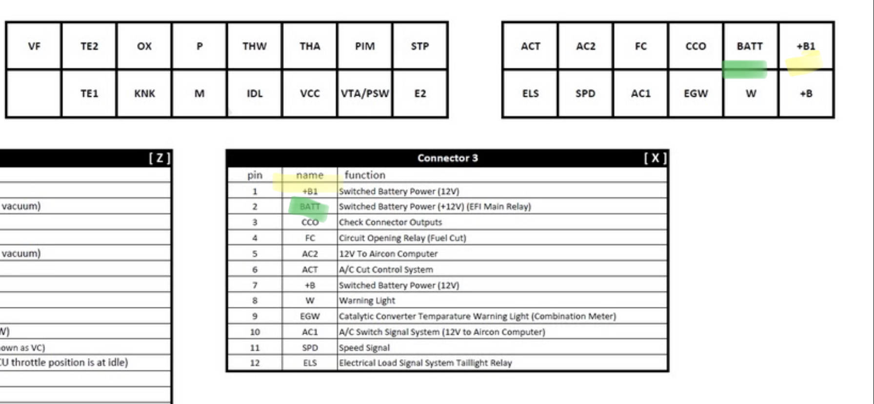

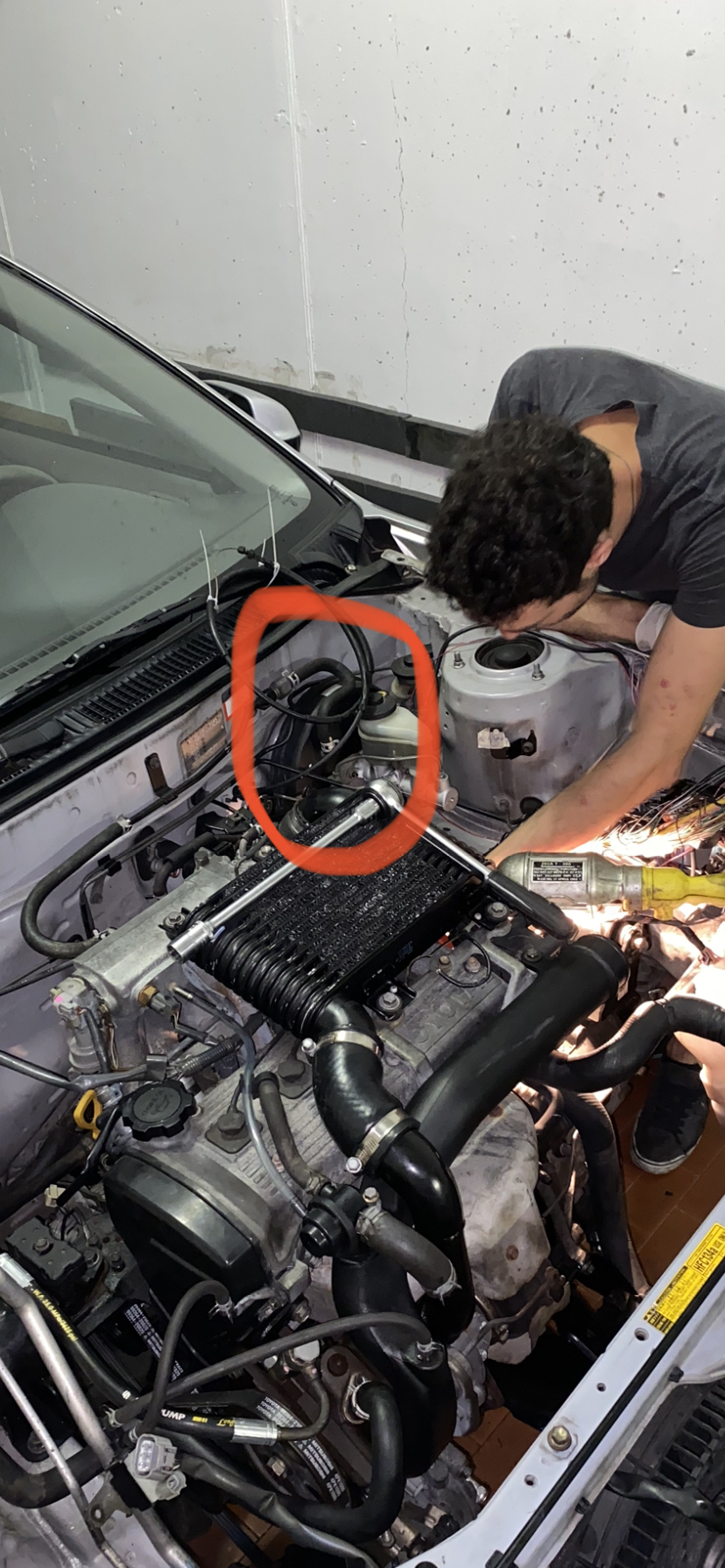

Wiring, I hate to state the obvious but are these wires important (green circle)?
These wires are all functions listed here. What do you suggest?07CBEBD0-FB30-4F1E-BC43-0273058D498F.thumb.jpeg.dda9648eda86d2f84f1db31bd32b831c.jpeg
Also when using an Automatic ECU and wiring loom I think you have to bridge some wires relating to the gear selector position wiring? Something about sending a signal to the ECU to tell it the gearbox is in Park or neutral or it won't let the car start? I think you have already found this information in an earlier post but did you do it?
Hi. Yes I bridged the gearbox connector. I saw it in a video. A British kid dis the auto to mNual conversion on a Starlet.

On 7/25/2021 at 3:21 PM, Sam44 said:
the wires in the picture are for the auto ecu/vehicle abs. not needed, also not found on the manual 4efte ems/ecu.
Thank you Sam! We are going step by step, function by function. If you have an updated diagram with the ECU outputs for the auto to manual ECU fix it will be very useful. We are using the amnuals and ECU pinout info.

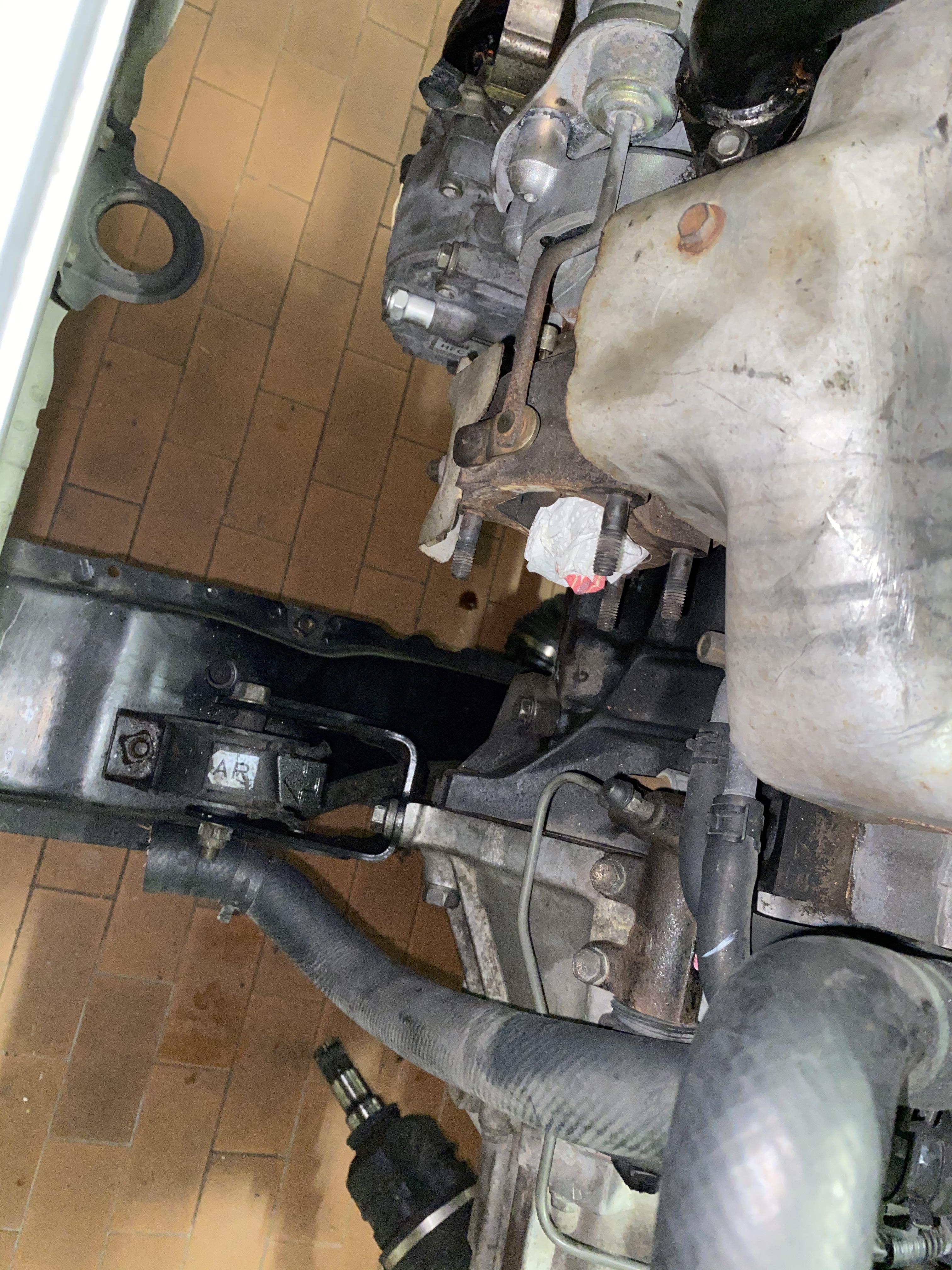

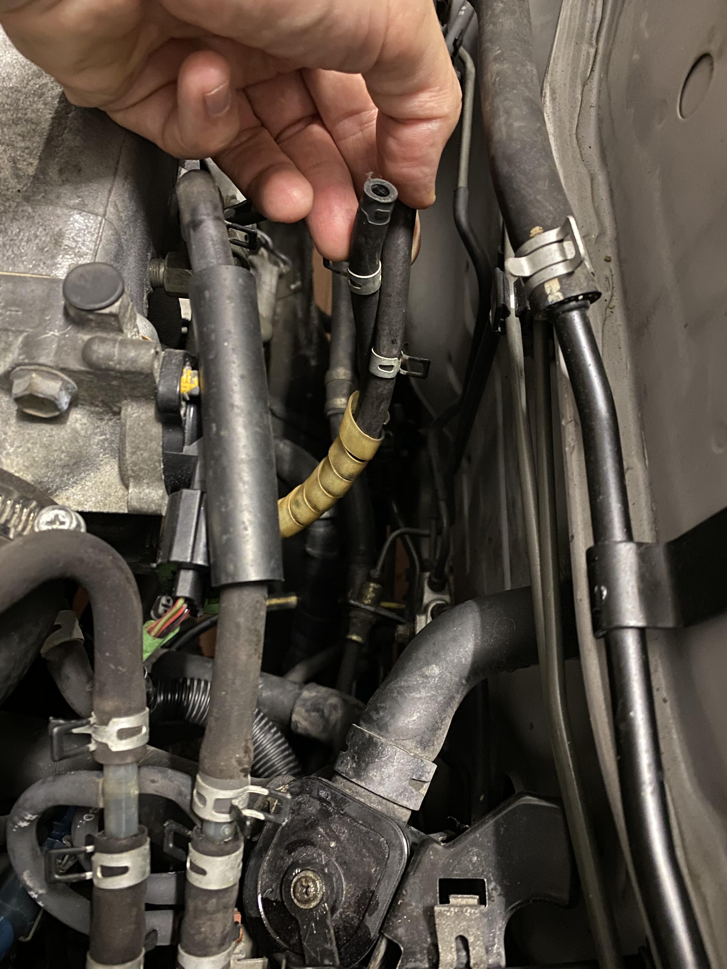

today I will see my boy to continue the work. I received the down pipe from tune developments. Hi will work on a few things and then try to figure out where those two vacuum pipes (that originally go to the vacuum pump on the Starlet) Will get hooked on my Corolla. My car has that acid pump input on the steering pump. I need to do the same elsewhere. I hope you can help with a simple example.
first issue is to adopt the free hose pipes that originally go to the vacuum pump that I do not have because the Corolla uses the steering pump to vacuum. I need a solution.

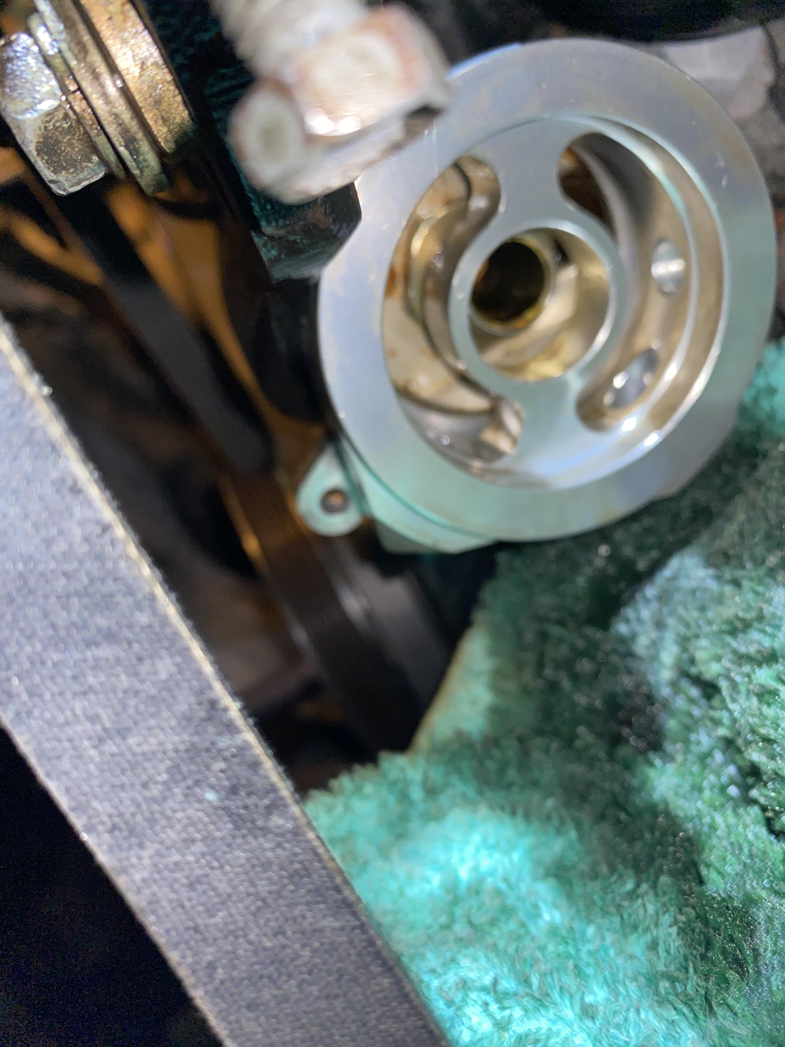

I bought oil Sandwich gauge but it doesn’t fit because it touches the steering pump bracket. We will have to try to peel some metal off it to get it in line. i’m not even thinking about taking the bracket off and ruining it for a gouge adapter.
let me know if you can help with the pipes please.

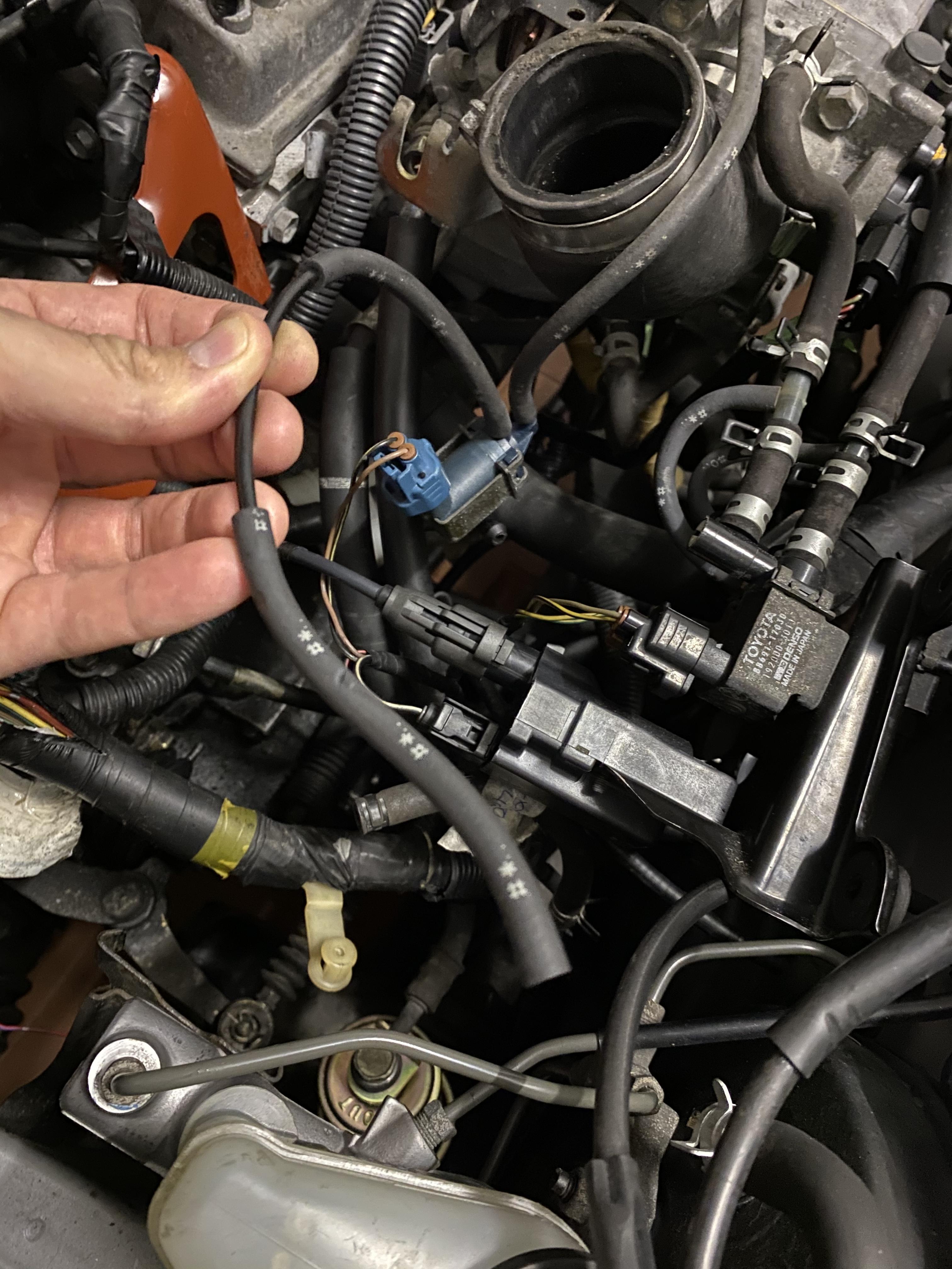

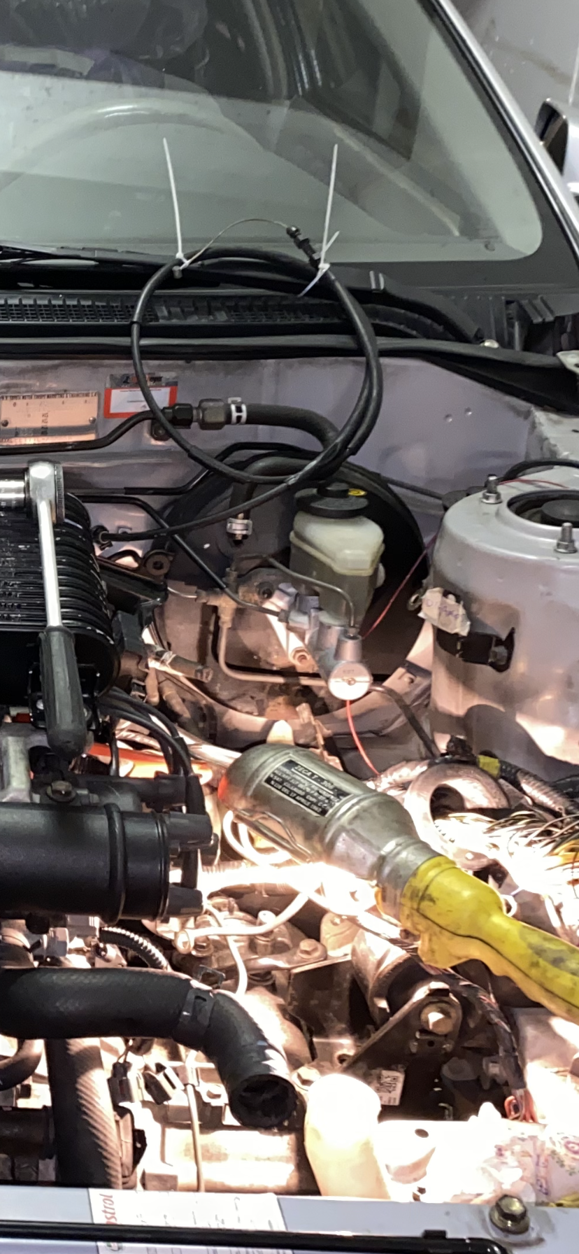

Now I really need now where the 2 air hoses (vacuum for low rpm) can be connected. One pipe comes out of the lower throttle. The other from the lower part of the inlet. The are short and hanging there. Can you help?095286EC-67A8-45BE-A642-46A08DE20CB2.thumb.jpeg.8fee5ca289856539f1d02d15c9af4654.jpeg
these two air hoses go where they should. Should I modify some thing here to connect the two RPM air pipes? does this make sense? If so, how and which hose where? thanks
58 minutes ago, RoyalDutchie said:
This looks pretty sketchy. Does the oil filter still seal well? I've been told the d1 spec sandwich plates fit without any work. Not sure if this is true, didn't try it myself.
It is catchy. They do not fit. They touch the steering pump bracket. We are modifying it right now because I refuse to modify the bracket. We will see if it still works and doesn’t leak.

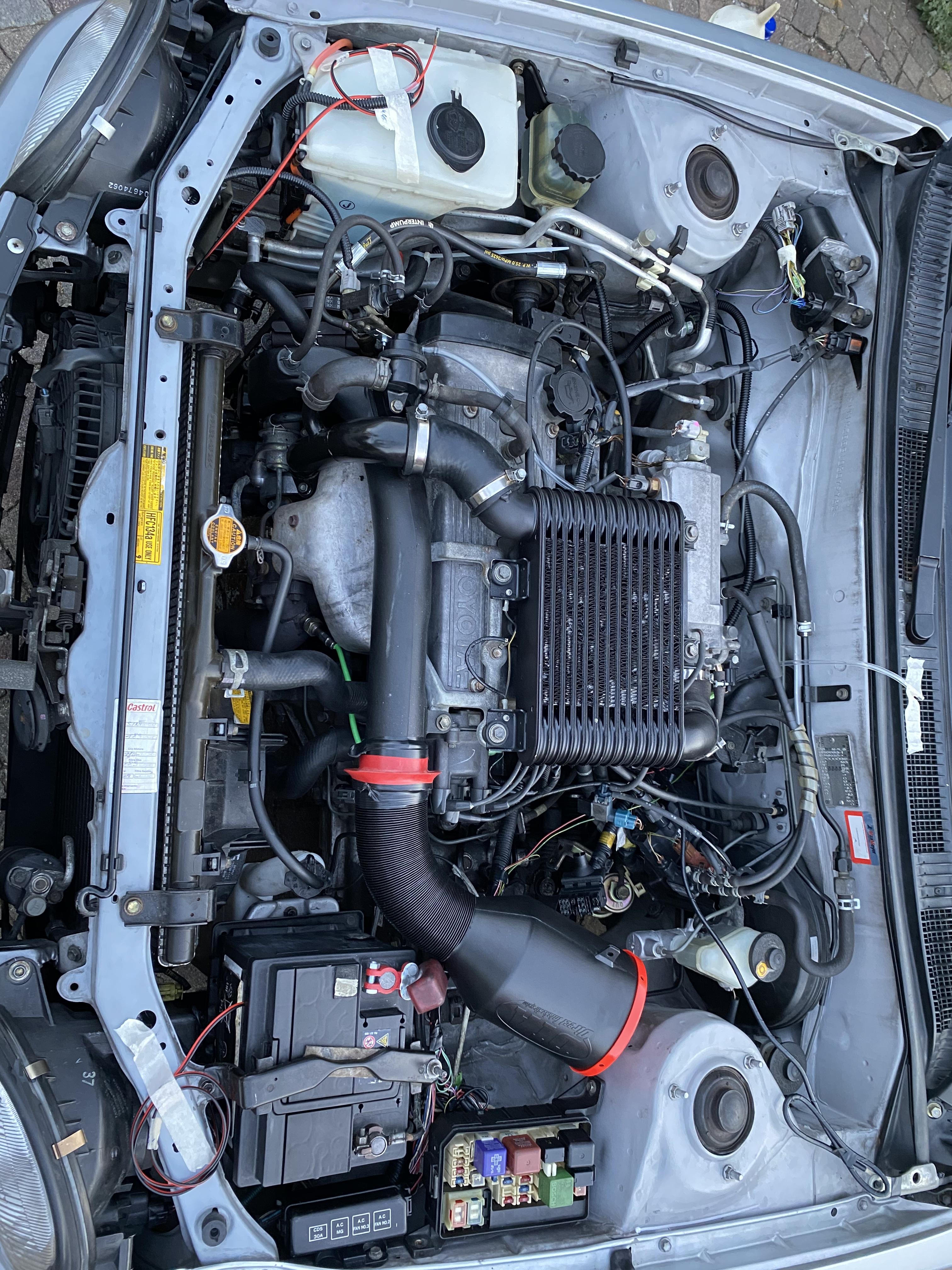

On 7/25/2021 at 4:26 PM, Claymore said:
I am already aware of the gains from removing the restrictive "EFI" pipe, airbox and piping to reduce the upstream pressure drop created by them (as are most people on the forum by now I think?)
Sock filters are best left to itb trumpets in my opinion and the amount of oil used by ITG on the panel filter I had on a previous car was ridiculous and it dripped out coating the bottom of the airbox (not good for a turbo to ingest).
It is important for a cone filter to have a trumpet base also to help gather more air than a straight pipe, good performance gains here. Element / filter area of significant size to reduce the pressure drop of filter and also to choose the correct media (stainless gauze, foam or cotton.) The bigger the better as far as I'm concerned, more surface = less restriction and balance the size of filter against the material to get the correct flow depending on room in the bay.
Also be careful the silicone pipes and couplers don't suck flat, it is often best to use aluminium pipe as much as possible with minimal silicone to prevent this. Not usually a problem until the Turbo is larger and sucking hard but worth considering.
Yes, the Turbo intake pipe (TIP as commonly referred to in other circles) is nicknamed the EFI pipe as some models had 16 valve EFI sticker on them.
I also don't think the cover on the intercooler is the Turbo because it has a sticker that says turbo 😉.

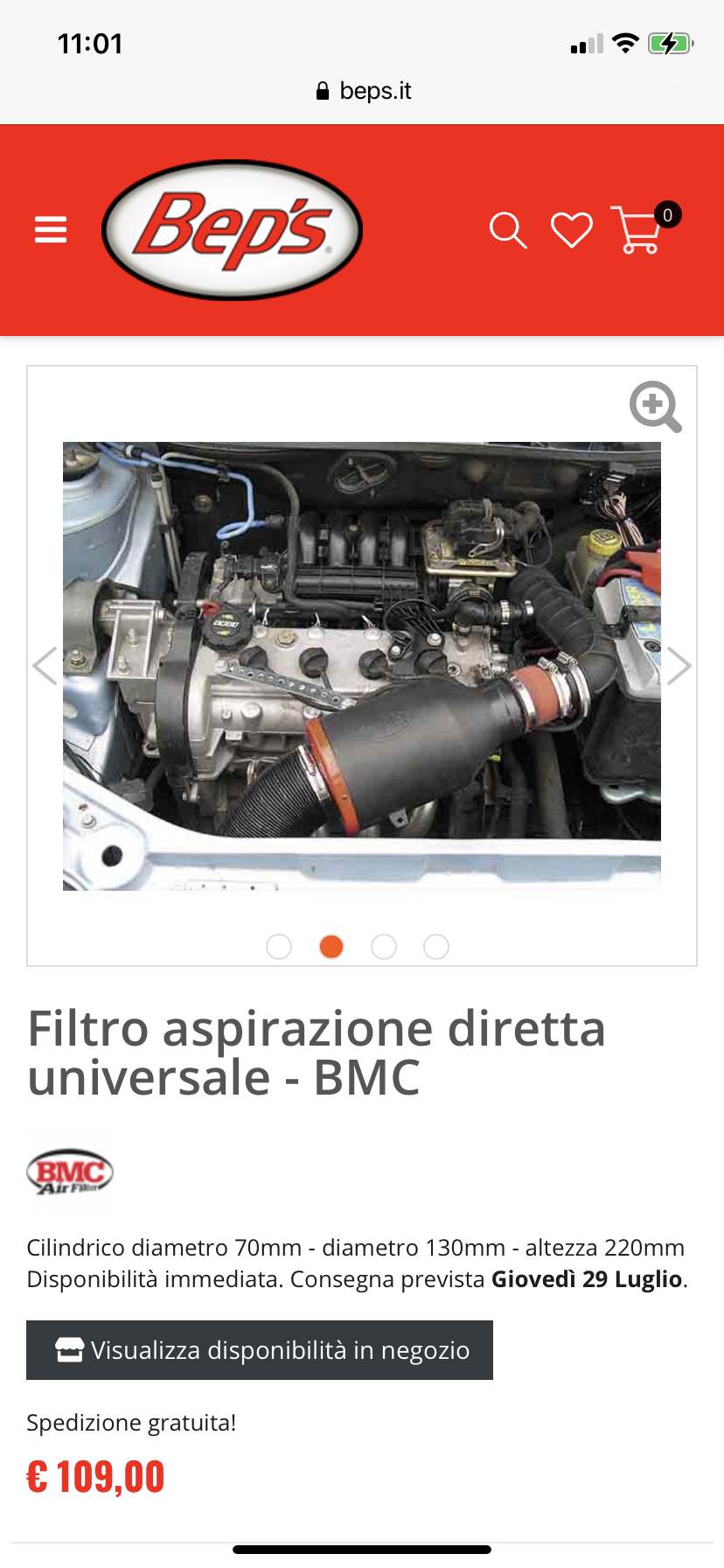

I bought this air filter for engines below 1600 cc. 34E0C088-AF48-4F82-81D9-792A2C3E0DAB.thumb.png.7b9da855ab6eaefe3afdf17b9e32409c.png
the filter should work.

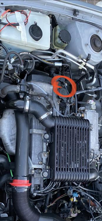

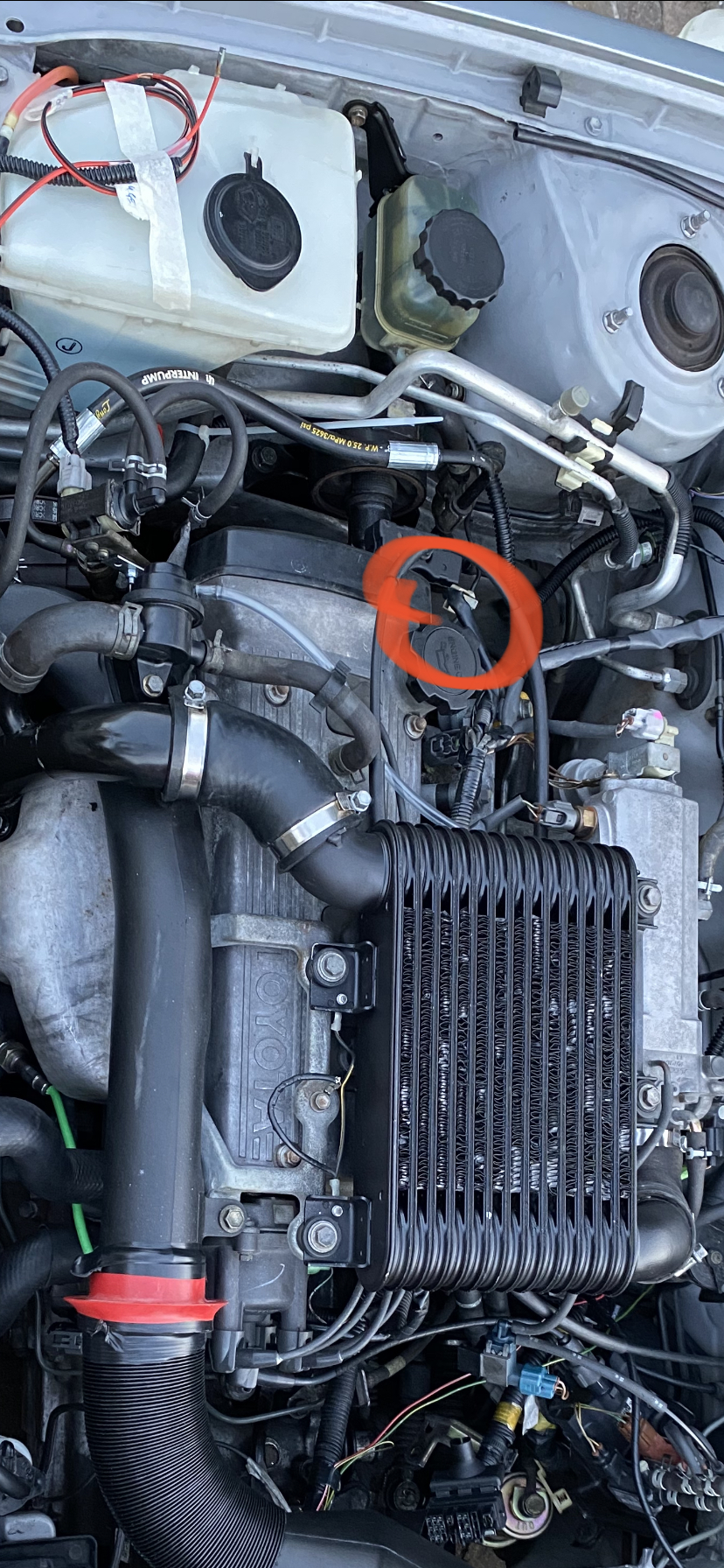

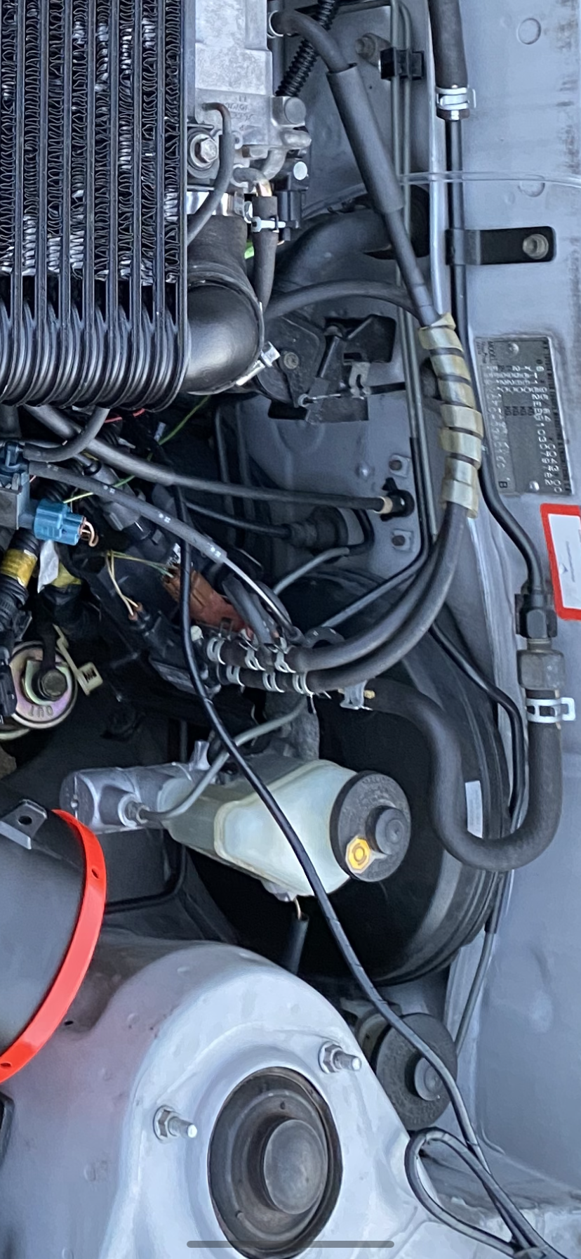

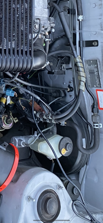

THE PIPES TO THE STEERING RACK VALVE, you can blank off most of the starlet lads do this, ive blanked them off on both my paseo and ep91 build. i cant tell any difference with engine loading at low rpm.
the blue electric valve in the picture is for the charcoal canister. this is a big round black canister that sits against the bulk head. the job of this canister is to store fuel vapor from the fuel tank breather (YOU CAN TRACE THE FUEL TANK VENT PIPE, IT GOES UNDER THE CHASSIS TO THE TANK) making it a enclosed system, environmentally friendly. when this opens the engine draws out the fuel vapor that is stored in the canister.
you can remove these (valve, pipes & canister) and blank off the pipes to the engines throttle body. ive done this and i use a motor bike fuel tank vent valve on the fuel tank breather pipe, this allows the fuel tank to draw in air as the fuel level in the tank drops.
this does also bring performance gains.
firstly it stops the older saturated canisters (these require replacing) from causing a vacuum in the fuel tank, when this happens the fuel that the fuel pump is trying to deliver to the engine is being sucked back to the tank. next time you fill up see if there is a sucking noise from the fuel cap as its removed. if so the canister is ready to be replaced.
also the throttle body area is a key area for the inlet system when there are more pipes added it causes air turbulence where these pipes meet, this reduces both peak flow rates and air velocity/speed.
it really neatens up the engine bay.
i will put a picture up of the vent valve.

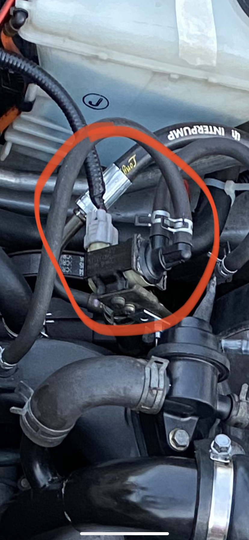

no engine warning light or diagnostic trouble codes are stored.
the black electrical valve circled in the picture im told is to help the engine when it comes under load from the air con pump, providing a slight increase in rpm at idle when the air con is on.

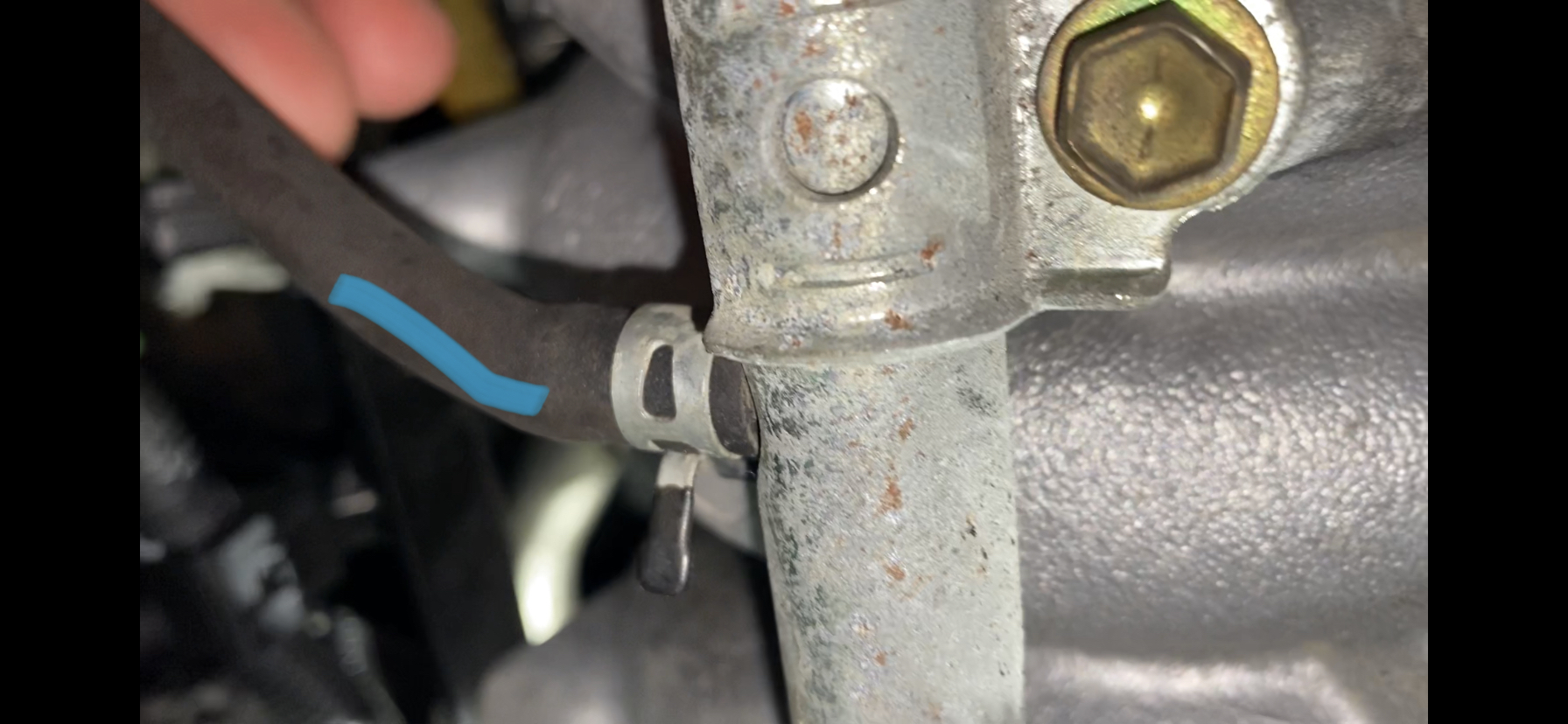

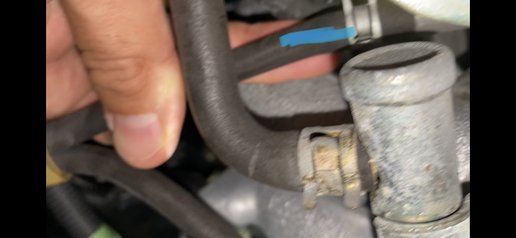

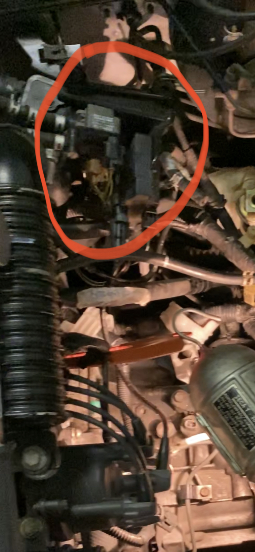

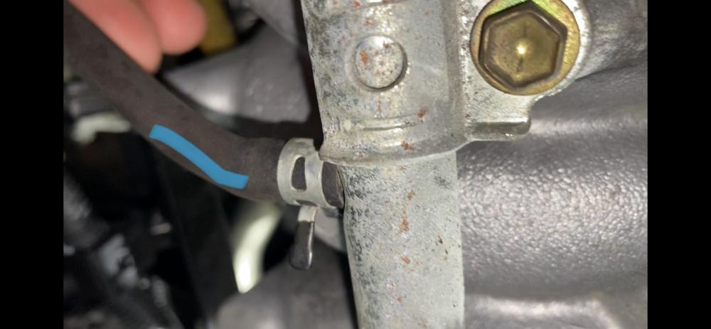

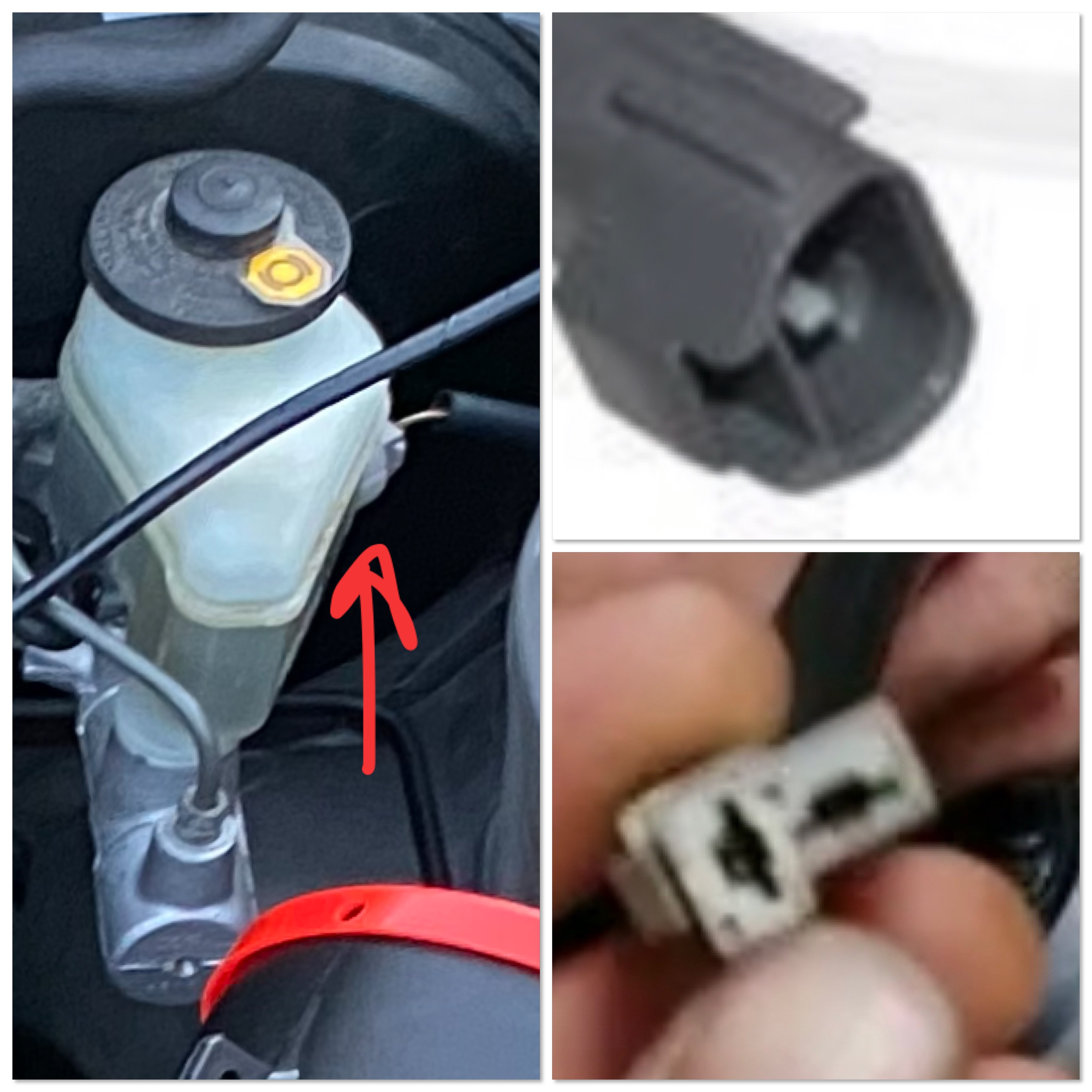

I found two pictures. One shows the valve with the two hoses. They are not three. My apologies. One goes in the valve and one goes to the canister. How should I modify it? should I put the motorbike tank valve straight in the hose coming from the engine?
The other picture shows a connector that we cannot figure out. What is it? My friend was talking about bus control     I thought that loose control was the valve with two hoses attached on the turbo air outlet. Can you confirm that?B3C8D479-4054-4370-87CC-A23FB3C80EF8.thumb.jpeg.2ff34988a5b789c5675d3141c7102461.jpeg4BCE9646-E229-4A74-8CB0-7D248D0872E3.thumb.jpeg.5a8d7cb2ec5e9e358d2ec022833c4043.jpegC31A8D41-AB88-4903-A648-F77EB1AF1525.thumb.jpeg.6512da0c1dac8238aaca328bbf22a3f9.jpeg
Edited by Frankieflowers

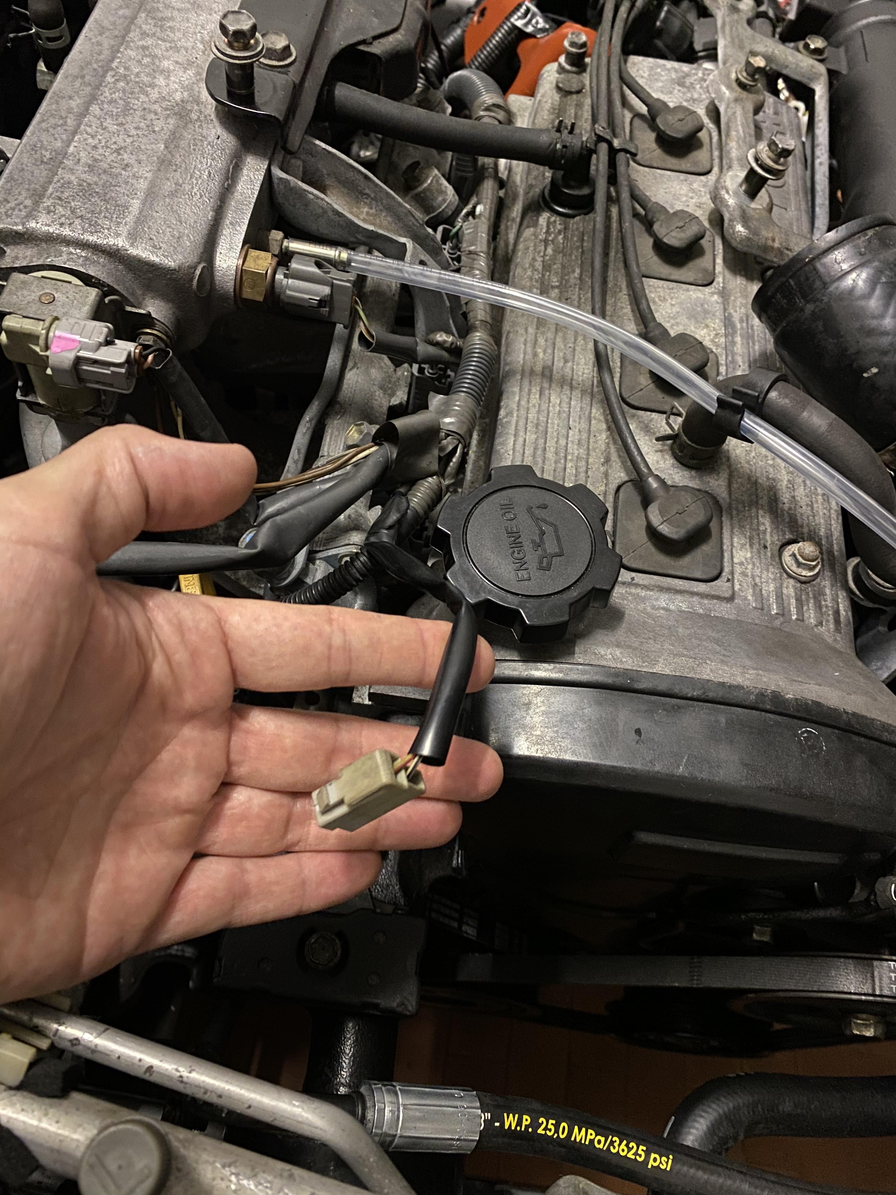

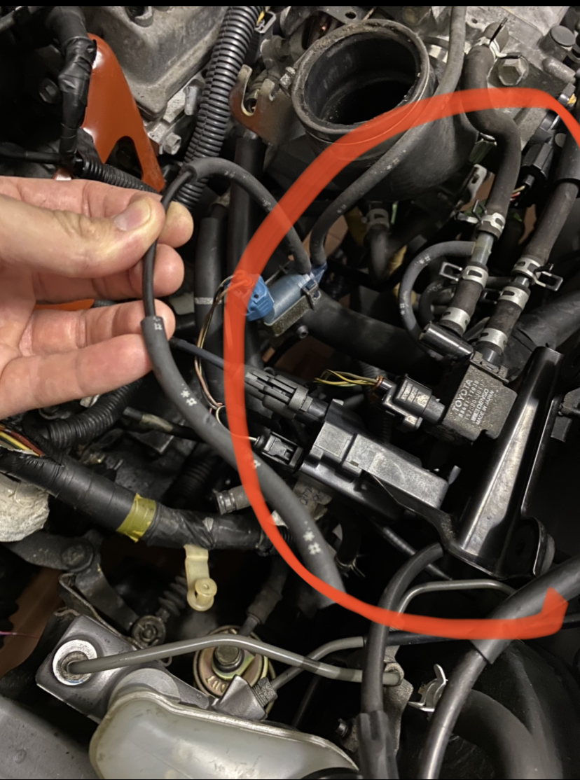

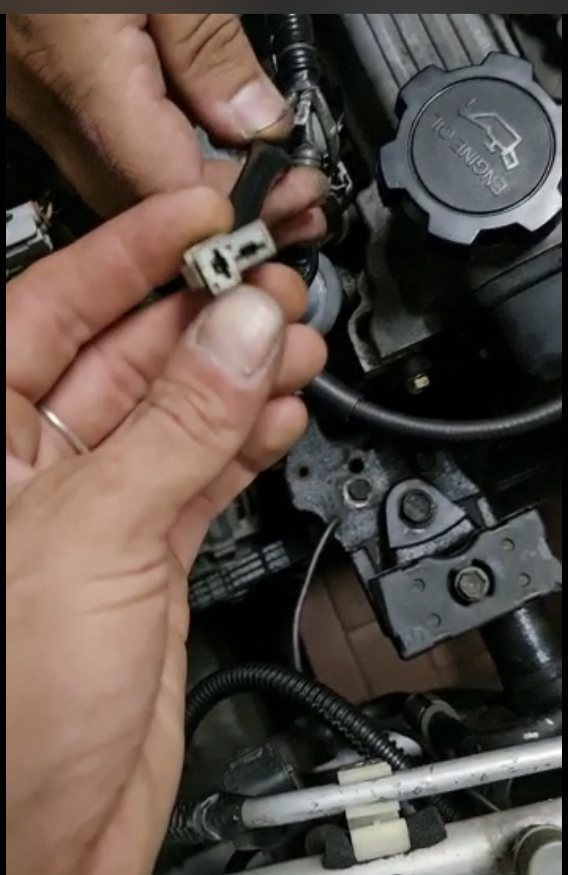

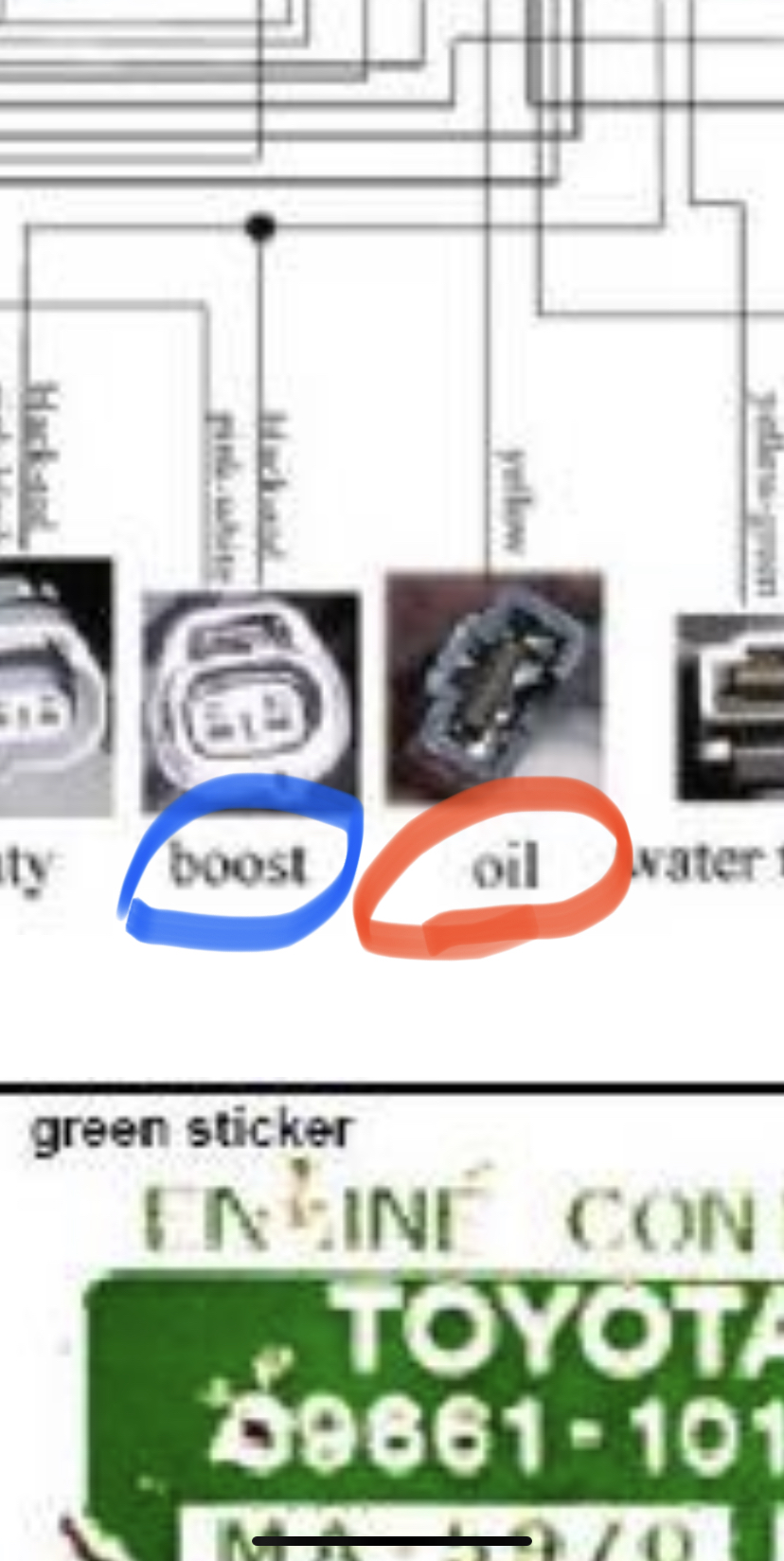

Here’s the connector I do not know. My friend was talking about boost control. If so then I don’t have the boost control valve. I thought lose control had the connector am showing below and it should be the vacuum on the left side of the engine in front connected to the turbo intercooler air output. A77944F3-924C-4585-8D14-F25EE40CA0E4.thumb.jpeg.497834cae44c69d82e4c5bfd3e0ce503.jpegF9C9E7D2-ABCB-4AC9-8735-52C61A69F3DB.thumb.jpeg.a36b9365bb9826c77fc5a1333d29ceda.jpeg6322BF8C-BB68-4A17-9701-03F828CD7AB9.thumb.jpeg.9e2fb8c1db8bbd95810c973c680b982c.jpegFF382F83-9A9E-4196-8F44-5C48A40AA95A.thumb.jpeg.4e5f25a6ebb30d82bb24c24de3eadd15.jpeg
  • 2 weeks later...
Sorry about late reply. The 2x pin connector grey in colour and not connected, is for your brake fluid level warning. It goes to your brake master cylinder fluid float.
Yeh the other valve is the high low boost solenoid. If you don't have the button for the dash to operate this valve then remove it and just run high boost. Other wise you might and will probably just be on low boost (fail safe mode).

On 8/22/2021 at 5:36 PM, Sam44 said:
yes that is what that plug/pins do. looking great. well done.
