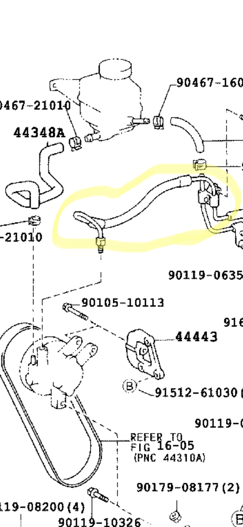

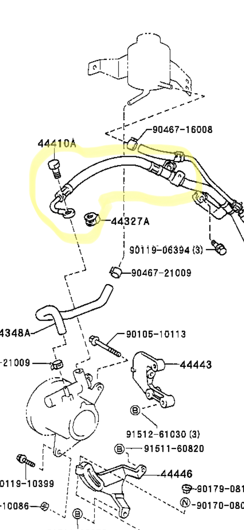

If your using the 4efte pump:
The Corolla Power steering feed line from bottle to pump should fit the 4efte pump. The connections look the same in the pictures. No modification needed. Or make a hose. Blue circle on diagram.
The Corolla low pressure return line from the rack to the bottle. Already in place and working. no modification needed. Red outline on diagram.
The High pressure hose is the one that needs modification. Green outline.
If using the corolla hose the 4efte pump fitting is different to the corolla. The 4efte pump is a banjo fitting and the corolla looks like a flare fitting. You will need an adapter on the pump to go from banjo thread to flare fitting. Grey circle on diagram
If you use the 4efte high pressure hose the pump end is good but the rack end is wrong (assuming its long enough to reach the rack). From the diagram it looks like the corolla hose at the rack end is female thread and the 4efte hose end will be a male flare. So you will need an adapter to join 4efte male hose end to the male pipe fitting on rack. Orange circles on diagram.
If you can't find an adapter you can cut the 2 hoses, use the 4efte pump end and the corolla rack end and have a hydraulic hose repair shop join the pieces together with a swaged / crimped hose repair joiner. Or have the hose shop make a custom hose for you.
The best idea is to talk to a hydraulic hose repair shop (forklift trucks etc) and show them the pump and hoses and ask them what adapter you need. I don't think anyone on this forum has done this swap before so we are all learning together and trying our best but unless we know the exact fittings then we can't suggest one.
The whole point in using the corolla pump was because it has the idle up valve on it to stop the engine losing revs whilst steering. If you use the 4efte pump you will lose this feature as it doesn't have one.

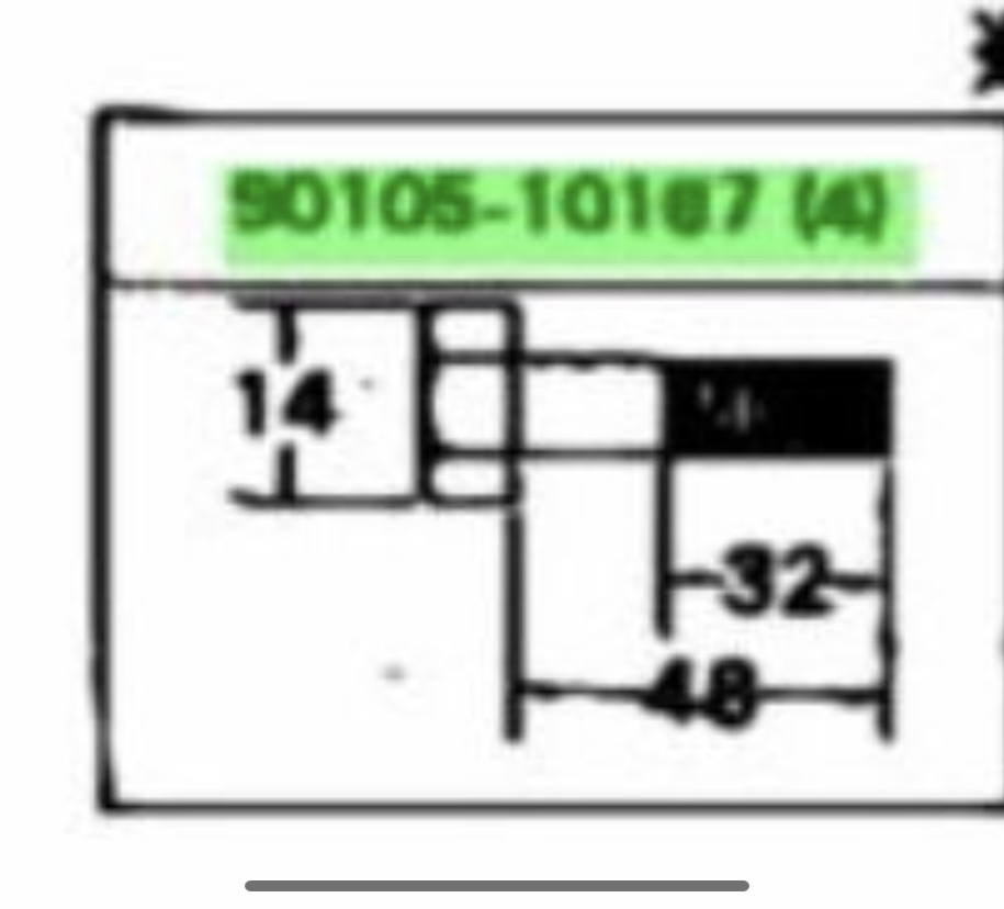

@RoyalDutchie@Sam44 do you guys have flywhell bolts measures?
an example in the picture. This way I can ask the guy I know here to avoid shipment expenses from Japan. Thanks!AF18906E-C35B-430D-A5A8-D7464B27E5B3.thumb.jpeg.676ebb20fc50d19ebd79d82b128f5b6a.jpeg
No measurements, but just like Jay wrote, only genuine ones(and arp ones) should be used with the right threadlock(I think it is blue). Toyota specifically developed bolts for the flywheel to prevent it from coming lose ones installed correctly. I wouldn't trust anything else to do the job and risk a failure.
1 hour ago, Frankieflowers said:
@RoyalDutchieYpu confirm that the 90105-10138 is a set of 6?
You need to buy 6 of them, Toyota sells them individually.
