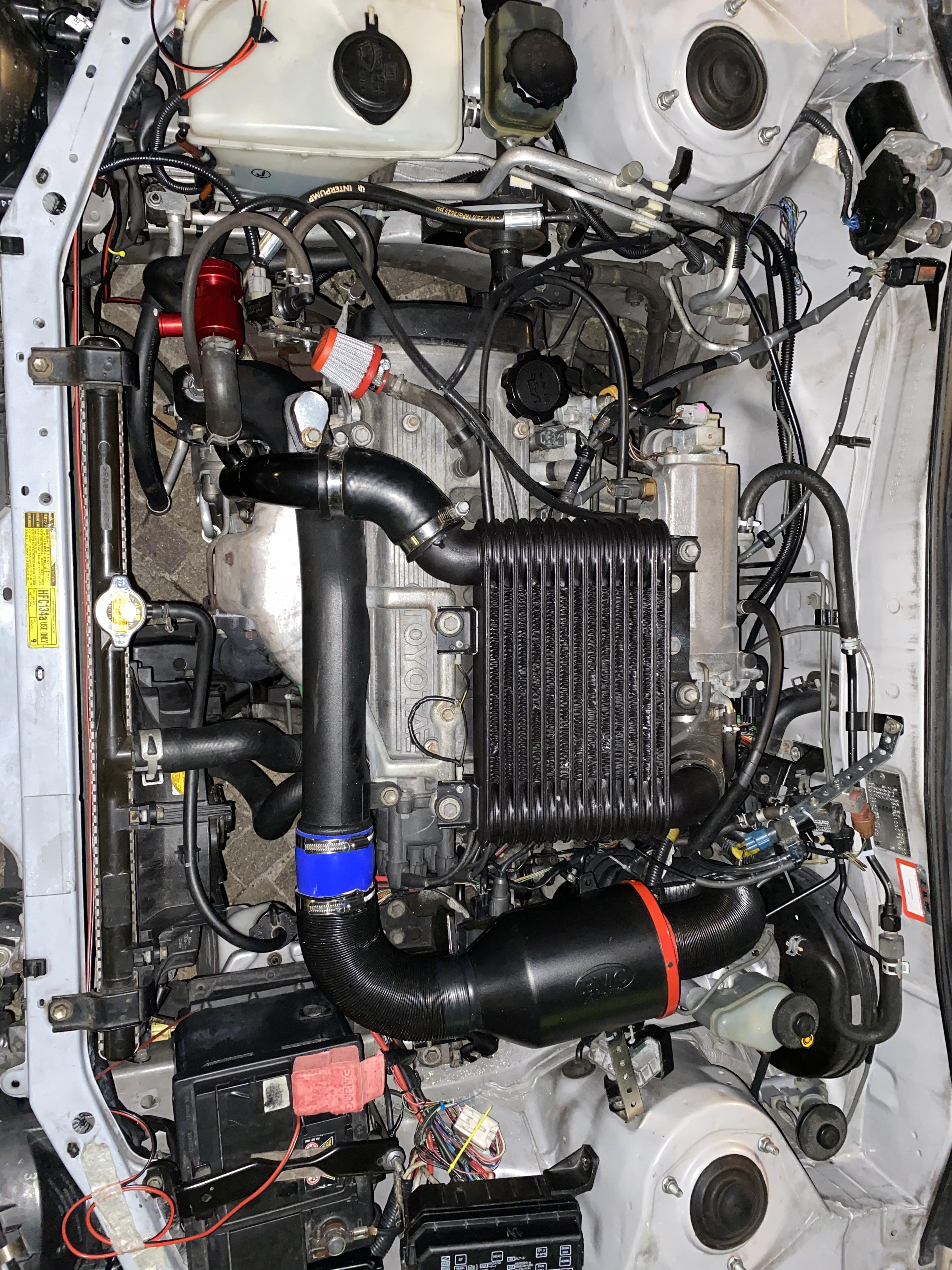

How does she feel. Congratulations a fantastic build in record time.
Get some pictures up please.

Hey there!
she feels great! I still have to finish the wiring for the AC. Figuring out why it doesn’t start in the morning. Error 22 and 42 have to be fixed. Check engine light on. I have to test fuel pressure because an ignitor might be leaking. At low rev it does blue smoke until I deive. Just a liTtle. Might be the turbo leaking a bit of oil. Must send it to refurbish. I hope it’s not a valve leaking because of old retainers.
It starts perfectly when the engine is warm. When it’s cold it need 6/8 temps to get the fuel back in. The engine. Could be the water temp sensor that has issues. Maybe the wires aren’t sending signal to the ECU.

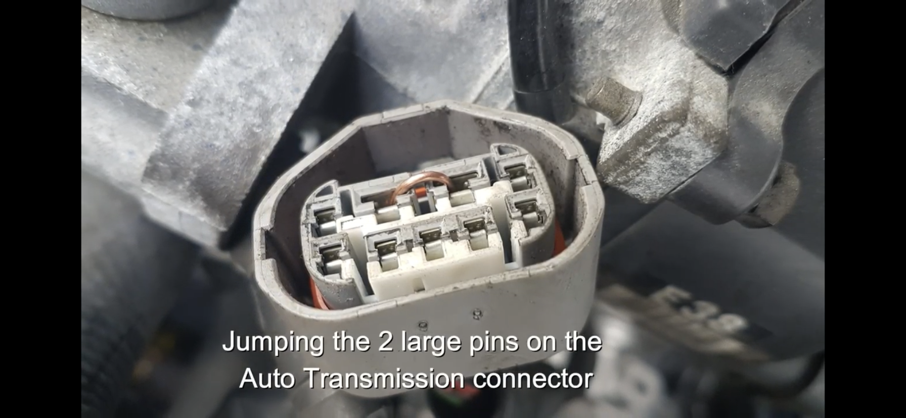

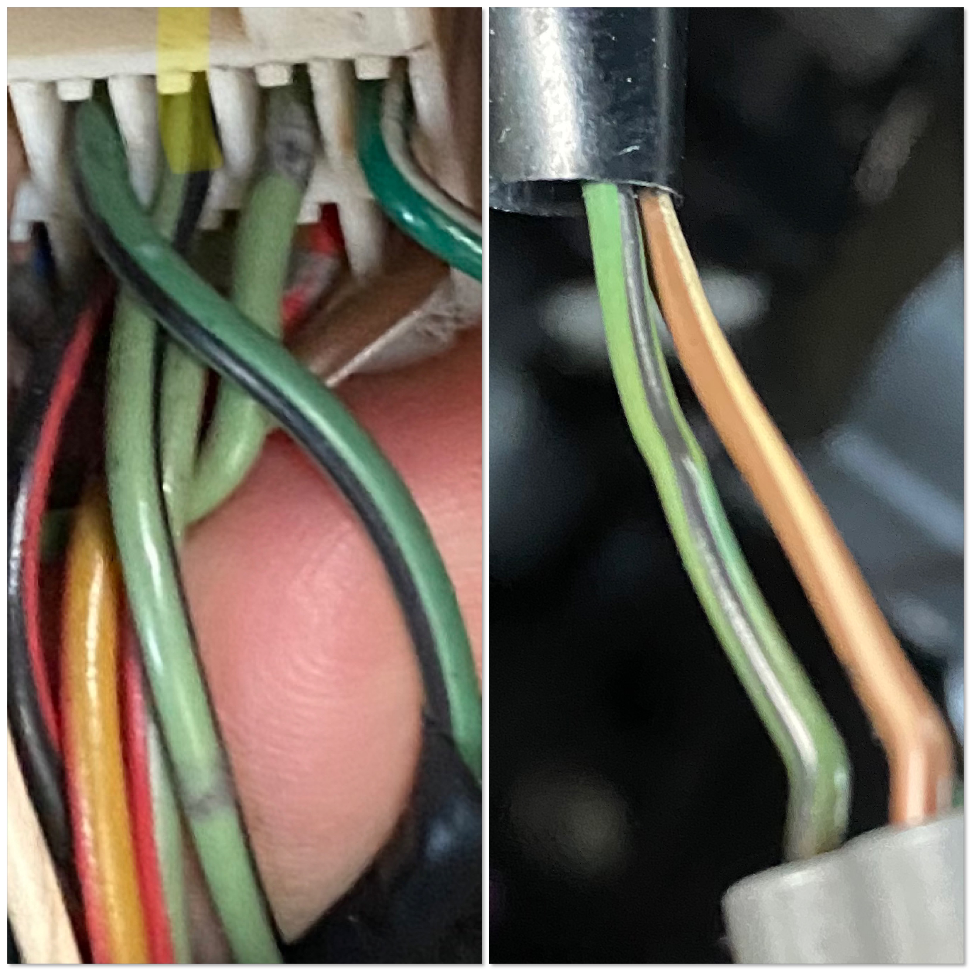

everyone is watching the car and loving the sound. My shop made an amazing exhaust. I am going to post everything as soon as I can get the air conditioning running and the engine starting cold. I have to figure out error 42. The guy who swapped gearboxes on I automatic Starlet 4EFE did bridge the automatic control connector and everything worked fine without check engine lights but it’s not my case. I am not 100% sure about what my electric guy did Saul my brother is not able to help me.

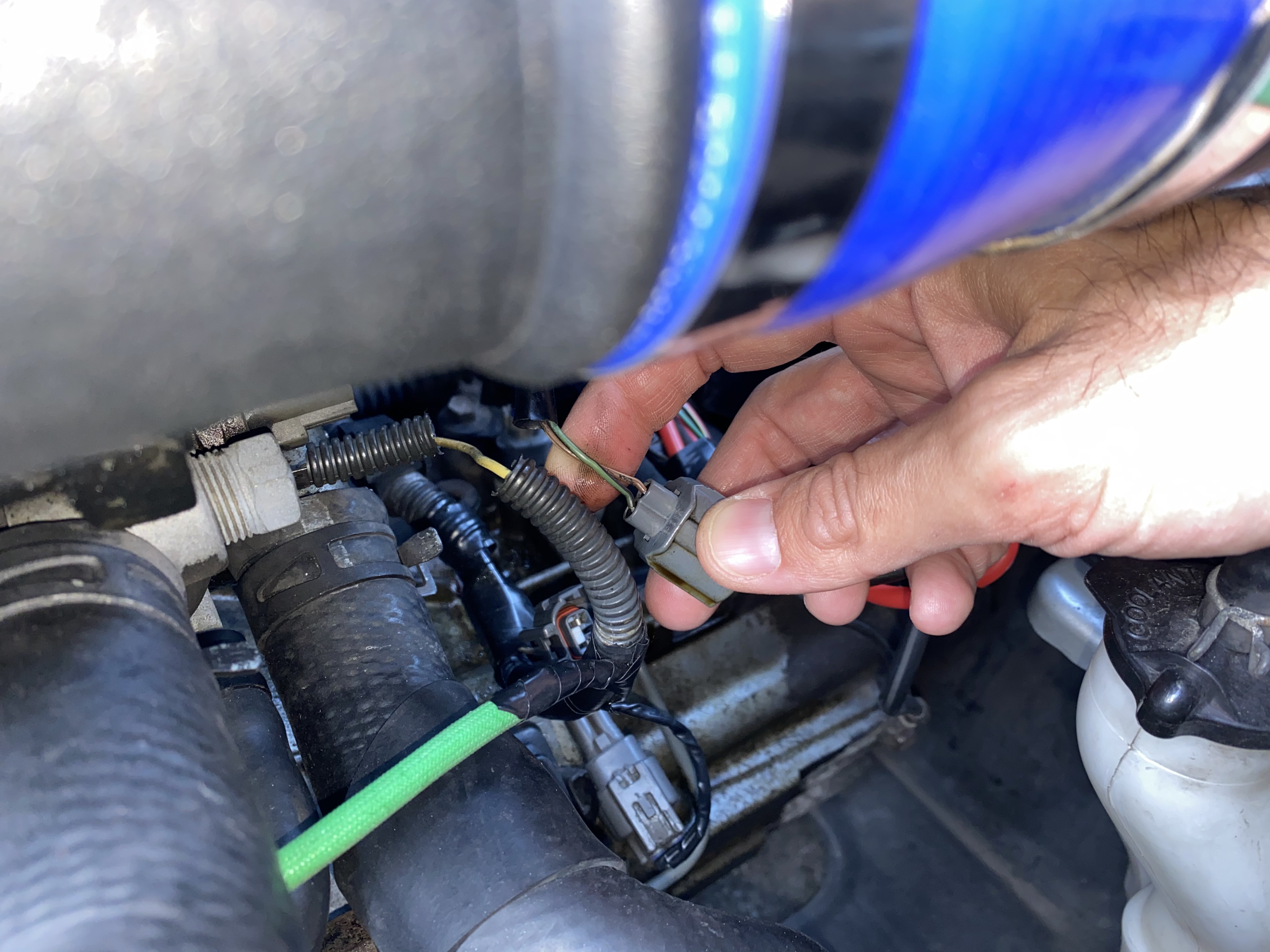

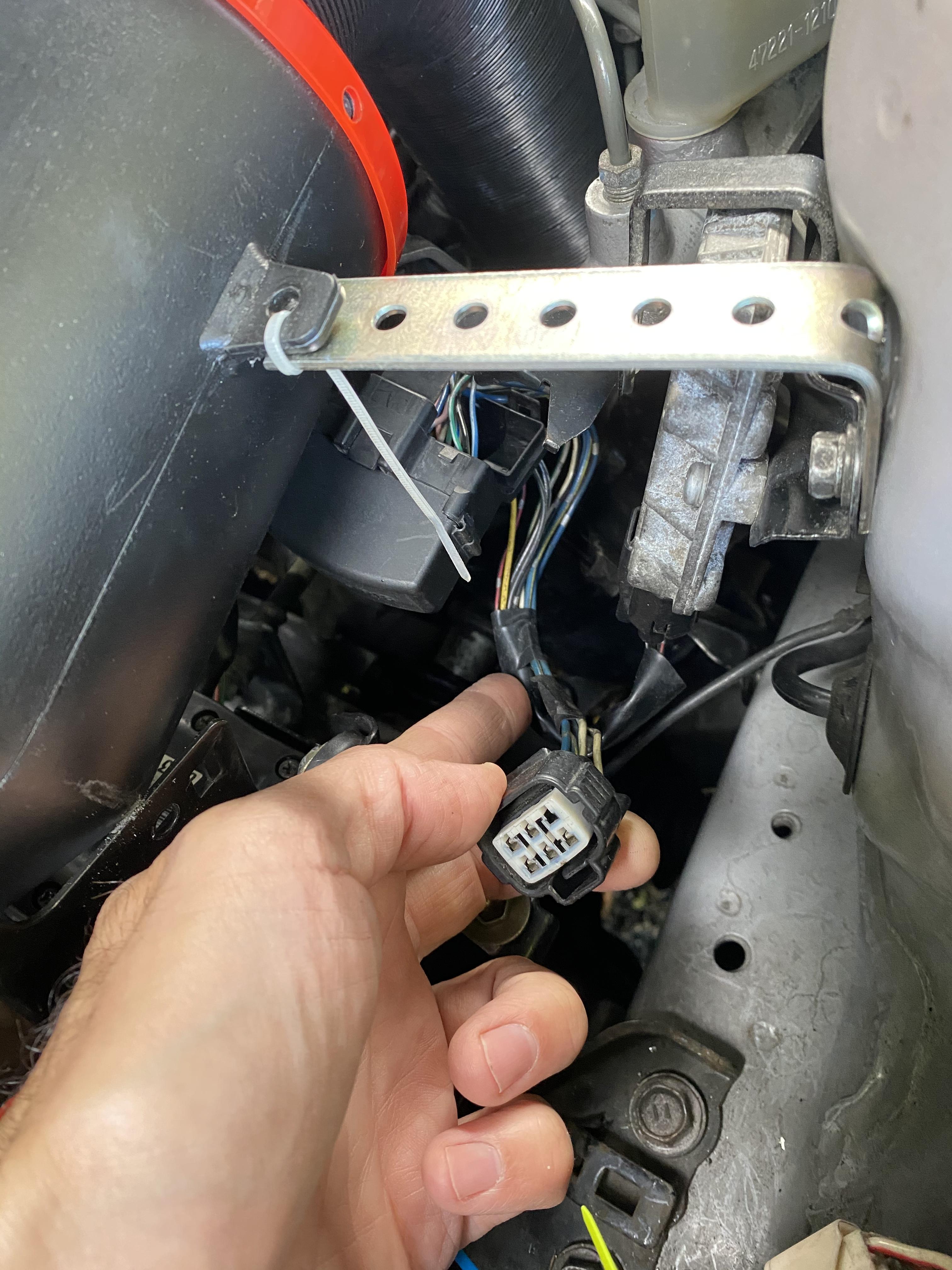

Here is the connector to be briged to avoid the ECU looking for the N and D signal from the gearbox
what is this connector for?

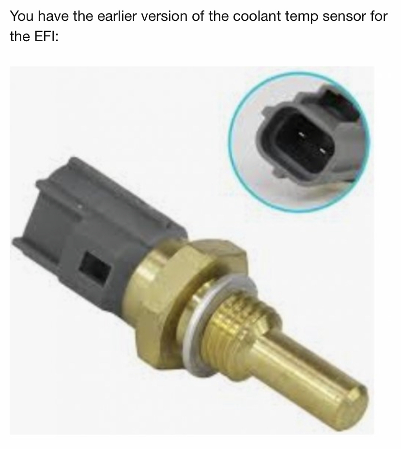

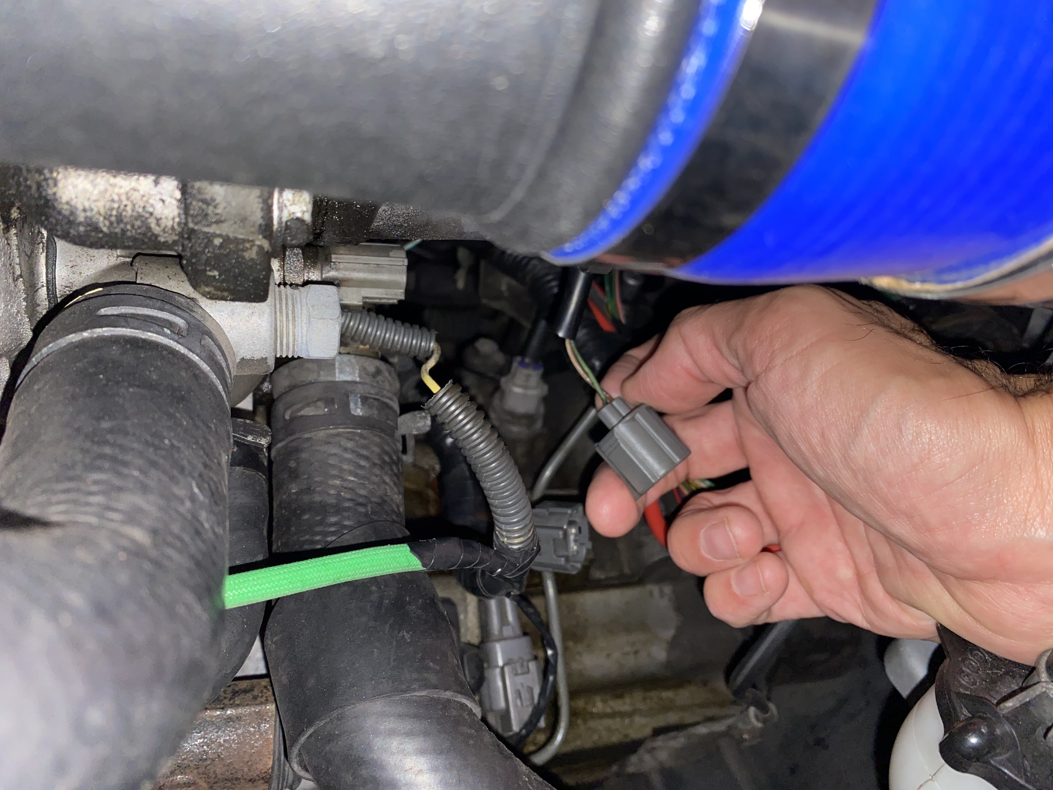

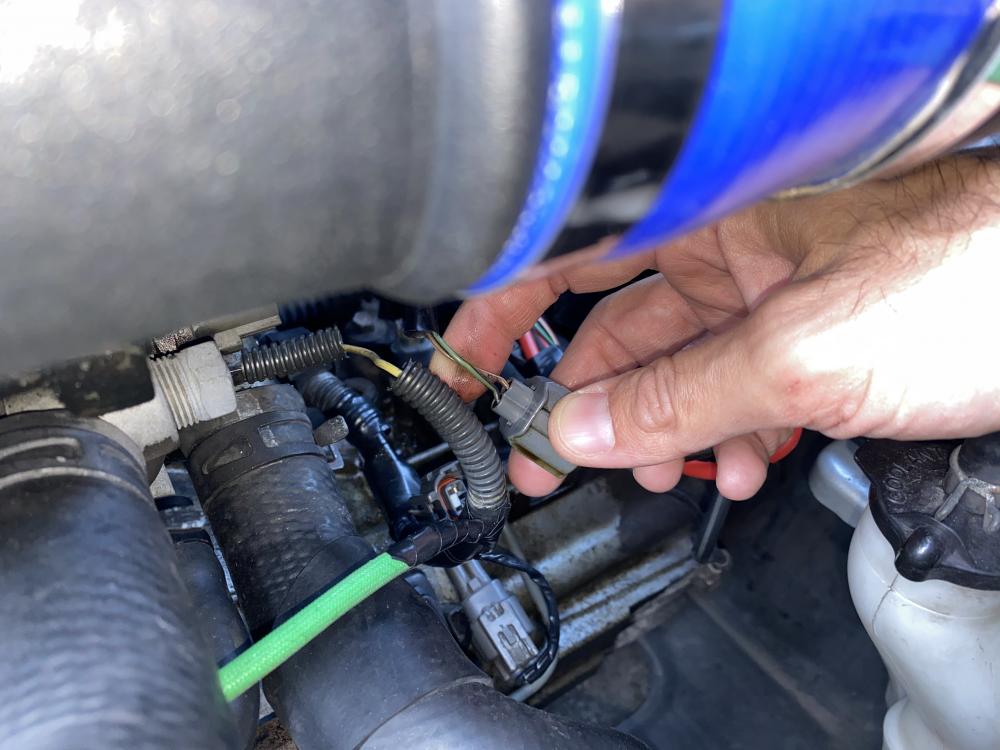

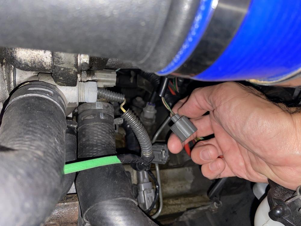

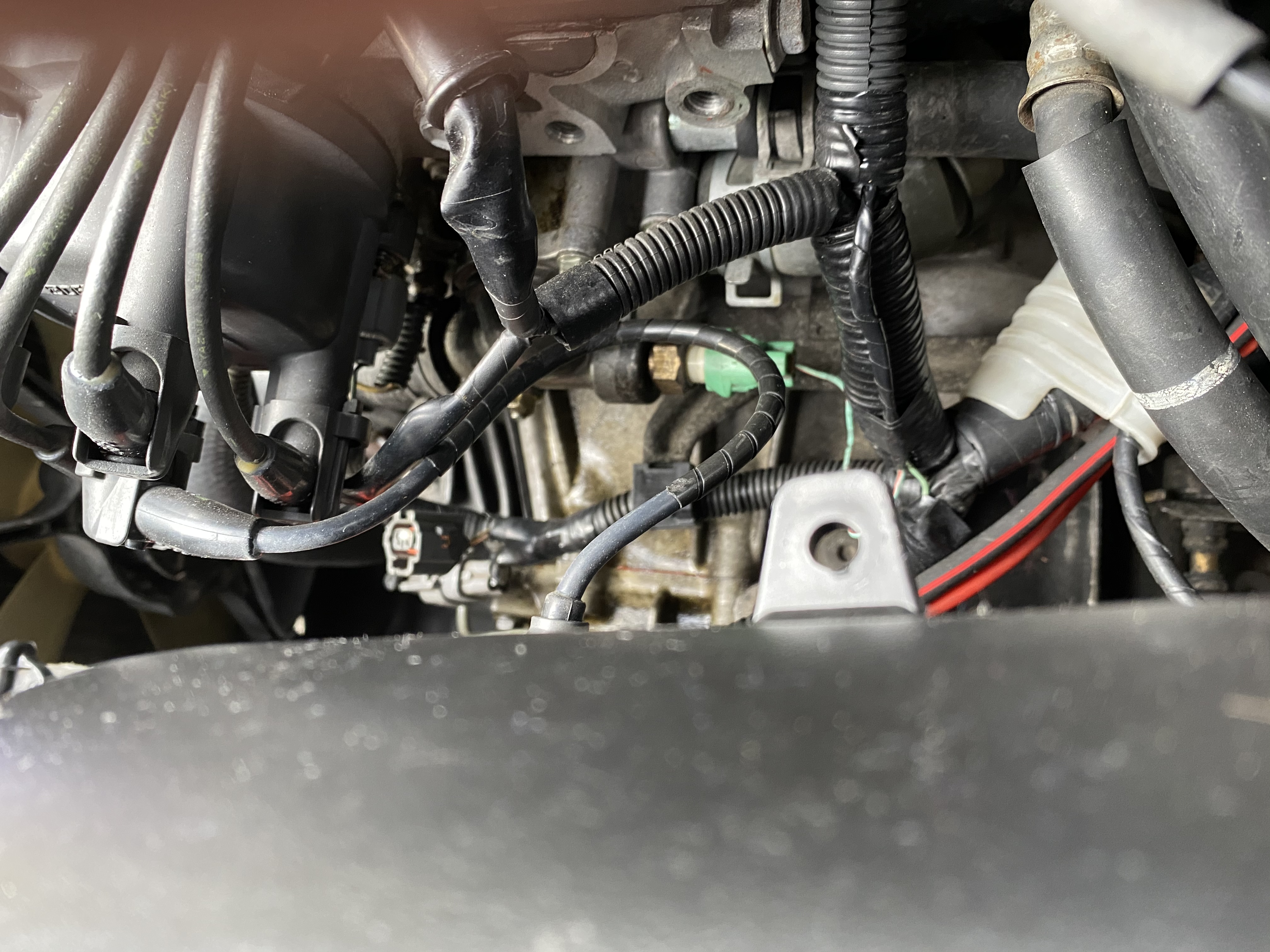

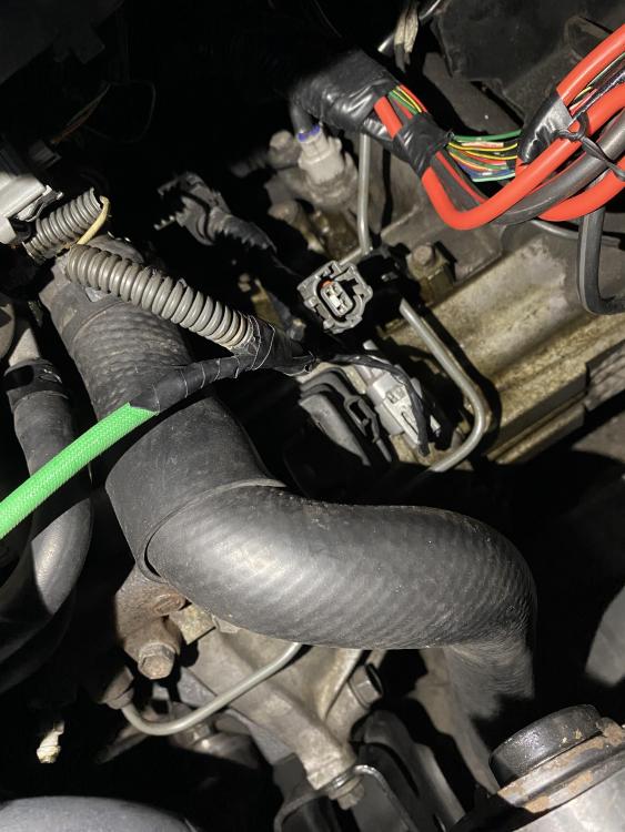

Here the temp signal sensor Diagnostics gave me error 22  I will change the sensor tomorro and check if the wire signal is interrupt  Should be the cause of false cold start
Please help me understand ehat this connector is for.

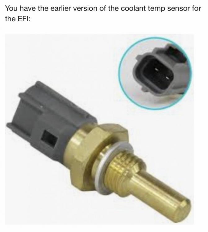

I finally solved the problems!as. As I felt, my friend who worked on the electric part got confused and took a signal from the yellow and green wire that comes from the two pin temperature sensor. He did it because he thought that he was dealing with the three pin sensor that was on the 4EFE Electric ignition new generation engine on the Corolla. He still did something wrong because Toyota is clear that certain sensors need to be connected straight without any impedance addition. He didn’t notice the sensor underneath that is dedicated to the cluster water temp. So when he took the bridge off and left the wire alone by himself to connect straight from the sensor to the ECU, everything went back to normal. This means that the engine never ran normally and it was in recovery mode. This is why the spark plugs were dry but the engine was running blue smoke. It doesn’t do it anymore even if it obviously could be the turbo or the valve gaskets. I know it also could be some sticky piston gaskets. But it runs better and I am happy about it. The engine check light disappeared and it was a great news because it means that error 22 and 42 are not there anymore. It’s a big achievement considering the amount of work during this swap. No check engine light whatsoever and the engine finally starts in the morning.

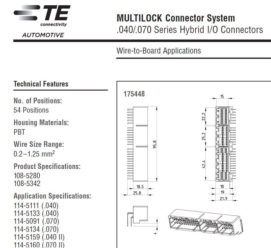

today I went to see the tuner and he told me about the ECU classic. He explained that it would be perfect because the engine has a wire  for the Excelerator. He asked me to find the original Toyota 4efte ECU female connectors in order to make the ECU swap easier. Is there any company that replicates those connectors?

The 4efte ECU female connector and the male plugs are made by a company called TE automotive / AMP.
From my research it should be a 54 pin Multilock connector. Part number: 175448
When I made a patch harness for my piggyback install on a 4efe (different plugs/socket to 4efte ECU) Royal dutchie and RobSR told me about them. I bought mine from RS components.
Unfortunately the 54 pin Glanza female ECU socket was only sold in batches of 10 and RS has discontinued them. 😡
RobSR at RaceCal Ltd. had some available last time I spoke with him. He might be able to sell you just the one socket.
