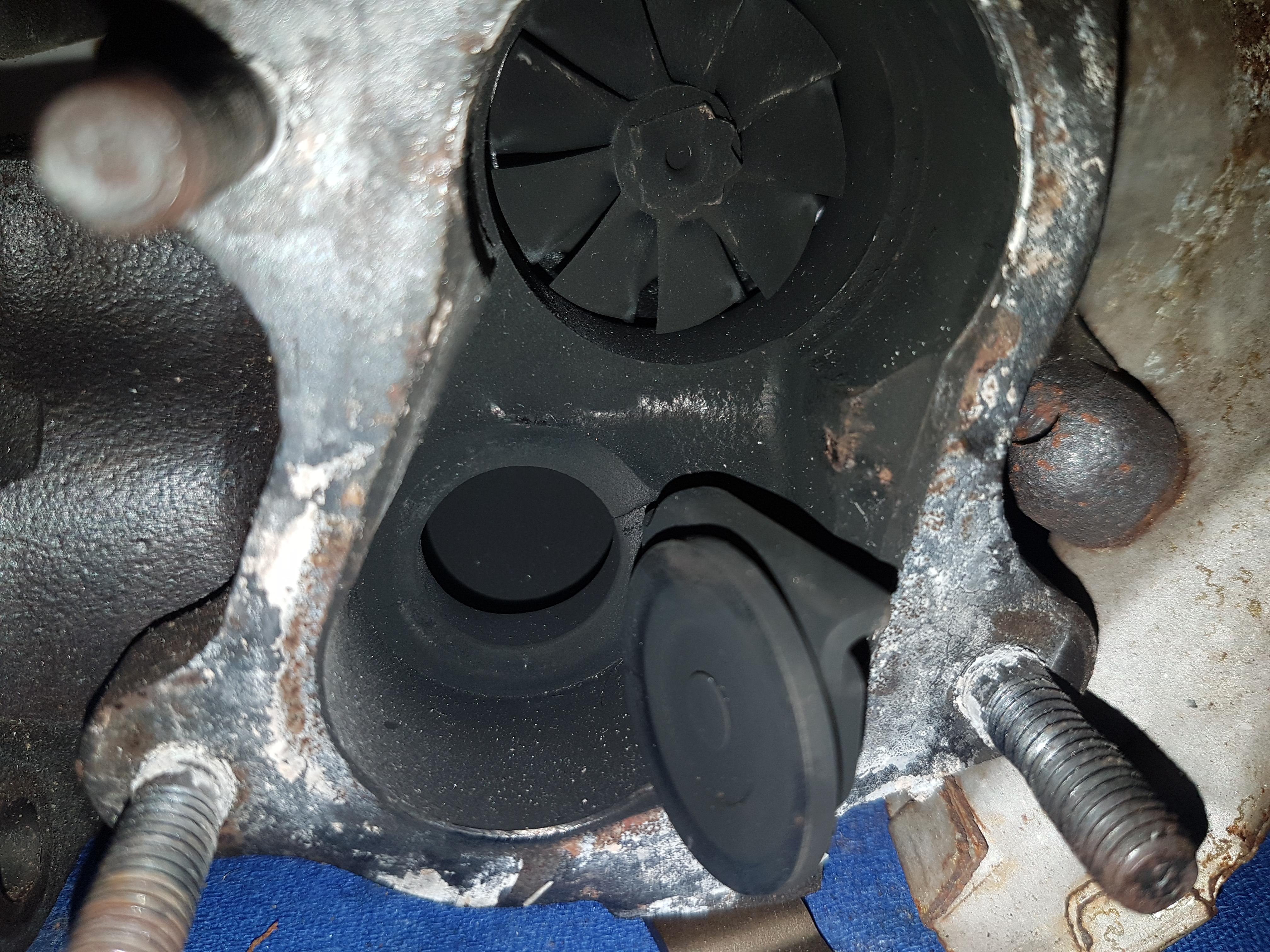

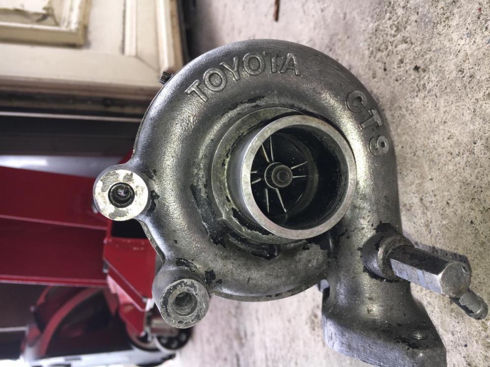

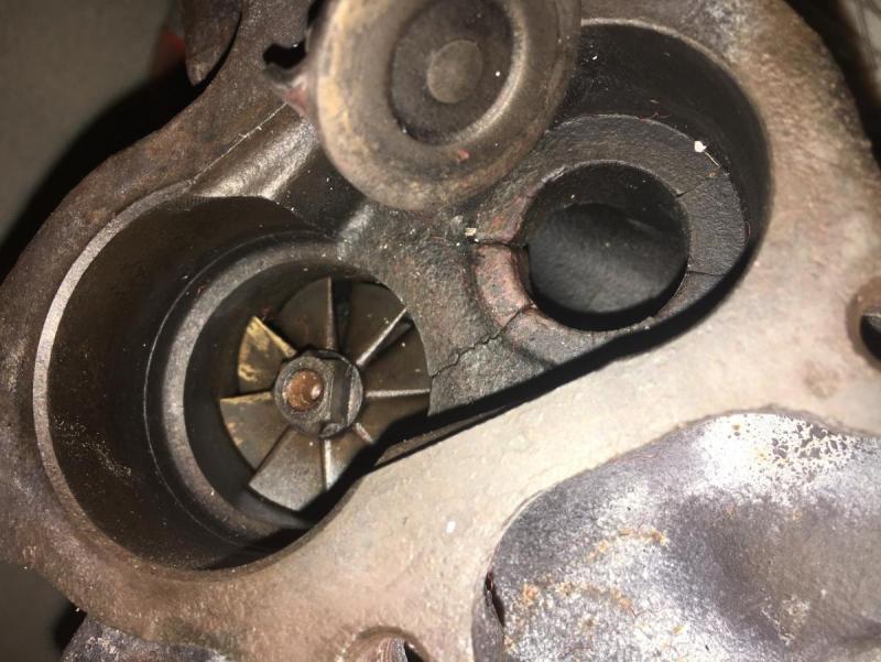

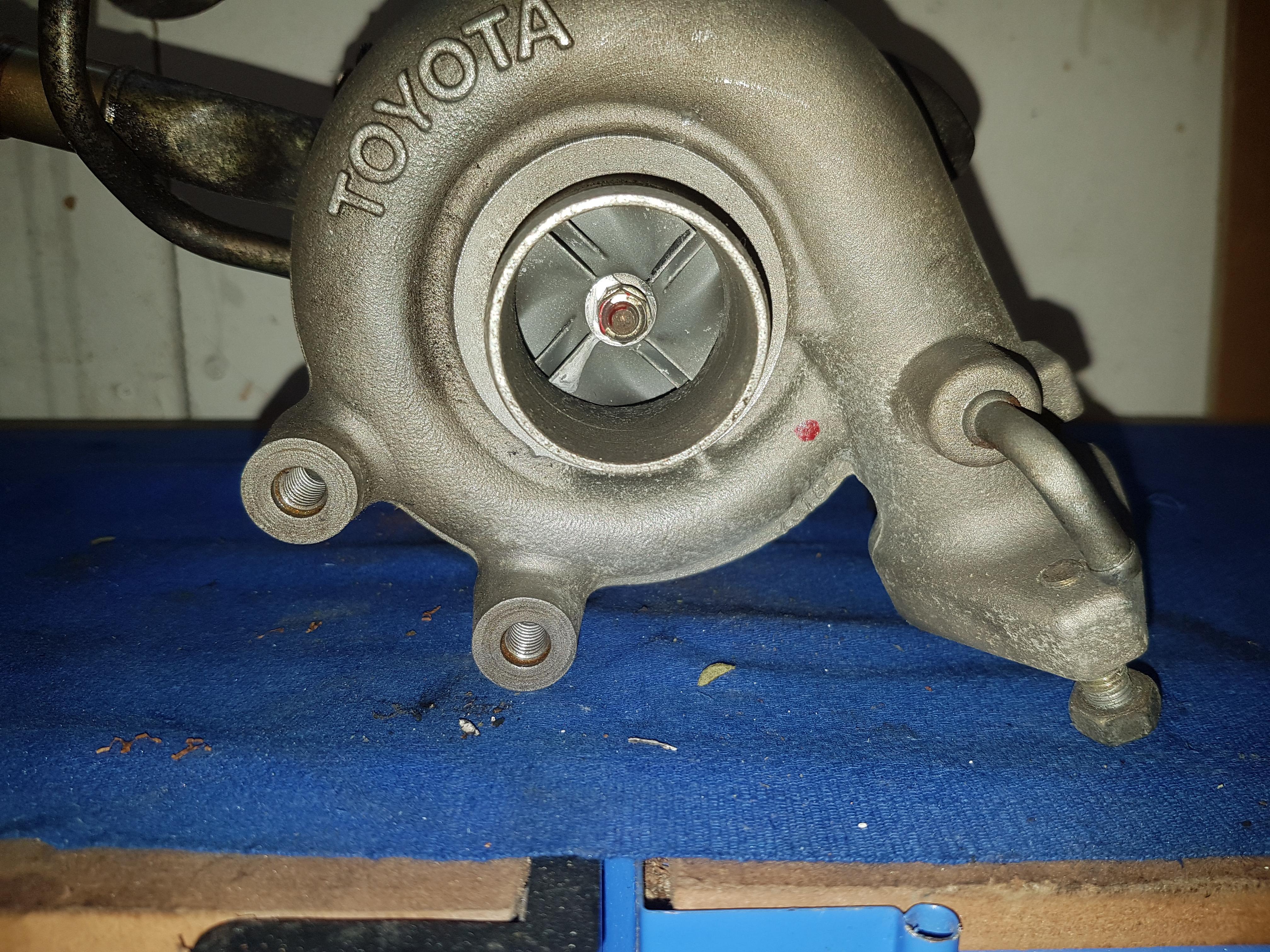

Sam44 Posted November 11, 2020 Posted November 11, 2020 (edited) as said by claymore me personally id get a 1998 glanza v 4efte complete with turbo (ct9b).@ 60k km it should be in great working order. to identify a ct9b turbo = on the alloy compressor housing it has no raised CT9 markings cast into the housing. the earlier ct9a does. ill put up a picture of the difference. also the ct9b has 9 blades in total on the exhaust turbine. the ct9b only came on the later glanza v engines. ct9b pictures below ct9a pictures below Edited November 11, 2020 by Sam44 Quote
Frankieflowers Posted November 11, 2020 Author Posted November 11, 2020 7 hours ago, Sam44 said: as said by claymore me personally id get a 1998 glanza v 4efte complete with turbo (ct9b).@ 60k km it should be in great working order. to identify a ct9b turbo = on the alloy compressor housing it has no raised CT9 markings cast into the housing. the earlier ct9a does. ill put up a picture of the difference. also the ct9b has 9 blades in total on the exhaust turbine. the ct9b only came on the later glanza v engines. ct9b pictures below ct9a pictures below Interesting. Thank you for sharing. How can I identify this detail when I buy an engine from the UK. Should I ask the seller to get the turbo apart and confirm it is the turbo I’m looking for? Quote

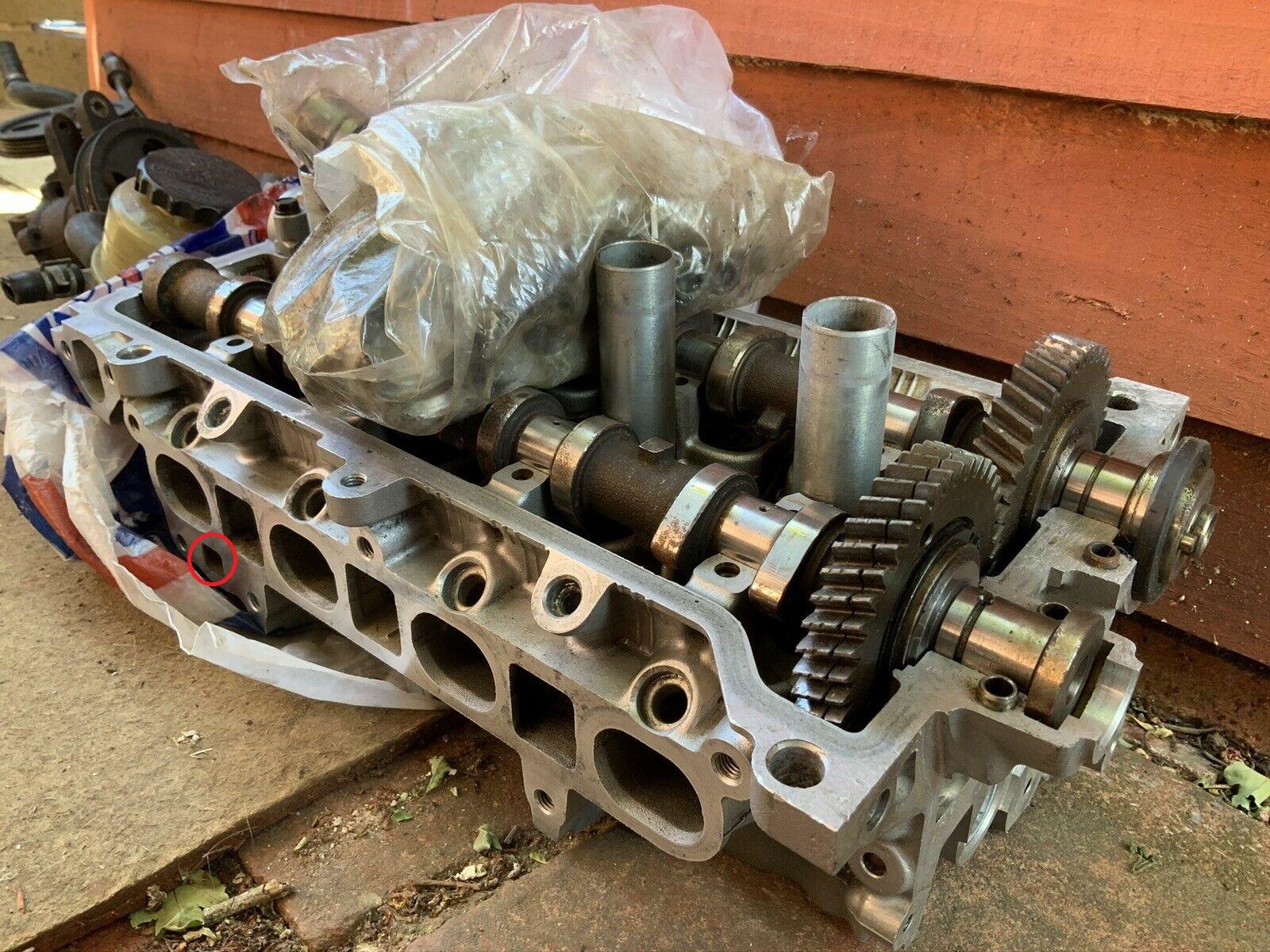

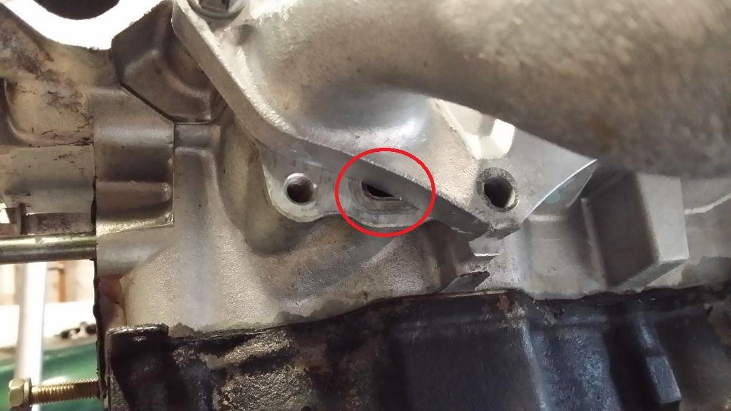

Frankieflowers Posted November 17, 2020 Author Posted November 17, 2020 On 11/10/2020 at 9:33 AM, Claymore said: I would keep the 4efe gearbox that you have in the corolla. It should hold the power you want. As far as I know the corolla manifold will fit to the 4efte head. But be careful as there are 2 different heads. One type of 4efte head has an extra water outlet that is blocked by the 4efte inlet manifold. The other type of head has no water outlet. Water outlet type: Water outlet not covered by manifold. You would have to weld some material to the inlet manifold flange to cover the hole IF you have the 4efte head with the water outlet. Apparently late ep91 4EFTE engines don’t have the water outlet on the head. Quote
