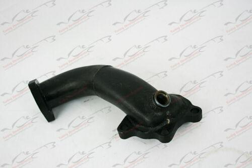

Frankieflowers Posted November 22, 2020 Author Posted November 22, 2020 10 hours ago, Sam44 said: this is the pipe that will require fabrication This is the original 4efte pipe? How will I have to fabricate the modified pipe? Isn’t there any on the market? Any drawing or measures? Quote

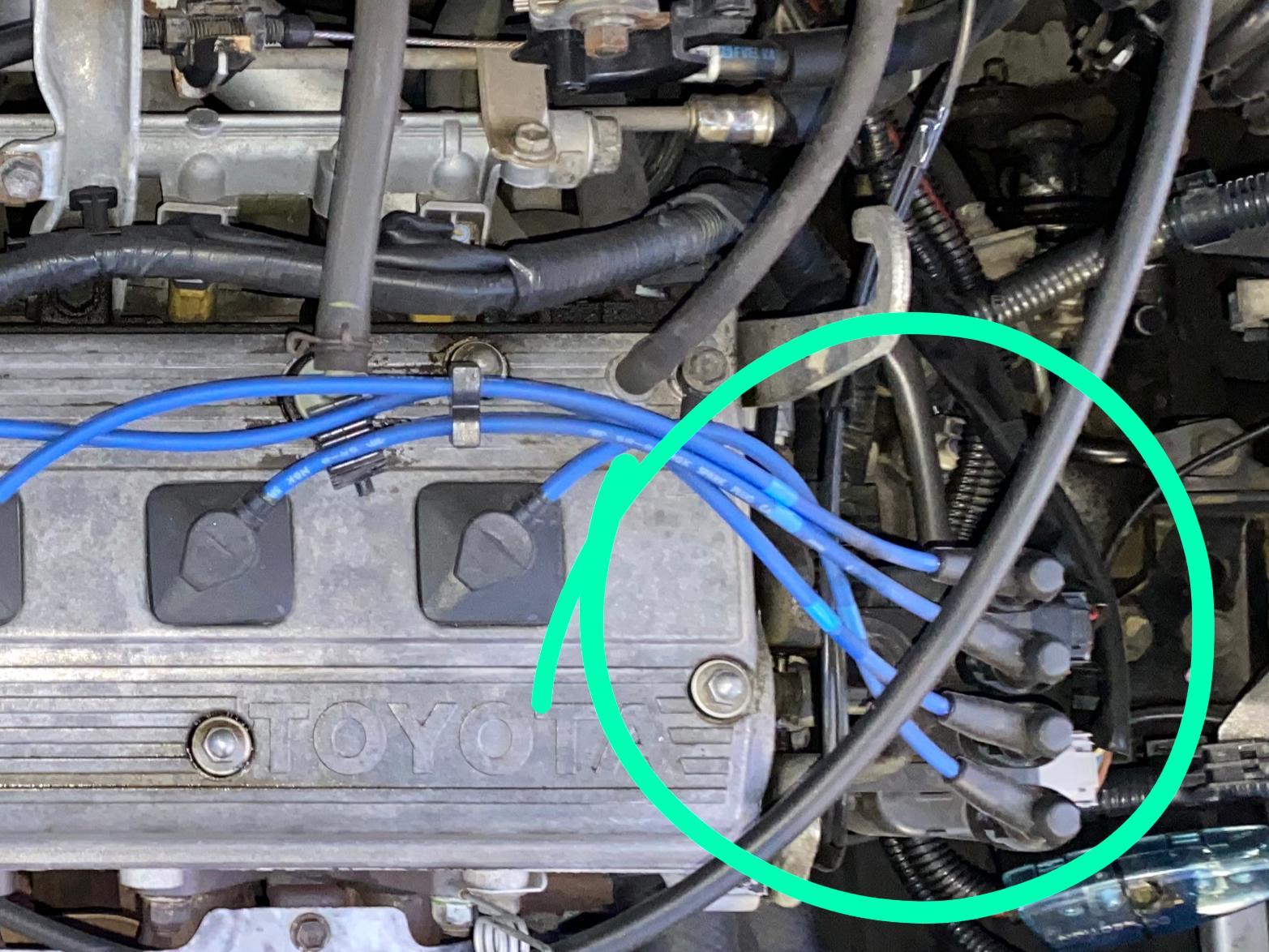

Frankieflowers Posted November 22, 2020 Author Posted November 22, 2020 (edited) 14 hours ago, Sam44 said: the 4efte distributor/head mounting point, is there a cap/cover on the 4efe e11 to blank this off and mount the dizless coils in the distributors place Should I send you another picture for the corner or this is enough? Is the cap cover the plastic boxes on the side? i found this maybe it helps Starlet Glanza V 1998 4efte http://www.japan-parts.eu/toyota/jp/1998/starlet/ep91-agmqy/4_121150_006_/tool-engine-fuel/1901_ignition-coil-spark-plug Corolla E11 1998 4efe http://www.japan-parts.eu/toyota/eu/1999/corolla-hb-lb/ee111r-agmdkw/3_153540_038_/tool-engine-fuel/1901_ignition-coil-spark-plug Edited November 23, 2020 by Frankieflowers Quote

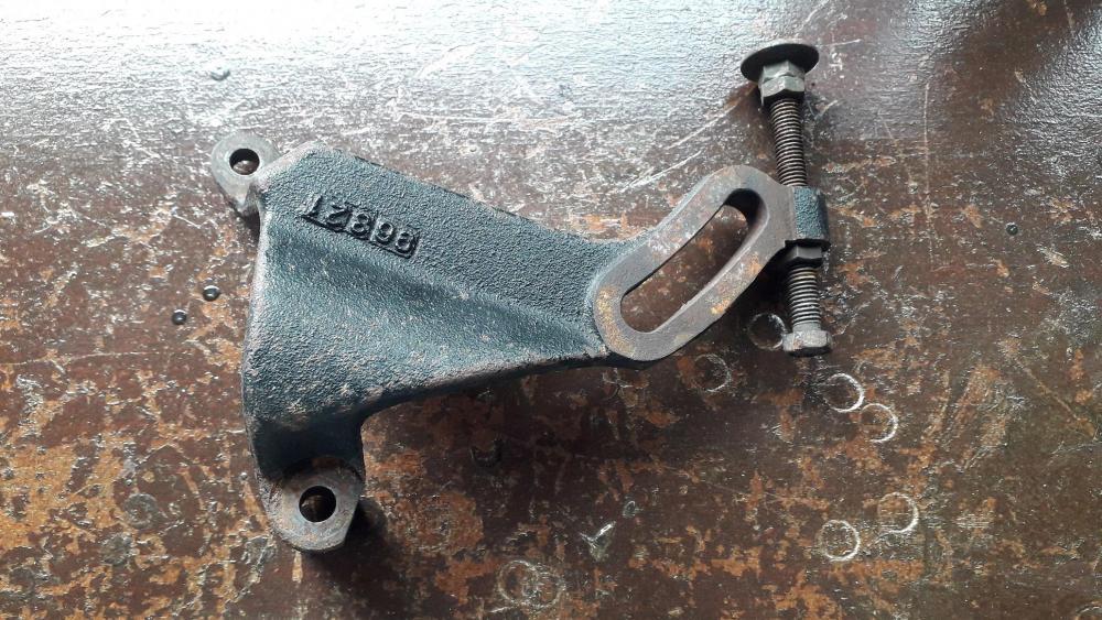

Frankieflowers Posted November 22, 2020 Author Posted November 22, 2020 Is the power steering pump bracket you mentioned part of the 4efte engine? Quote
Sam44 Posted November 23, 2020 Posted November 23, 2020 (edited) 10 hours ago, Frankieflowers said: This is the original 4efte pipe? How will I have to fabricate the modified pipe? Isn’t there any on the market? Any drawing or measures? rather that it droping straight down it will have to bend back on itself by around 45 deg then drop straight down. this pipe is only a small diameter, some of these are quite a large diameter. with this pipe being quite small you might get away with just cutting away some of the cross member lip/edge. this is not the 4efte original pipe. the original pipe is a catalytic converter which will defiantly not fit in. this is the aftermarket decat pipe. Edited November 23, 2020 by Sam44 Quote
Sam44 Posted November 23, 2020 Posted November 23, 2020 10 hours ago, Frankieflowers said: Should I send you another picture for the corner or this is enough? Is the cap cover the plastic boxes on the side? i found this maybe it helps Starlet Glanza V 1998 4efte http://www.japan-parts.eu/toyota/jp/1998/starlet/ep91-agmqy/4_121150_006_/tool-engine-fuel/1901_ignition-coil-spark-plug Corolla E11 1998 4efe http://www.japan-parts.eu/toyota/eu/1999/corolla-hb-lb/ee111r-agmdkw/3_153540_038_/tool-engine-fuel/1901_ignition-coil-spark-plug yep thanks. it does bolt in place of the distributor and seal the head. Quote

Sam44 Posted November 23, 2020 Posted November 23, 2020 9 hours ago, Frankieflowers said: Is the power steering pump bracket you mentioned part of the 4efte engine? yep it comes with the engine normally. Quote
Frankieflowers Posted November 25, 2020 Author Posted November 25, 2020 On 11/23/2020 at 8:39 AM, Sam44 said: this is not the 4efte original pipe. the original pipe is a catalytic converter which will defiantly not fit in. this is the aftermarket decat pipe. Gotcha. Thanks. What about the manifold? How should it be cut Nd welded to avoid hitting the 4efe gearbox front mount? Do you have pictures? my mechanic asked me how should he modify the steering wheel oil distributor to get an extra exit for the turbo pipe to the turbo? Is this correct? How ca dot4 oil work with the turbo? Can you please explain. Do you have pictures of that part? Thanks Quote

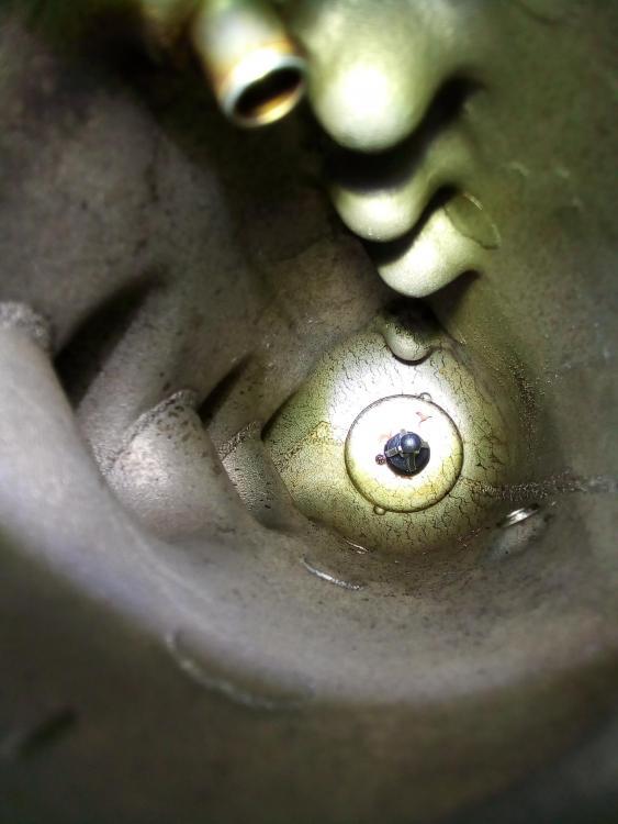

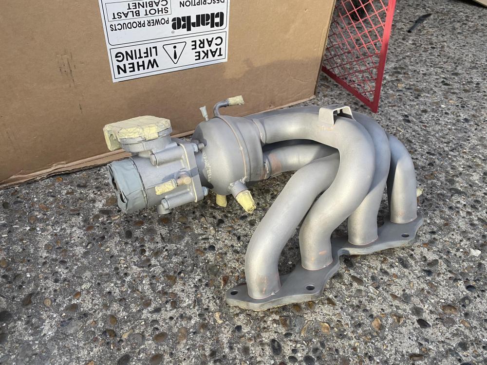

Sam44 Posted November 25, 2020 Posted November 25, 2020 (edited) Why we Port grind out (porting) the original exhaust manifold and turbo waste gate. As I have mentioned in the previous post " in order to hit 190 hp" these modifications are needed. CLAYMORE build thread recently includes an excellent write up of this process with detailed pictures of where the grinding/porting out should be done. This is to reduce exhaust back pressure and help temps and proformance. ill put up pictures of a ported out waste gate port on the ct9 turbo I have some here from a hyb turbo. This is done because very quickly after only afew 4efte engine breathing mods (introduction of a fmic and aftermarket air filter+piping) all standard 4efte ct9 engines start to experience boost creep (the point boost pressure starts to rise and the turbos waste gate can not regulate/reduce it). This in turn leads to fuel cut on the 4efte ems. Edited November 25, 2020 by Sam44 Quote
Claymore Posted November 25, 2020 Posted November 25, 2020 (edited) 1 hour ago, Sam44 said: As I have mentioned in the previous post " in order to hit 190 hp" these modifications are needed. CLAYMORE build thread recently includes an excellent write up of this process with detailed pictures of where the grinding/porting out should be done. This is to reduce exhaust back pressure and help temps and proformance. Edited November 25, 2020 by Claymore Quote
