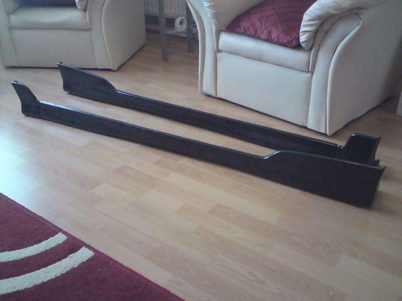

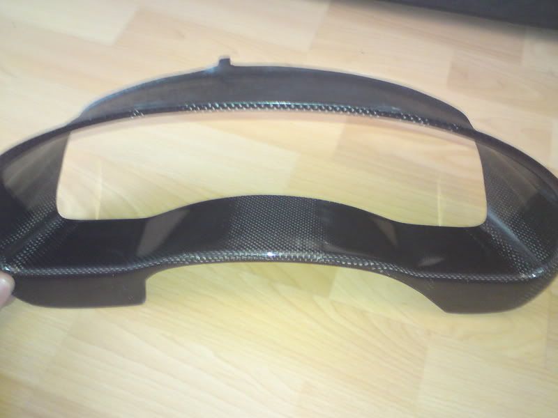

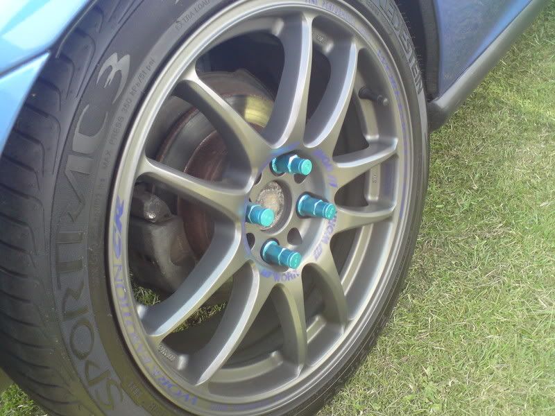

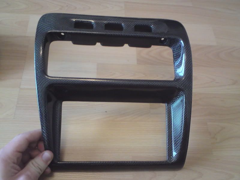

Sparky Posted August 31, 2008 Author Posted August 31, 2008 Decided not to go with the Glanza, dont want to get myself into debt, so FTE can wait Got a few parts whilst at JAEGlanza skirts (staying black)Carbon meter surroundCarbon Centre consoleAlso seen the rims I want at JAE should have them by JAE next year ;)Oh yea JAE was awsome for those who didnt go Quote
Galliano Posted August 31, 2008 Posted August 31, 2008 great selection, get it all fitted if LOWRED strips the glanza, get the rear bumper QUICK! Quote
Sparky Posted August 31, 2008 Author Posted August 31, 2008 Interior will be done soon as for the bodywork that will be done in a few months already got dibs on the back bumper Quote

Sparky Posted August 31, 2008 Author Posted August 31, 2008 Yea spoke to the owner, going to be £700ish without tyres Hopefully have them for JAE next year Quote
BenV Posted August 31, 2008 Posted August 31, 2008 dam thats alot bud but they will suit the car wellglad you had a good time at jae cant say it was any good at the chepstow show.found out that the tent the GF got wasnt water proof, but woke up to find she had buggerd of to the car! not amused Quote

Liam_D Posted September 1, 2008 Posted September 1, 2008 Good to finally meet you at JAE mate, although i didn't really introduce myself. Them Carbon bits look so god damn good i think i need some of them in my life. Also dont talk about seeing the wheels you want at JAE!! i seen some that are like my favourite wheels ever!! and now i really really want some for mine Quote
Sparky Posted September 2, 2008 Author Posted September 2, 2008 Can you explain a bit better Gall??Yea Liam could of introduced yourself a bit btter, I was like did Liam come and you were like I'm Liam Your not allowed them mate Oh and looks like I am in the middle of buying some parts which are going to be really special and play a big part in my conversion next year Quote
Liam_D Posted September 2, 2008 Posted September 2, 2008 Can you explain a bit better Gall??Yea Liam could of introduced yourself a bit btter, I was like did Liam come and you were like I'm Liam Your not allowed them mate Oh and looks like I am in the middle of buying some parts which are going to be really special and play a big part in my conversion next year Yeah mate i no. Not really a confident person so i dont introduce myself well at all. Oh well!!! They was different wheels to the ones you saw though mate, so im still allowed them Quote

RobSR Posted September 2, 2008 Posted September 2, 2008 love works wheels...are they emotions!?im shite at introducing myself aswell...i spoke to you...i just presumed you knew who i was Quote
Galliano Posted September 3, 2008 Posted September 3, 2008 here you go sparkywarky1. remove headunit, center console and whatever you need to have the center console out on your lap.2. take the ashtray unit out (2 screws up the top pull out)3. remove brackets from the both units, then fit the brackets from the ash tray to the head unit..4. on the LEFT bracket, the hole that is scratched (from previous position on the ashtray) doesnt line up, use the top hole as shown VVV.So far you should have this :5. pull the wires from the headunit down behind the dashboard line like so VVVV6. plug the wires into the back of the headunit and slide the centerconsole back into place, beware though, the centerconsole gets a bit top - heavysorted.i did this without using my blanking plate under the ashtray, but this still fits but you just need to screw it to the brackets. Quote
Sparky Posted September 3, 2008 Author Posted September 3, 2008 Cheers for that my little cherrub!! @ Rob they are indeed Emotion CRKai's Its OK mate I recognised you from Jap Show Quote
