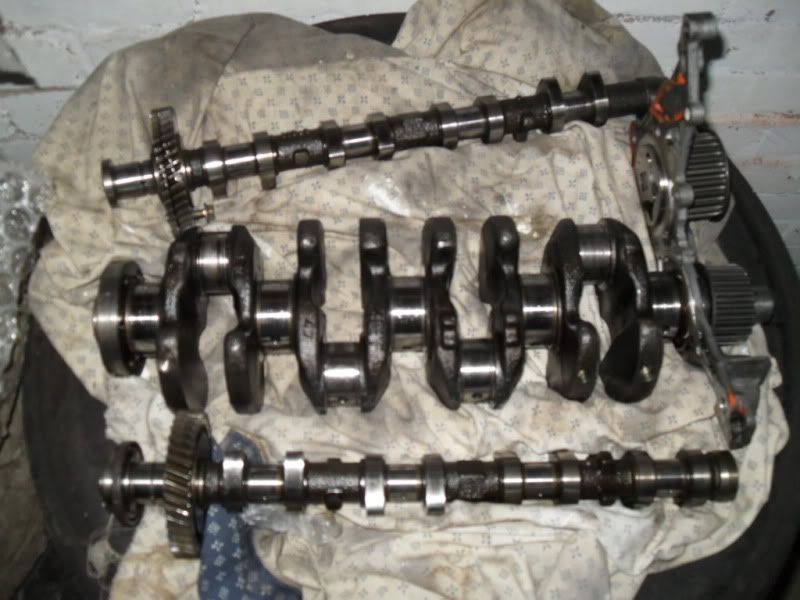

*greg* Posted November 2, 2010 Author Posted November 2, 2010 Update:After having a major failure in the engine which was caused by no oil pressure, the head , cams , crank , 1 forged rod and all bearings are now scrap! So i am starting again! Pics below:Notice the heat marks ! And yes i know the caps on the wrong way round ! Quote
whiteglanzav Posted November 2, 2010 Posted November 2, 2010 fuckin hell man thats shit i have a forged rod at home the same as that sat on my mantle piece caused by oil moving away from the pick up (oil pressure) i thought fuck it and built a forged 5e but i still got a baffled sump made which i think will hopefully prevent that from happening again maybe you should think about ithere is one my mate made !! Quote
*greg* Posted November 2, 2010 Author Posted November 2, 2010 i have thought about a baffled sump before , but it was the oil pressure regulator that had snapped off so the engine was running nothing near the required pressure hense why the cams went also. But because the wiring loom was in pieces the gauges werent wired up and the standard warning light didnt come on either.My fault in a way but shit happens. Quote

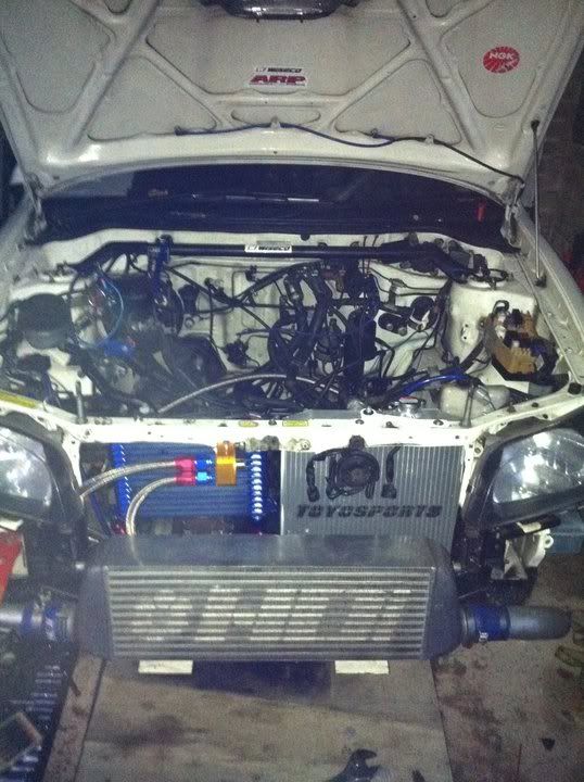

*greg* Posted February 24, 2011 Author Posted February 24, 2011 Quick update! 30 days to go to round 1 at Rockingham ,so thought better get started on the list of jobs ! Fitted so far : Whiteline anti lift kit Whiteline rear adjustable ARB 244LPH fuel pump Civic aluminium rad and slimline fan Oil filter relocation and cooler ID-Workz fibreglass varis style bonnet Quote

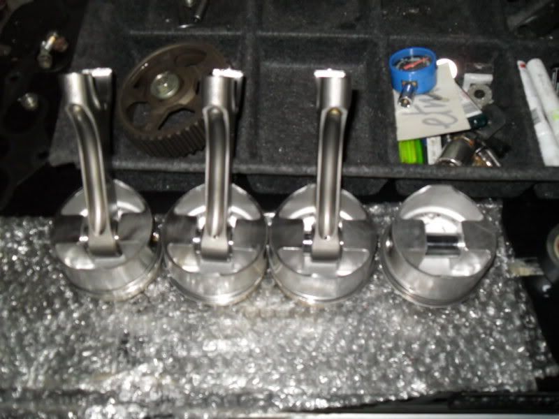

*greg* Posted February 24, 2011 Author Posted February 24, 2011 Nice to see some progress on this dude!! Yeah , been waiting on cash and parts for ages and they have all arrived except the rod from scat ! So got to build the engine along with loads of other bits an dpieces Quote

*greg* Posted February 25, 2011 Author Posted February 25, 2011 I know ! About time is deserve some good luck with this bloody car! The list on the window is old but i have a new list in the kitchen on a white board just to depress me evertime i wake up and make a brew lol. Everything is on schedule apart from the scat rod which is floating around in postal system! Quote
