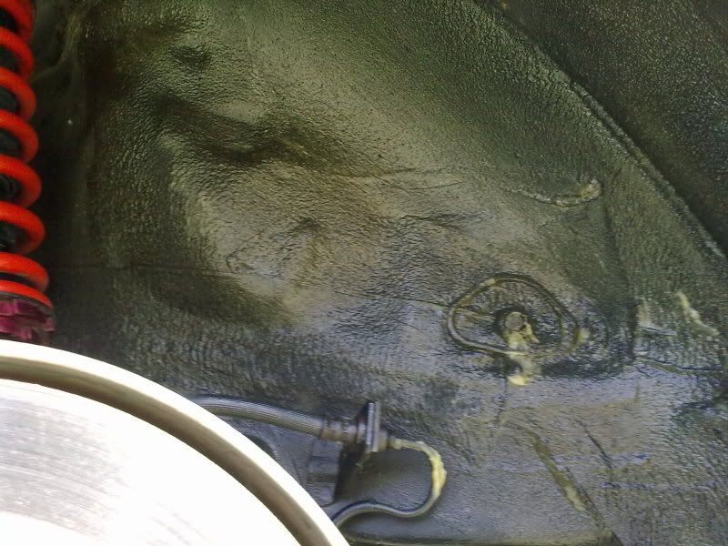

Scott-EP Posted April 10, 2010 Author Posted April 10, 2010 Another little boring update nothing major as saving for my respray which is the next big thing Just started waxoyling my car, Done all the front behind the Front Bumper and behind the back lights, Behind rear bumper, inside the boot, Engine bay, Battery shelf, Still got loads to do all the underneath, Suspension, Arches, Sills ect.. Took me 2 & a 1/2 hours to do what i've done so far given it 3 coats, Lumpy custardJust applying itDry after 3 coatsBehind the lightsI'll keep the boring update picture's coming when i do abit more Quote

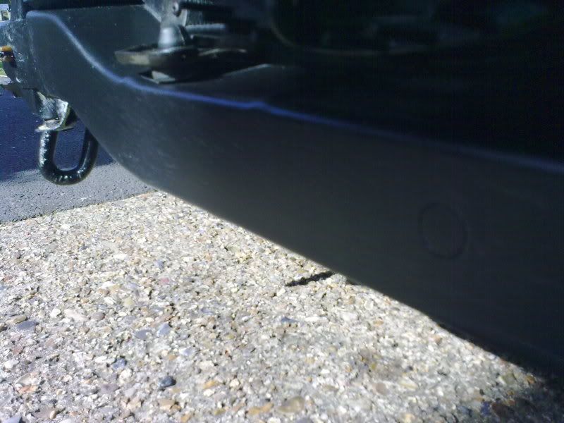

Scott-EP Posted April 17, 2010 Author Posted April 17, 2010 Little bit more Waxoyl treatment done all the arch's, Tank, Brake/Fuel pipes, Rear axle and all suspension components so just got the underneave like floor to do now... how boring lol Quote

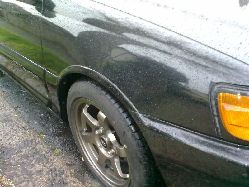

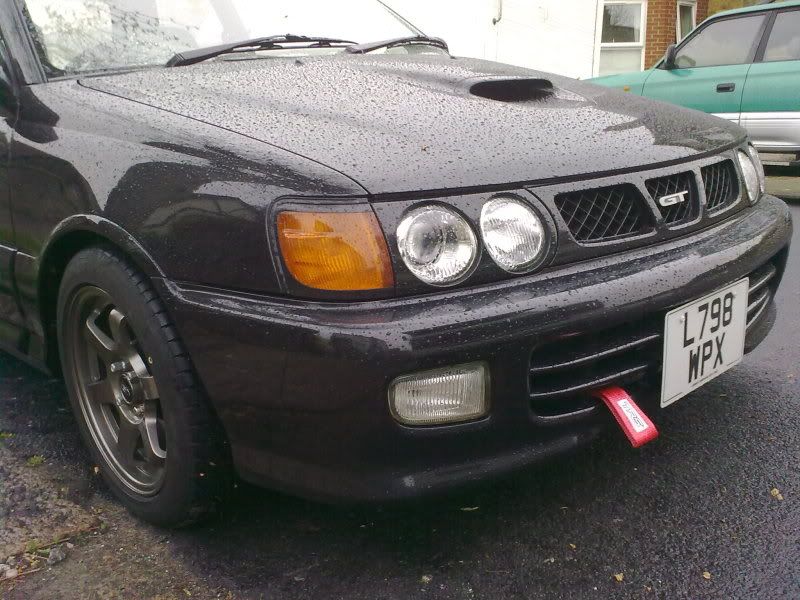

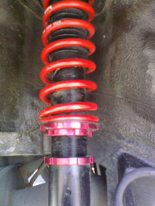

Scott-EP Posted April 29, 2010 Author Posted April 29, 2010 Got car back today from getting one of the Arches that i caught with the jetwash and the passenger side door panel resprayed for this show I'm off to on Monday, Hopefully should get whole car done in about 1month now as keep changing my mind whether i actually want to or not! Need to put GT TURBO Sticker back on though, What is best to use ?? Really thin double sided tape ?So the car looks reasonable now still quite a few marks though but they don't stick out like those marks did and it only cost me £60 to get done so thought it was worth it!Also Purchased a Towing Strap the other day! Not sure if I'm actually going to put it on or not ?? Quote
Sparky Posted April 29, 2010 Posted April 29, 2010 Looks like a tongue poking out I think I want one instead of a tow eye.Looking good bud Quote

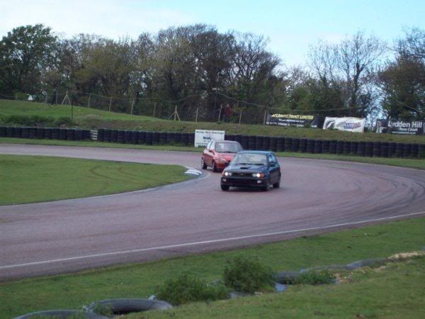

Scott-EP Posted May 3, 2010 Author Posted May 3, 2010 My first track session! Was really slippery so was going really easy but even so was great fun! ;)Not best quality picture's Quote
Sparky Posted May 3, 2010 Posted May 3, 2010 Over taken by a RS? ;)Good effort mate, nothing like caining it around a track ;) Quote
Scott-EP Posted May 3, 2010 Author Posted May 3, 2010 Haha i kept up with him going down the hill though but was going easy round corners, Was proper sketchy lol Quote

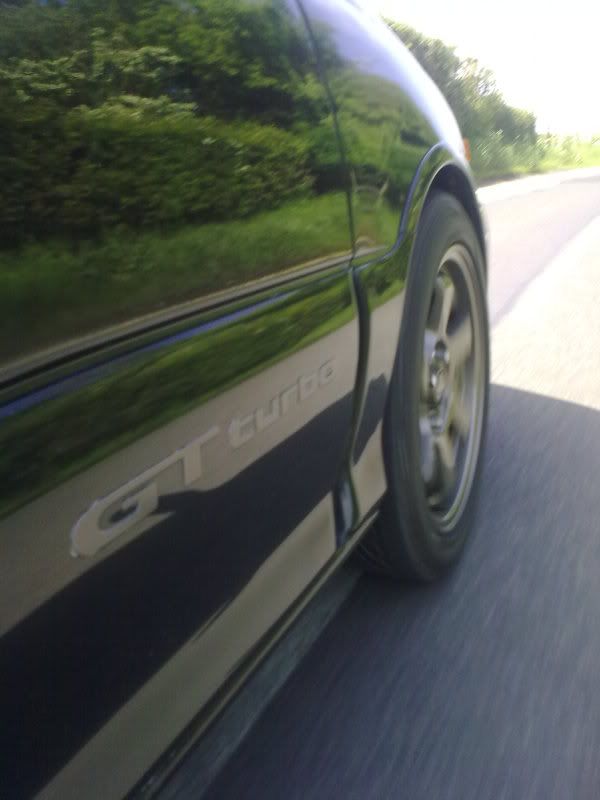

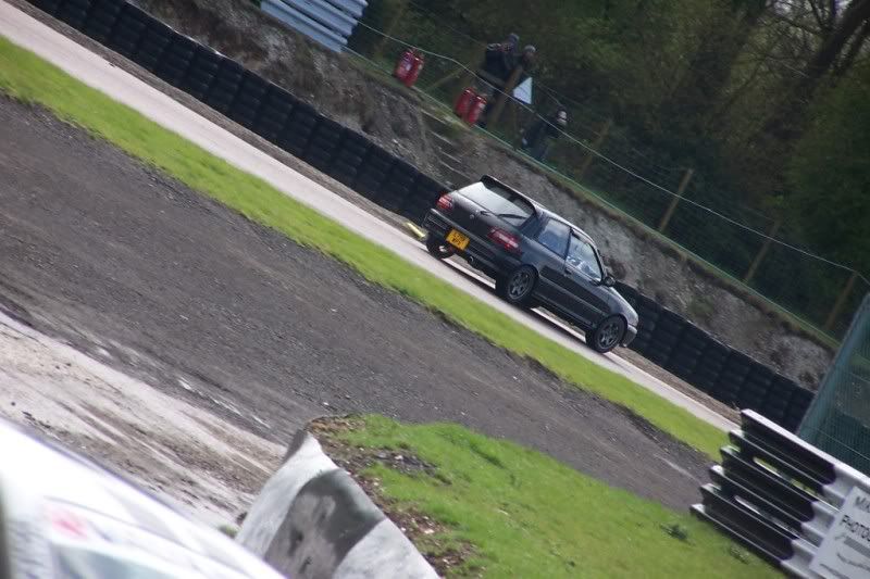

Scott-EP Posted May 20, 2010 Author Posted May 20, 2010 Just a couple of side motion picture's taken on my Phone Thought they come out pretty good actually so thought i would share Quote

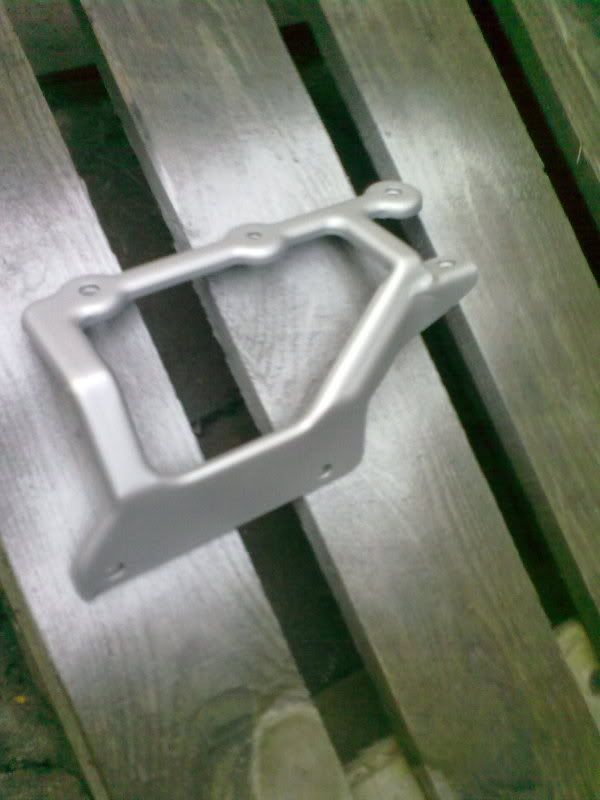

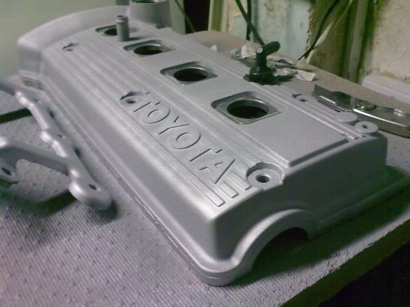

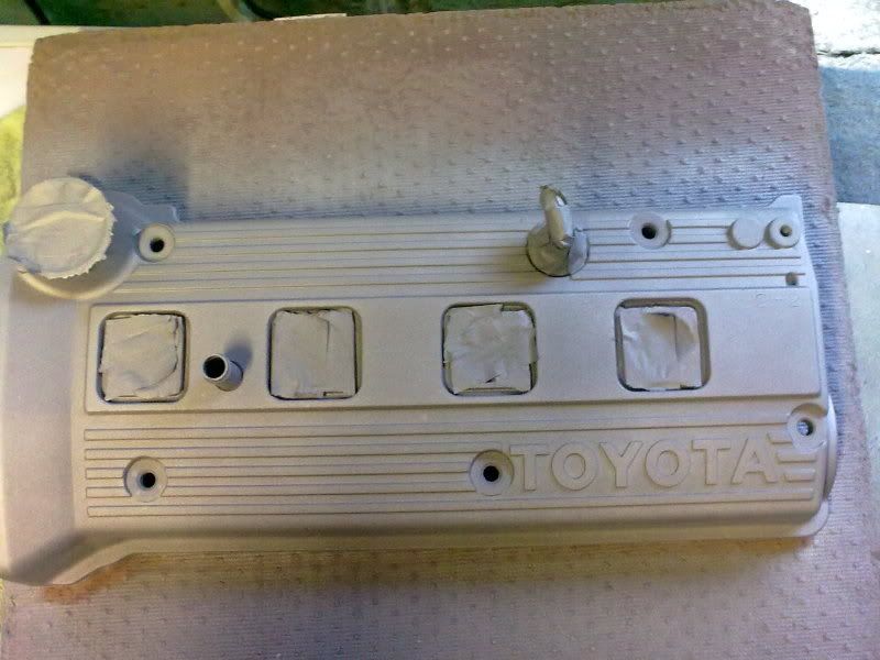

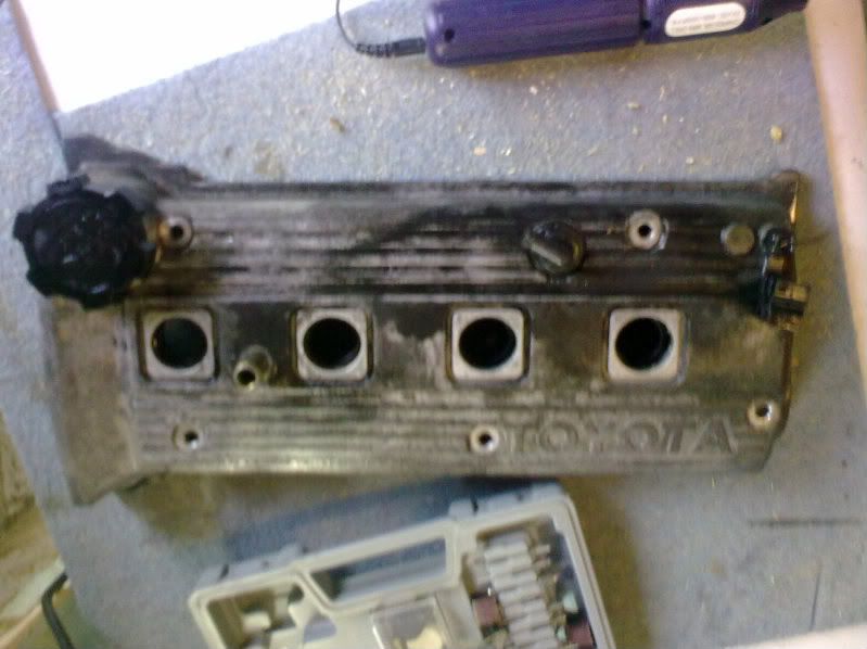

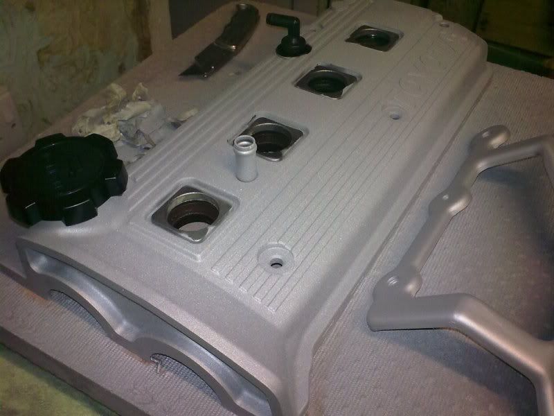

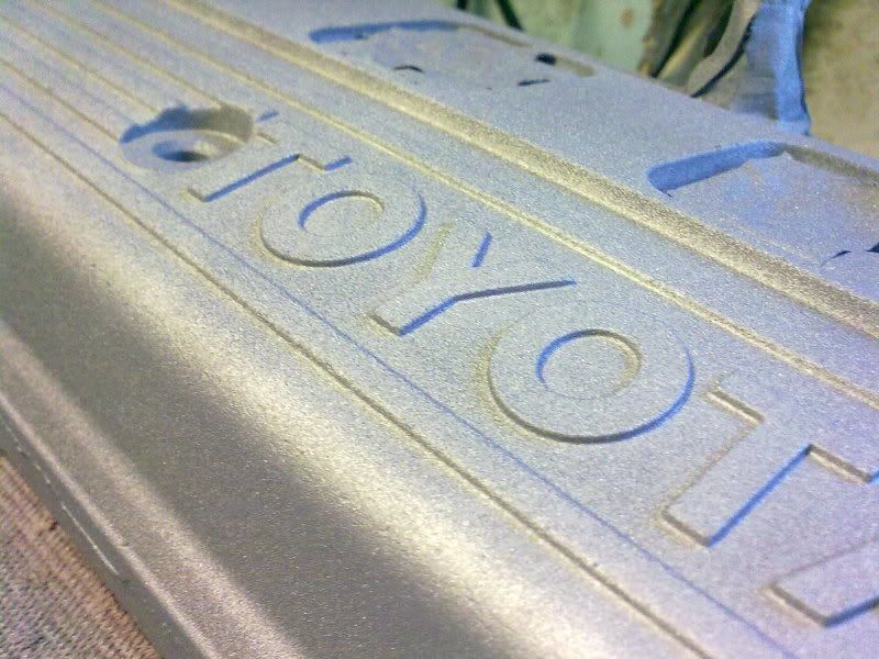

Scott-EP Posted June 9, 2010 Author Posted June 9, 2010 Time for an UpdateRight kicked my ass into gear and finally got my CV Joint Replaced, Had to use a Hydraulic press in the end it's amazing that Splines can hold of 10tonne of Pressure as it took 10tonne to release it from the hub, Replaced the Gear Oil aswel as i took drive shaft out most pissed out anyway, So now that's done it drives 10 times better, not having all the knockingAlso just taken my Cam Cover of to spray it, No exciting colour just Aluminium Silver as trieing to get the car to look more Standard and Ultra Clean, Also going to do the Fuel Rail and Inlet manifold at some point but that's when ive got more time...What it was like, Really Yucky How it looks nowGoing to take it down work tomorrow and get my mate to do the lines and Toyota in Black for me as he's better with stuff like that...Also Spraying the Intercooler mountAlso my Boss has a Toyota Previa (Import) Was talking to him about Japanese car's having Flares in them and he said he's got one and he gave it to me Obviously it says Toyota on it aswel coming out of a Previa so another little JDM Goody and didn't cost me anything Quote
Scott-EP Posted June 9, 2010 Author Posted June 9, 2010 Few more pictures with all the Masking Tape removed, Well Happy with how it's come out, Make me want to take the engine out and do the Block, Head and Gearbox Quote

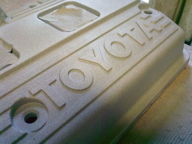

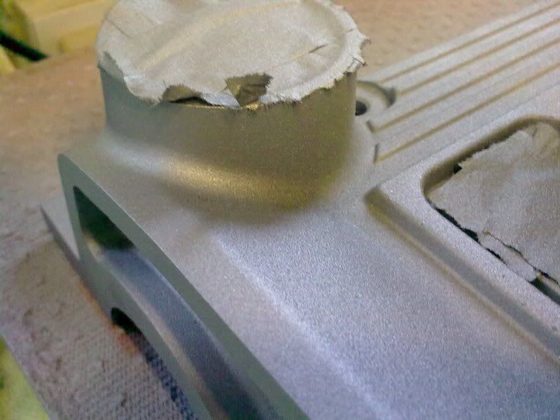

BAZ2CRAZY Posted June 10, 2010 Posted June 10, 2010 I want a flare lucky man.That rocker cover looks neat too. by the way, the reason it was going powdery is because its aluminiumoxide. Its a protective coating thats caused by the oxygen in the air reacting with the aluminium. Dont worry.. its not bad... it just looks wank. Notice your gearbox and block will be doing the same thing.Mitch Quote
Scott-EP Posted June 10, 2010 Author Posted June 10, 2010 Right had abit of trouble with the Original Paint Coat, As the Cam Cover is Alluminium it was reacting with the VHT and making it turn to powder so it was just falling of, So rubbed the whole thing down again....Found some Hammerite special metal primer down work that my boss used to do his roll cage with, Put a coat of it on the Cam Cover have just gone out and keyed it up and put first coat of VHT on it again and will have to wait and see what happens, Unfortunately its not High Temperature primer don't think they make it ?? But i know hammerite is tough as nails and people have painted there blocks and Heads with it so should be ok considering Cam cover doesn't get to hot...The Paint that should Prevent further problems First coat after the PrimerYou can tell it hasn't gone all grainy as it did without the Primer.. But it hasn't got quite as good of a finish as it did without the primer Quote
Amjad Posted June 10, 2010 Posted June 10, 2010 Don't worry about high temp paint buddy, I used normal paint on mine, just do a good 2-3 layers each or primer and main coat then lacquer if you want Quote
Scott-EP Posted June 10, 2010 Author Posted June 10, 2010 How it is at the moment is the best its going to get so decided to put it on the car and see how it goes, Already run it up hot twice and seems to be ok, Still get silver dust on your finger when you wipe it though, May be ok once gone through a few cycles of heating up and cooling down will keep an eye on itBut if it keeps doing that im going to just polish it instead Didn't do the Lines and Toyota in black in the end as got fed up with the paint messing around so just put it on SilverDoesn't look to bad i supposeOldNew Quote
