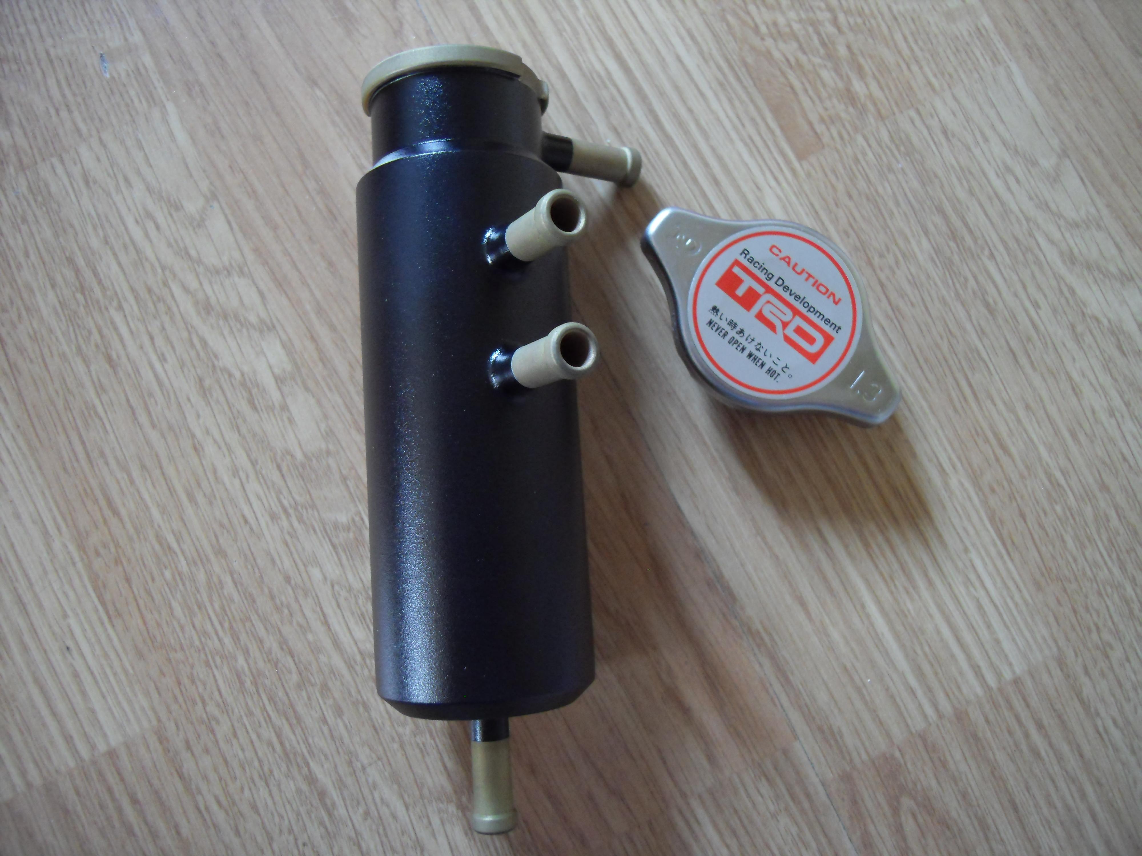

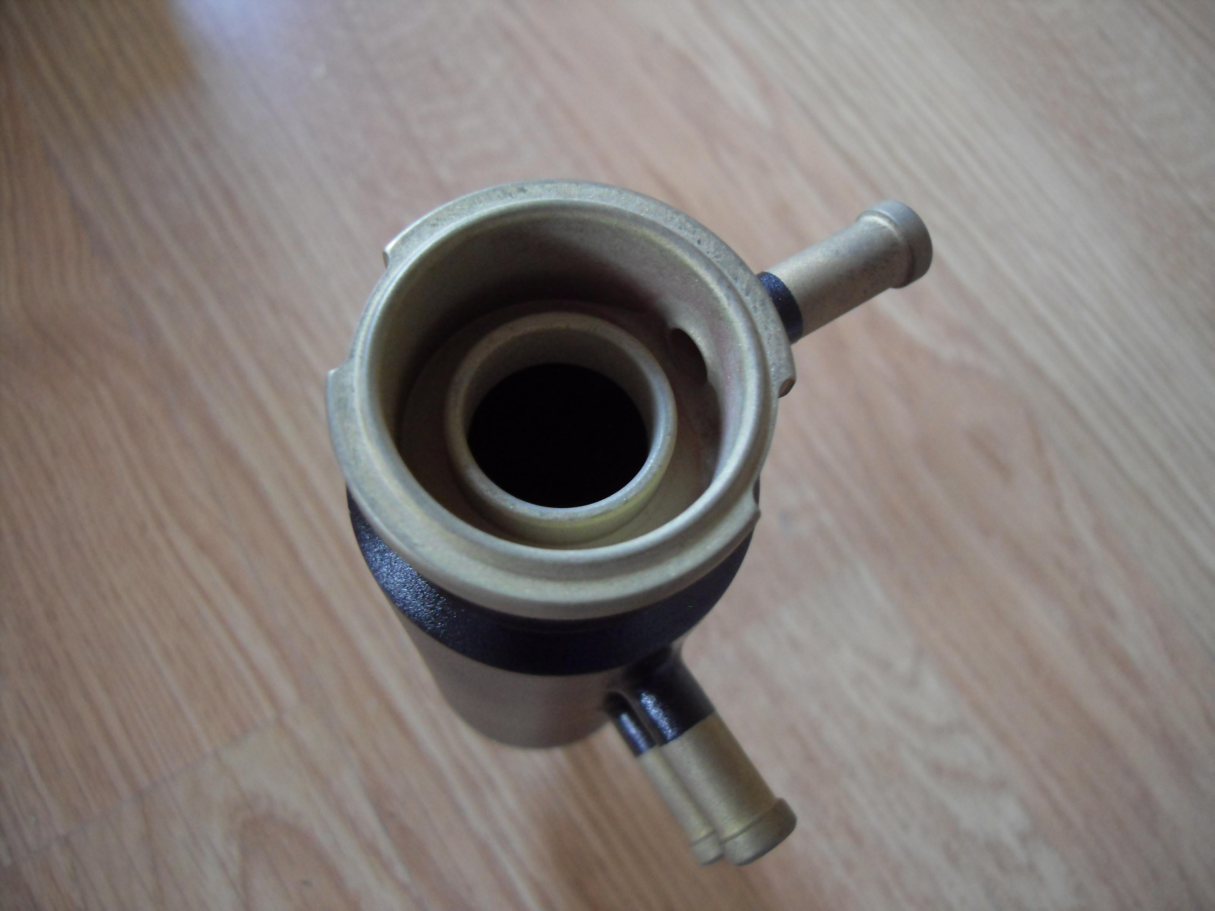

I've made half the Coolant Swirl/Constant Bleed system. This is the custom DIY Constant Bleed Pot. It's made from brass silver soldered together and has a machined neck to suit a TRD Rad Cap.
SDC12147.thumb.JPG.4491da0760f174f4e43e7fb08eef2dae.JPGSDC12146.thumb.JPG.c03ca19b3ed9a7eb8fd110017b8c1564.JPG

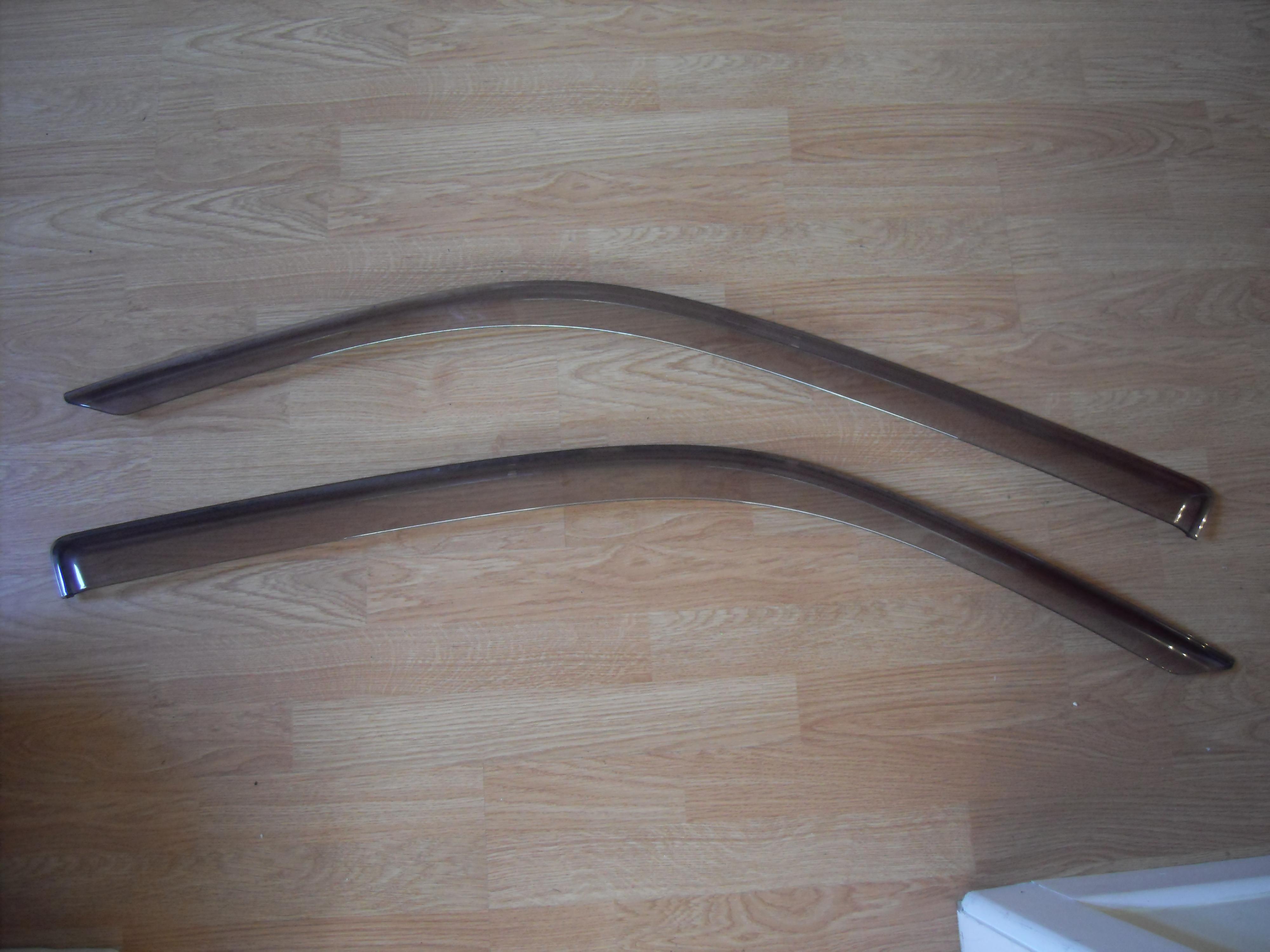

I've finally managed to get a pair of Genuine Glanza Wind Deflectors and clips.

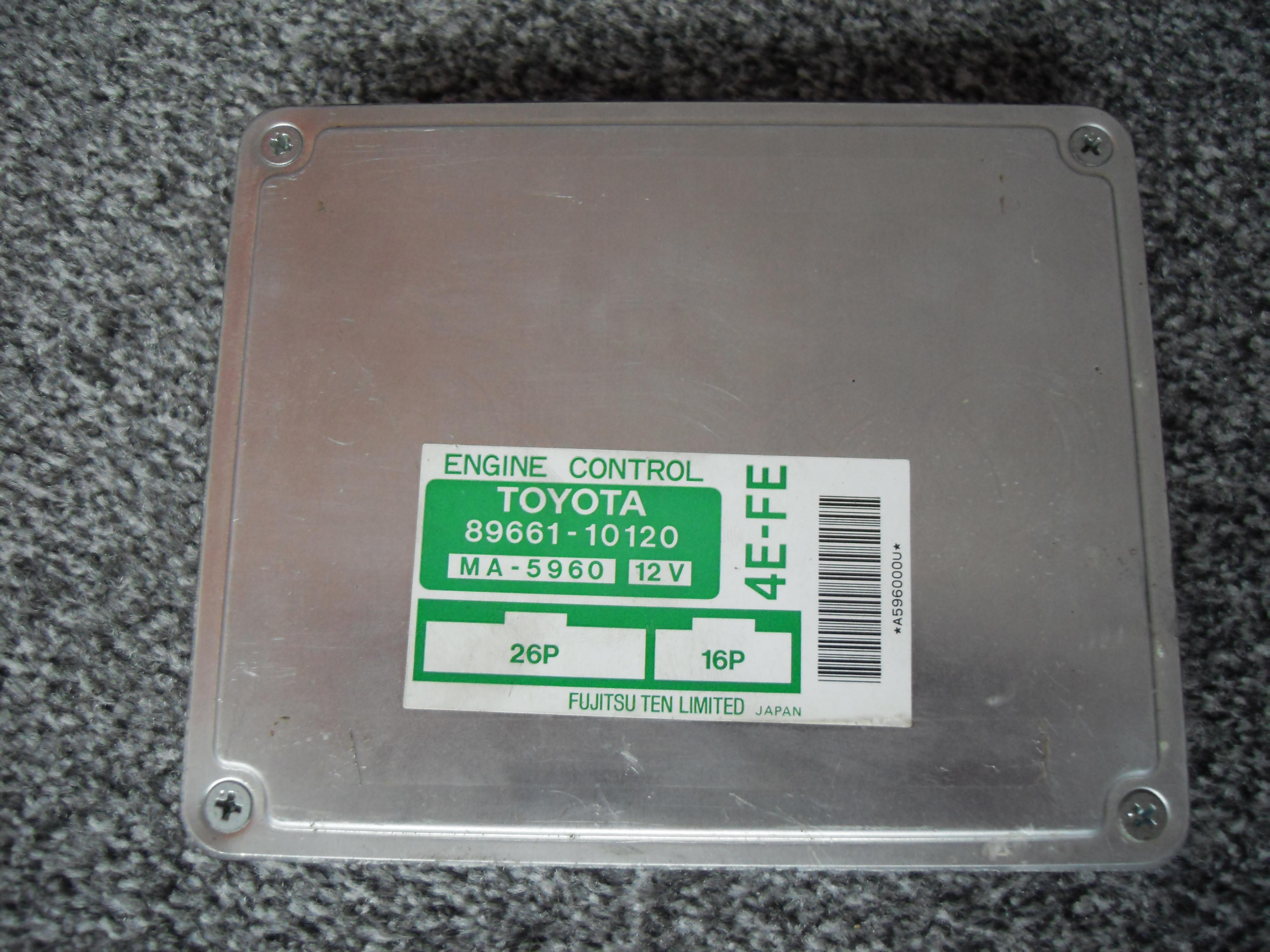

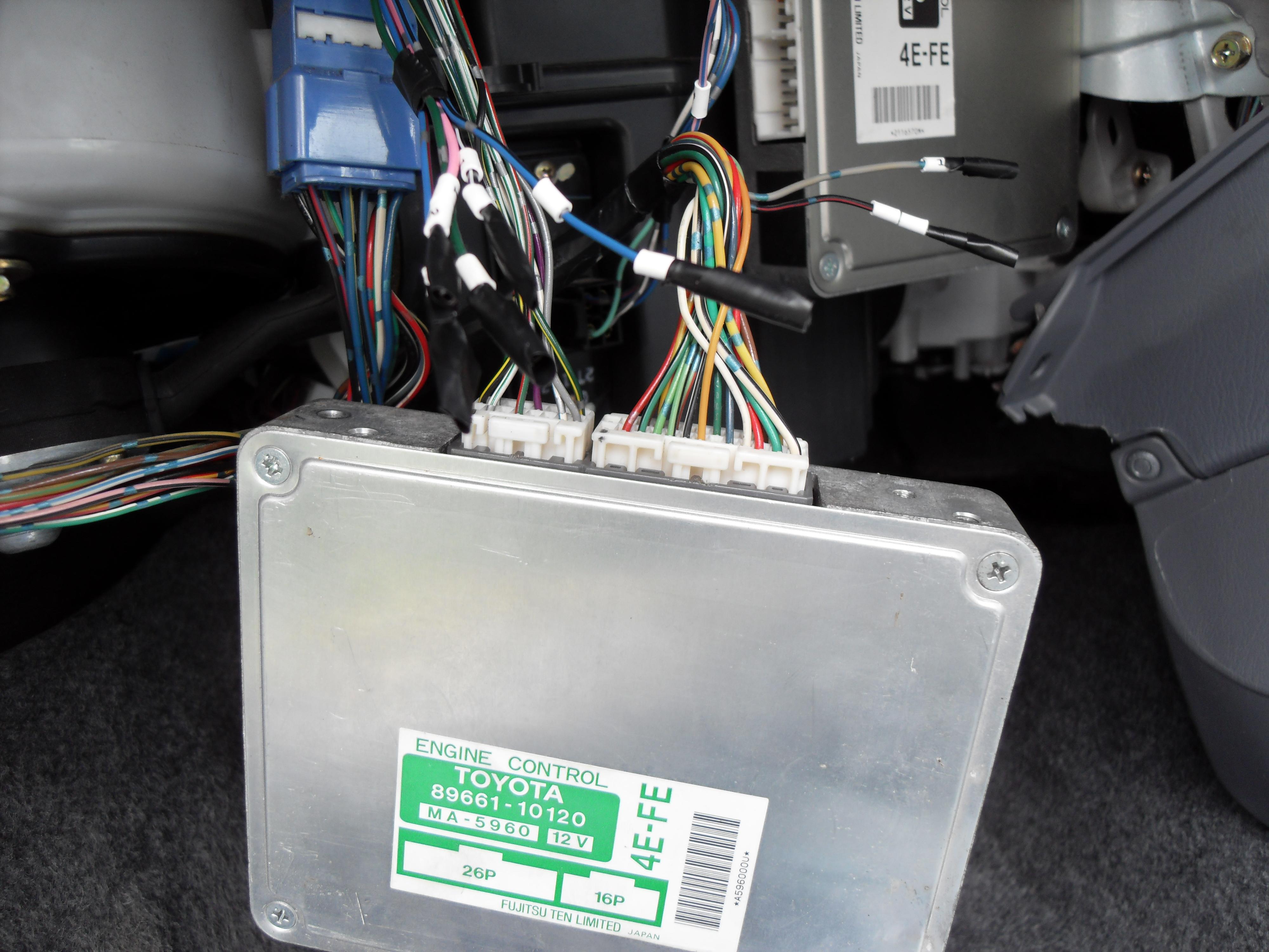

I finally managed to get a 100HP Gen 1 JDM ECU (P/N:89661-10120) EP82 Engine and EP82 ECU finally reunited in a EP91. It's going to be beautiful.

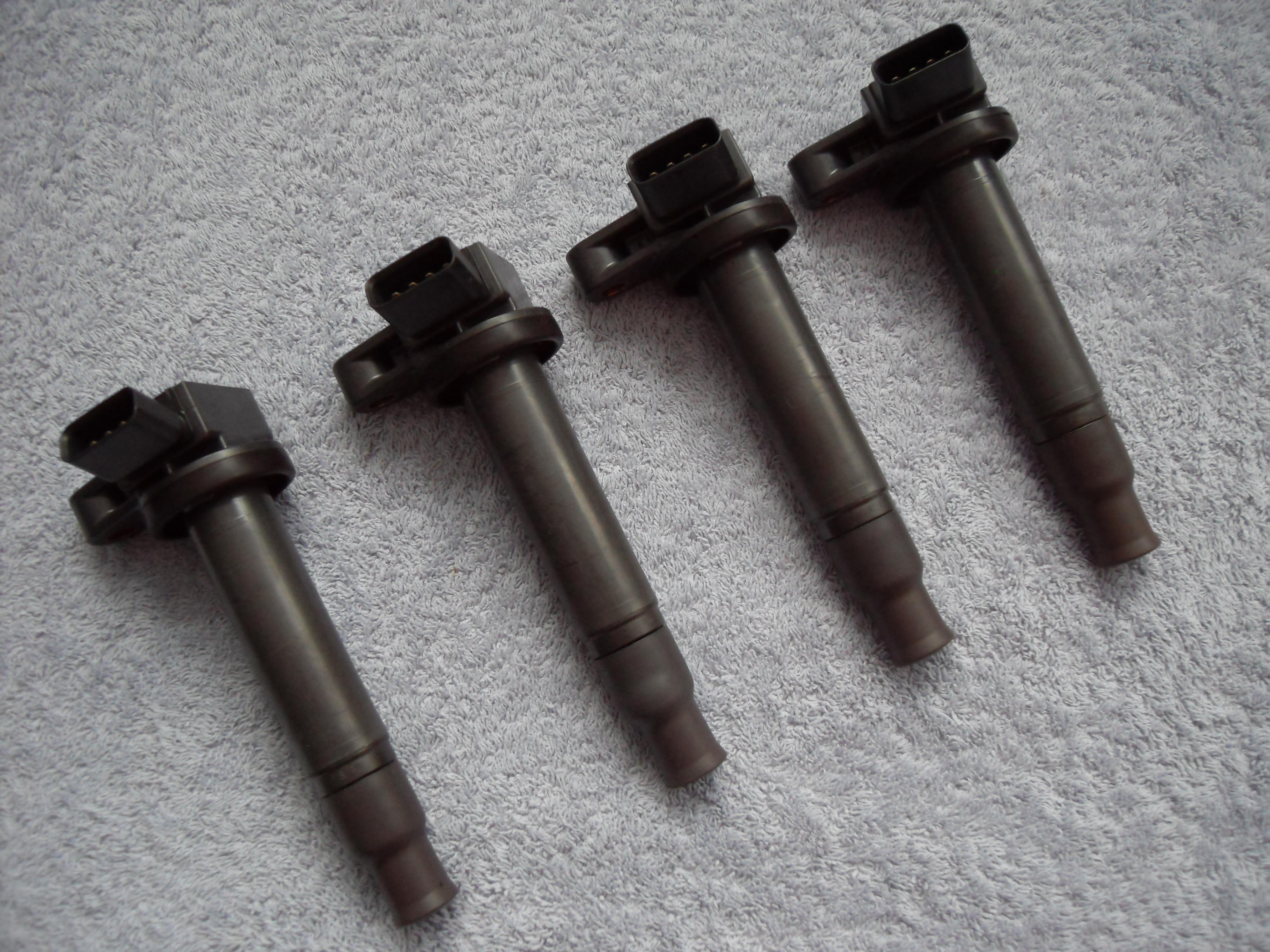

And I got some Toyota Denso Direct Mount Coils (P/N:90919-02230)

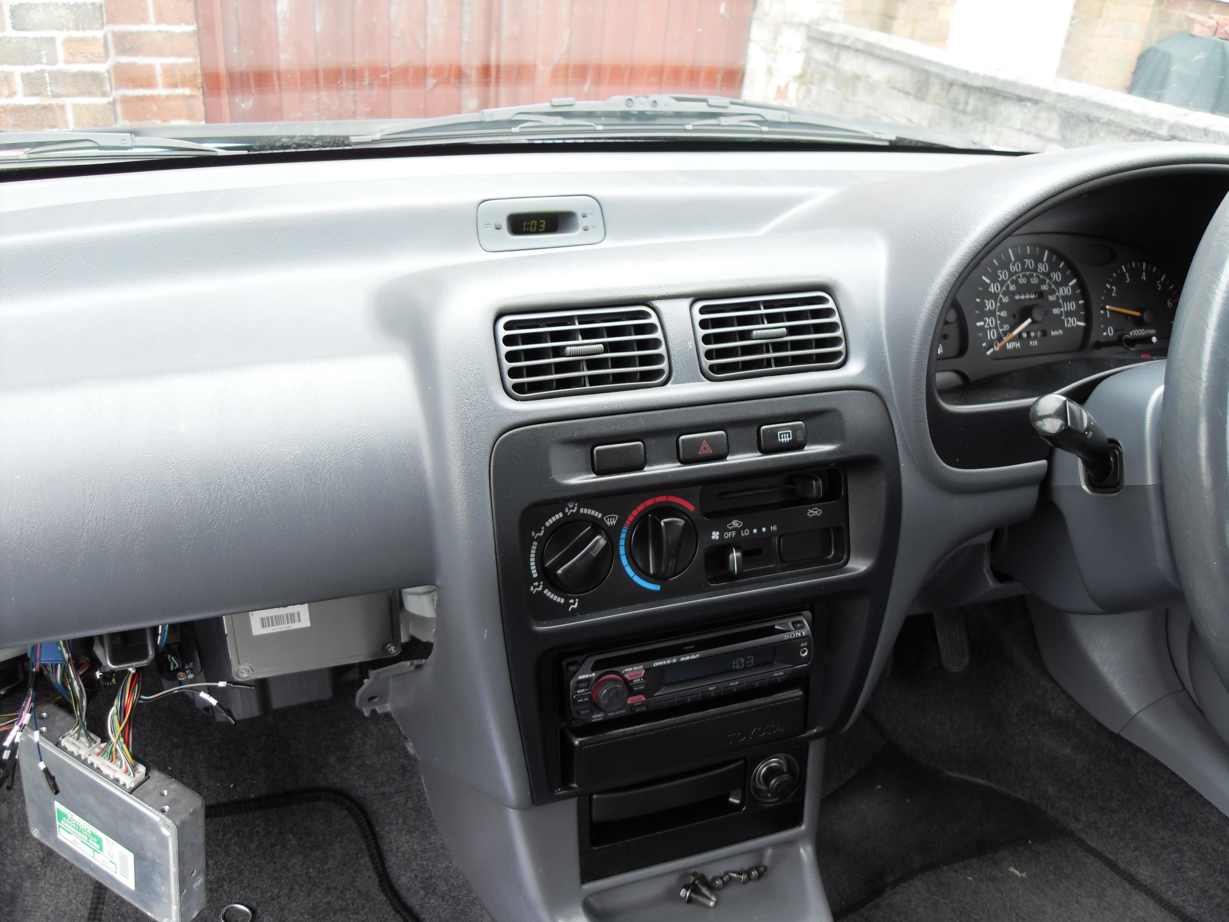

I have already got the JDM ECU working in my car. To make testing the ECU easy and because some of the pins might interfere with the ECU, I disconnected some sensor pins and the immobiliser pins, 8 in total, I also swapped 1 of the pins position. When this ECU is fitted for good the 8 pins need new wiring because of the difference in sensors.
SDC12154.thumb.JPG.108b6d5816798d5bafdcfcf6ecb76d56.JPGSDC12155.thumb.JPG.4a76545f3c330e9ee91b7a93b114f972.JPG

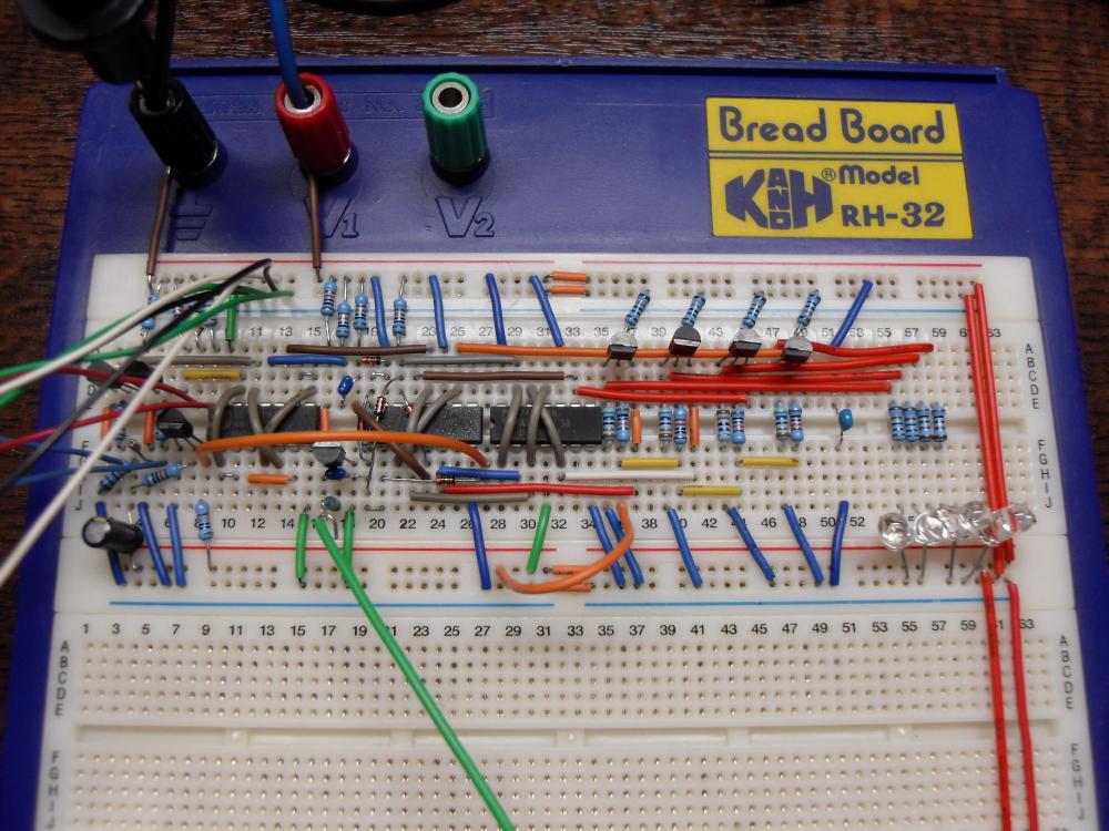

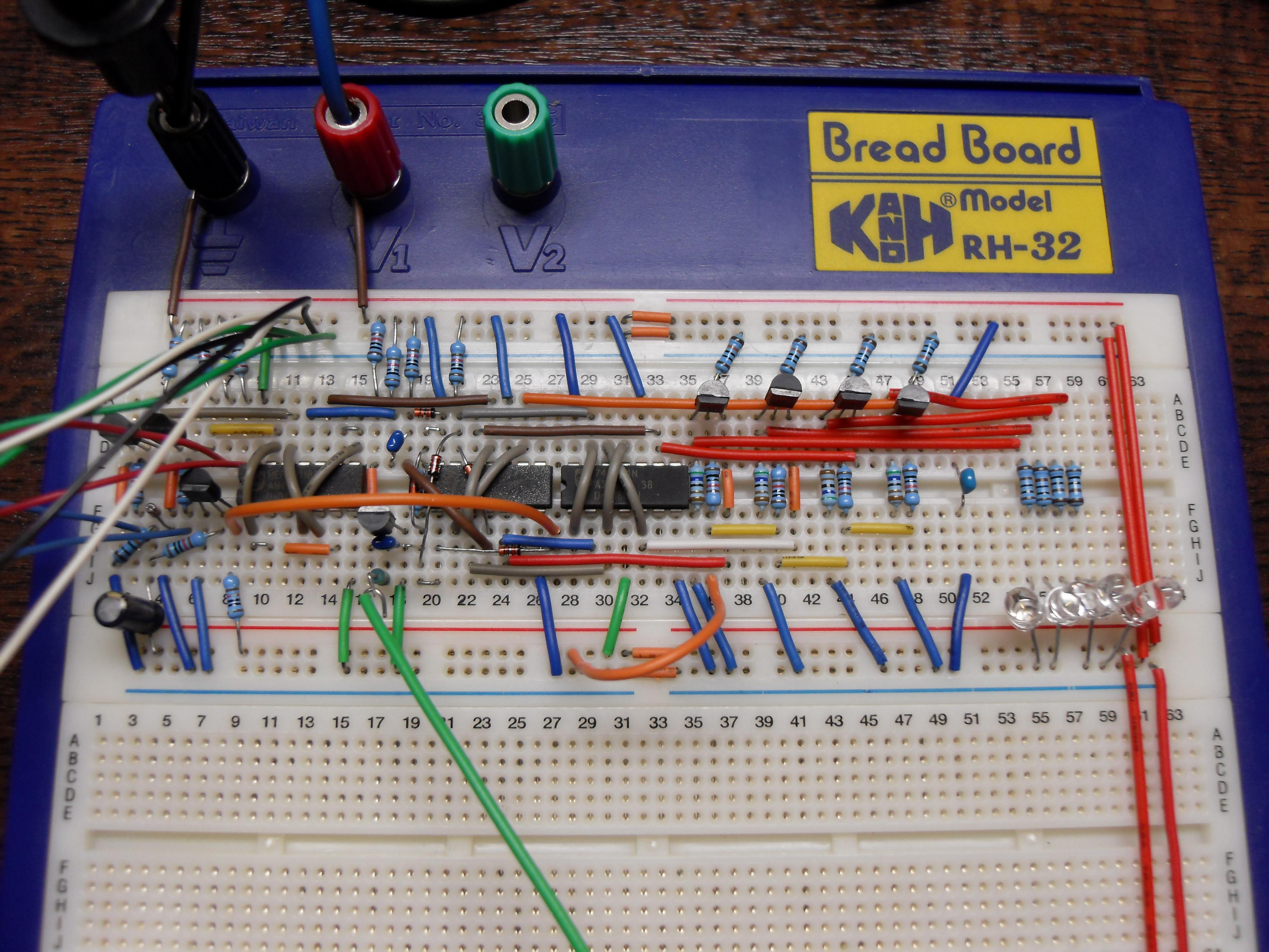

Now, anyone with a sharp brain might be wondering how I'm going to use the coils with the JDM ECU. Well that brings be to the "something that's very interesting" I mentioned a few posts above.
I am in the process of designing and building an upgrade to the ignition system. This system won't give each coil independent timing control but because of the separate coils it will give some benefits. There are no HT Leads for starters and each coil has more recovery time. This will result in a stronger spark, smoother idle, smoother running and the ability to run a larger spark plug gap.
Here are some photos.

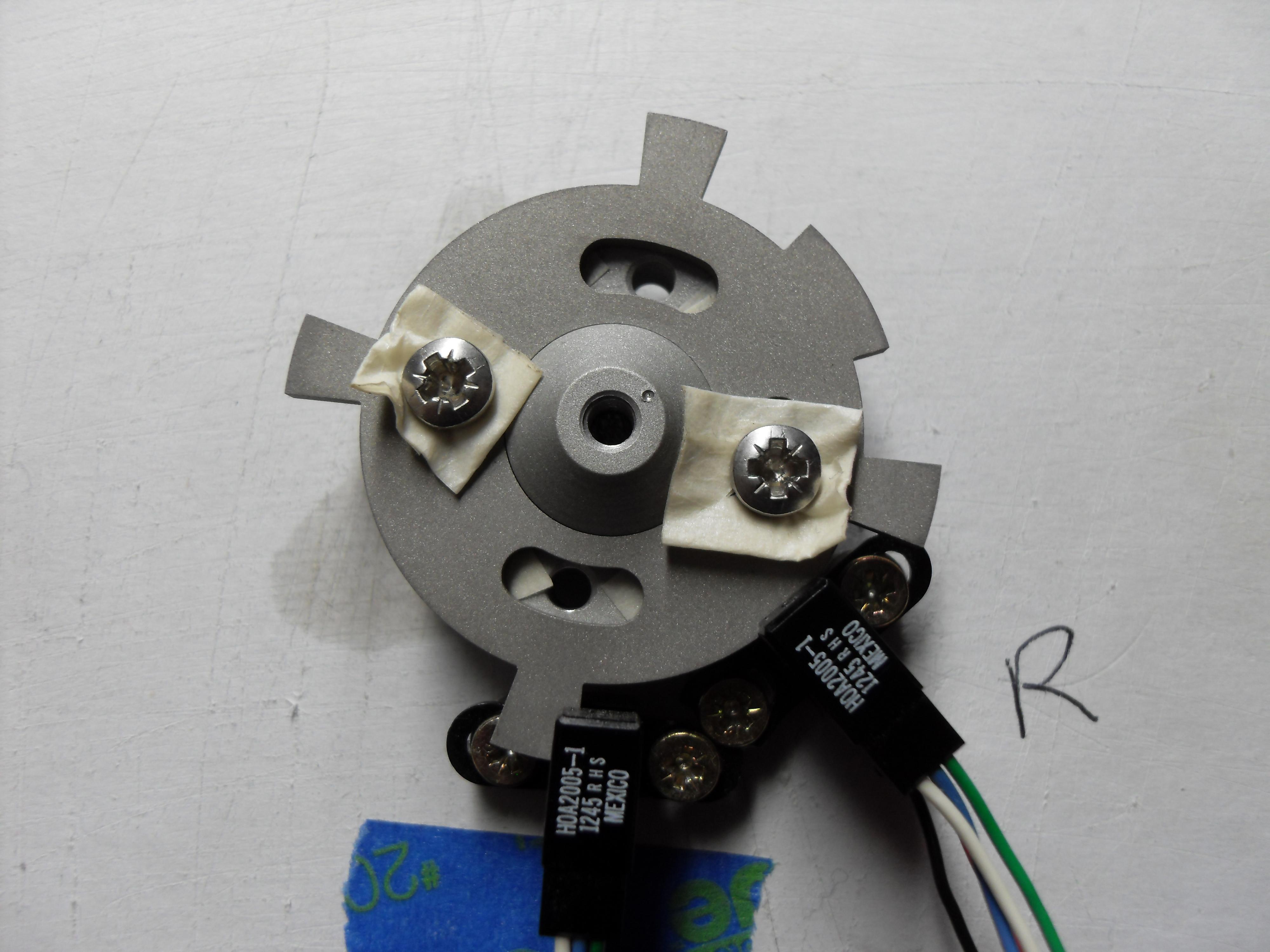

Prototype v1 electronics on a Bread Board.

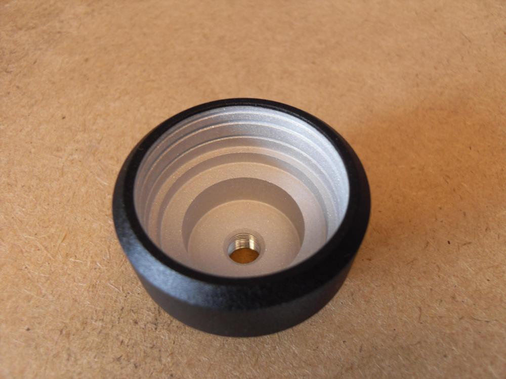

Prototype v1 Crank/Cam Sensor.
Prototype v1 distributor housing.
SDC12148.thumb.JPG.d02ebd905b1d5d9a2f4ce29df496422a.JPGSDC12149.thumb.JPG.ac9b94203e7b8aba59fa765e71ac978c.JPG

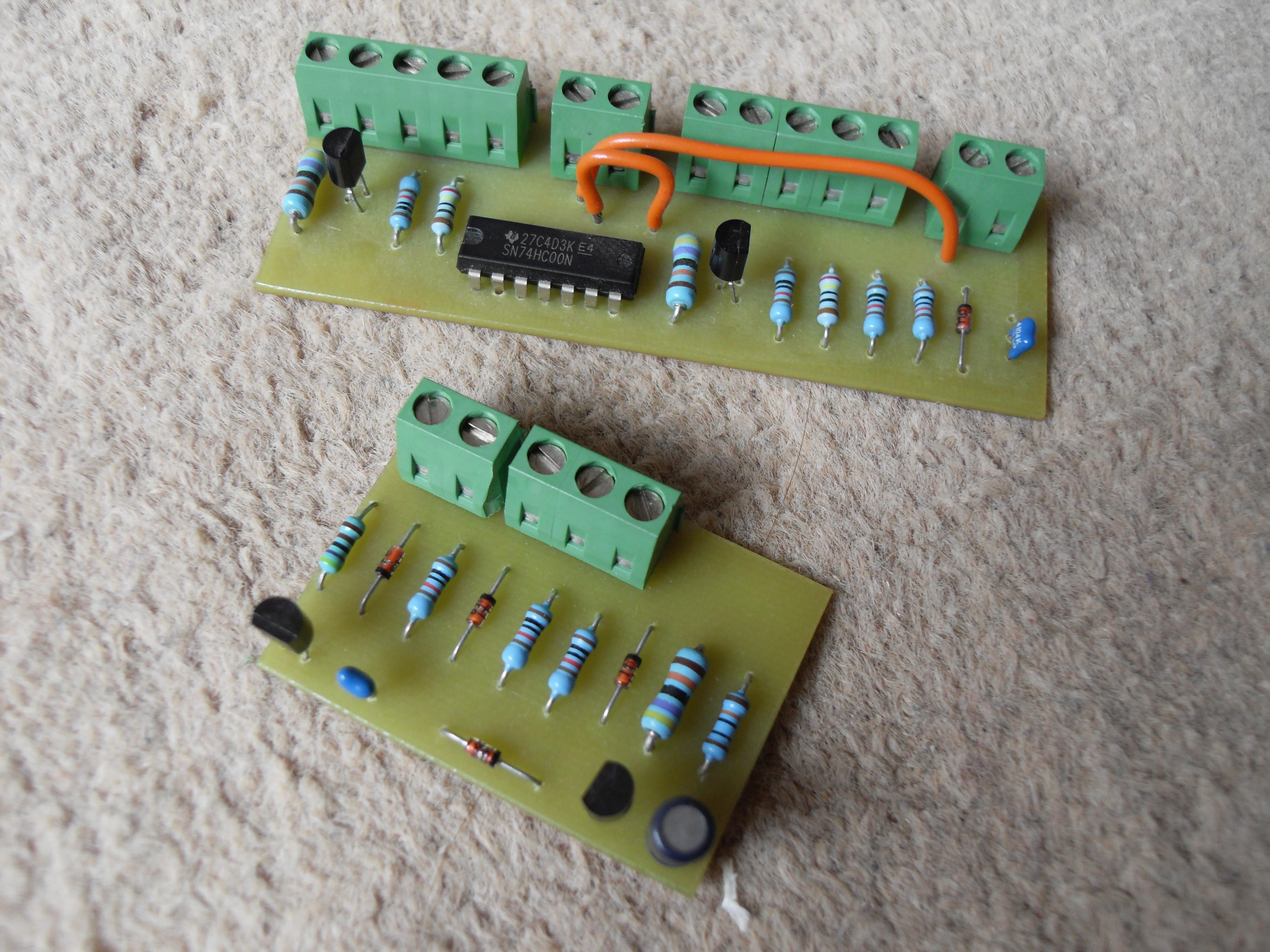

Parts of prototype v2 electronics on a PCB.

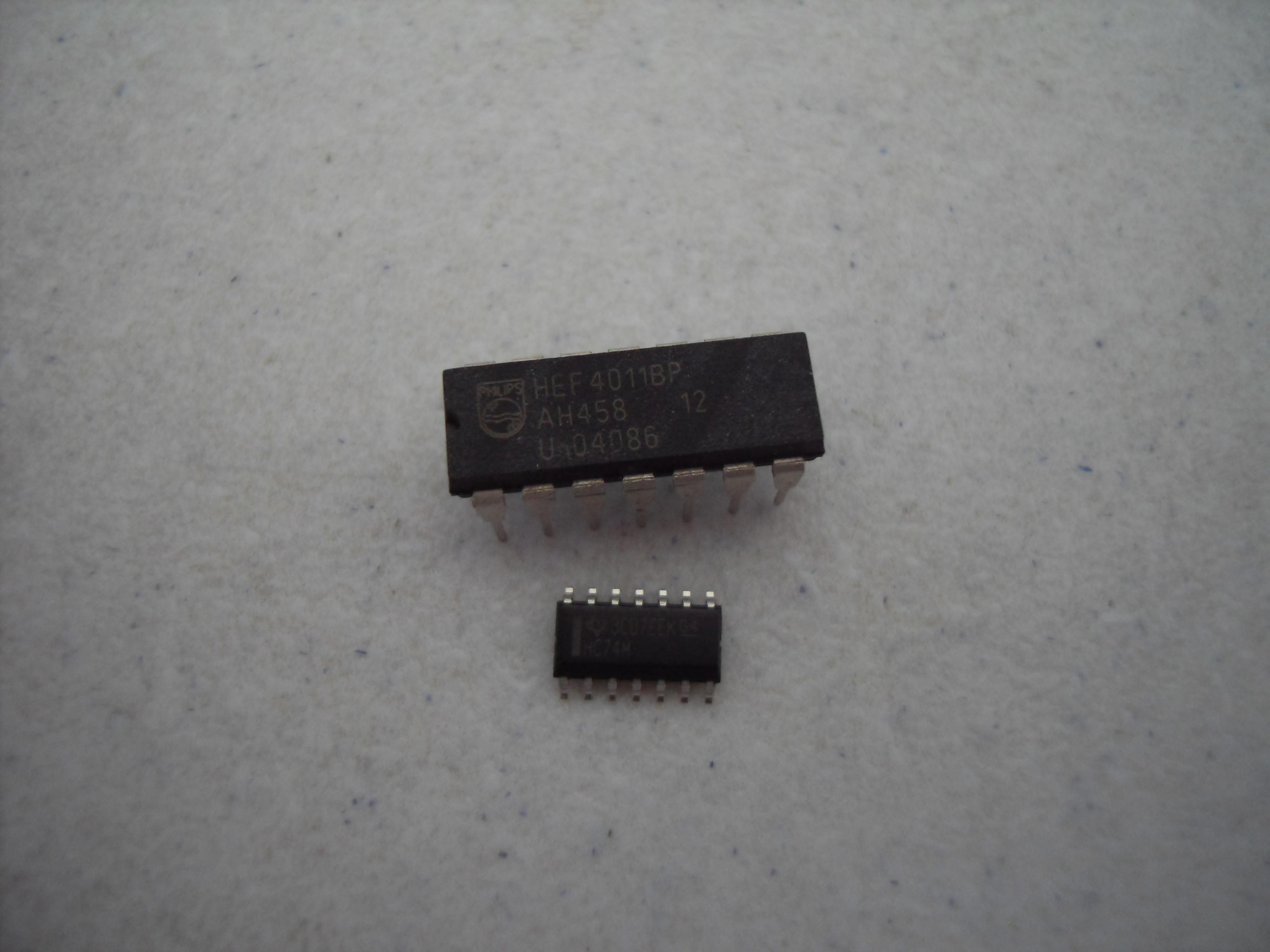

The components used for the prototypes of the electronics are called through hole but the parts I will use for the finished electronics will be surface mount, this will mean the complete electronics will fit inside the new distributor housing along with the new Crank/Cam Sensor.
Through hole VS surface mount components.

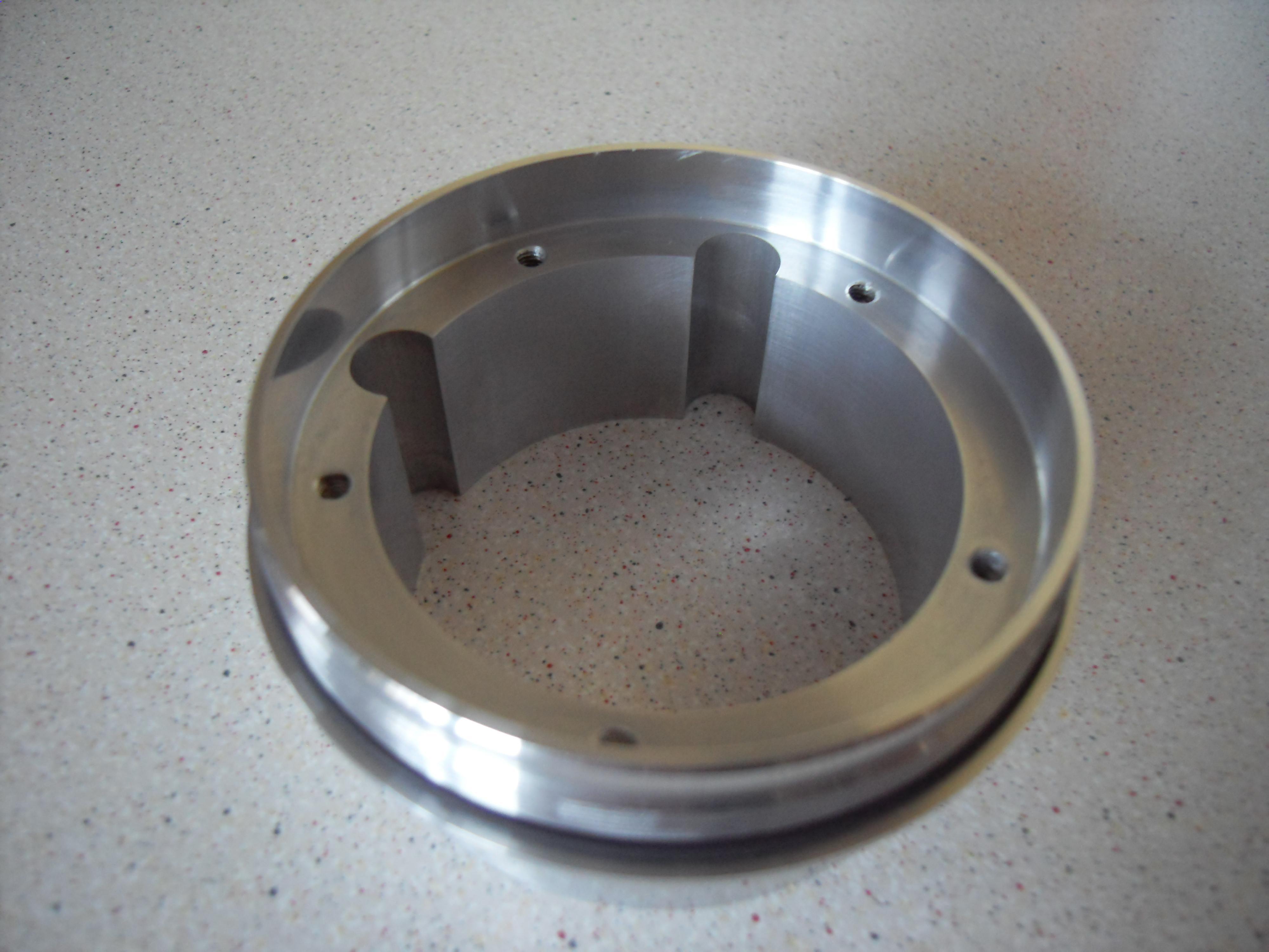

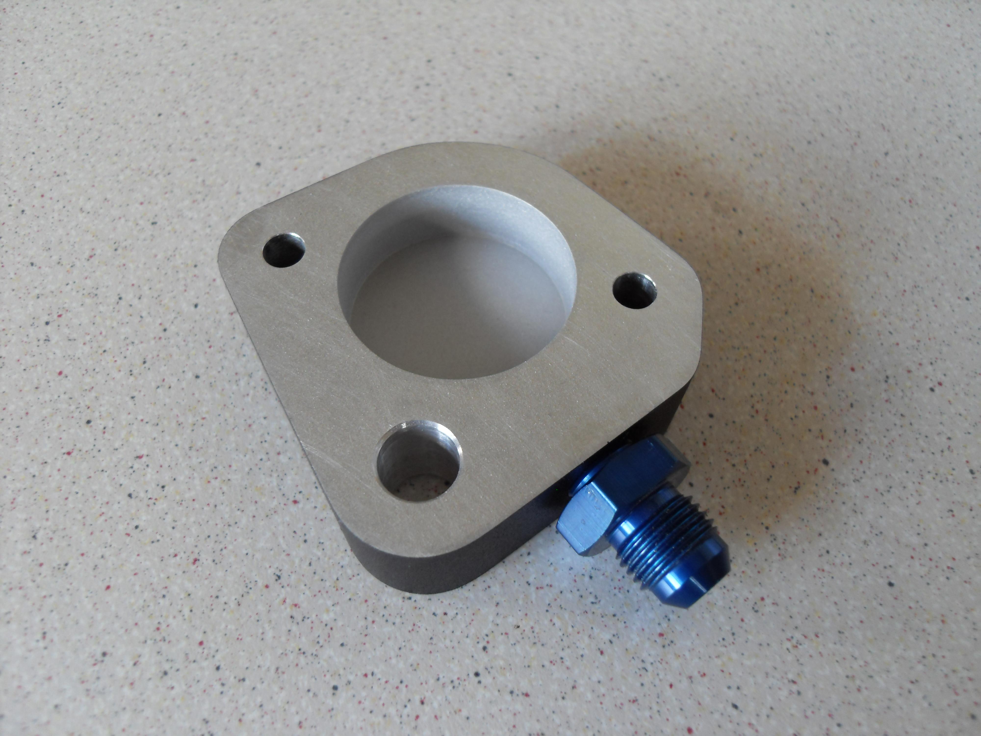

Small update, nothing exciting.

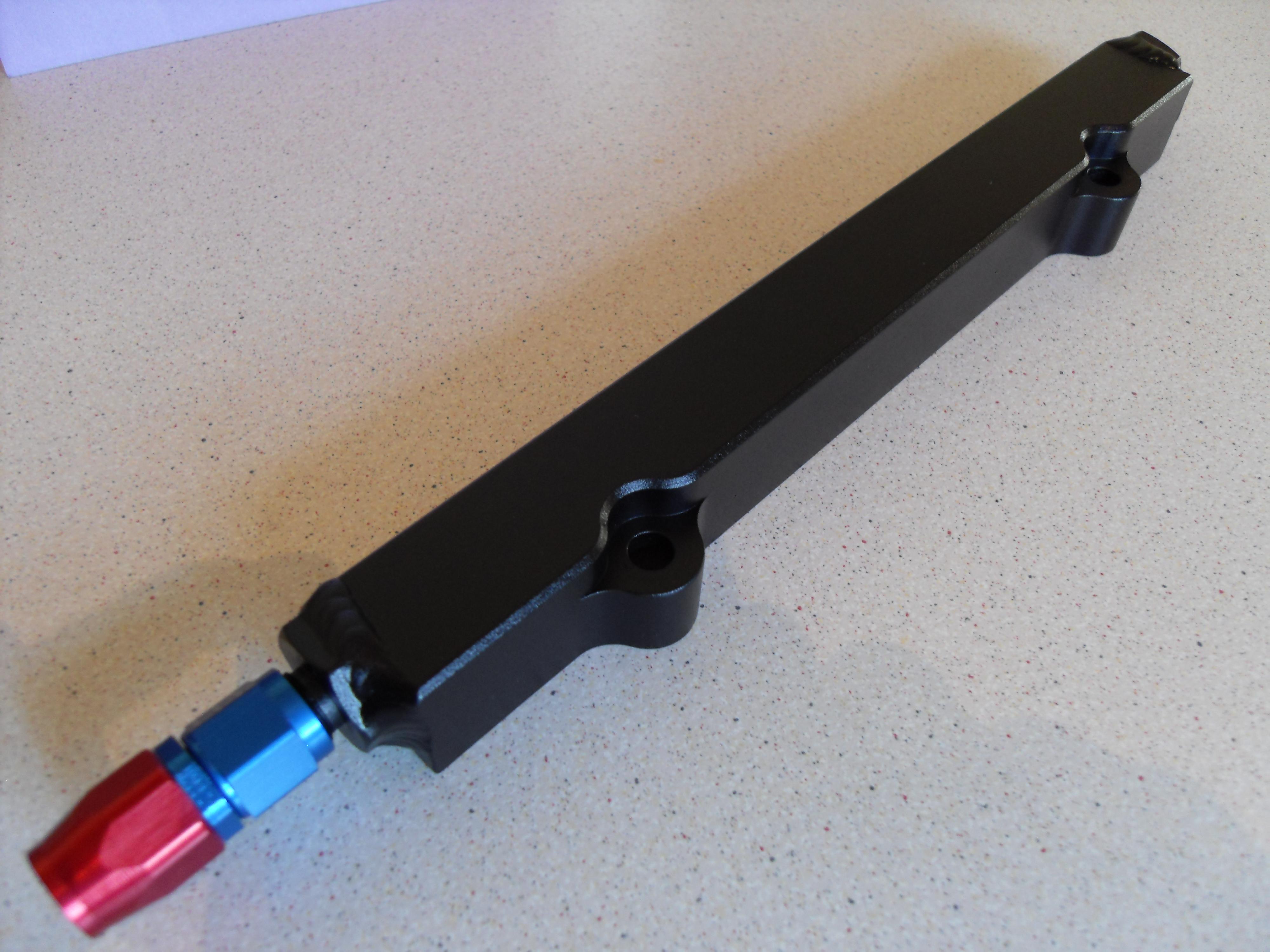

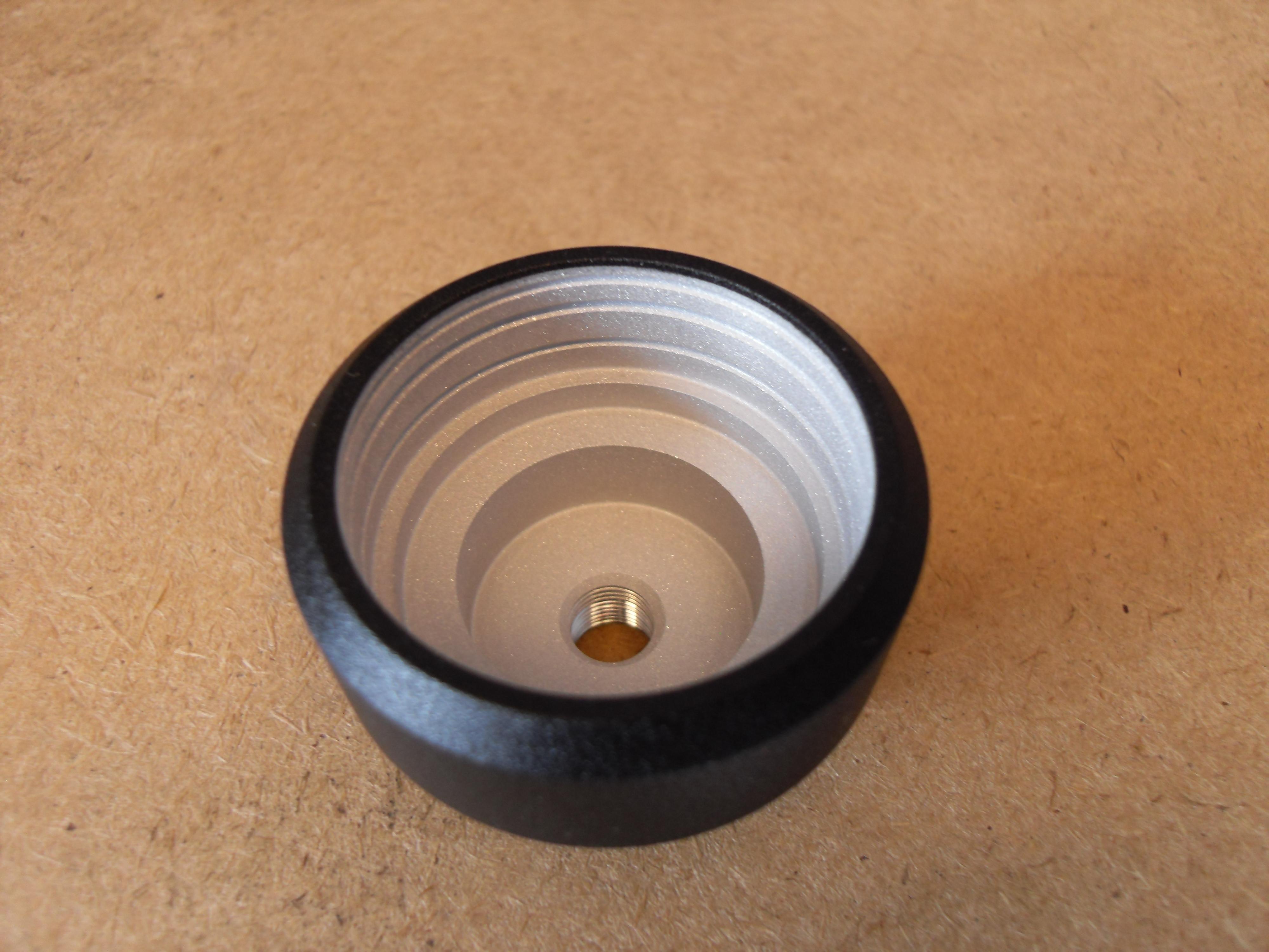

I got some more DIY custom parts made this week. Now I can start making the bigger, more interesting parts. I also managed to de-anodise and paint the old style TD Fuel Rail I've had for so long.
Hopefully within the next month I should be able to order a JUN lightweight flywheel and Zep brake and clutch hoses.
As ever photos speak a thousand words...

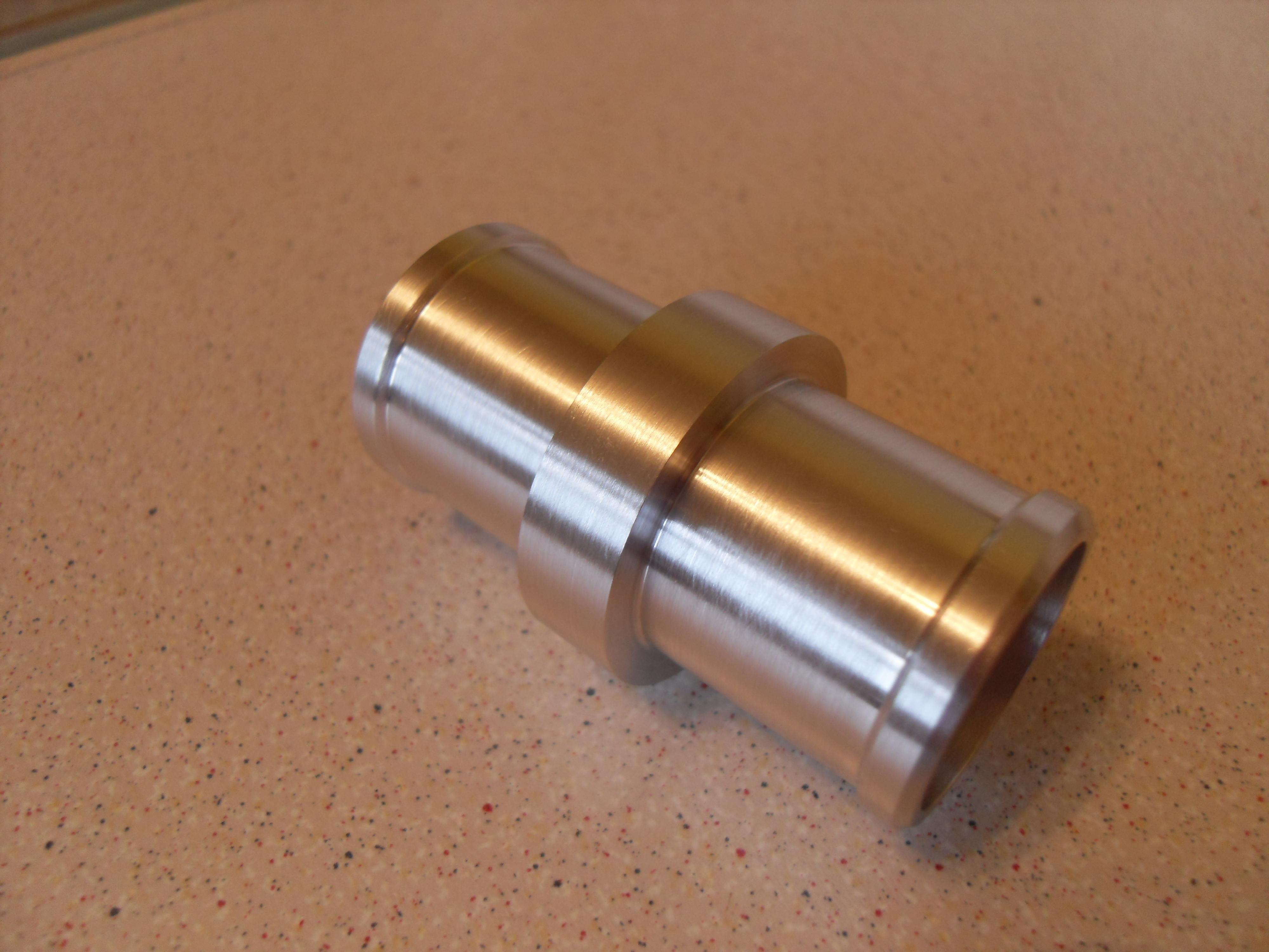

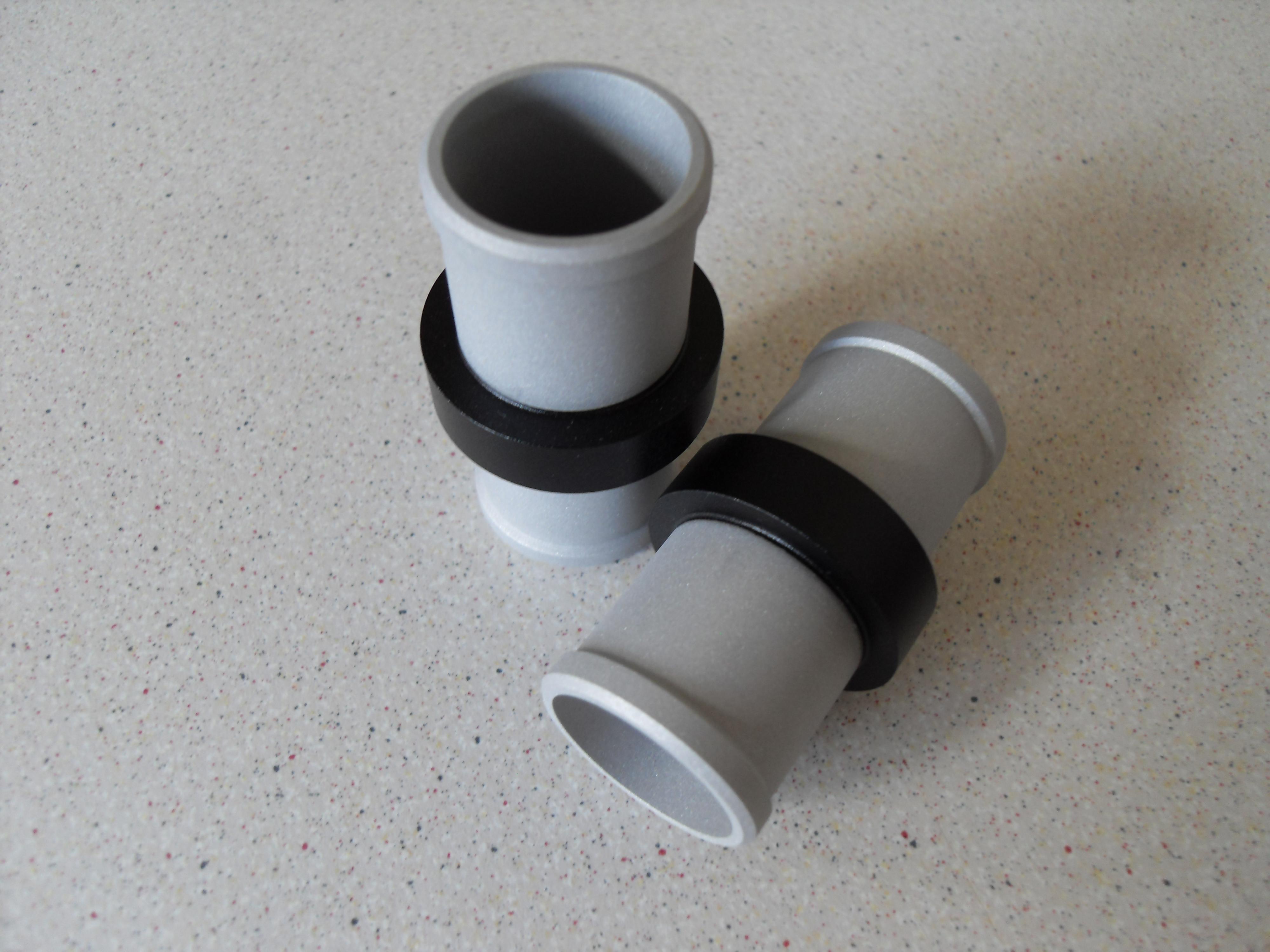

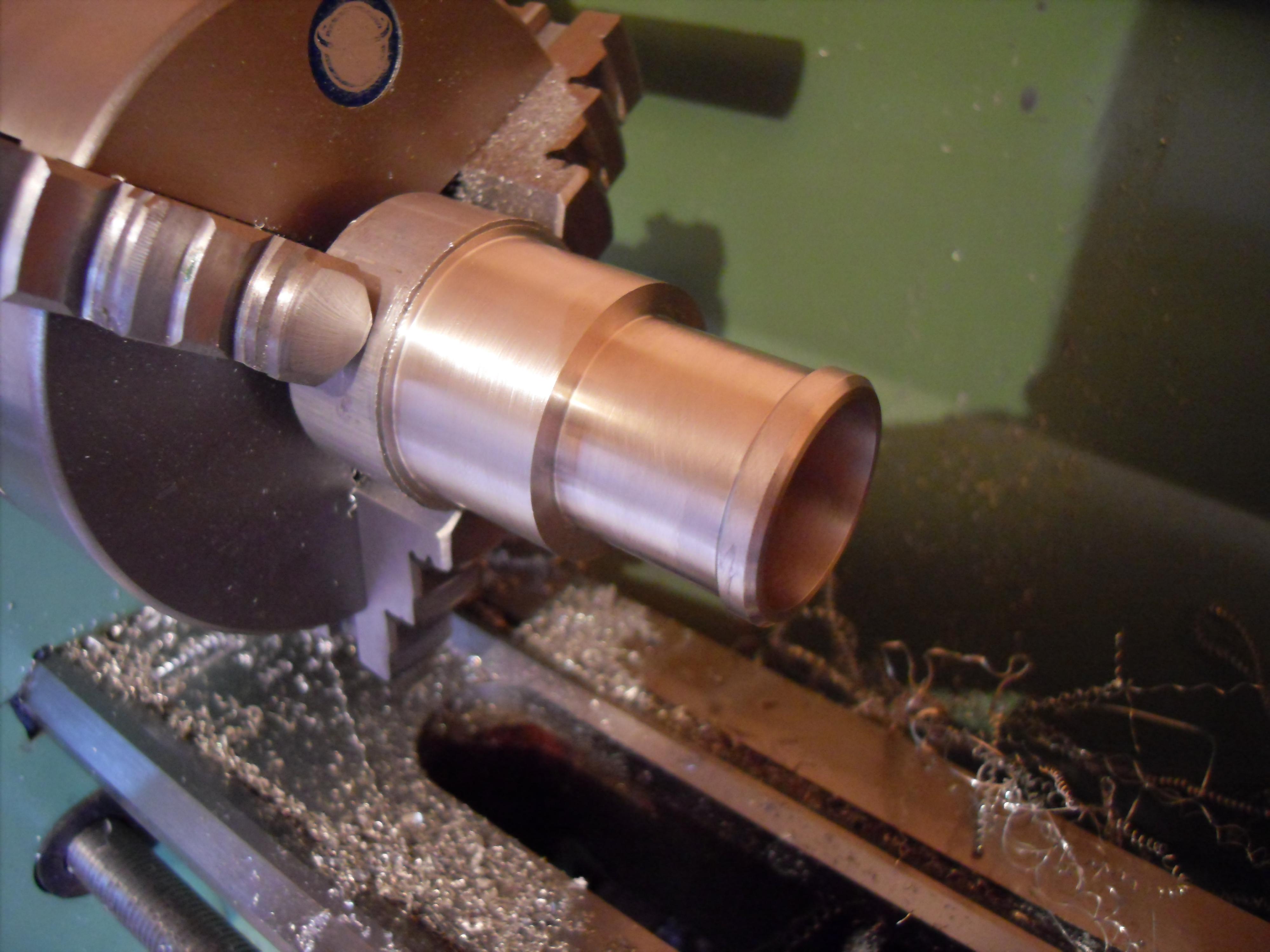

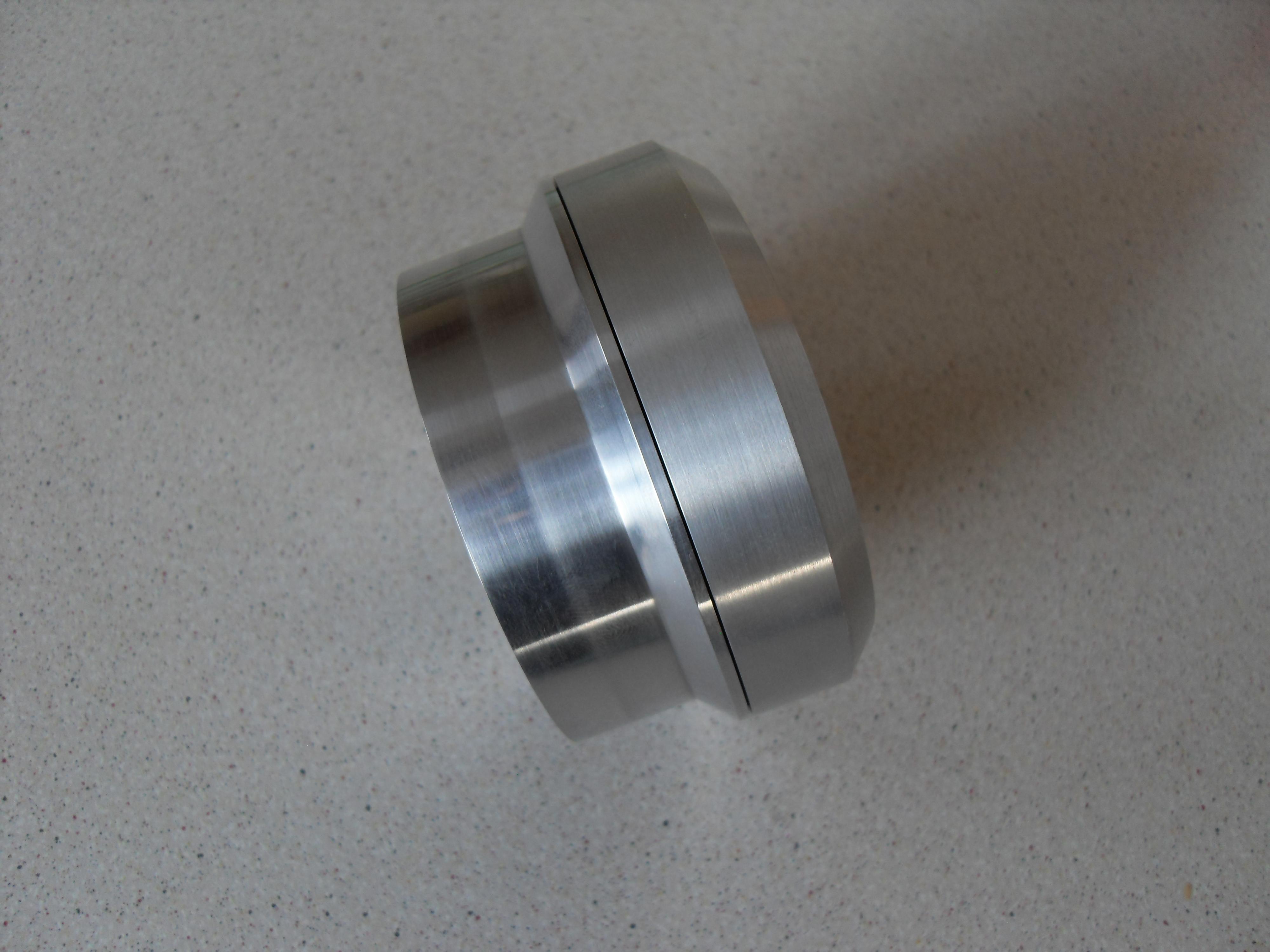

Hose joiners for the custom cooling system plumbing. I've made 4 so far but I think I might need a couple more.
SDC12017.thumb.JPG.8ca33dd0202362f8c0c7145f5eecec3f.JPGSDC12019.thumb.JPG.92dc1e18ac6d39e27c1c71e166b8410a.JPGSDC12160.thumb.JPG.b335eb79165ff09461af3173615a1816.JPG

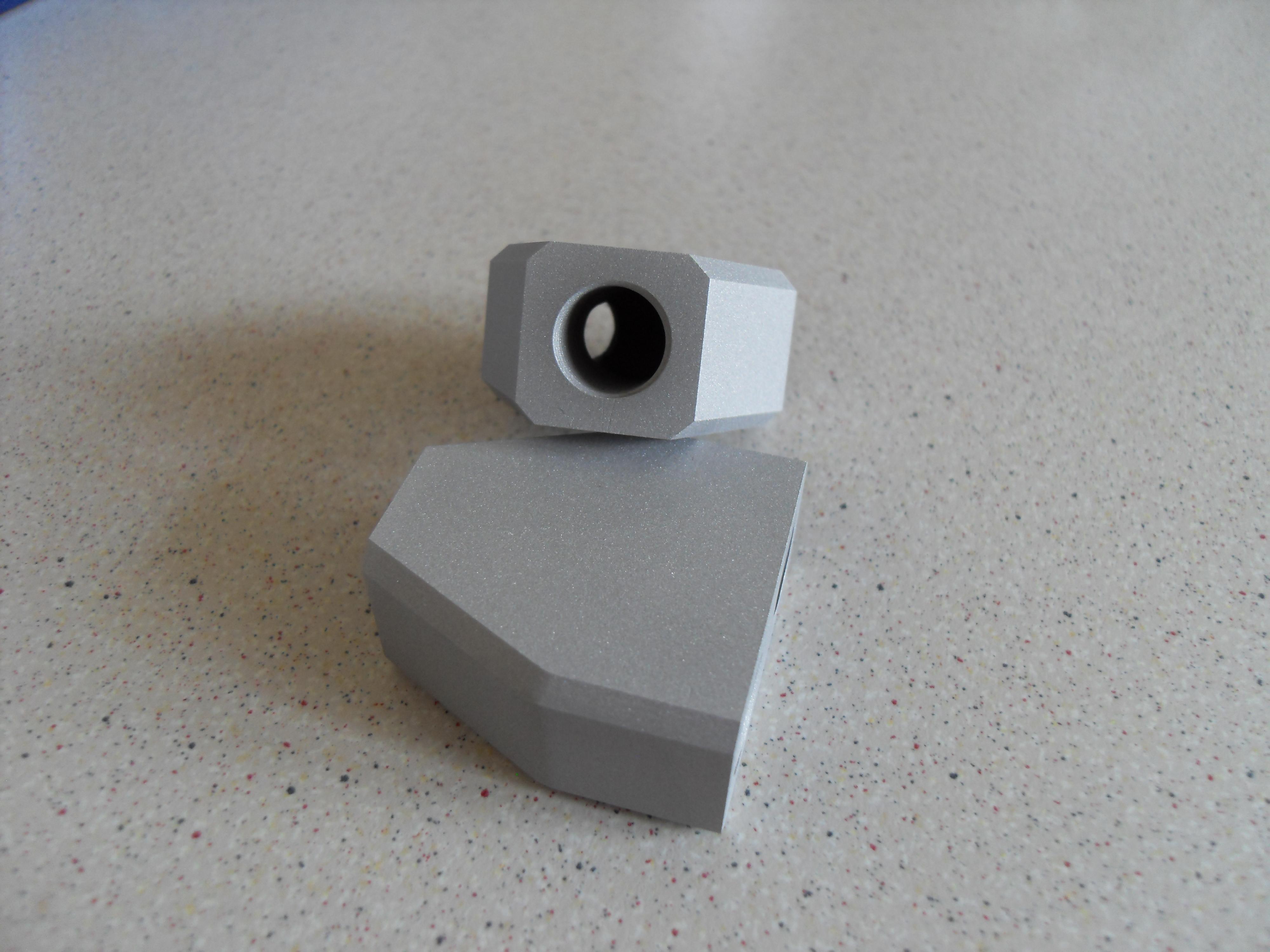

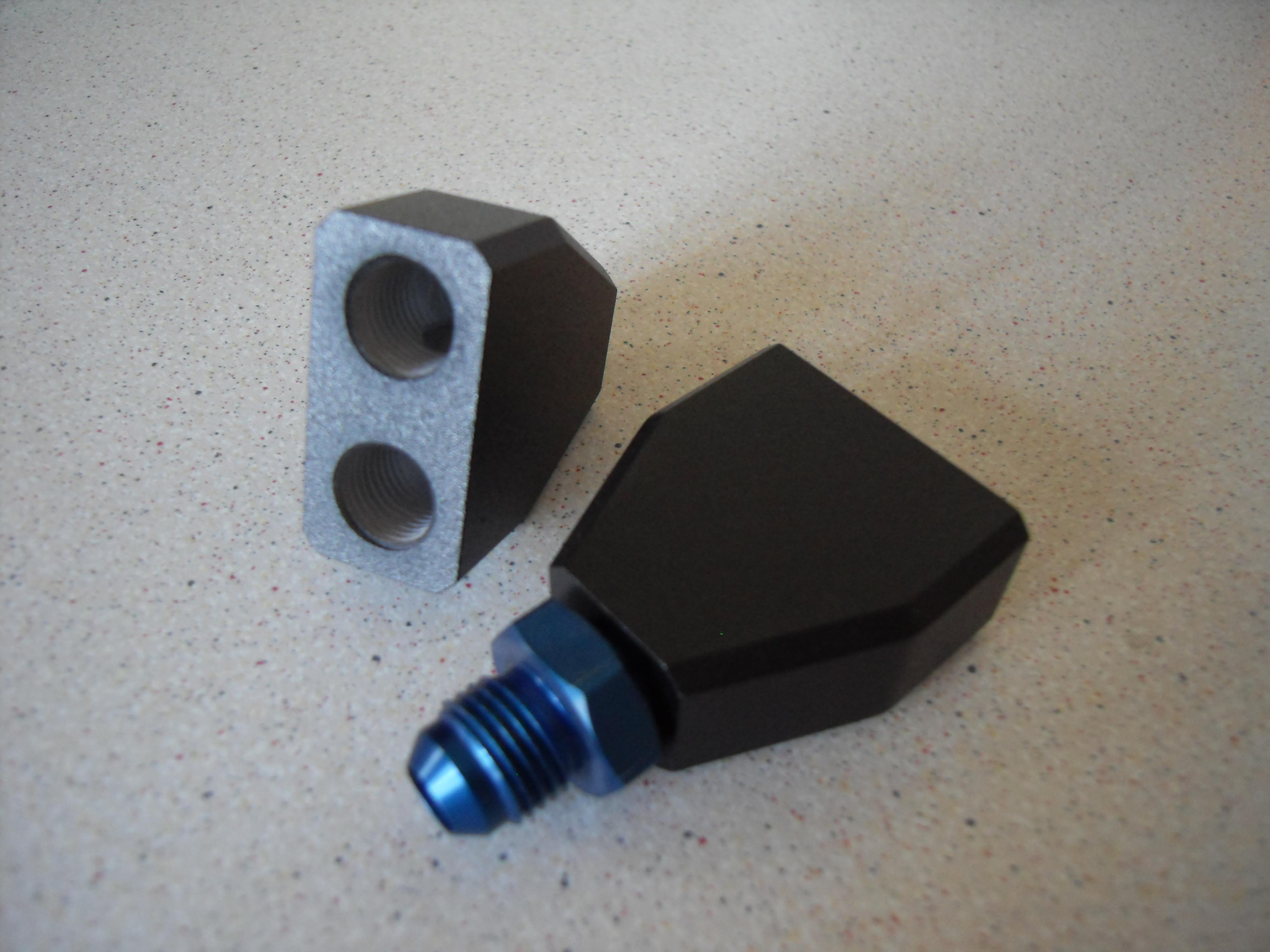

Splitter blocks for the custom 2 way oil catch can and breather system.
SDC12066.thumb.JPG.ee421cc7f921b12101b46bbd7b74622f.JPGSDC12161.thumb.JPG.2d51b71a935504c56afe43620ff4c364.JPG

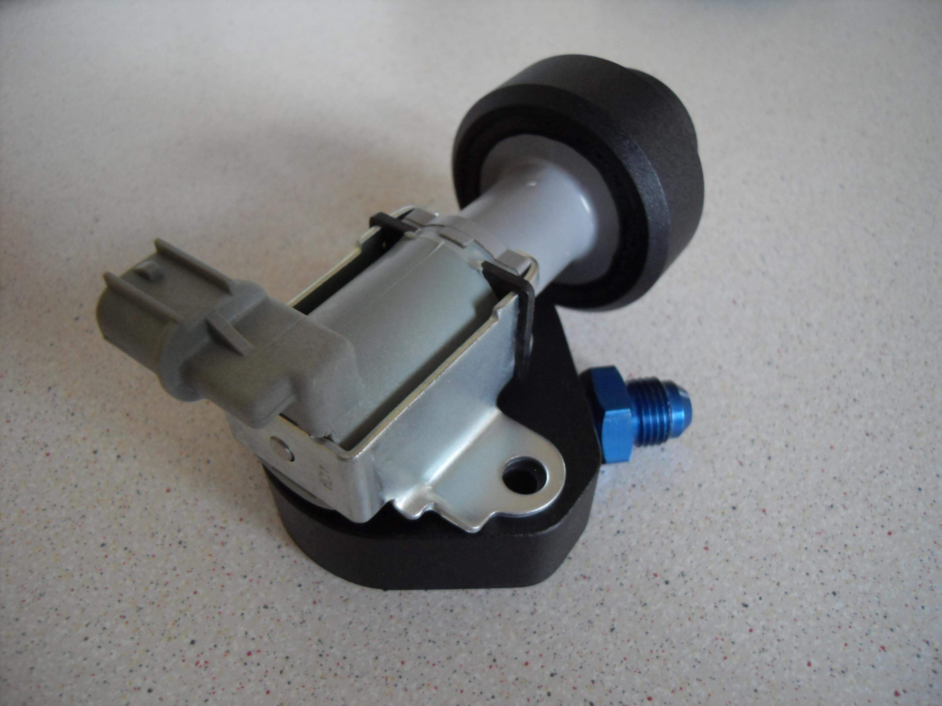

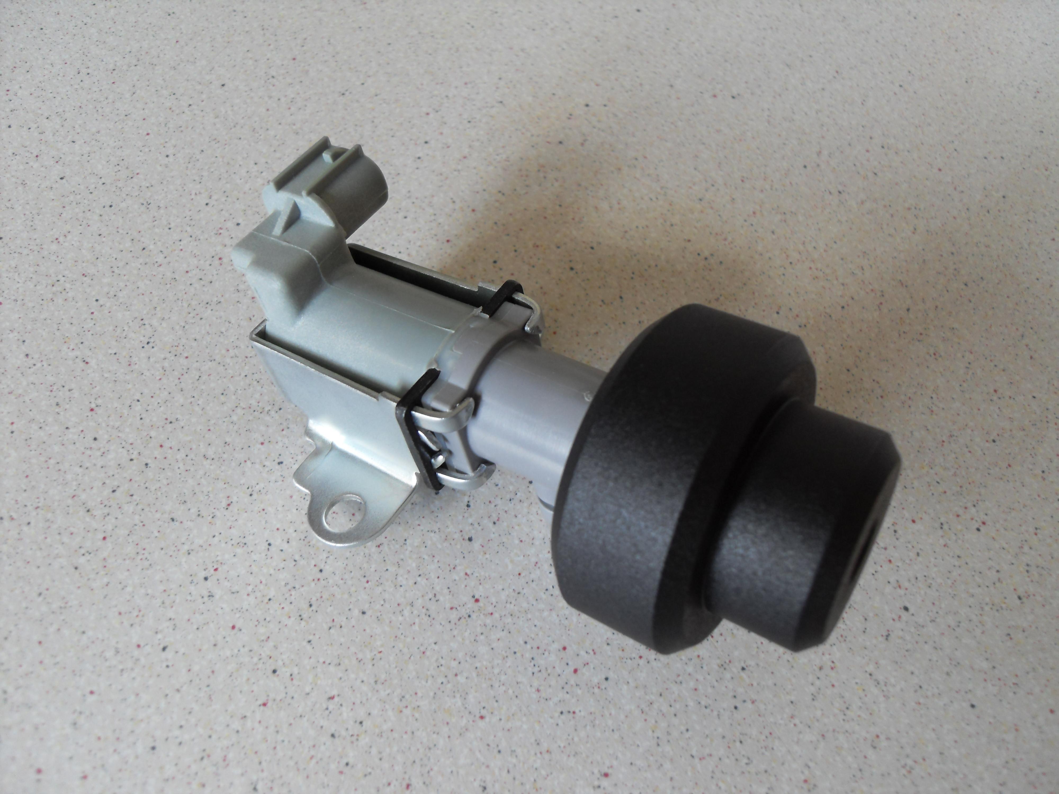

Idle stabilization valve modified with a slightly bigger reservoir.
SDC11981.thumb.JPG.9fcd1ccbb412fed881b19110fca2eef5.JPGSDC12159.thumb.JPG.cf565374080c690f9d32e6e2ee8ada27.JPG

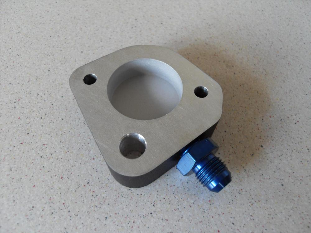

Idle stabilization valve sandwich plate.
SDC12162.thumb.JPG.74137c68869068673a4aba329e87ceeb.JPGSDC12163.thumb.JPG.b8ea42aaa9ffe905af65c589af0a7d32.JPG

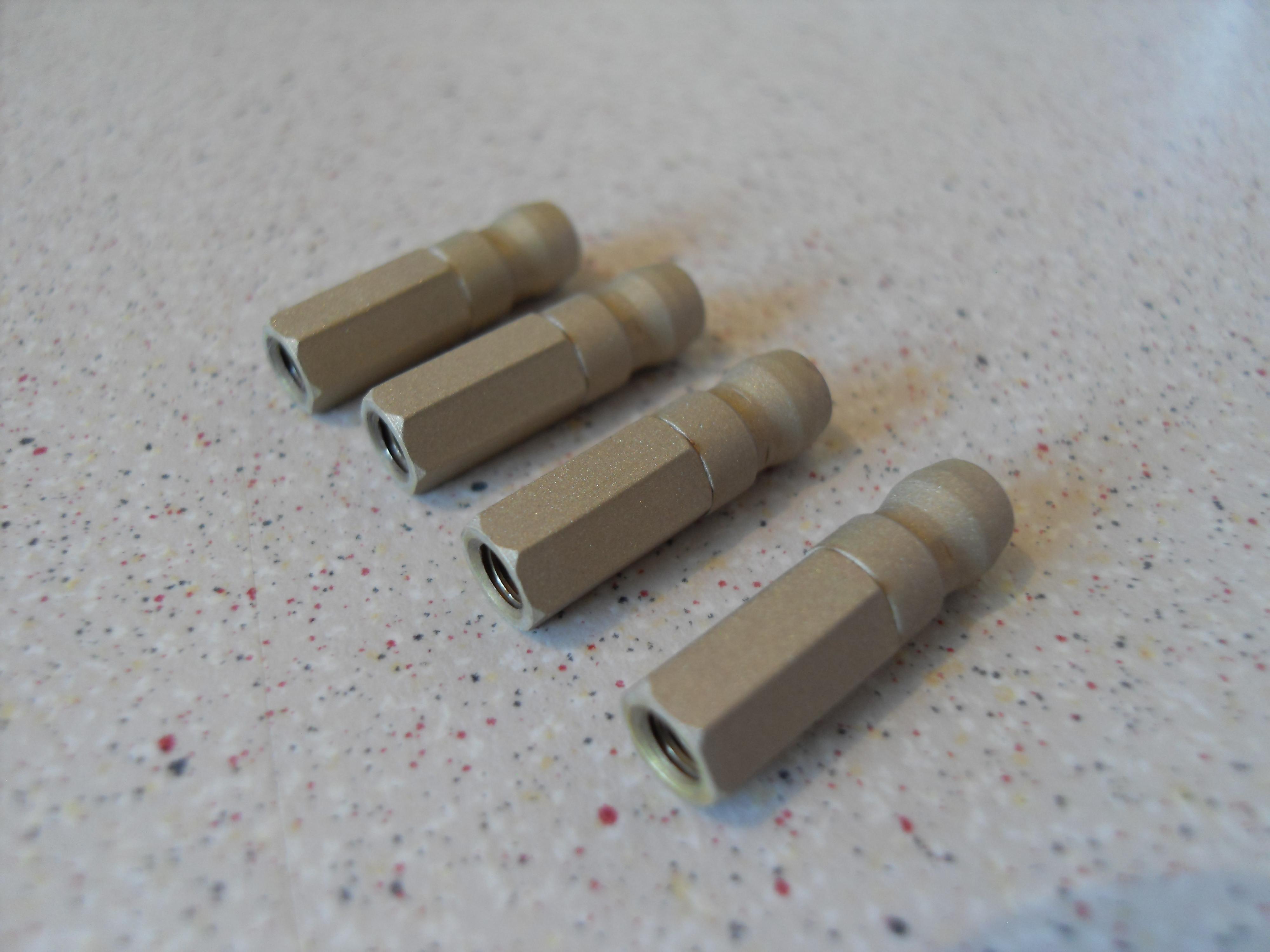

Spark plug extenders. Spark plug nuts silvered soldered to PCB standoffs.
The painted TD fuel rail.
More soon
Gavin
Edited by enzo_e492901
