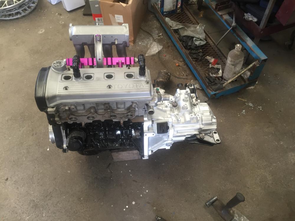

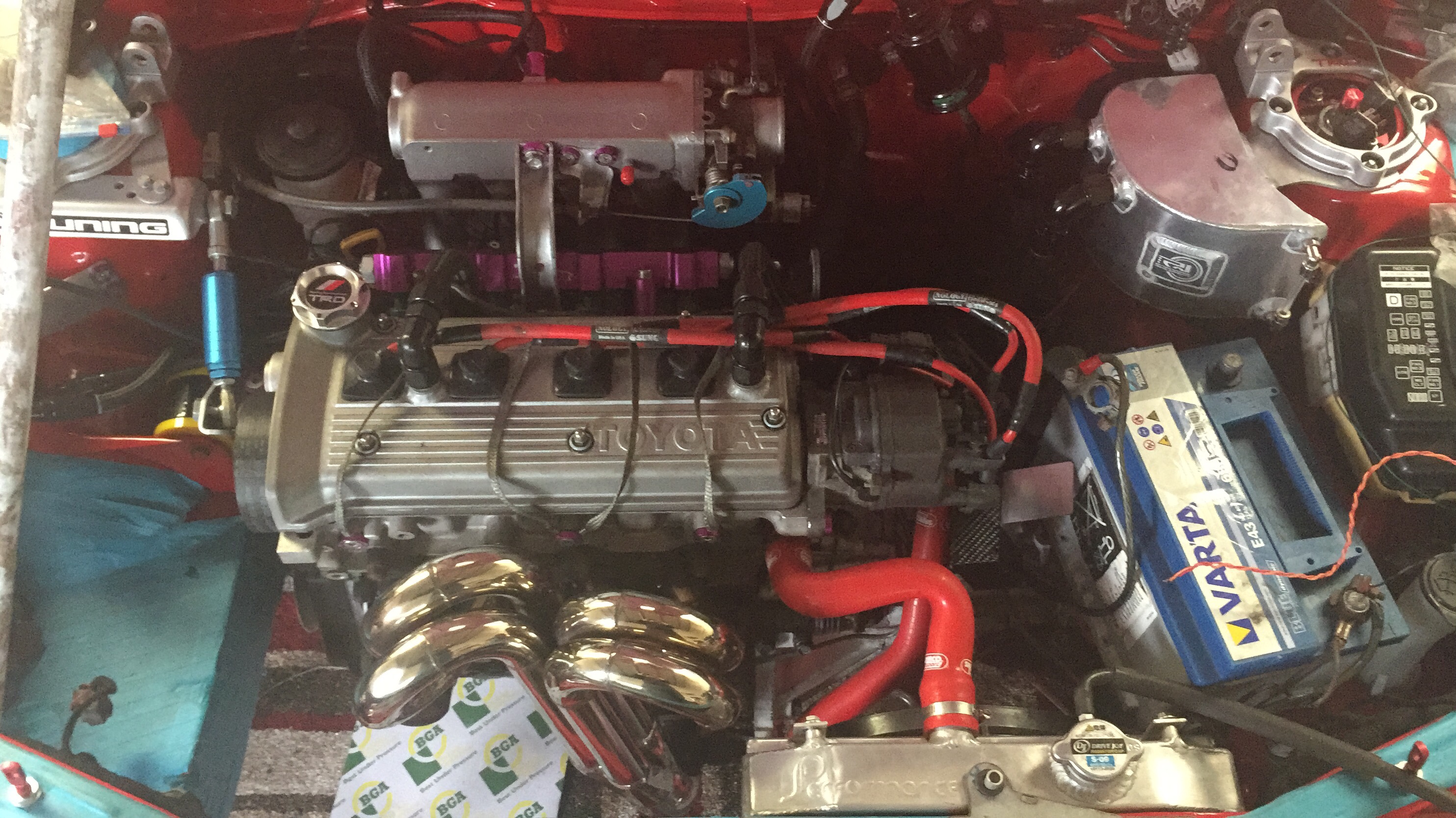

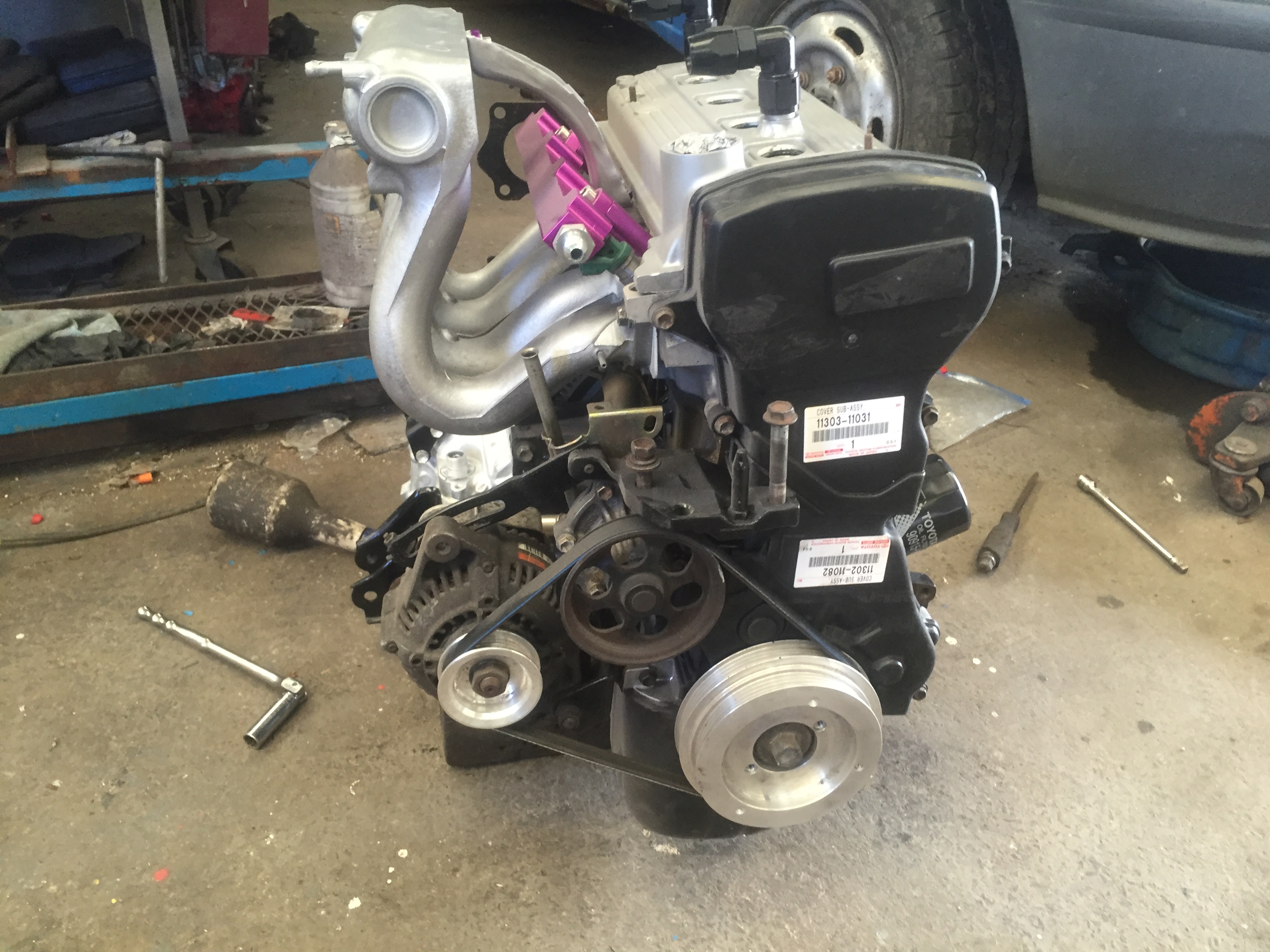

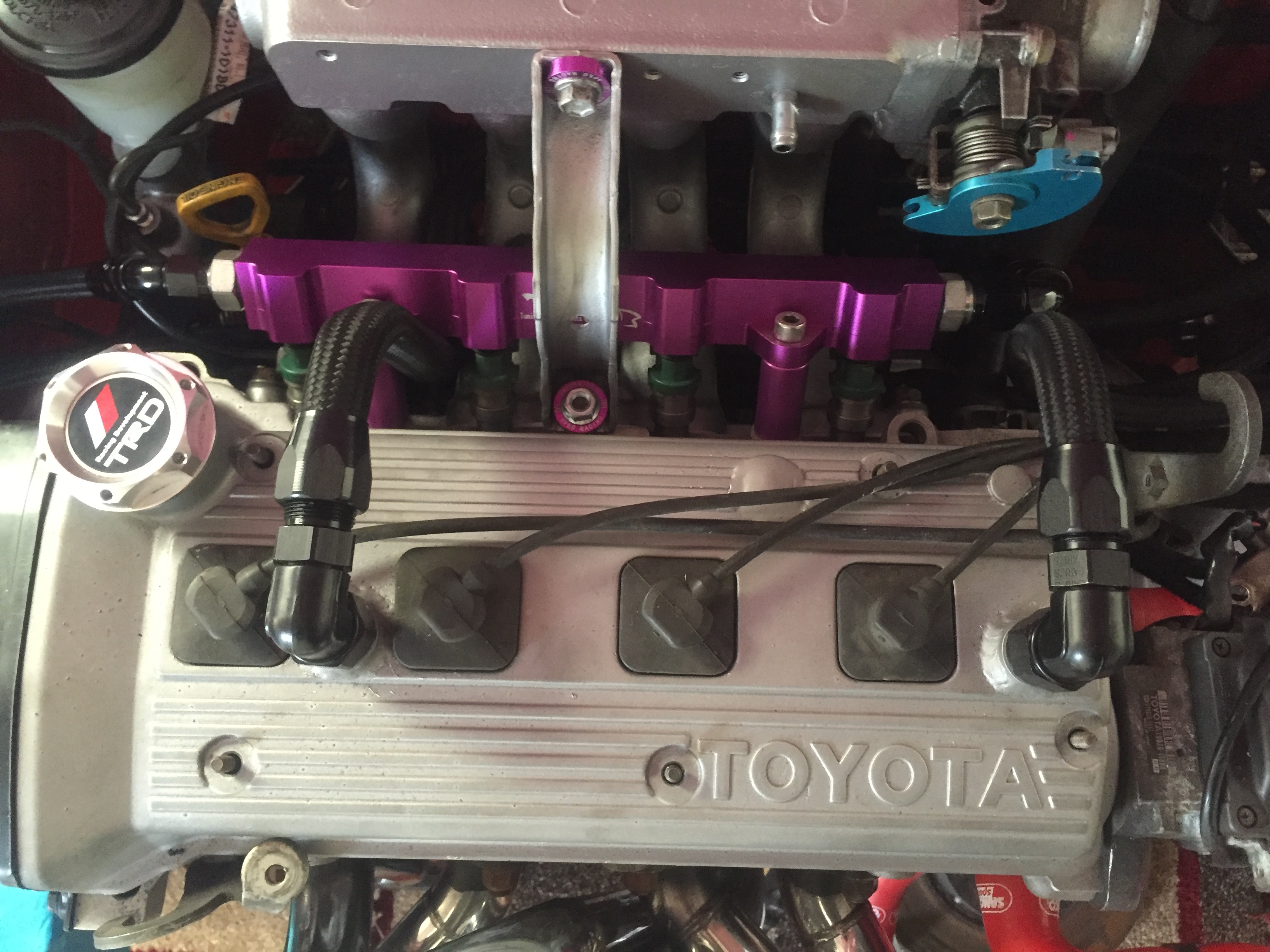

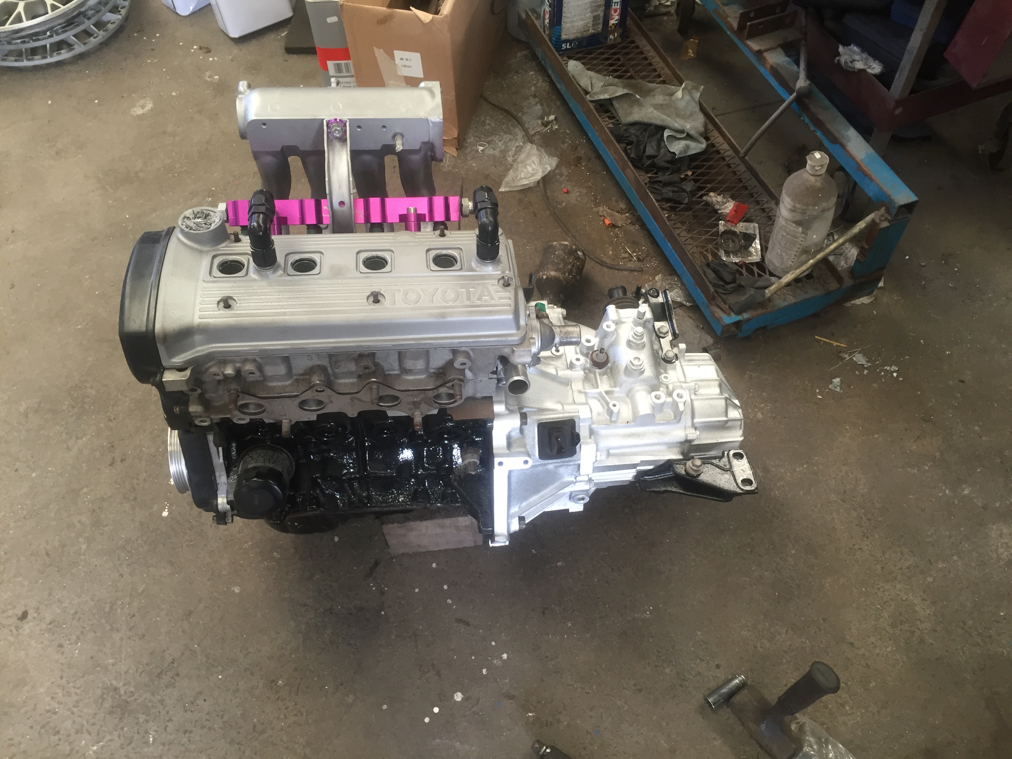

joel_ep91 Posted February 3, 2018 Author Posted February 3, 2018 Thanks guys, seem to be having issues uploading pictures at the moment I will upload as and when I can, Running standard injectors and manifold during run in period engine is running now brief run down of what I’m running / will be running when the engine is run in.  5efe engine scat rod custom wiesco high comp pistons , crank rods and pistons balance ported head with 5efhe cams cruise valve springs trd headgasket 0.7mm from memory zisco ram horn manifold ( will it be good or will it be a hindrance who knows ) looks cool tho 4age 20v blacktop ITB,S corolla g6 six speed gearbox with brand new trd diff and all syncros replaced compression ratio is now 11.8 - 1 ecu will be hks v pro gold version 3.2 then possibly onto a link in the future. not your convetional build but somthing different I suppose I have all the parts fitted so if I’m the future I want to go boosted change the headgasket to a 1.4/1.6mm gasket and I will be in perfect low comp area for boost     Quote
5e colin Posted February 3, 2018 Posted February 3, 2018 I doubt the ram will be a hindrance as it goes in 2.5" that's e ough for NA Quote

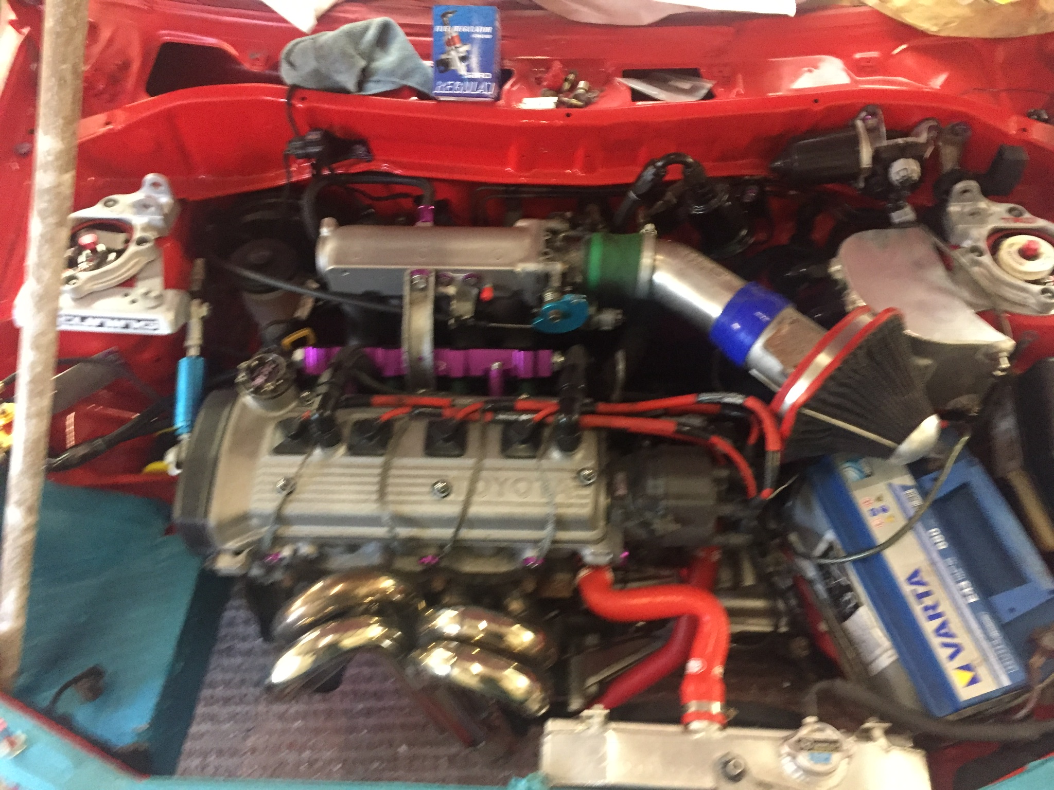

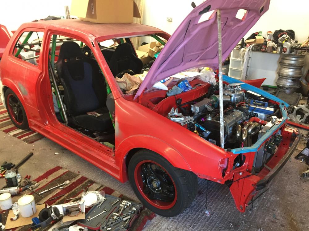

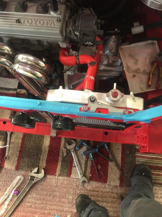

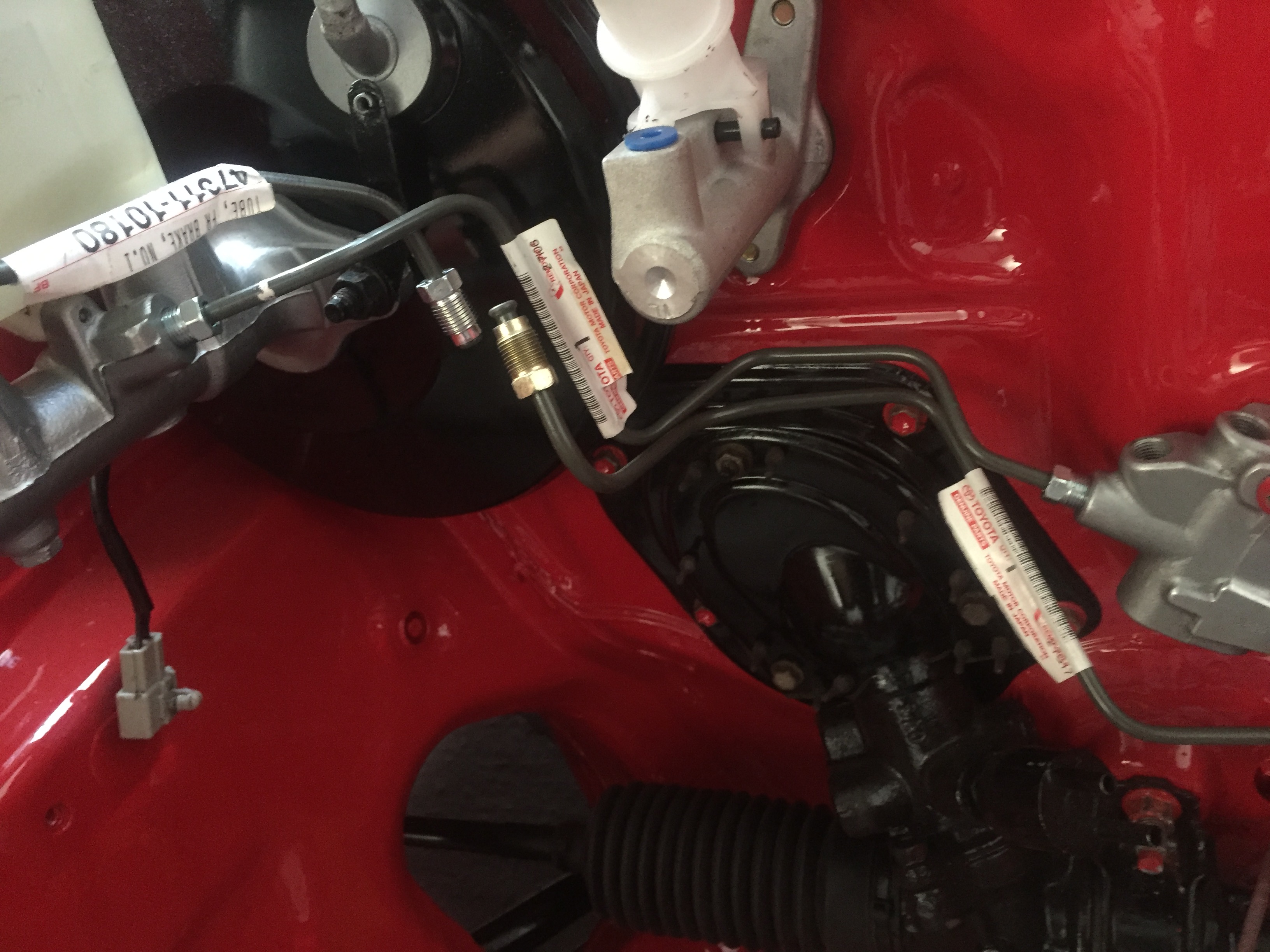

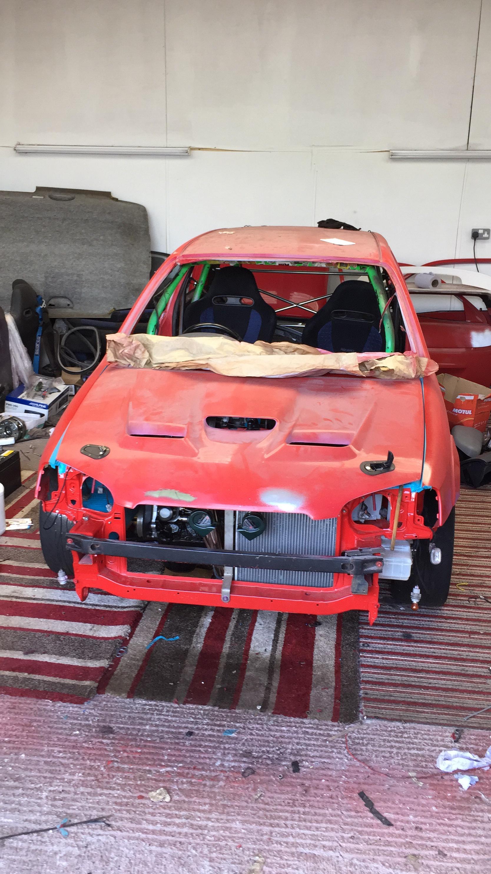

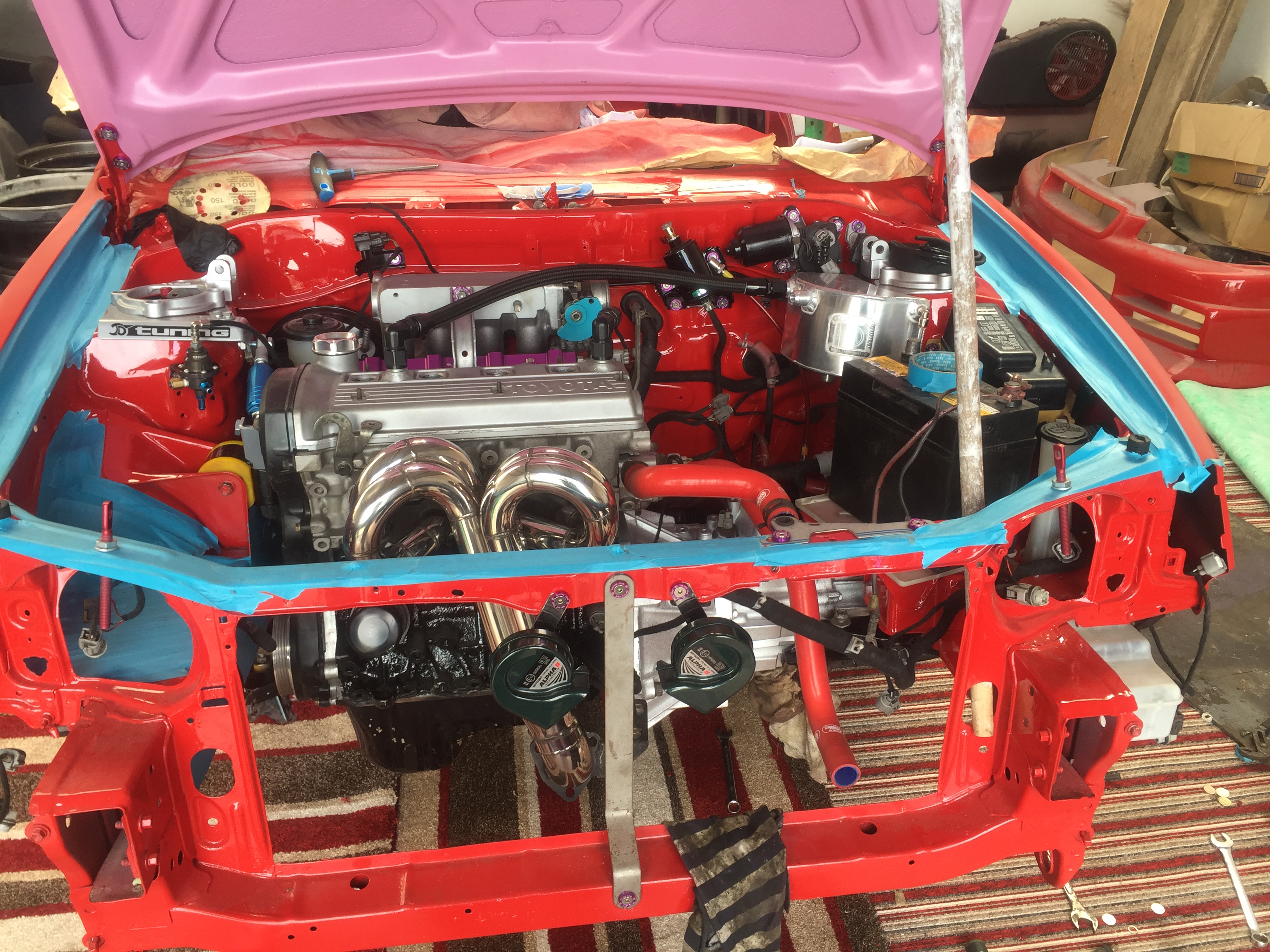

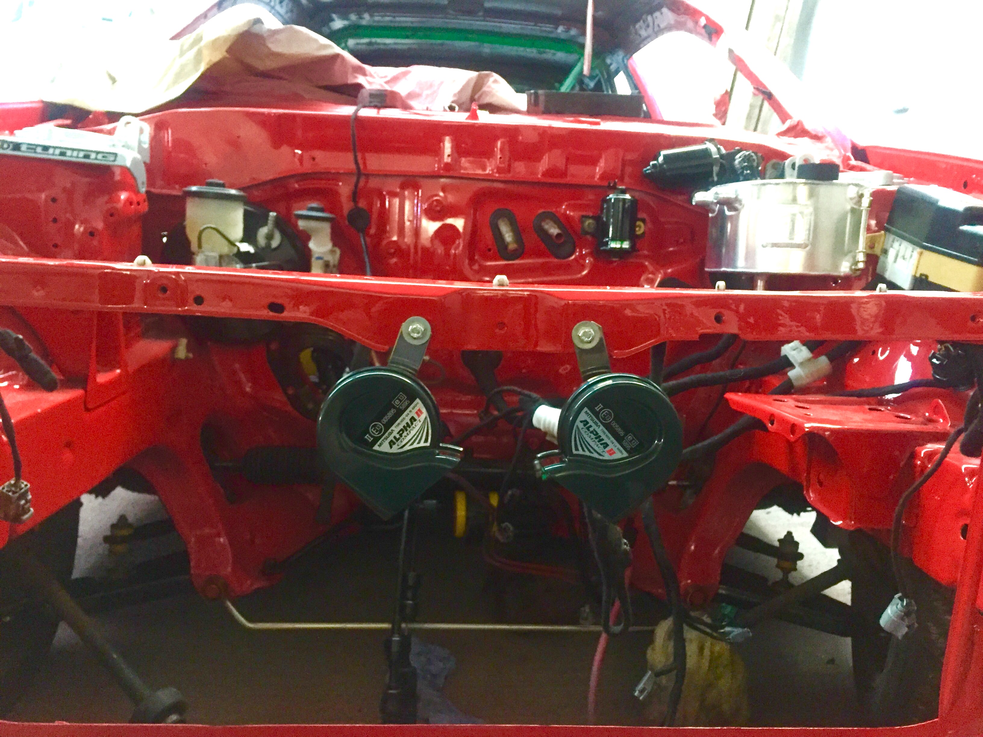

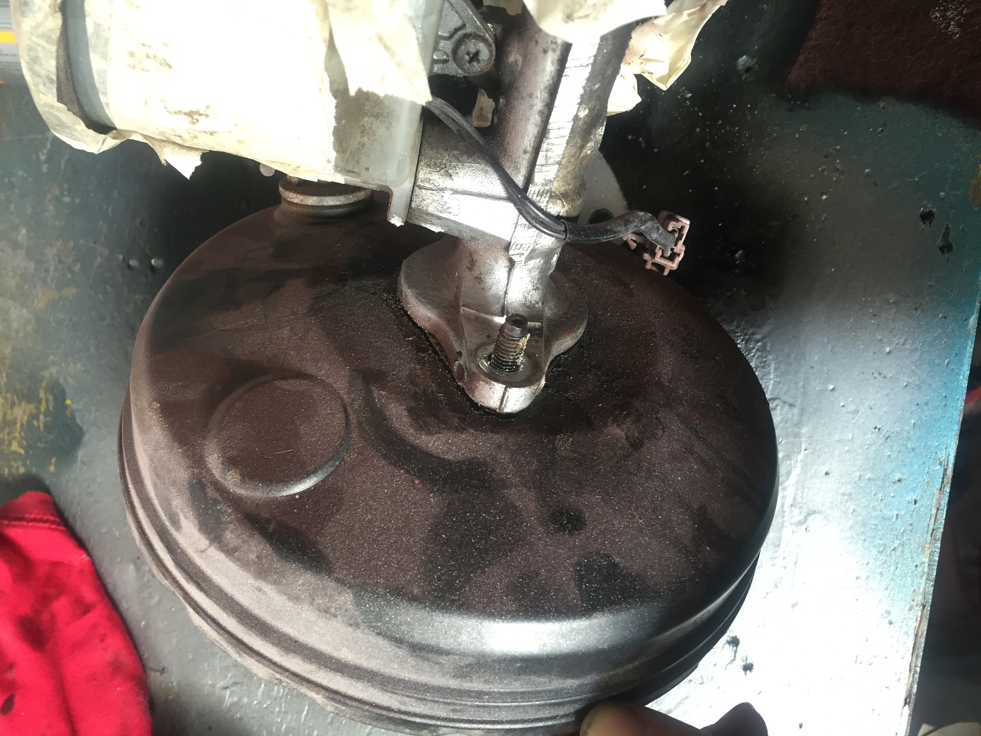

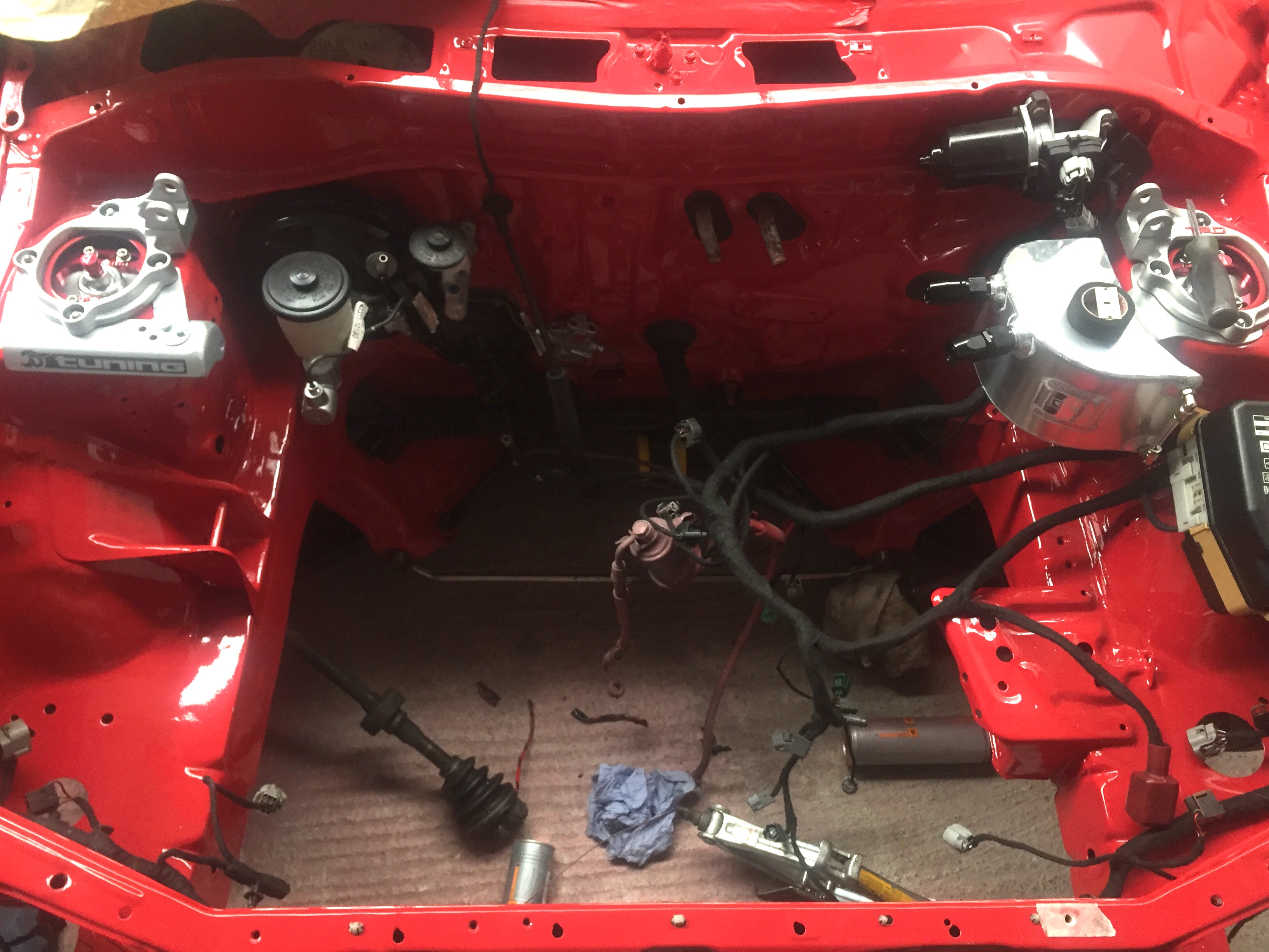

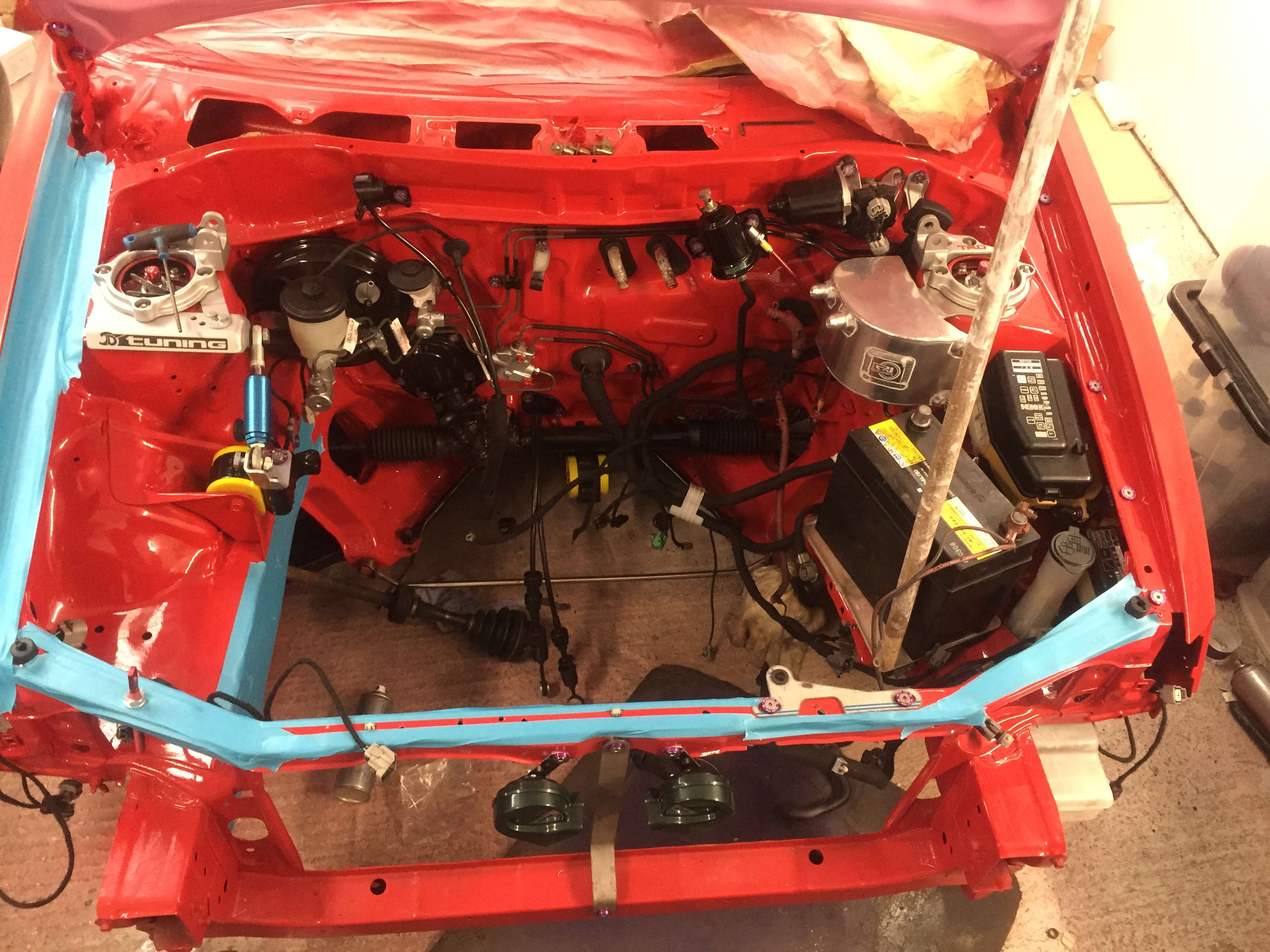

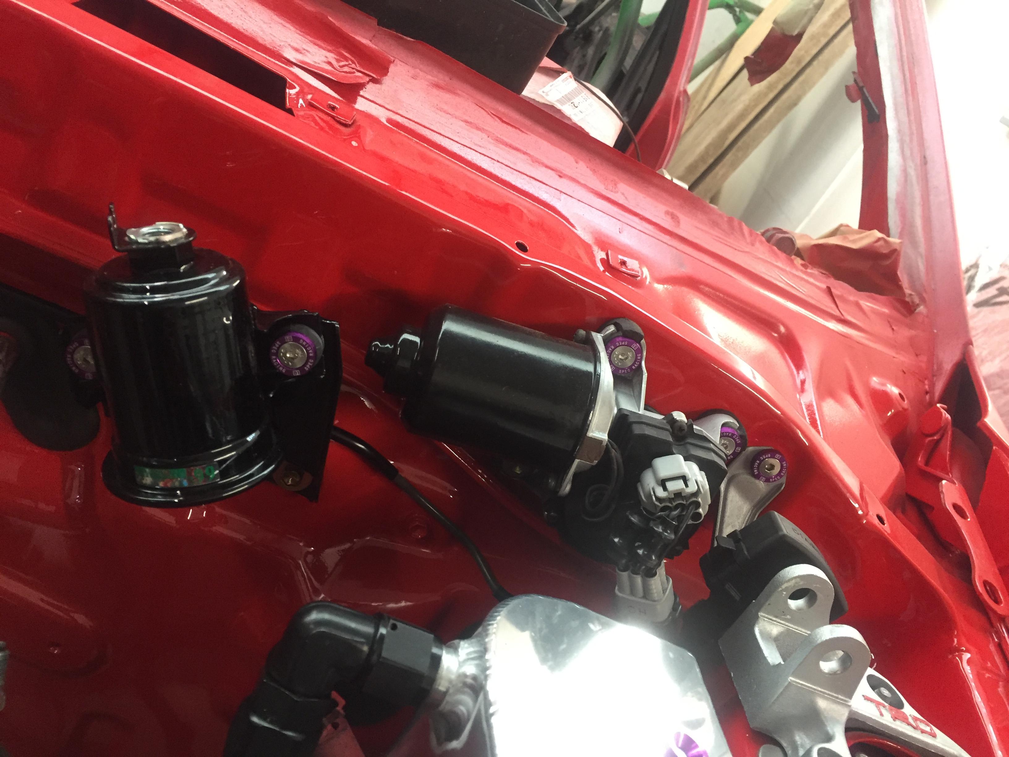

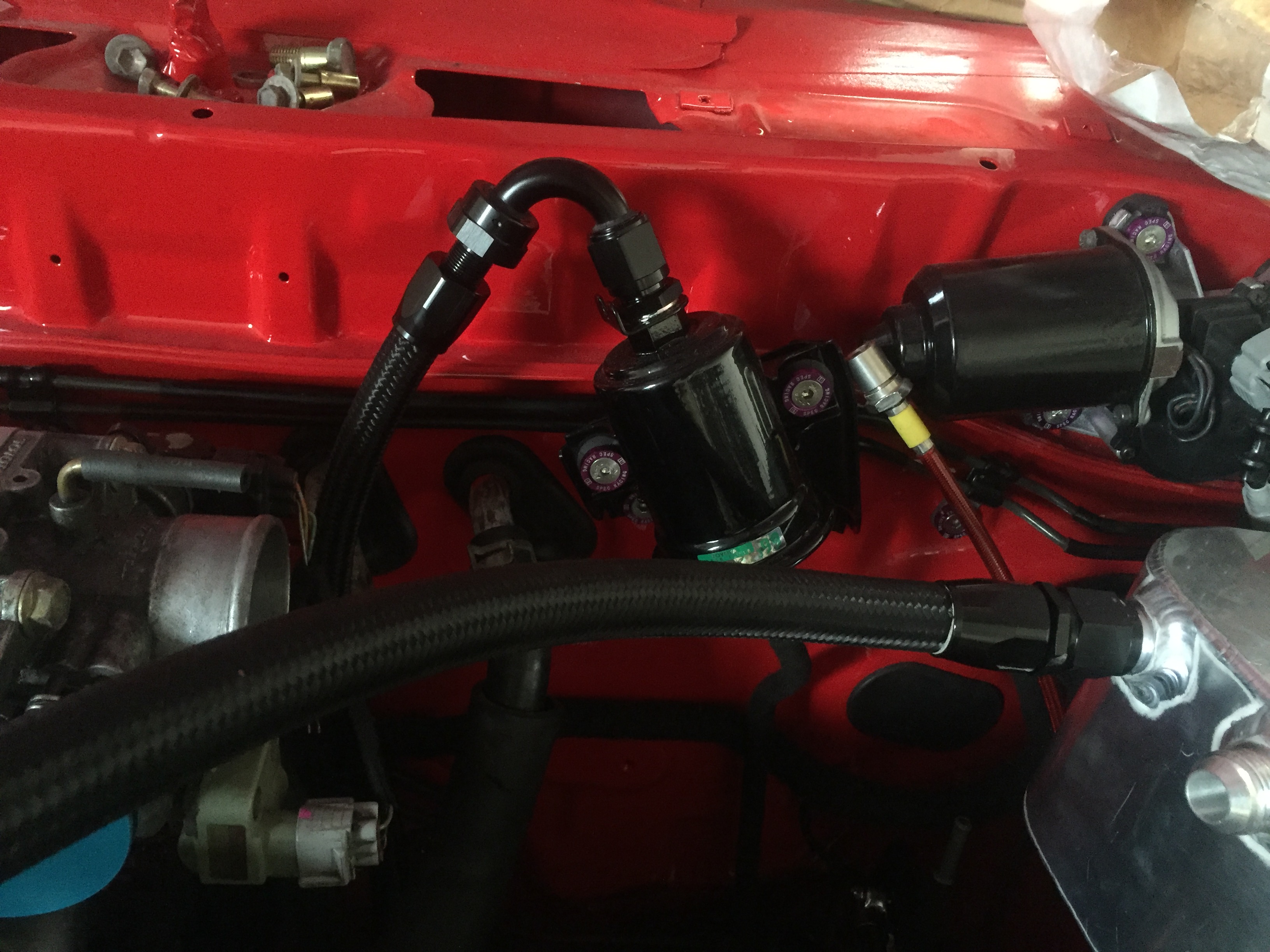

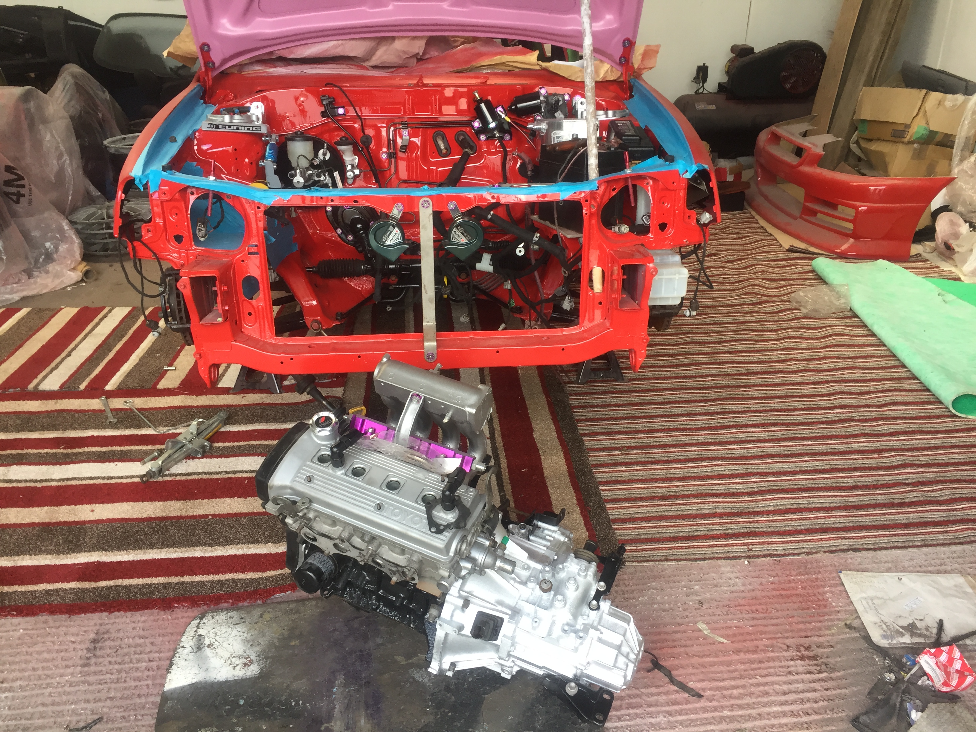

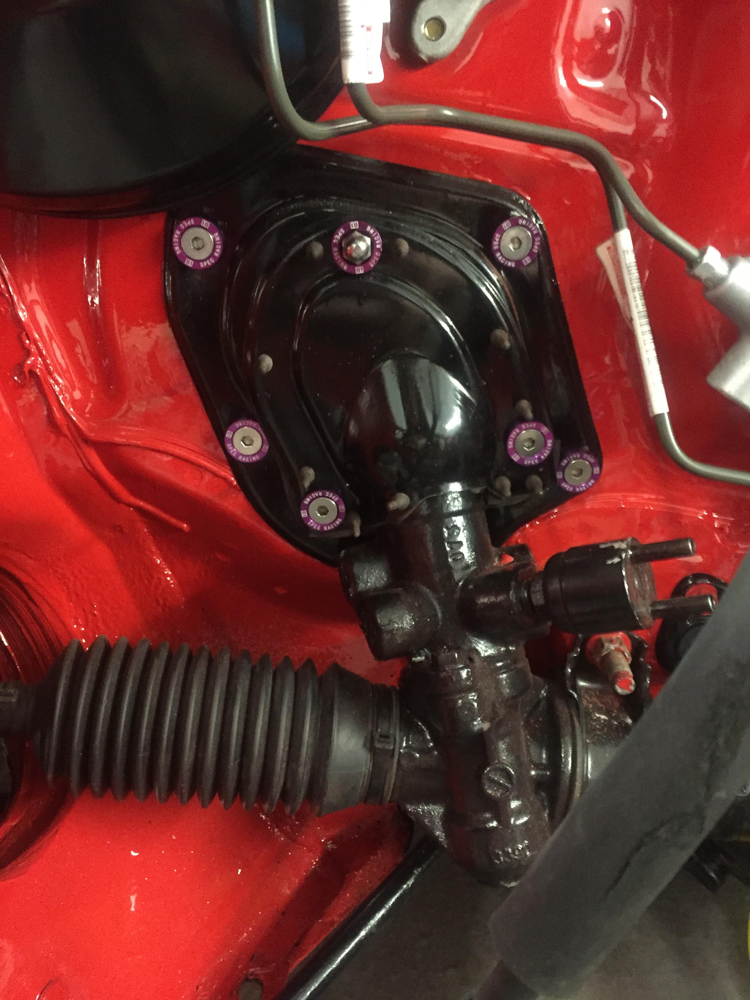

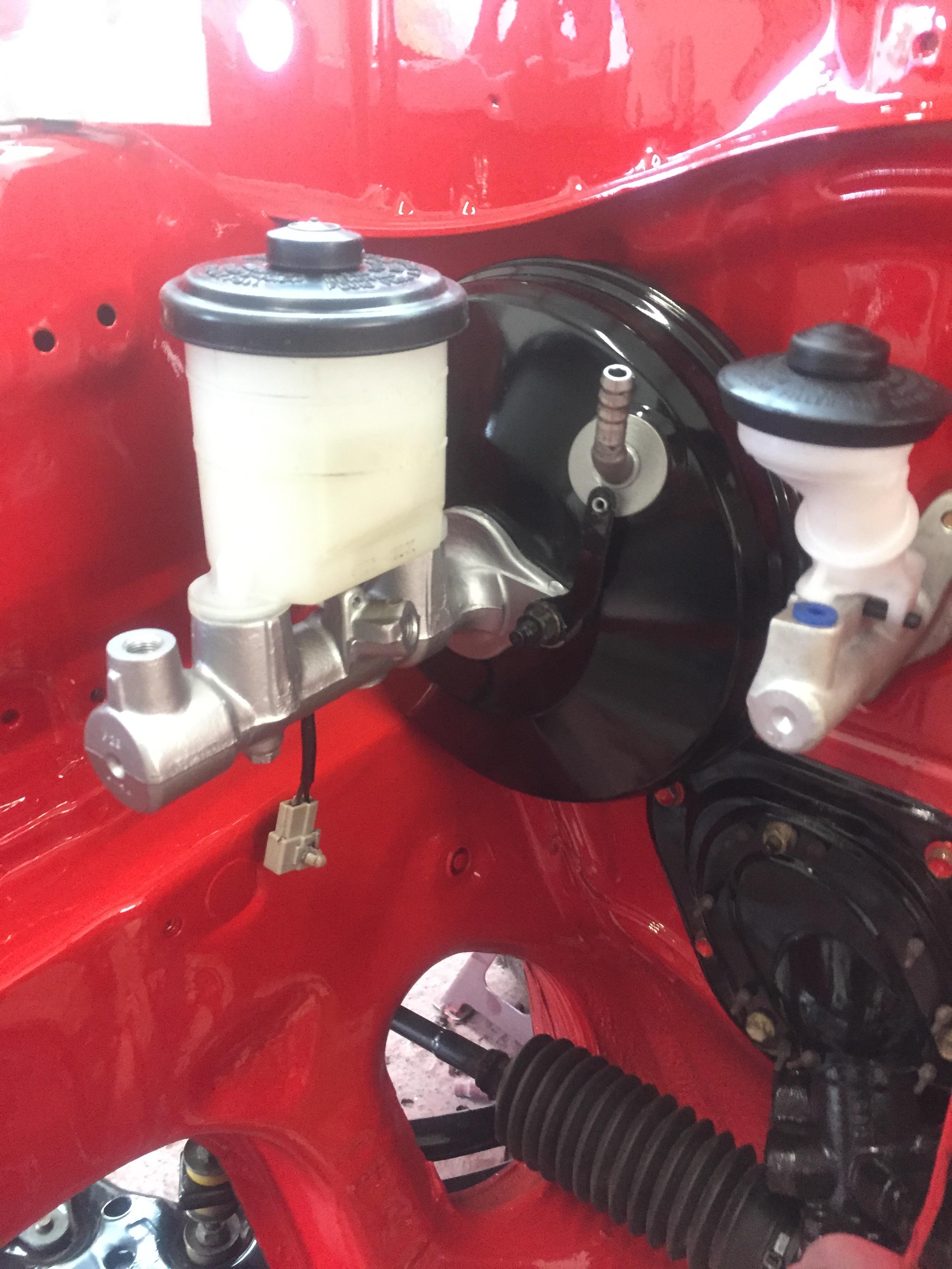

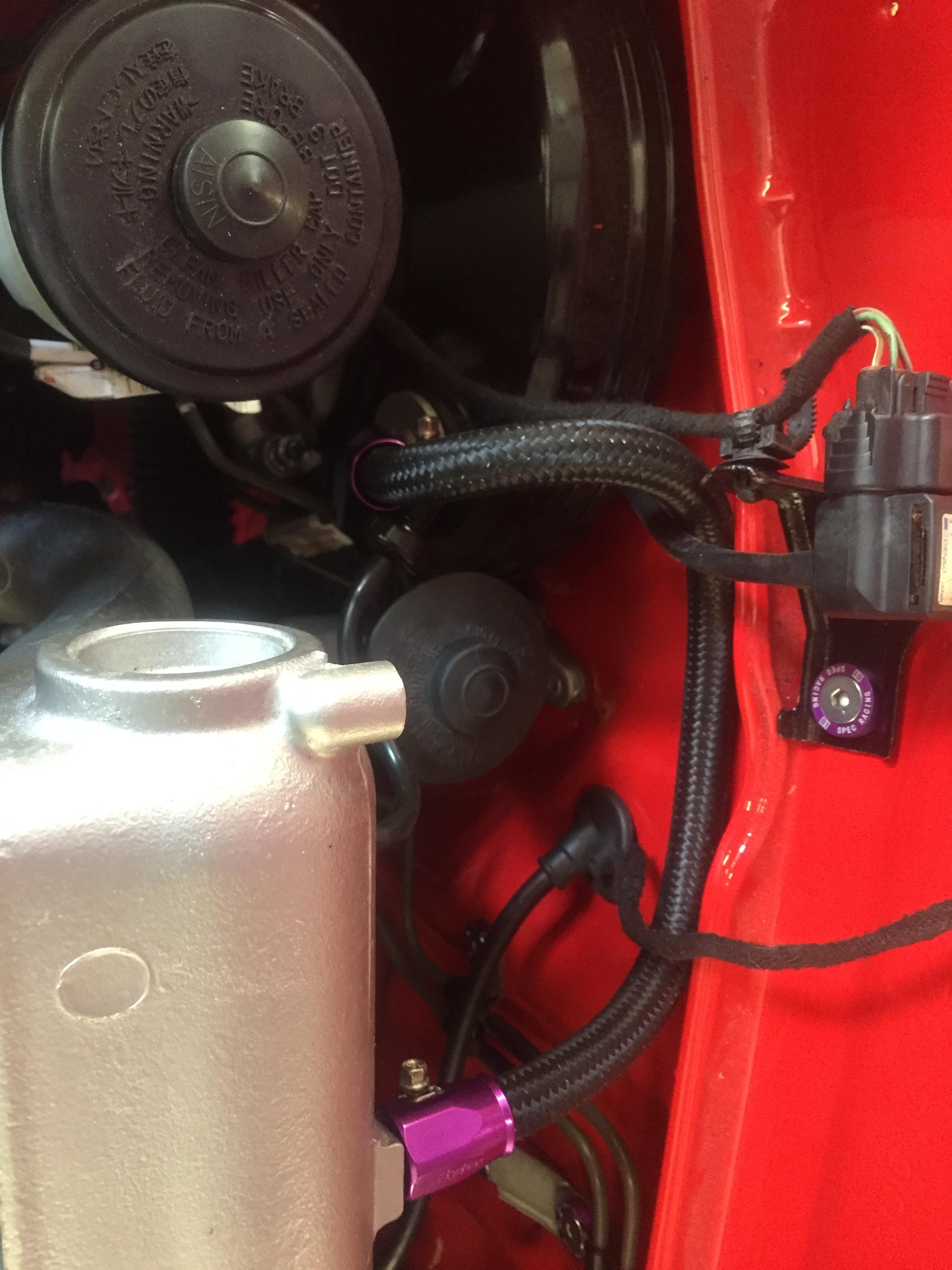

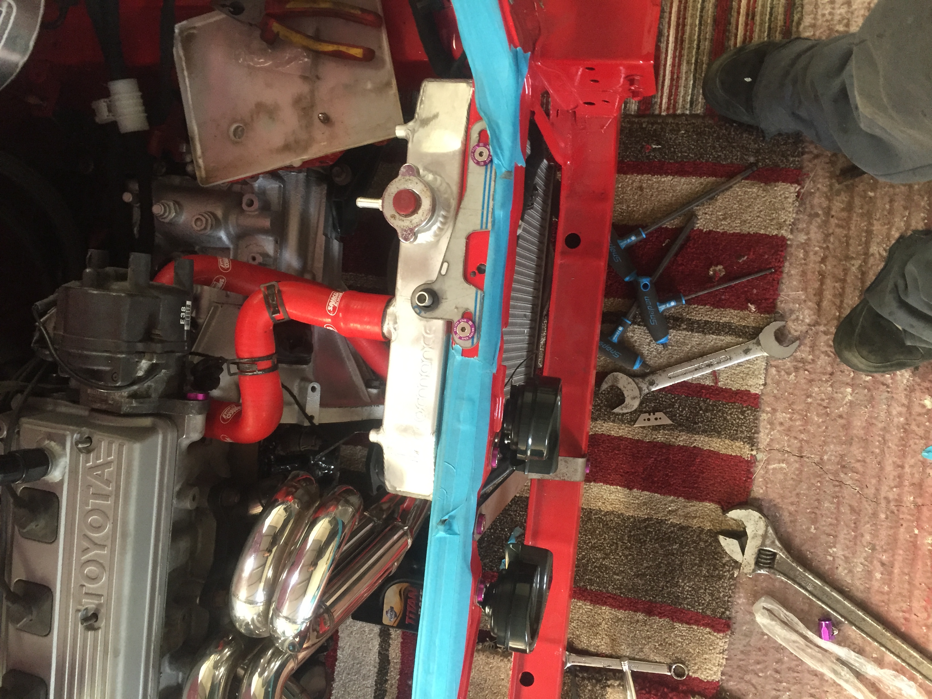

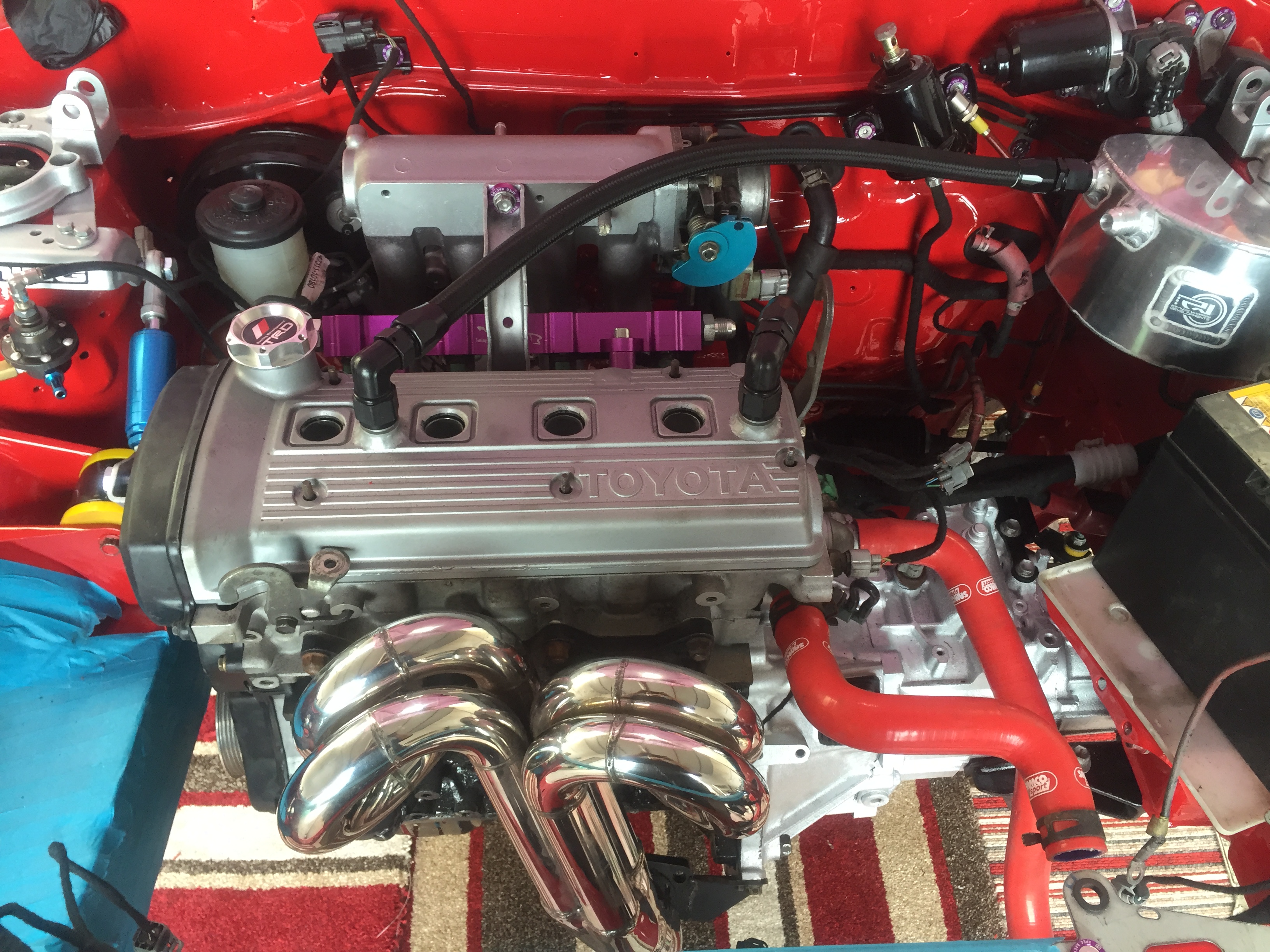

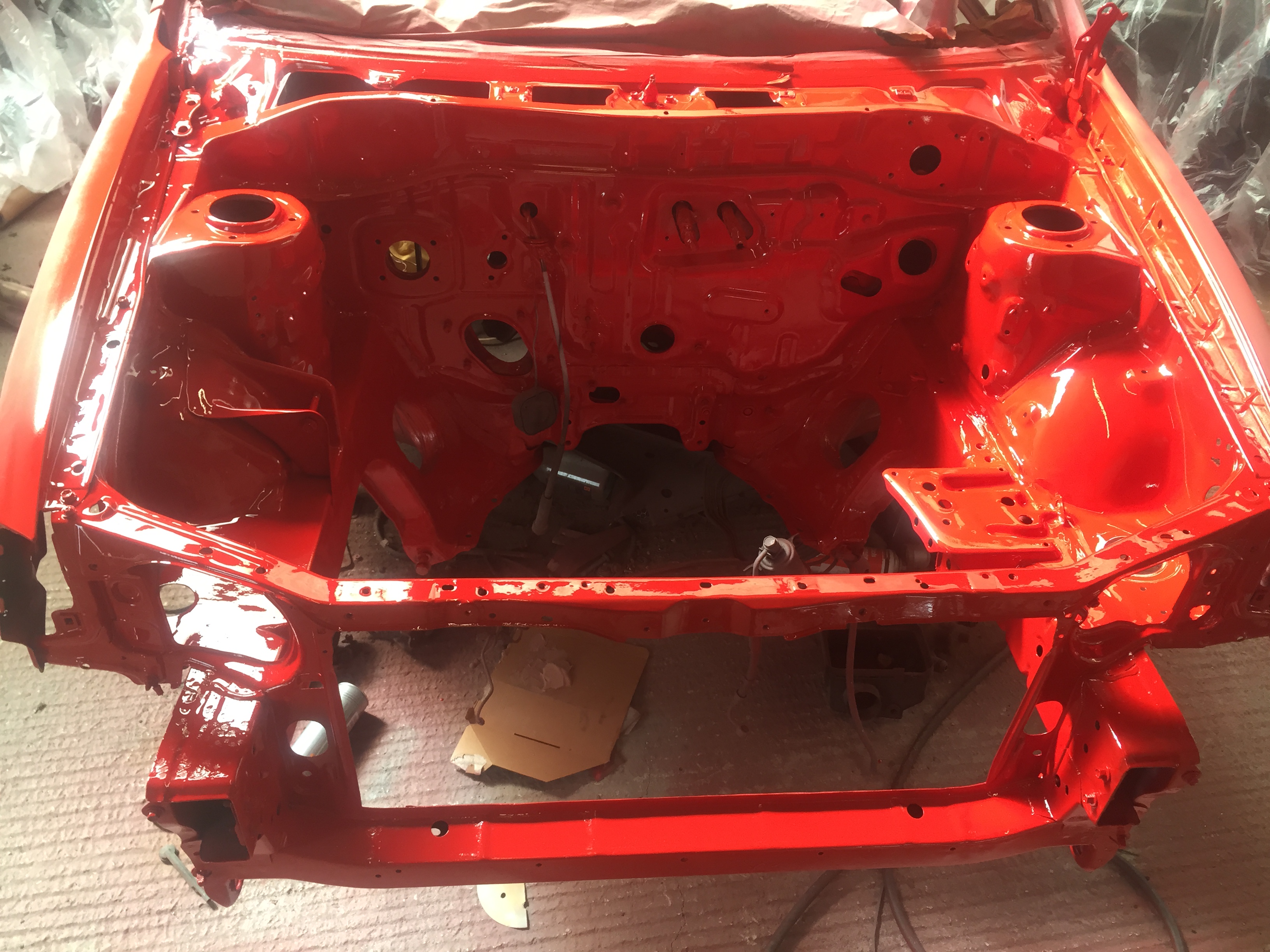

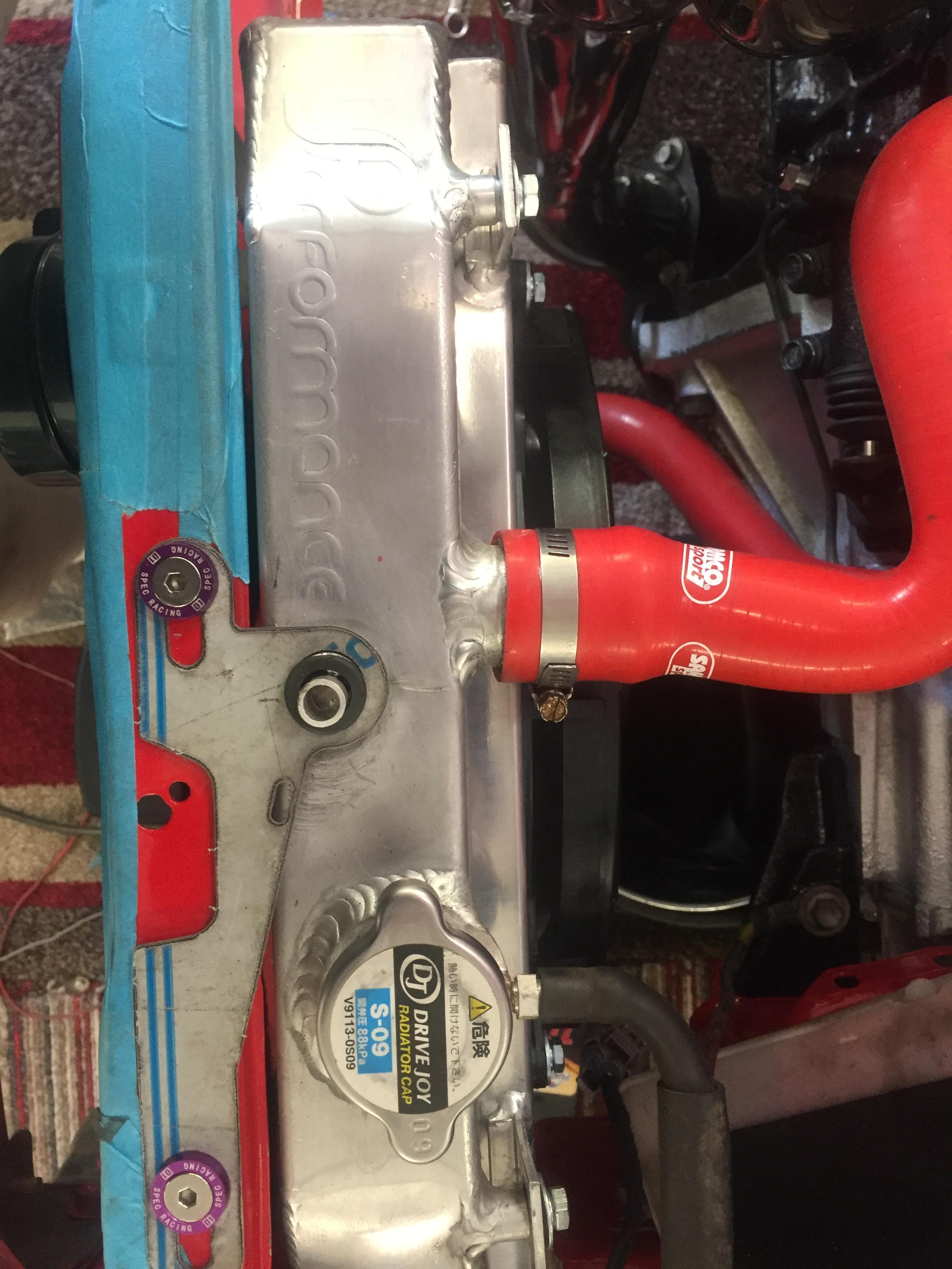

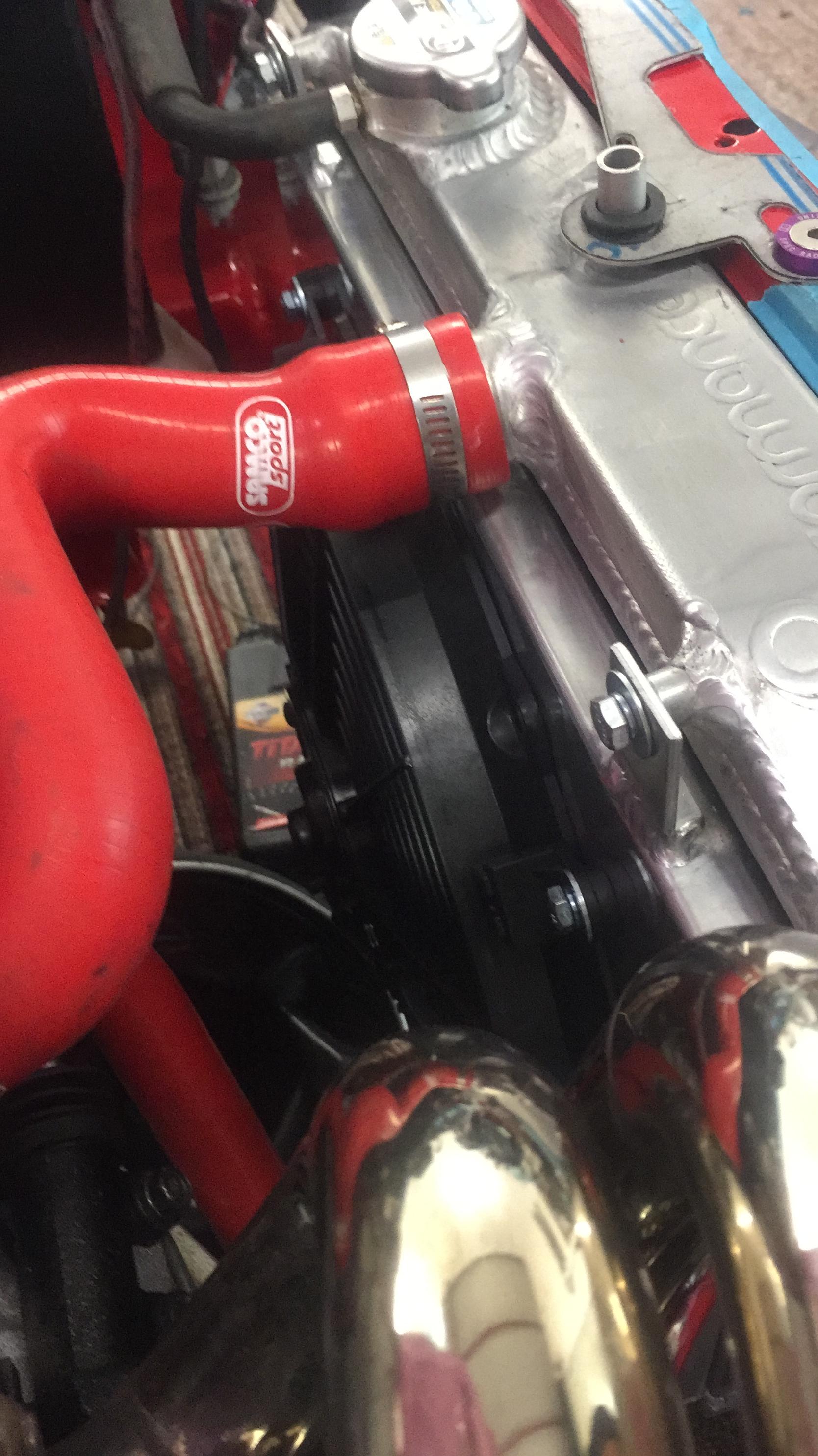

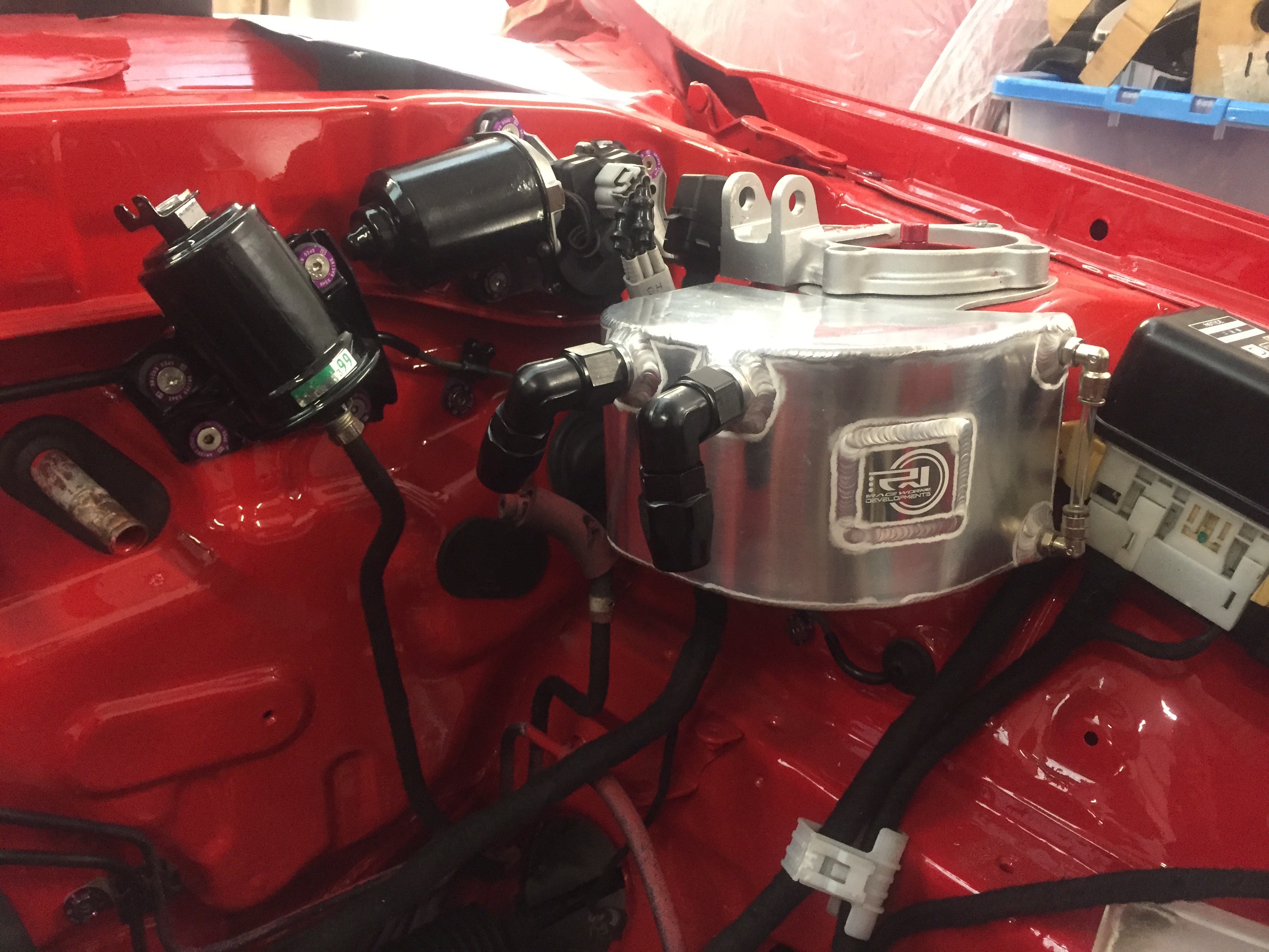

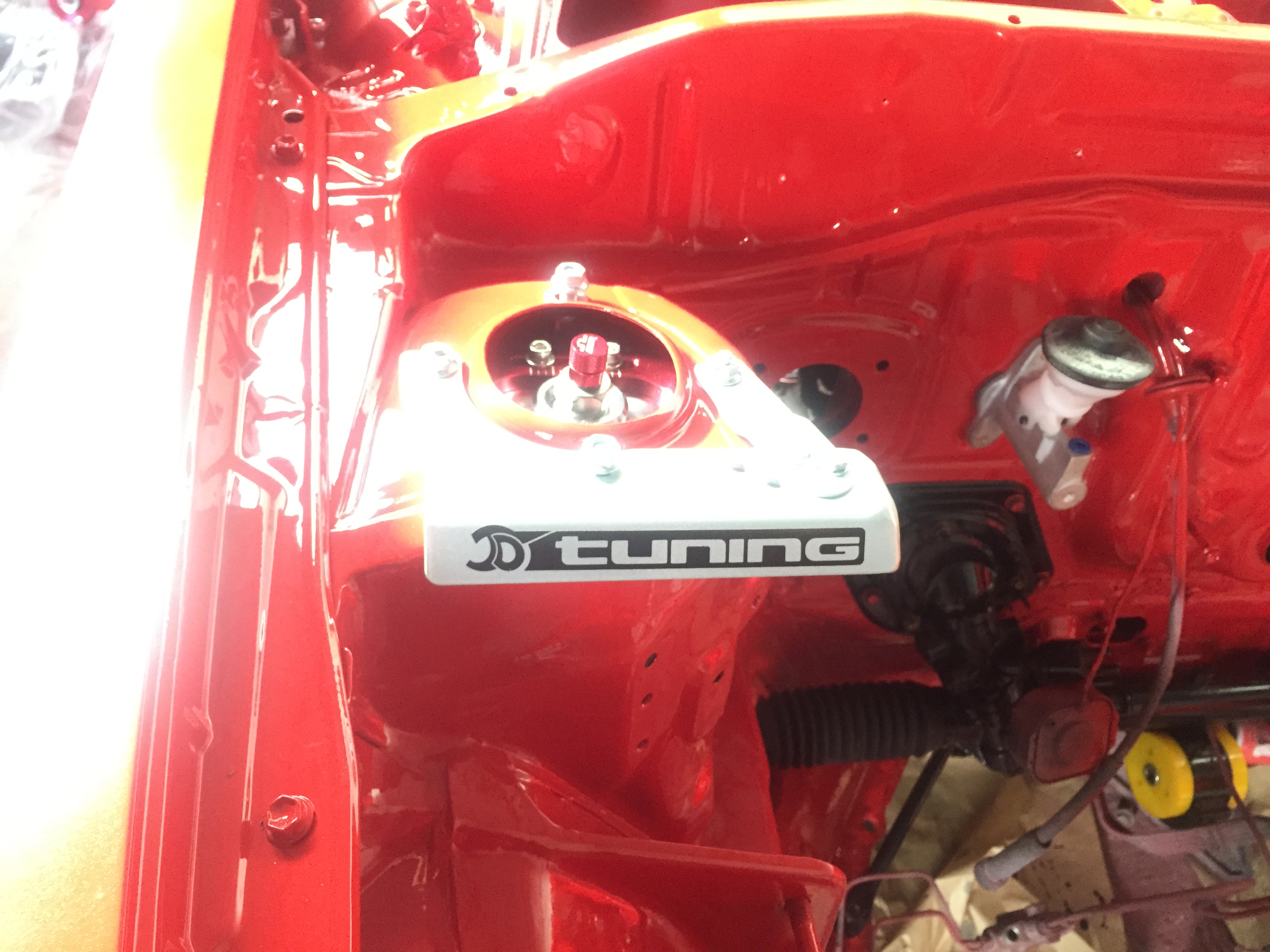

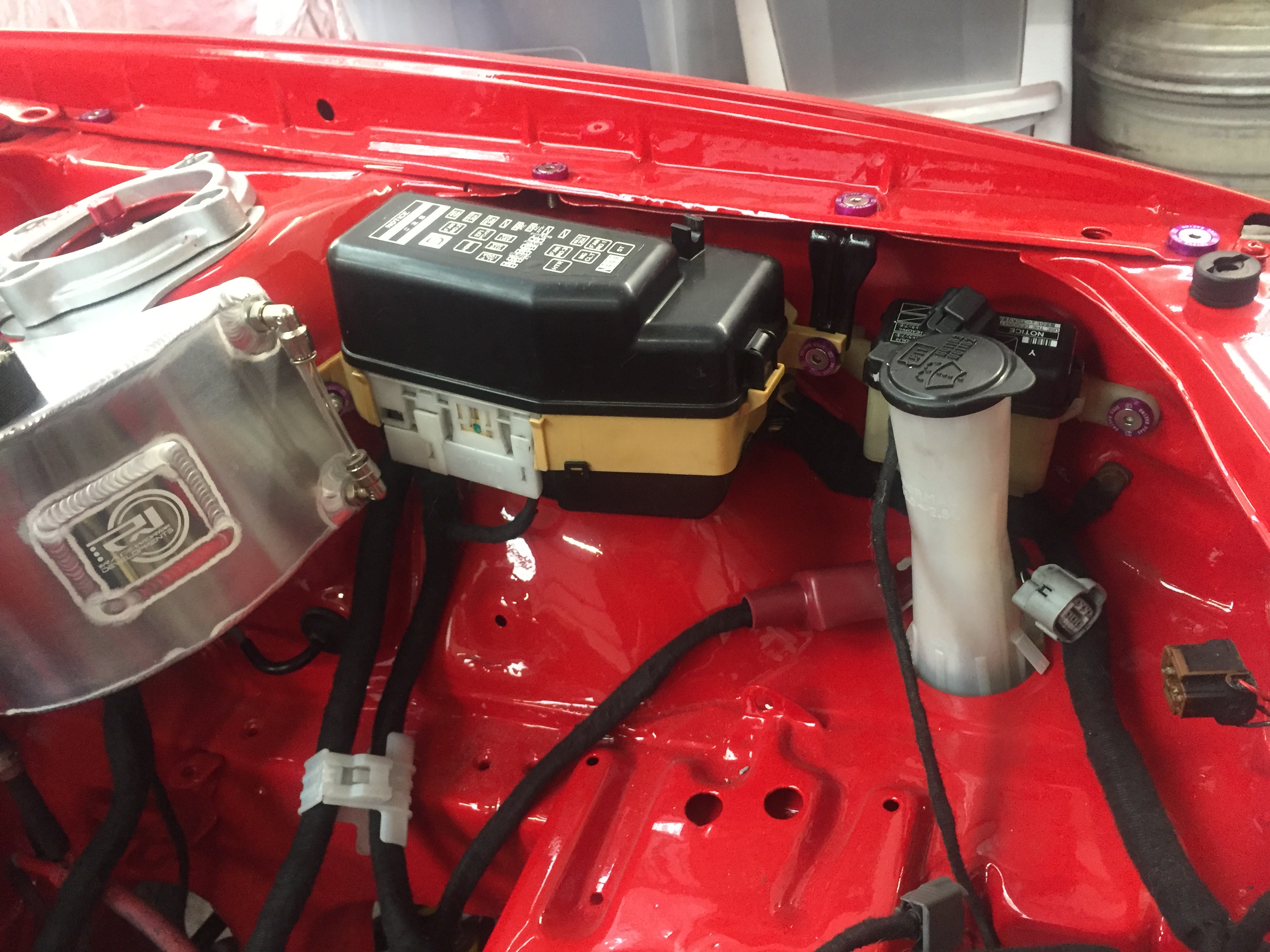

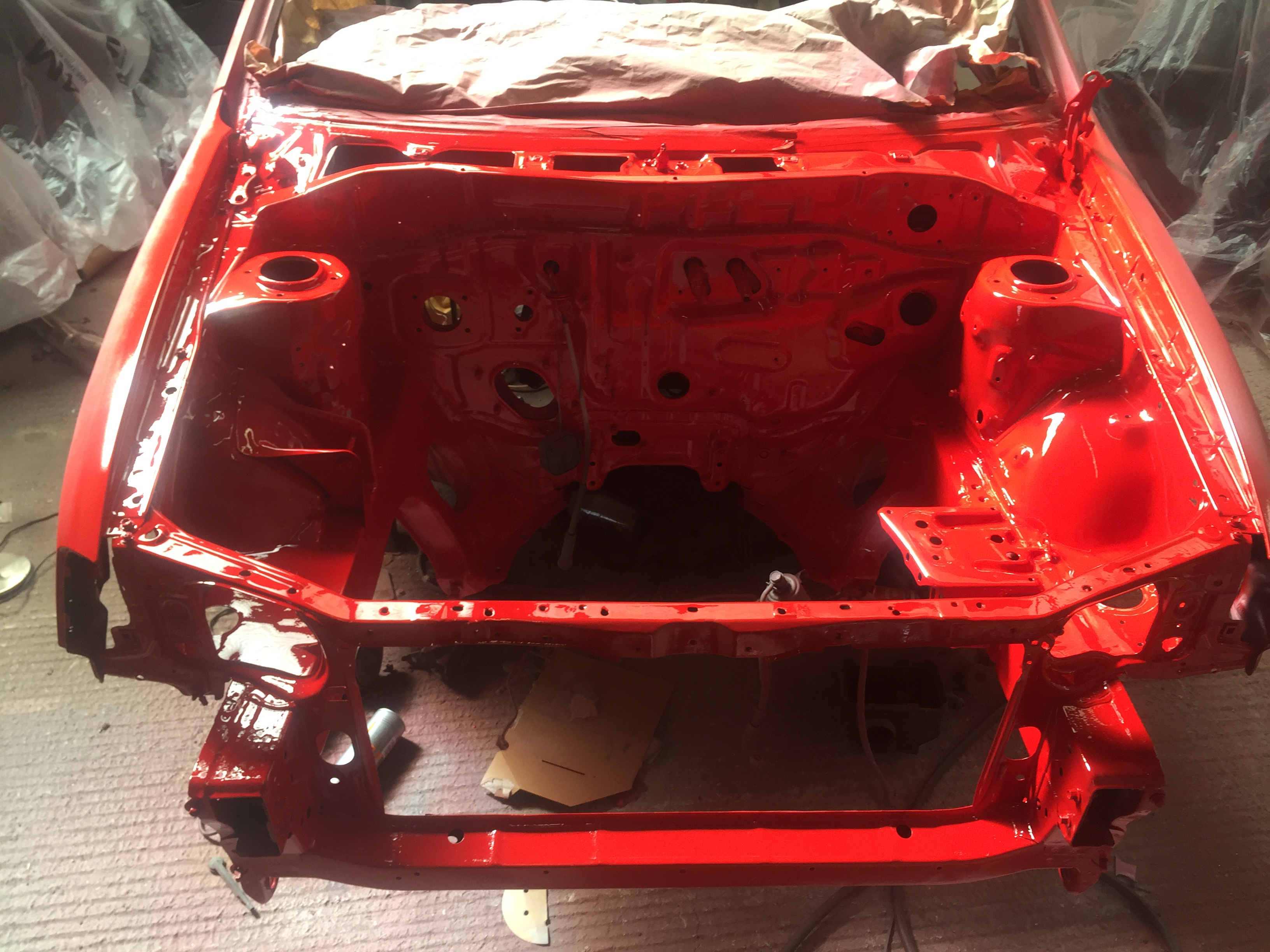

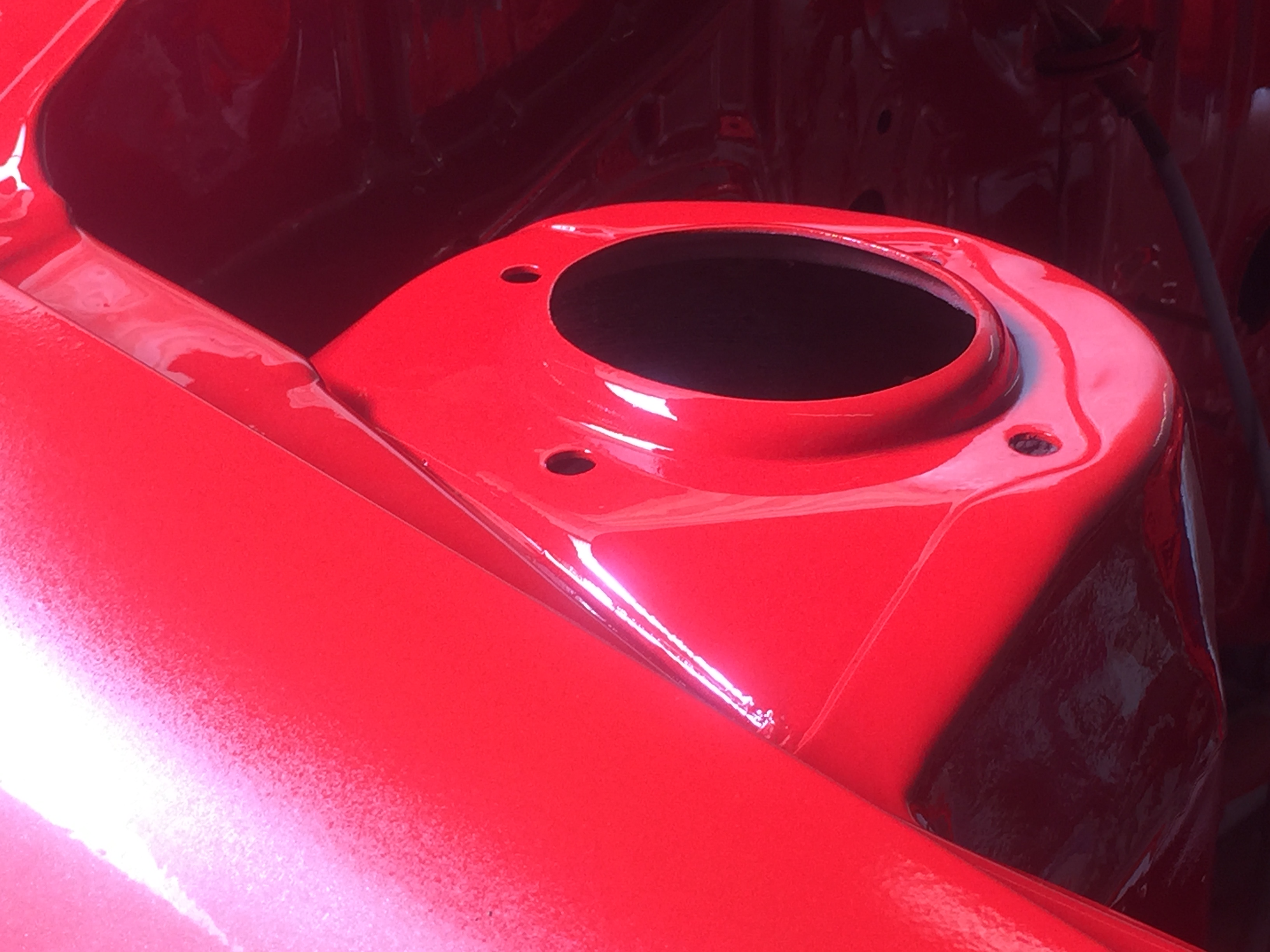

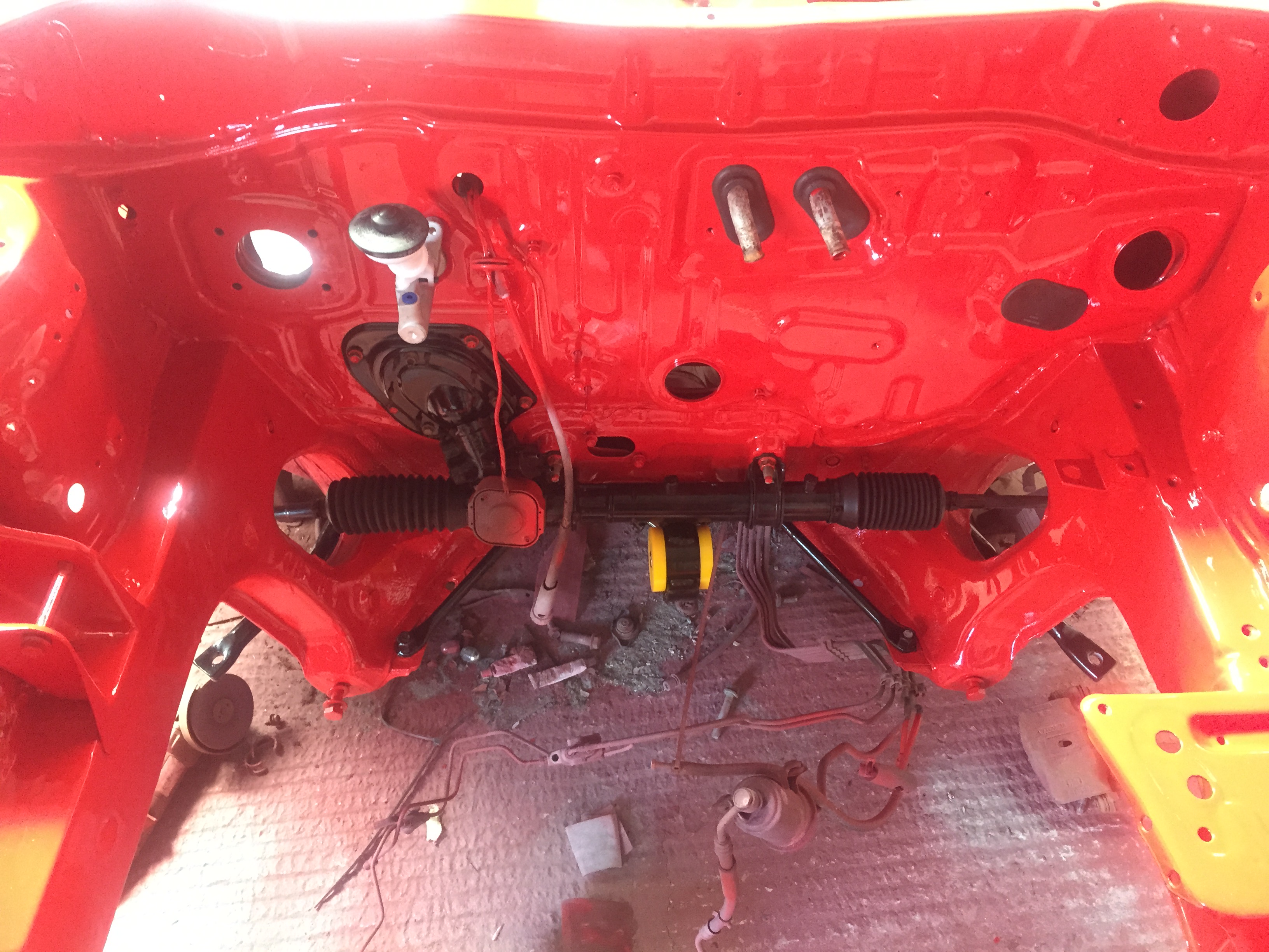

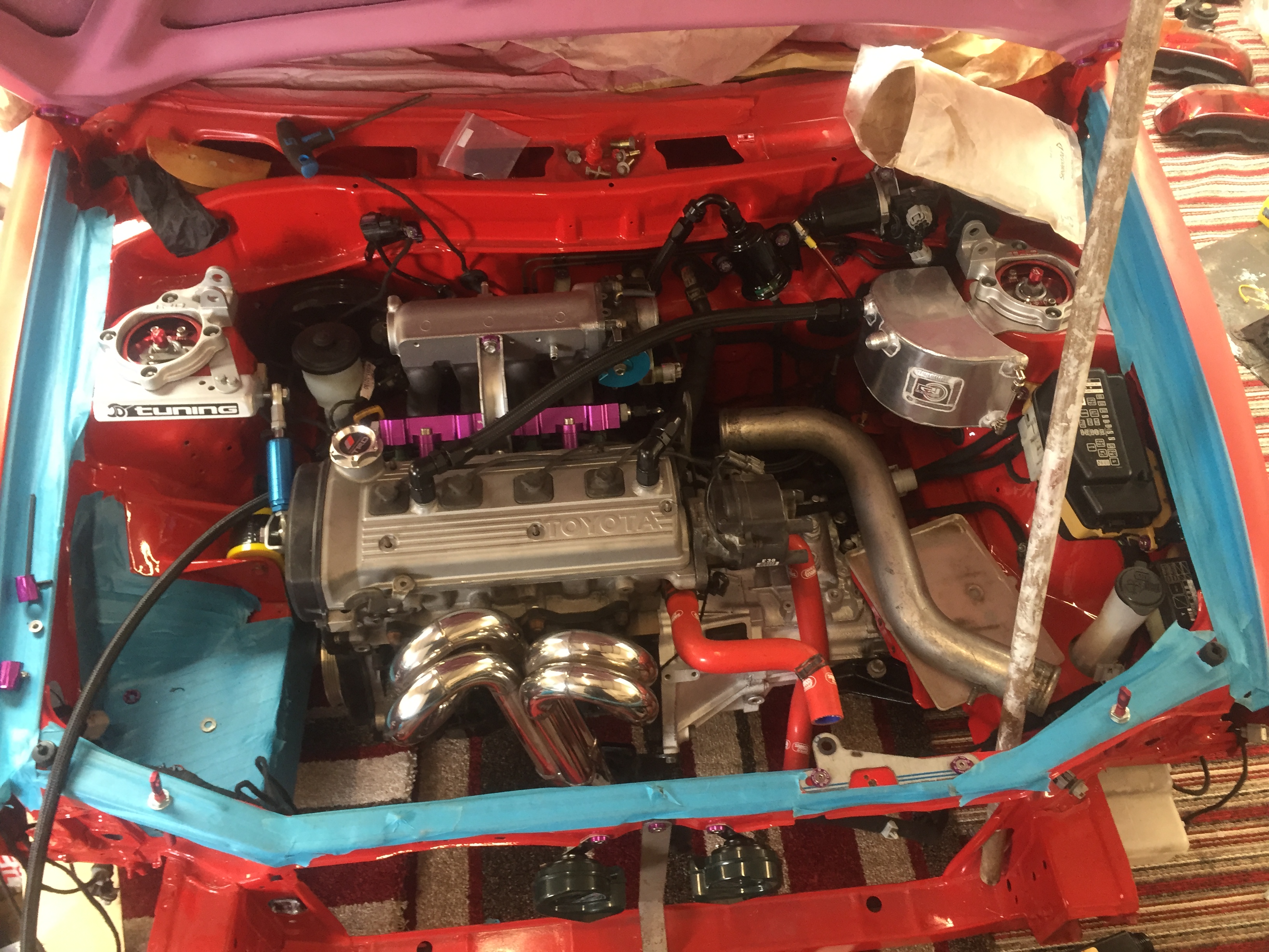

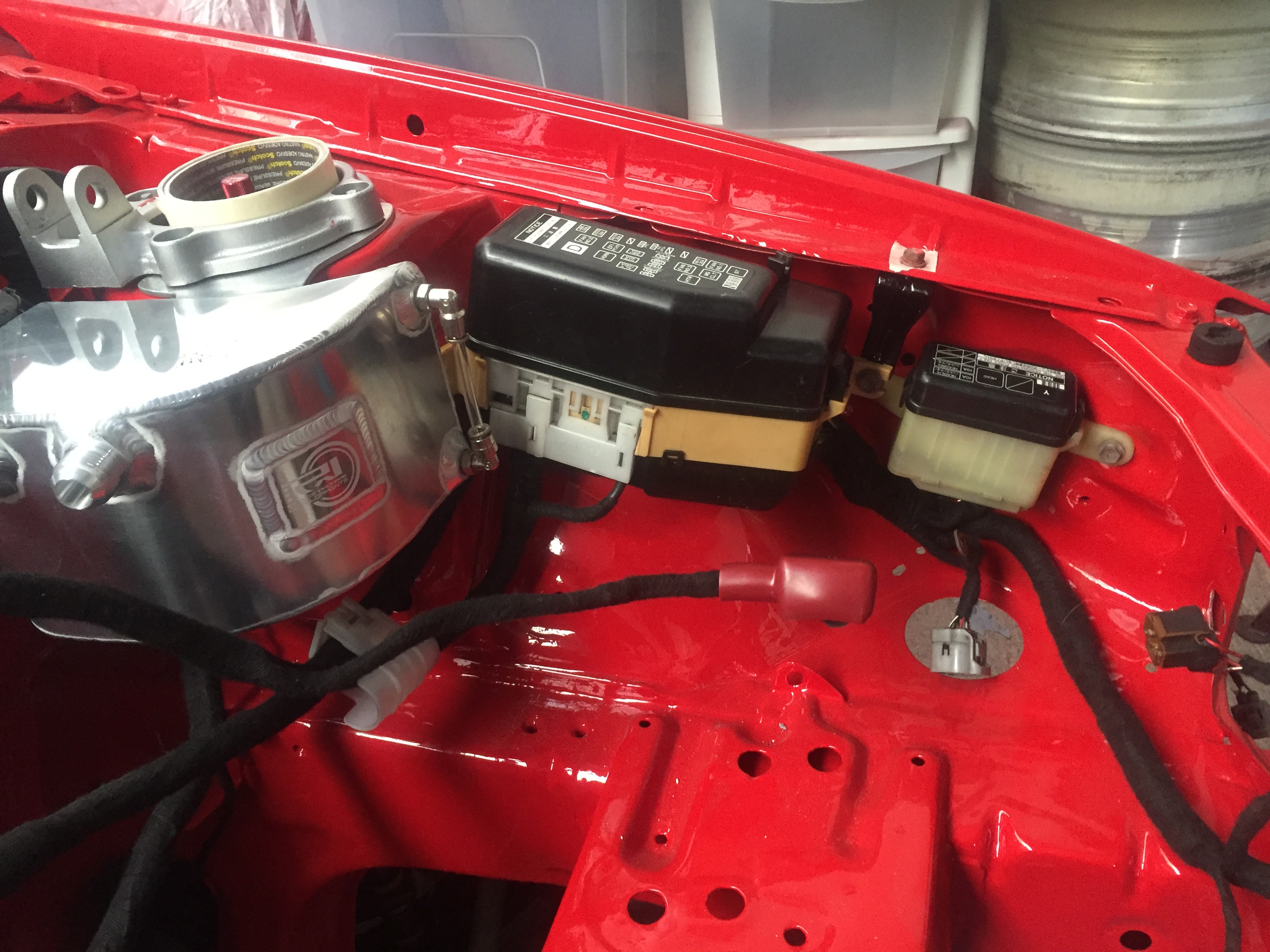

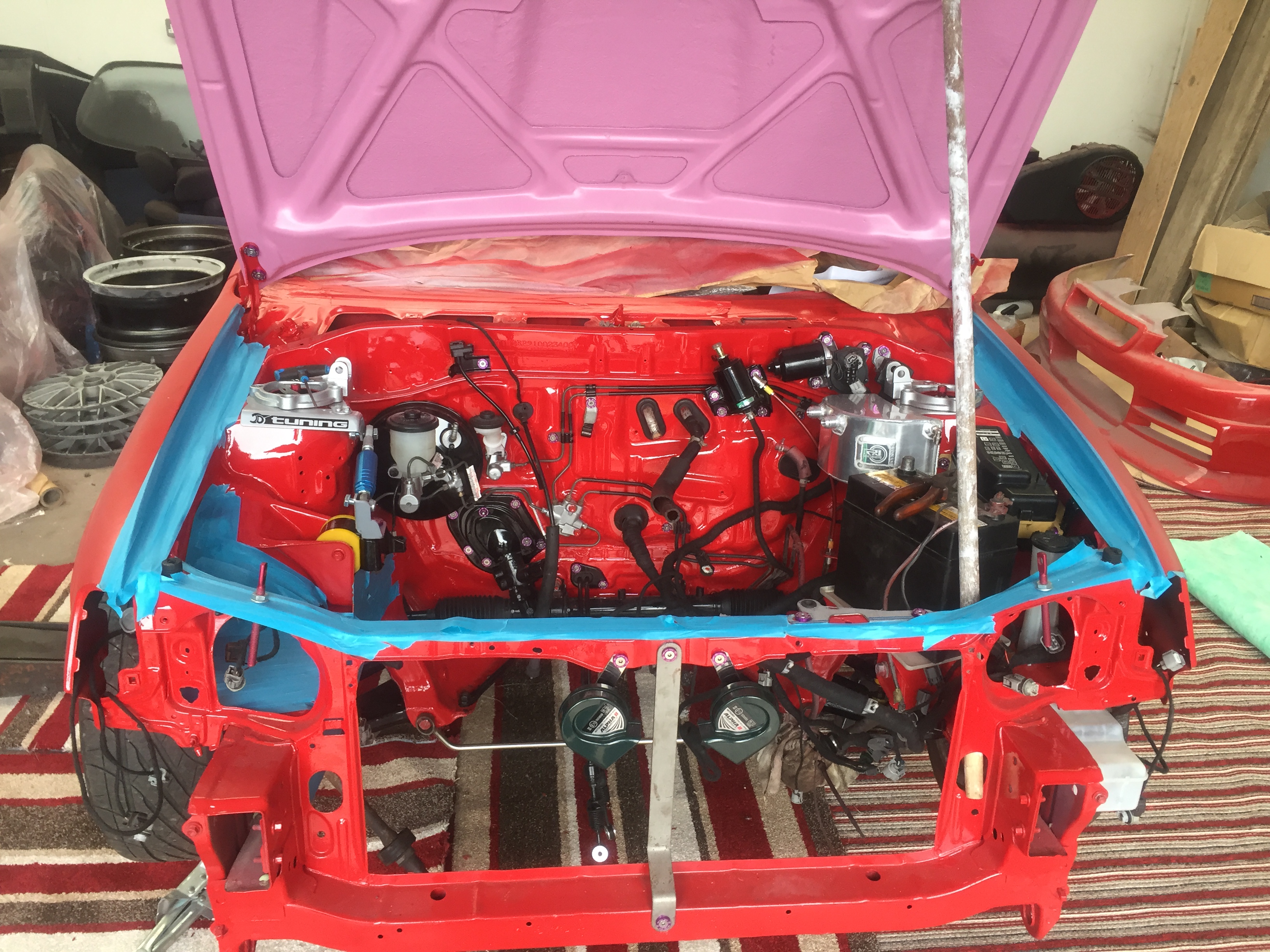

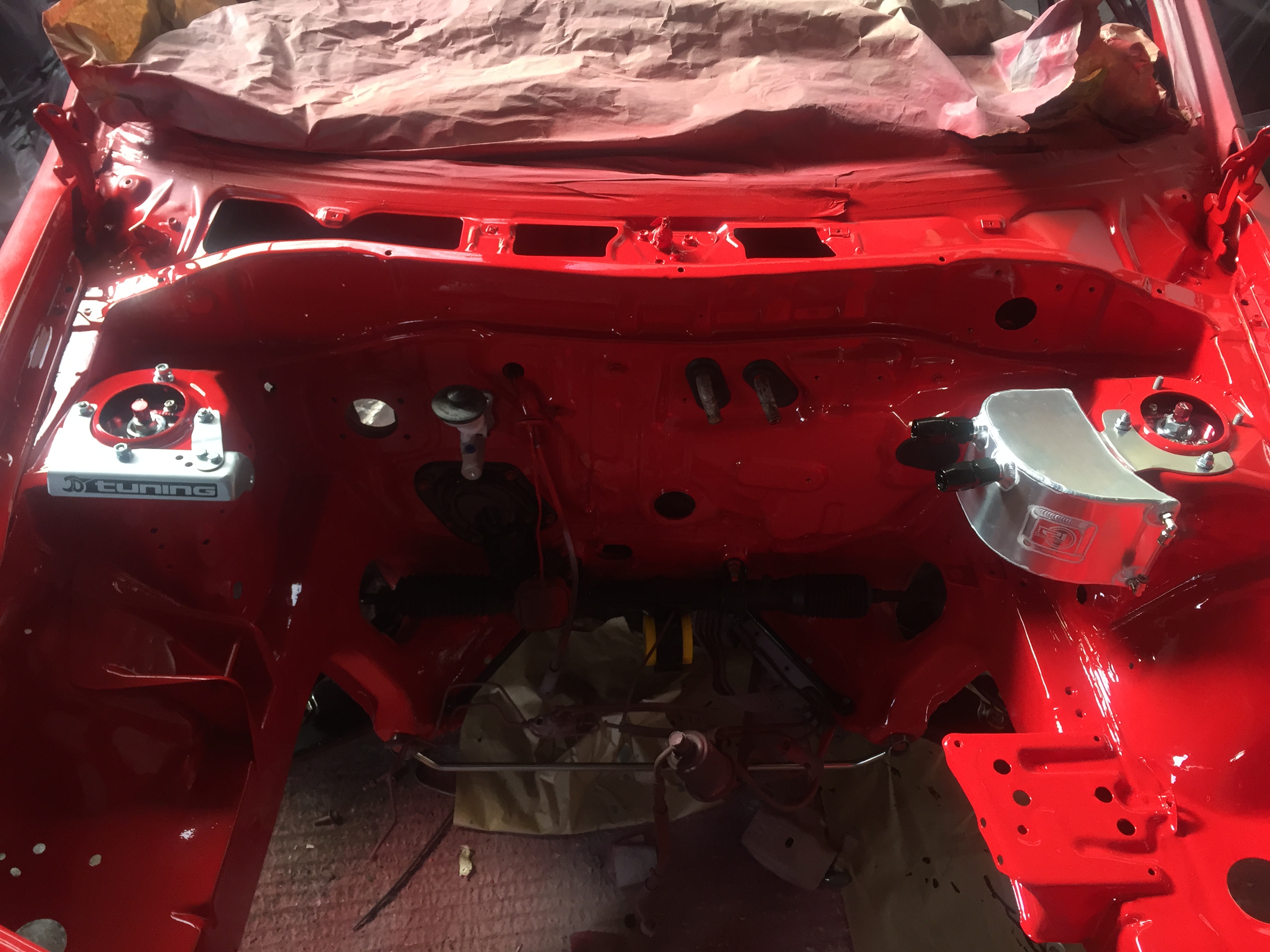

joel_ep91 Posted March 9, 2018 Author Posted March 9, 2018 A paid up member again so now I can share some more photos, here is one or two of the engine bay build up Quote
