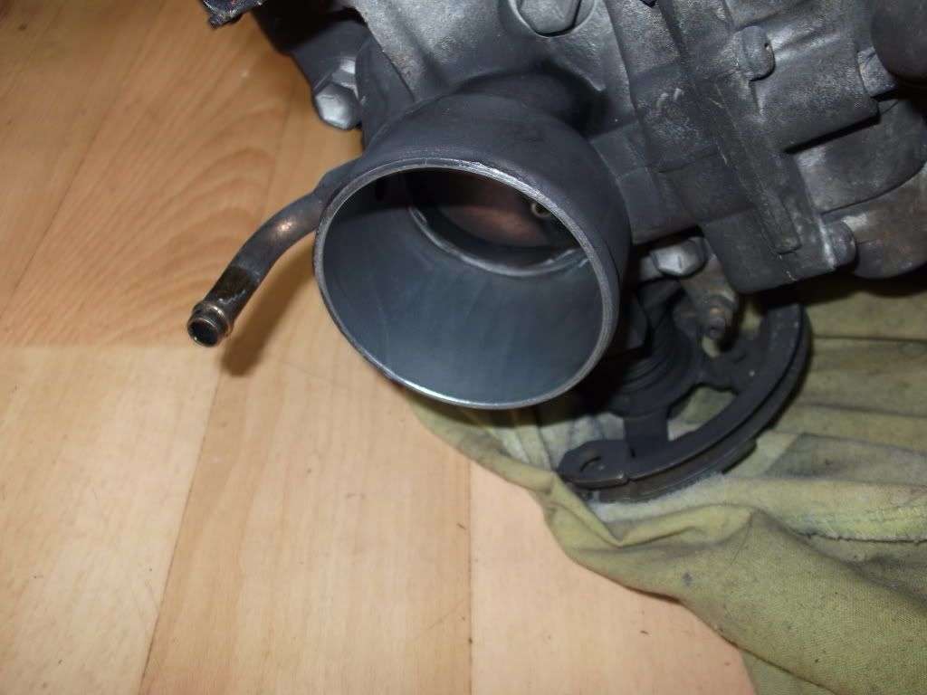

nastyrash 2003 Posted February 10, 2011 Posted February 10, 2011 yep and your head is the first stage 2 i have done ste. = cutting back inlet valve guids to match ports, just remember to prime everything with oil mate and disconect your injectors in order not to flood with fuel. + i would recomend cleaning out the throttle body was very dirty!!!. enjoy fella and u got my number if u need my help. Quote
Steve GT Posted February 10, 2011 Author Posted February 10, 2011 haha awesome well ive got dibs on this hollandguys one if he is a genuine seller etc ill snap it outta his hands then, just hope my turbo lasts lolGood man hope you get it yep and your head is the first stage 2 i have done ste. = cutting back inlet valve guids to match ports, just remember to prime everything with oil mate and disconect your injectors in order not to flood with fuel. + i would recomend cleaning out the throttle body was very dirty!!!. enjoy fella and u got my number if u need my help.Cheers matey i will take no chances when it comes to starting it up dont worry. and yeah il give it a clean. everything will be getting a good clean and polish today Quote

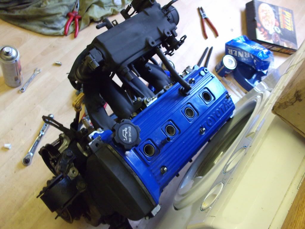

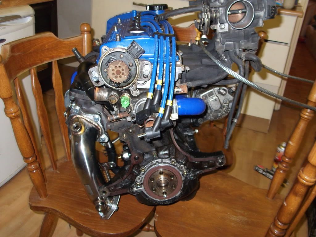

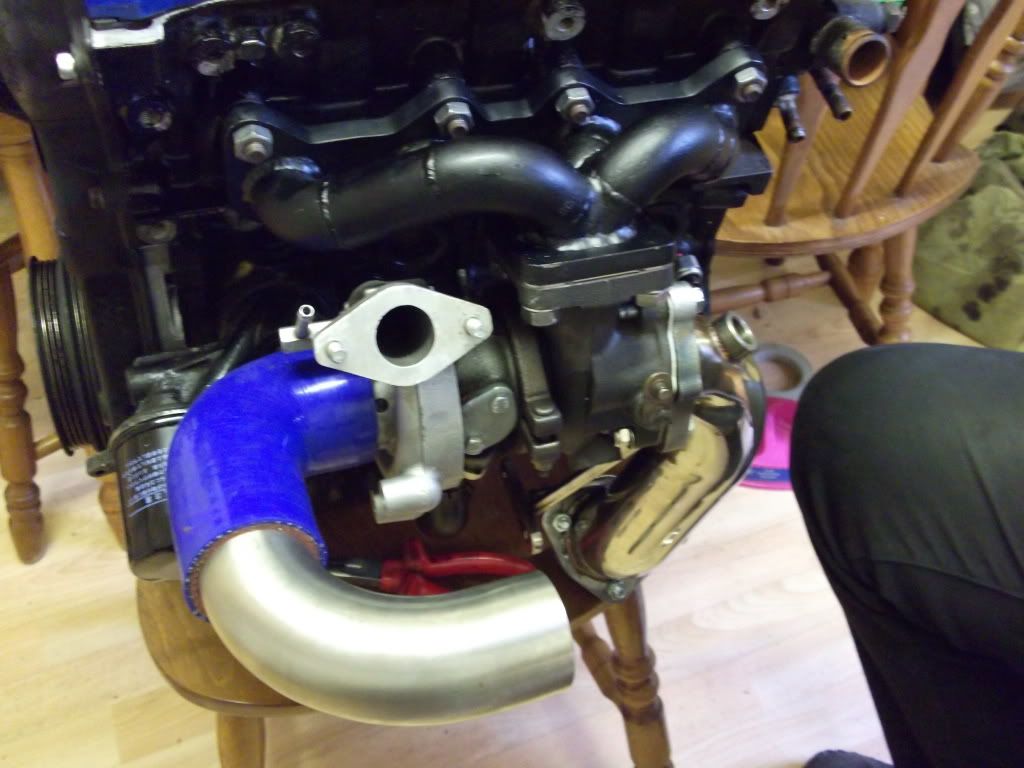

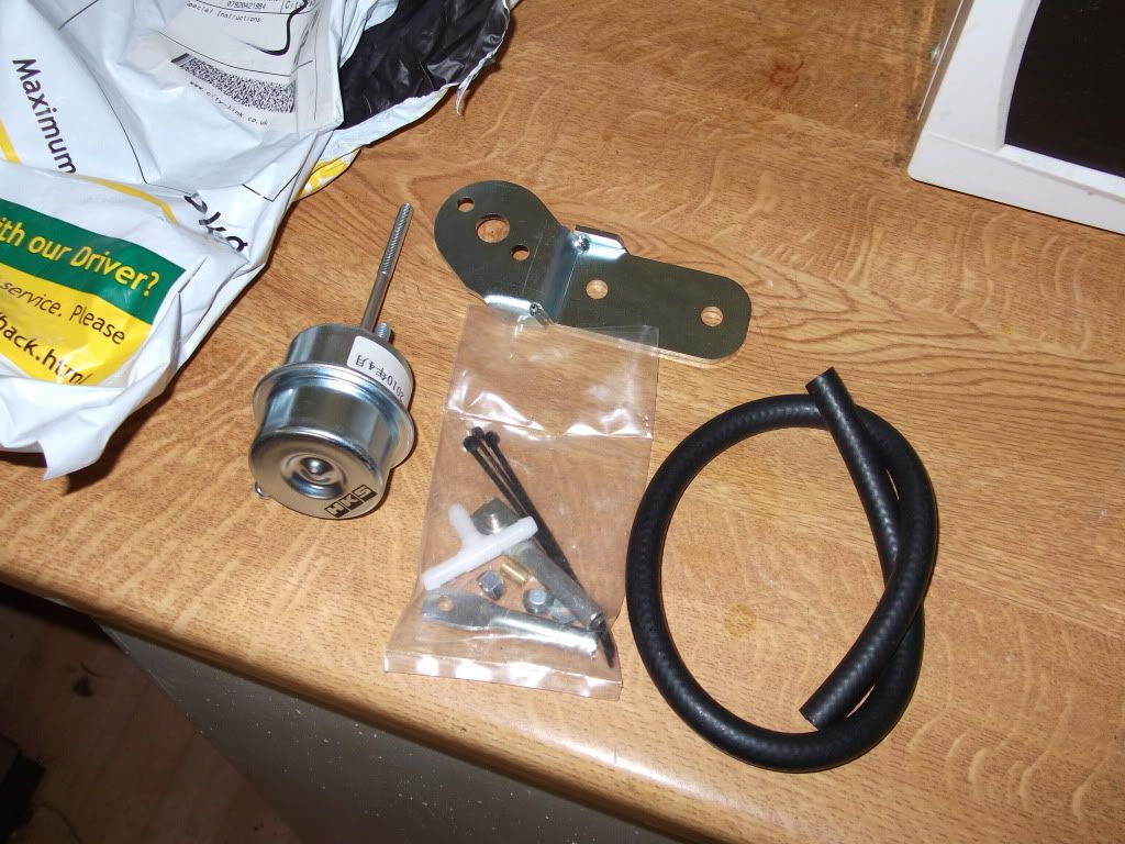

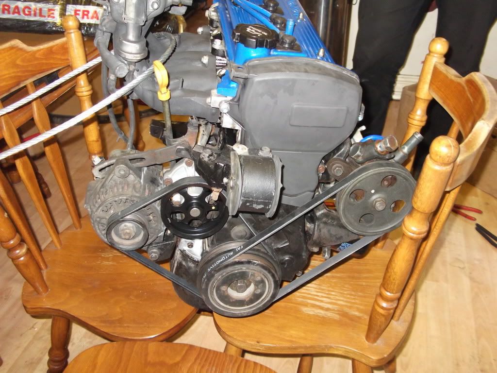

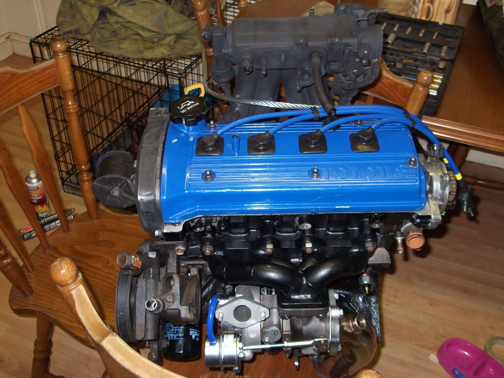

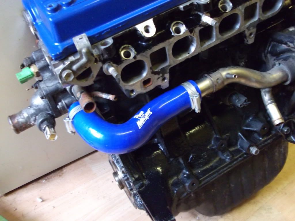

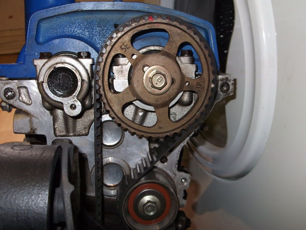

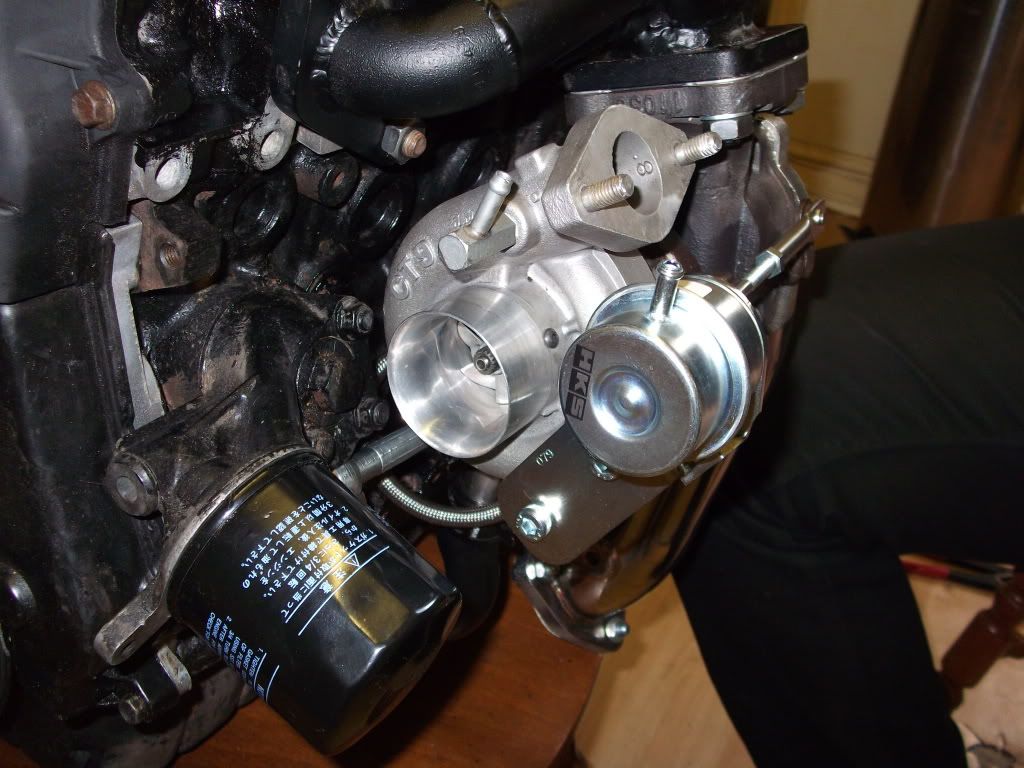

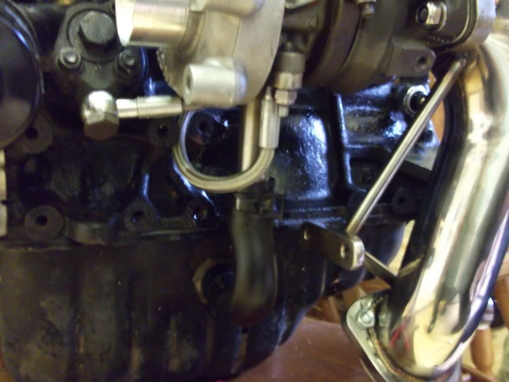

Steve GT Posted February 10, 2011 Author Posted February 10, 2011 Well decided to crack on with putting the engine back together today. made a lot of progress. thanks to socks as well for coming over and helping out with his expertese too couldnt have done it without him Well this is how she looked this morningGave the cambelt a quick paint just for now to tidy it up a bitAlso gave the end of the TB a quick clean too as it was mingingNew water pumpNew cambelt kitFirst of the roose engine bay hoses going onInlet fittedBrand new HKS adjustable actuatorMani/decat/Hybrid turbo fittedRace-tech Braided oil feed onUwwww shiny And what she looked like at the end of todays sessionPretty much ready to be fitted now. Few things on order too which I've added to ListOn order: New ThermostatCouple more gaskets (water feed etc)New dizzy cap and rotor armGrade 7 iridium spark plugsAlso hit a small problem which hopefully socks can sort out if he still has one. I sold my standard turbo and forgot it still had the water pipes on so now i need to source another one which is a bummer but hopefully socks has still got his.Also need the bracked which the cat bolts to to brace the decat as I've not got mine so not driving the car until i get one. think that will be a toyota jobbie and pretty sure that aint cheap damm problems lol nothing that cant be sorted thoughFew more bits needed like new jubilee clips for the front mount, need a air filter for my relocation kit, a blanking plug for the oxygen sensor on the decat and i checked the injectors and 2 of them need new seals.Hopefully though engine will be going in at the weekend Quote

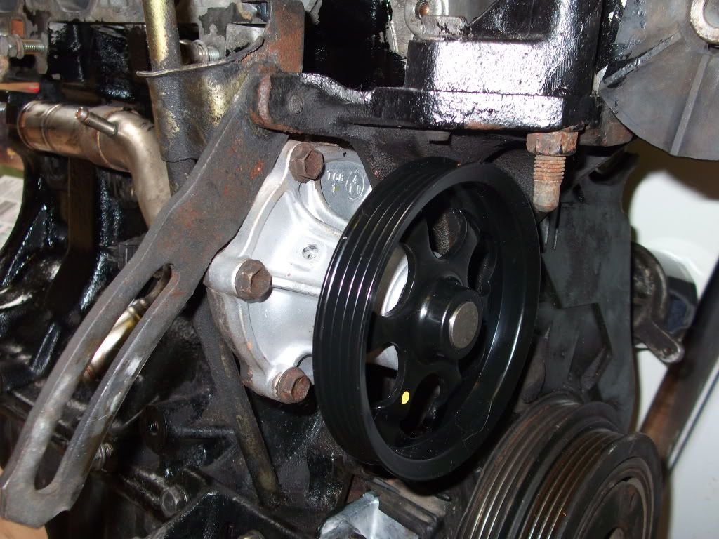

Idrees Posted February 10, 2011 Posted February 10, 2011 That's a water pump, not an oil pump Engine looks sweet but the matt black inlet lets it down imo, would have looked better Oem silver Quote
Craig_N Posted February 10, 2011 Posted February 10, 2011 You FAIL why isnt it fitted???????Only joking dude nice work bet you carnt wait Quote
daz gt turbz Posted February 10, 2011 Posted February 10, 2011 looking good mate, see its now moved onto the dining room chairs! love it. and the roose hose youve got on is the only one i havent got on, bit more awkward when engine in the car. Quote
Sparky Posted February 10, 2011 Posted February 10, 2011 I was gonna mention that mistake Iddy lolLooking good though mate Im sure someone breaking a FTE can sell you the bracket for the block/cat, no biggy Quote

Steve GT Posted February 11, 2011 Author Posted February 11, 2011 That's a water pump, not an oil pump Engine looks sweet but the matt black inlet lets it down imo, would have looked better Oem silverDamm it i meant water pump Really got to start concentrating what i write from now on lmao new oil pump as well though ;)and as for the inlet i know but i just wanted to give it a tidy up and thought fuck it black will do for now. was going for a CJ polished one but too hard to keep tidy IMOYou FAIL why isnt it fitted???????Only joking dude nice work bet you carnt waitSaturday dude hopefullylooking good mate, see its now moved onto the dining room chairs! ;) love it. and the roose hose youve got on is the only one i havent got on, bit more awkward when engine in the car.Oh yes next destination is the stairs ;)I was gonna mention that mistake Iddy lolLooking good though mate Im sure someone breaking a FTE can sell you the bracket for the block/cat, no biggyShut up you haha yeh geo's going to hopefully sort me out with a brand new one tomorrow if not il ask some breakers. iddy may have one he has a thousand of everything else lmaoLooking awesome mate, wish i had my engine out to clean everything up.Its a nice feeling dude trust me Quote
nastyrash 2003 Posted February 11, 2011 Posted February 11, 2011 u might struggle getting it into the engine bay all built up mate. i woud have put the engine in thn built it all up. + clean the throttle plate and plate housing ste the car will struggle to idle. Quote

Steve GT Posted February 11, 2011 Author Posted February 11, 2011 cheers Johnu might struggle getting it into the engine bay all built up mate. i woud have put the engine in thn built it all up. + clean the throttle plate and plate housing ste the car will struggle to idle.Nah mate changed the engine in my black GT before. my neighbour helps me and he prefers putting it all together outside of the car then lowering it all in at once. goes straight in matey. still got the clutch and gearbox to go on before we put it in too lol Quote
daz gt turbz Posted February 11, 2011 Posted February 11, 2011 give that power steering pump a lick of black hammerite dude! Quote
Steve GT Posted February 11, 2011 Author Posted February 11, 2011 yeh it could do with it couldnt itOh forgot to say socks found me his water lines yesterday so thats another one off the list. all i need now is a 52mm air filter, a cat brace bracket and injector seals and she'll be all ready to fire up Quote

iamlegend Posted February 11, 2011 Posted February 11, 2011 looking good mate! getting along there....what made you go with that set up?thing is with the hybrids ct9 still get so hot Quote

Steve GT Posted February 11, 2011 Author Posted February 11, 2011 Always heared good things from the tongs hybrids and hopefully a reloation kit and a nice front mount will keep the temps down Quote

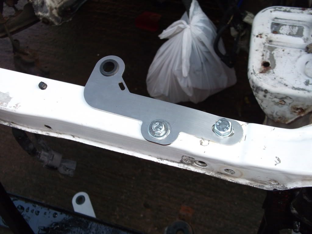

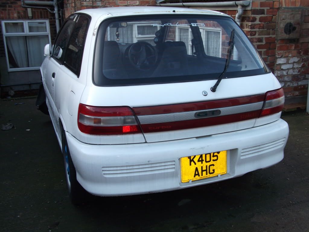

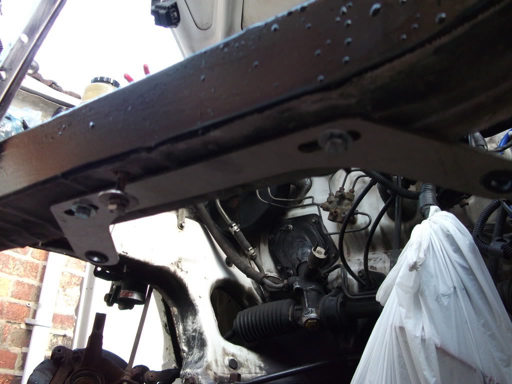

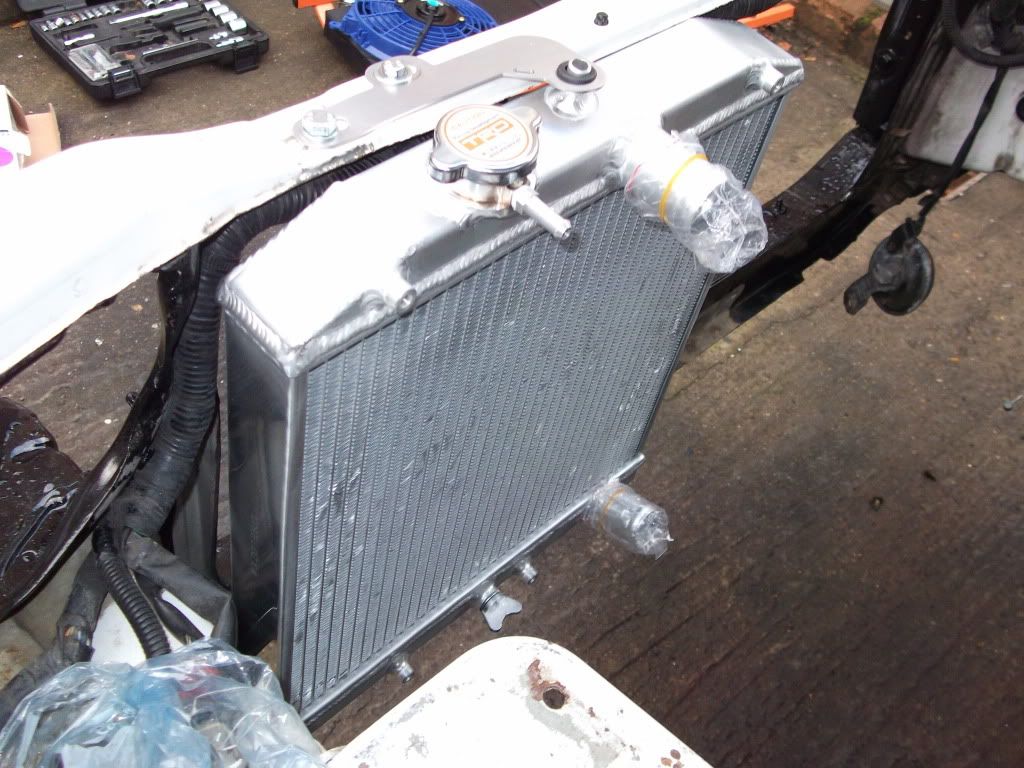

Steve GT Posted February 11, 2011 Author Posted February 11, 2011 Right got a few more bits in todayFirstly a test fit of my rear glow panelIts coming back off when i get some new bulbs for it so it lights up better ;)Also got the civic rad mounting kit fitted and test fitted the radiatorGot to get a fitting kit for the fan though before i fit it Tomorrows plans are to get the quad headlights fitted finially and also the tuning developments fuel pump fitted as wellWas going to get the engine fitted tomorrow but socks made me realise its best to wait till everythings here so currently waiting for Turbo waterfeed gasketThermostatDizzy capRotor armIridium spark plugsAlso all my problems have been solved that i was stuck on.Firstly got a Cat bracing bracket off someone on here which has saved me some moneyAlso got on the phone to geo and he's brilliantly sorted me out with some injector seals so ordered 4 new top and bottom injector seals and he's also got me some new flywheel bolts as well. Big thanks to him deffo the best person for sourcing genuine parts ;)So once all them come through at the start of next week hopefully i can really crack on. get the clutch and gearbox on then put it all in the bay and strike it up ;)Got some EBC grooved and vented discs to come as well soon Quote
