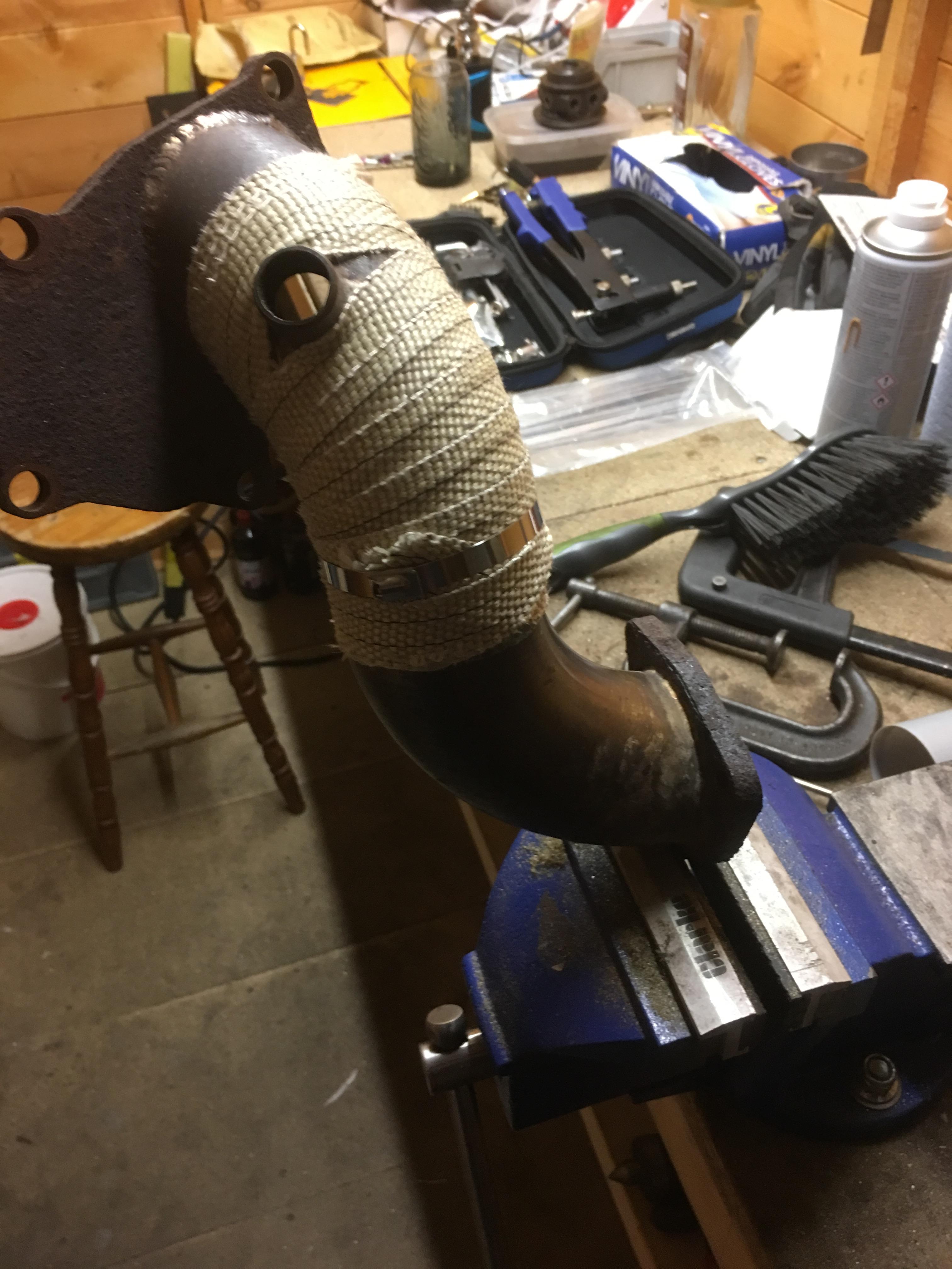

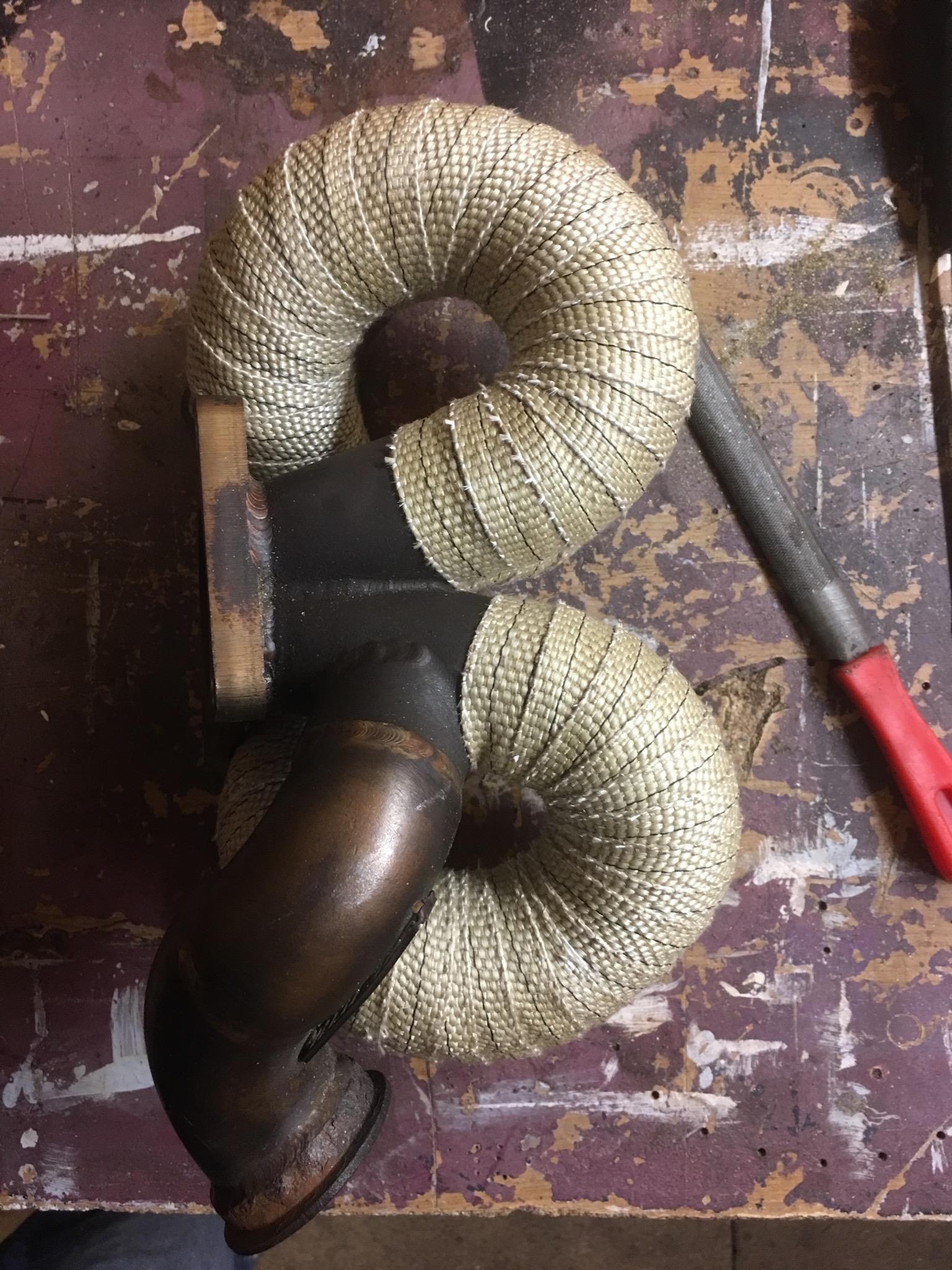

federalman Posted February 17, 2018 Author Posted February 17, 2018 Solid shifter bushes. K&N filter fitted. Custom catch can parts and final product. Modified rocker cover. Did some heat wrapping New clutch Various bushes. Various fuelling parts Harness bar Resprayed the rear bumper and JAM splitter. Had some filling to do where I had cracked the splitter. For an electrician I don’t think it’s a bad job Quote

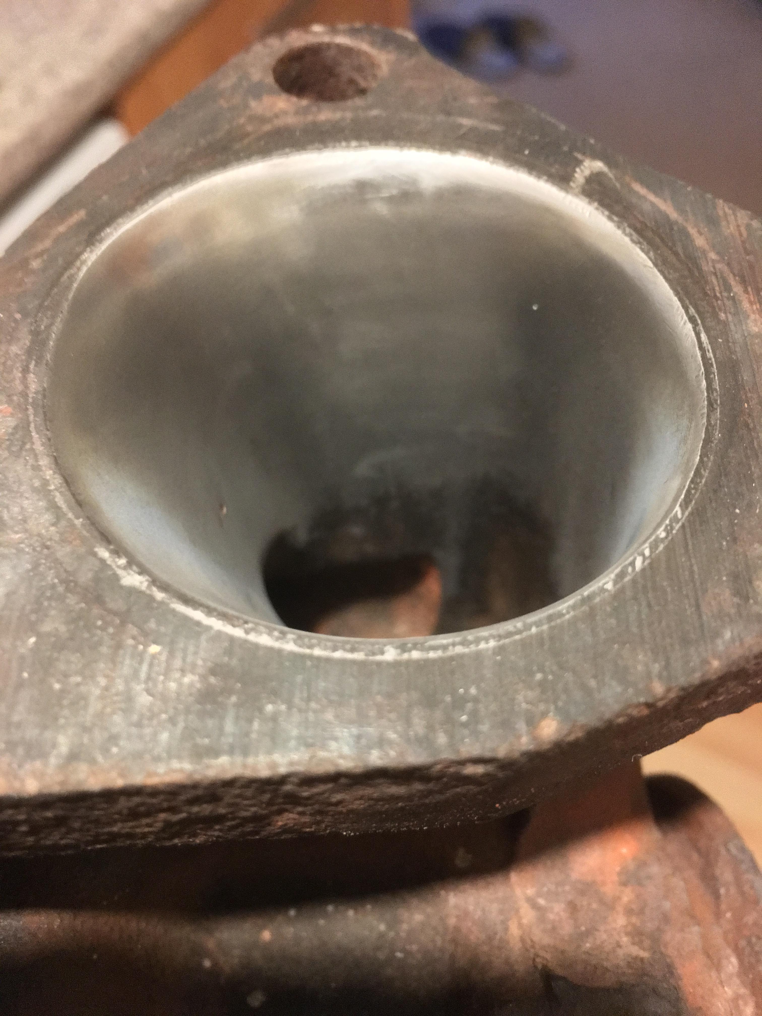

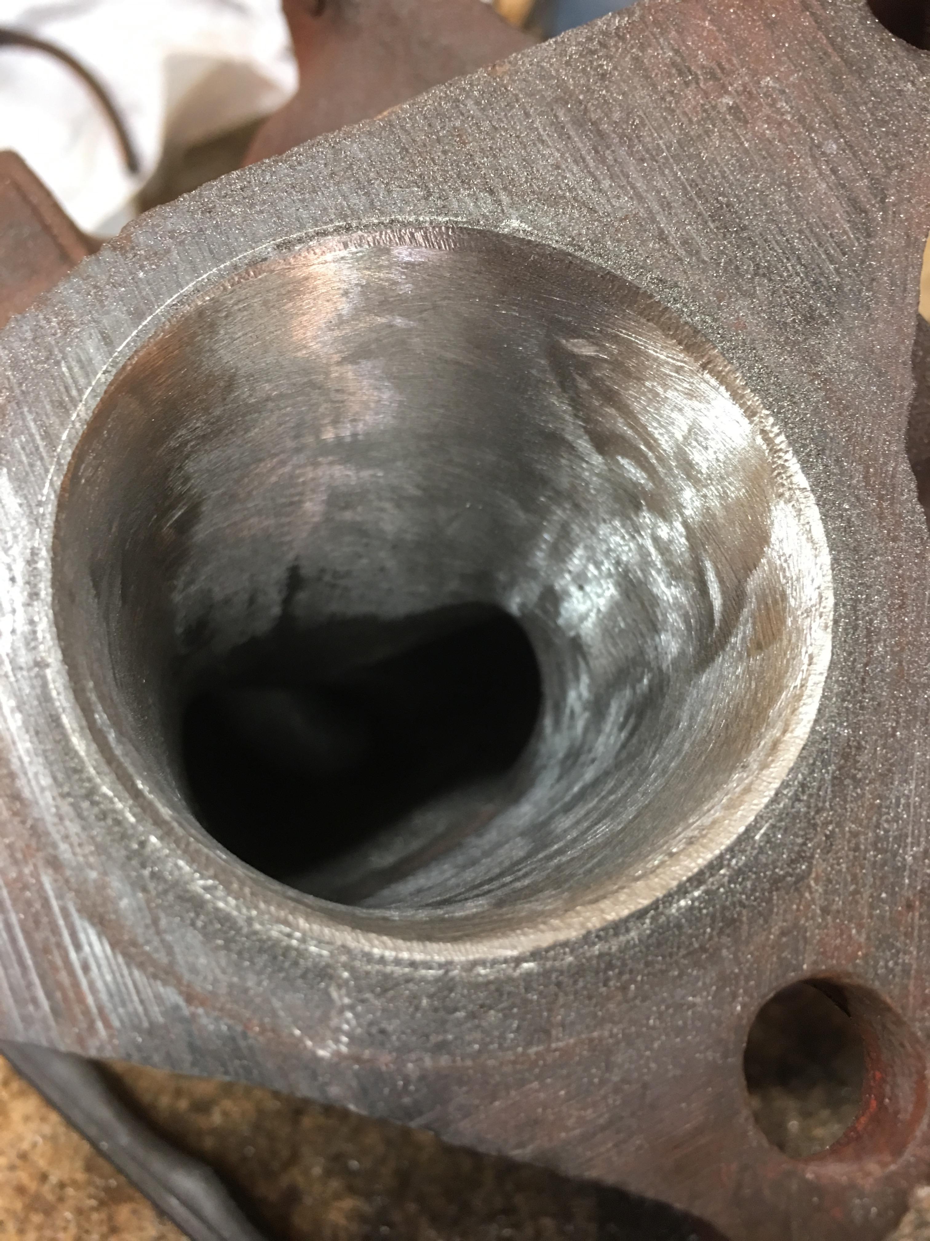

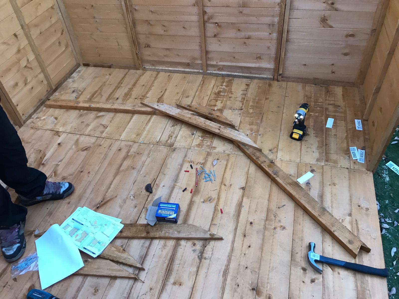

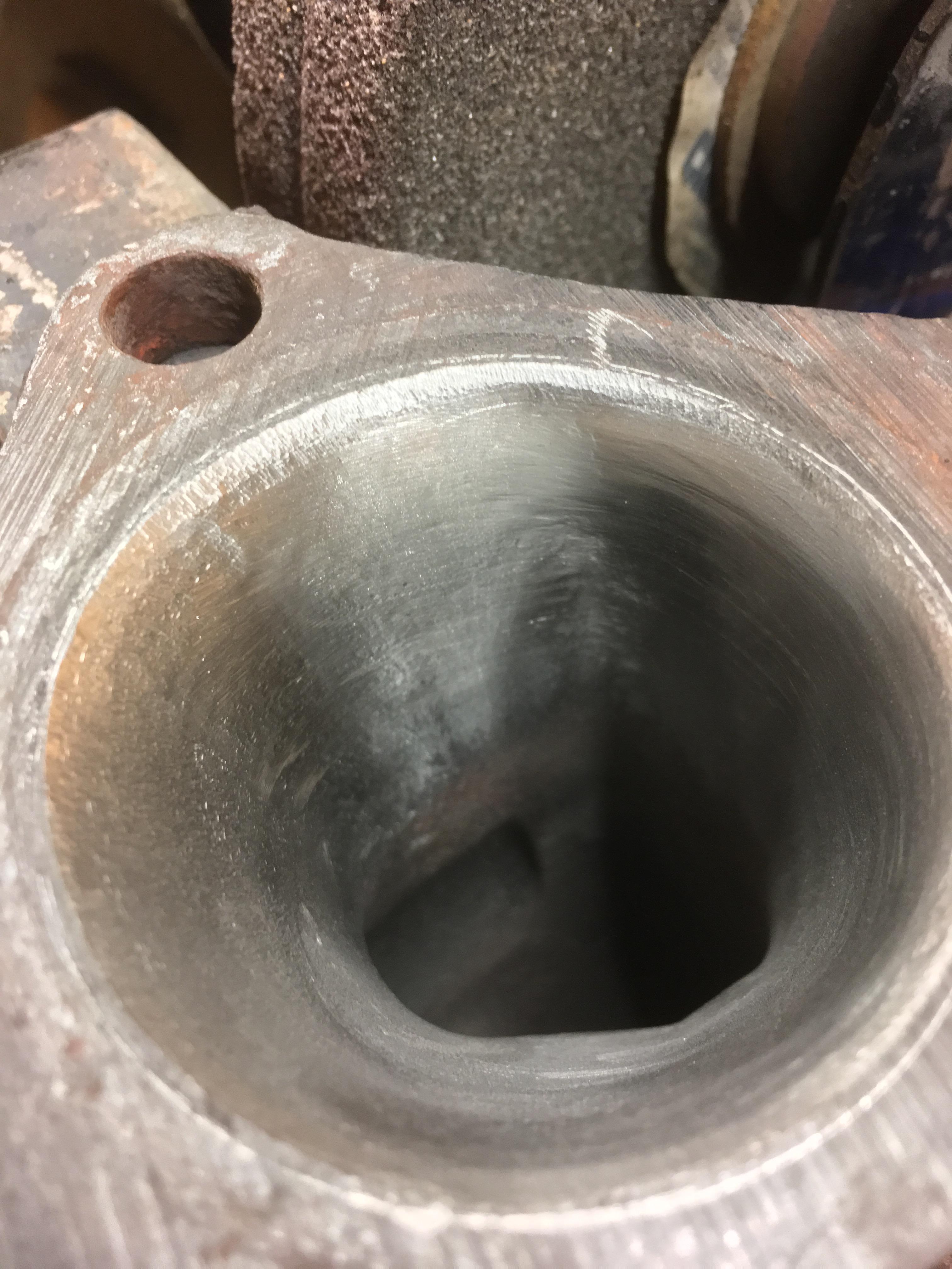

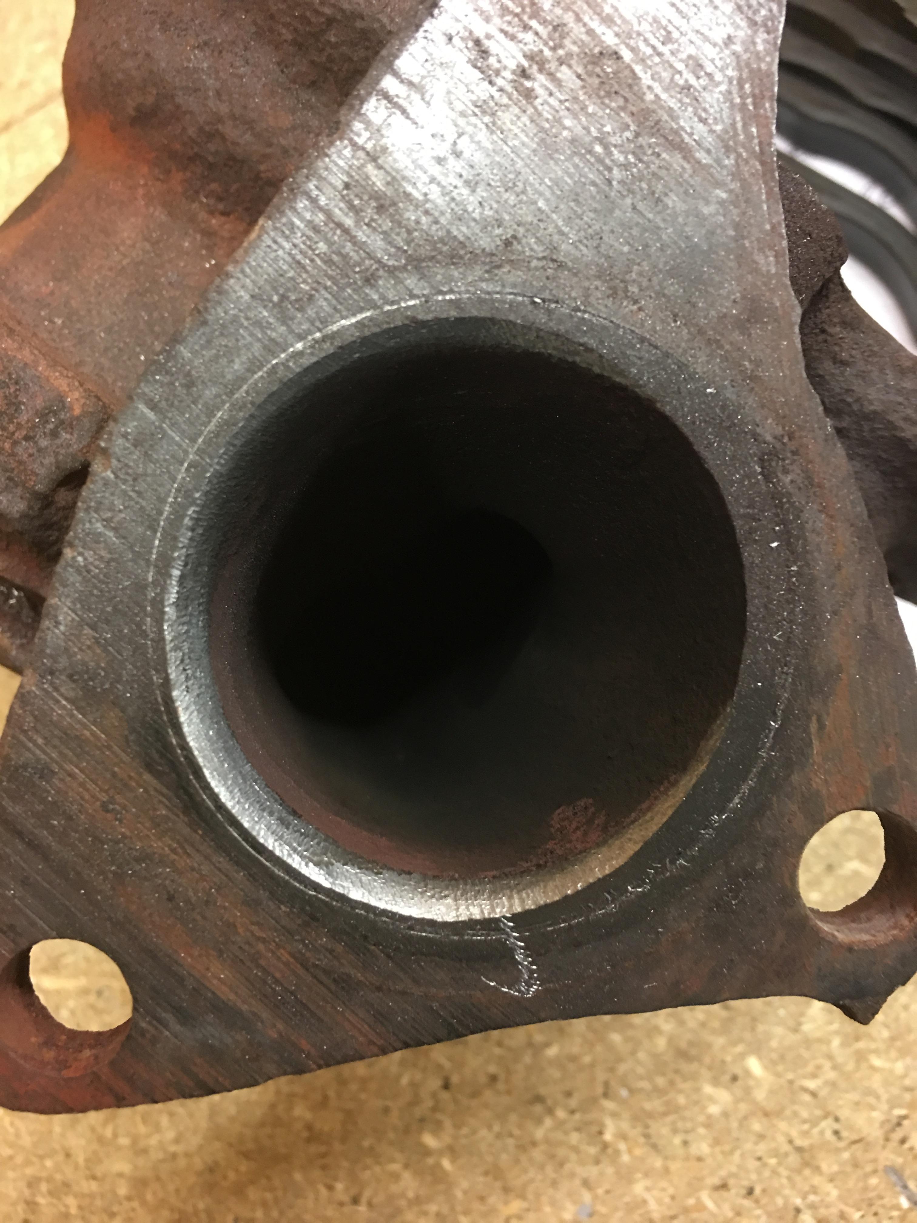

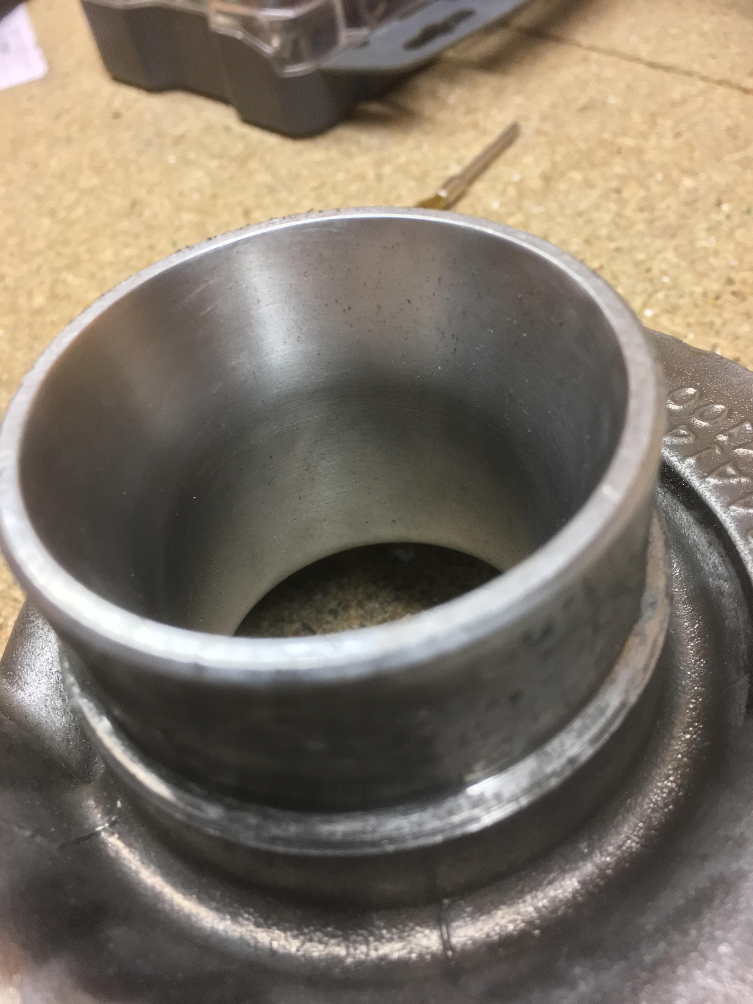

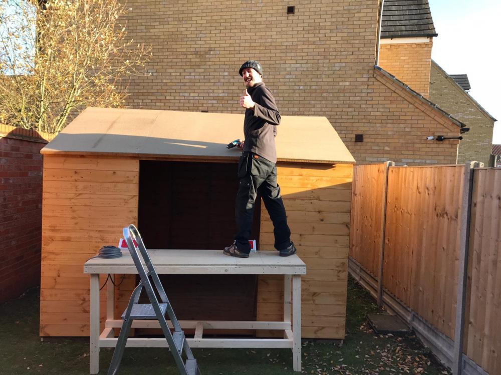

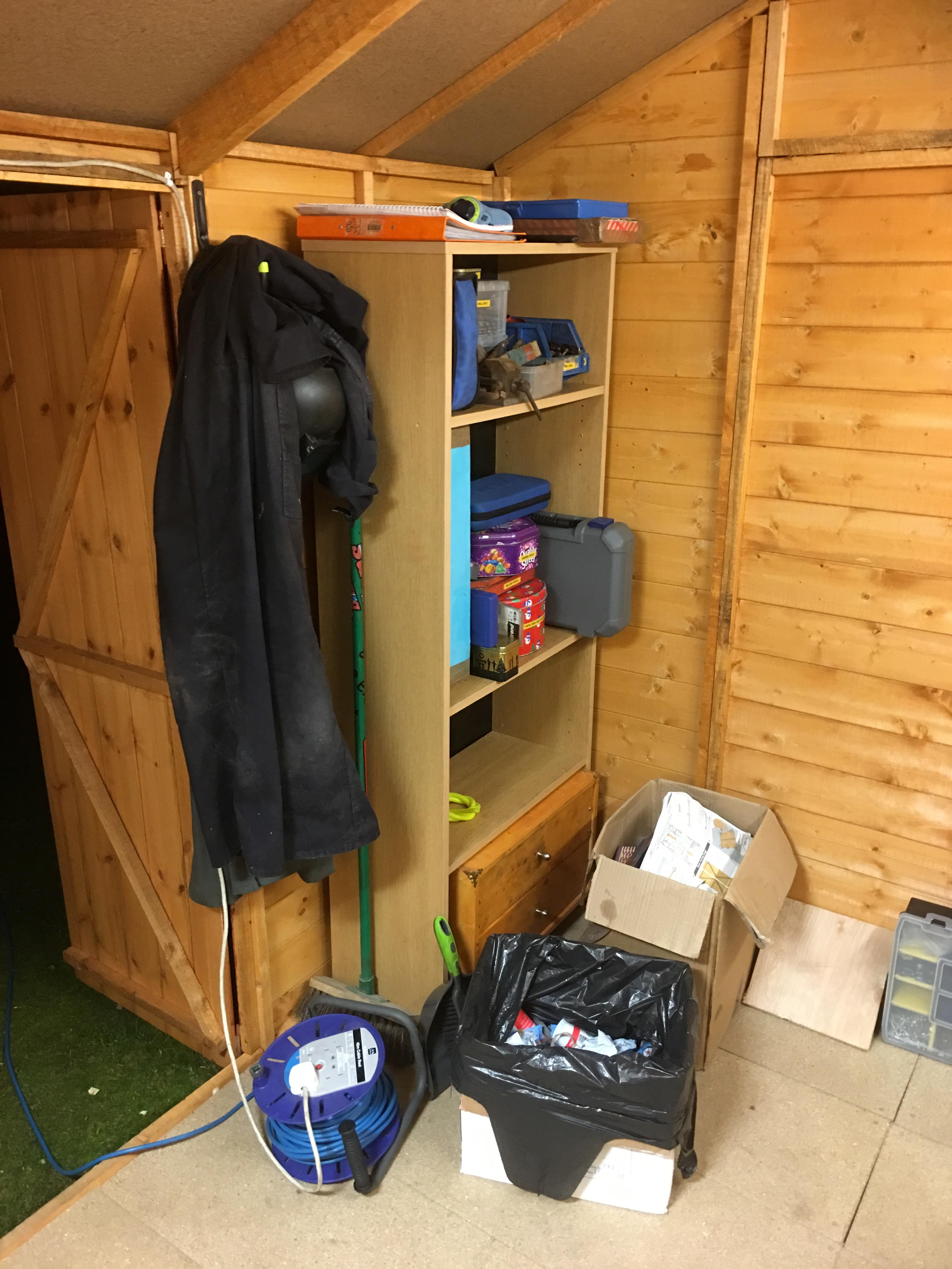

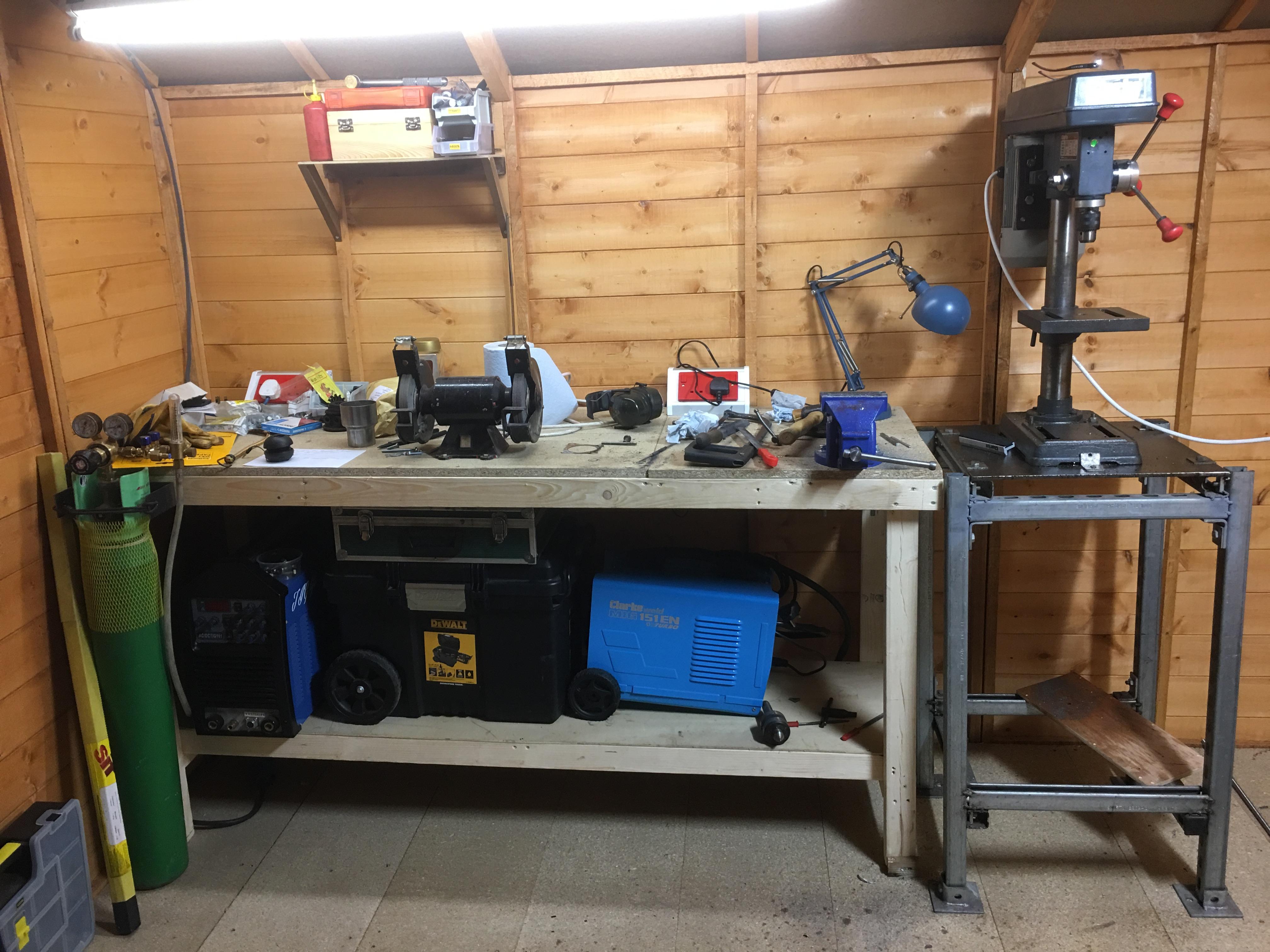

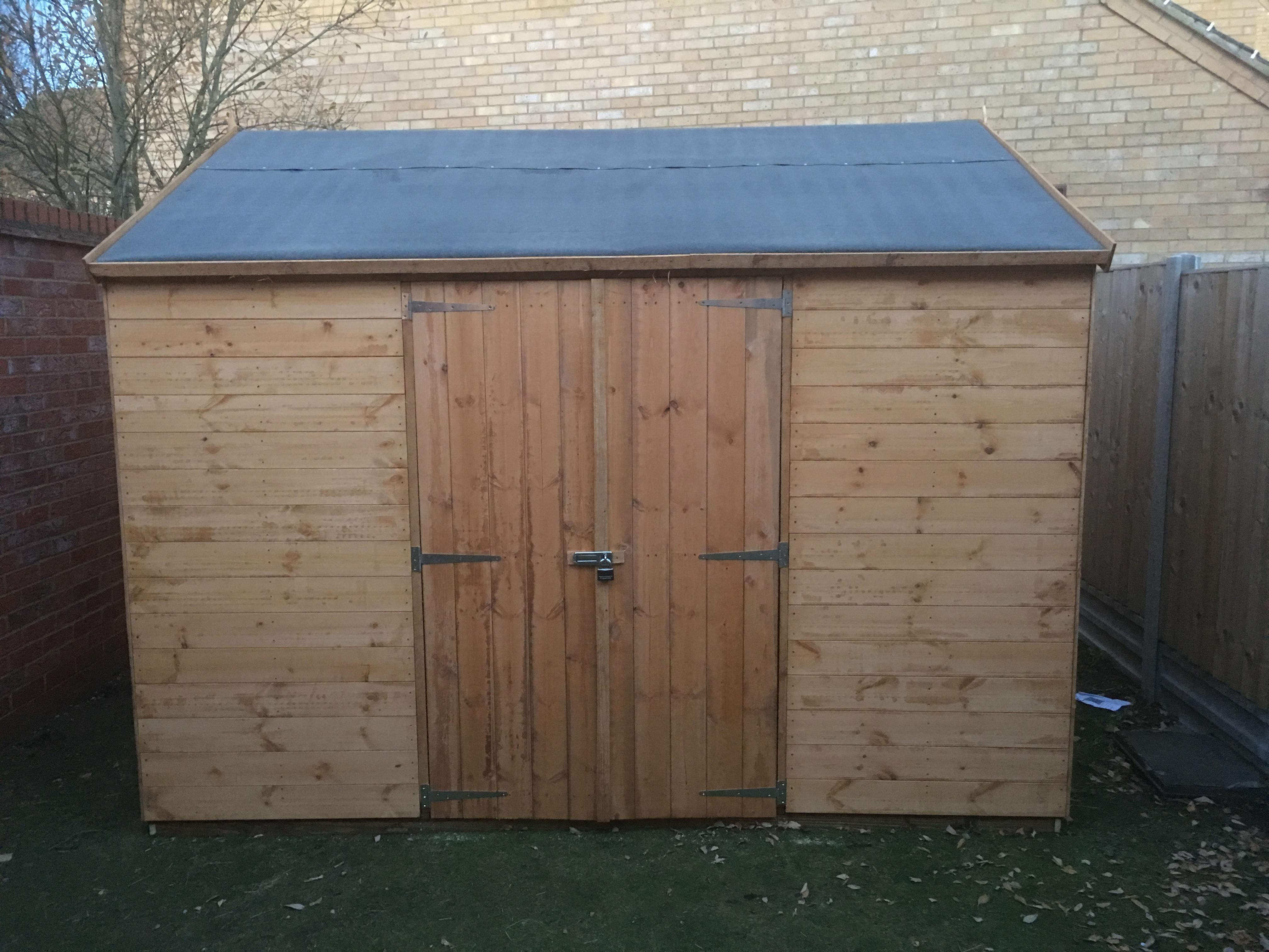

federalman Posted May 24, 2019 Author Posted May 24, 2019 Been a while, had quite a lot going on of recent having moved a few months back and building myself a workshop. Rebuilt the TD04 and ported the turbine housing whilst I was at it. Still stinks of burning oil however. I suspect the oil return is causing the problem as it’s always been a bit long and is currently squashed slightly causing a restriction. If anyone has some suggestions as to anything else it could be I’m all ears. Got it balanced though and there were no issues of it leaking oil during that. Anyway here’s some photos Quote
federalman Posted May 24, 2019 Author Posted May 24, 2019 Just need to pick my lathe up from my parents now Quote
