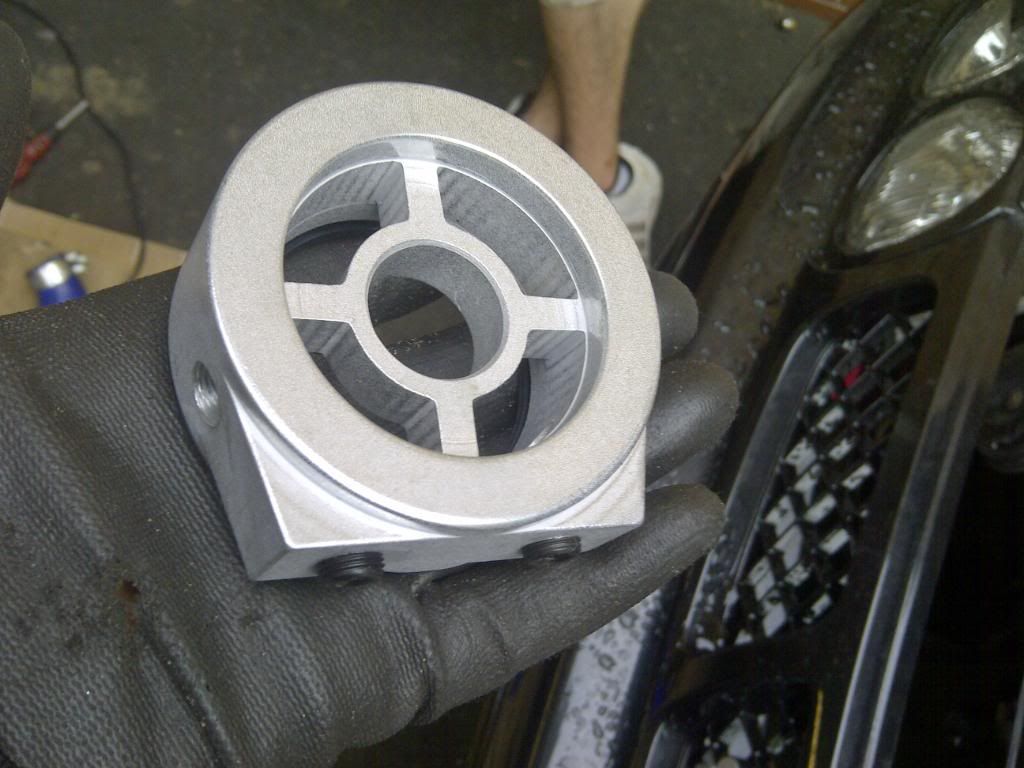

james@cjperformance Posted June 22, 2011 Posted June 22, 2011 does the sandwich plate have any attachments with it, threaded bar seals?discs look good too, you will need some jubilee clips for the water temp adaptor.think you need 75-90 fully synthetic oil x2 and friction modifier for the box too. Quote

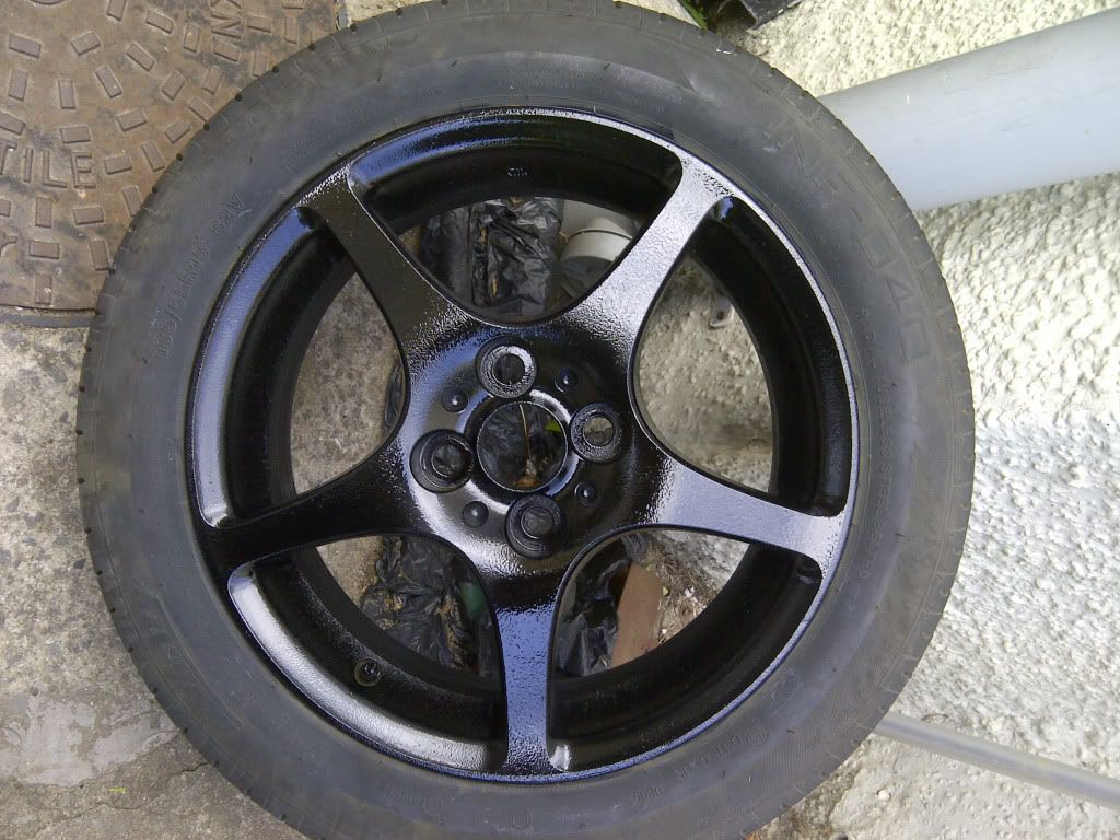

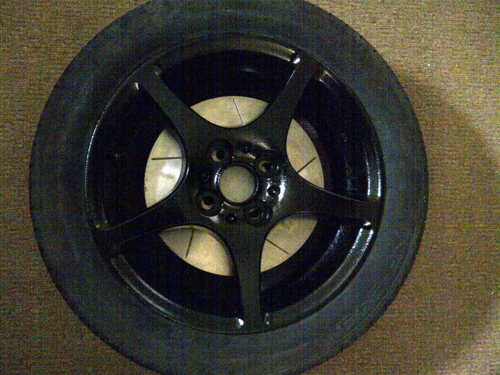

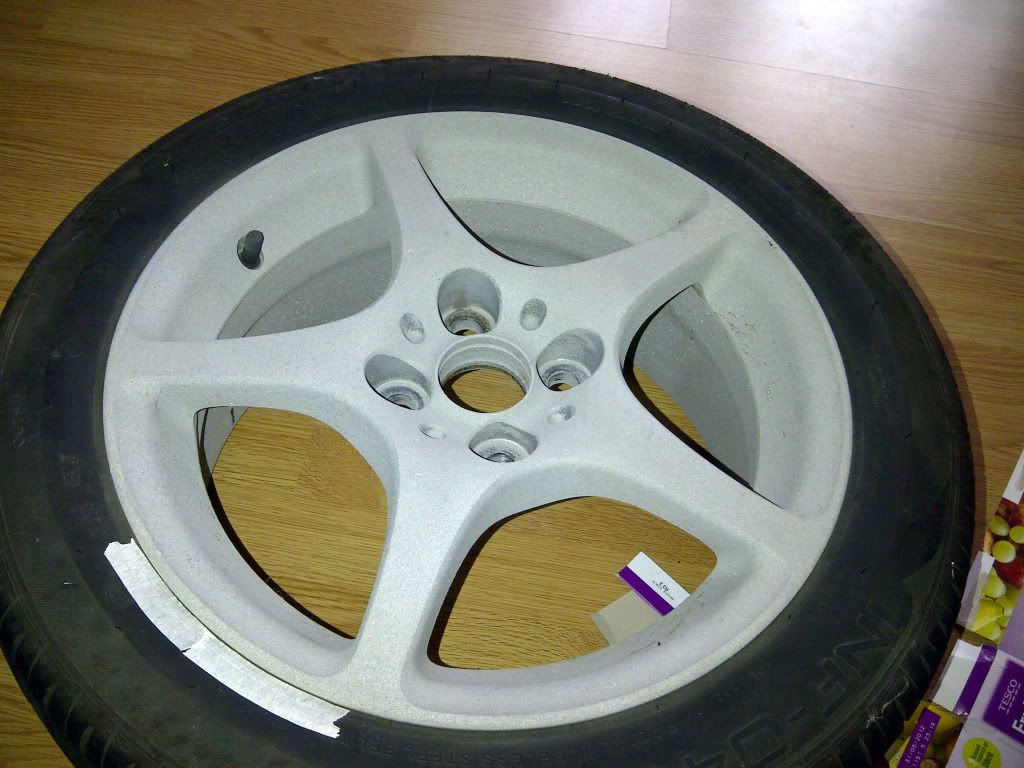

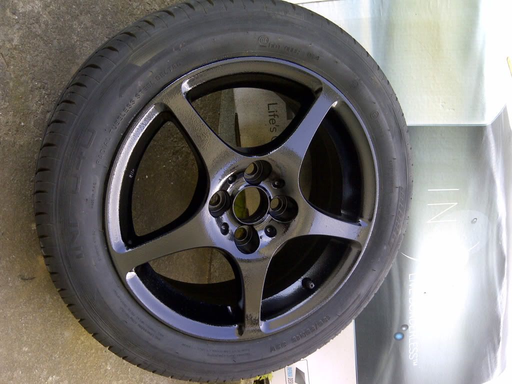

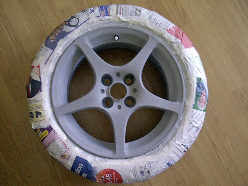

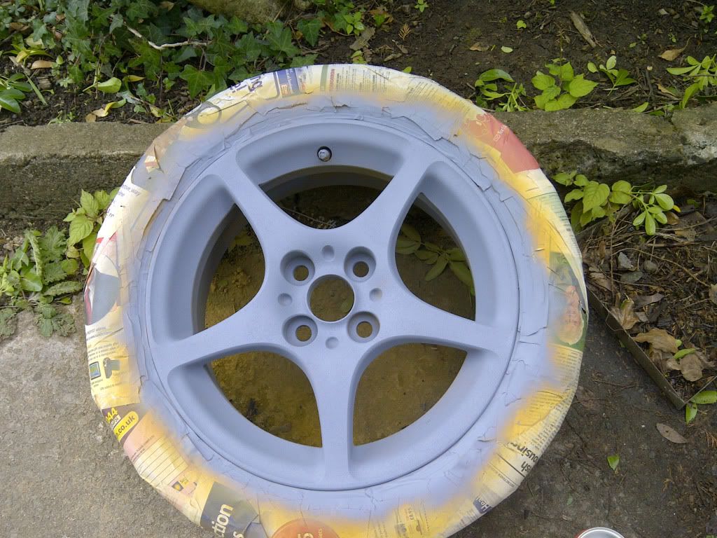

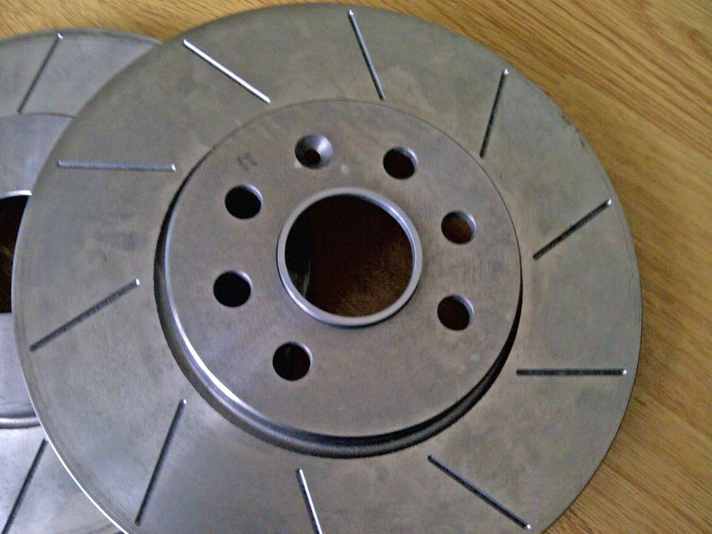

Amjad Posted June 23, 2011 Author Posted June 23, 2011 Ahhhh man shame you wont make the RR day in this its coming along awsome, I like the gaugesYeah last year was a good day I'm gutted!But I can finally get these parts fitted! loldoes the sandwich plate have any attachments with it, threaded bar seals?discs look good too, you will need some jubilee clips for the water temp adaptor.think you need 75-90 fully synthetic oil x2 and friction modifier for the box too.Yeah it came with the thing sitting in the middle herePicking up the discs today, £65 for machining though I'm off to get the jubilees later (stingy sellers didn't include any ) 75w-90? I'm gonna ring that Dave guy in a bit and pop down there laterLoving what you're doing with this Amjad! Thanks man that means a lot! *Update*I managed to refurb two of the MR2 wheels yesterday, didn't turn out great but that's because the shotblasting left them with a rough surface and I didn't want to sit there for ages sanding bare metal (thought the filler primer would help fill the dimples in the metal!) The second wheel came out a bit better because I DID sand it a little, think I'll spend more time on the last two wheels sanding though!Also my Whiteline ALK cameGoing to pick up my discs later on today, looking forward to Saturday now when the springs, rad, clutch, gauges and possibly ALK will go on Quote

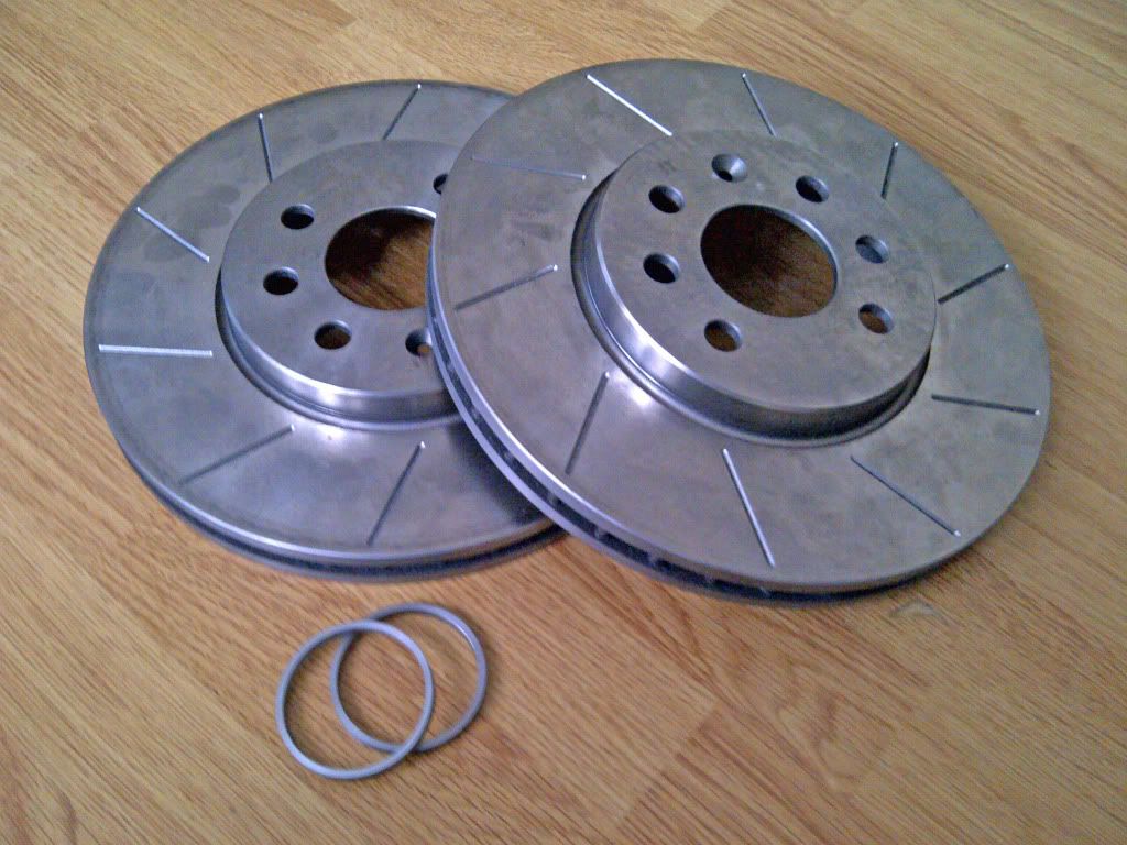

Amjad Posted June 24, 2011 Author Posted June 24, 2011 Got the discs back with new reducers for the hub all machined and ready to roll!Should look beasty with the calipers on ;) Quote

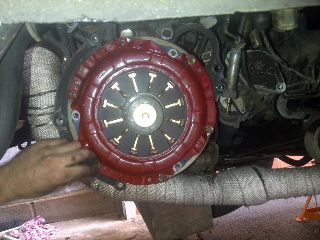

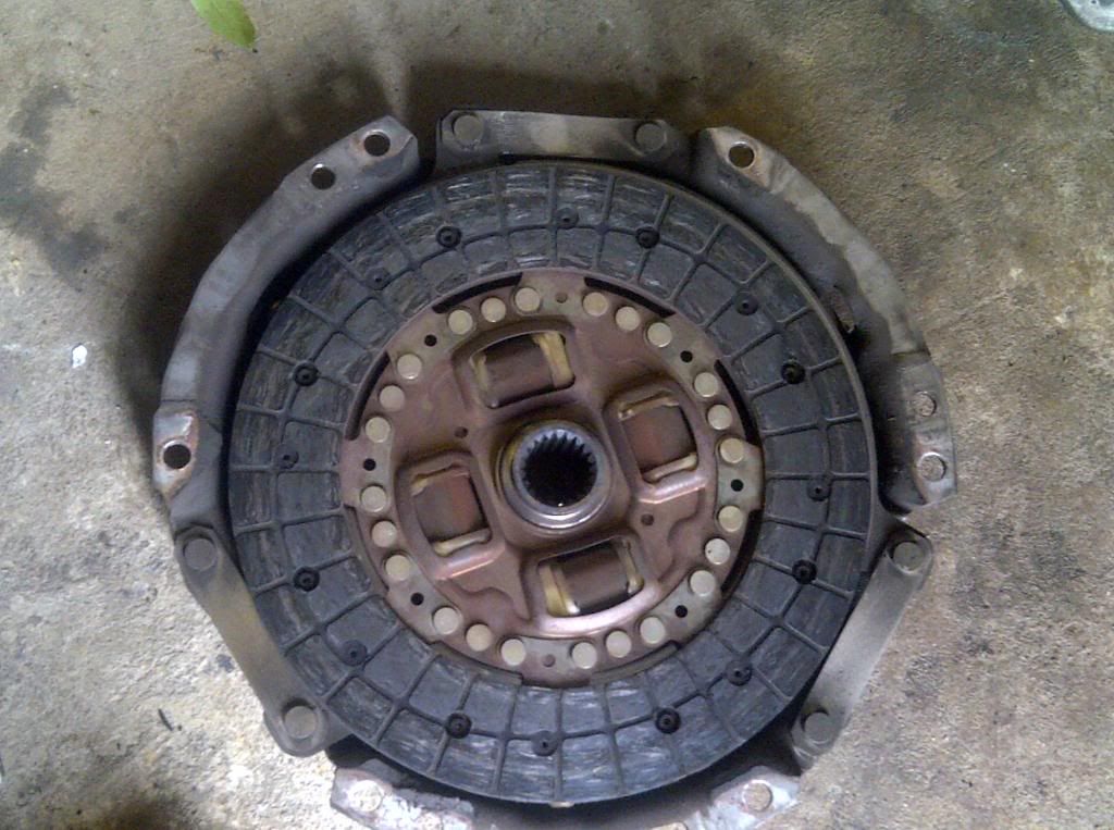

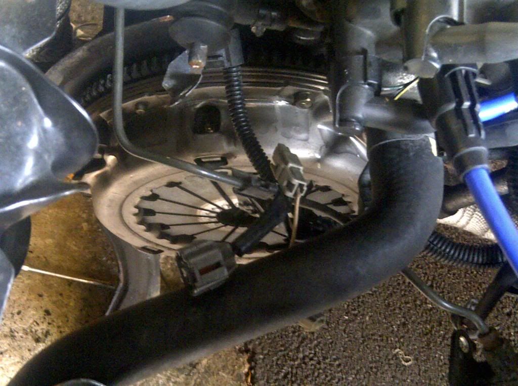

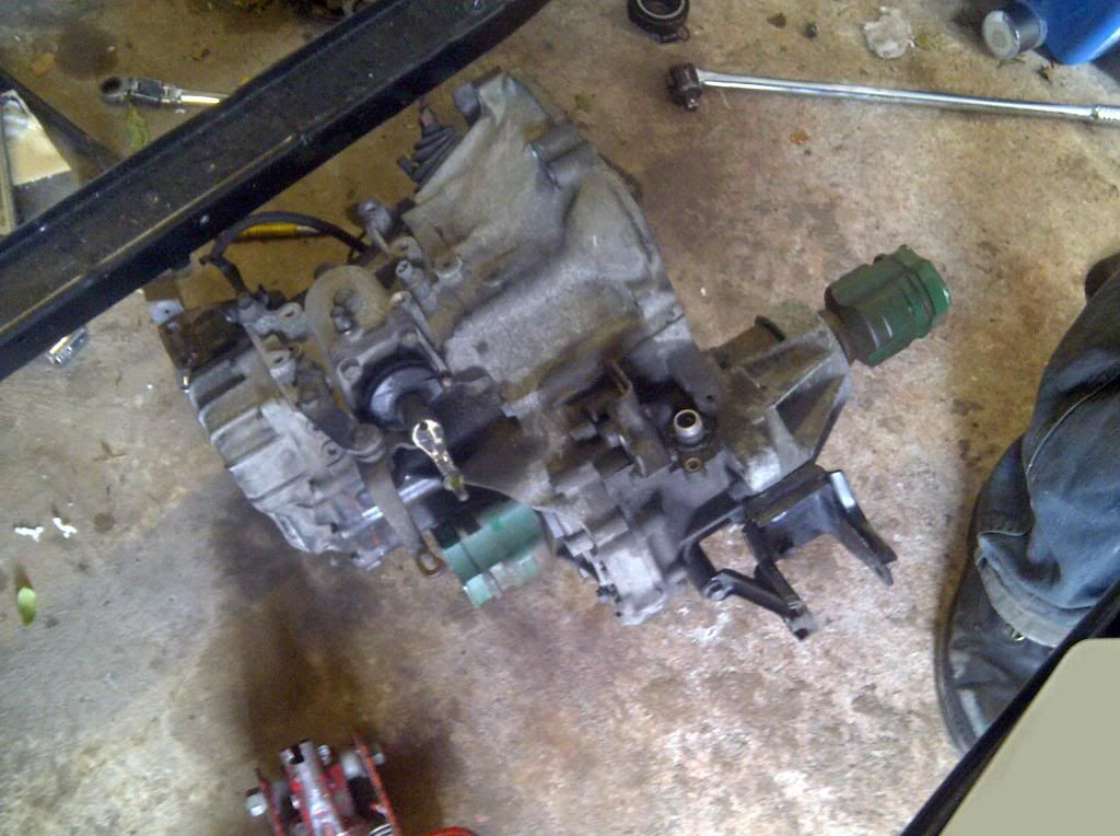

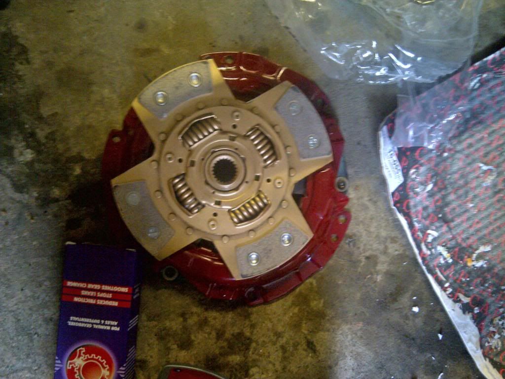

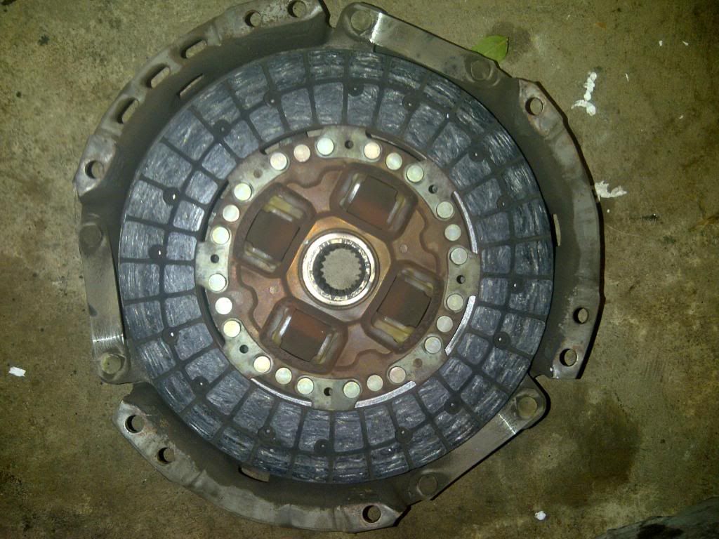

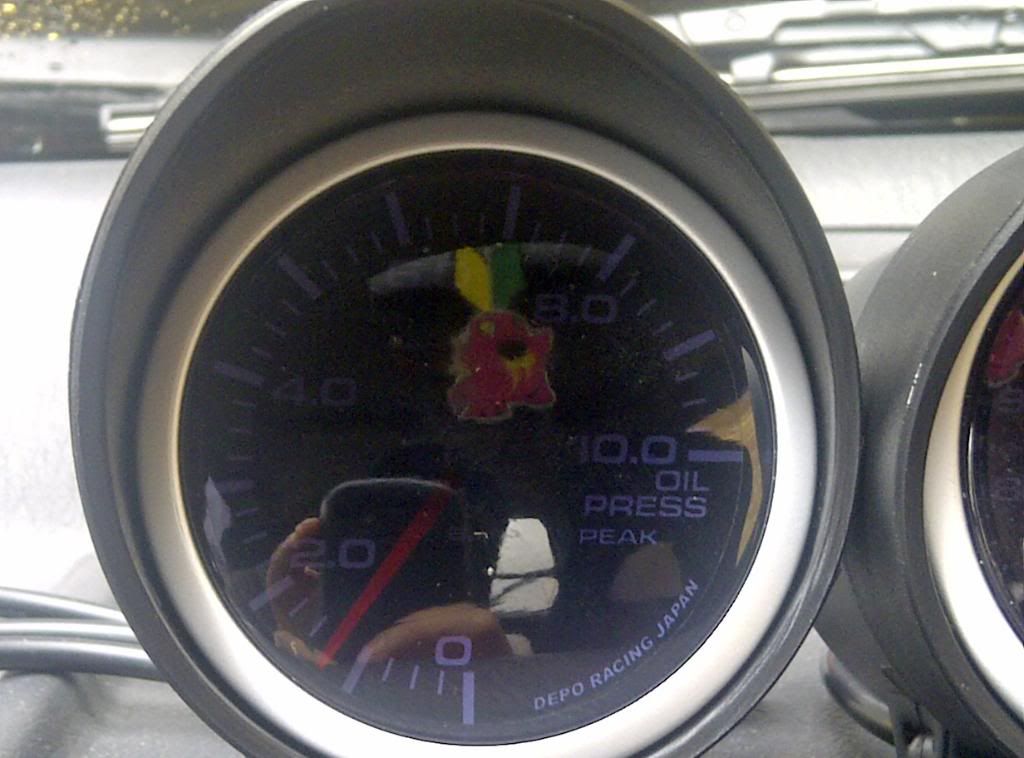

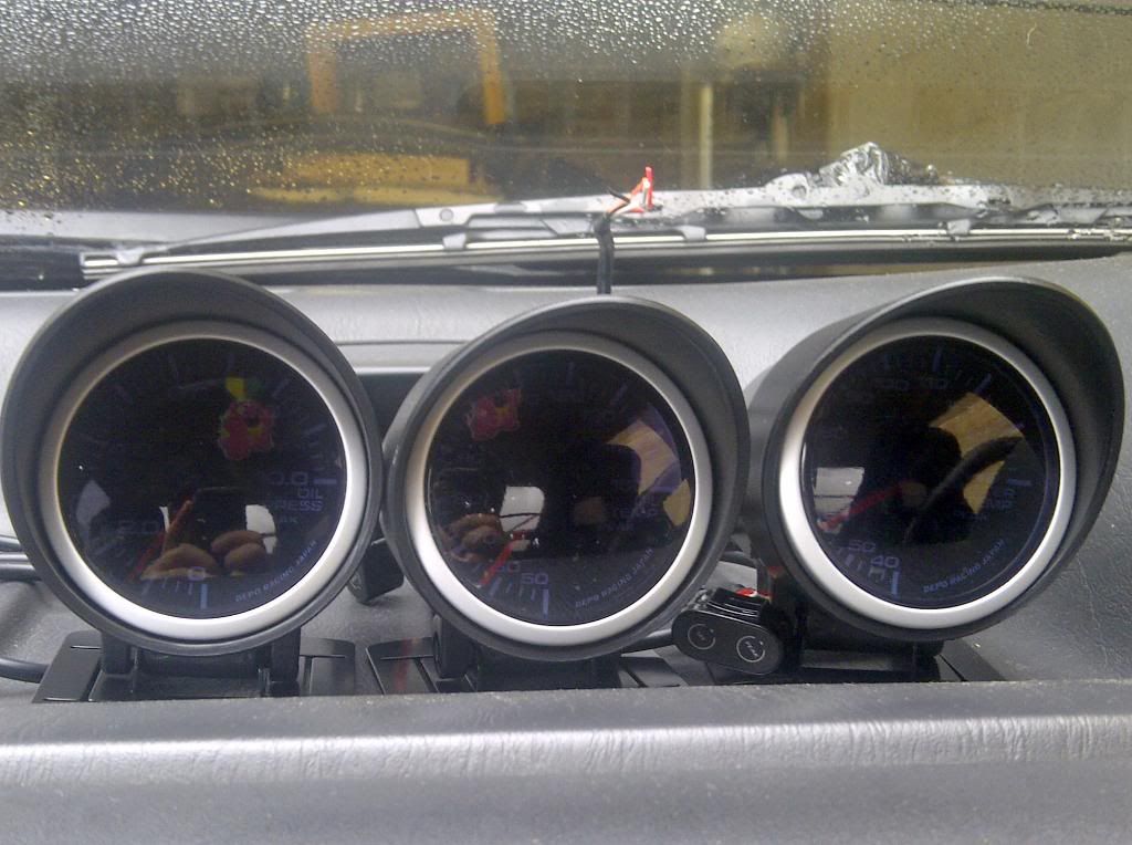

Amjad Posted June 27, 2011 Author Posted June 27, 2011 *Update*So big thanks must go to James @ CJ Performance, who kindly gave up his day to help me with the car! I say help, he did most of it while I stood around watching The plan was to get as much as we could get done out of the clutch, brakes, civic rad, oil change, oil sandwich plate/gauges, springs, ALK and upping the boostIn the end we only managed to get the clutch and oil change done, due to various problems we encountered!-Firstly the brakes, after confirming on the phone that the calipers were in "good working order", it turned out one of the dust seals was torn and the pistons were seized -My AC fan electrical wires were torn off somehow, so we couldn't do the rad-Oil sandwich plate fitting fitted the oil filter fine, but would bolt to the engine WTF?! So we couldn't do that or the gaugesAnd by the time we had done the clutch, oil and discovered all that, time to do anything else had run out! Anyhoo, pictures..Off goes the LSD gearboxOut with the old, very worn clutch..Shiny new clutchFew pics of the gauges, these are amazing quality, cannot wait to get them wired up!And for reference, the clutch and oil changed atCar feels SO much better with the new clutch! Shifts beautifully and can actually put the power down properly! It is a bit juddery in first gear being a paddle, but it's getting better I spoke to the breakers that sold me the calipers, I SPECIFICALLY asked whether everything was intact, and they started running their mouths off at me down the phone, but I have sorted it and they will be sent back for a refund! Knobheads!!Today I ordered a new oil sandwich plate, slimline fan, and another set of calipers. And we're hoping to get the rest of the stuff we didn't get to do on Saturday done next week, as well as a transmission fluid/brake fluid change as long as it all goes to plan this time! Also gotta book the tracking for Thursday/Friday next week which will be cutting it super close to Japfest 2!! Let's hope I make it on track this time Amjad Quote

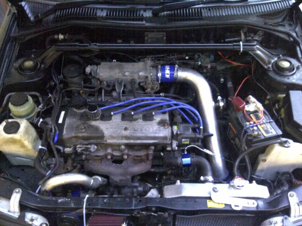

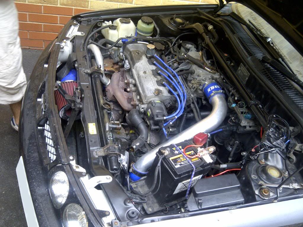

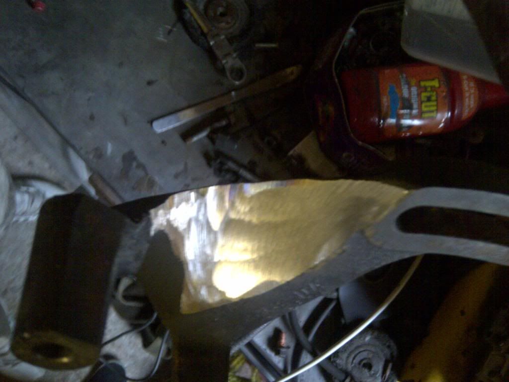

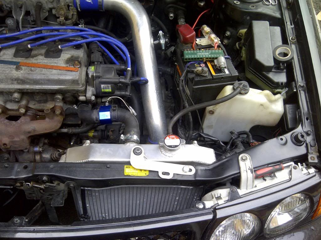

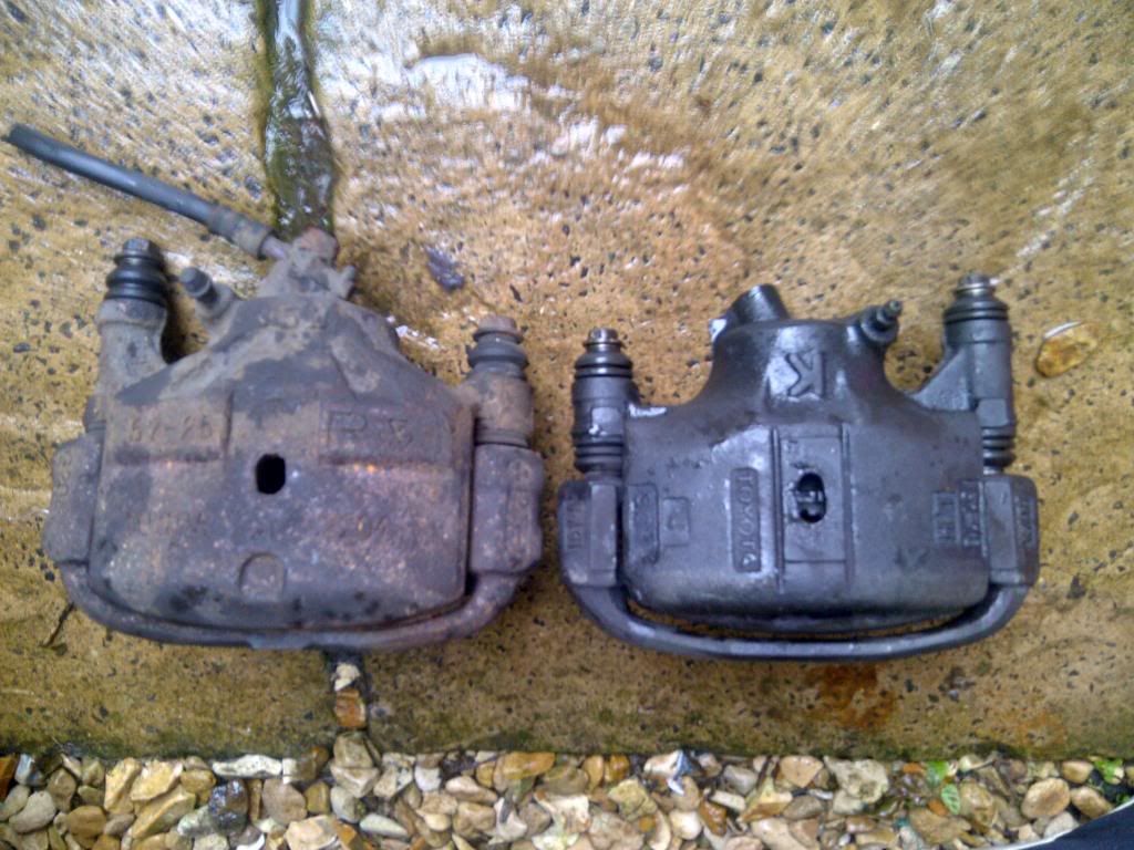

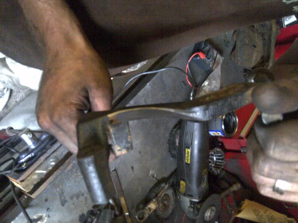

Amjad Posted July 7, 2011 Author Posted July 7, 2011 Thanks guys! The gauges are a good investment as they are really useful, but they also look freaking awesome! Haha*Update*James again kindly helped me fit a lot of the stuff the other day, car is pretty much ready for Japfest! We got started by doing the brakes..Old disc vs New discNew caliper vs Old caliperAnd fitted! They look massive, you can't even get your finger in between the caliper and wheel lolThen onto the new oil sandwich plate I boughtA silly amount of metal had to be grinded off the PAS bracket!Engine bay before Civic rad..FittedEngine bay after Civic radAlso managed to get the rear NA suspension swapped over onto this (didn't have any spring tensioners to fit new springs). The bottom shock bolts on the NA came off nicely, but the ones on the GT were truly seized! I went to a garage to nip these off, and they almost snapped the bolt as the neck of the bolt was stuck in the sleeve of the shock but luckily they managed to remove it. I've used one of the bolts off the NA for now but a new bolt and nut is coming from Toyota on Friday. Finally sitting pretty!I've also got a new rubber oil return hose & oil feed gaskets from Toyota for piece of mindThe brakes so far, still bedding in but already they feel better than the old ones! I cannot wait until they've settled in so I can experience the full potential!It's a shame I couldn't get the Water Temp gauge running before changing the rad, but the Civic rad seems to do it's job. We only had a chance to fill it with water as I left my coolant at home, but temp hovers around 80c, and the fan is bloody powerful so all good there!And now that the back end has been dropped, looks and feels infinitely better! I'm finally confident of this car's abilities around a track lolWe also turned the actuator up two turns, only went to about 0.85ish bar, but the increase from 0.7bar was very noticeable! The woosh dump at high boost is now a high pitched chirp (like Taggy's GT at JF2 last year) and it pulls a lot better. But I will be upping boost a little more Just a few more things to do now before we leave for JF2 on Saturday:- Drain rad & replace fluid with Red coolant- Apply PTFE tape to oil, water sensors- Turn actuator to 1bar- Fit new oil return rubber hose & gaskets- Put in a new headlamp bulb for the one that went pop lol- Finish painting the pink wheels! (As I need the grip from the T1Rs on track)- Paint brake calipers if there's timeLet me know what you guys think Amjad Quote

Amjad Posted July 7, 2011 Author Posted July 7, 2011 Awsome work bor if you get all that done by JF2 you will have a proper little weapon on your hands Thanks Lew! I managed to get all of those jobs done bar the painting, running just under a bar..still bored of it lol! I want TD04!! But it does go well as an Astra CDTi found out earlier hehe Awesome work Amjad!!Thanks dude!pop to toyota down cardiff for coolant i went there the other week when i did my rad and he said they'd stopped stocking it but he'll check if they had any. managed to get 5 litres for a 5er as it wouldn't scan through on their system no more so he put it through as a litre of the new stuff ;)Nice one for that! Shame I already bought coolant a few weeks ago I'm down there tomorrow to pick up the shock bolt, I'll ask if they have any Well like I said managed to do all those little jobs. Sensors are no longer leaking, Actuator turned up to about 0.95bar and rad flushed with fresh coolant!Just need to paint the wheels, brakes, bleed the brakes again and fit my Sparco harness! Oh, and give it a wash Roll on Saturday/Sunday Quote
