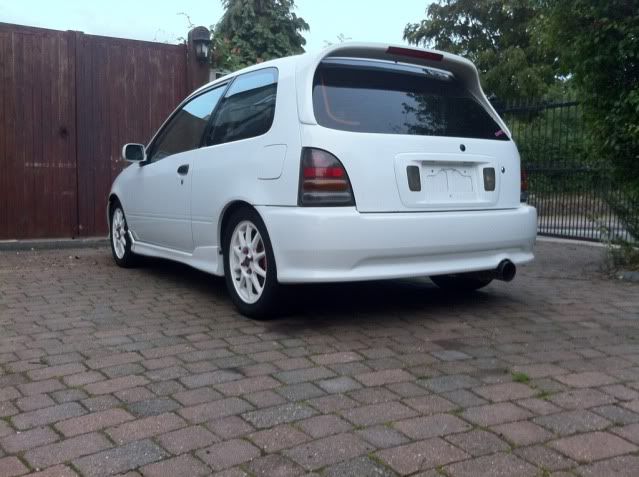

tez Posted May 27, 2011 Posted May 27, 2011 been on here for a while, after doing some good old research on "starlet glanza"i purchased one. At first i was after one unmodified,but didnt happen So i collected this from EdNeeded abit of work, and bit of TLC in areas.Im more of OEM+ guy so imo the spolier had to go!OLD newsA new genuine wheel bearing was purchased,After getting it pressed in at a garage, it was safe to say the hub itself was fucked,(it span in the hub) Opps.So i quickly found myself a hub Of ebay!Arrived and bobs your uncle was sorted.No play etc. But i still had a knocking noise when pulling away!so i went to other side and noticed the inner nut wasnt tight, tightend up and sorted. no knocking.A new speedo cable was fitted which was from toyota!The CV was leaking greese and was spraying up the chassis, so a new inner cv was purchased and fitted.After being given a set of pads, decided to fit them also, one of the 12mm nuts,wasnt 12mm, more like 11 3/4 lol tryed a few AF sizes but it was solid. Grinder!WearNew bolts where also purhcased from toyota! upper and lower for both calipers!A new fuel filter was also fitted!Few engine modifications took place!relocated New HKS filter to frontgood old baileys chav valve fitted aswell as a rocker cover breather and some silly red hoses:)My little custom earthing kitSounds very nice on boost!Bodywork needs TLC, so i started on the little spots on bodywork, Good old dodo bits purchased.Also purchased myself some tar remover for the annoying little black spots on bodywork!Thanks for mattymax?on youtubei restored the yellow haze headlights to a better condition. drivers isnt as good as passengers so needs quick re go over.!Oh & new wheels Ps the white bit on my bumper is abit of velcro for plate attachment!New Oil ready to be put in!Comments & critism welcomed Quote

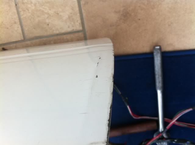

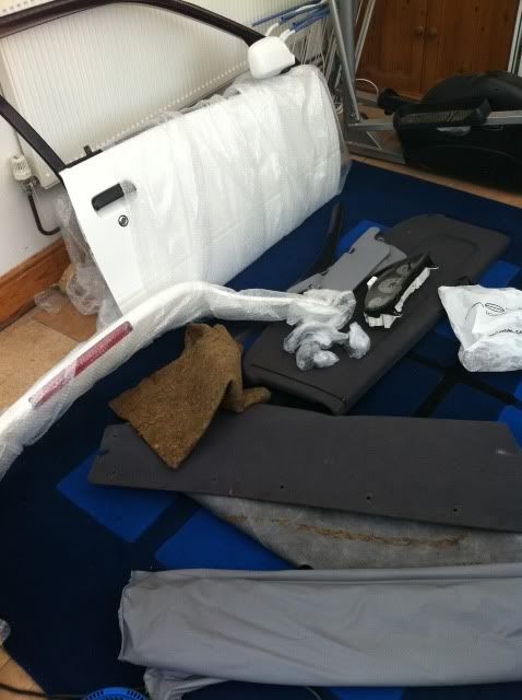

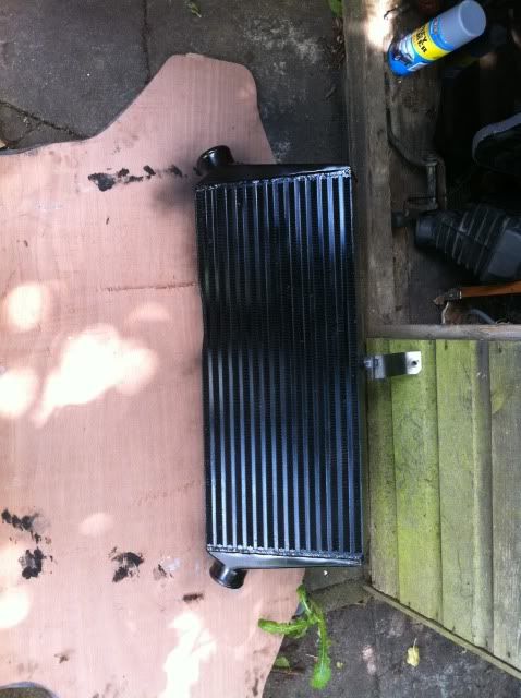

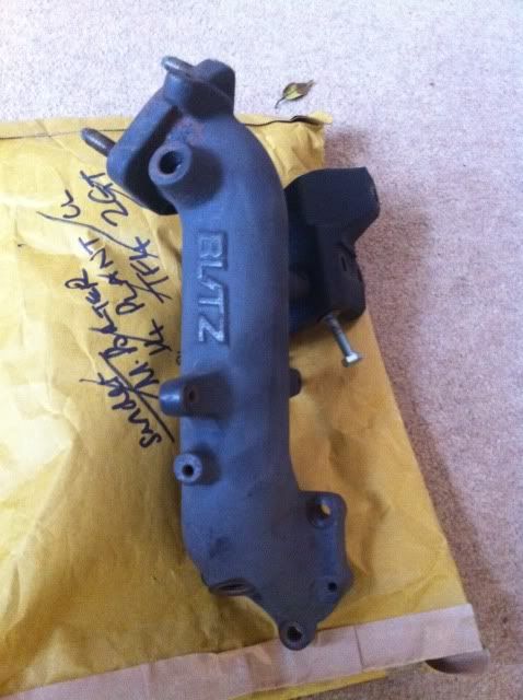

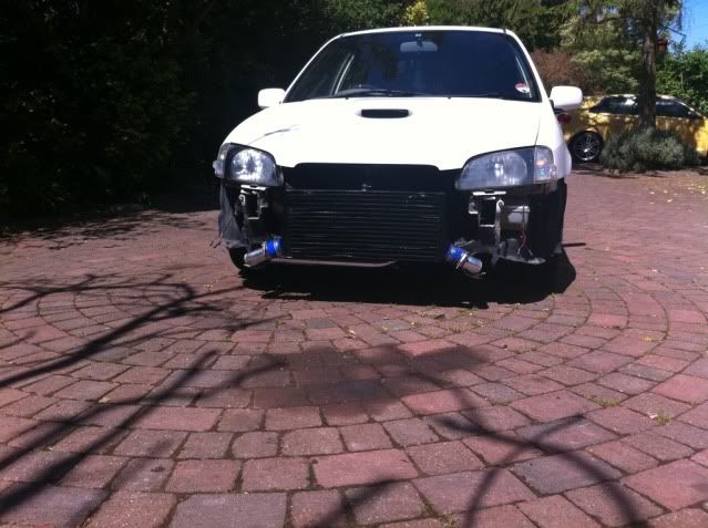

tez Posted June 2, 2011 Author Posted June 2, 2011 The damaged spolier i hadThanks to marc(morph) & stavros for bitsnewFCD incase i hit fuel cut, i wont be raising the boost it will just be boost creep.boost gauge finally lights upBlotz & bracket and bolts from jezzaOooo yeaTurns out not to be coilovers but a fmic from luke(thought i had won something in a competition FMIC blackold door marks & new door now on but i forgot to change the lock:@Got Nuts?Roof lining now in and fitted with new parcel shelf, boot carpet.Tryed to fit fmic earlier but had few issuses with top of bumper and it needing to be lower(the fmic)C&C welcomed.Car is starting to look how i want it too!I wont be fitting the blitz till a manifold is purchased as then i can kill two birds with one stone.the fmic sits pretty close to the air filter will this be ok for the filter to breath? suppose its better than the stock position. Quote
tez Posted June 3, 2011 Author Posted June 3, 2011 fitted icmade to brackets to keep it steady underneath,still got a slight bumper issue but its on!its started to chatter more at lower Boost then dumps?thats ok isnt it?Also my blitz decat, should i heatwrap it or as its cast iron will it make no difference? Quote
lukEp Posted June 4, 2011 Posted June 4, 2011 The bracket that were attached to the FMIC should have lined up to two bolt hole under the bottom cross member mate I didnt have to cut my bumper but it was 96spec Quote
tez Posted June 4, 2011 Author Posted June 4, 2011 I had to modify the top bracket to make it sit out more in cut outAnd then was two --- Welded straight shapes from bottom cross panel underneath intercooler so it's secure and ic sits on it. Win win. Quote

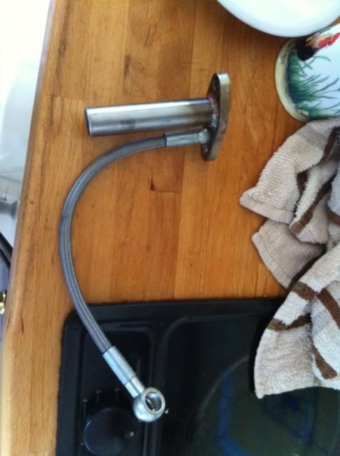

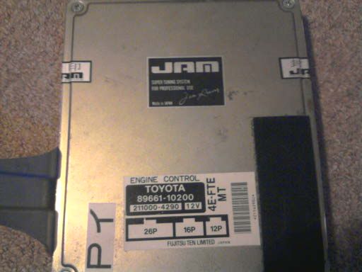

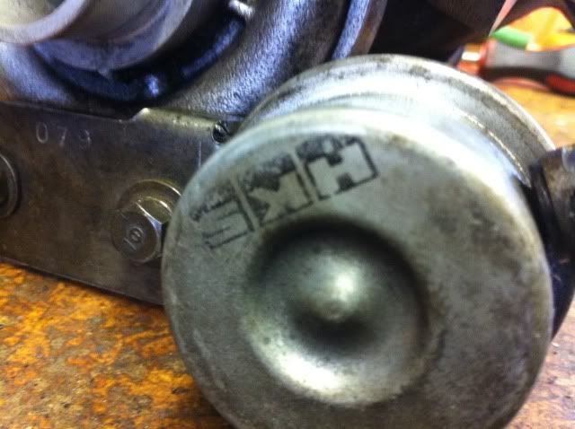

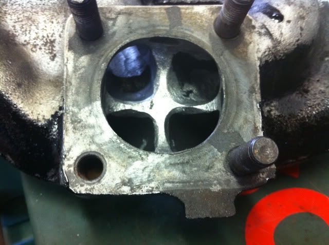

tez Posted June 18, 2011 Author Posted June 18, 2011 Purchased few bits Woop ep91 JAM ecu, seals intact etcvery happy at the minute.not fitted it yet as the turbo is still off.I finally ported the wastgate about 1/2mm with a hoover at hand(thanks to zac for the idea) Ported the manifold enough!Set the actuator at 0.9 barpainted the mani with high temp paint(black)fitted my cat bracket with allen key high tensil shiny boltsMy plan hopefully tomorrow(all going well)to fit turbo,mani decat back onand im also worried that the braided oil feed is going to leak,(due to the horror stories on here) its had a new gasket on it too! so touchwood it dont!going to start the car up on standard ecu, make sure no problems arise. then fit the JAM.Quite excited! guessing i should leave the car to idle for 20 mins, to make sure it sets it self correctly?you can see the the 2nd port on collector as the light shines bright through it:)quick pics of the mani porting, the one showing the porting was midjob,and just needing smoothing round. Quote

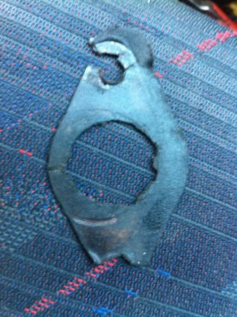

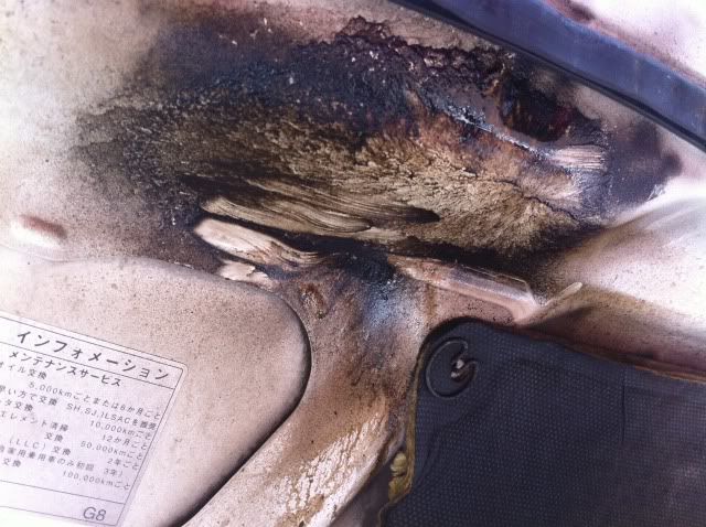

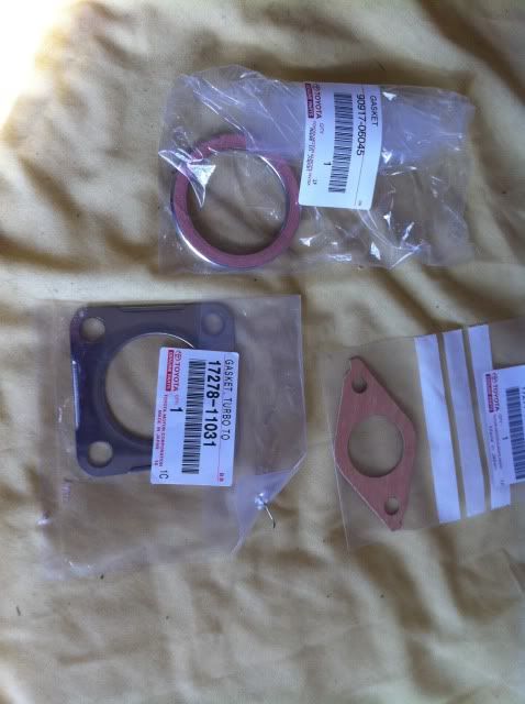

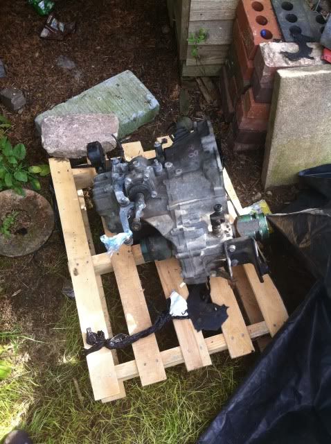

tez Posted June 20, 2011 Author Posted June 20, 2011 spoiler wasnt to my taste, the new owner got a bargain, im just happy i have a standard one now.After fitting the turbo back onto the car, it decided to shit itself and spit out oilcausing thisguessing i need them gaskets lolep91 Gearbox 60k off andy:)So the same day i got my spare turbo on,which is now on and running:)no oil, no smoke and im happy:)The car is currently running fine, but due to me going away for few weeks, will be garaged and battery taken off, so the alarm doesnt go off when my battery gets low.I havent drove the car properly apart from when purchasing the car, so carnt wait to get insured when i come back into the country.The speedo also decided to snap, after literally 1 mile max of driving. Internally. Which is weird,the cable was straight as possible with no kinks.so taking it back to toyota tomorrow and get one on warrenty.Current specBlue Braided Hoses all roundLower powerflex engine mounttoytuning front mount intercoolerHKS actuatorSwoosh boost gaugeHKS front relocated filterJAM ECUPorted manifoldCT9 turboBraided oil feedMagnacore leadsBlitz decatCustom 2.5 inch exhausttanabe sustec shocks & springsCusco Brake master cylinder stopperim happy with the spec ;) Quote

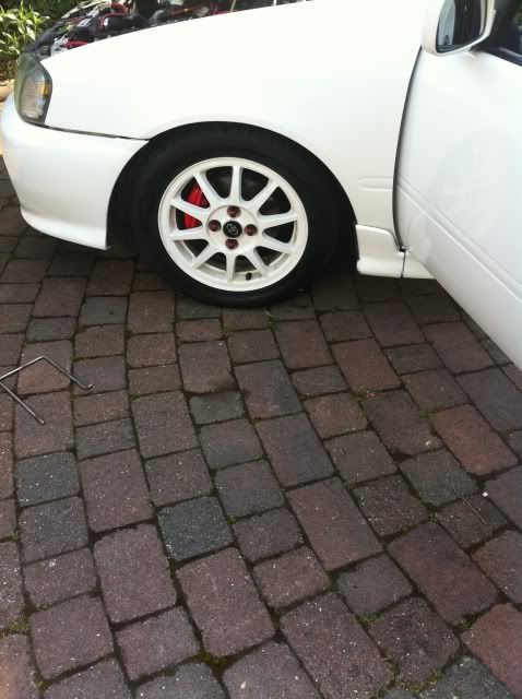

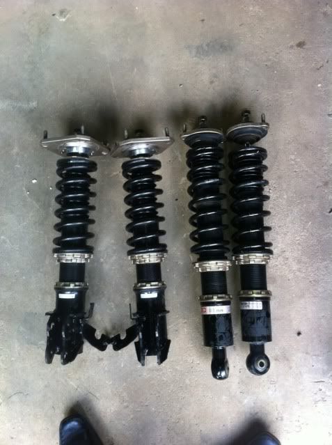

tez Posted July 12, 2011 Author Posted July 12, 2011 Trd knobBc coilovers literally got the rears fitted as soon as i got backnot sure if its low enough on the rear, how low do the bcs go?also how what camber should i run for a road setup?i dont want to rip through tryes. would it best me running a normal no camber?On the list is 4 wheel allignment after, not sure if theres many places in leicester Quote

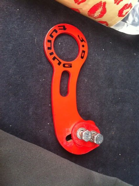

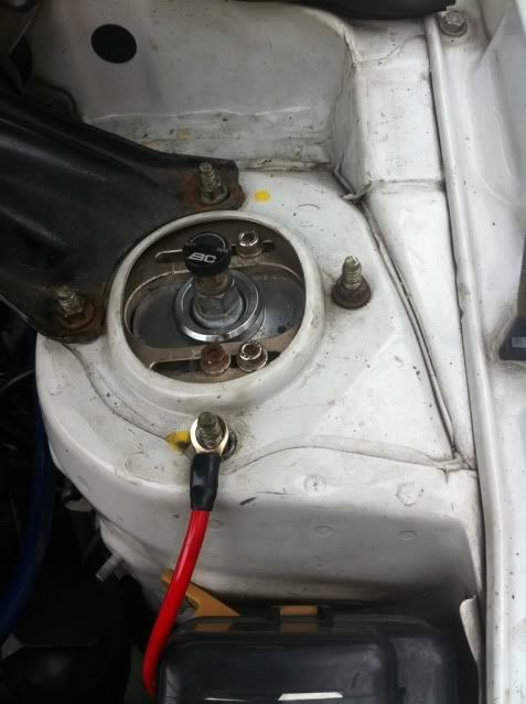

tez Posted July 14, 2011 Author Posted July 14, 2011 Pmd you Liam Update fitted the coiloversRears fineFronts seizedSo tried duck oil, pb blaster,plus gas & censolStill fucking solid By the looks of it going to need to grind of the collars and hope the threads underneath aren't fuckedAnd stick new collars on. Height of the carAs you can see. Front doesn't match back I know there's a mNut missing from earth lol Quote
ali_legend Posted July 14, 2011 Posted July 14, 2011 wow Nice tow hook lol good build mate, keep it up.! Quote
tez Posted July 14, 2011 Author Posted July 14, 2011 Yea it's pretty cool It's on now. Tryed pulling the car with it. All good.The coilovers are pissing me off Currently having a T break hoping the coilovers will adjust after lol Quote

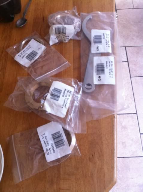

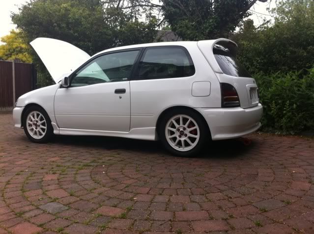

tez Posted July 15, 2011 Author Posted July 15, 2011 new collars and c spannersNow on car and lowered just over arches but not even for scrapping!I reset my actuator as it was boosting at 0.8 bari set it at 1 bar this time 121mmand its boost passed that (or on it)and popping a fmic pipe off.the one underneath (hot pipe)at first it popped one side off(had a massive mikolar(changed with it)then it popped off the back one)still a smaller mikolarIt boosts quick up to 1 bar and seems to pop it off and then rises up the boost to like 1.3 baris this because its overboosting?or the actuator is set to high?cheers lads Quote
