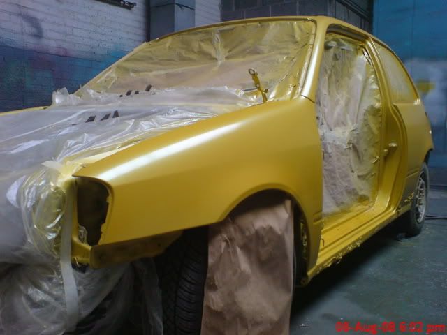

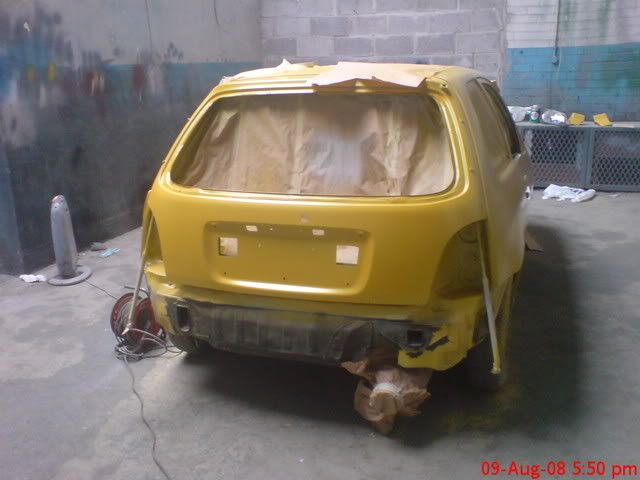

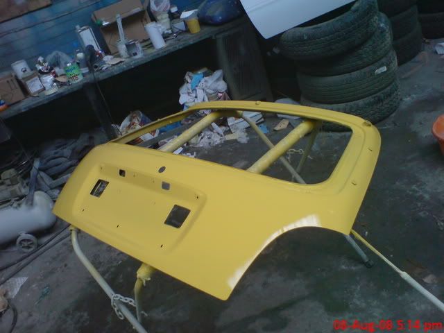

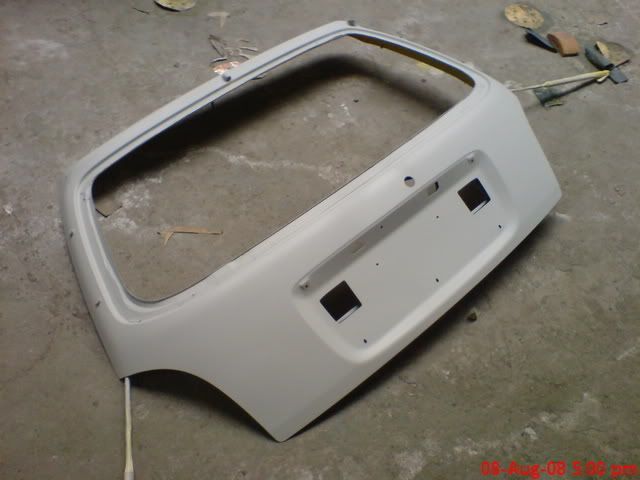

Idrees Posted August 8, 2008 Author Posted August 8, 2008 Got the new wings primed and based along with the bootlid.Groundcoat:Pearl coat:That's just one dry coat of the pearl that's why it looks quite dull. Also flushed the wing repeaters and the rear lock. Quote

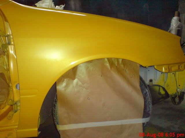

Sparky Posted August 9, 2008 Posted August 9, 2008 Colour looks GORGEOUS in that last pic mate ;)Whats stuck to the bottom of your rear quarter just behind the door though? Be careful with the flushed side repeaters mind mine wouldnt go through MOT ;) Quote
Galliano Posted August 9, 2008 Posted August 9, 2008 looks great mate ;)and sparkey.. im guessing its the bonding stuff for the sideskirts? Quote

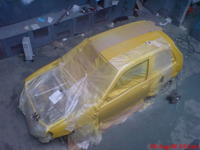

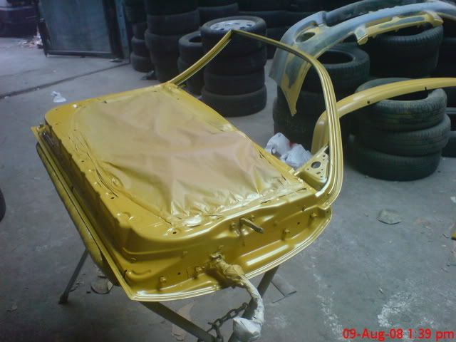

Idrees Posted August 9, 2008 Author Posted August 9, 2008 Too late to worry about the repeaters now! And yep thats some bonding glue from the skirt, total pain in the arse to remove so I painted over it as the skirt will cover that up nicely anyway.Got some of the pearl coats inside the doors:Panels back on the car:Hopefully it'll be all painted and lacquered early next week. Quote

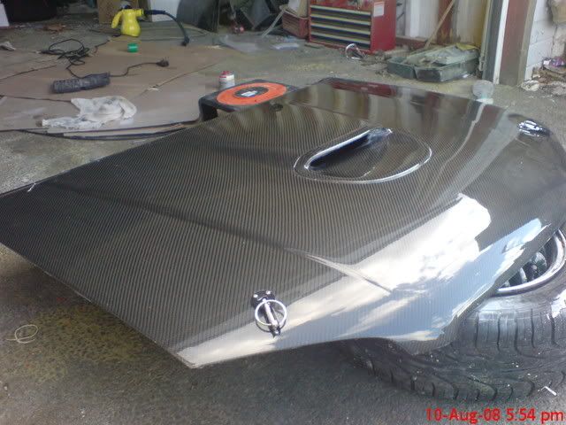

Idrees Posted August 10, 2008 Author Posted August 10, 2008 I gave my new bonnet a nice polish today too and fitted a new pair of bonnet pins in black ;) Quote
Idrees Posted August 11, 2008 Author Posted August 11, 2008 Nope I don't use the G3 anymore. I use something called Polish Abrasive made by Impa. Does the job as good as G3 without leaving behind swirl marks, bonus! I used that on a woolen buffhead with loadsa water. Quote
