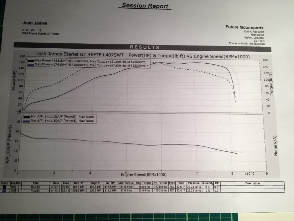

Josh@TunerLifestyle Posted April 18, 2012 Author Posted April 18, 2012 UPDATES!SHE MADE 200bhp! after finding out she was running lean and i could see better gains from using higher octane fuel , i went on my way to get it all sorted!found a rrfpr and set it to 2.7 and from now on its better fuel all the way! so took it back to an RR and this is how it turned out you can still see its running abit lean so will be turning it up to 3 bar and that should sort it heres a vid of the car on the rollers!http://s750.photobucket.com/albums/xx142/josheyboy006/?action=view¤t=722b3b85.mp4wasnt expecting the popping and banging from the exhaust at the end!but i was very proud of this old girl last night Quote
Socks Posted April 18, 2012 Posted April 18, 2012 Awesome Josh! I assume those figures r at the wheels yes?As good as 200bhp tbh! PM me your results and ill change your result on leaderboard! x Quote

Josh@TunerLifestyle Posted April 18, 2012 Author Posted April 18, 2012 cheers guys as i said im well chuffed with the result! plan is now to just keep her clean and look after her Quote
