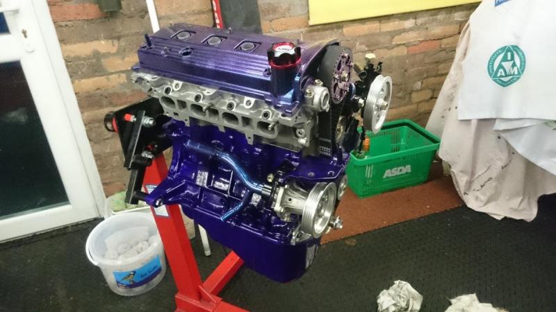

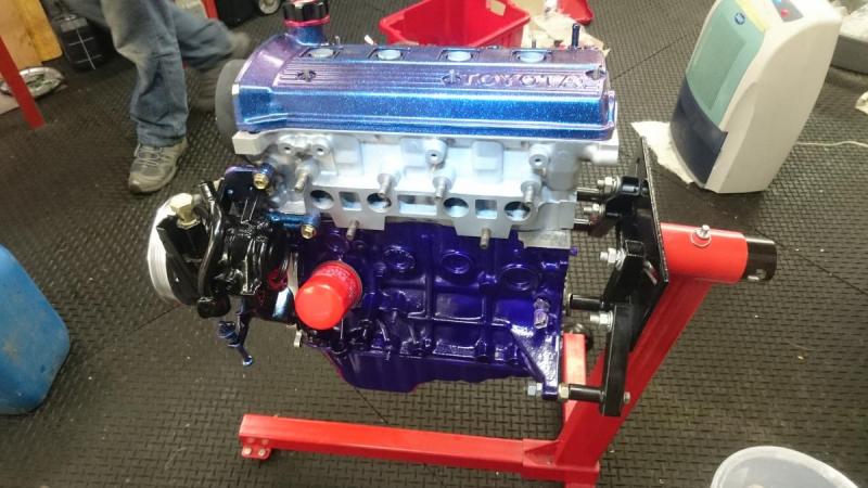

Chris Green Posted January 6, 2013 Author Posted January 6, 2013 All is running sweet now, 1800rpm until warm then just under 1000rpm when warm.Got the brakes all sorted so all I need now is hopefully a MOT and Tax.I changed the colour of the rocker cover too. Colour coded it with the body.Next plans are:Blue ignition leads to match the hosesSome bride seatsFull resprayAlloy wheel refurbCrystal fogs for the remix bumperCrystal Head lightsAnd that shout be it. Quote
shorty Posted January 6, 2013 Posted January 6, 2013 Looks sweet! Loving the 5e na tune, nice to see something different should be tourqey id of thought Quote
