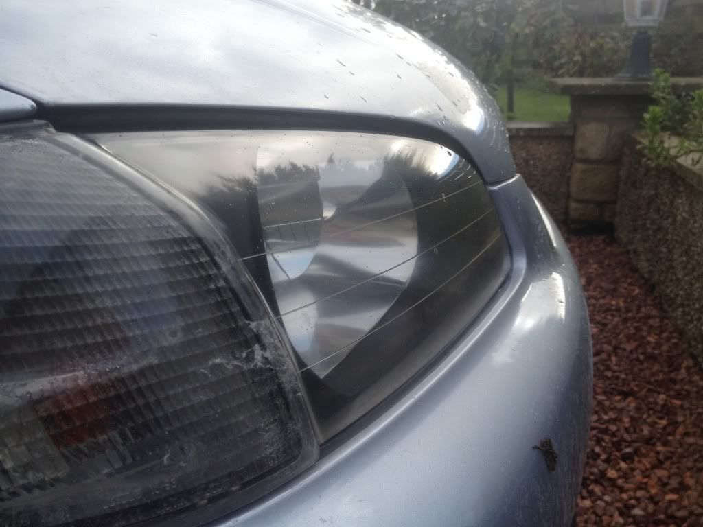

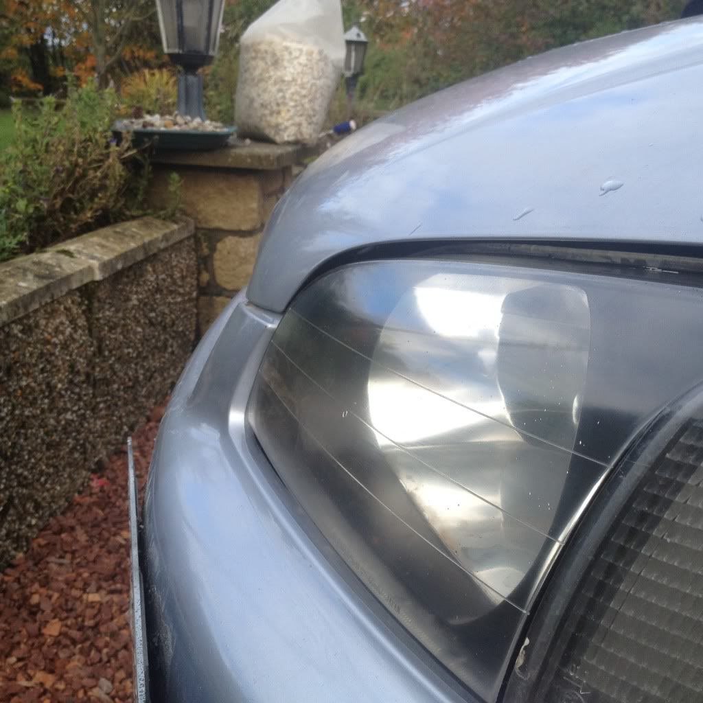

Evo_stevo Posted October 24, 2013 Author Posted October 24, 2013 Got this done 1st thing this morning. Both headlights were yellow looking, drivers side being the worse.Gave both the headlights a good rub with some 600 paper which removed a lot of dirt and scratches, I then gave it a few passes with some 1200 paper leaving both headlights cloudy looking.I polished both lamps by hand with some farecla g3 compound, this brought them up not to bad but still left a few light scratches. I then used the electric polisher and gave them a couple of passes with some water and g3 compound again which cut the rest of the visable scratches out.Never took any before pictures but both lamps were yellowed, the drivers side was the worst.Here's a couple of pictures of how they look now.Still a few marks but overall I'm happy enough and so should my mot tester be Quote
