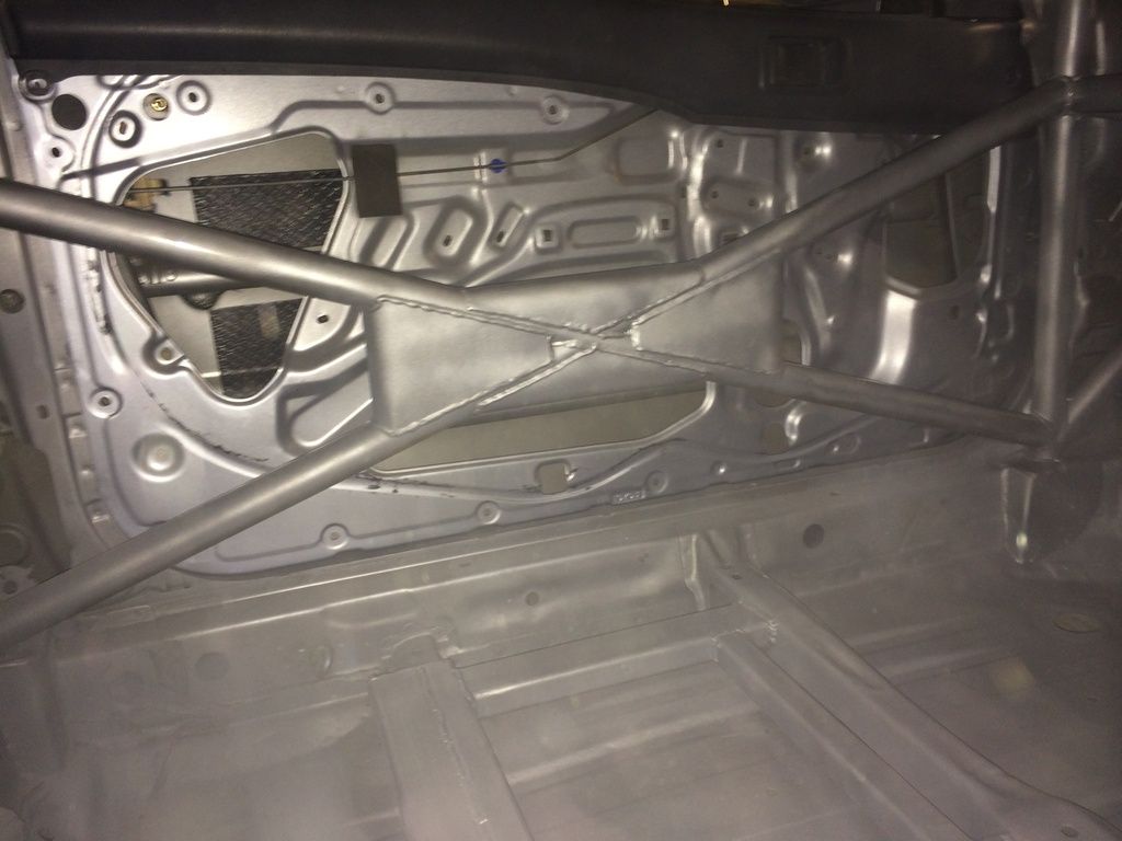

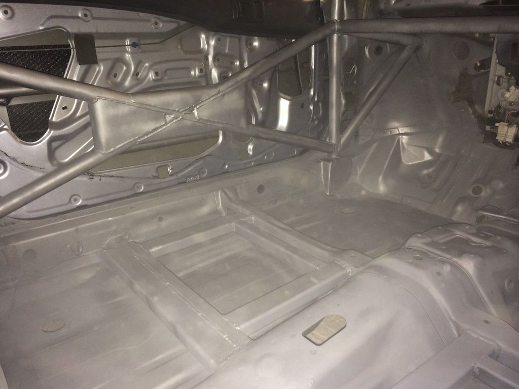

jiggaman_16 Posted November 29, 2015 Posted November 29, 2015 They've taken the rear legs and welded them to a cross bar which is between the rear suspension turrets. It would be better if the rear leg's were on top of the rear suspension turrets. You'd usually weld a plate onto the top of that area to strengthen then weld to that. Hard to explain with out a pic. It'll be more than fine though. Is there a X bar in the roof? Same thing i was saying. 1) the plate welded onto the wheel arch part of the shell looks a bit small. 2) The diagonal bars running from the roof part of the cage to the wheel well, those normally meet the wheel well at the front of the well (facing towards the front of the car) or on top as RobSR said Note, this is constructive criticism, not tearing anyone down. Quote
Bussey Posted November 29, 2015 Author Posted November 29, 2015 Same thing i was saying. 1) the plate welded onto the wheel arch part of the shell looks a bit small. 2) The diagonal bars running from the roof part of the cage to the wheel well, those normally meet the wheel well at the front of the well (facing towards the front of the car) or on top as RobSR said Note, this is constructive criticism, not tearing anyone down. No stress man, easy to forget how everyone on the forum builds cages for a living Quote
jiggaman_16 Posted November 29, 2015 Posted November 29, 2015 No stress man, easy to forget how everyone on the forum builds cages for a living Good luck with the project. Quote

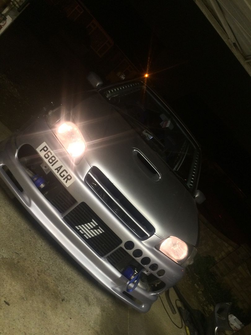

Bussey Posted February 1, 2016 Author Posted February 1, 2016 Words. Cannot. Describe. How. Stressful. This. Has. Been.Have some pictures, haven't had time to take loads because I've been balls deep in getting this done.Everything's now done minus a few little nigglys, just waiting on custom inlet and my exhaust manifold bank from having some changes then were off for mapping on March the 4th Note to everyone. NEVER EVER RE-SHELL A CAR IN YOUR GARAGE ITS A LIVING HELL. Quote

Bussey Posted February 2, 2016 Author Posted February 2, 2016 So sad to hear about the crash, glad everything is fine and sorted now... One question though, what's with the hole?Air hole mate, acts like AC during summer Quote
