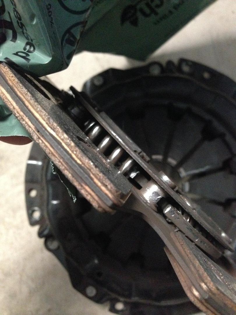

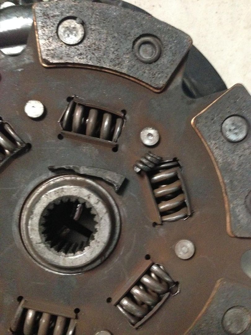

Broony Posted December 14, 2014 Author Share Posted December 14, 2014 Well found the problem, it's the competition clutch from Idrees! Part of the clutch disc has came away and small spring has came out! So lucky it never scored my brand new zep flywheel!! Annoying thing is clutch is only 6 month old max !! Pictures soon Quote Link to post Share on other sites

Broony Posted December 14, 2014 Author Share Posted December 14, 2014 Quote Link to post Share on other sites
daniel_g Posted December 14, 2014 Share Posted December 14, 2014 Yeah not good at all. What are they rated to ? Quote Link to post Share on other sites
Broony Posted December 14, 2014 Author Share Posted December 14, 2014 Sure it's stage four so should be more than enough for my low 220bhp Quote Link to post Share on other sites
mikey4410 Posted December 14, 2014 Share Posted December 14, 2014 get on to iddy and get a replacement man.thats not normal. Quote Link to post Share on other sites
TurboTobz Posted December 14, 2014 Share Posted December 14, 2014 get on to iddy and get a replacement man.thats not normal.*refund Quote Link to post Share on other sites
Idrees Posted December 14, 2014 Share Posted December 14, 2014 First one I've seen fail and we've sold dozens, I'm sure Competition Clutch will be willing to sort something out. Please send me a PM with your original order/invoice number and all the pictures and I'll forward them on. Quote Link to post Share on other sites
