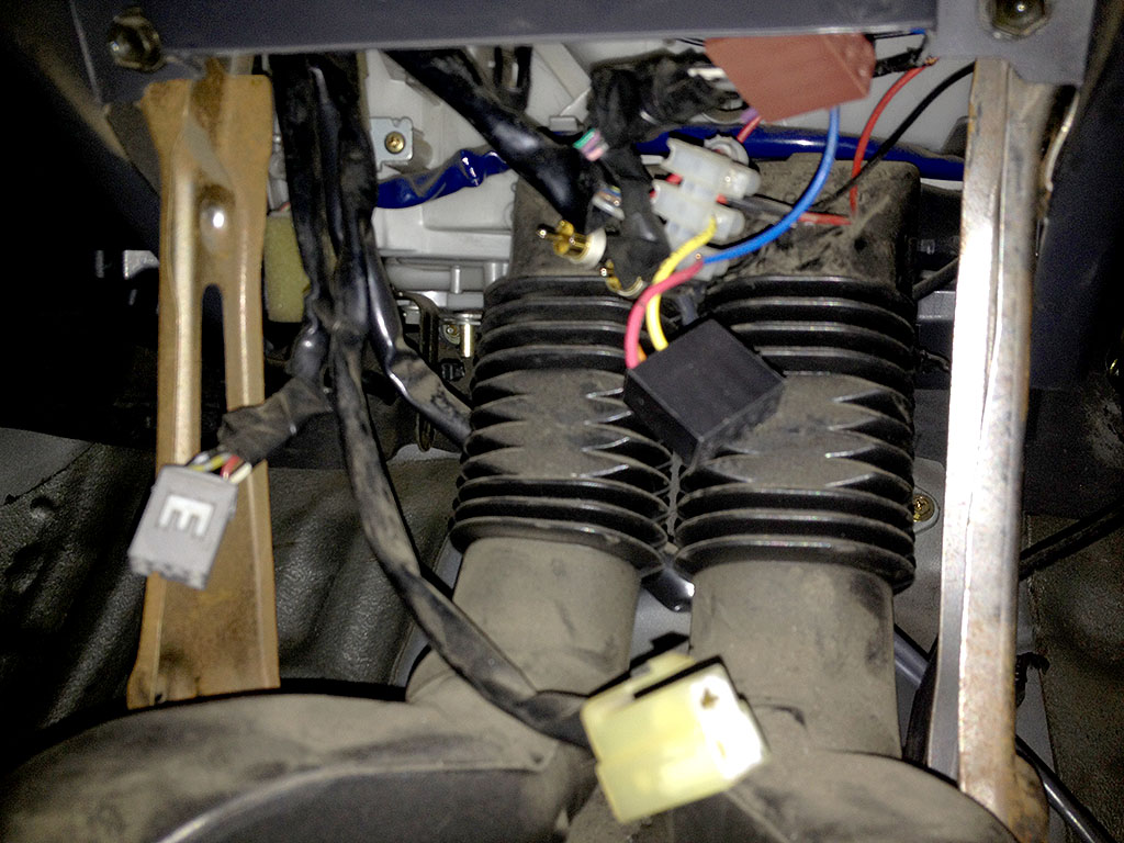

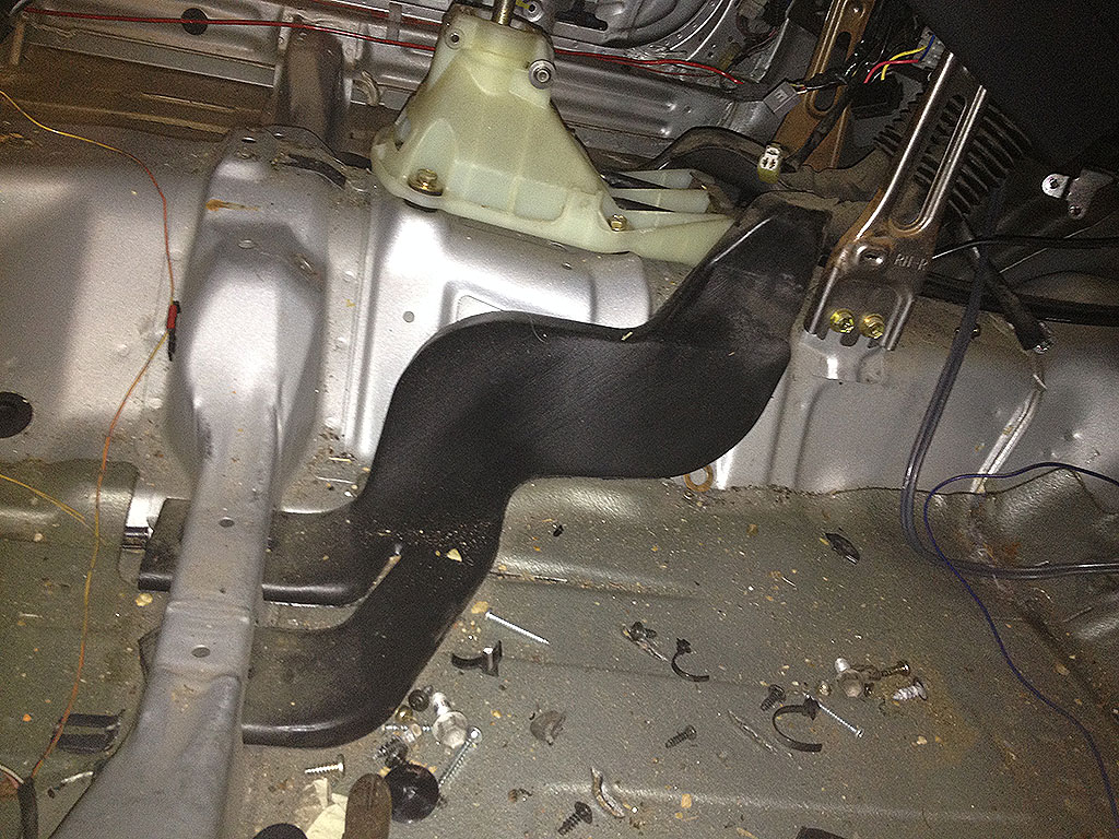

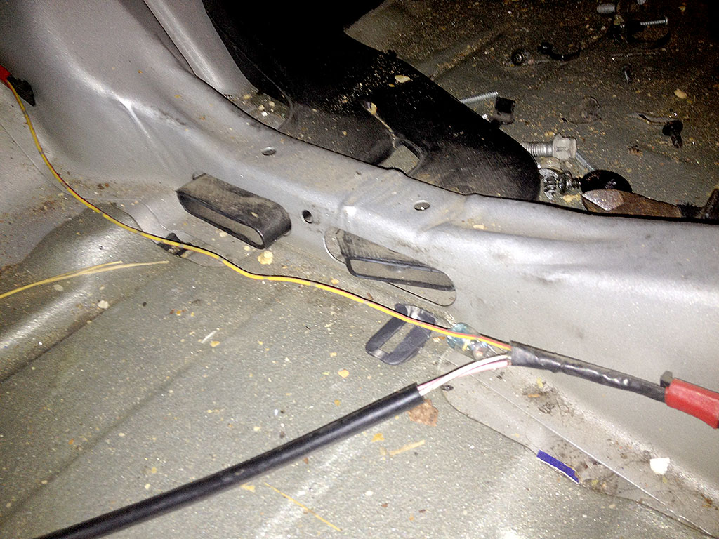

Socks Posted January 17, 2015 Posted January 17, 2015 I was stripping a dog of Starlet GT Turbo that had a blown engine this weekend, and I lifted the carpet to see something I've never seen before in a GT or a Glanza for that matter.Excuse the pics, low light conditions and the car was a fucking disgrace, thumbs DOWN to the previous owner! Ever wondered what the gaps were in those strengthening beams...? Follow the ducting back.... They attach the the bottom of the heater box.... The carpet is simply cut out under the seats by Toyota..... So they are rear interior heater/coolers?Wasn't aware of this at all? Anyone else seen this before? Quote

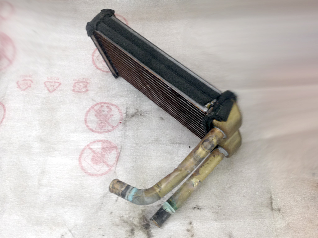

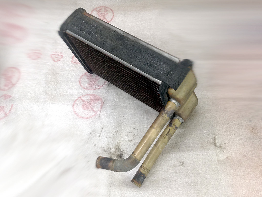

Socks Posted February 2, 2015 Author Posted February 2, 2015 The Plot thickens... This same GT had a much much much bigger starter motor & different/heavier alternator.... Ontop of that, the heater matrix was huge, compared to stock... Stock: Out of this GT: Way Way Way bigger/thicker. To give better heating...My friend adam disagrees this is a winter model due to it not having yellow foglights... However one foglight was new, and one was old. No idea if they were original or not. Not do we know if the radiator was thicker as like i said it had a civic one on it.... Unsure at what point a starlet becomes a "Winter" model... Quote
