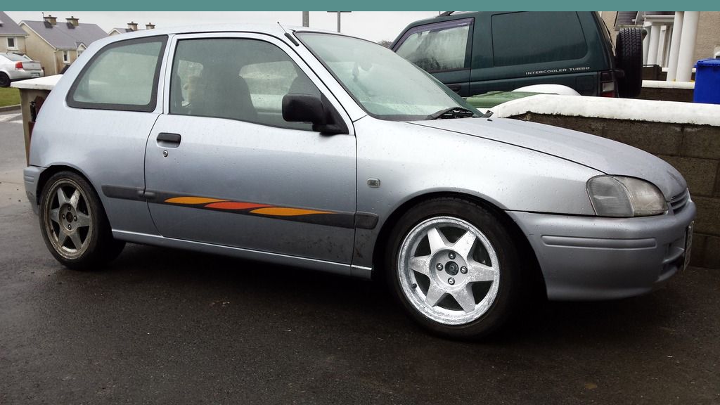

Rich-k Posted March 12, 2015 Posted March 12, 2015 Thats fantastic work matey! Id paint those wheels personally! Quote
JDMfreak Posted March 12, 2015 Author Posted March 12, 2015 i think thats what i might do finish sanding them and paint them white as was metioned before and maybe lower it and a set of clear indicators upfront Quote
Rich-k Posted March 13, 2015 Posted March 13, 2015 Thats a good idea man they will look good nice clean and original polished wheels are a nightmare if you laquer them you never know when there gunna flake as laquer wont stick to bare metal n uf you keep them bare you have to constantly wax them or they will just corrode haha when you paint them tho make sure you etch primer them first as the paint will just flake off the bare metal other wise Quote
JDMfreak Posted March 13, 2015 Author Posted March 13, 2015 ive decided gloss white im going to do the wheels same colour i painted the spoon str reps on first page. Iknow polished wheels are a nightmare to keep clean and unstained with rain,,laquer never takes to aluminium always flakes even when done 100% right,, Will be getting some proper alloy primer and a good few heavy coats aswell and a good roughing up of the wheels to give the primer something to grab too Quote

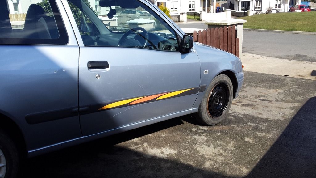

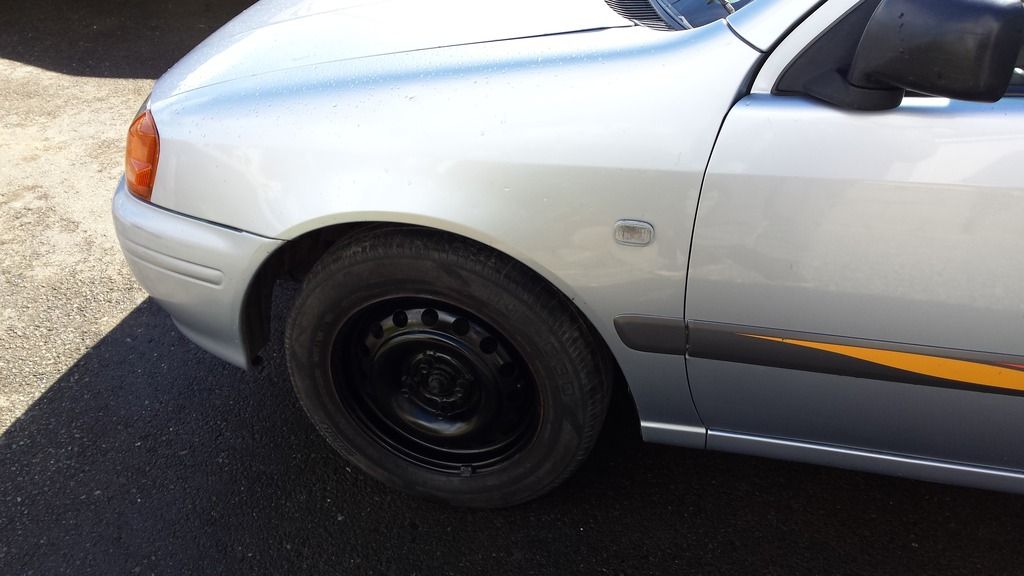

JDMfreak Posted March 27, 2015 Author Posted March 27, 2015 im not sure what to do with the car th wheel i had planned on fitting to the car i may sell as i owe money to somone so car will have to roll on steelies for a while the oil burning situation is annoying me the most as i cant afford to keep topping it up and currentley has no (mot) nct or tax so im chancing using it i just dont have the money to do anything at the car currentley with no work and a wedding to pay for so my only thing is scrap the car and use the funds on the wedding Quote

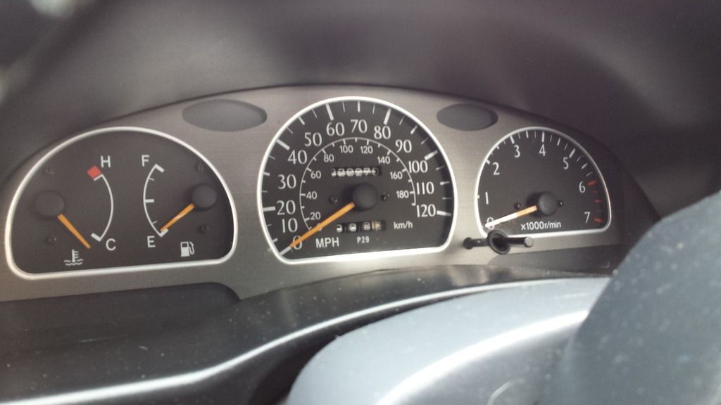

JDMfreak Posted March 28, 2015 Author Posted March 28, 2015 last pic i'll probably post of this but here goes clocks i only fitted the other day will be buying a new car soon prefeably another toyota glanza/or gt this i will leave at the back of house for now Quote

Walker96 Posted March 28, 2015 Posted March 28, 2015 last pic i'll probably post of this but here goesclocks i only fitted the other daywill be buying a new car soon prefeably another toyota glanza/or gt this i will leave at the back of house for nowHow you fit clocks mate? Tired the other day didn't work Quote
JDMfreak Posted March 29, 2015 Author Posted March 29, 2015 followed a guide on here on how to fit them depend though what year your car is mines a 96 so M L Reg tried it before with a 98 starlet and it didnt work best was to check is look at the guide and make sure you have the same colour wiring if you do your good to go Quote
Walker96 Posted March 29, 2015 Posted March 29, 2015 followed a guide on here on how to fit them depend though what year your car is mines a 96 so M L Reg tried it before with a 98 starlet and it didnt work best was to check is look at the guide and make sure you have the same colour wiring if you do your good to go Cheers mate, mines a 96 as well Quote
GlanzaJim Posted March 29, 2015 Posted March 29, 2015 Dudeee said so many times get CD or GLS model clocks there plug and play no shitty wireing changes Quote
Walker96 Posted March 29, 2015 Posted March 29, 2015 Dudeee said so many times get CD or GLS model clocks there plug and play no shitty wireing changes I have to gls ones mate tried it didn't work Quote
GlanzaJim Posted March 29, 2015 Posted March 29, 2015 Strange man, my CD ones fitted straight in Quote
