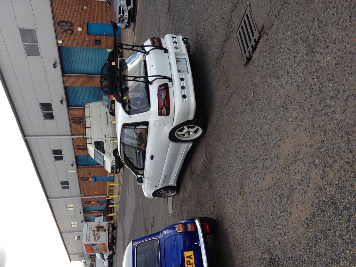

Socks Posted February 22, 2016 Posted February 22, 2016 I think the wing is effective, in that it works. I really didn't expect any reduction in time until I get the front aero sorted to balance it out. I did my quickest last sector, which makes sense with the wing helping around the last corner of Tsukuba. The car felt more stable under brakes and around the higher speed corners. I did loose a little top speed down the track and noticed more understeer, but this could be a combination of pushing a little harder, tyres getting old/worn and also the track conditions on the day. Sounds like its doing exactly what its supposed to be doing! Which is great news. Everyone that's run one so far has reported the same so im pleased.... Car looks stunning now, looking forward to seeing it get a splitter! Quote

starletezy Posted July 27, 2016 Posted July 27, 2016 How does the big rear wing feel on track mate? I got this one on mine much smaller feels good so far Quote
EP82 Touge Posted July 27, 2016 Author Posted July 27, 2016 I think the wing is effective. Also it should help more once I have more power and the front aero is balanced out. Quote
starletezy Posted July 27, 2016 Posted July 27, 2016 Good to hear some feedback as I'm developing my aero as well what front canard's you running they custom? Quote
