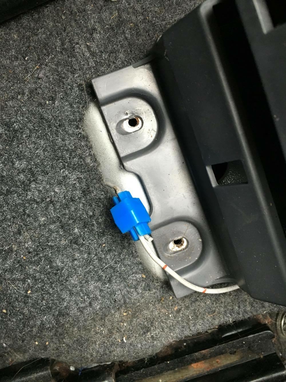

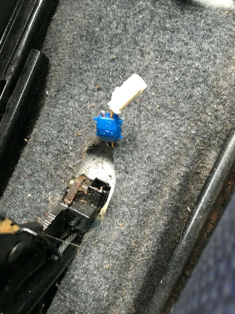

Currently having an issue with the handbreak light on the dash permanently bring on. The car feels fine and I'm pretty sure the handbreak isn't actually sticking I think it's just the light on the dash? Anyone know how I can sort this? Cheers
The wire will be damaged somewhere and earthing, which will cause the light to come on and your turbo timer to stop working. If wired in correctly a turbo timer will only work when the handbrake is applied to stop someone jumping in and diving off with it.
The wire looks crimped to me in the bottom picture just as it comes out of the carpet.

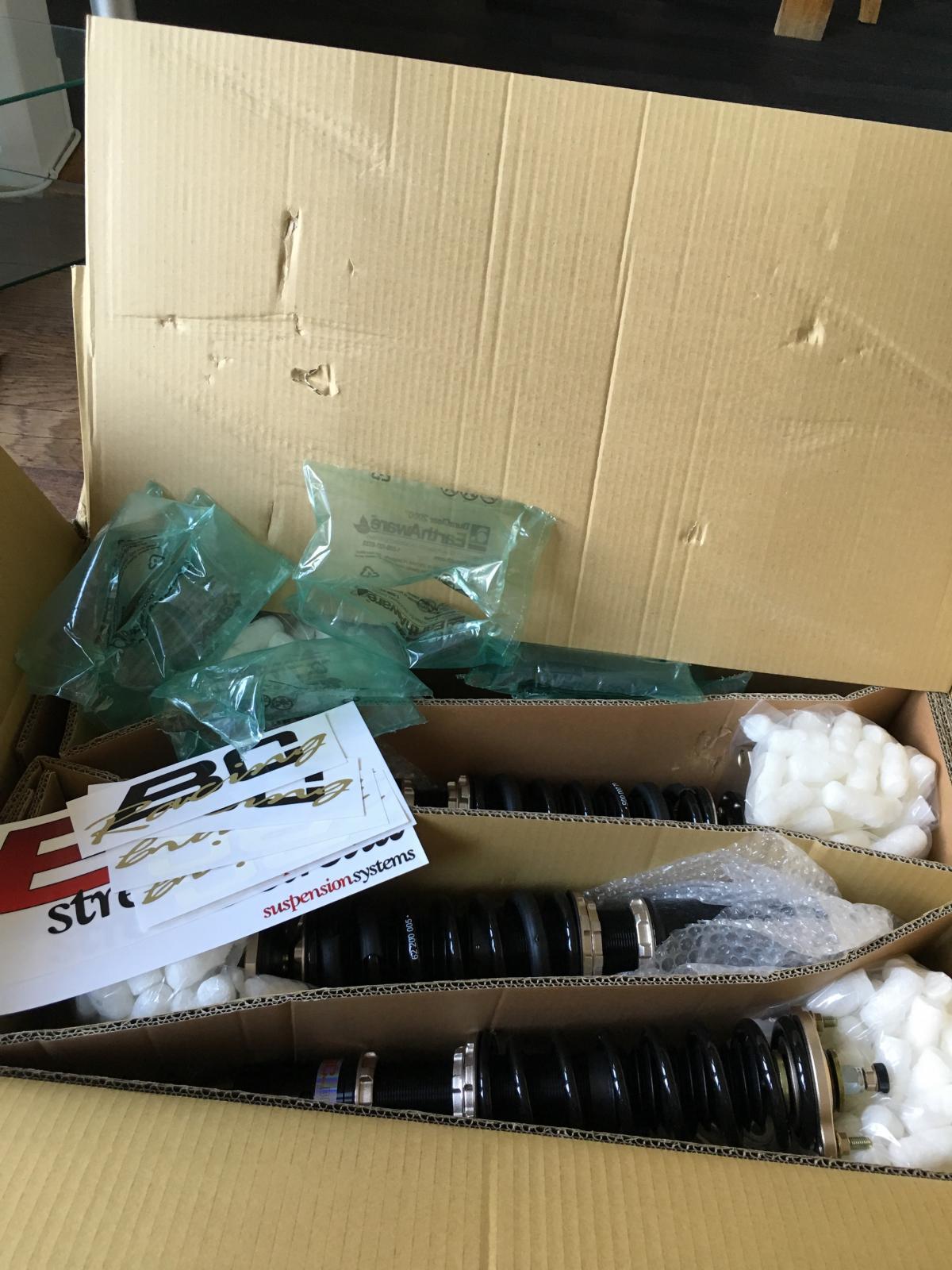

Little delivery came today and they look like impressive bits of kit!
Aw mate they look epic I'm So jealous haha get them on! Would be good to know what you think of them as I'm not sure which brand to go with really! relative comfort is something I need in my car for passengers haha
Tell the passengers they can walk if it's a bit bumpy 😂 I've gone with slightly softer springs and I'll probably run them fairly soft as its my daily again. I'll let you know what I think to them qhen they're on and all set up 😊
Haha I would do but girlfriend has joint problems so that would be abit rude 😂 Right I see is that the springs that have come on the coilovers? Really interested to know what they're like. How much where they all in by the way buddy out of interest? 😊
