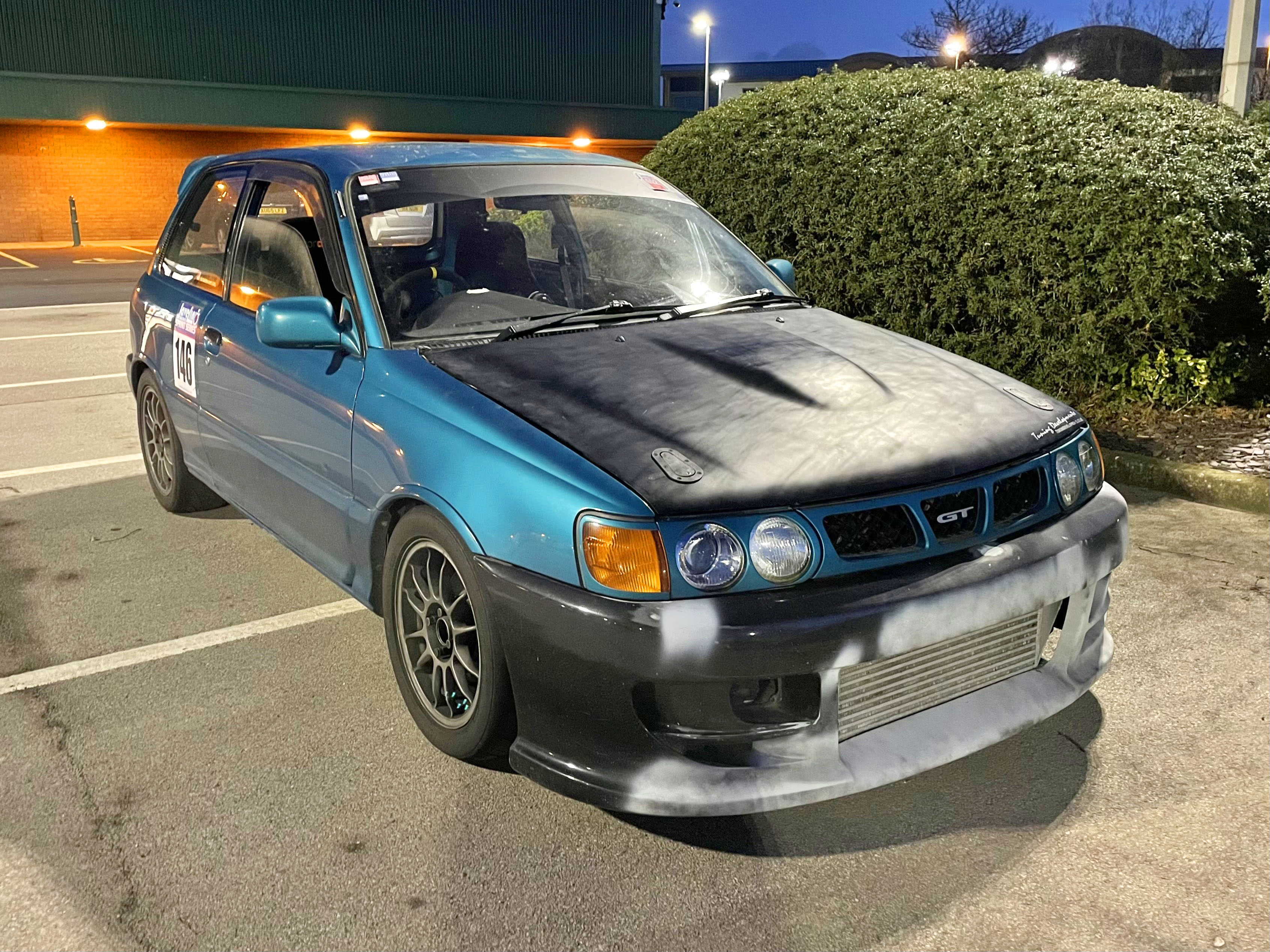

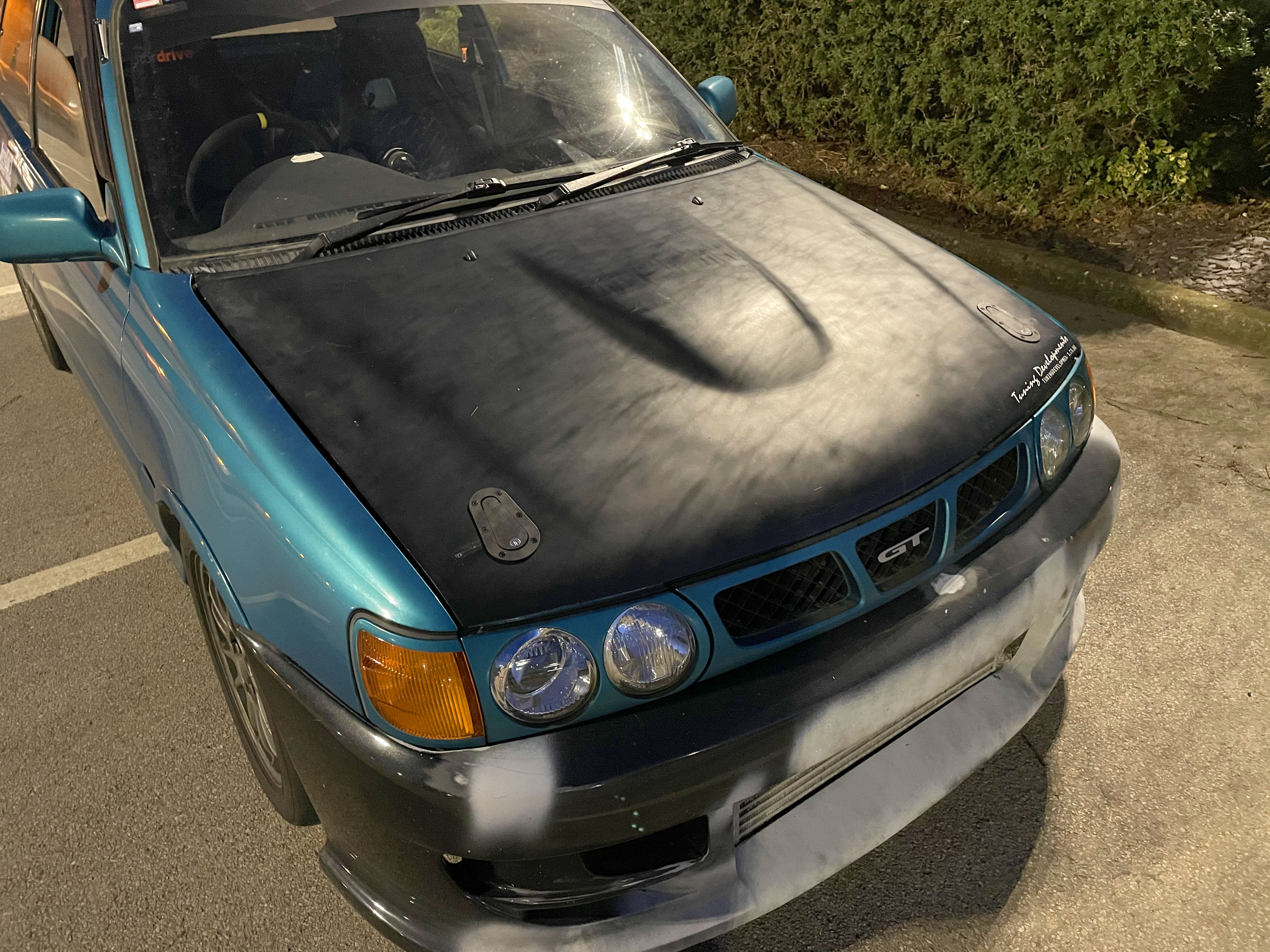

Socks Posted March 22, 2021 Author Share Posted March 22, 2021 On 3/13/2021 at 9:41 PM, Sam44 said: Thanks for the information, the setup looks well balanced on the videos. I had no idea about chamber bolt's. I've just found them now. Thanks. No worries dude! On 3/20/2021 at 9:55 PM, Devs313 said: Nice build Socks. Hows she holding up on the stock internals at that sort of power and boost? Pretty impressive bud. Solid dude. Literally ARP Headbolts to cope with the TD04 Hybrid. Haven't had a problem since. ----------- So, got my Carbon Bonnet on! Its even a Gi one too with no scoop! Perfect! Found it on ebay of all places, bargain too! Collected it fairly local! Fitted with brand new Aerocatch Extreme bonnet clips too! So it will allow me to remove all the original bonnet mechanism, latch, cable to save even more weight! The standard bonnet on these cars is ridiculously heavy, so this is over 25kg of weight saving alone! lockable version of course, so I can actually park it in a car park! Quote Link to post Share on other sites
