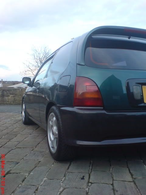

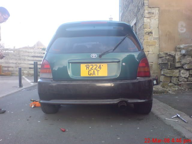

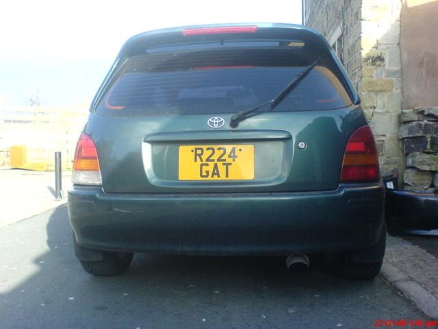

Idrees Posted March 22, 2008 Author Posted March 22, 2008 Lol at Rob BowerFitted the rear Glanza bumper today, even though its black!OldNewShould have the passengers side 96 spec Glanza lense soon too to go with the Glanza look. Quote
Tayyib Posted March 25, 2008 Posted March 25, 2008 cheers guys.i ended up running at york raceway.got 17.7 on the quarter mile as my quickest and that was in the wet. which im happy with for now. im also still running on the 5E-FE ECU and it seems to be running allot smoother. Quote

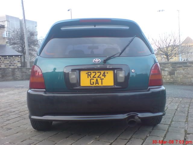

Idrees Posted March 27, 2008 Author Posted March 27, 2008 Got a Glanza passengers lense today, thanks to David.We decided to fit the number plate holder on at the same time, its in black yet just like the bumpers.I'll get some proper pictures tomorrow. He needs to get a new import number plate made to fit in there nicely. Quote

Sparky Posted March 29, 2008 Posted March 29, 2008 How easy is it to fit the numberplate surround?Toying with the idea of a CF one Quote
Idrees Posted March 29, 2008 Author Posted March 29, 2008 Pretty straight forward.I trial fitted it with the reverse lights out and made a marking on the tailgate for the the reverse lights because they stick out fromt the back, therefore the tailgate is too shallow for them. Then I got the angle grinder out and made two big holes. Put loads of bonding glue on the tailgate and inside of the plate surround to ensure it doesn't rattle, stuck it on with masking tape holding it in place and put the two nuts back on from the inside of the tailgate. Quote
Tayyib Posted March 30, 2008 Posted March 30, 2008 that depends which way i go mechanics/bodywork, but if i dont do bodywork then there is always u to do it lol Quote
Sparky Posted March 31, 2008 Posted March 31, 2008 Cool I thought the tailgate would need grinding for the plate holder to fit flush Quote

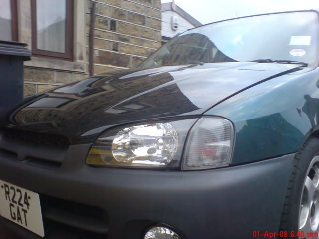

Idrees Posted April 5, 2008 Author Posted April 5, 2008 Just thought I'd add a few new pictures and some very small updates..Random one of mine..Raised bonnetIce white headlight bulbs(Old on the right and new on the left)The car is now running on a 5EFE ECU Quote
scutch0 Posted April 6, 2008 Posted April 6, 2008 nice pics, when is it being painted?surely it'll have a much lower rev limit with a 5e ecu? Quote
Dean @RW-Developments Posted April 6, 2008 Posted April 6, 2008 looks like its coming along nicely mate Quote
Nanglebadger Posted April 6, 2008 Posted April 6, 2008 comin along great and really quick too!Keep it up guys!Phil. Quote
Tayyib Posted April 6, 2008 Posted April 6, 2008 im not sure there is a rev limit difference, but oh wel its running on this ecu until conversion now, respray will be in 6-7 weeks hopefully. Quote
Idrees Posted April 6, 2008 Author Posted April 6, 2008 According to the rev needle, it hits the limiter at 6200. That is obviously not accurate though. From sitting in the passengers seat it does feel like it redlines quicker than it did before but not so much difference.If I'm spraying it, it will be after all my exams which will be the end of May. Quote
