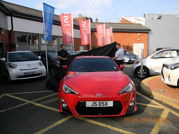

Anyway long story short, lots of emails, phone calls and poking around. My Car had to go into RRG Macclesfield for some warranty work. They also kept pushing Toyota, eventually we were allowed to import a premiered TRD Kit! And Toyota UK let it slip through on the 'understanding' it would be painted white or black.... But gave us a nod to paint it Red! Was more for paper work on the system than anything else!
10615900_10152607209944757_1995369815_n_
Anyway after a month of long waiting for parts, work and tick boxes. My TRD Baby was born!
10705112_515516375250515_1023786875_n_zp
10251893_10152675505014757_3126605657314
10628574_10152678955054757_4559108108176
