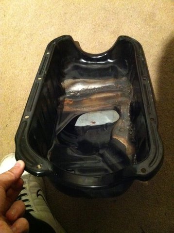

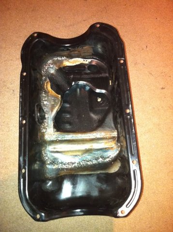

akyakapotter Posted April 14, 2016 Posted April 14, 2016 (edited) Charlie have you seen the welds on the zep sump it's shocking. Edited April 14, 2016 by akyakapotter Quote
Charlie28 Posted April 14, 2016 Posted April 14, 2016 Charlie have you seen the welds on the zep sump it's shocking.tmp_5387-032(2)-1506351472.jpgtmp_5387-002(2)1155137067.jpg I didn't know! Just saw it on RHD! That's crazy bad! Quote
MR-2 Posted April 15, 2016 Posted April 15, 2016 Hah, that why RHD didn't have inside picture, horrible Quote
Johnboy GT Posted April 15, 2016 Posted April 15, 2016 I've a sump similar to the one above. I has my welds redone though.John Quote
aleximport25 Posted April 15, 2016 Posted April 15, 2016 they guy who welded those sumps looks like this that is appalling though Quote
