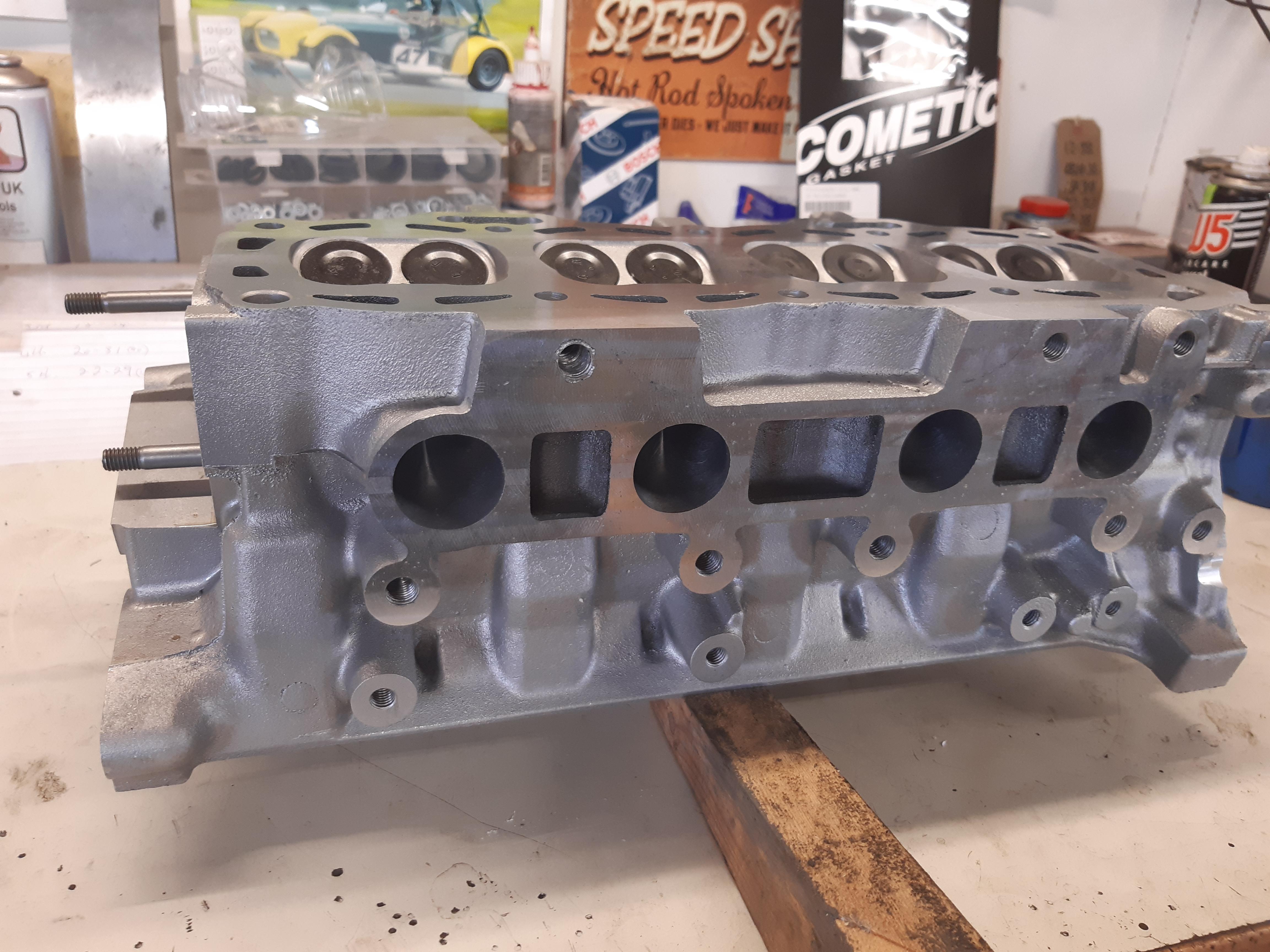

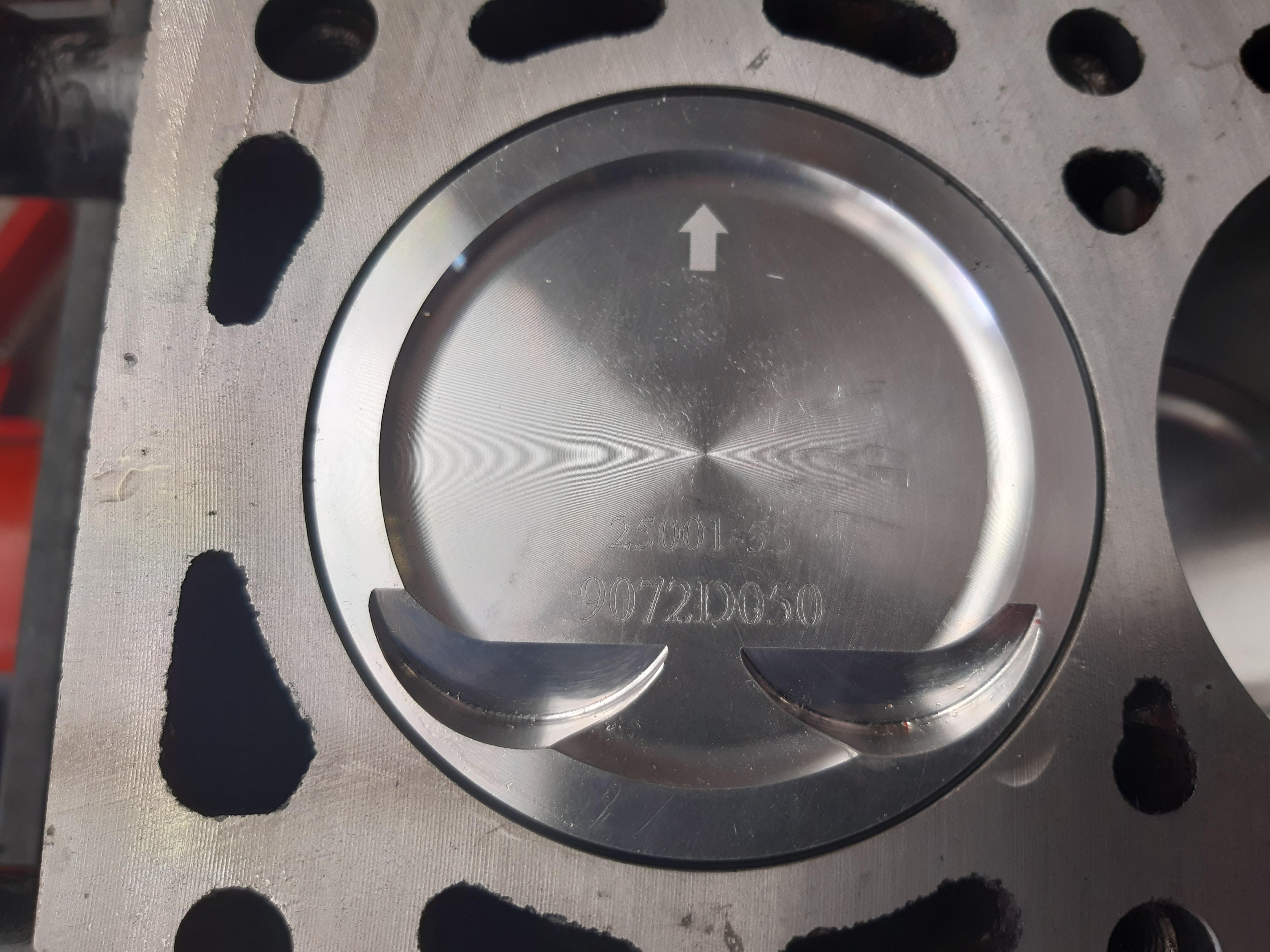

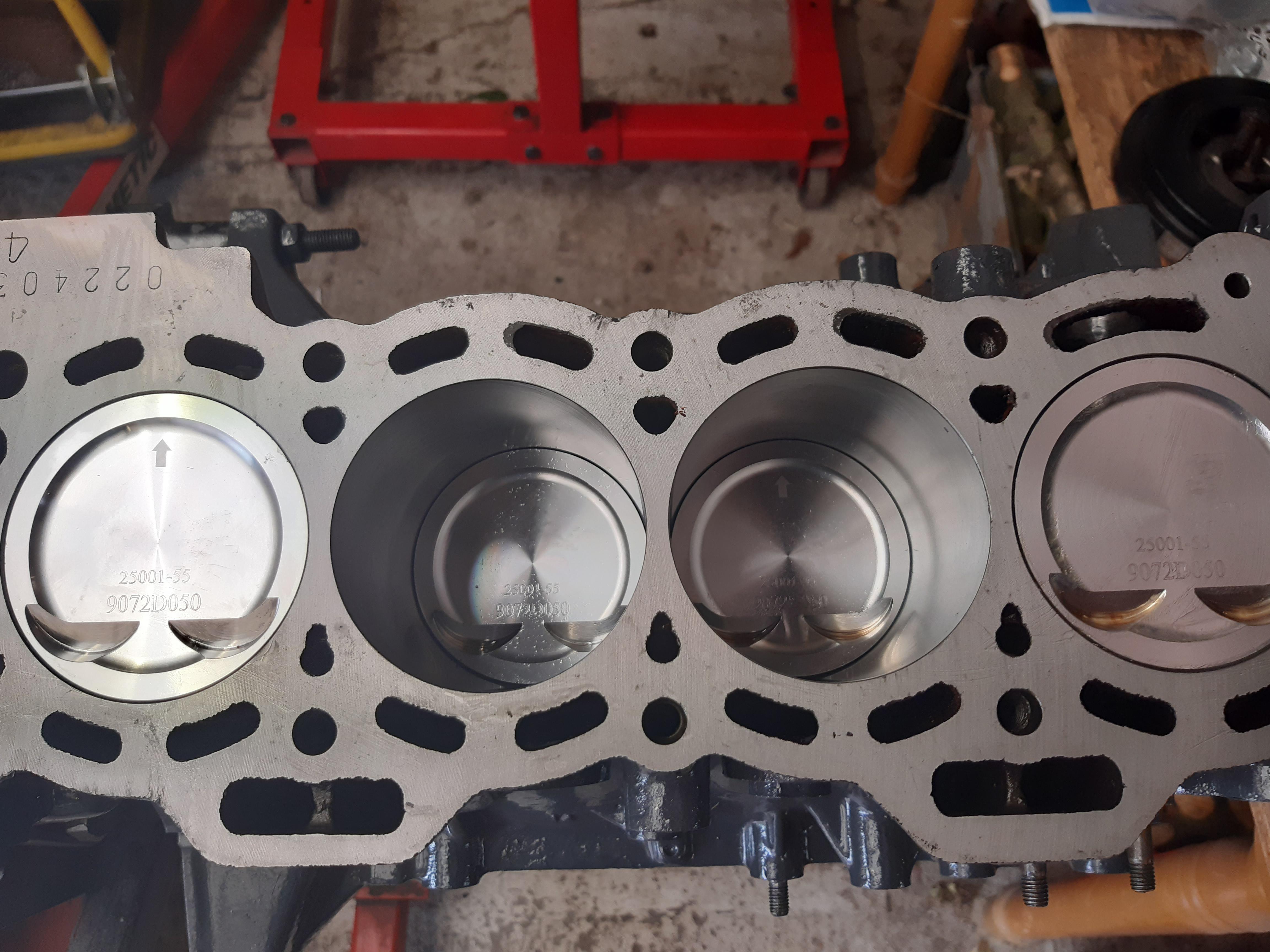

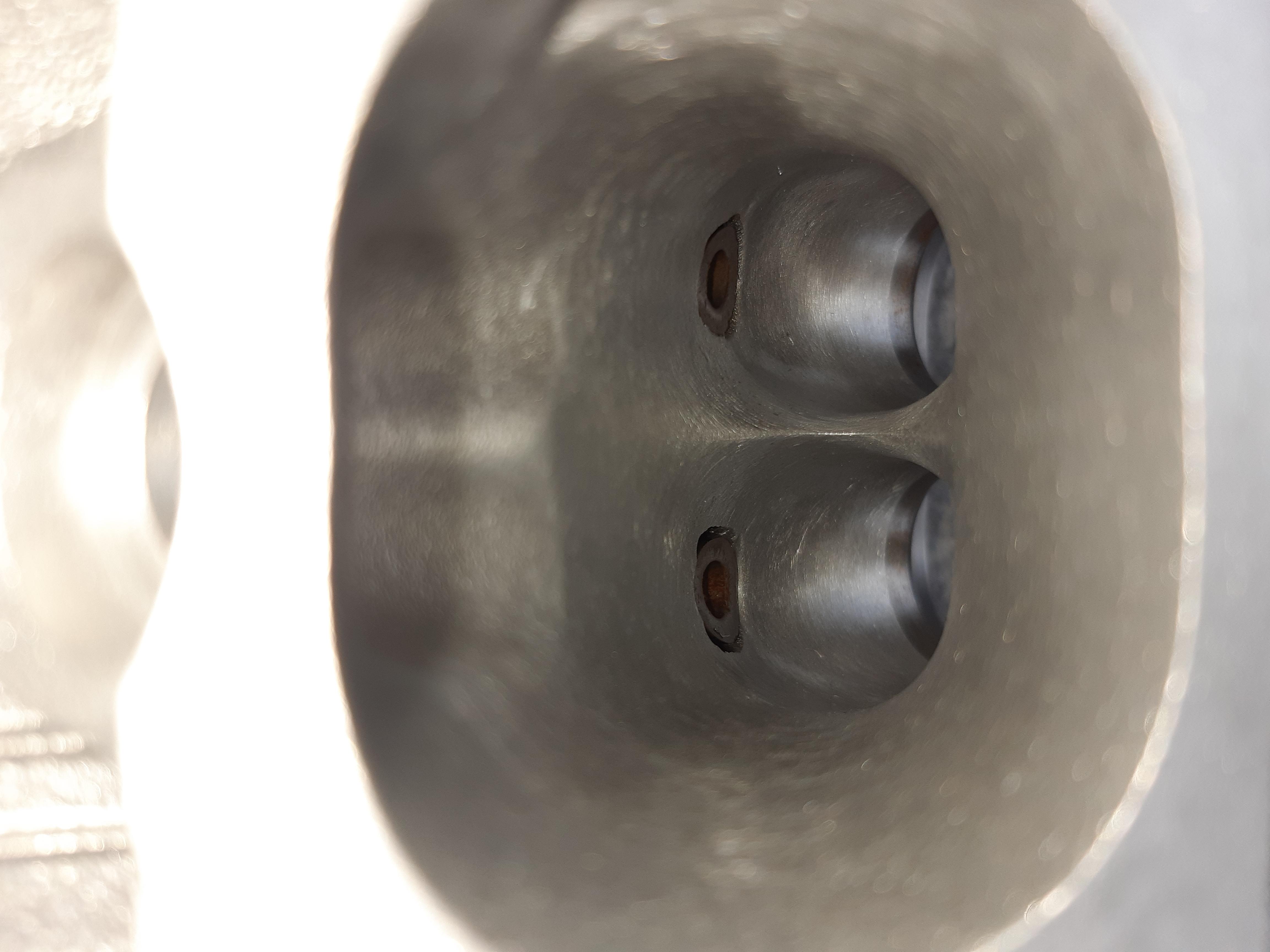

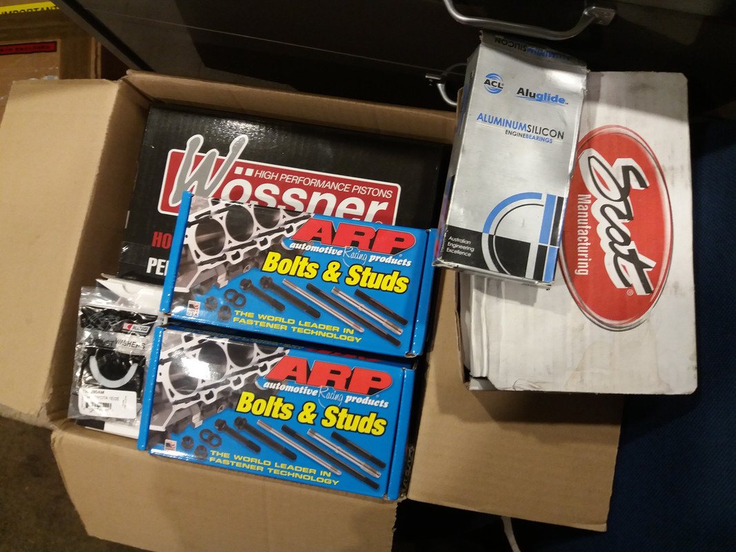

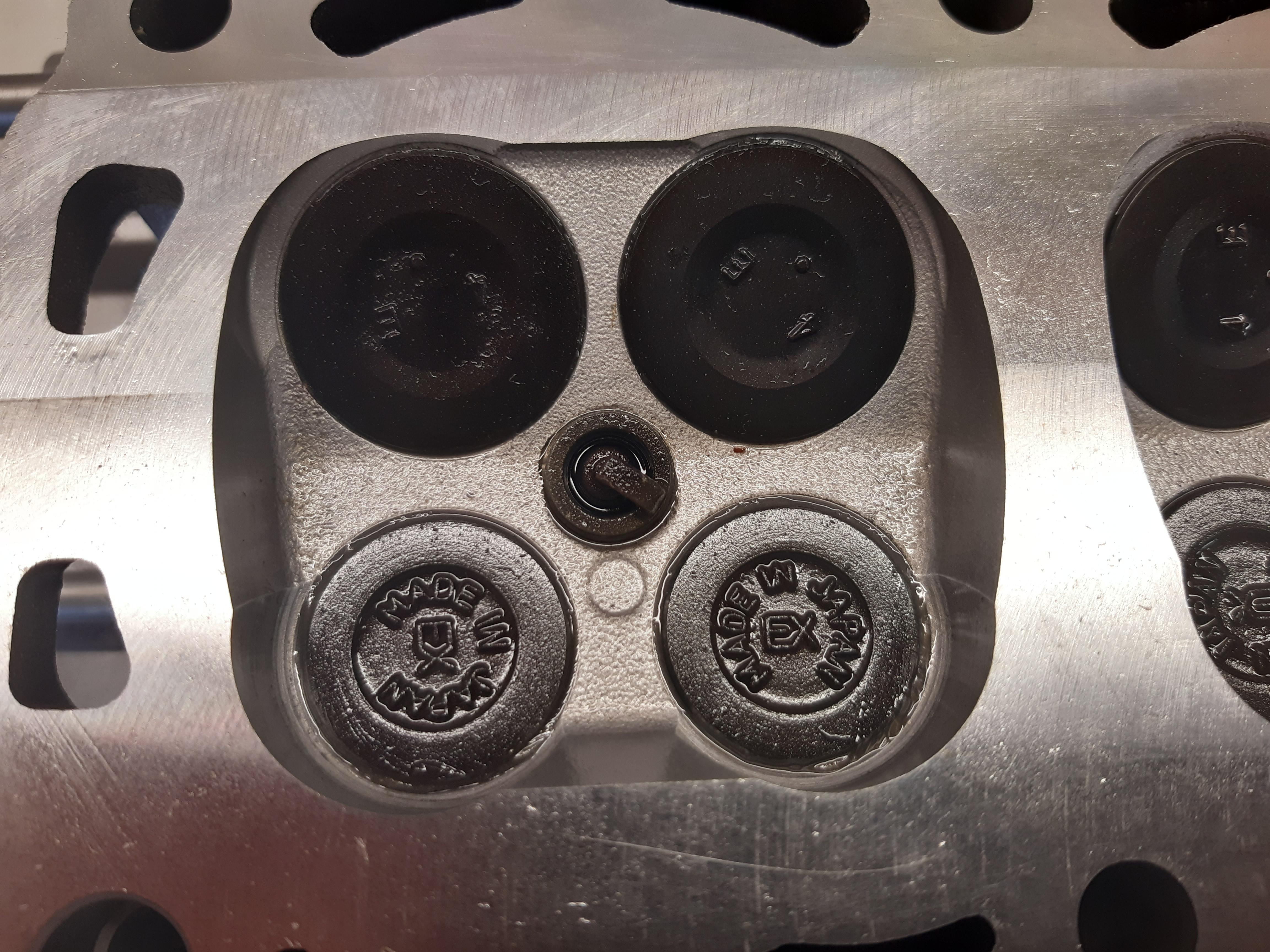

Mike84 Posted November 18, 2019 Author Share Posted November 18, 2019 More goodies arrived , engine is currently having crank assembly balanced . Also block has been bored to match pistons and surfaced. Head is currently with Liam at Lc_porting working his magic , who will also be doing porting of the inlet manifold. Quote Link to post Share on other sites

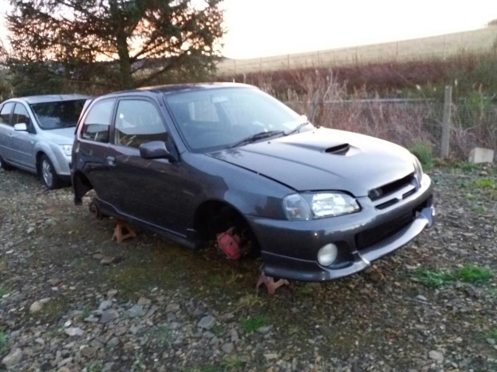

Mike84 Posted December 1, 2019 Author Share Posted December 1, 2019 Bit more progress first mock up of supercharger to determine exact position and to trial fit to engine in car also Quote Link to post Share on other sites

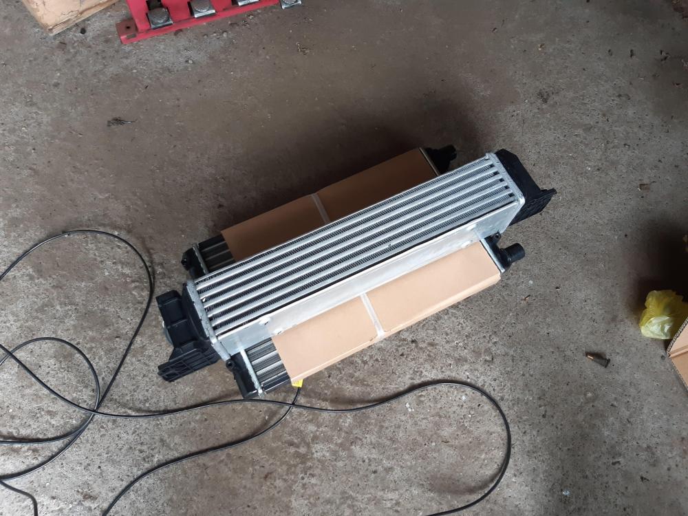

Mike84 Posted September 13, 2020 Author Share Posted September 13, 2020 Updates been pretty lacking but I have been working slowly but surely in the back ground. Somewhat snowballing with new intercooler and radiator setup aswell now🙄 Mainly to try to save weight and make it easier to repair if the inevitable ever happens Anyhow some overdue picture hoaring Quote Link to post Share on other sites
