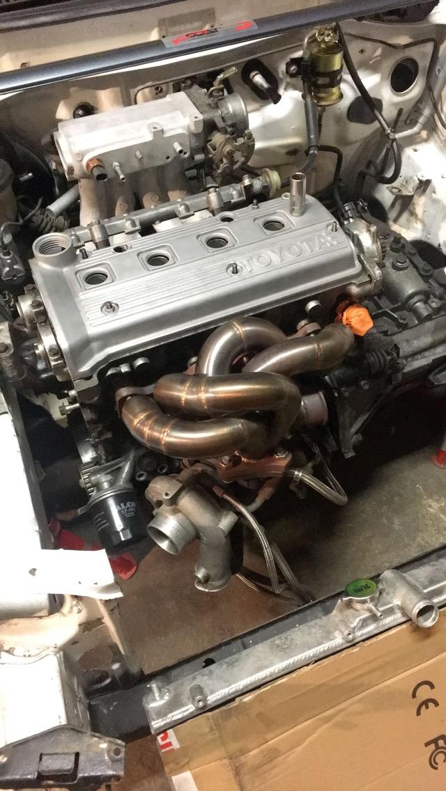

Ryan.Truesdale Posted July 20, 2018 Author Posted July 20, 2018 Have had a slight change of plans. I went and picked up a 4efte on the 12th of july, this came from Richard Bradley Motorsport. So now the plan is get this engine rebuilt just standard pistons with my gt rods and possibly a bit porting still going td04 at 1 bar boost. not forging as i don't think its worth the money and anyone ive talked to says td04 1 bar boost on a standard engine is the most fun they've had. Quote

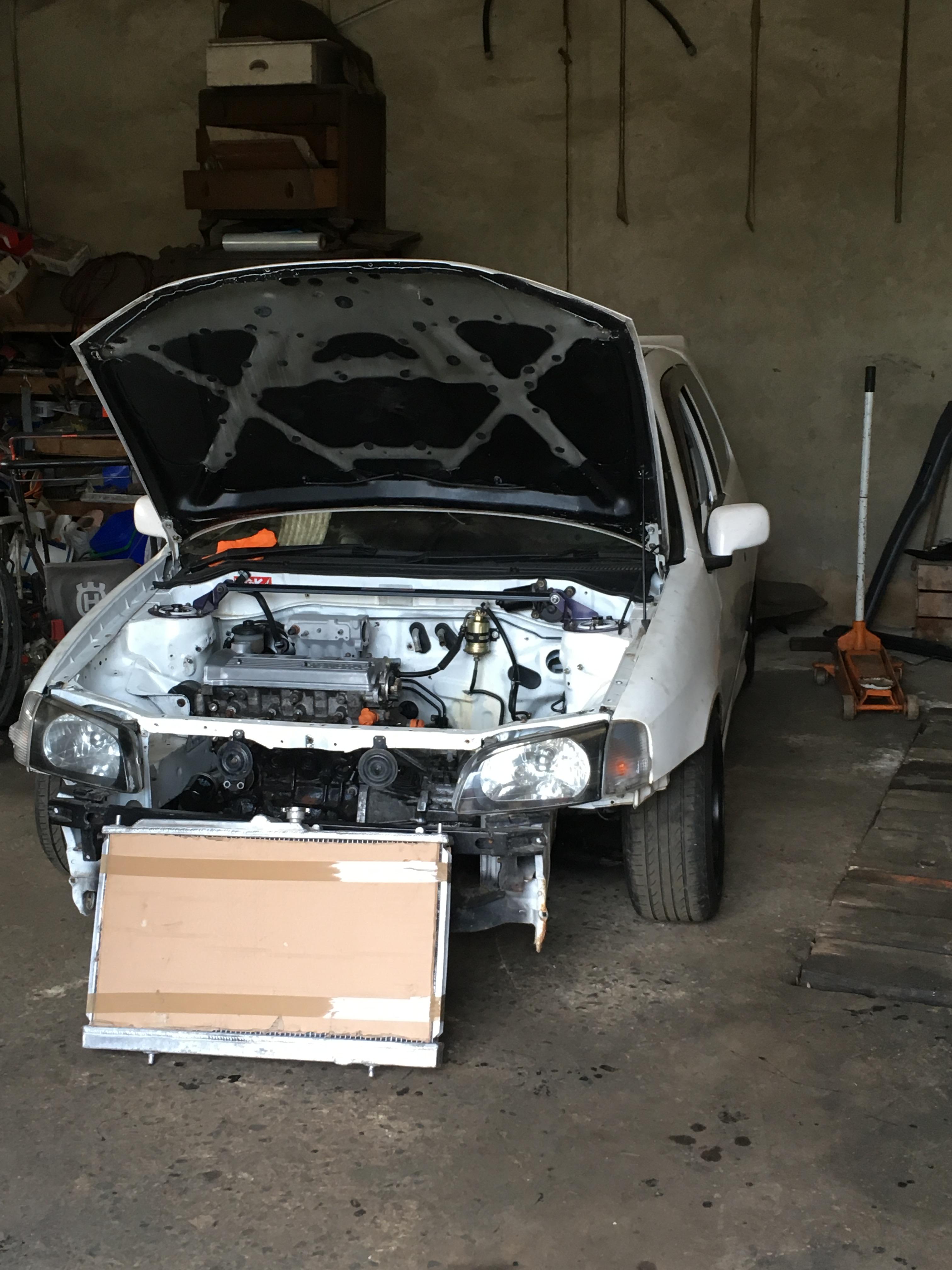

Ryan.Truesdale Posted August 17, 2018 Author Posted August 17, 2018 Some progress made on the car. Mainly collecting parts. Picked up an evo radiator. Disc brake back axel (need calipers) td04L and wepr mani fold with a tial wastegate Quote

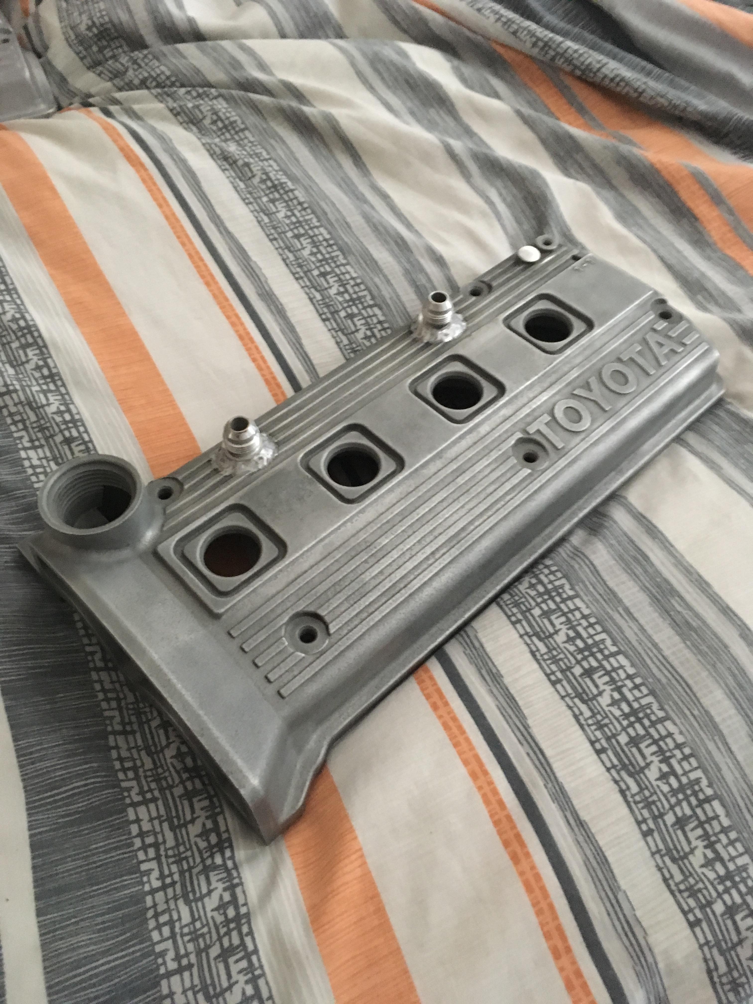

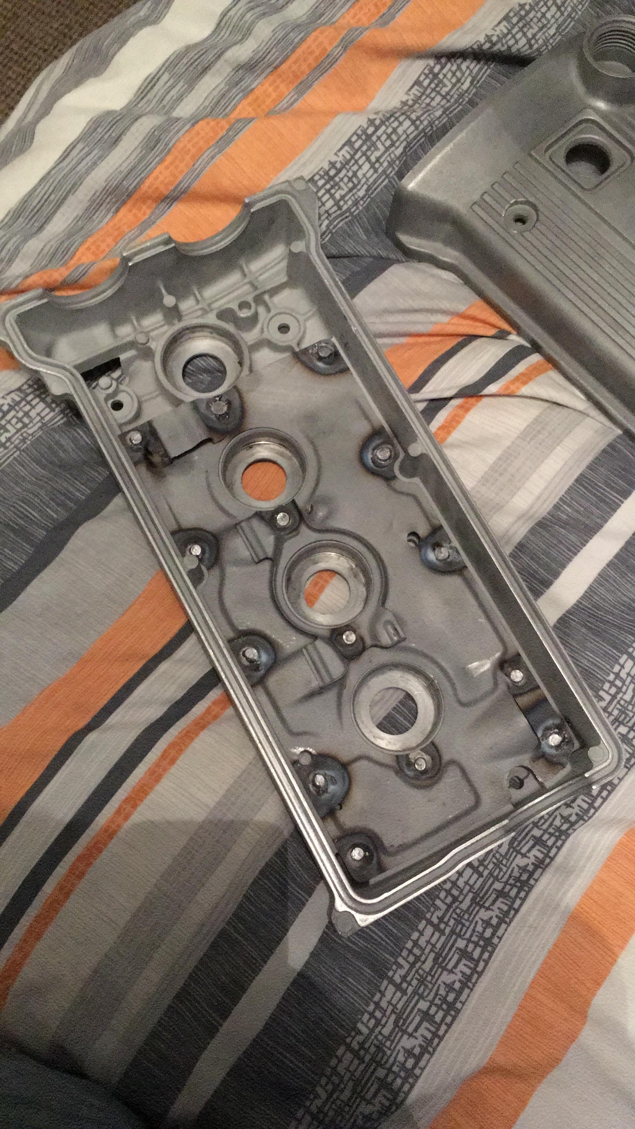

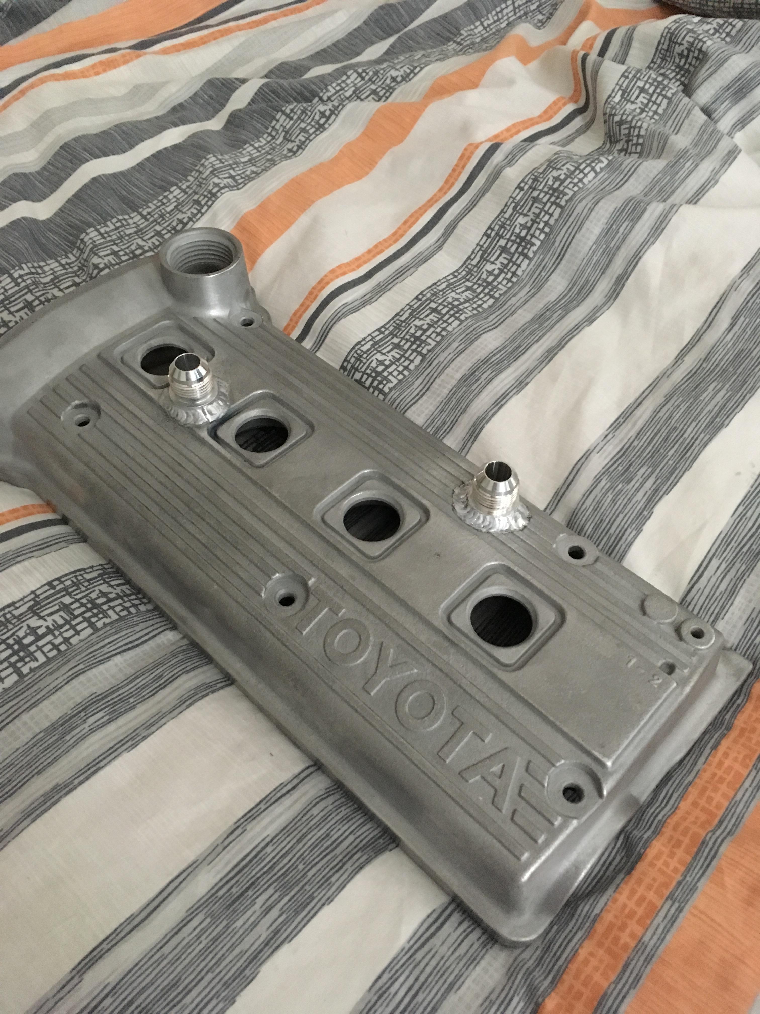

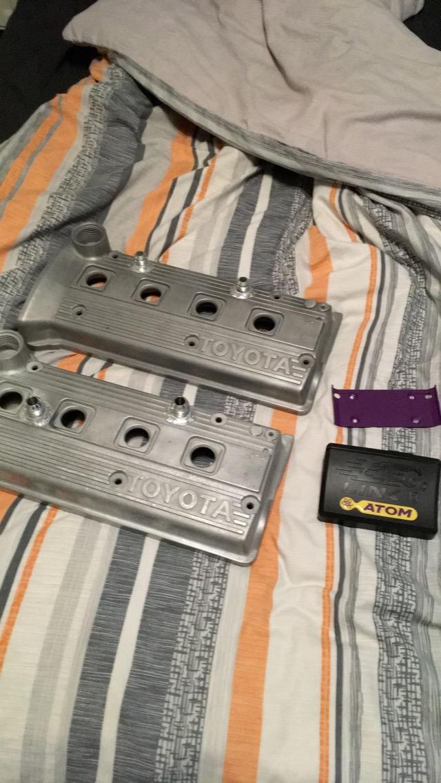

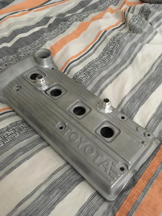

Ryan.Truesdale Posted September 27, 2018 Author Posted September 27, 2018 Custom "Race spec" rocker covers I made. Quote

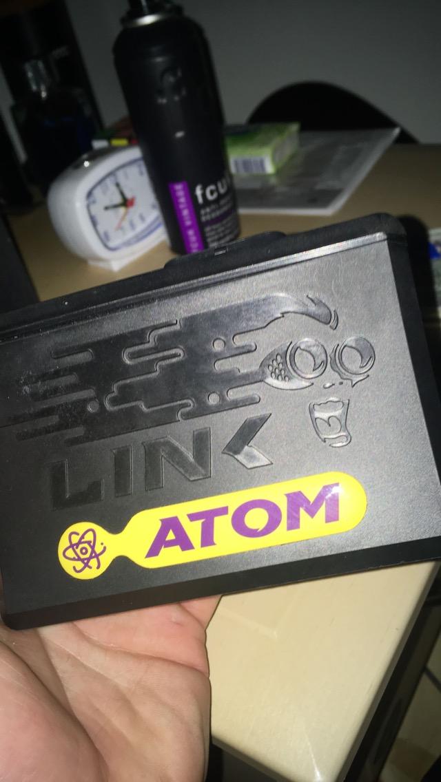

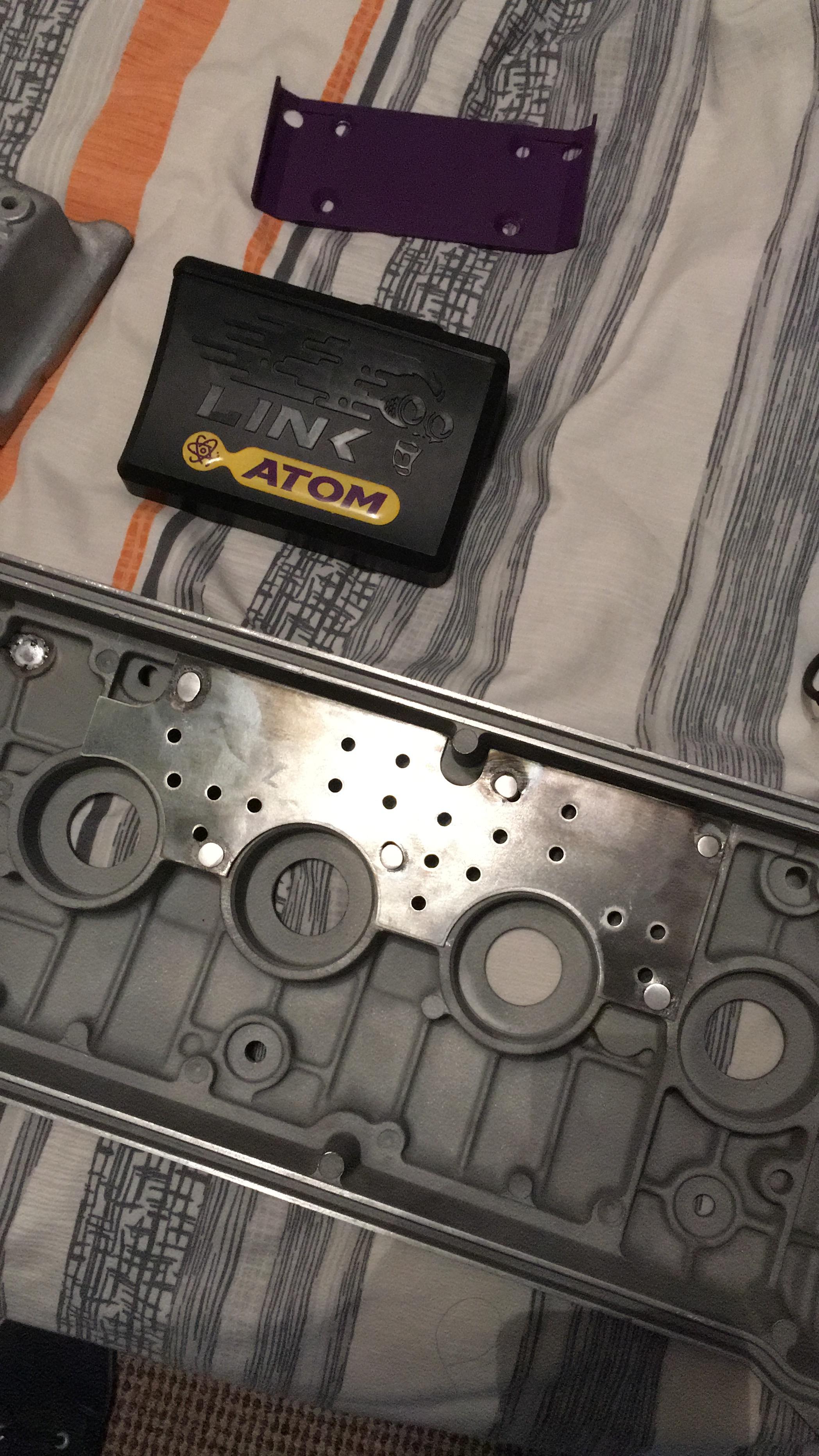

Ryan.Truesdale Posted September 27, 2018 Author Posted September 27, 2018 Picked up some French power steering and a link atom ecu. Quote

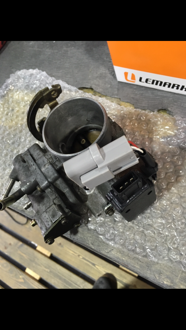

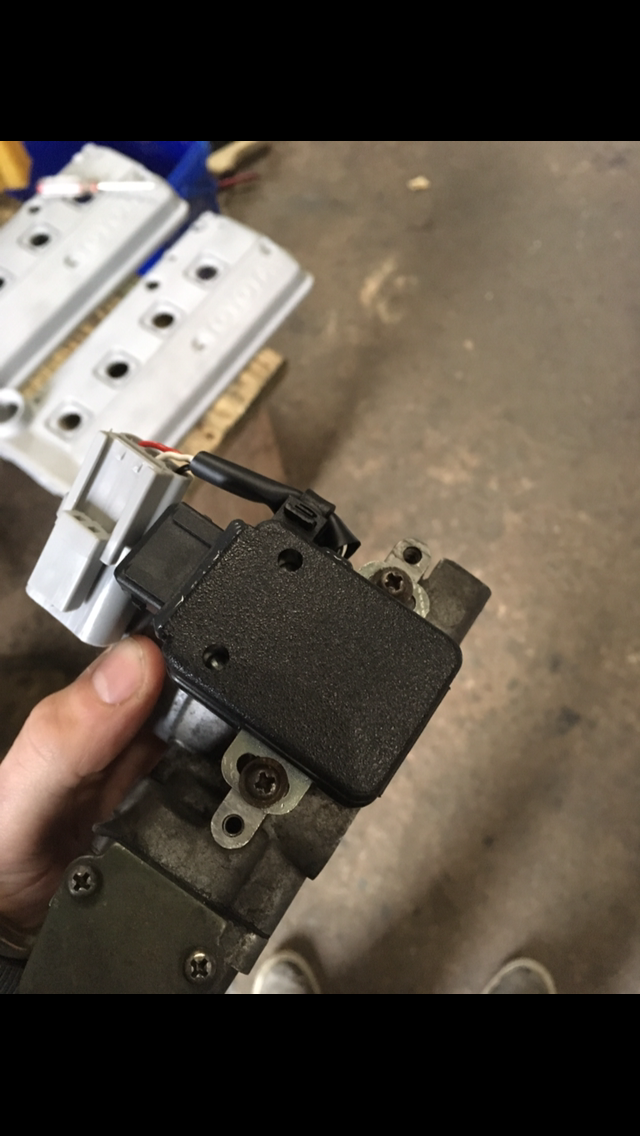

Ryan.Truesdale Posted October 2, 2018 Author Posted October 2, 2018 (edited) Got my rb25 throttle position sensor mounted fits very nicely. Edited October 2, 2018 by Ryan.Truesdale Quote

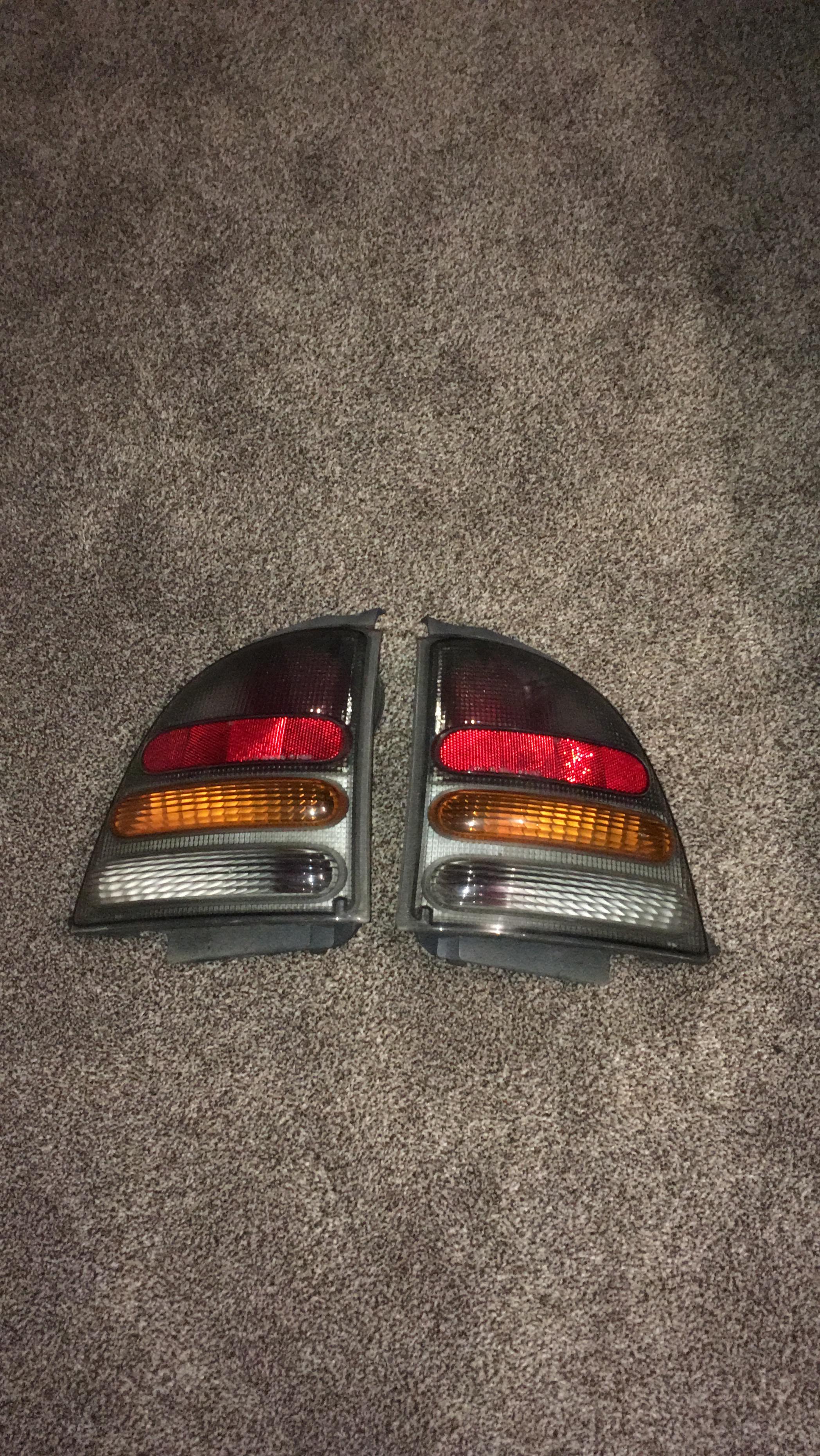

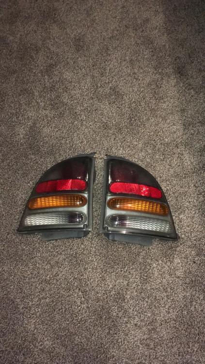

Ryan.Truesdale Posted November 26, 2018 Author Posted November 26, 2018 Cleanest set of 98 lights I’ve ever seen. Got these as my last lights were actually 98 lenses on 96 backs. Anyone who has done that knows they don’t fit great due to different mounting holes. Quote
matte11 Posted November 26, 2018 Posted November 26, 2018 Nice build matey, I've just found that out with the lenses I've drilled out the new positions just to make them fit for now. Quote

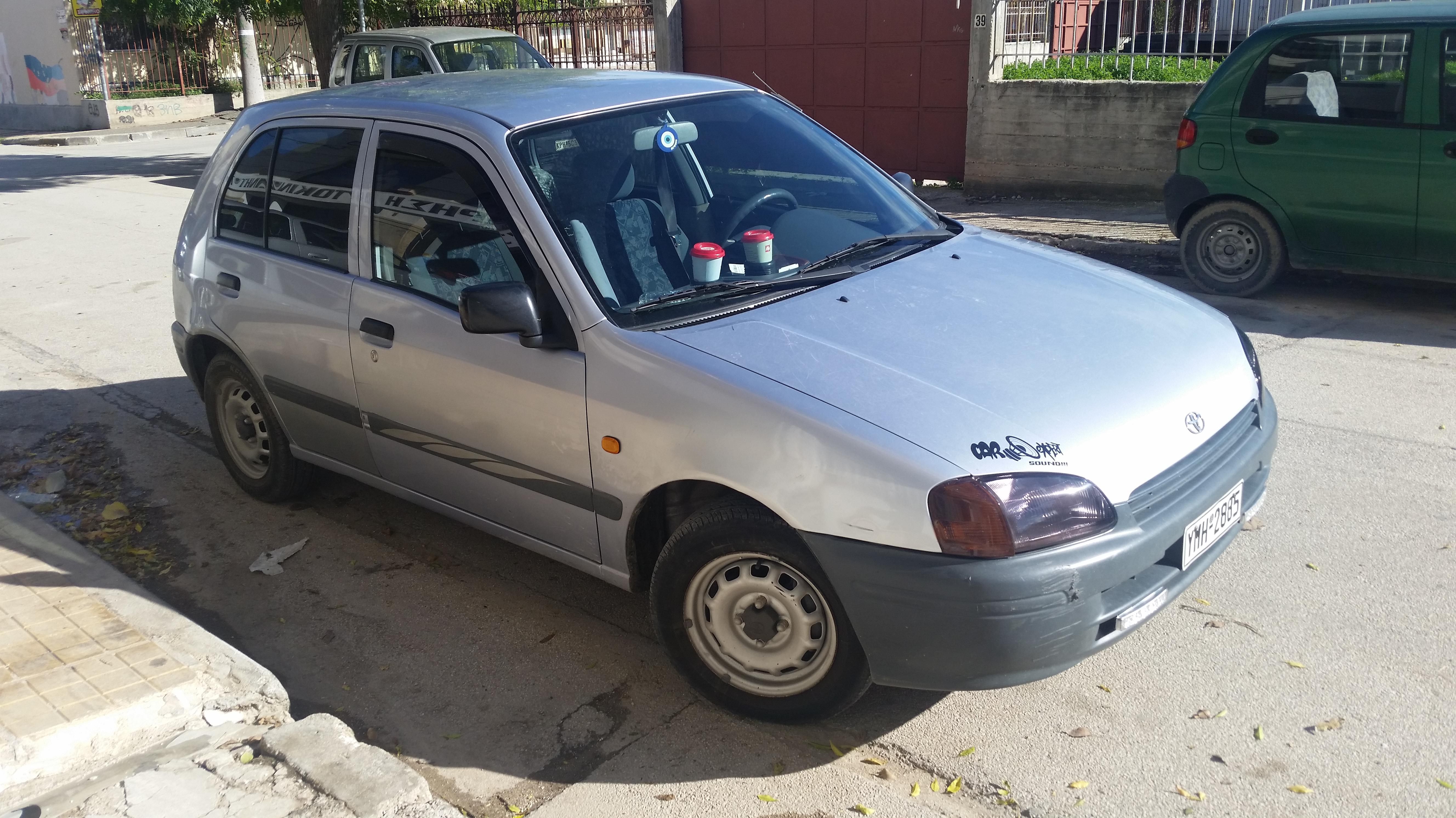

Parasa97 Posted January 22, 2019 Posted January 22, 2019 Hello fellas, sorry for interrupting the post but I need your help Before 3 years I've been given a Toyota Starlet Ep91 '98 1.3 16v, finally the previous summer i' ve managed to start improving it's appearance, I want to replace the stock glass headlights, with glanza V headlights το make this change do I have to replace the front bumper also so the headlight to fit properly? Or the stock bumper do not have to be changed These are the headlights that I want to buy an the photo is from my car https://www.ebay.co.uk/itm/TOYOTA-STARLET-GLANZA-V-HEADLIGHTS-HEAD-LIGHTS-EP91-/131349750956 Quote
Ryan.Truesdale Posted January 29, 2019 Author Posted January 29, 2019 On 1/22/2019 at 9:11 PM, Parasa97 said: Hello fellas, sorry for interrupting the post but I need your help Before 3 years I've been given a Toyota Starlet Ep91 '98 1.3 16v, finally the previous summer i' ve managed to start improving it's appearance, I want to replace the stock glass headlights, with glanza V headlights το make this change do I have to replace the front bumper also so the headlight to fit properly? Or the stock bumper do not have to be changed These are the headlights that I want to buy an the photo is from my car https://www.ebay.co.uk/itm/TOYOTA-STARLET-GLANZA-V-HEADLIGHTS-HEAD-LIGHTS-EP91-/131349750956 To fit glanza headlights you need a glanza bumper and bonnet as the glanza lights are slightly larger Quote

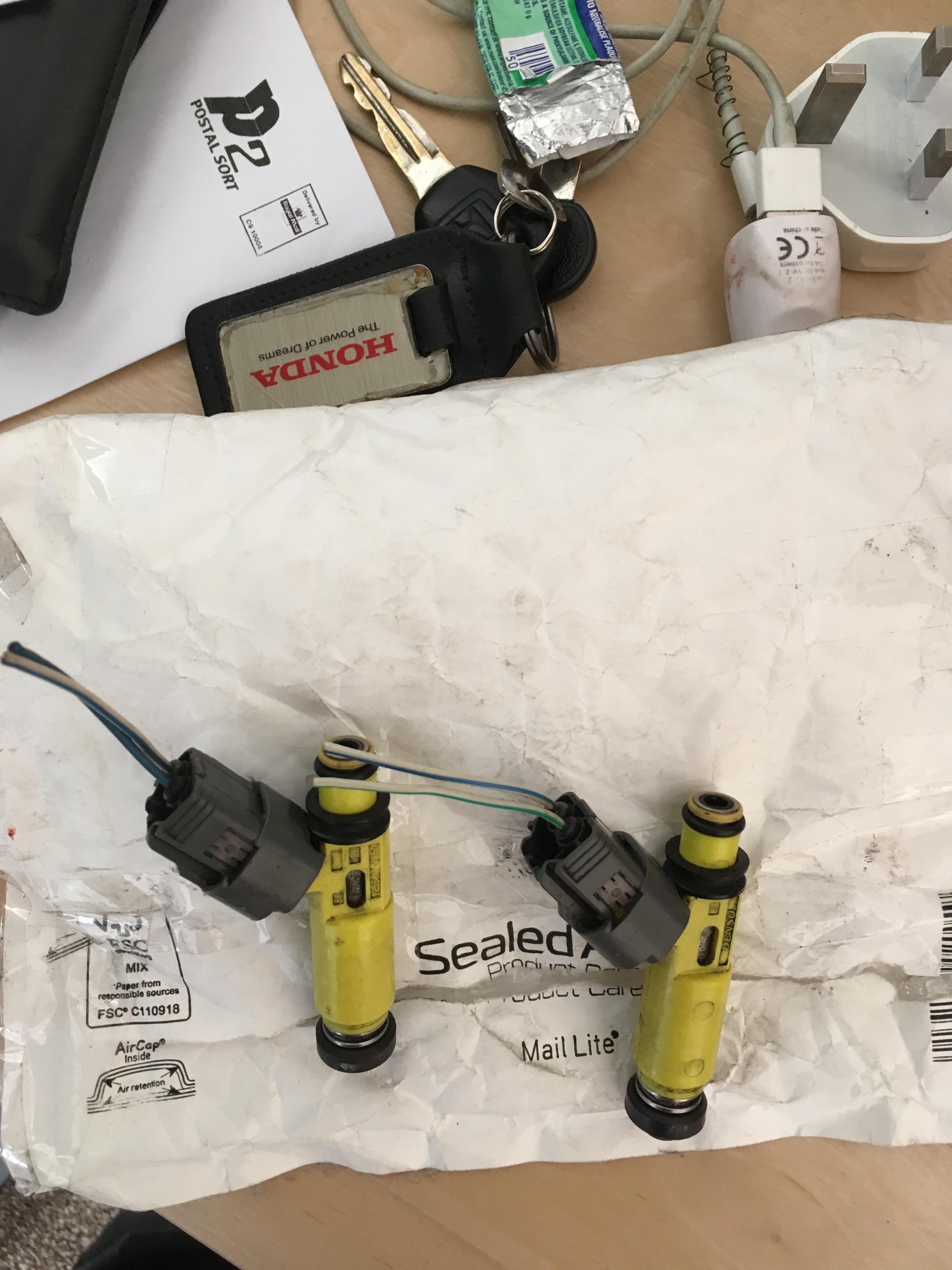

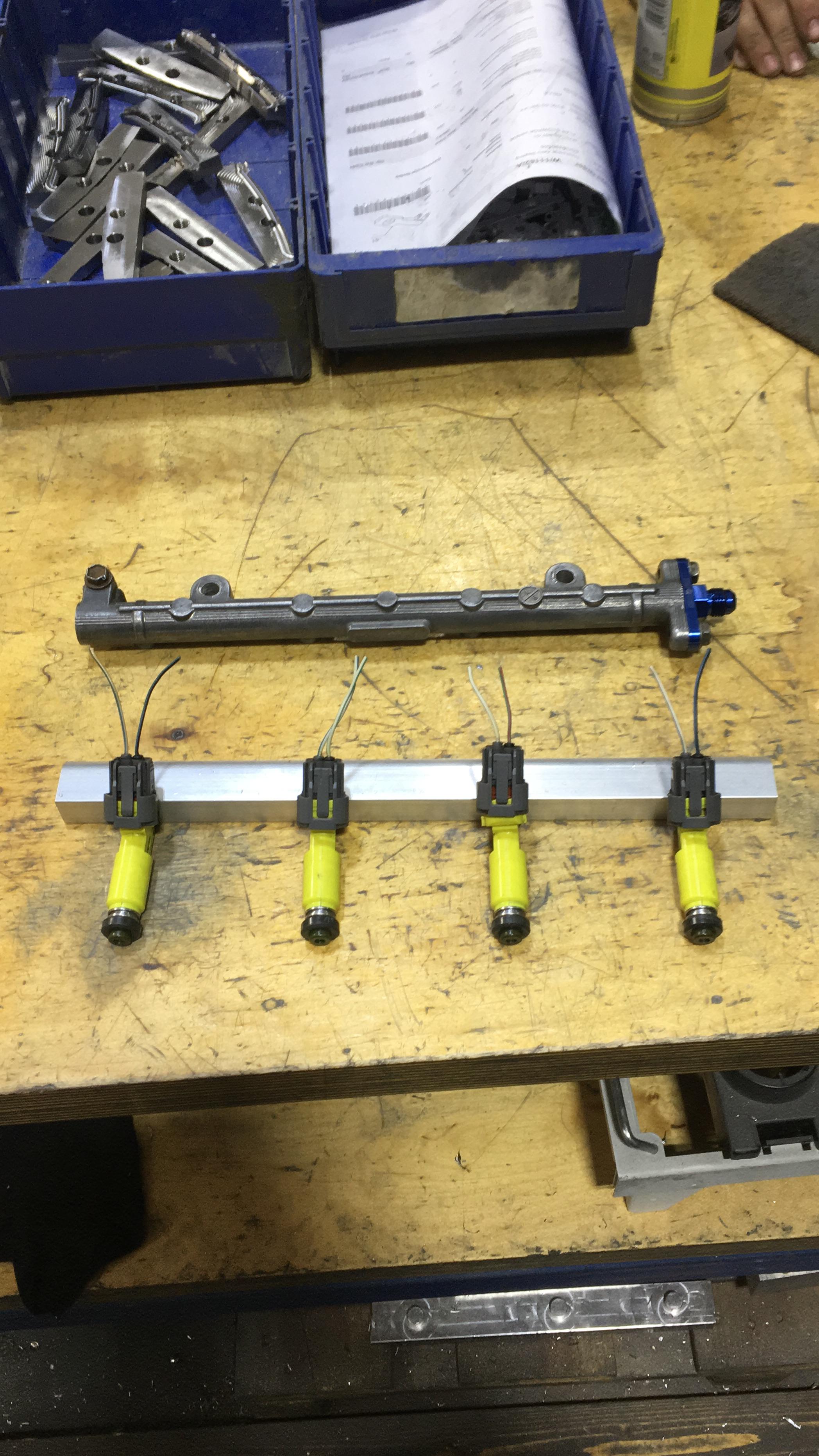

Ryan.Truesdale Posted February 3, 2019 Author Posted February 3, 2019 Some Mazda injectors, thanks to Phil for these Quote

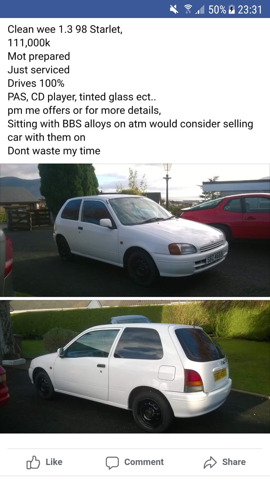

Ryan.Truesdale Posted March 6, 2019 Author Posted March 6, 2019 Old for sale adverts of my car. It’s been through a few different looks! Quote

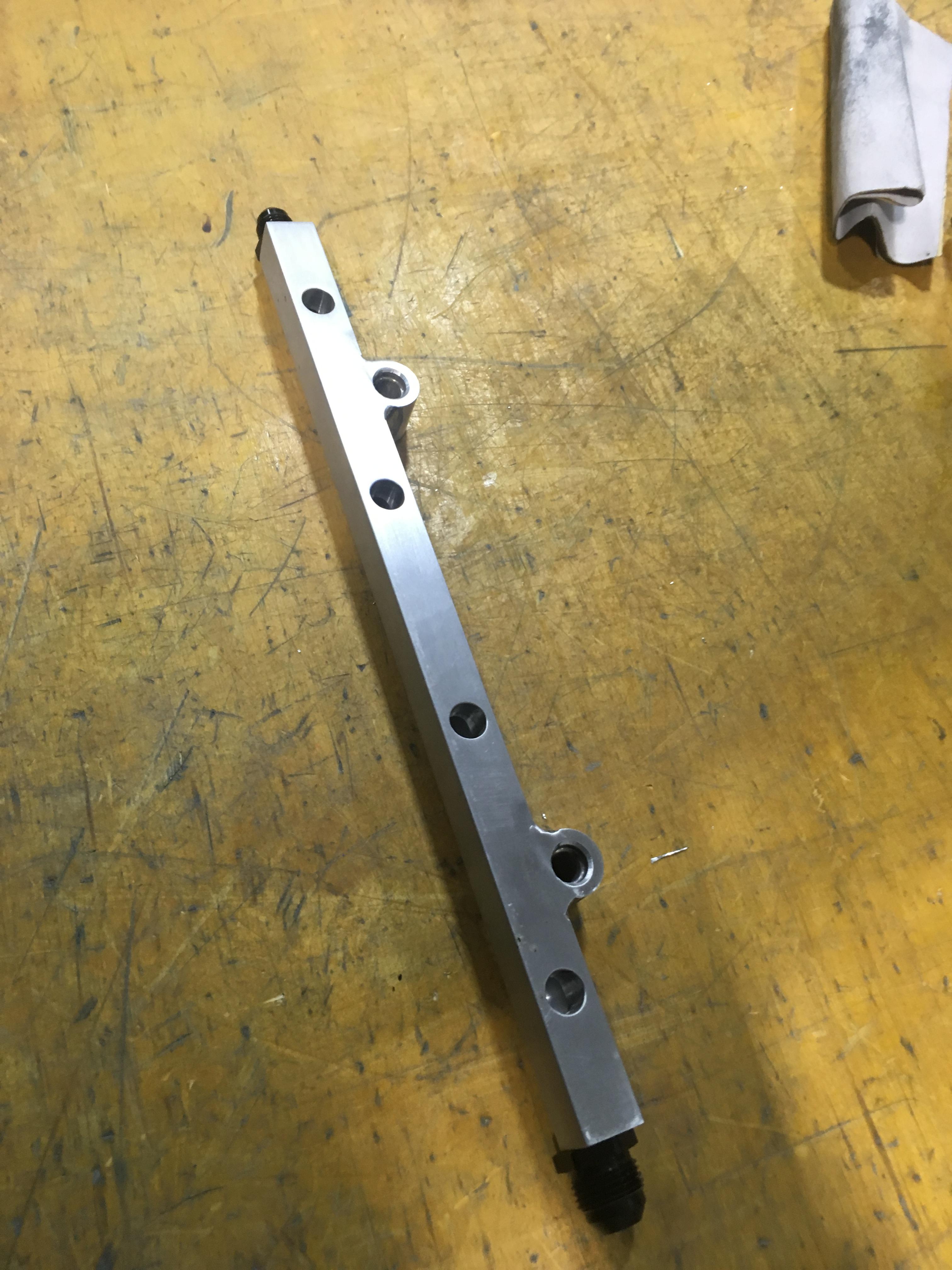

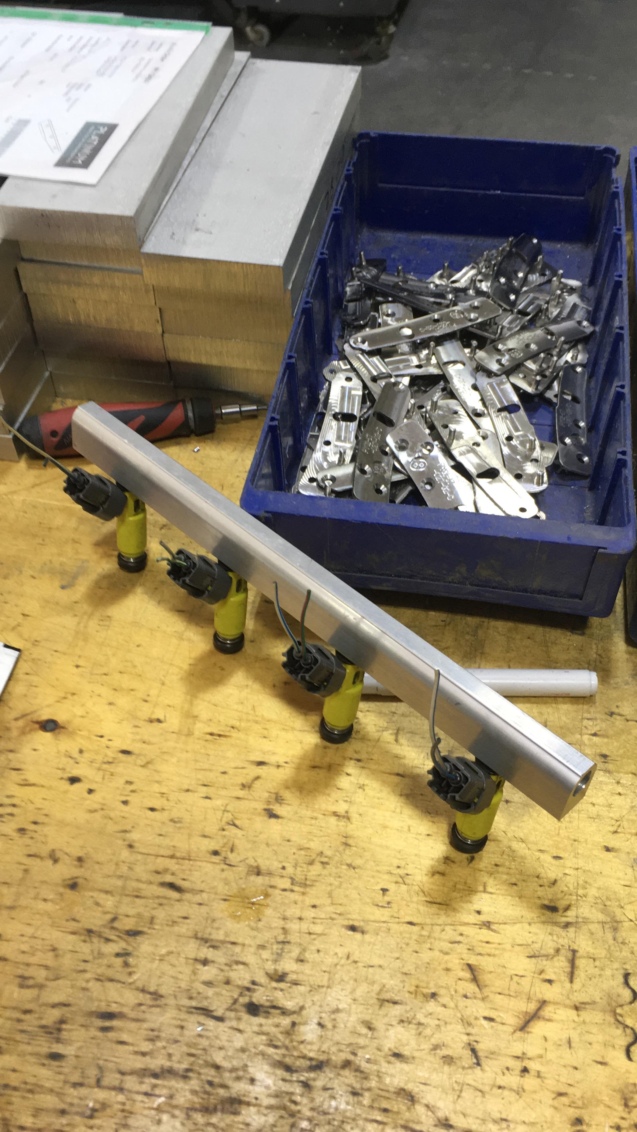

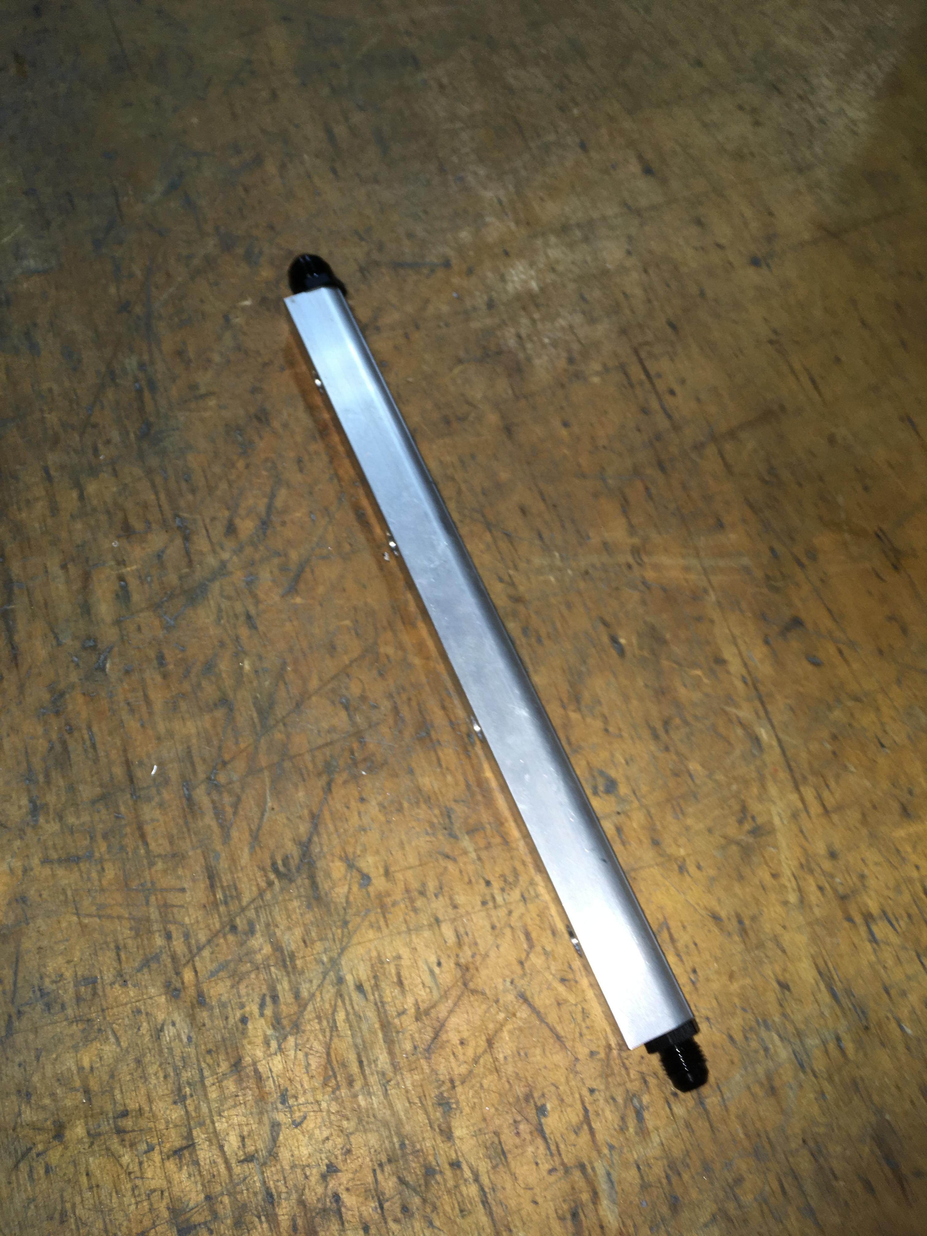

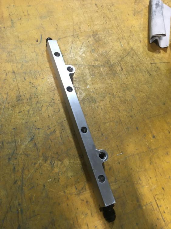

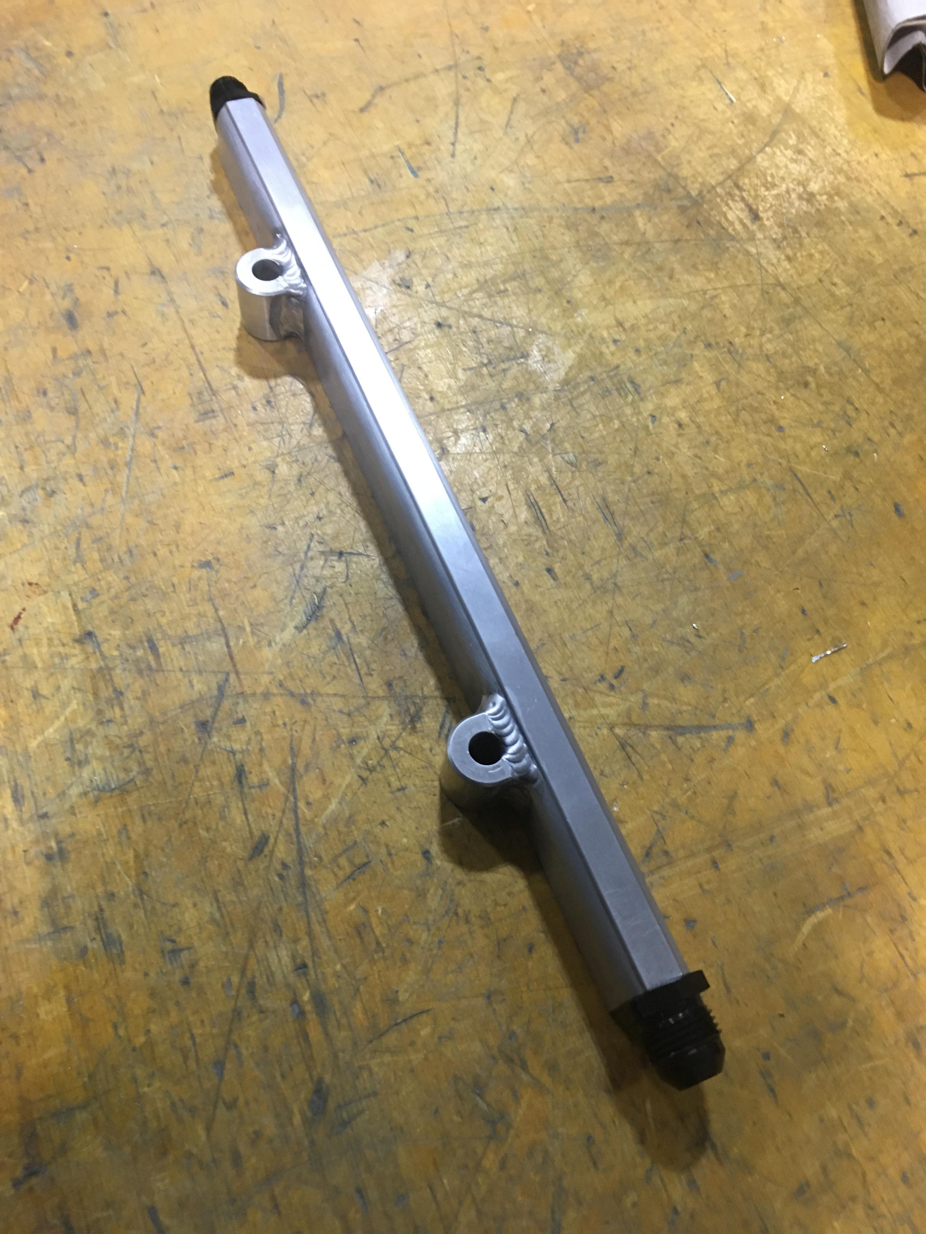

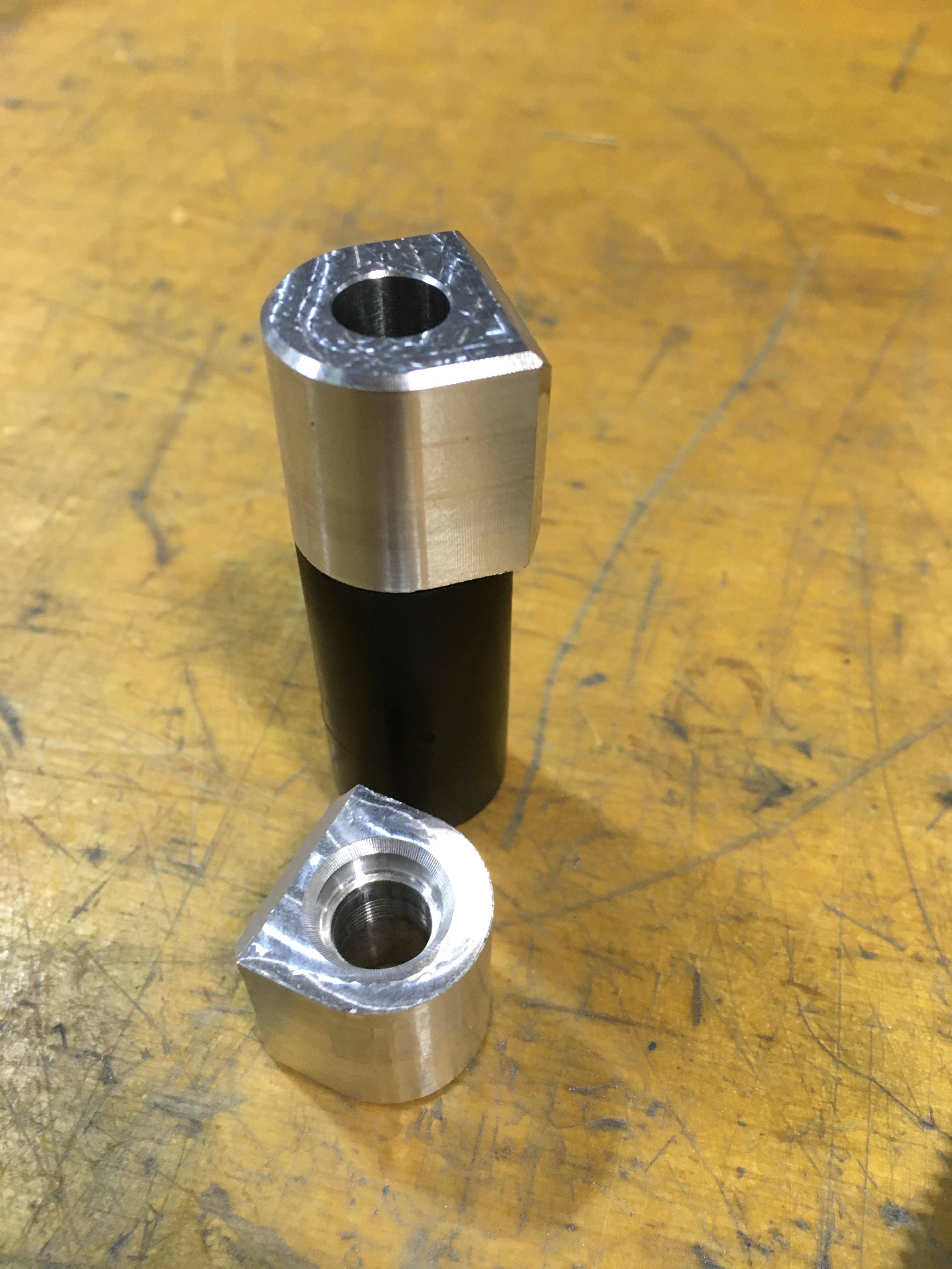

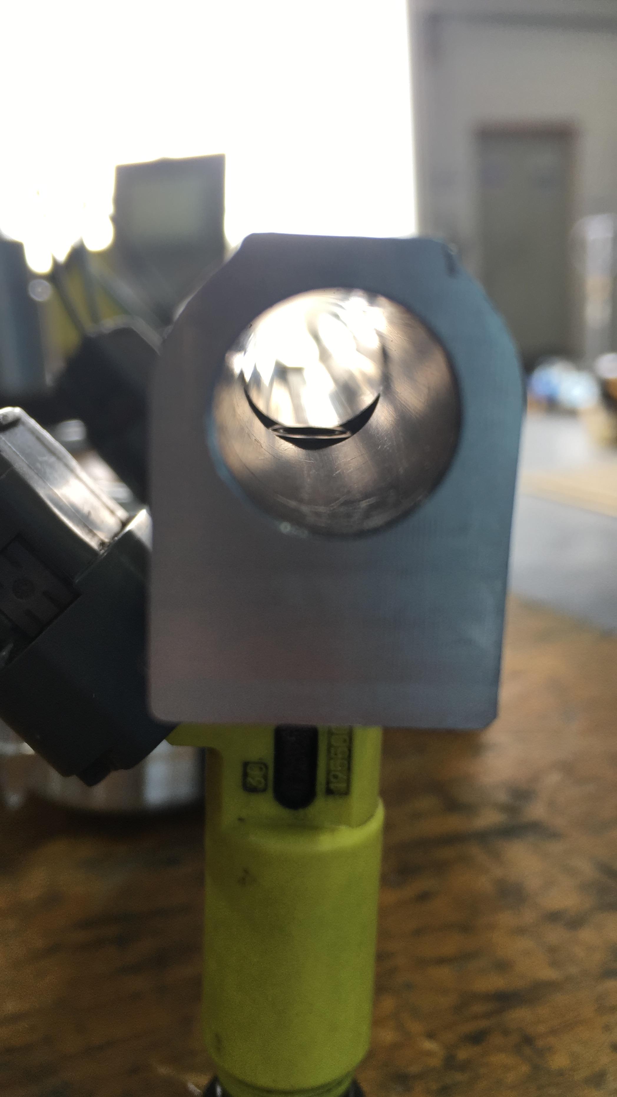

Ryan.Truesdale Posted March 25, 2019 Author Posted March 25, 2019 Started making a high flow rail Quote
Ryan.Truesdale Posted April 14, 2019 Author Posted April 14, 2019 Update on fuel rail. Currently off being anodised. Quote
