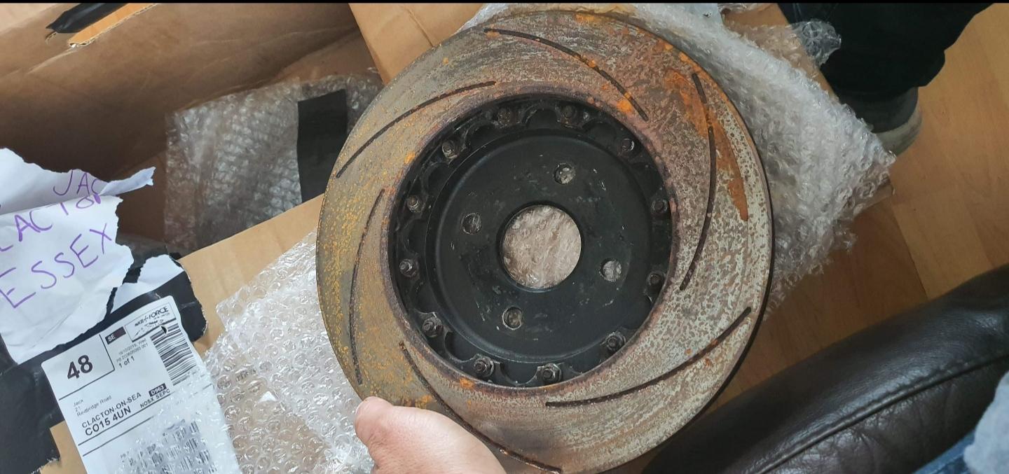

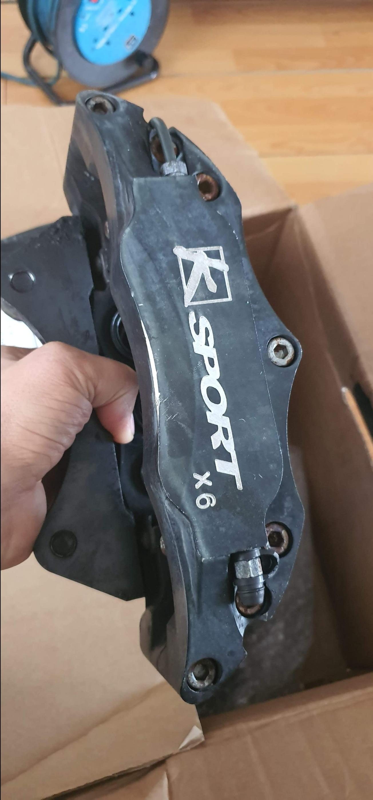

Not much happened over the last few weeks with the car, just sat on the front garden. Fresh out of uni with zero jobs,  the logical thing was to park it up and save some cash. Half of that happened, it did get parked up haha. Bargain set of k sports came up on marketplace, so had to have them20191019_143949.thumb.jpg.784e18e8bfebdf073629d983b148a1d6.jpg
All for £500. I'll get daddy to lacquer them see it that brings them back up to new. But now I gotta decide on wheels to clear them ;/

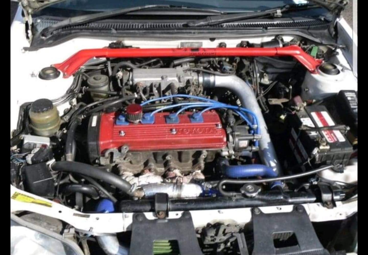

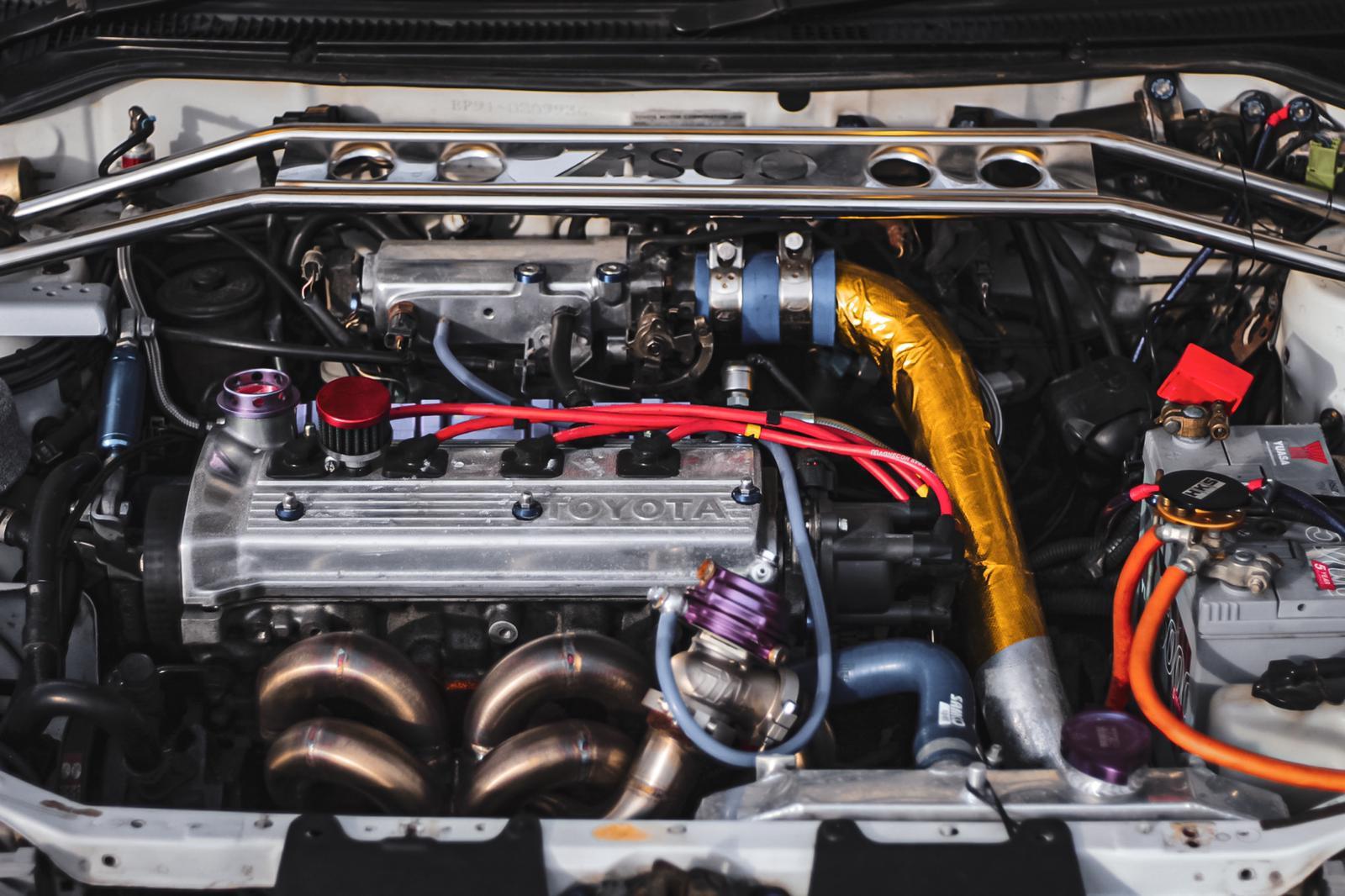

At least she's still in the family. Laggy Td04 on a 4efte? :unknw: Even tho hybrid ....... Probly pistons are low compression.
It's not bad tbh, yep it's a low compression forged bottom end. It's only running 6psi at the moment and even then it comes in hard, harder than a ct9. Will be brutal once its mapped properly

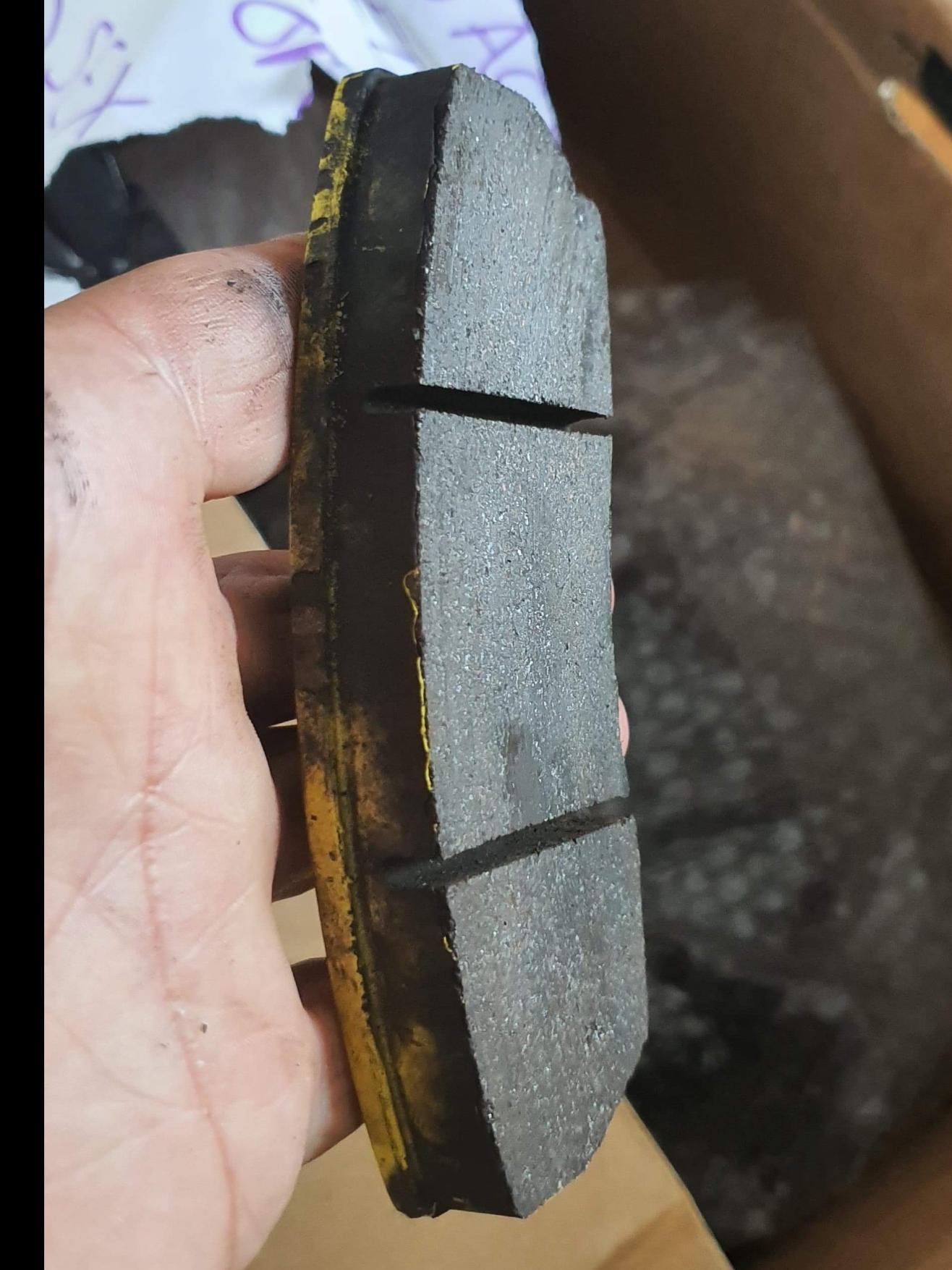

The Ksport brakes feel amazing, really confidence inspiring, people who say they're chinese shite need to go out in a Ksport BBK car. I reckon breaking hard enough the rear wheels will come off the ground haha

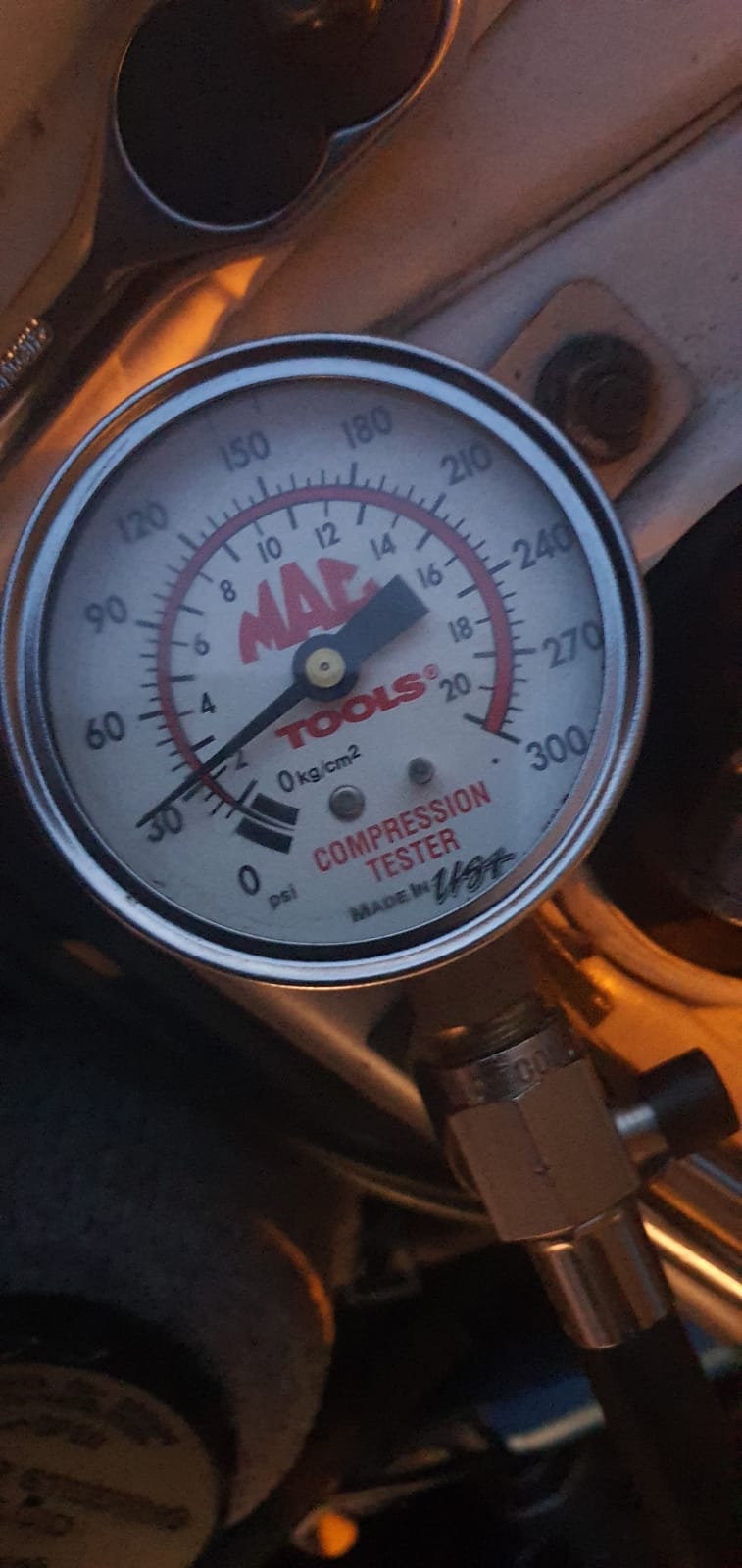

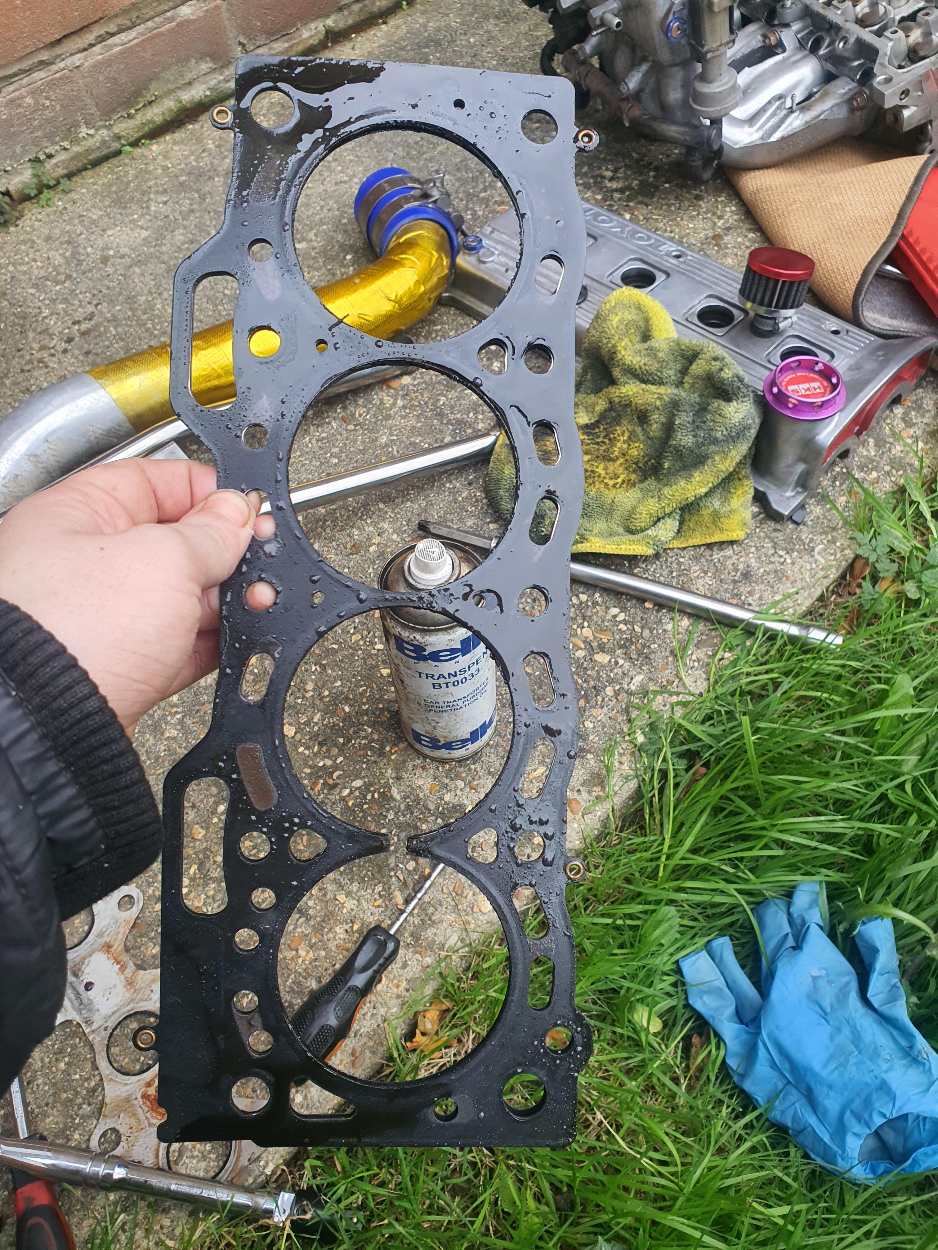

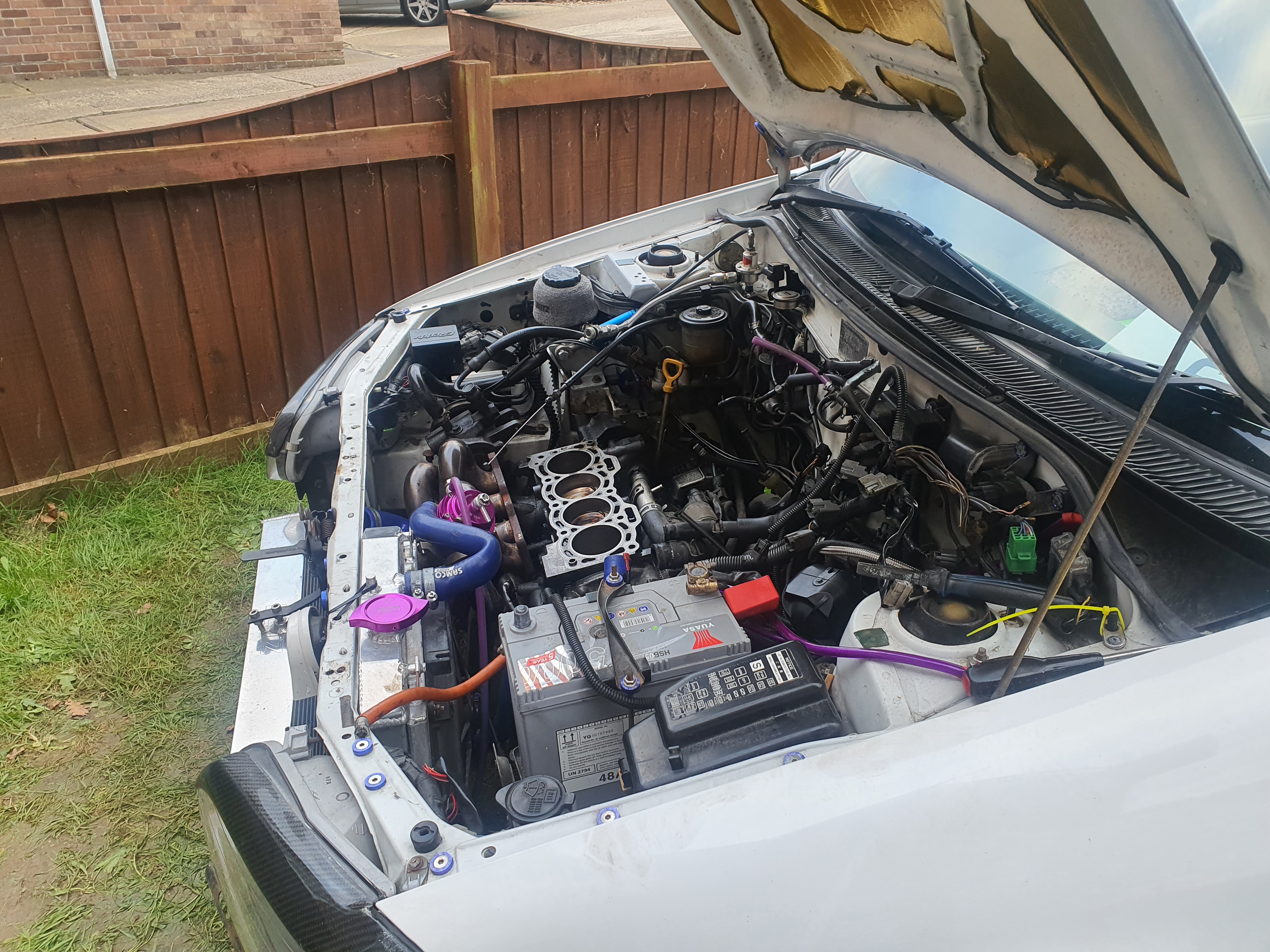

Took my girlfriend out in the car (she never goes in this, doesn't have an interest in cars. Thinks they're just a piece of metal blah blah blah) pulled out of a side road. Gave it some shit in first, changed to 2nd and went strught onto 2 cylinders. Great. Compression test shows 1&2 down to 30psi. But 1&4 on 150 (cold engine etc) so likely cause either damaged pistons or headgasket blown between 1 and 2.
So set to work stripping the head off20201109_110848.thumb.jpg.bb4a26f3322a248693da5c255f89b411.jpg
Interestingly the bores look a lot better this time round, so I think where it had been dry stored for 10+yrs the rings needed to be bedded in again. Or its had new pistons and a hone at some point. Either way, bottom end is in perfect condition
But one very dead Athena gasket, yikes!!

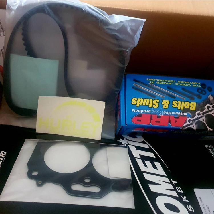

Not gonna sit and slag off this brand, could have been a number of reasons why it went. One of the headbolts wasn't as tight as the other etc etc etc but what happened has happened and onto bigger and better things. Took it on the chin and set about fixing it, but I was adamant that I didn't want an athena again, I've heard good and bad things about them so thought I'd try a different one. Spoke to Hurley engineering. What an absolute genuine and proper guy he is, ordered a 1.3mm Cometic gasket and essentially everything else I'd need. Sorted me out massively.
To make sure it doesn't happen again, had a mate (JellybabyJ) come round and put it all back together for me. So huge thank you to him for dealing with this absolute trouble maker of a car.

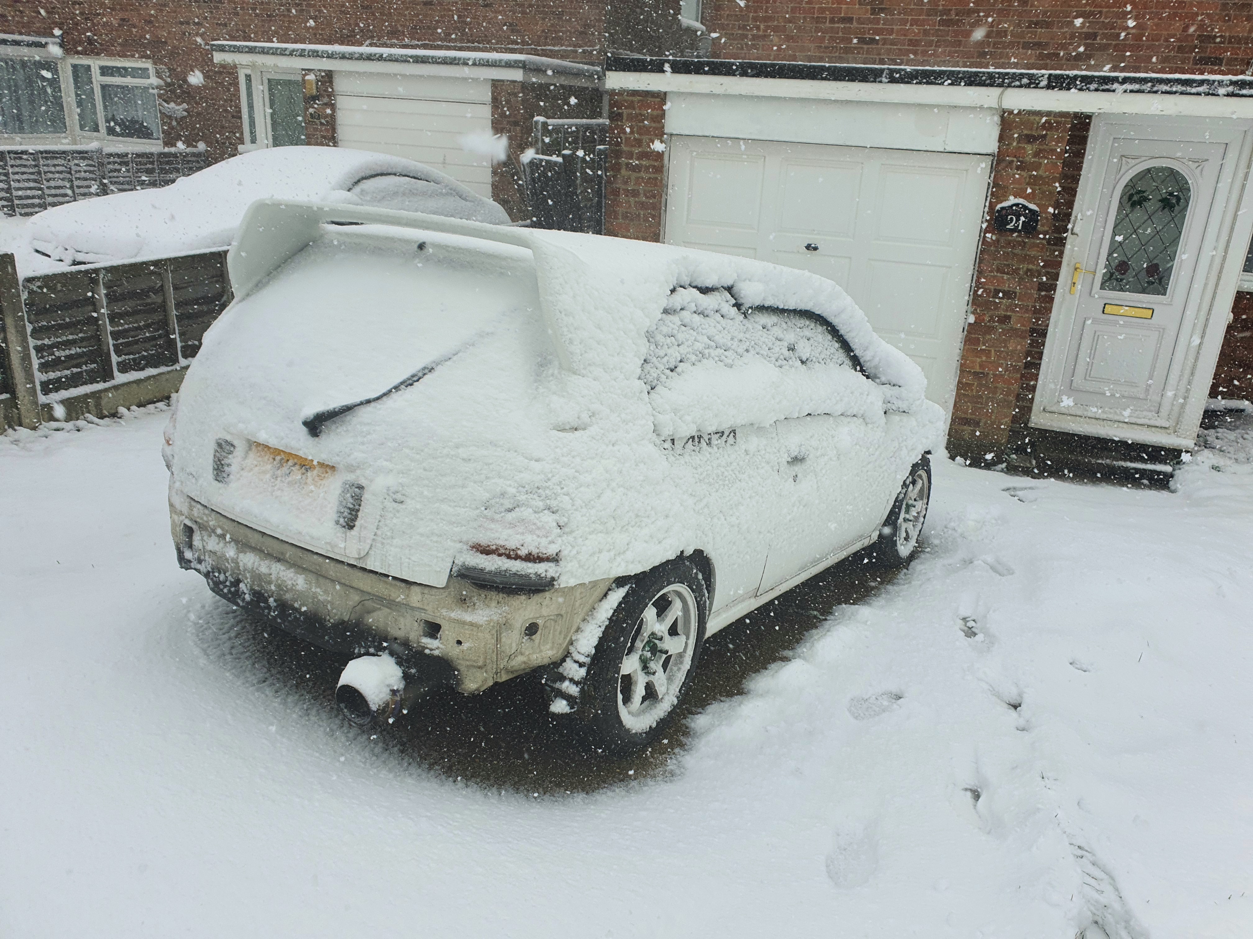

Massive sigh of relief when it started it up on all 4 again! And of course had to grab a snow pic, I reckon this is the first time this car has ever seen the snow haha. 20210207_103806.thumb.jpg.03482b2a1d750f48c5b7c9cff1bd84ef.jpg

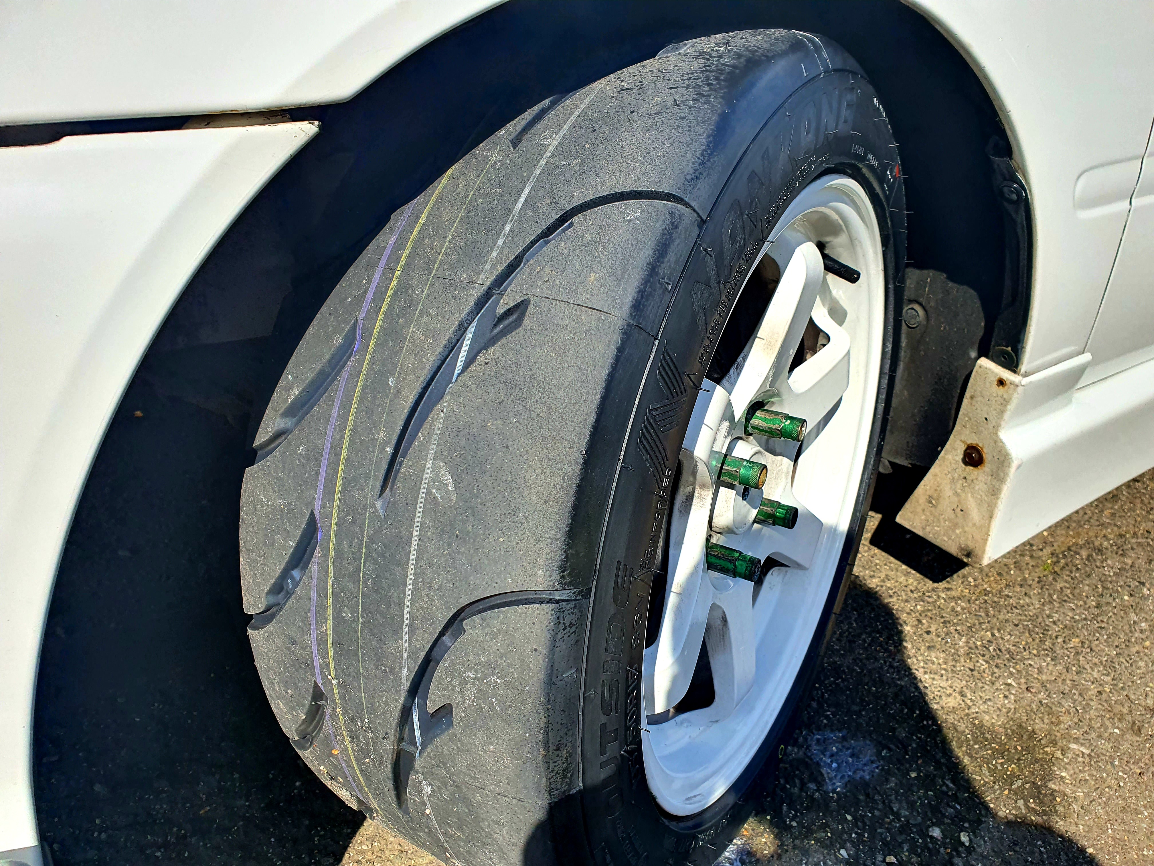

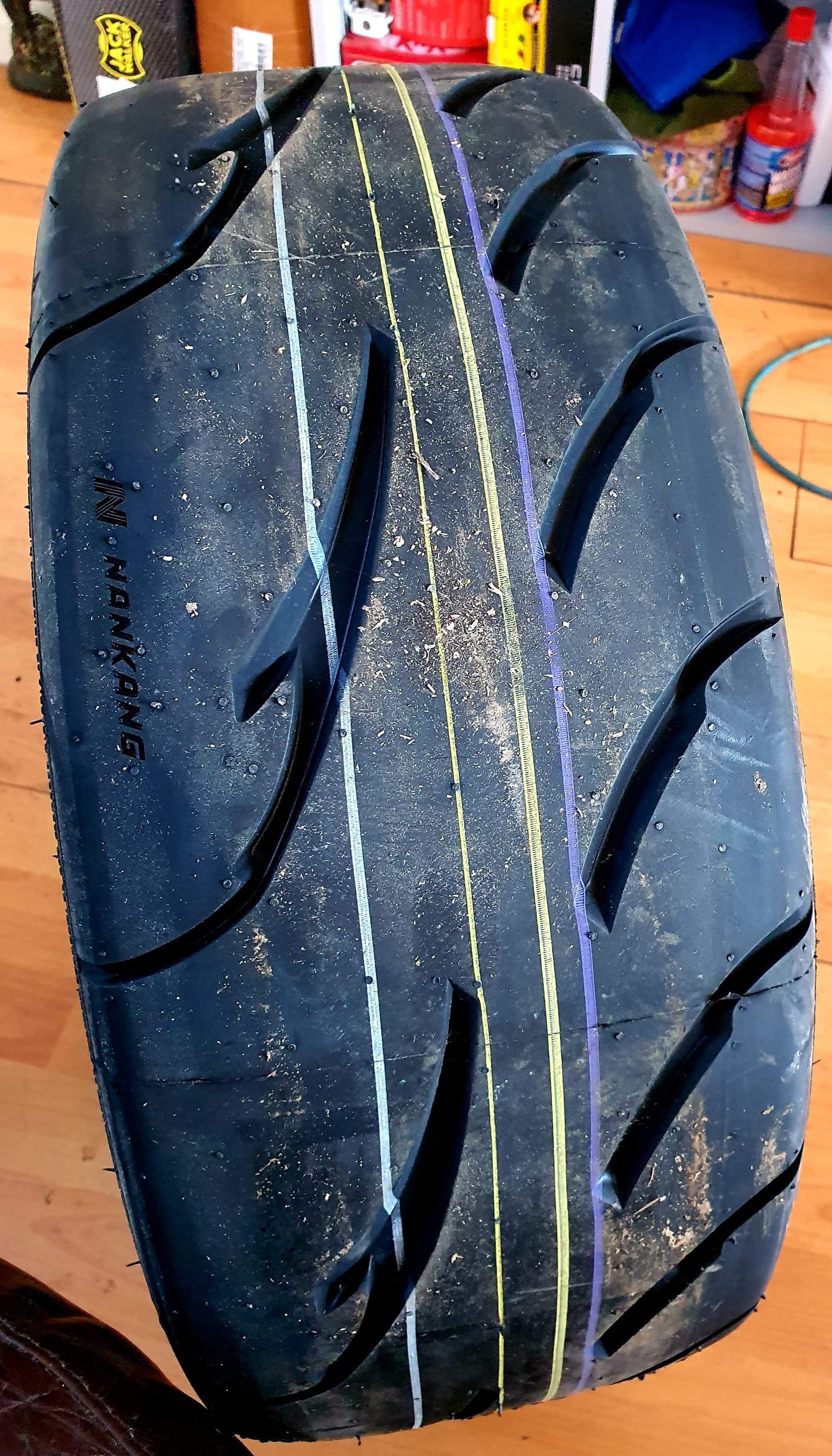

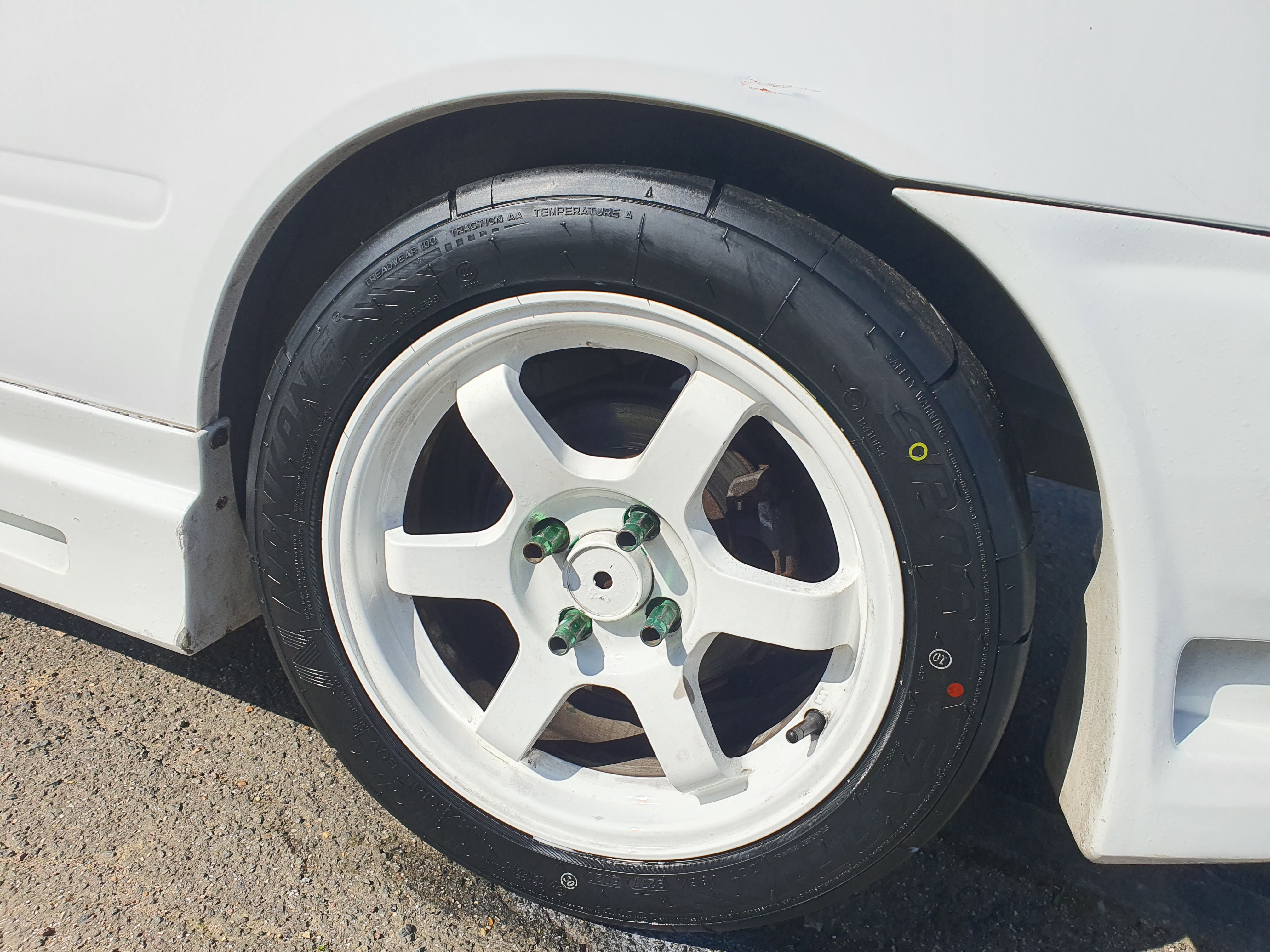

I had a rsther generous Christmas bonus, so treated the car to some new tyres. Very sticky, I've only done about 3 or 4 miles on them, first impressions are fantastic. Even stone cold, they are very impressive grip levels

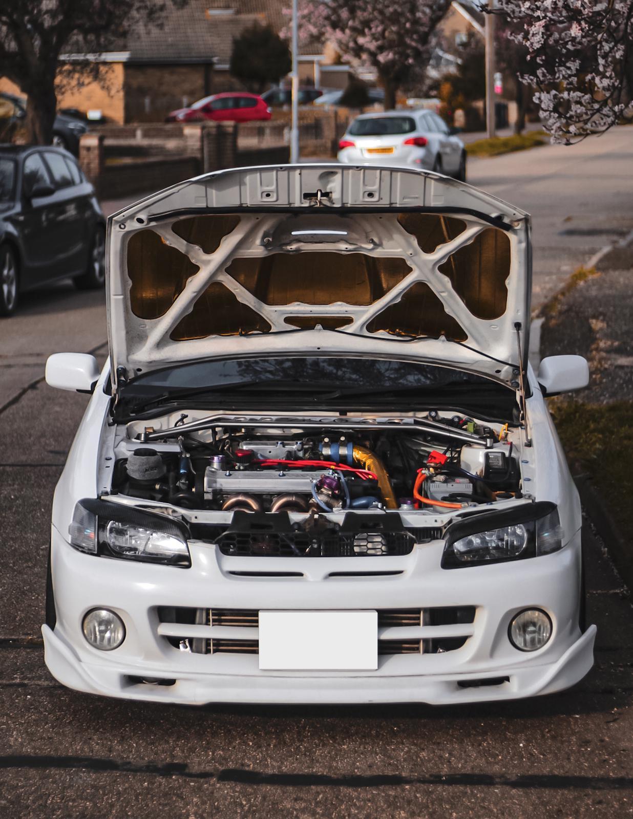

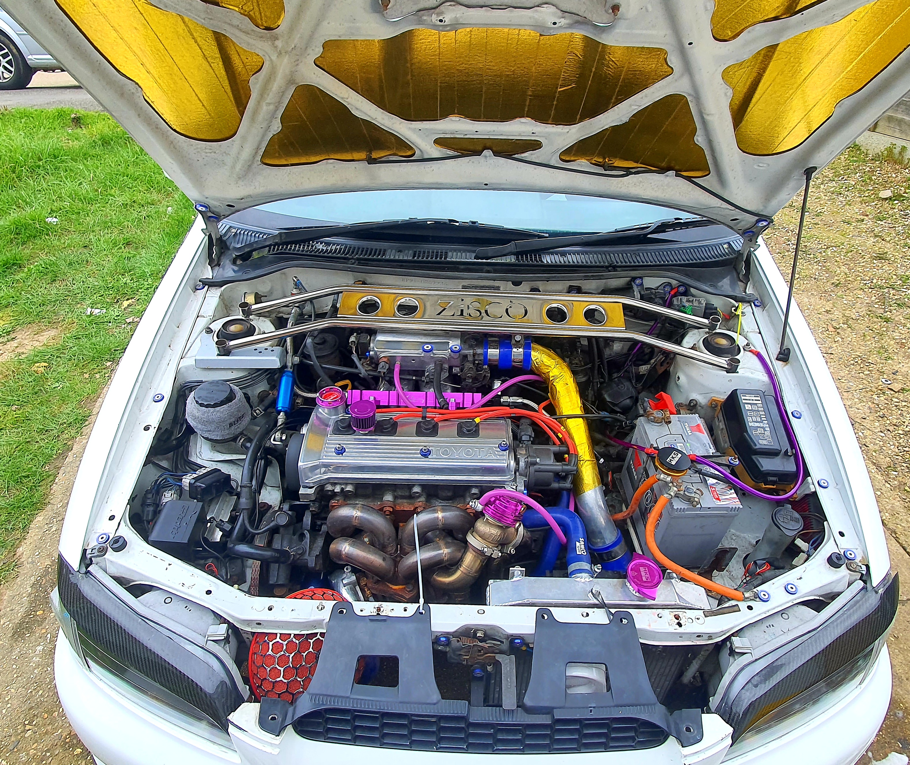

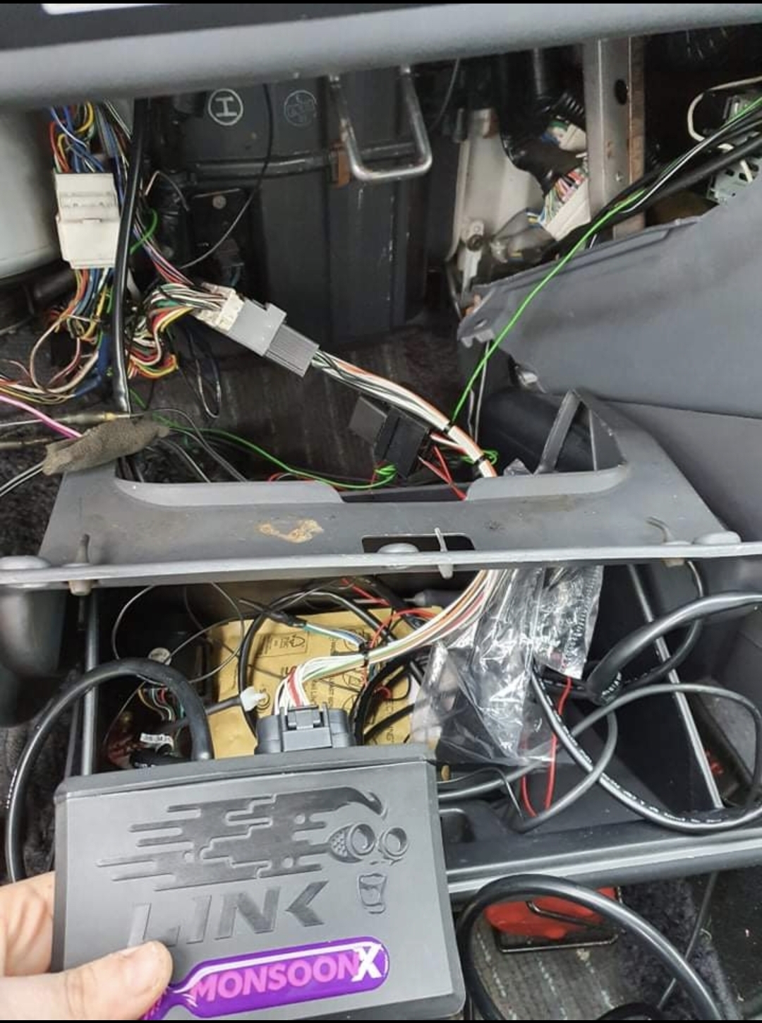

To update this thread. Car sat around for a good while, life gets in the way as usual. Went to start it about mid September time, just cranking. Had fuel and spark so baffled everyone. Speaking to people in the know, and confirming with ME, the ecu was picking up electrical noise from the dizzy. Great. Had 2 choices, strip back all the distributor wiring, convert it to a different triggering system by grinding some teeth off of the dizzy wheel. Or bin the ME221 off and go to something else.

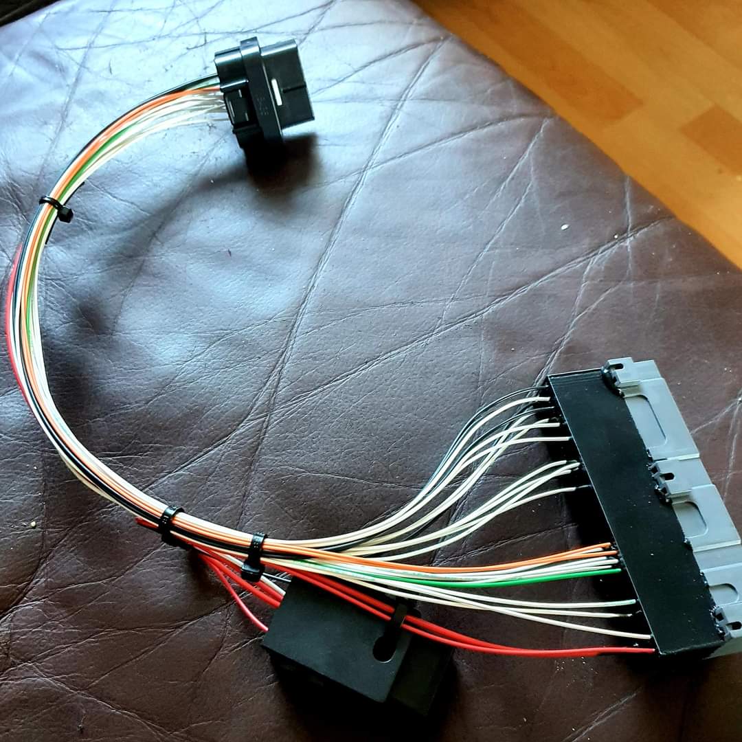

So of course went with something else after that headache, Link G4X Monsoon and a jumper harness made by Rob Fisher.
its about as basic as setups go for the time being, no COP and no sequential fuelling just yet

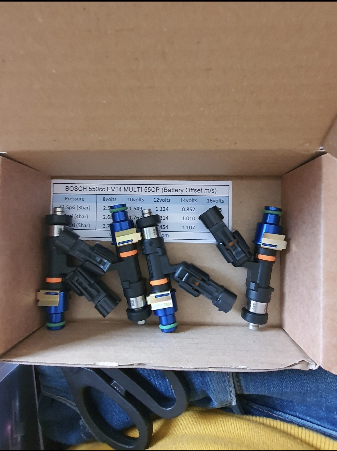

Now onto fuelling I could either keep the old style denso 550cc that I bought or go to a much newer design Screenshot_20220417-114322_Gallery.thumb.jpg.20b4973304d86cad9521fda631955b5d.jpg
Bosch Ev14 were chosen, pretty much because they're about half the price of ID1050x and we all like saving money.

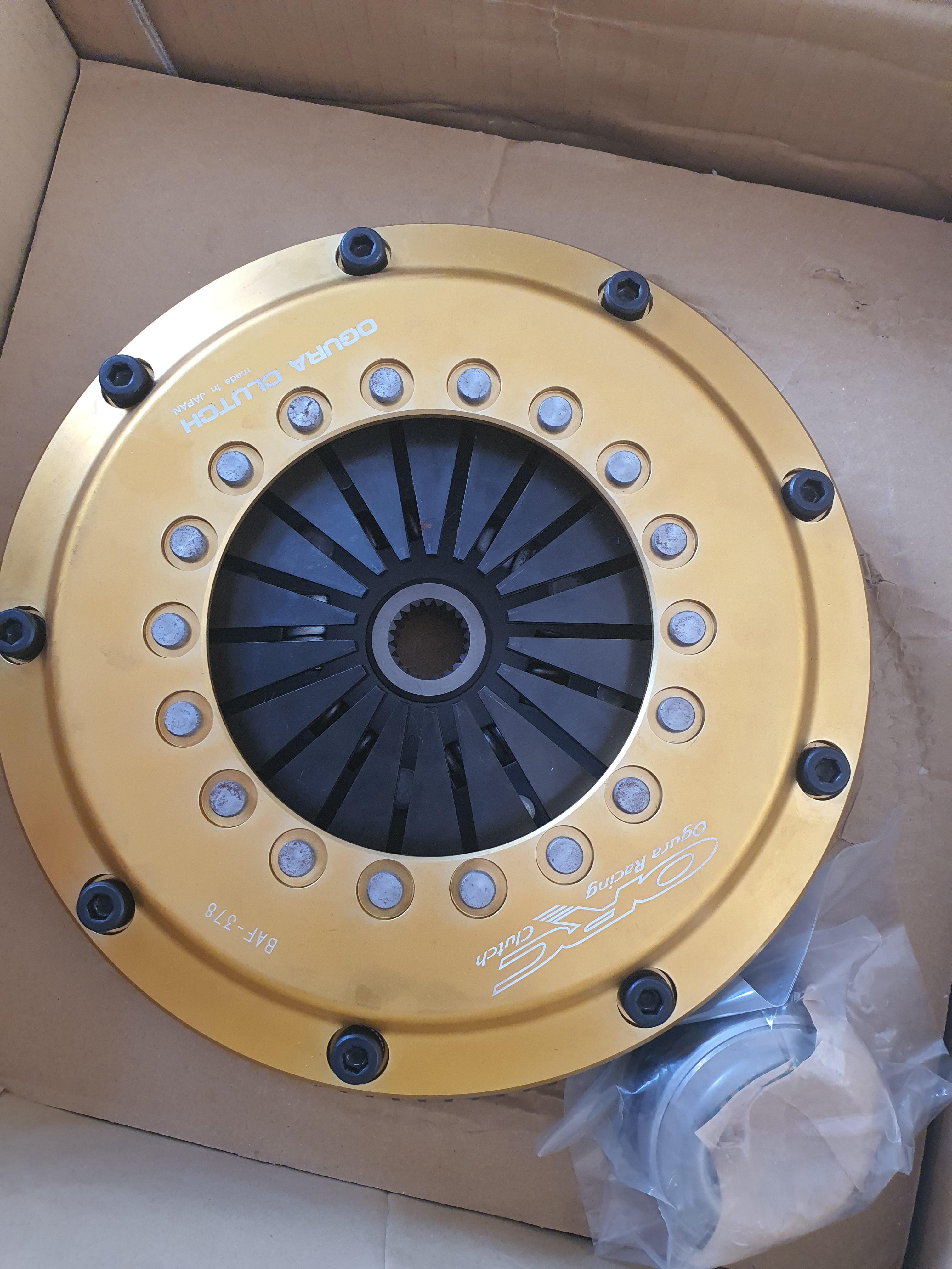

I wasn't entirely sure what clutch was in the car, felt stock but juddered a lot. Originally was gonna just send it on this clutch and see when it gives up, but what's the point in having a 300+ capable set up if the clutch gives up after 200bhp. In the end bit the bullet and chose an ORC 309d direct from japan
Still waiting to go in the car but what a beautiful bit of kit to be sat on the bed side table!

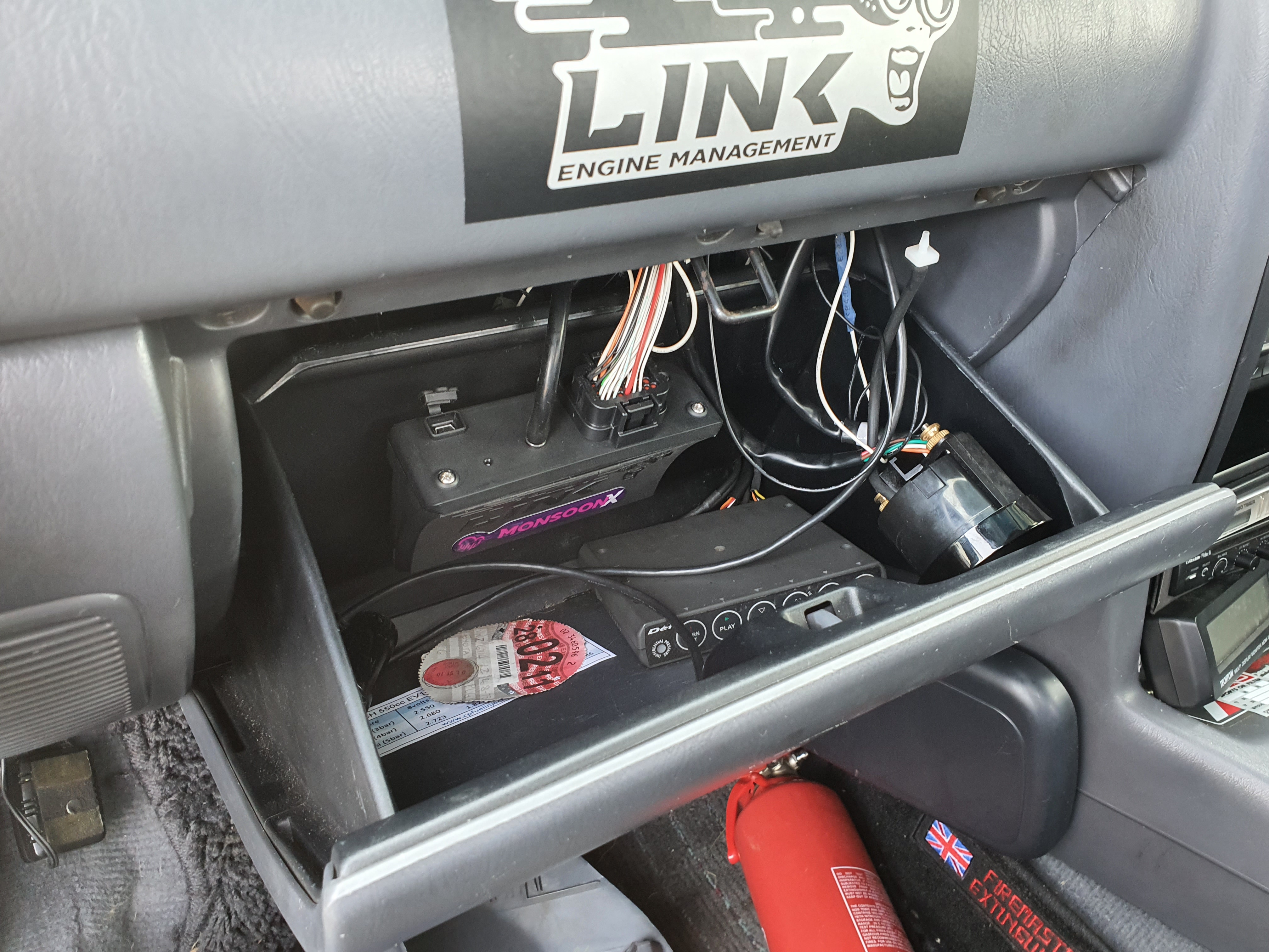

I think that's all the purchases out the way, just a case of plugging in Robs loom, putting the AEM wideband to the ecu, changing the IAT sensor to links own
Present day just finished tidying up the glove box area, unsure if I want the wideband in a pod on the dash or centre console area. So atm it's just sat in there. One day I'll go to links digi dash, so the wideband will be displayed on that anyway
