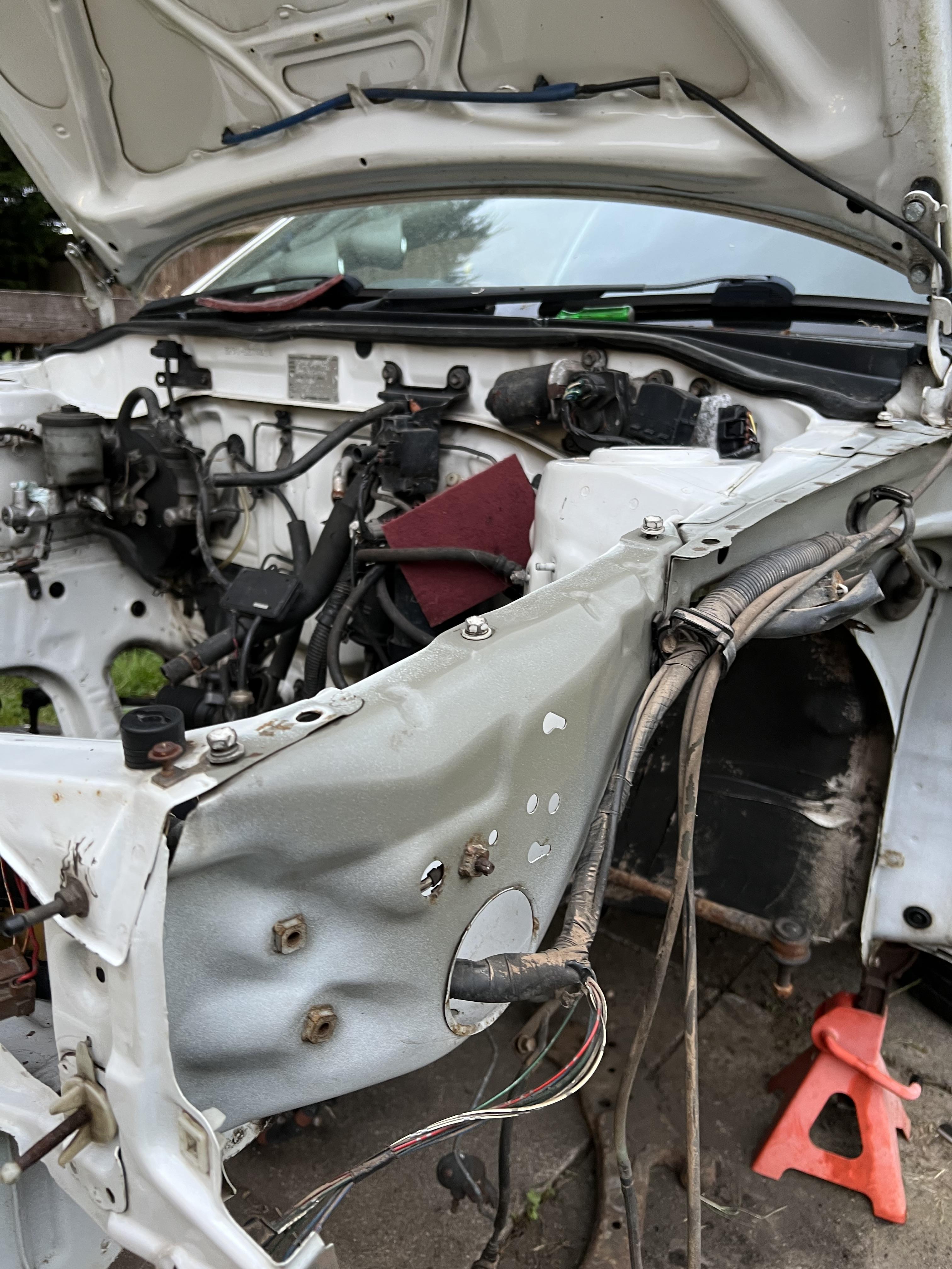

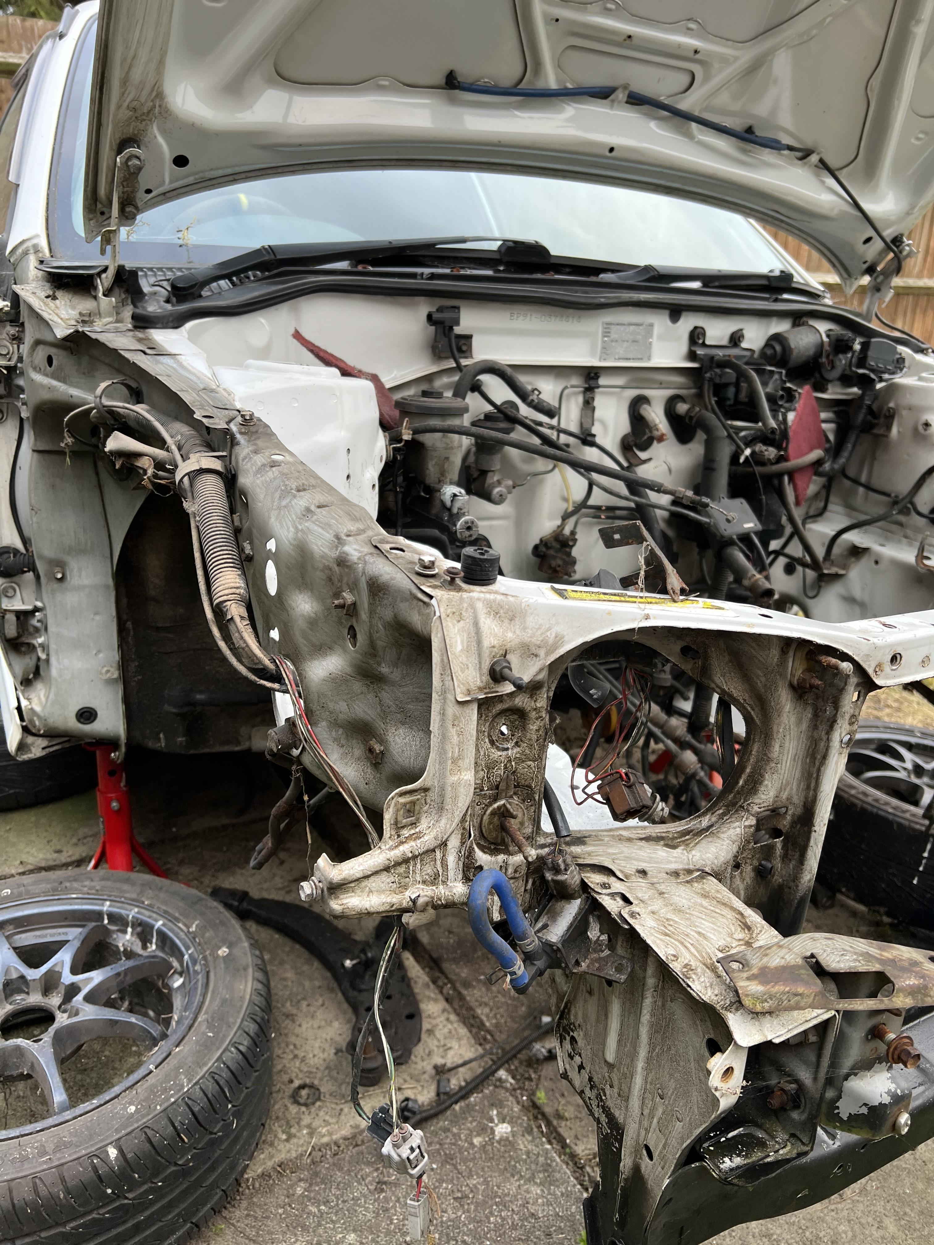

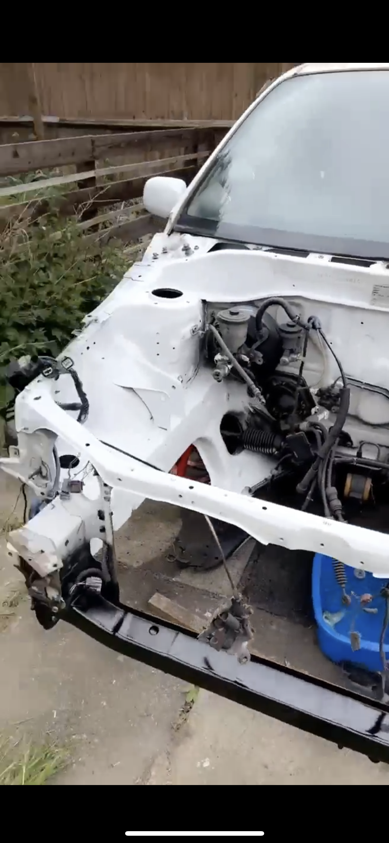

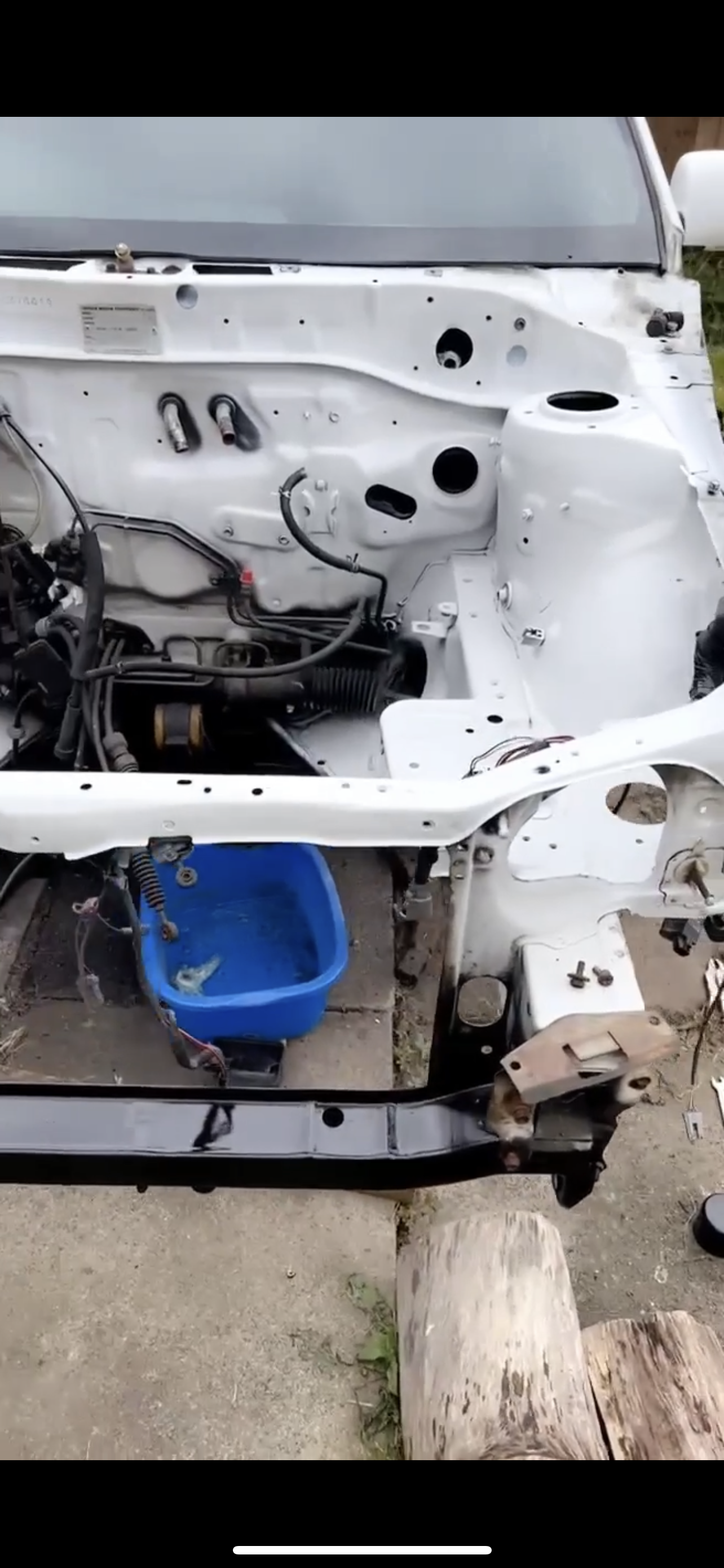

Had a quick hour on G after work, removed the wings just to make it a bit easier to clean everything up and I also plan on condensing down the loom in them areas as it’s very messy and maybe relocating the fuse box inside the car.
had a scrub up in the bay and arches was very grimey under the wings as you can see, getting a bit of prep work done ready for some paint, will also under seal the arches, trying to get this done soon as my suspension parts are slowly turning up so would like it all painted whilst it bare.

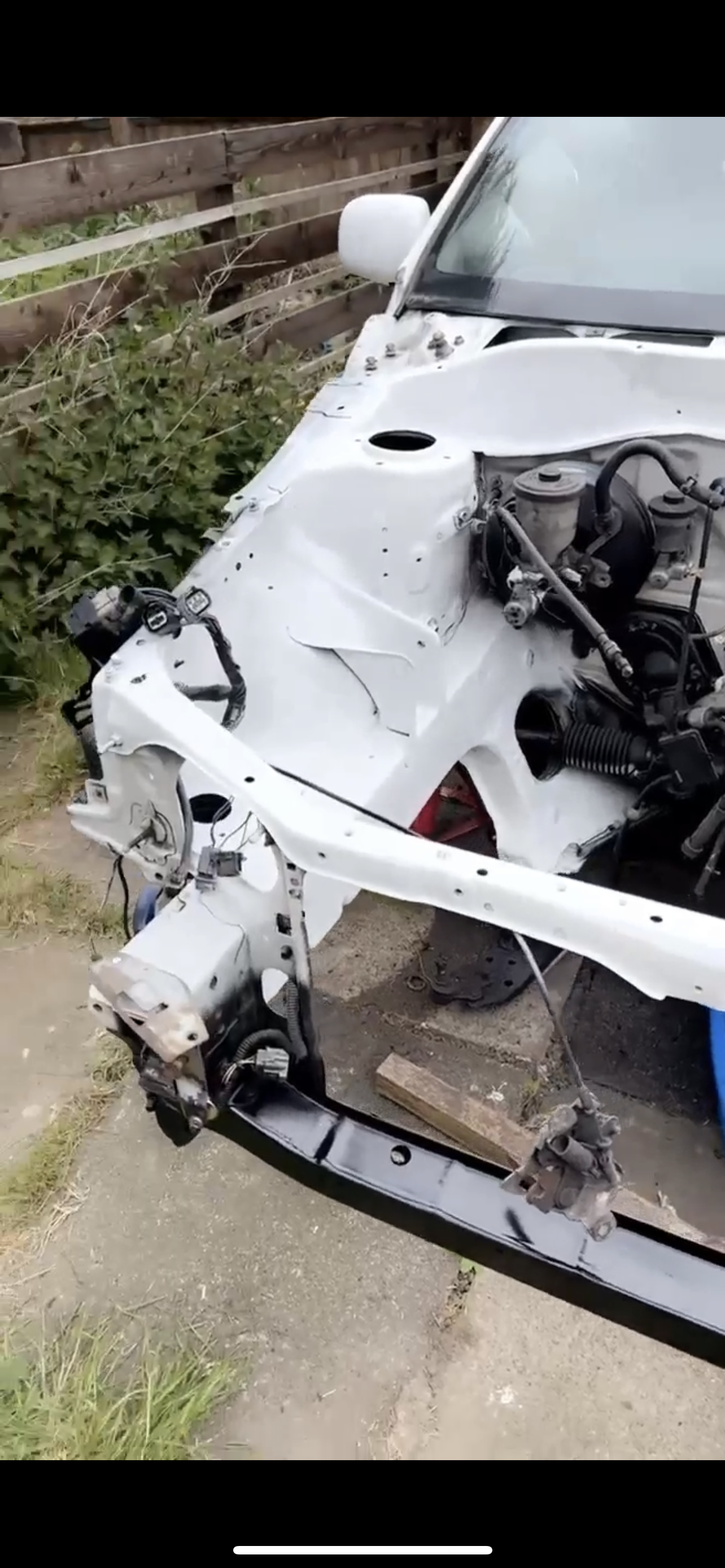

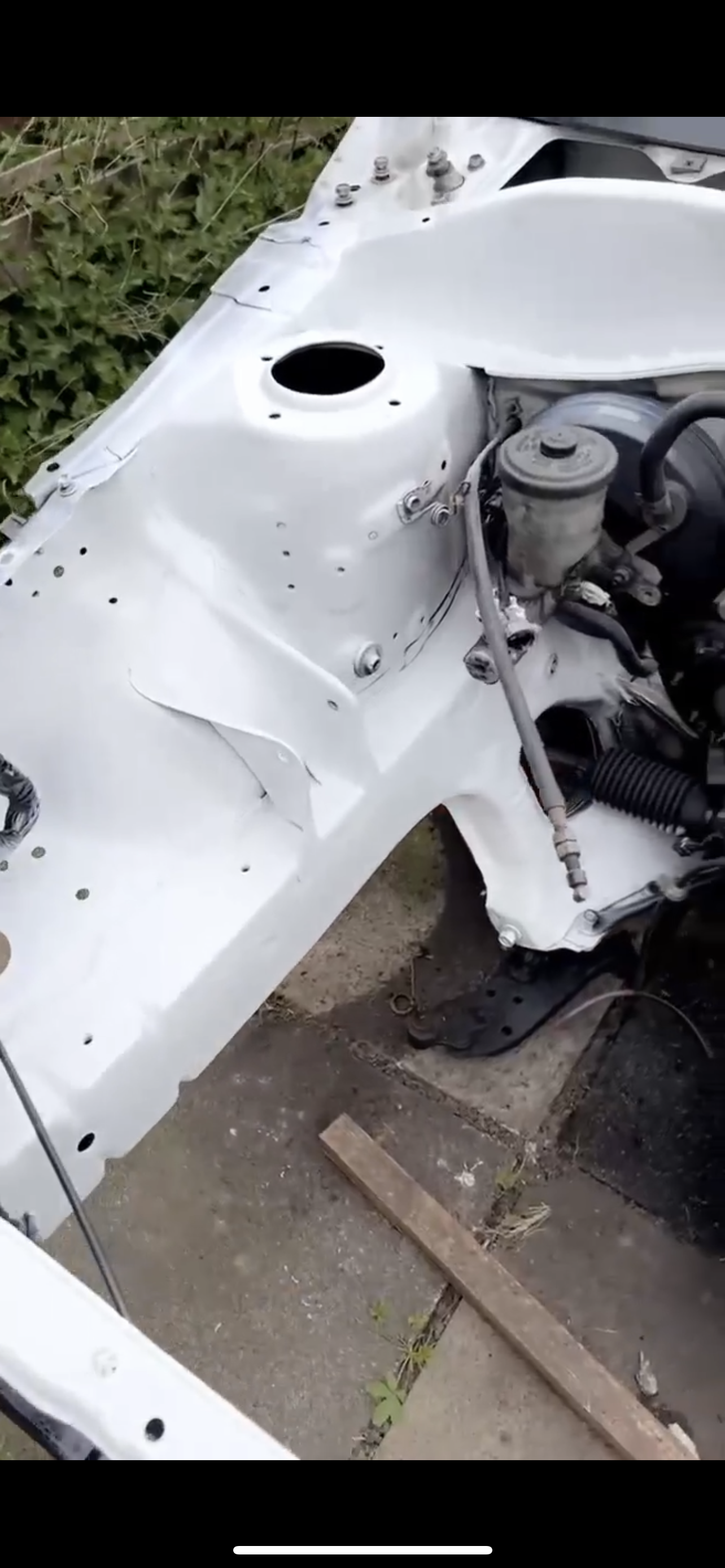

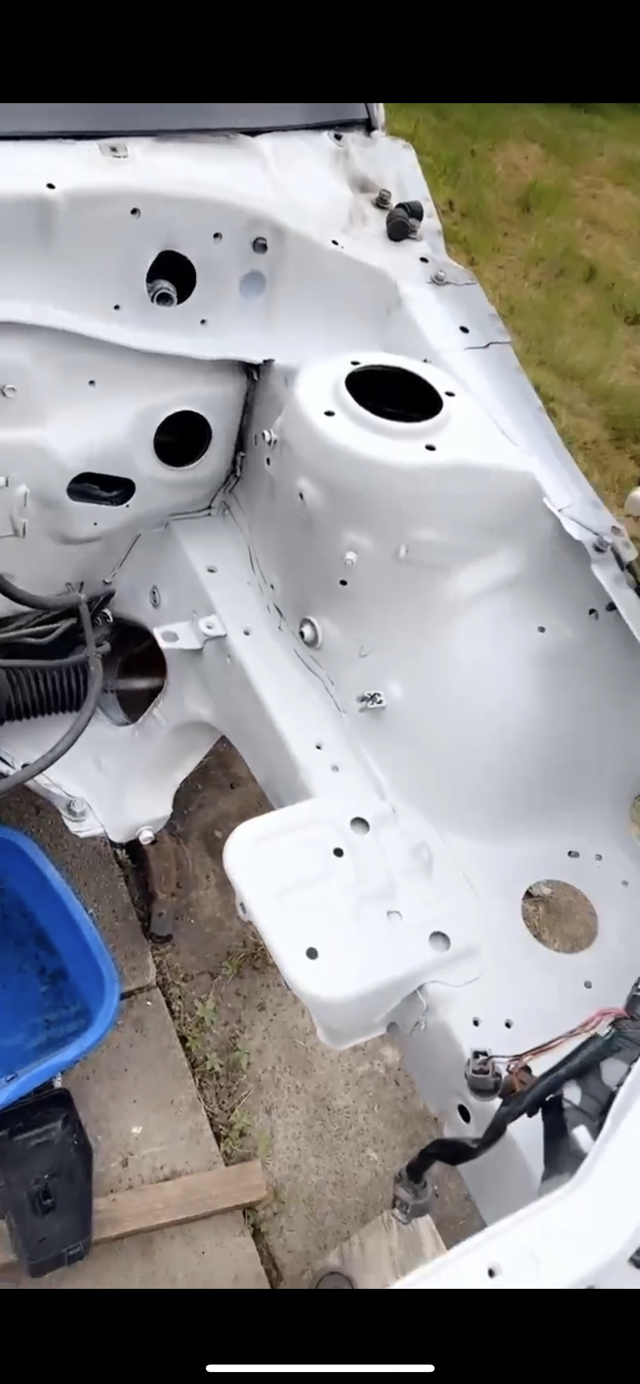

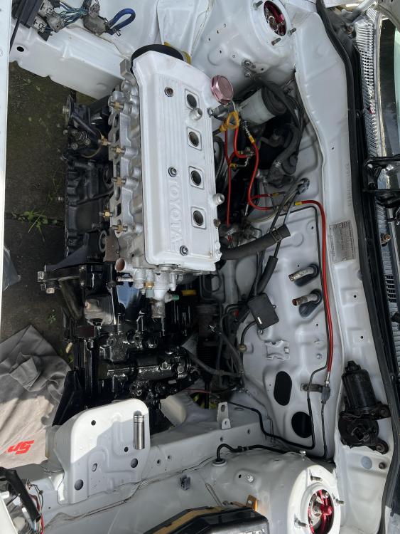

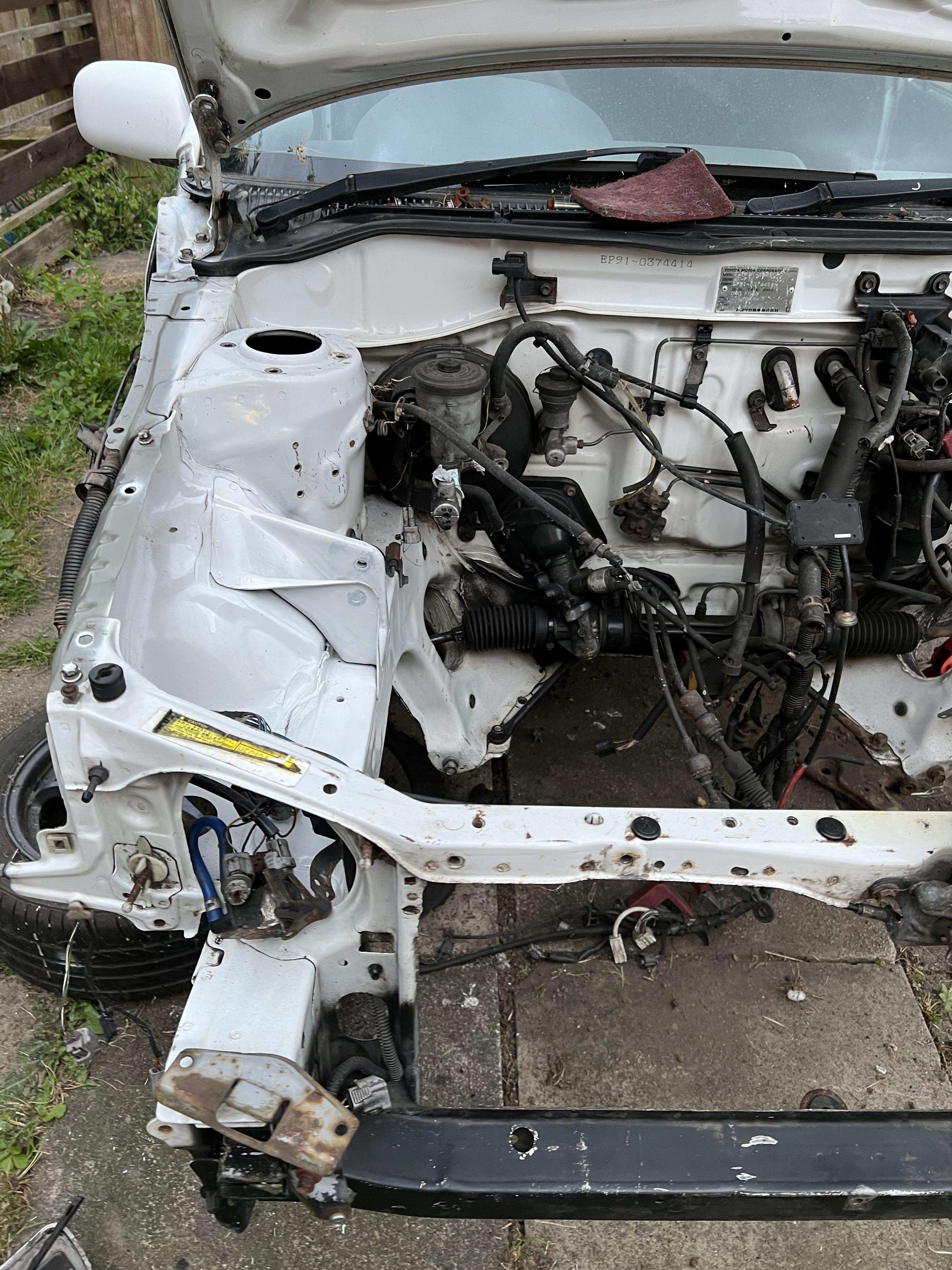

So managed to get the bay painted and looking tidy 👌🏽
image.thumb.png.e8535d1beecc6021b997d0f7afea8ac5.pngimage.thumb.png.328310ac151421f784e8c83cb778759c.pngimage.thumb.png.62467010de177dd775b4162df3da7961.pngimage.thumb.png.5b9176ab3e39ab9dfcaccd25cdfb68ee.png

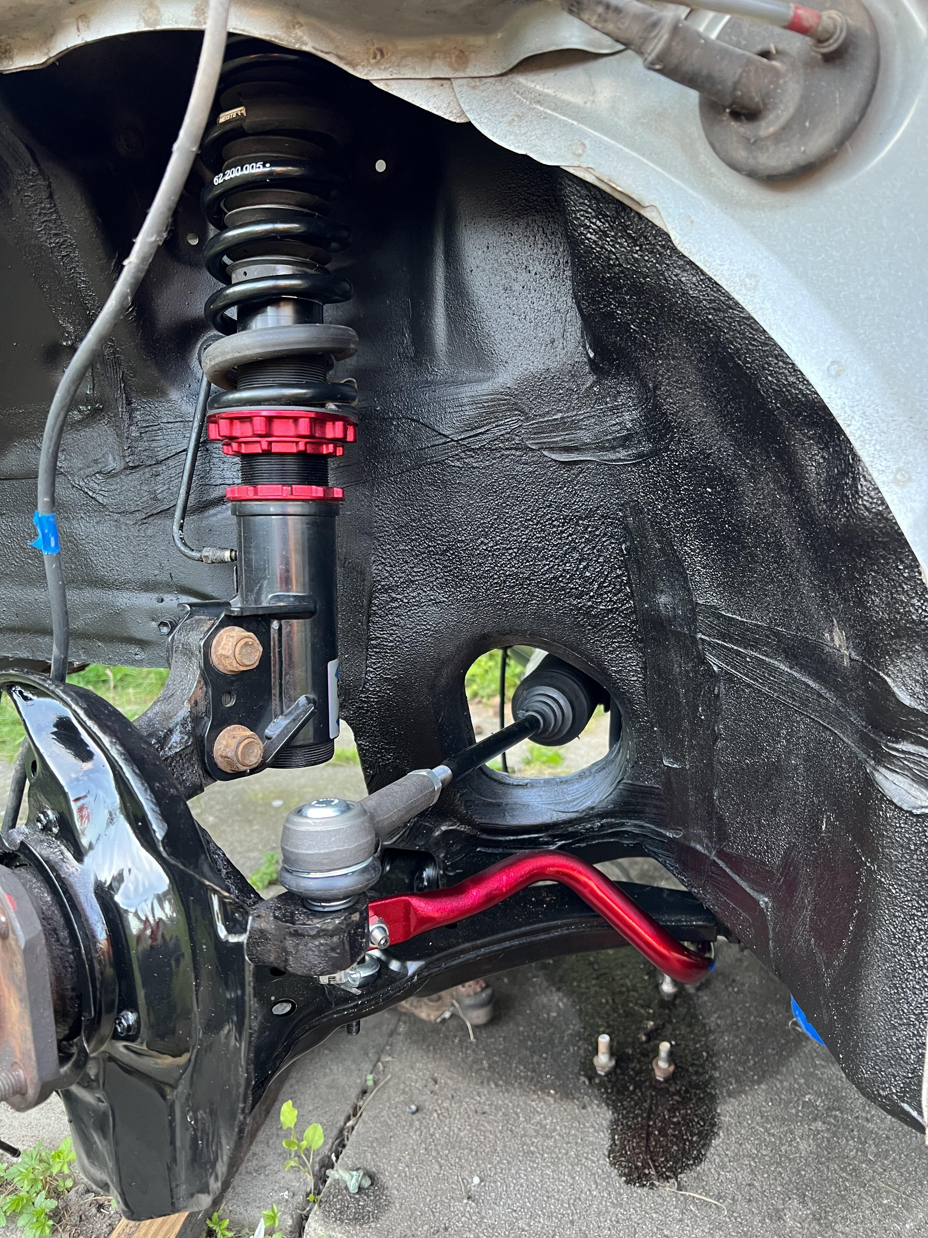

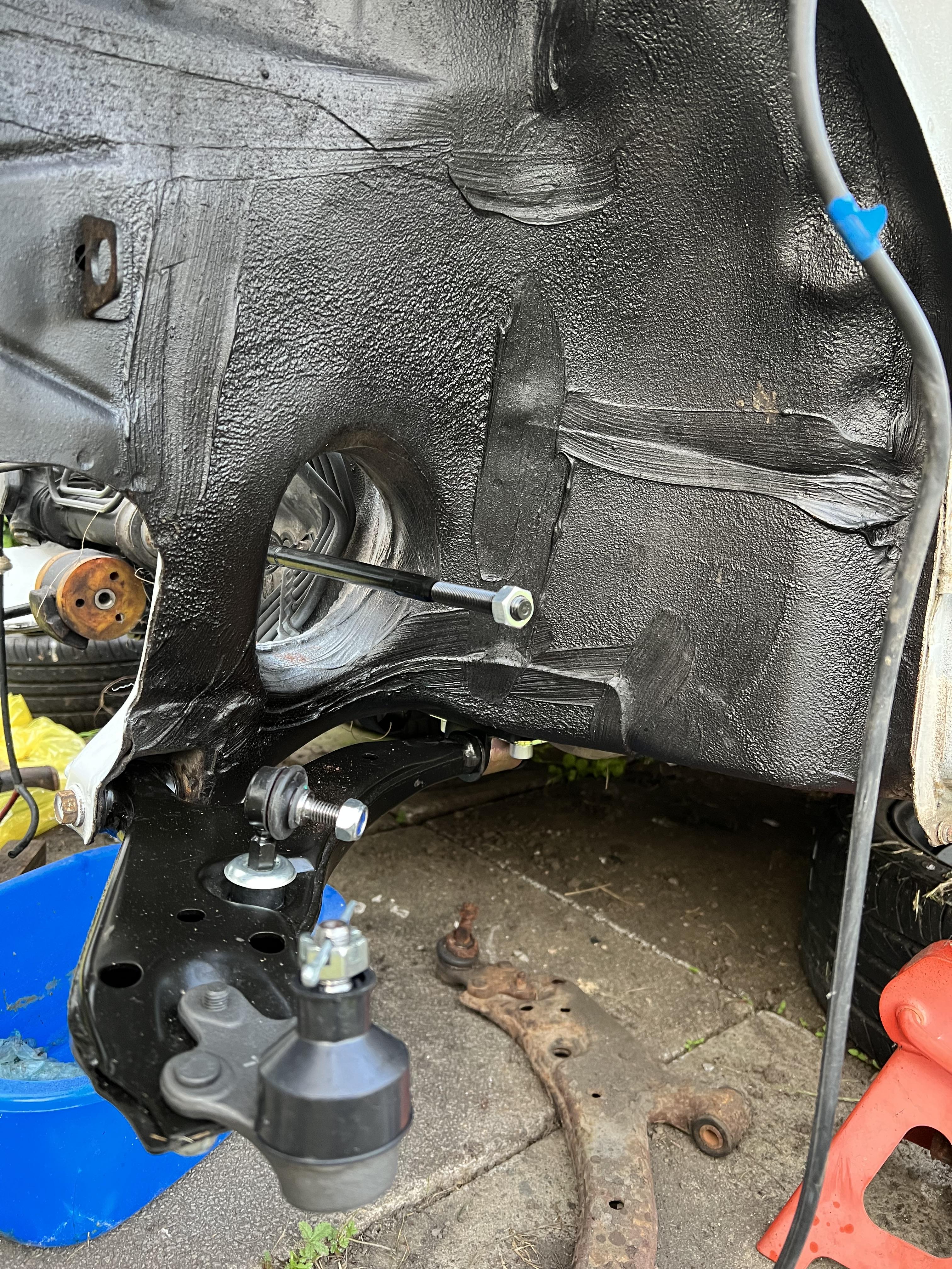

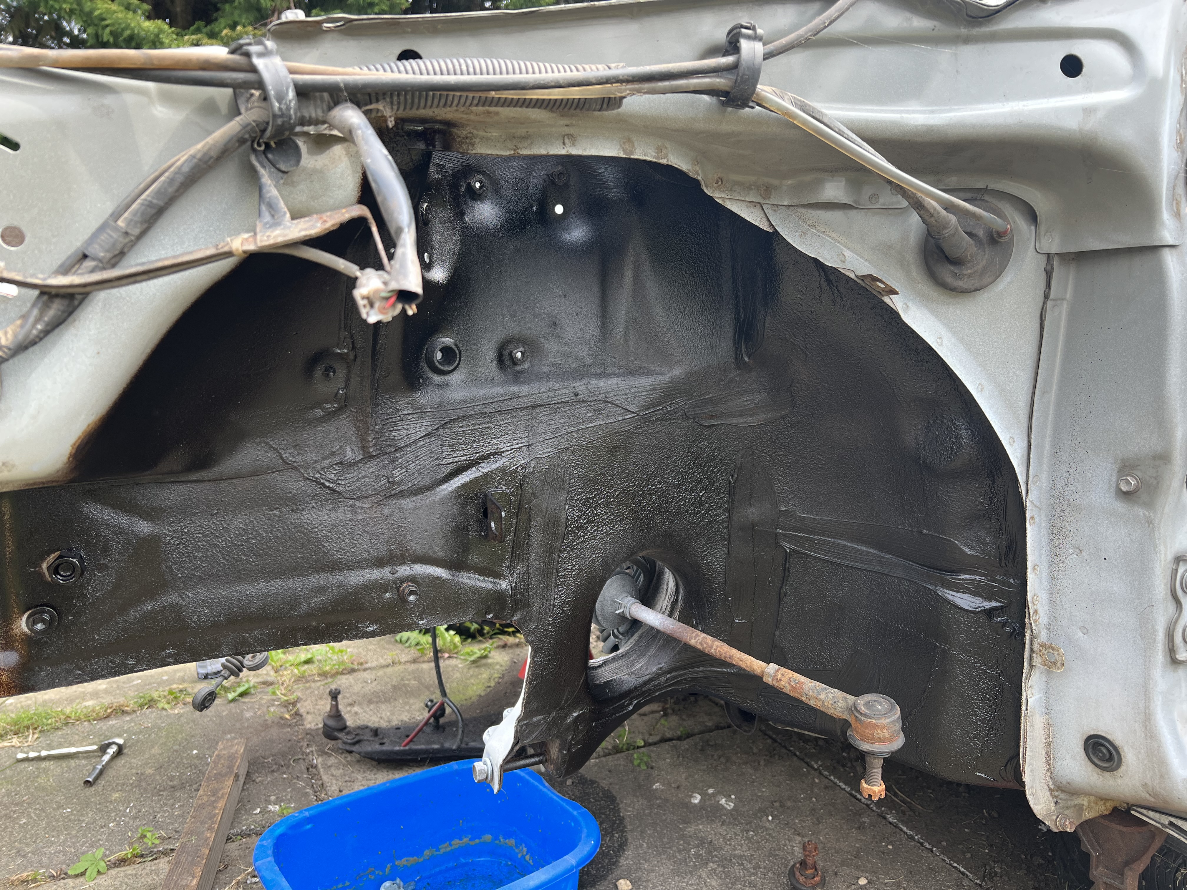

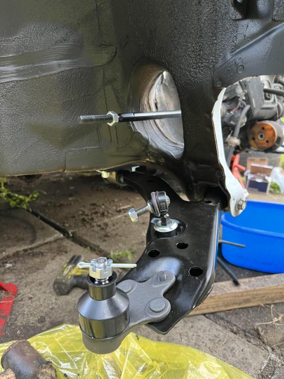

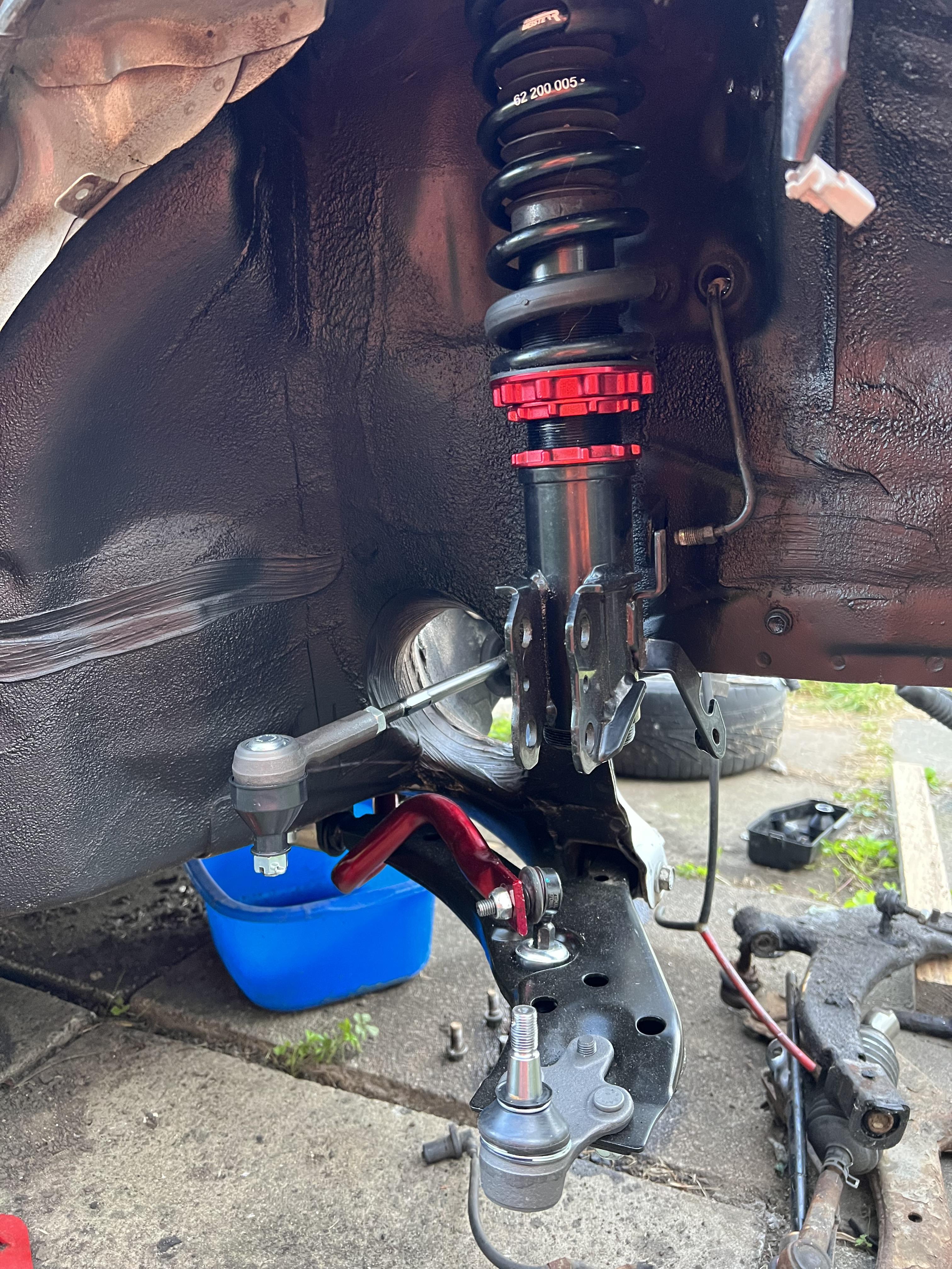

also got the inner arches cleaned and under sealed ready to put all the new wishbones anti lift kit droplinks track rods etc on

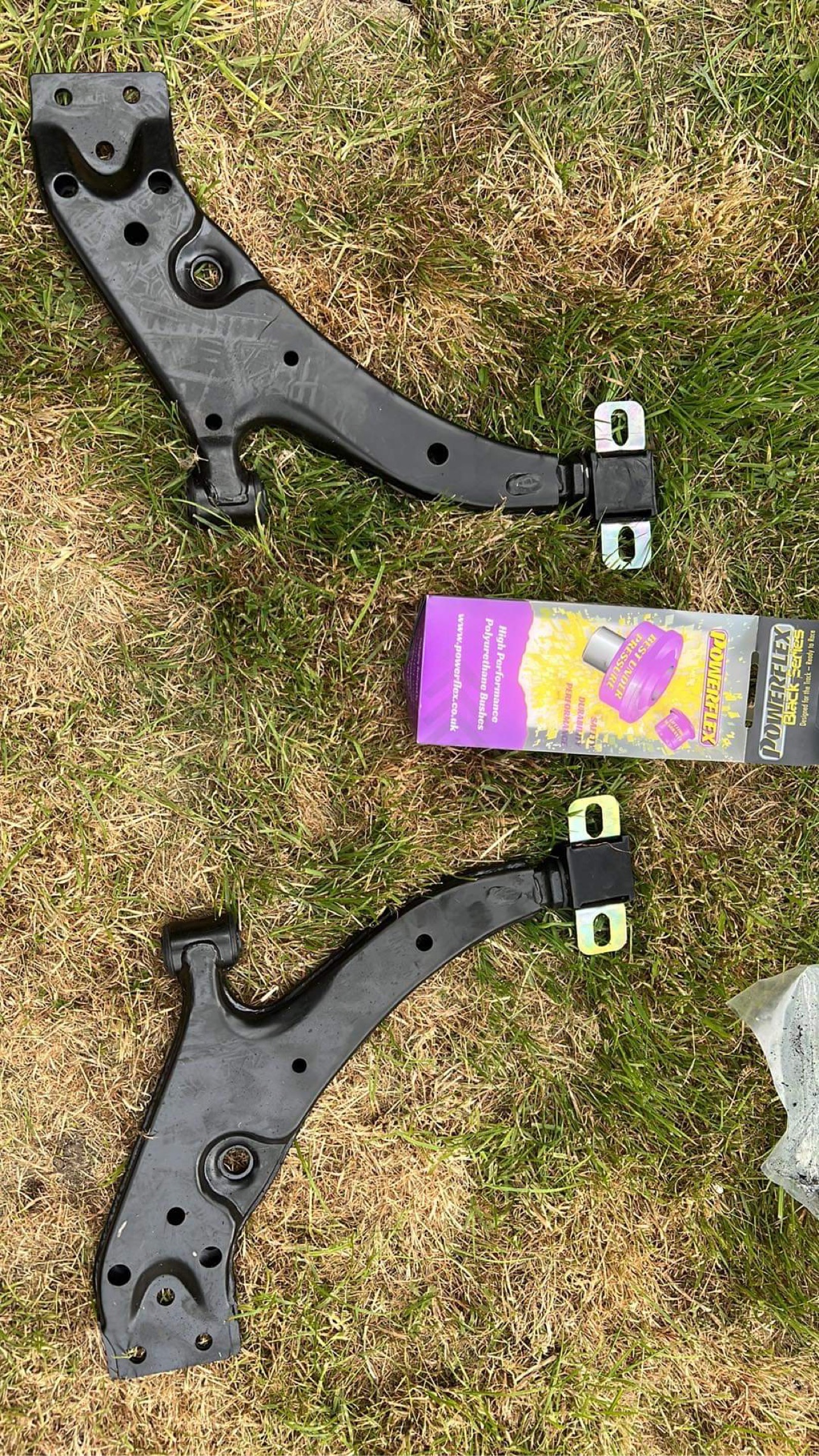

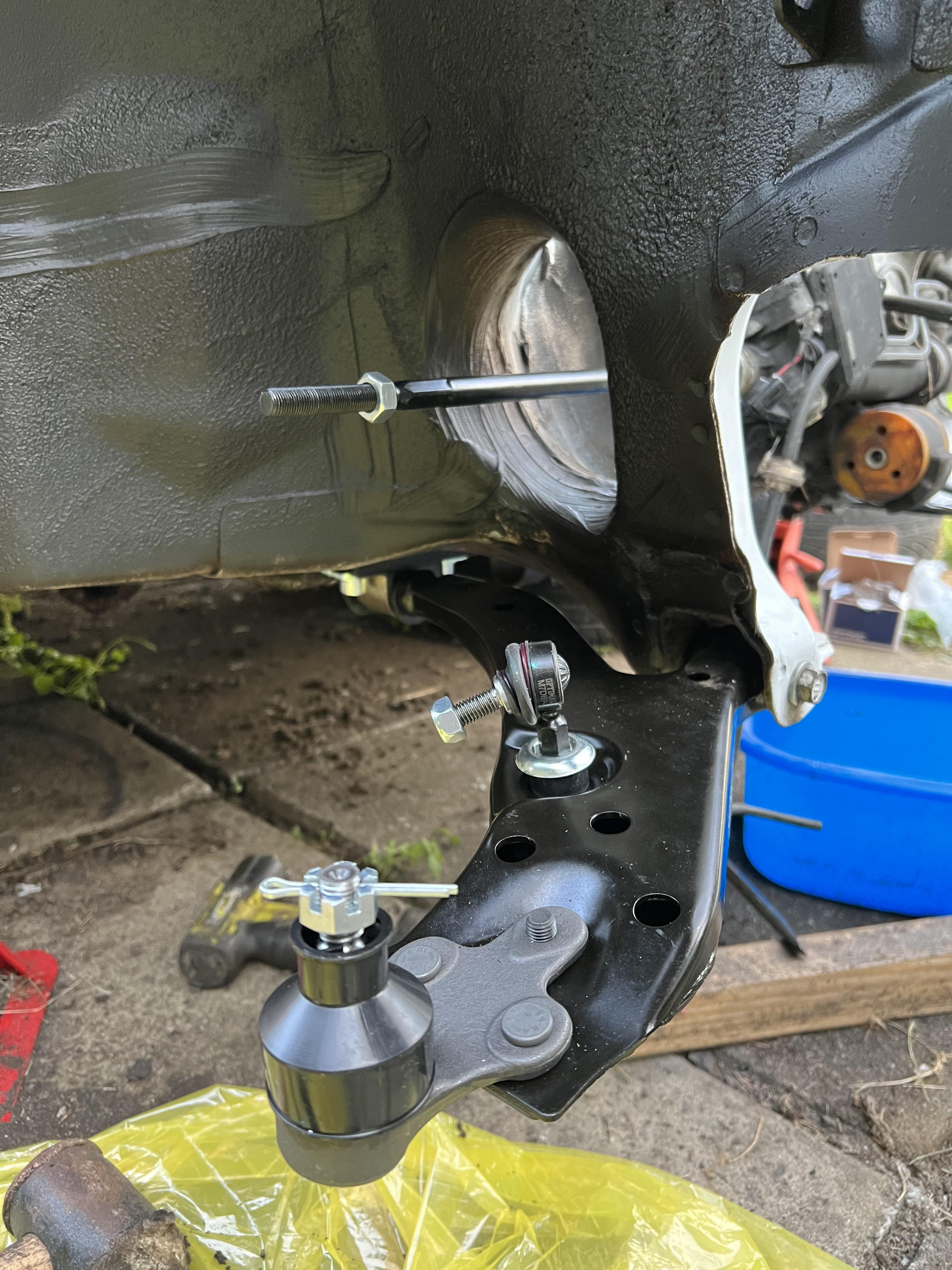

all of the suspension parts have turned up now so removed the new bushes off the wishbones and replaced with the anti lift kit ones

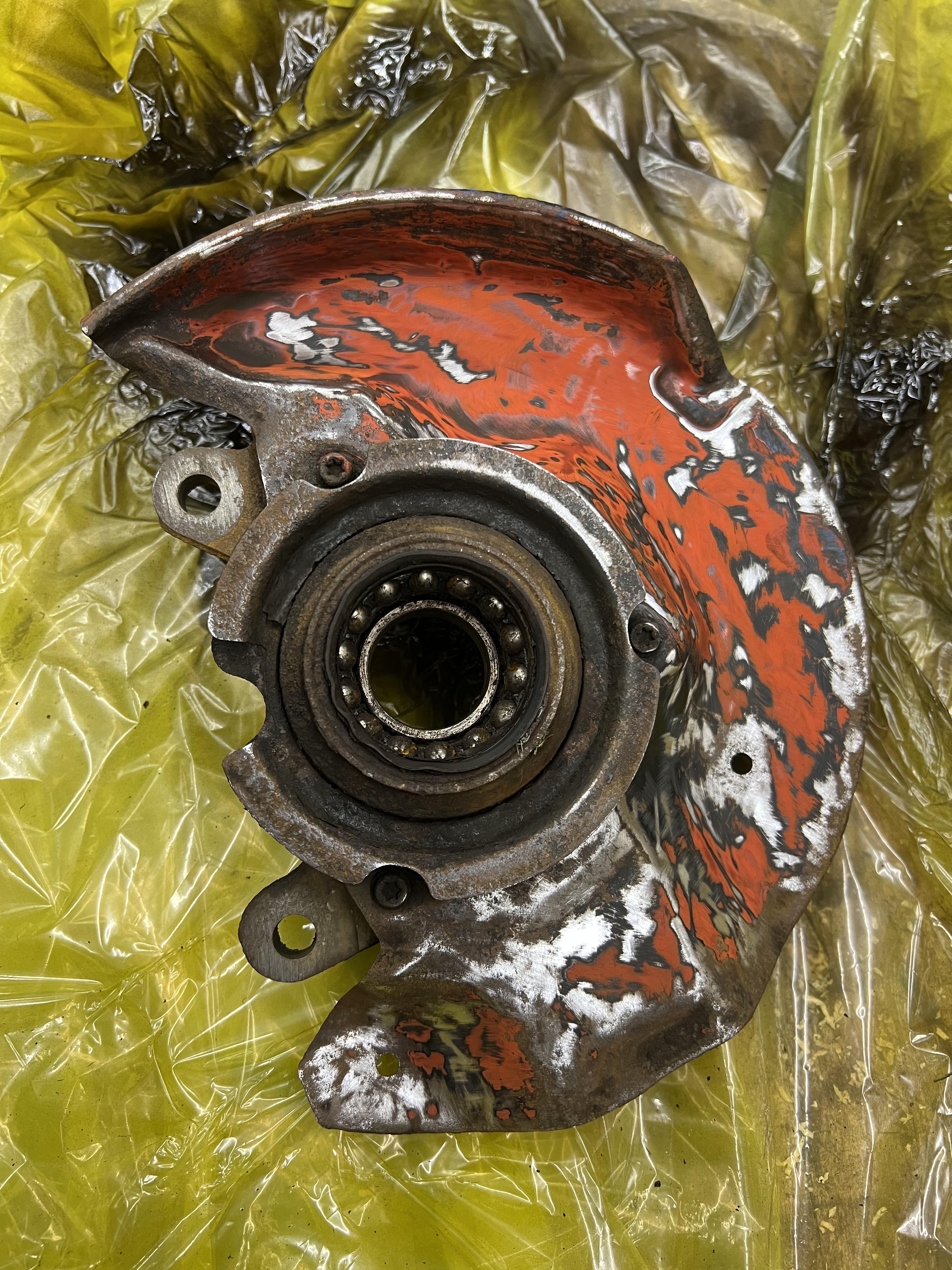

So fitted some more parts today, forgot to order steering rack gaitors so hopefully getting some more today.
also dropped my hubs off last night to get the wheel bearings fitted so they will be going on over the weekend too.
image.thumb.jpeg.c8f24715697d06208e0fe74b143f9fa3.jpegimage.thumb.jpeg.2177cf3a74573870e65cbe906579984a.jpeg

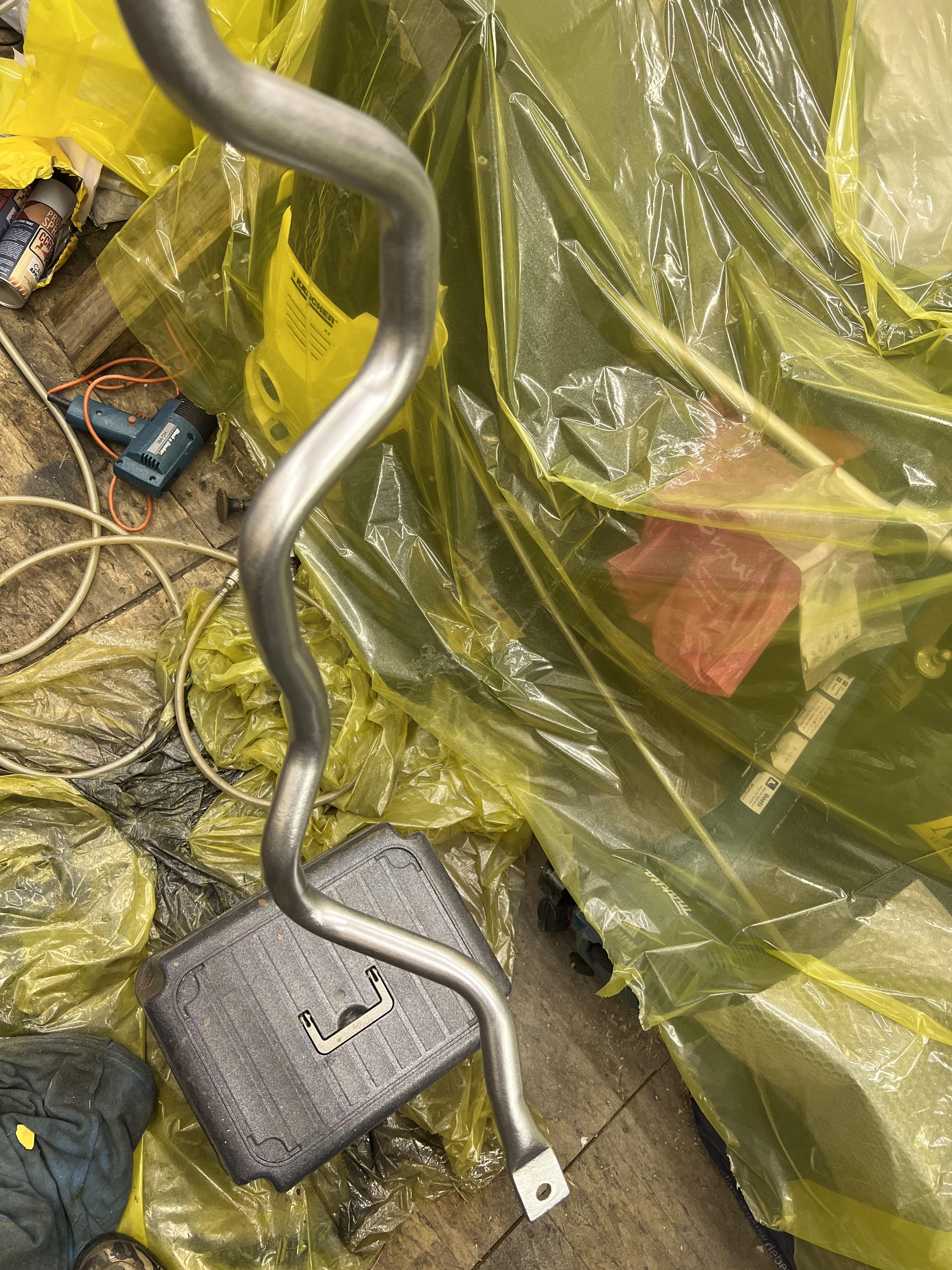

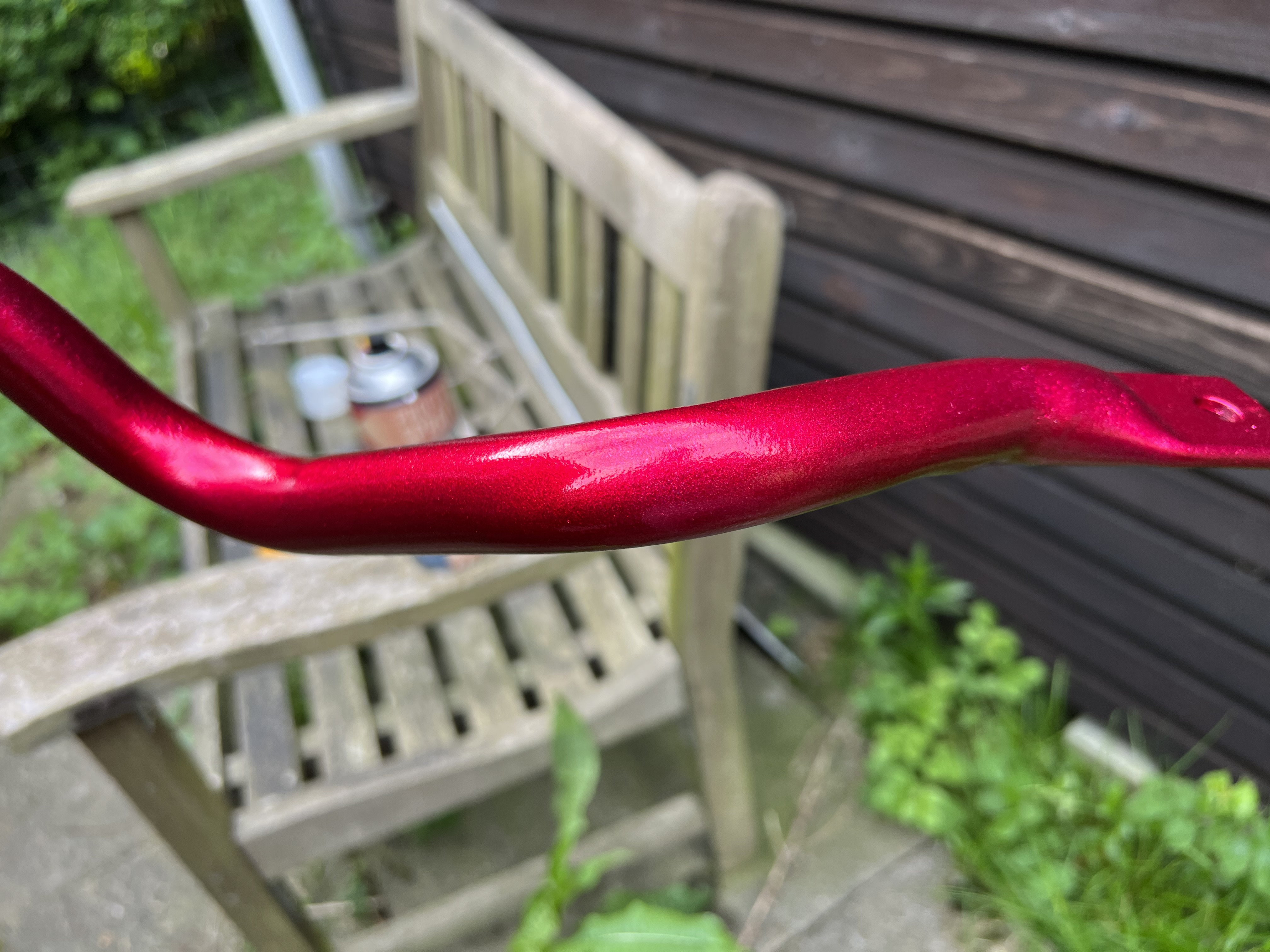

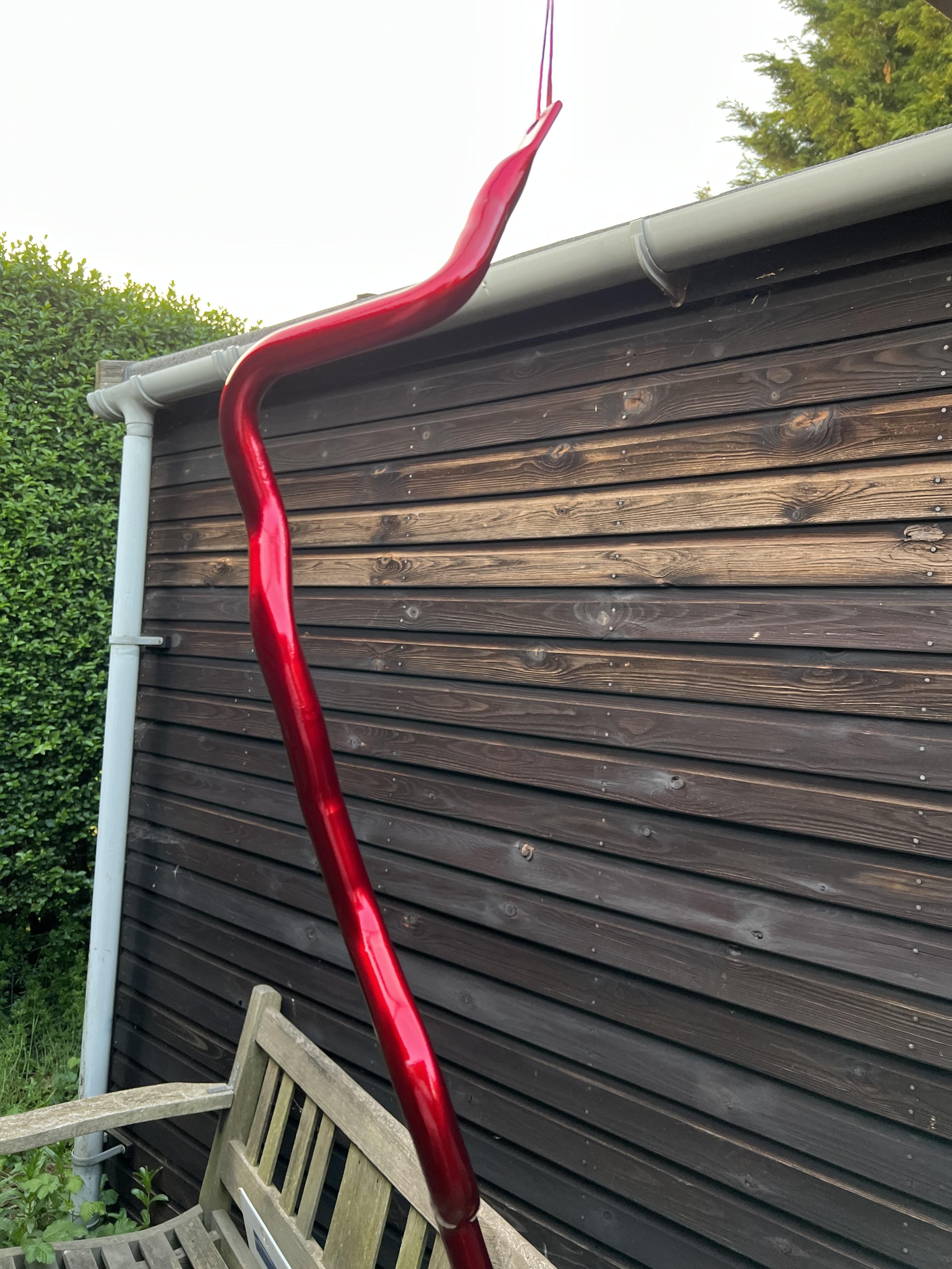

also prepped my anti roll bar up, gave it a metallic silver base coat then coated with candy apple red followed by 2k gloss laquer, came out quite well

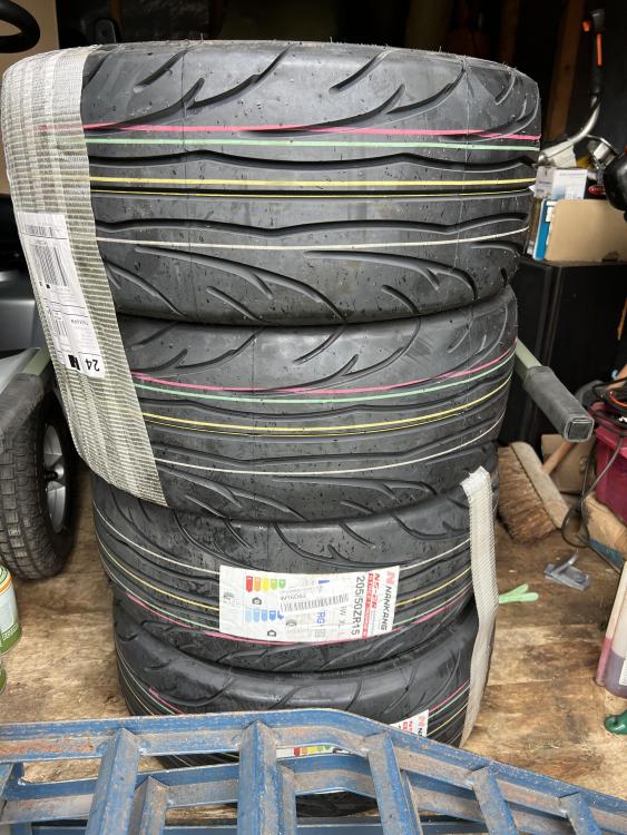

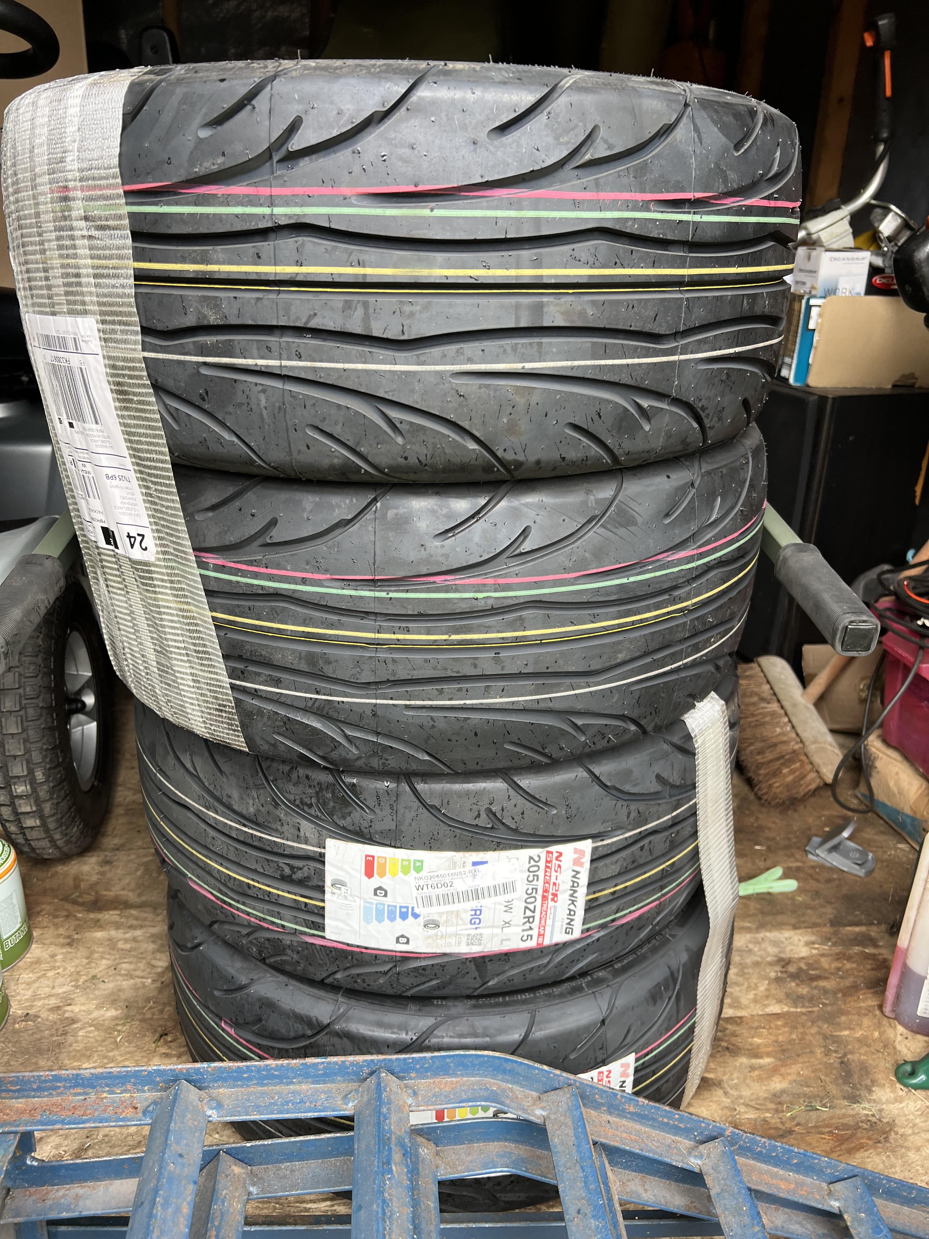

also ordered some bronze Grid V’s and some ns2r’s which arrived today!

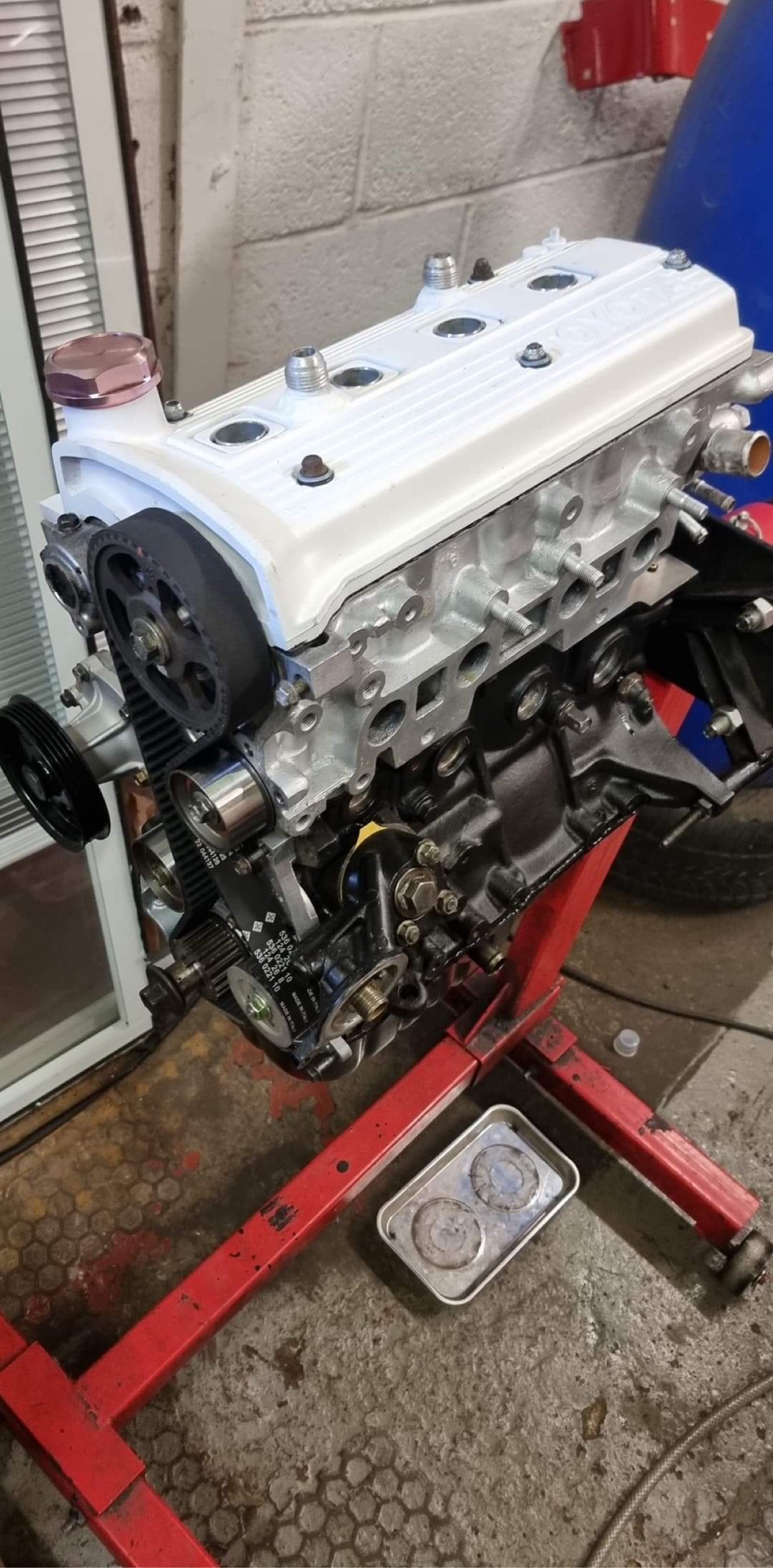

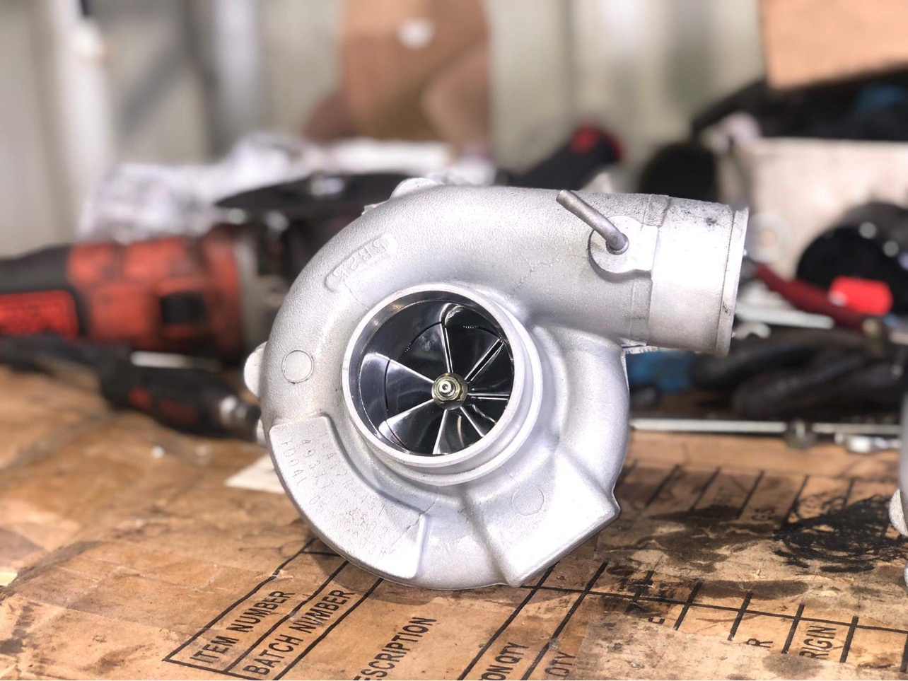

Haven’t posted for a while but back on track!
Engine is done and now fully forged I’ll do a spec list later on

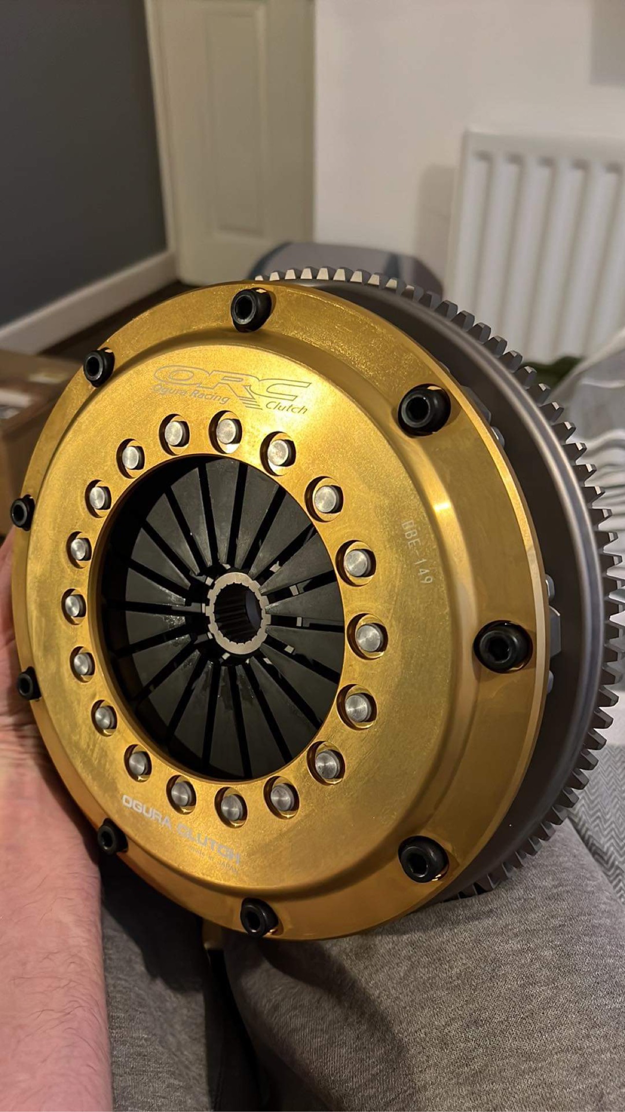

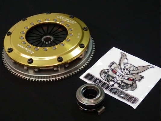

The ORC clutch & flywheel arrived from Japan really pleased with that looks a great bit of kit

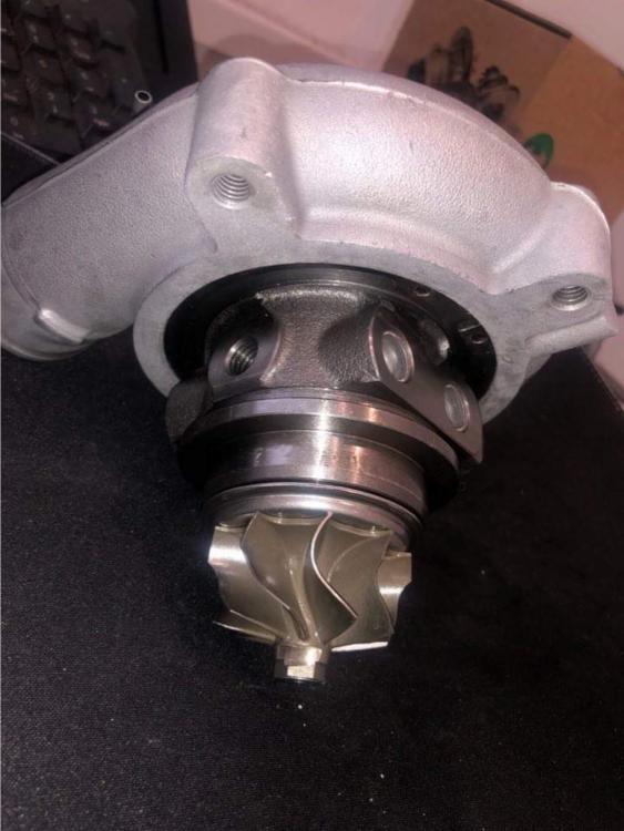

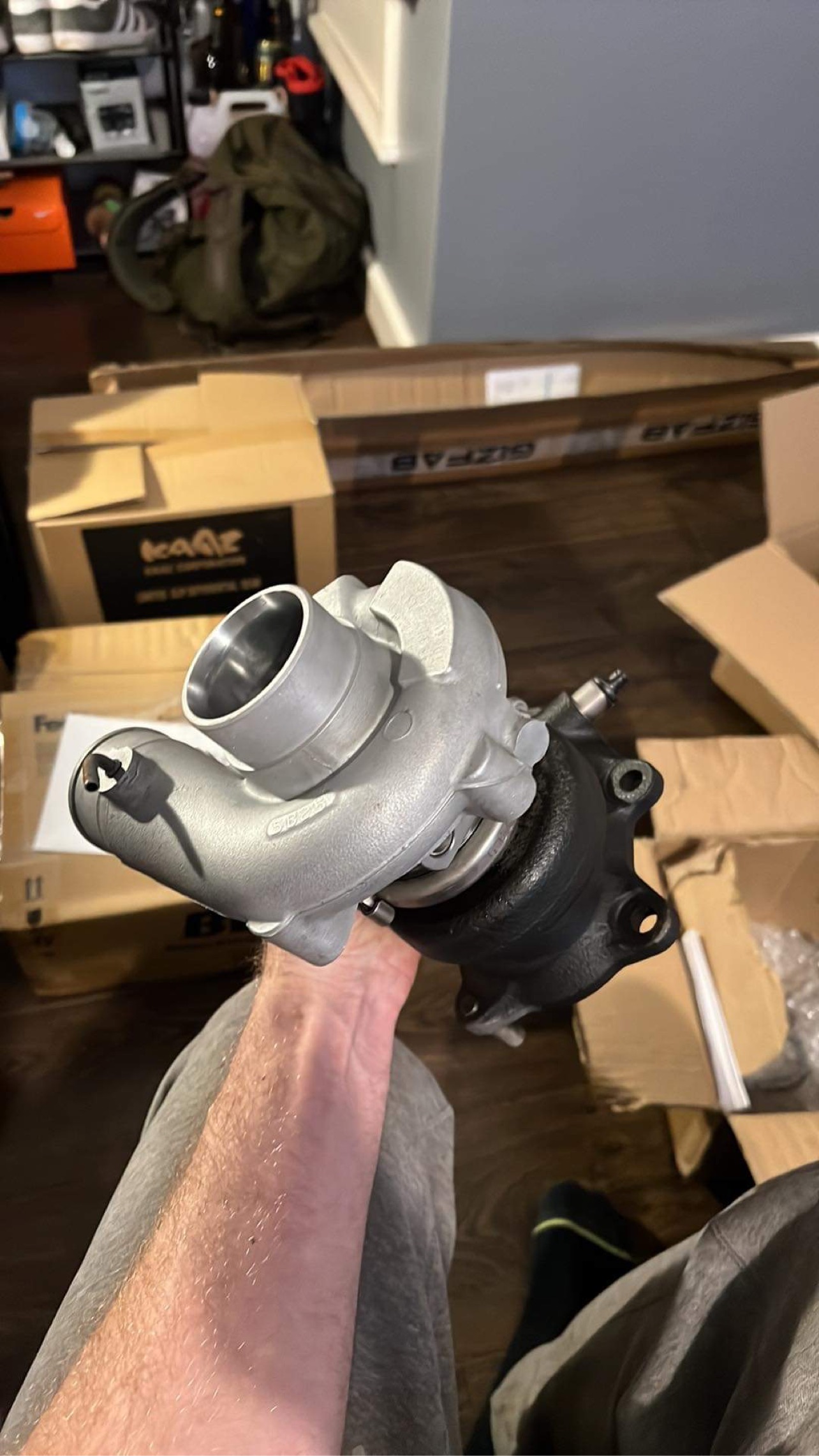

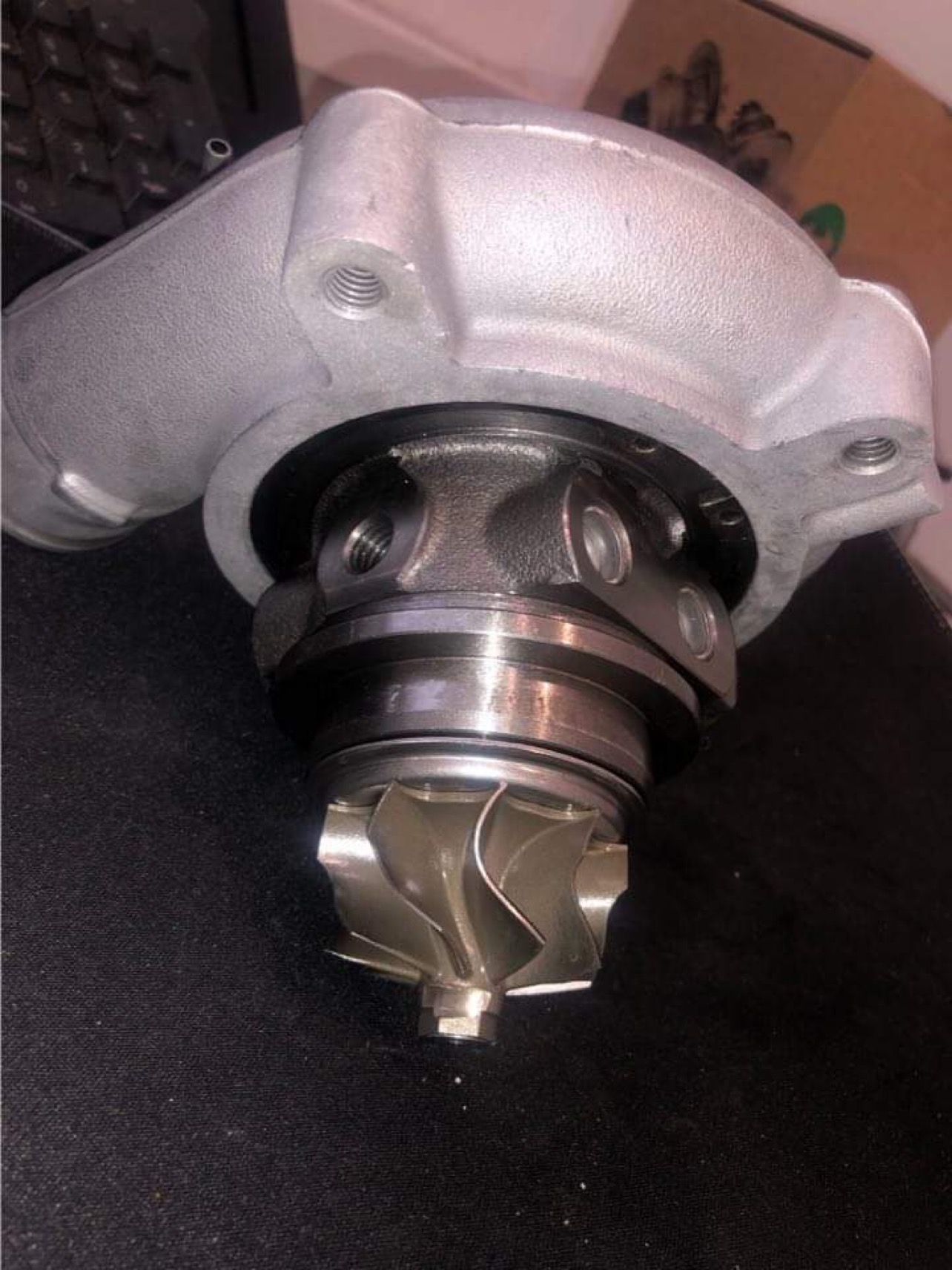

Turbo arrived from midnite turbos TD04 hybrid billet wheel Greddy 9 blade shaft
image.thumb.jpeg.5a41c666fef1a5bd3da8567118a27bc8.jpegimage.thumb.jpeg.f10b8842d2e9d0310d173810147f21d7.jpegimage.thumb.jpeg.cbba1e076017a13fc857aae7e67f89c2.jpeg

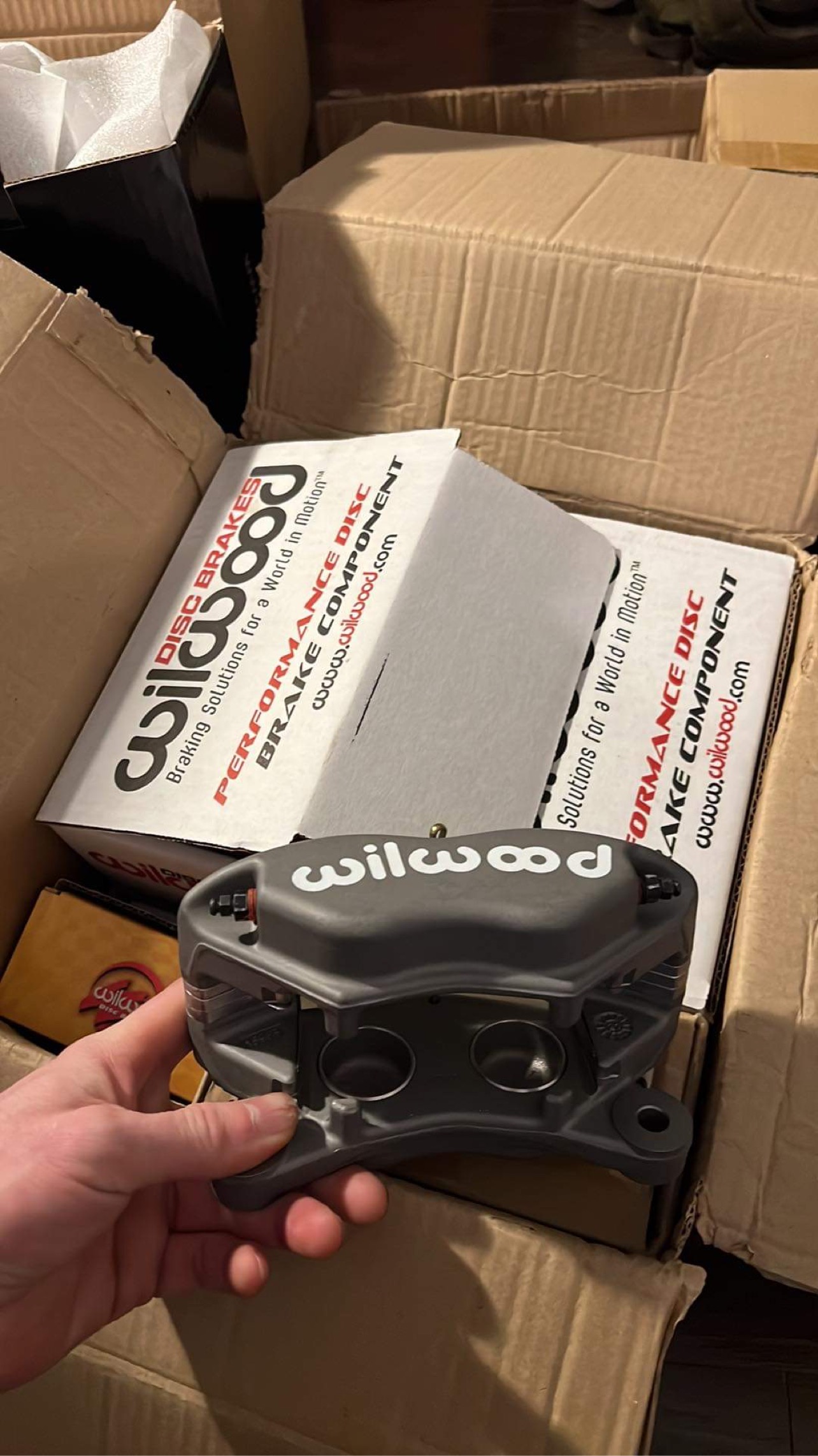

Willwood brakes are here ready to go on

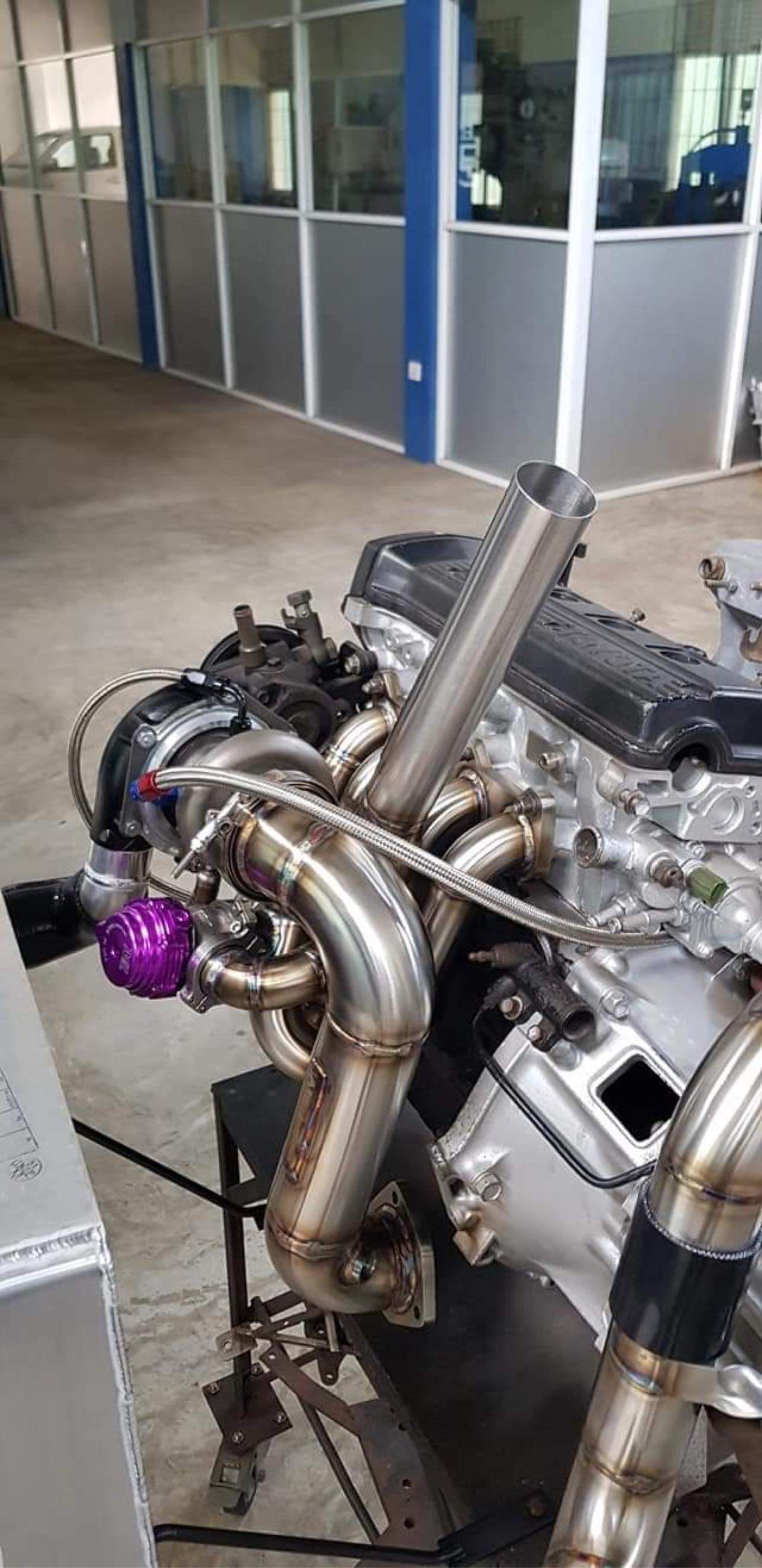

WEPR manifold is a real bit of kit looks lovely

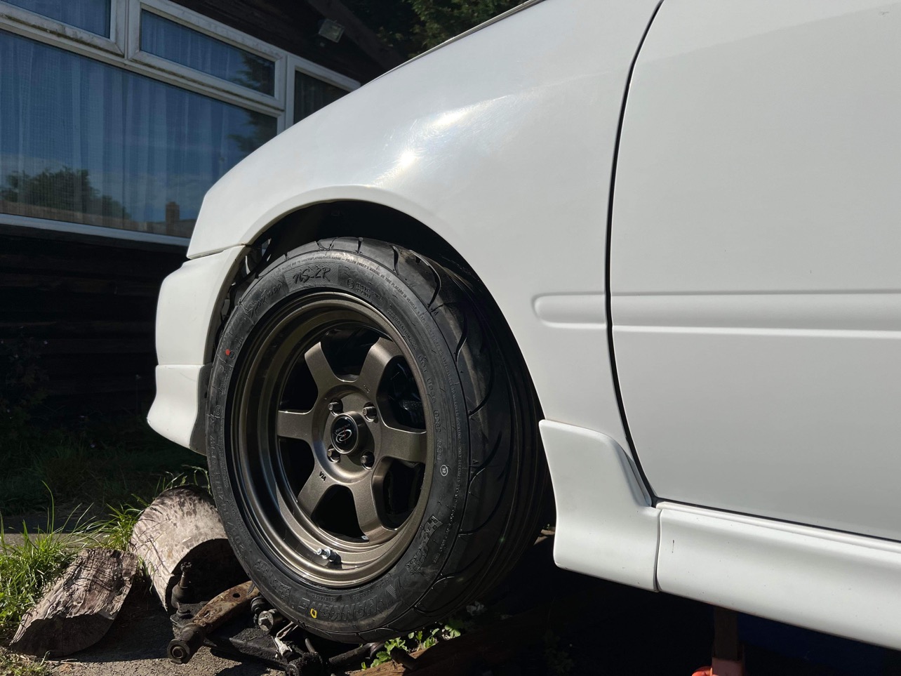

Test fitted the wheels and may have to figure something out with the arches or get some wider ones it’s very tight

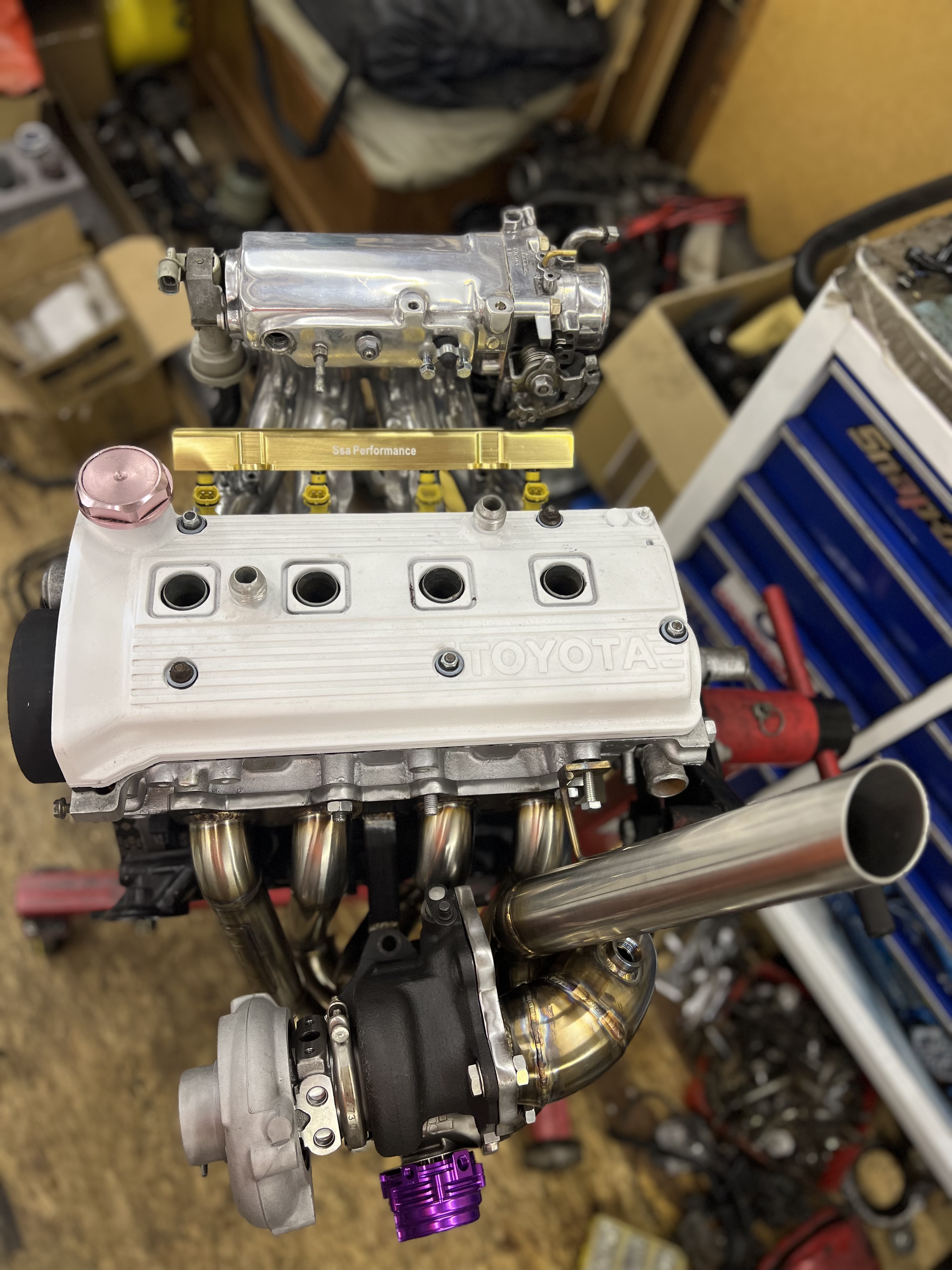

Another update

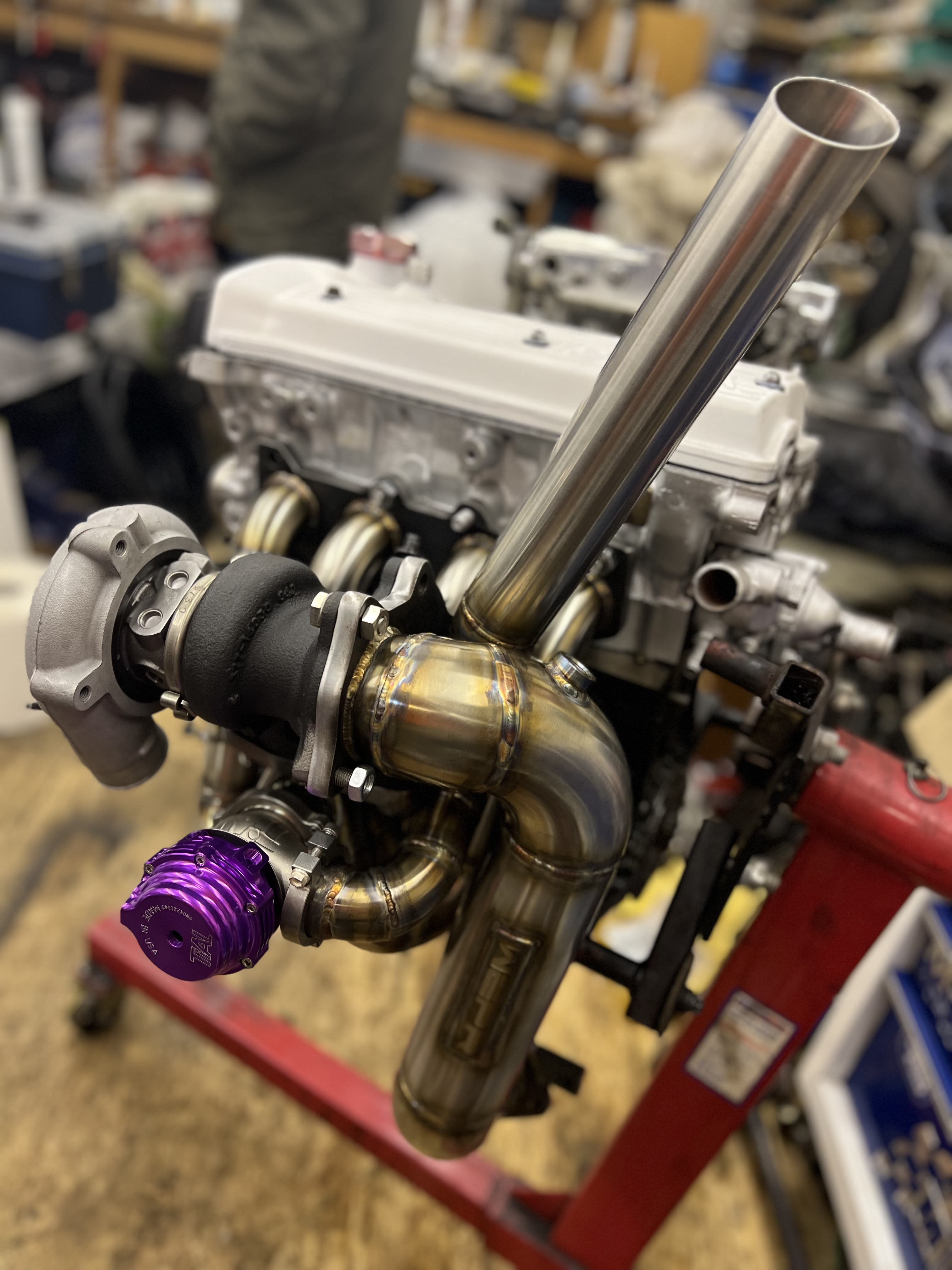

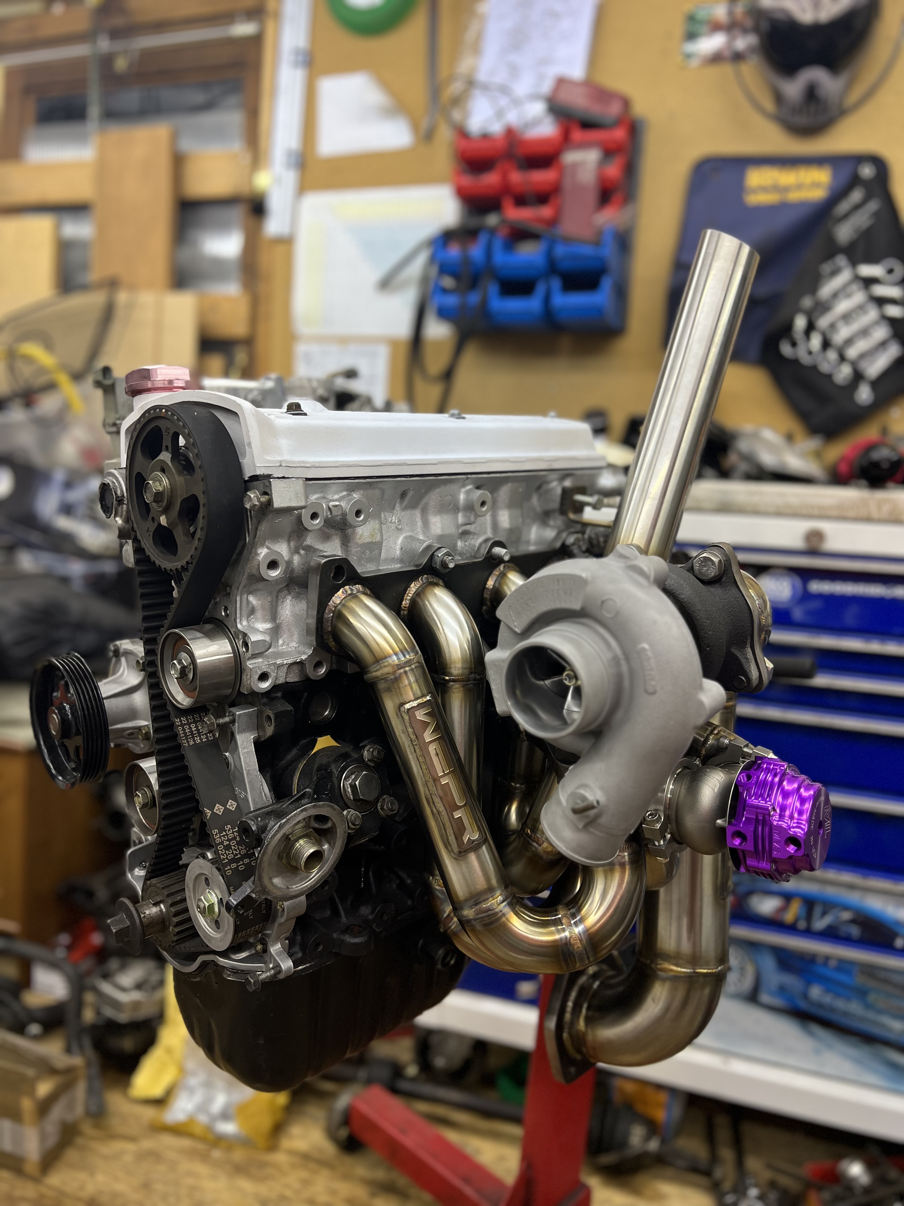

got some parts test fitted on the engine all looks good so far

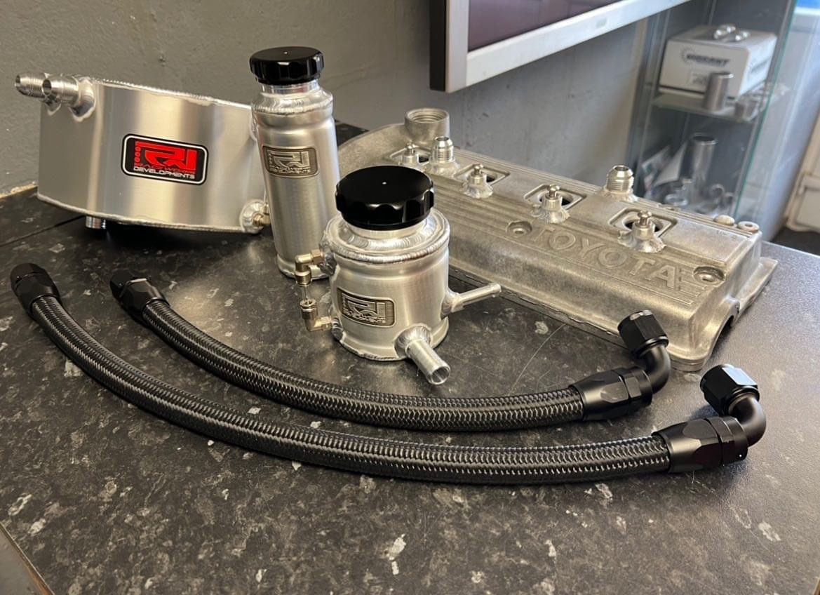

Ordered a RE developments catch tank & lines and a coolant reservoir tank

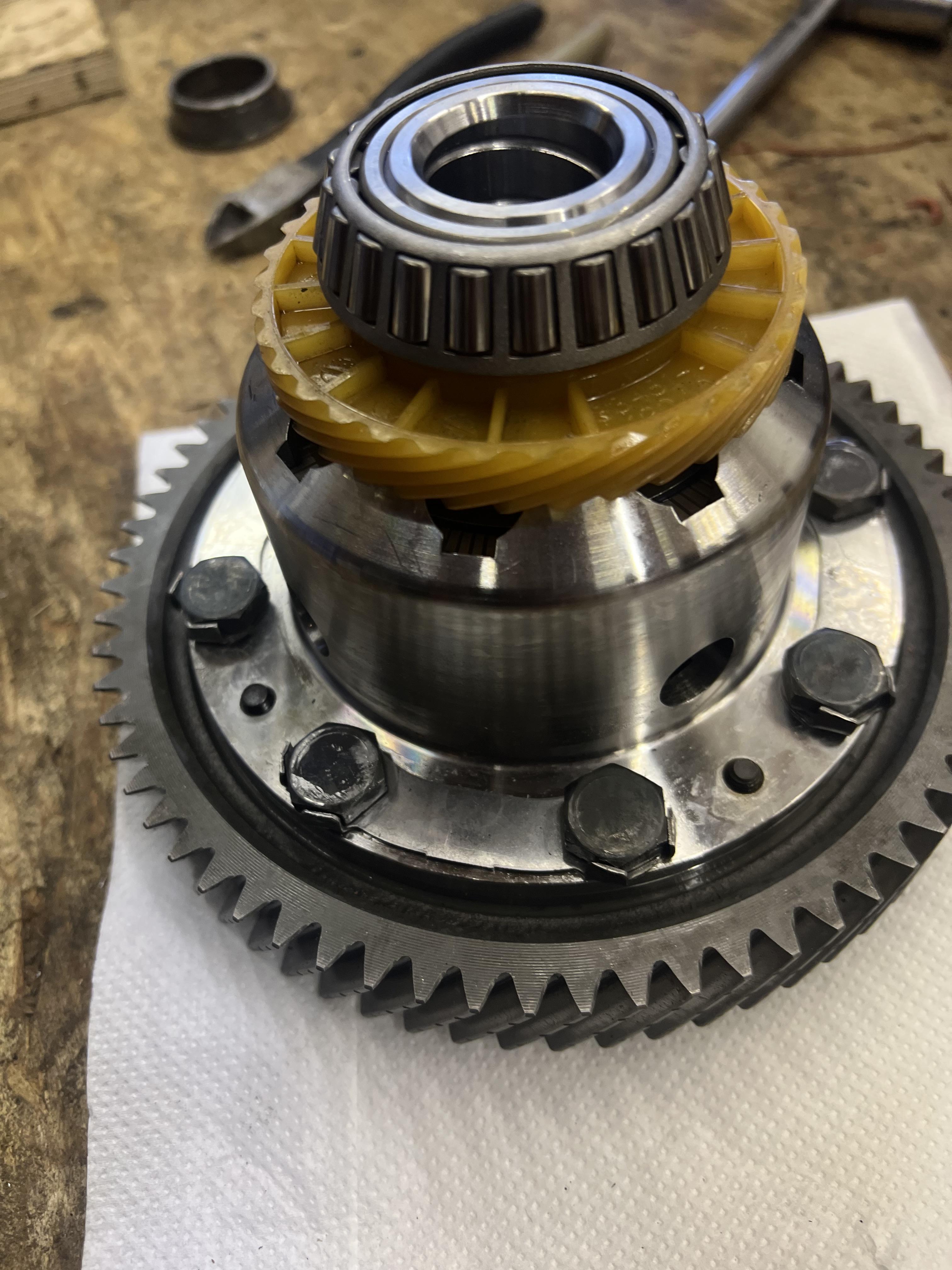

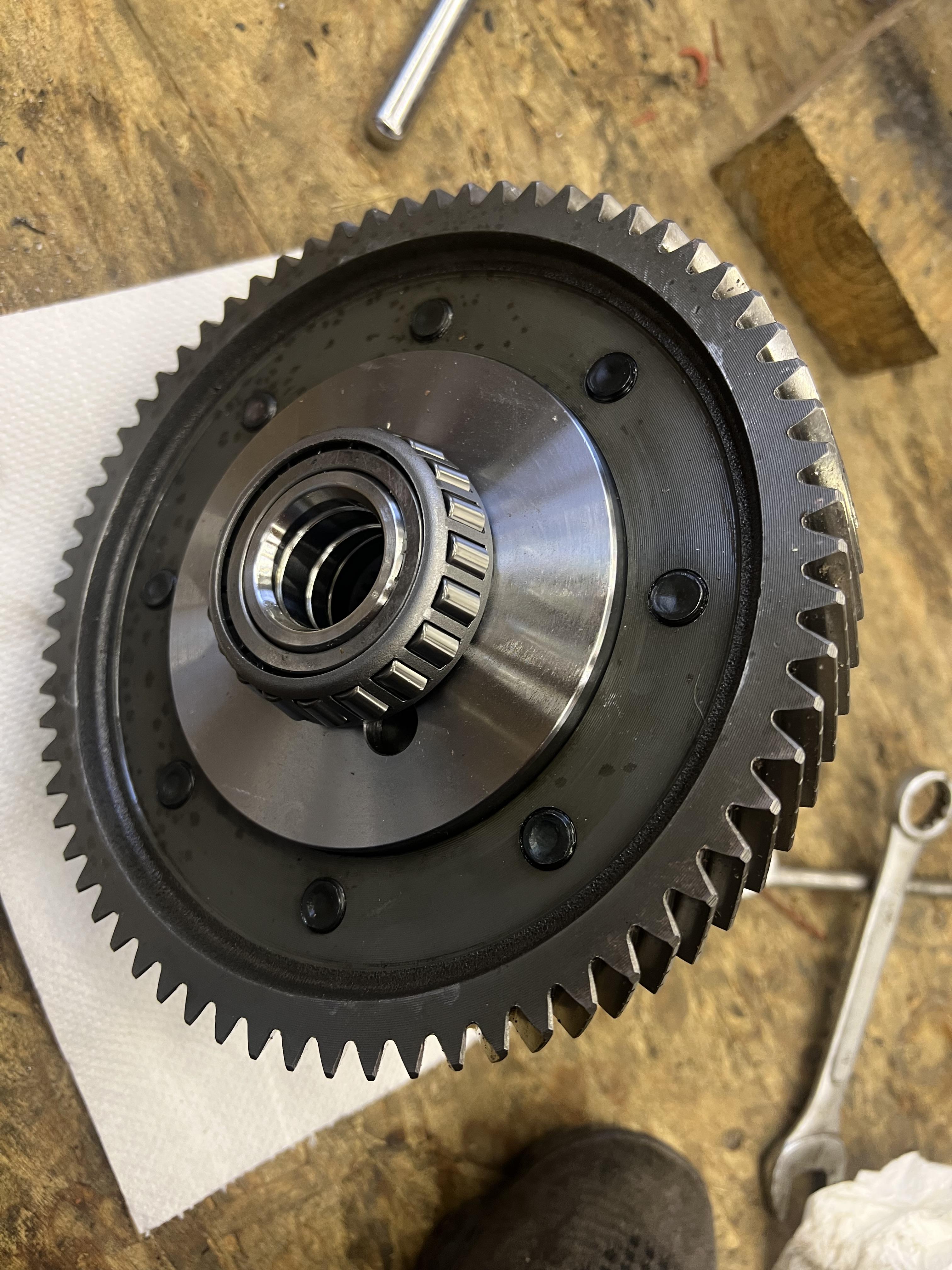

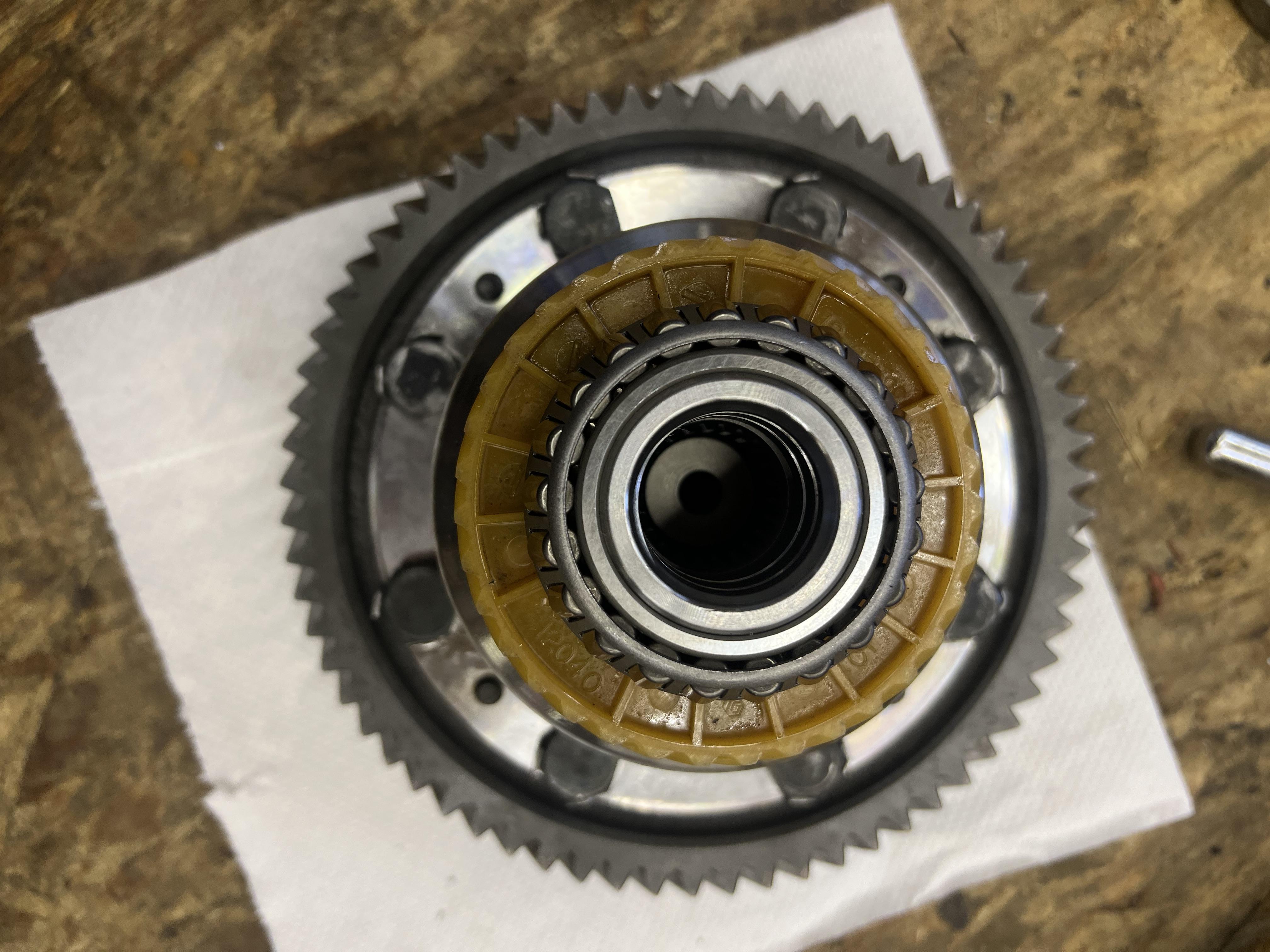

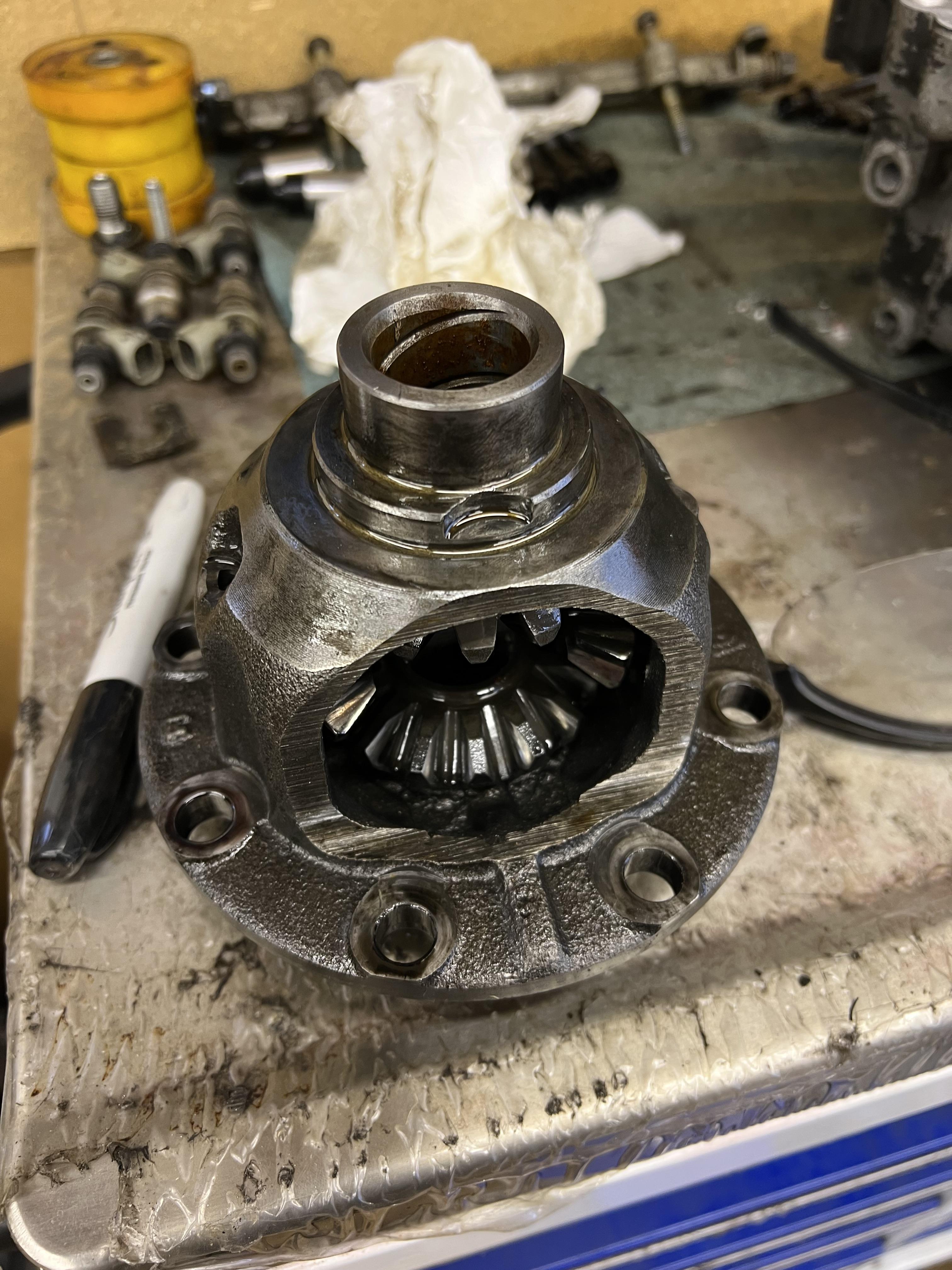

I then split the gearbox in half removed the old diff and gave it a little clean inside
I then fitted my new Kaaz 1.5 way diff and fitted new bearings etc

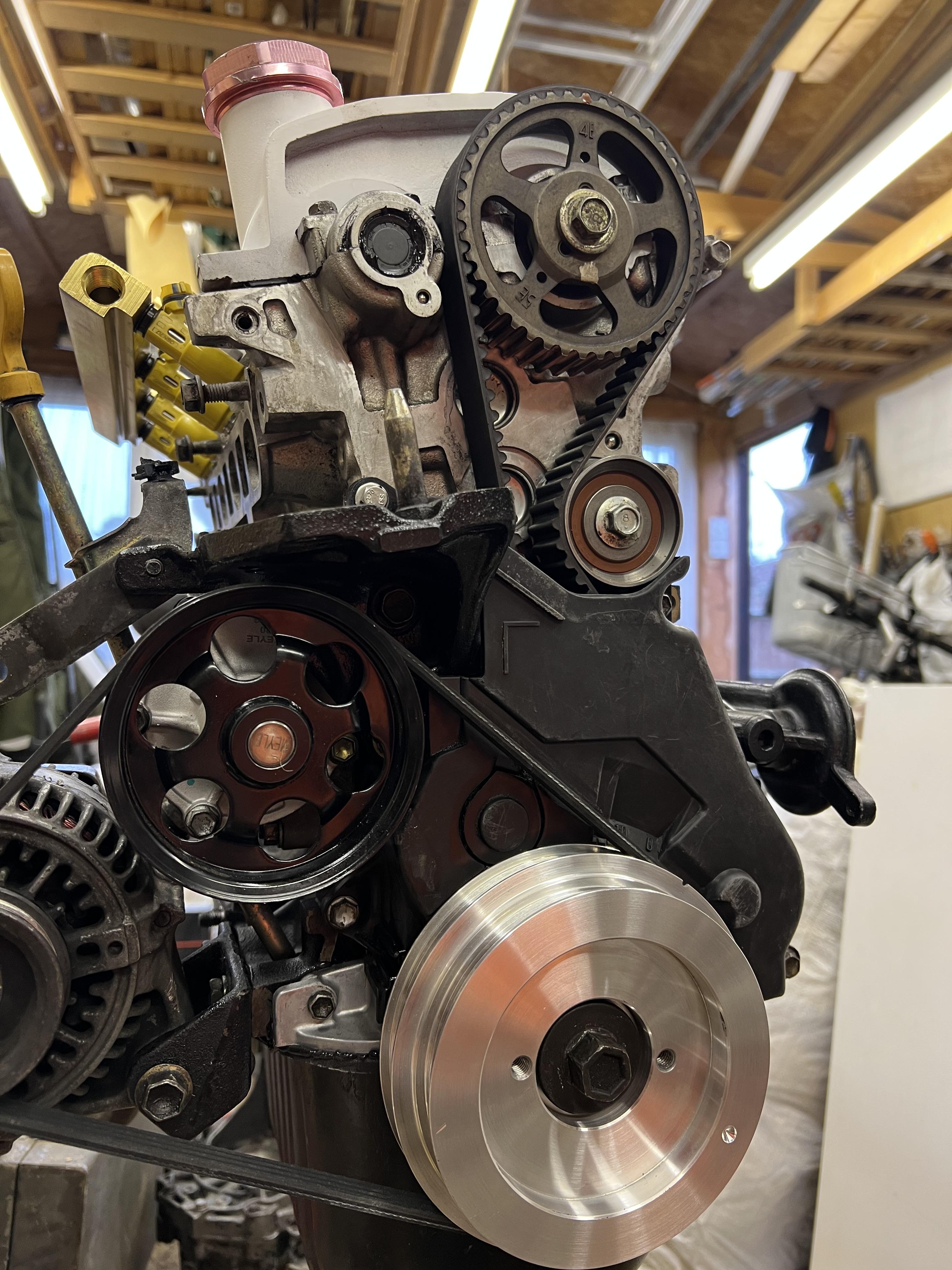

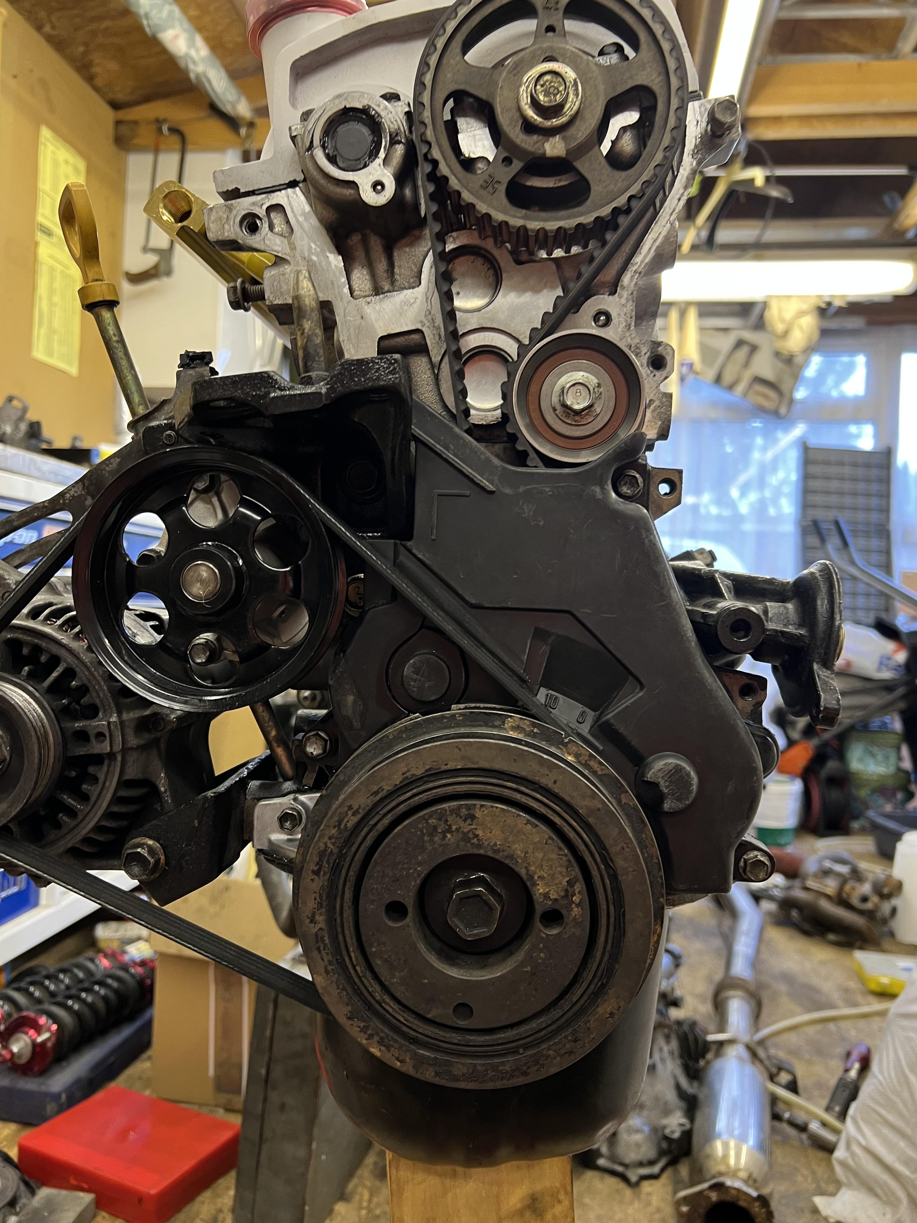

got sick of looking at the state of the old crank pulley
ordered a fensport one and really happy with it build quality looks good

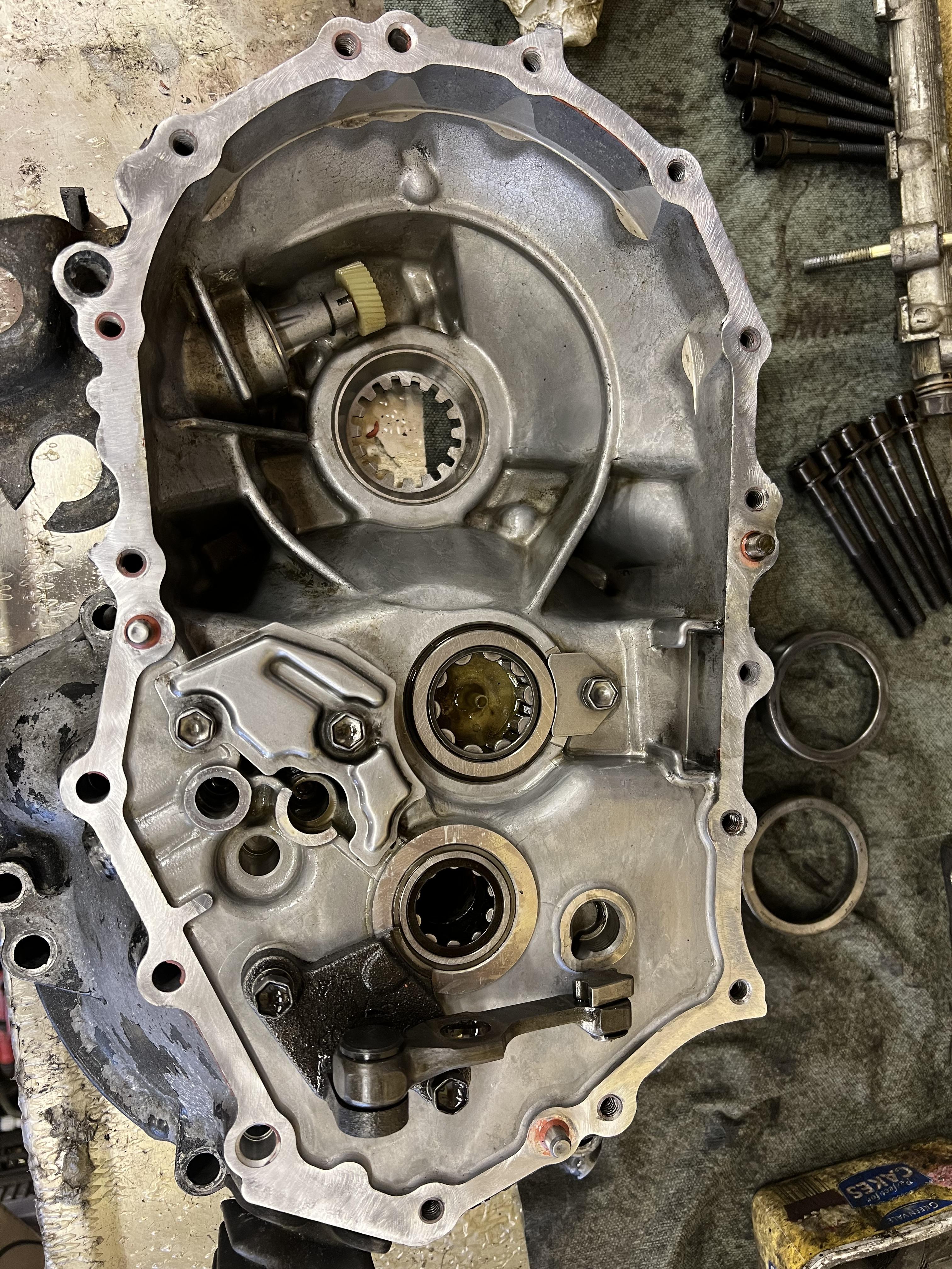

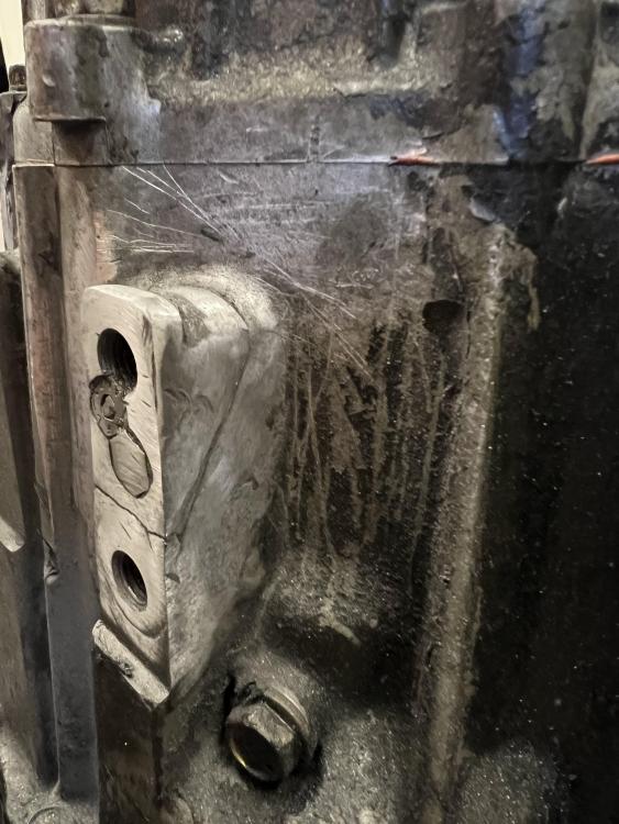

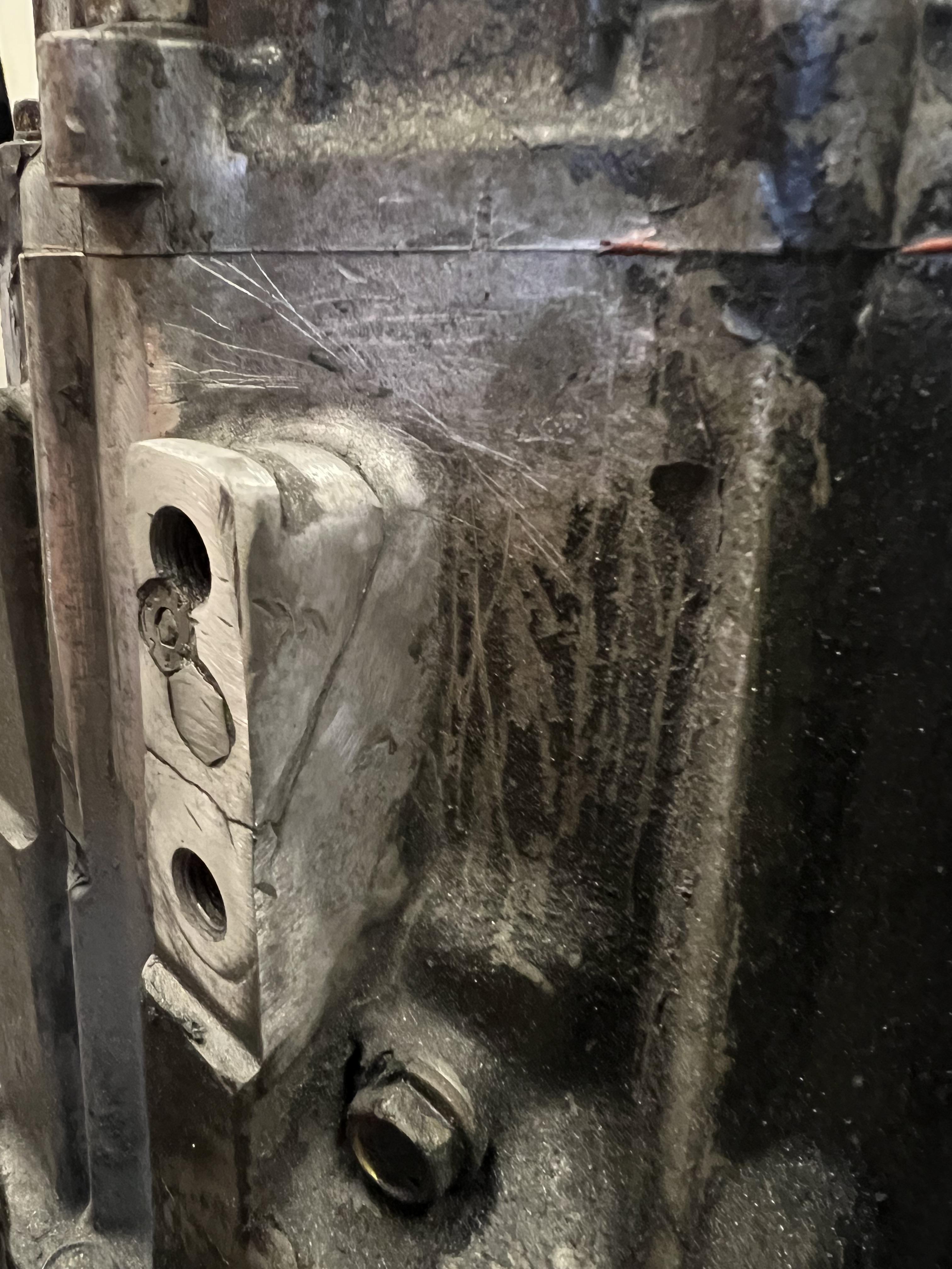

also sent my gearbox off to be repaired, I’m not sure what hillbilly done the last repair but oh my goodness 🤣
image.thumb.jpeg.29f7f3d48d2b5339564b319be5e2bd1d.jpegimage.thumb.jpeg.214e1dfdf408fdeec22fa1de64e5e032.jpegimage.thumb.jpeg.59fe9176b286d24506fafc669227586f.jpeg
pretty safe to say it won’t be staying like that

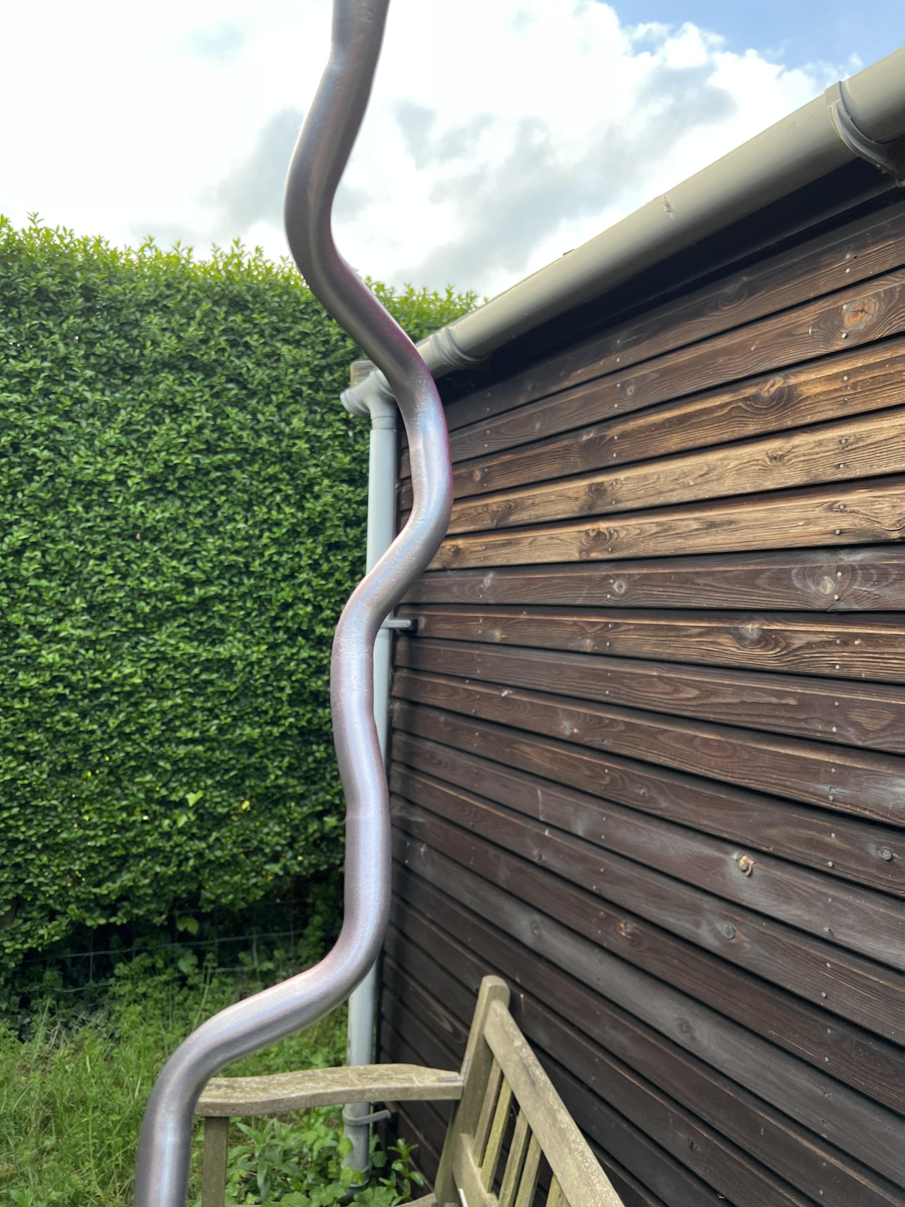

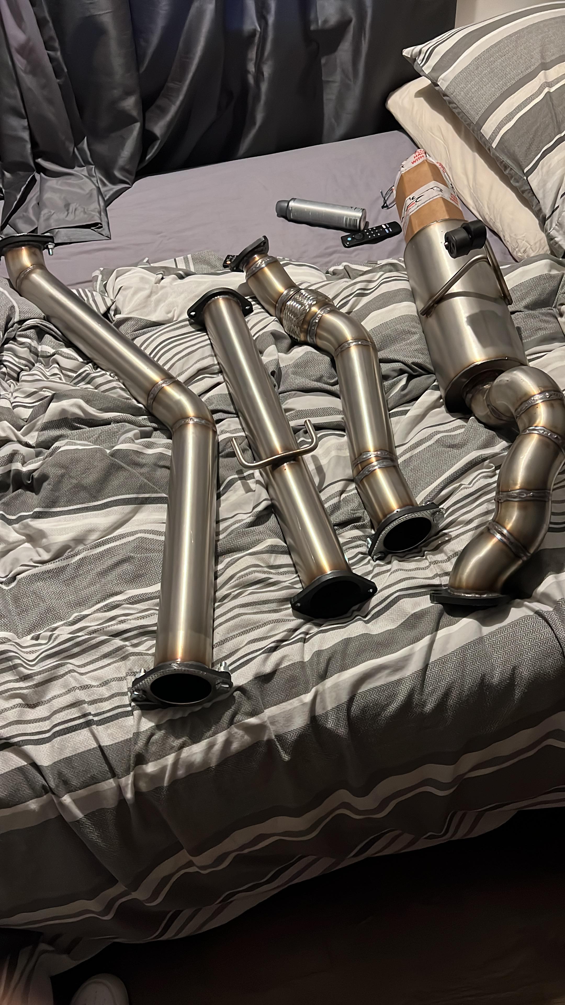

3” exhaust turned up just need to cut the downpipe flange off and get it matched up to my 3” wepr downpipe

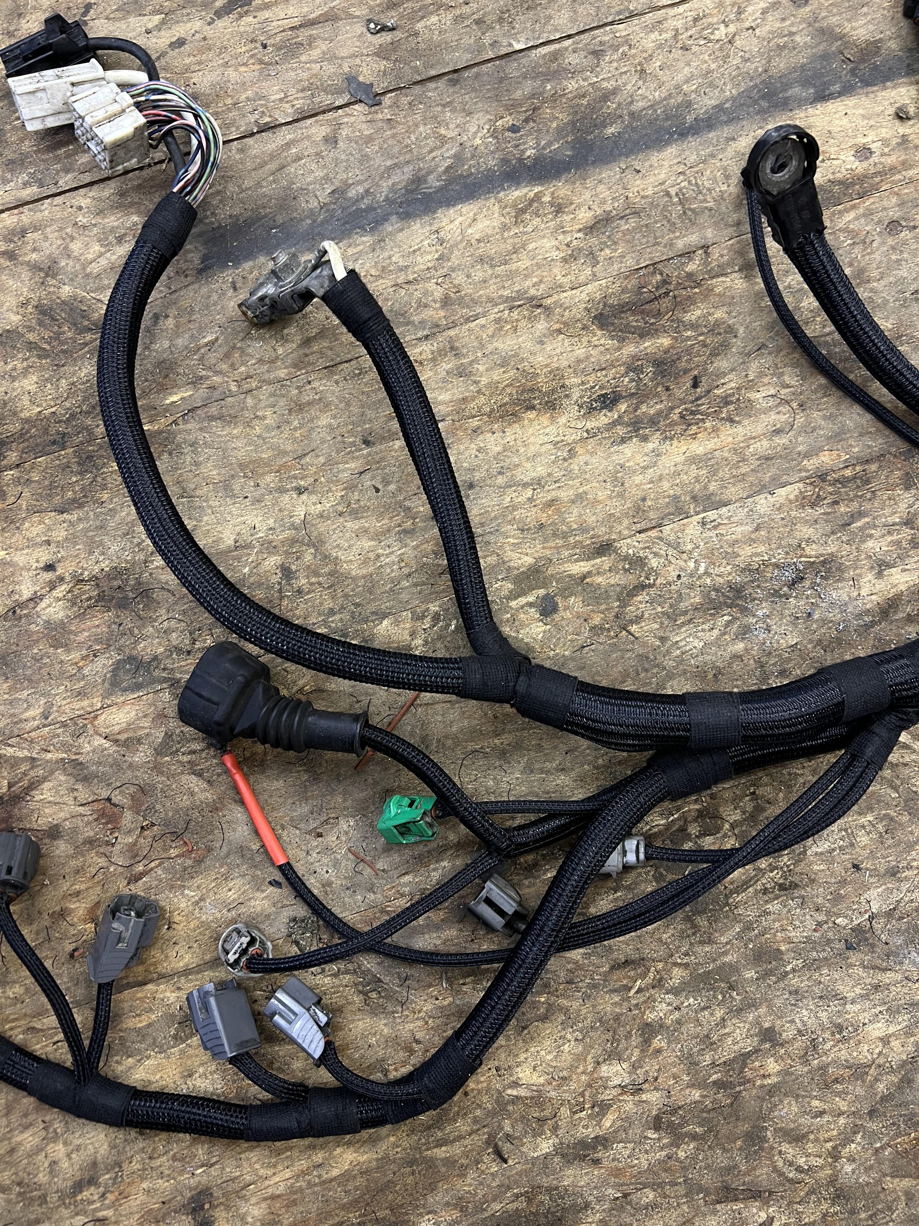

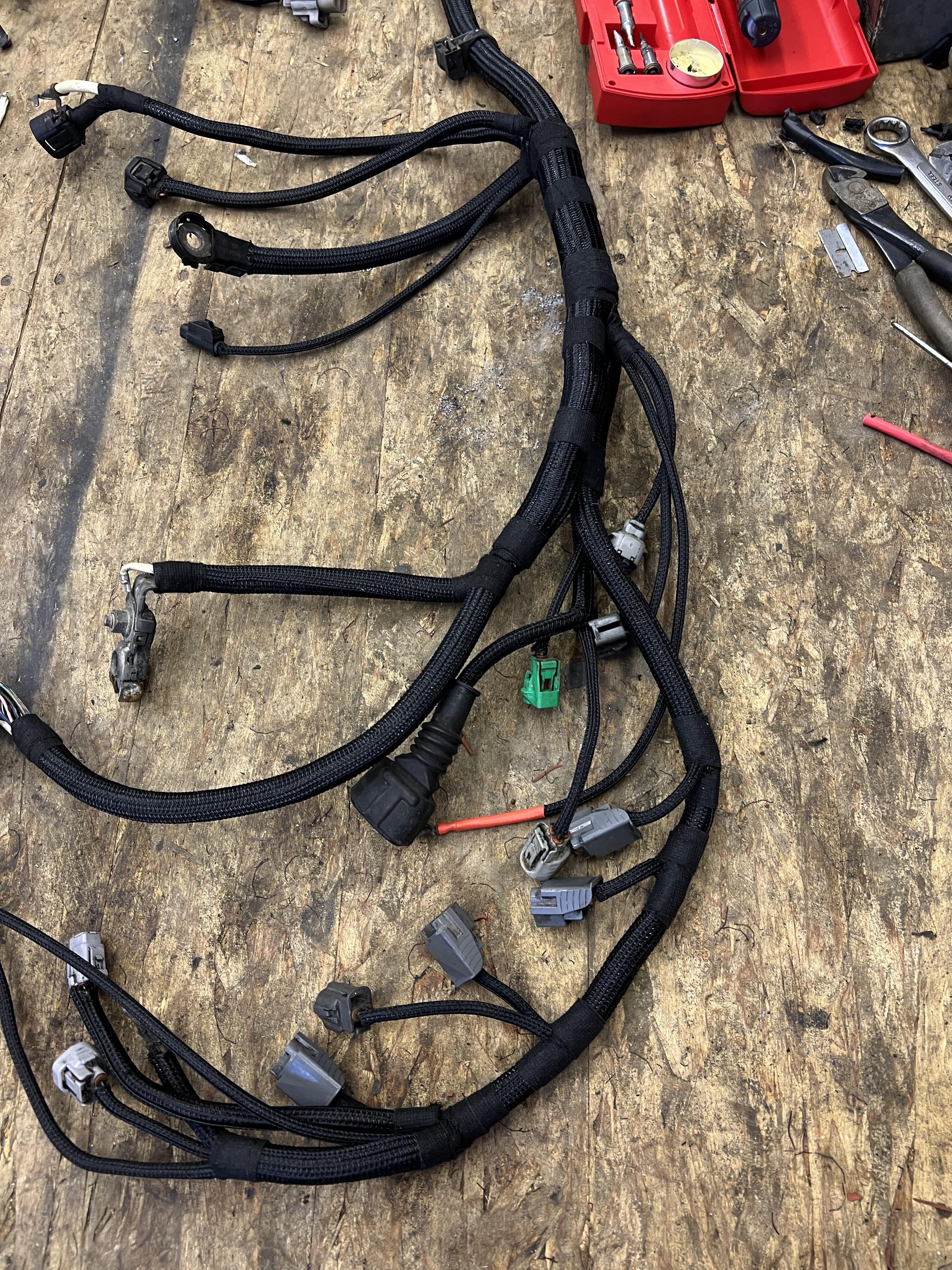

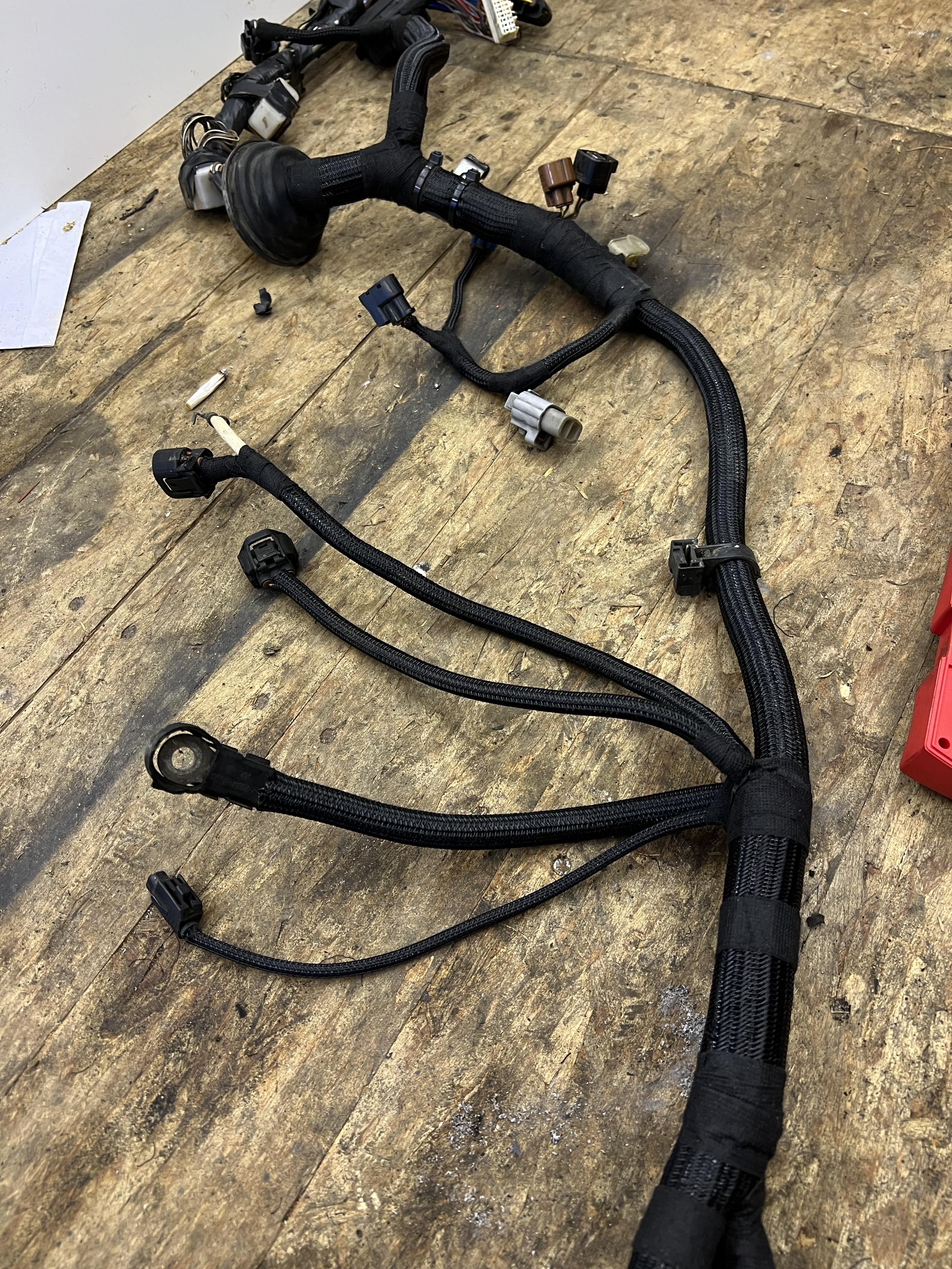

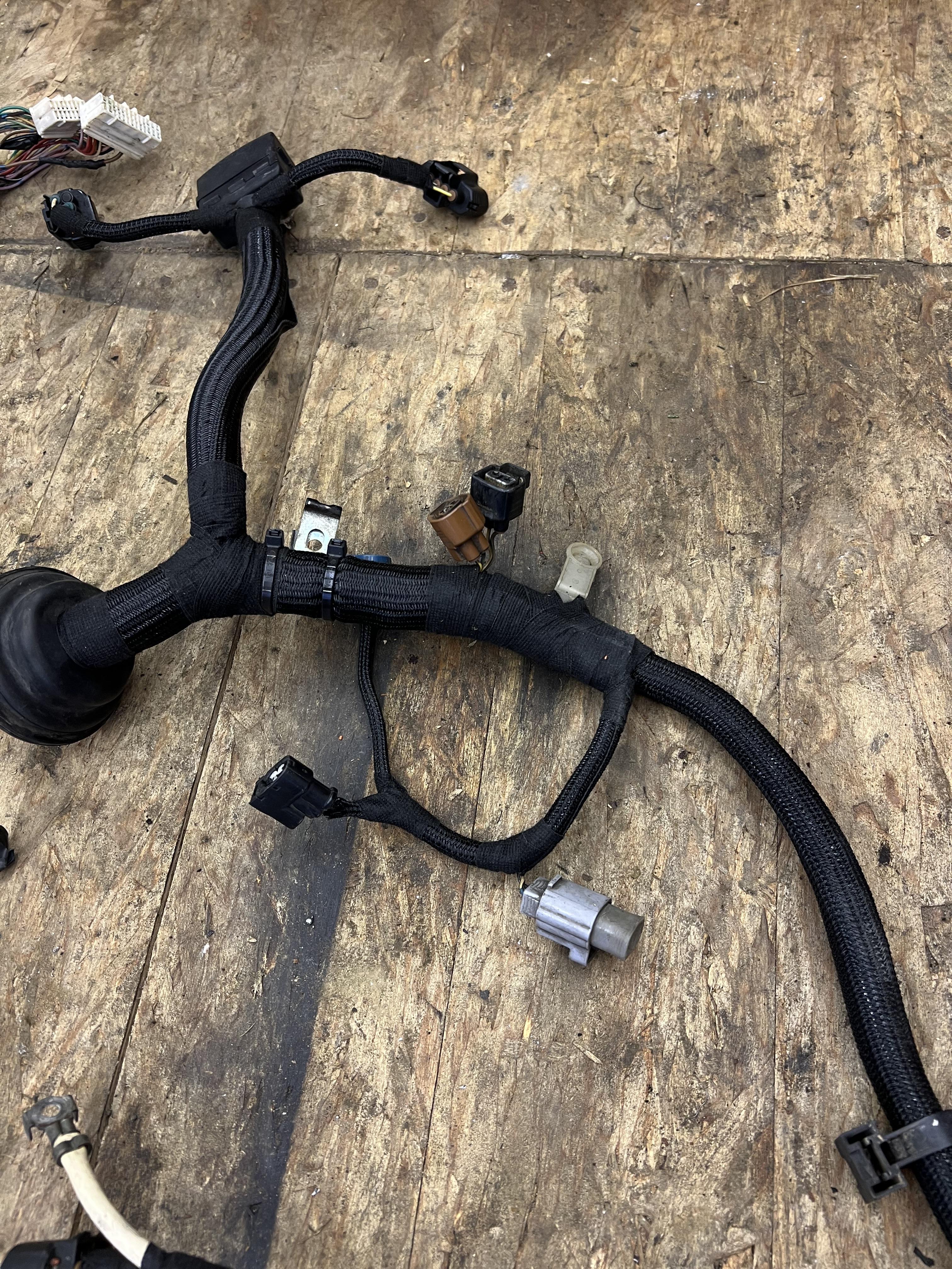

got bored staring at the first crusty loom so stripped it all back and re sleeved it in braided cover not 100% but looks 10x better
image.thumb.jpeg.a72a37aa3406088393f1a2a85533d645.jpegimage.thumb.jpeg.078d43356afe5b84773eae97e25347e0.jpegimage.thumb.jpeg.8b4f8756fd050e5ab53a26058010254d.jpegimage.thumb.jpeg.5f5c2323fe669ba243a12ea7ec8df2c8.jpeg

So bit of a bigger update as haven’t posted in a while..

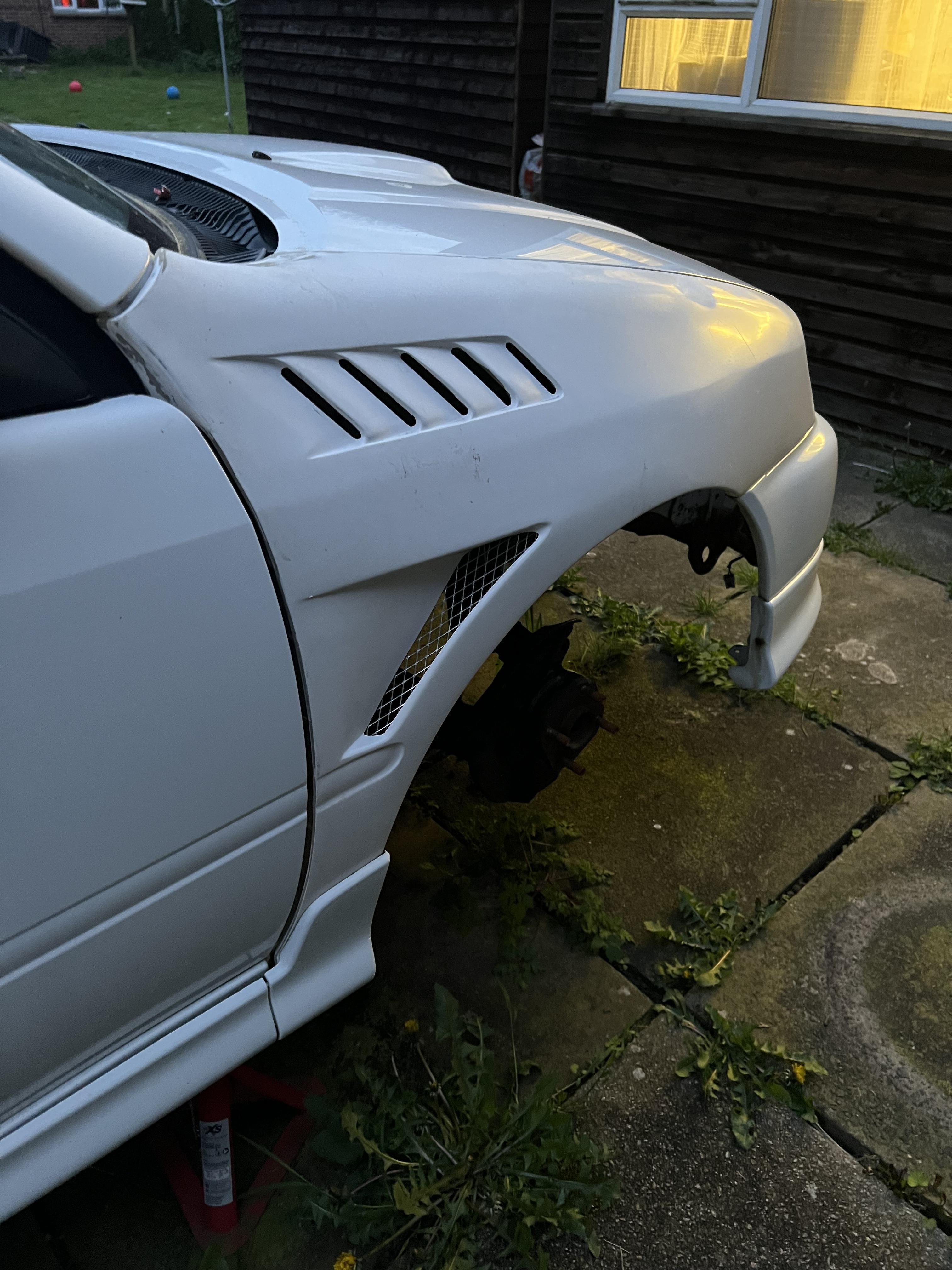

managed to source some livesports wings to fit the new wheel width still in gel coat yet to be painted

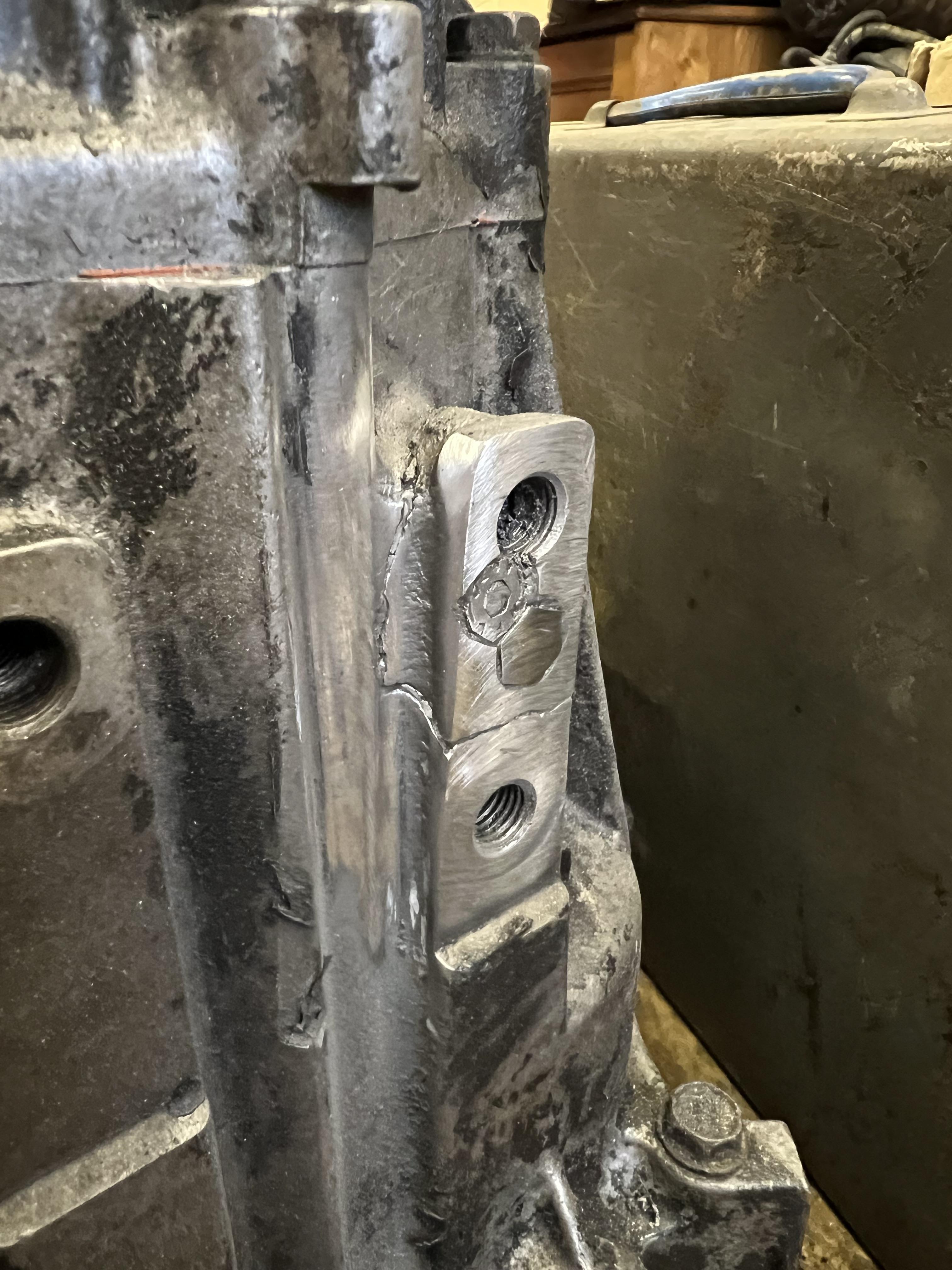

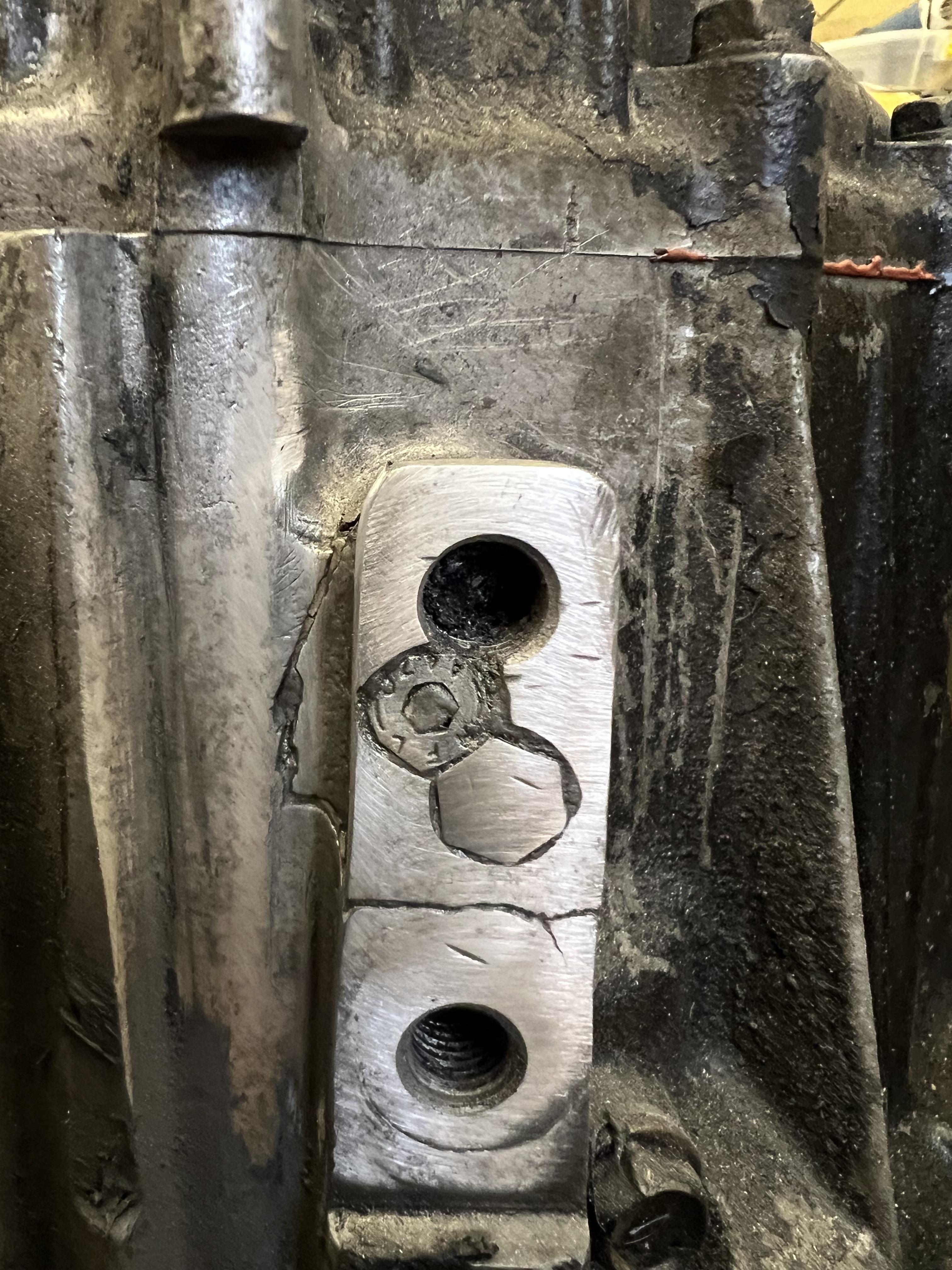

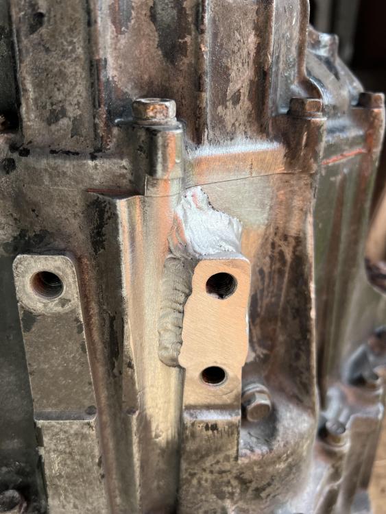

also got the gearbox casing welded up where there was a crack

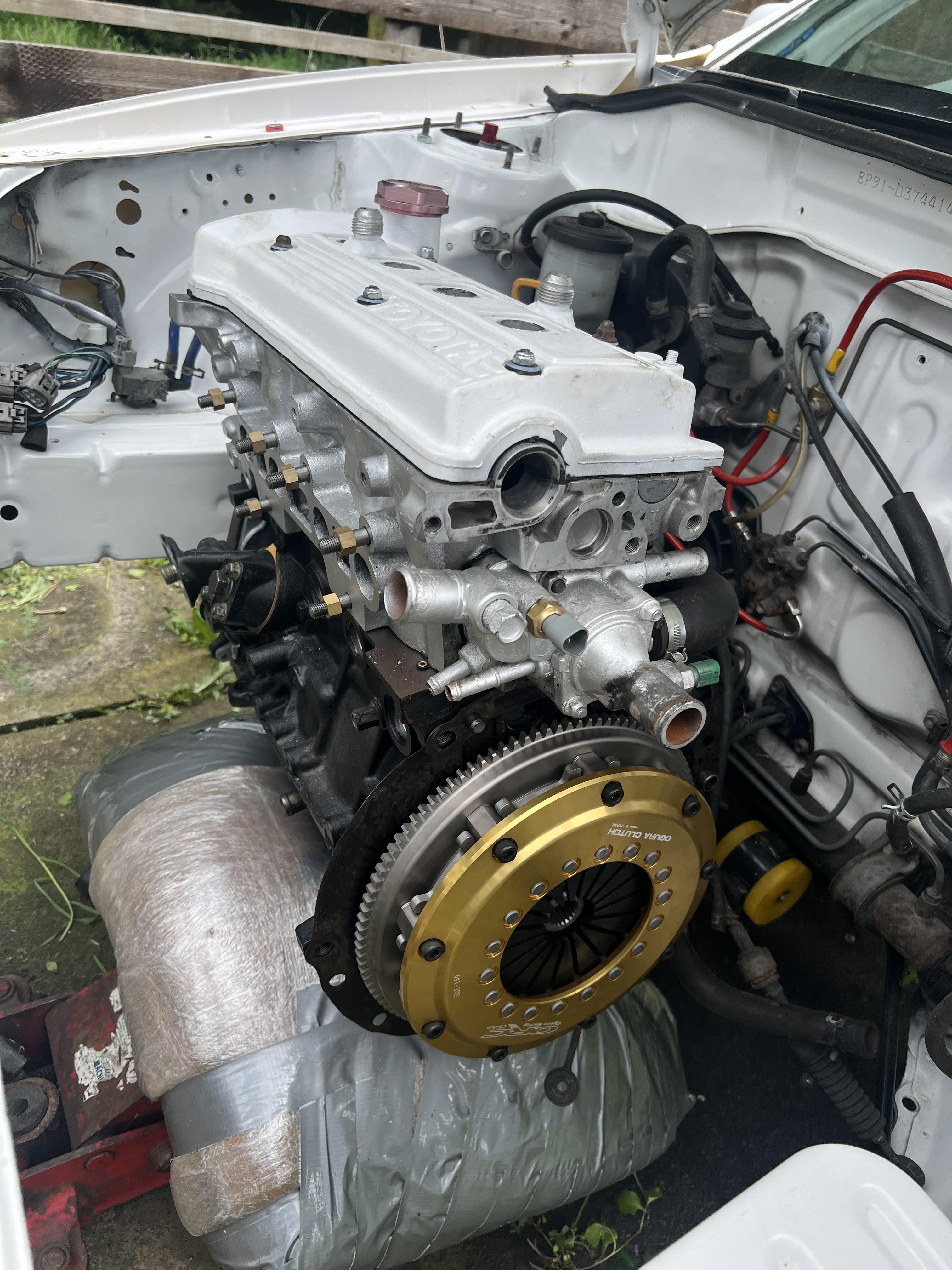

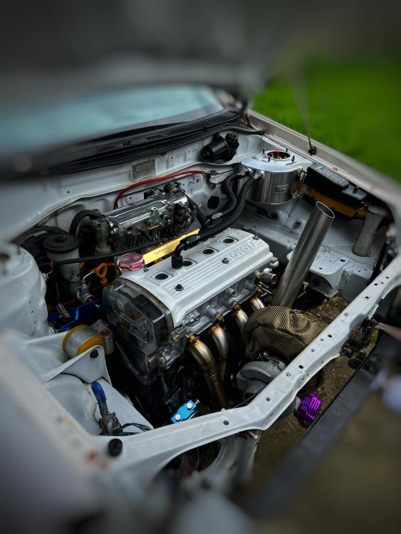

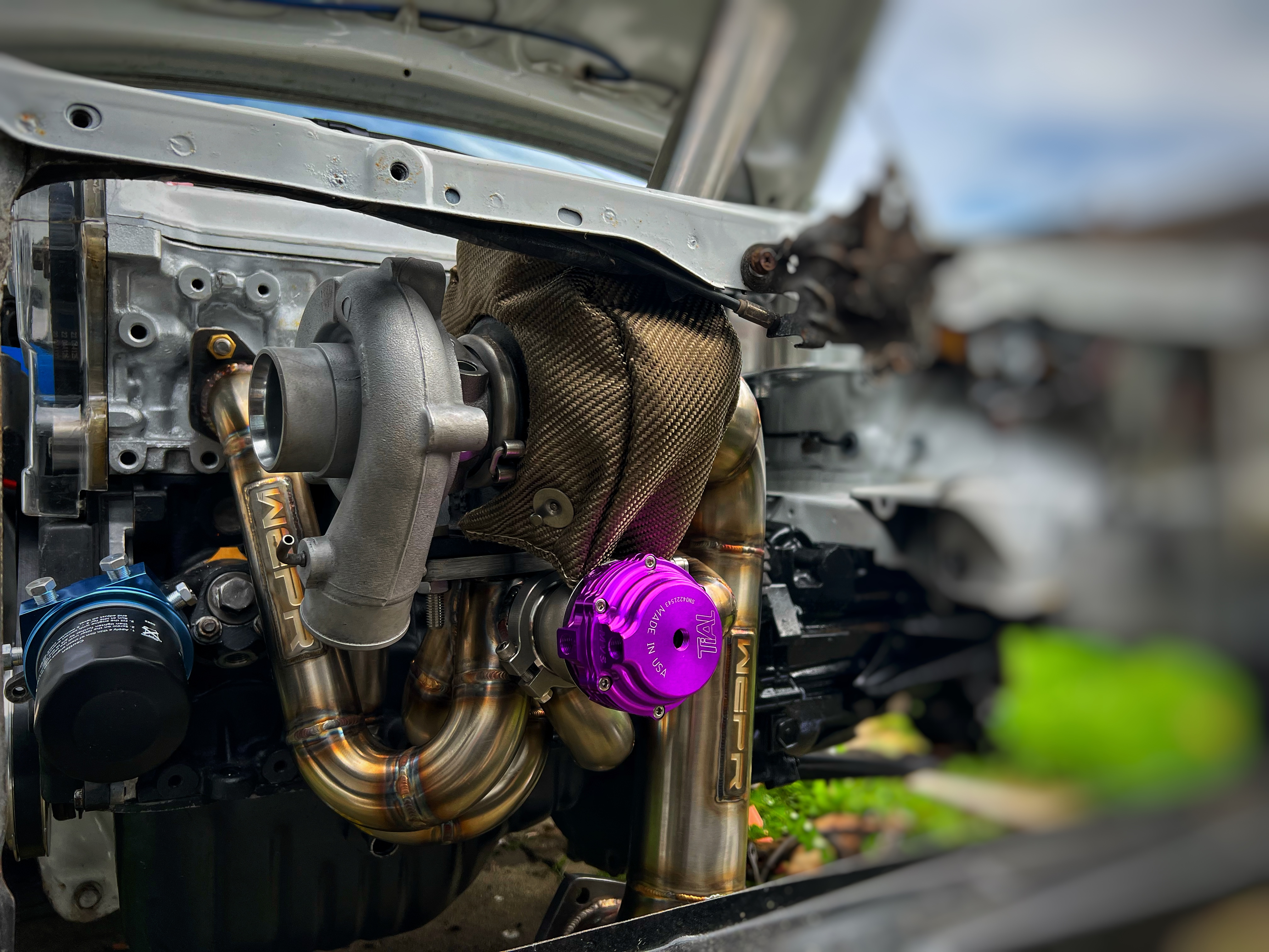

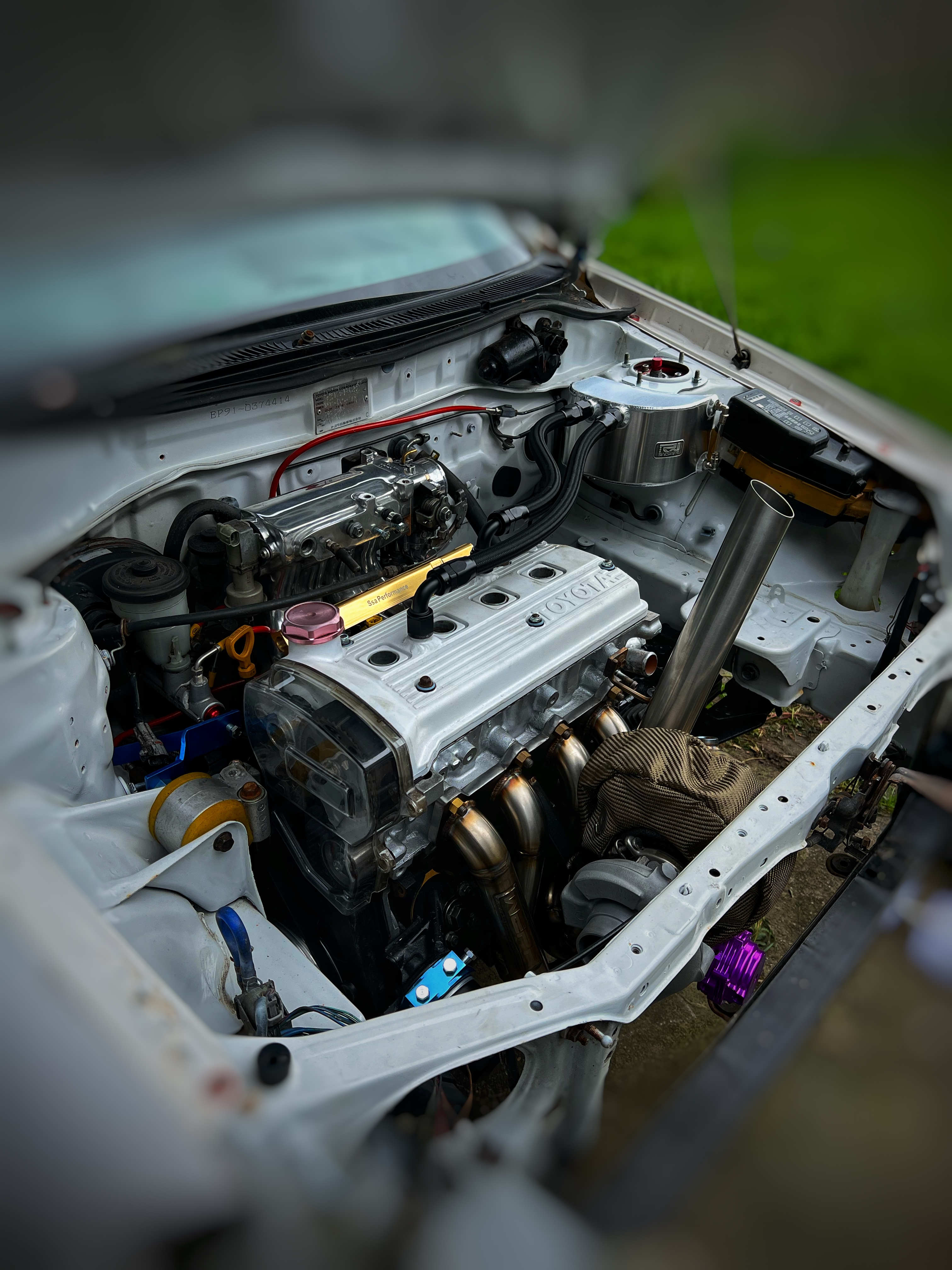

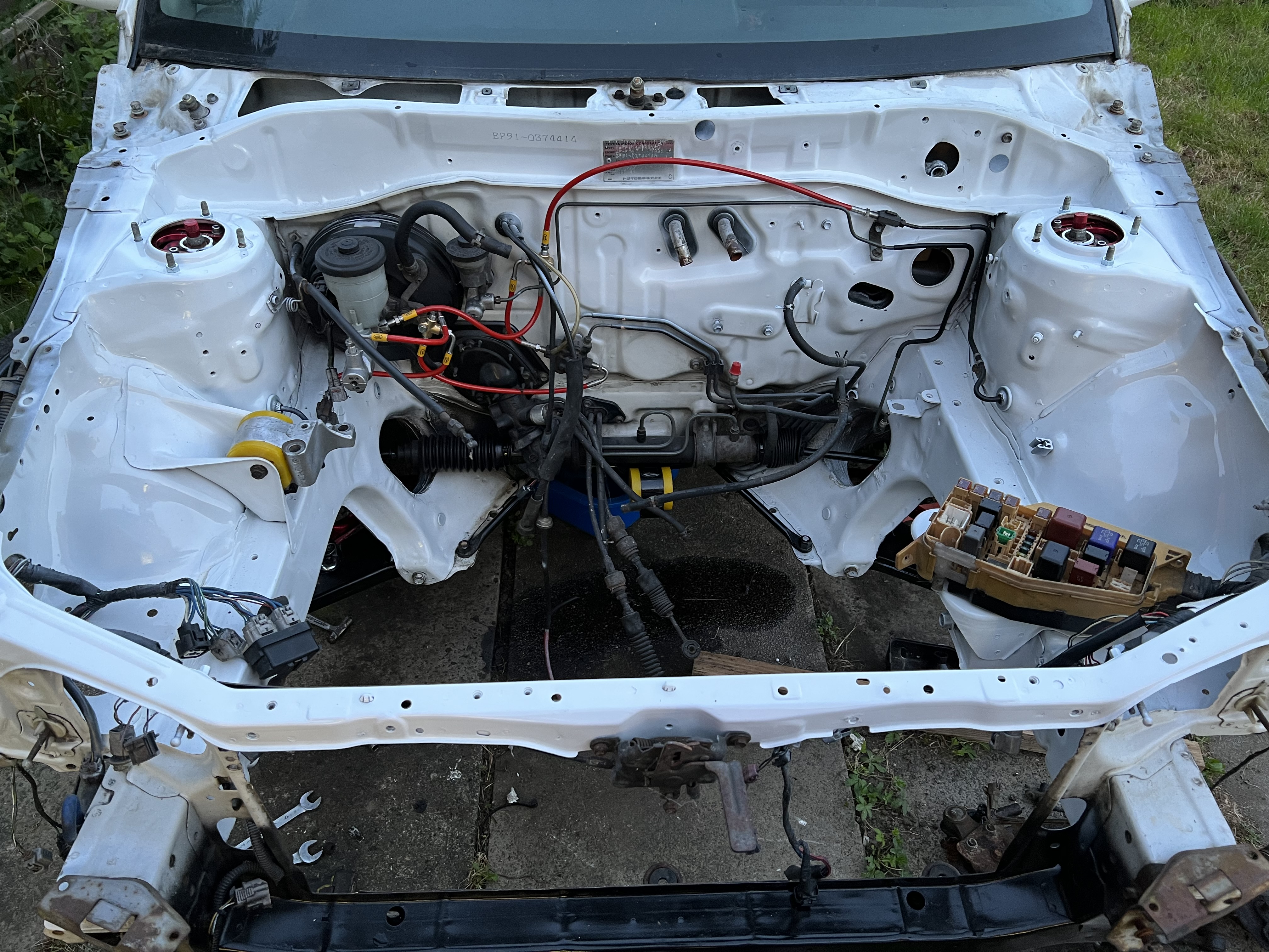

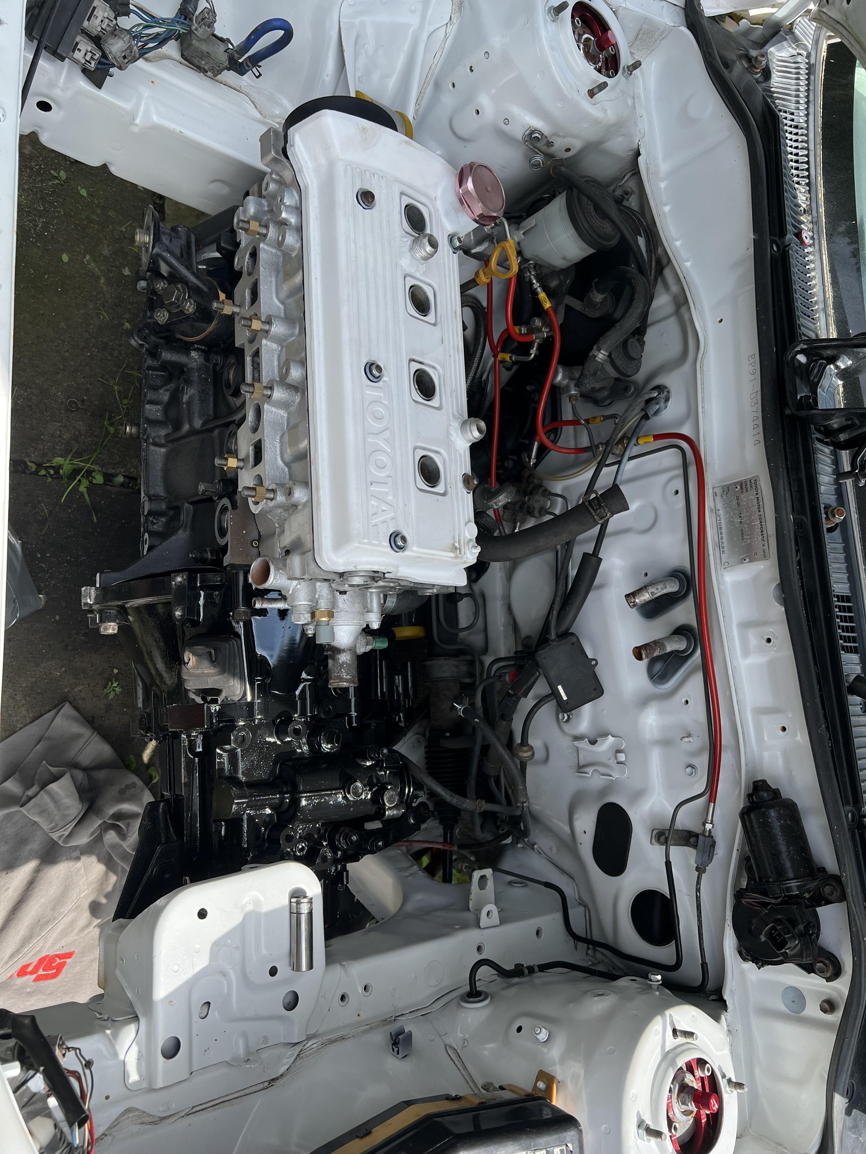

then managed to finally get the engine in! Feels a shame to be covering up the ORC clutch & fly 😭
gave the gearbox a clean and sprayed it black
then mocked up the turbo and manifold, also fitted the new catch can and lines along with the Cusco brake stopper

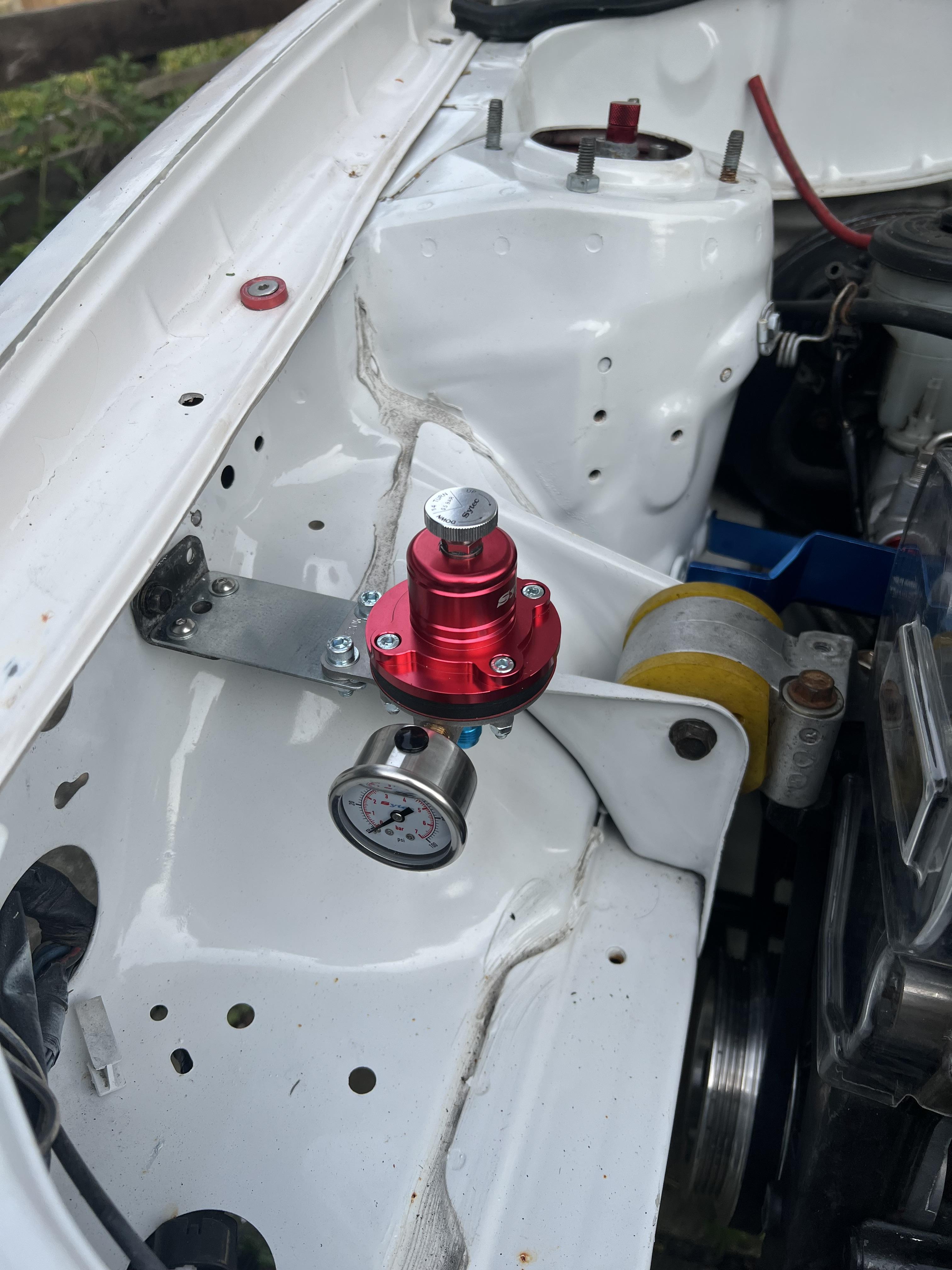

now that the abs & p/s are out the way I can mount the fpr here which I think is a nice touch
